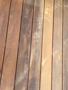

We had our deck powerwashed close to the wood a few days ago and plan to stain using either RAD or Armstrong. I have attached 2 photos of the deck + a 3rd photo of the porch ceiling which is the color we’d like to restore to.
A few questions please:
1) Do you think we should use RAD stripper + brightener first based on these photos? Unsure if the deck has been stained in the past.
2) As for the stain, do you have a recommendation on which color for the RAD semi-transparent stain to match picture #3? We were thinking Natural.
3) If we go with Armstrong instead, do you have a color recommendation?
1, It would not hurt.
2. Natural is similar to a clean wet look so that would be closest.
3. Amber

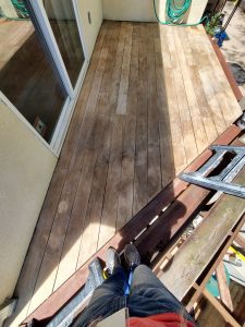

Looking for advice on next steps on prepping ipe decking. We are refinishing a neglected section of decking. So far, sprayed and scrubbed with sodium percarbonate, rinsed and 1x treated with oxalic acid. There are a lot of light spots from flower pots along one edge (photo is wet state after acid). Would it be better to apply acid one or two additional times or sand to try and blend light spots?
Is there an old stain on the deck? If so, it needs to be all stripped off and then brightened. If it is just wet, then send a picture with the wood dry.
The deck only had it’s mill finish on it and that was 10yrs+ ago. It was weathered and silver colored prior to Sunday’s treatment. This is a photo from today, after it dried.
The only way we think you can even it all out is to power sand it evenly with 60-80 grit paper.
Thanks for the advise. I just want sure if some additional acid (maybe citric) would help help prior to the sanding. I appreciate the input.
No, doubt it will but you should use a wood brightener after the sanding is done.

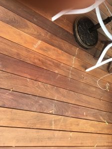

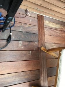

Hi – My new and newly stained ipe deck surface scratches if you breathe on it. I followed all your excellent advice, used restore-a-deck to prep it,both bleach and cleaner, had enough dry days to stain, waited for a while to put furniture on it… and it seems every time something is dragged, I get a surface scratch. Some of them big and ugly. I don’t think the ipe itself is scratched, but it’s sure discouraged me from ever staining again. I keep reading you can’t scratch these decks.. but in my case it’s a mess. What did I do wrong? I used Messmer IPE hardwood natural stain.
Could be that the Messmers did not cure correctly? Post some pictures.
Here you go. Some from furniture movement, some from soap with some bleach, the big wear spot I have no idea.
sorry, pix didn’t load. Will post one at a time
bleach stain
You used “bleach”? You cannot use bleach on deck stains.
No, I did not use bleach. While pressure washing the house, the lovely gents who are painting the house dripped a little of the soap/solution which i assume includes bleach or a lightener of some kind….. I guess i used the word ‘bleach” inaccurately. This was the result. In another spot like this, prior to staining, I had similarly dripped a little of the restore-a-deck part 2 mixture that lightens the deck. That left a lightened mark like this that never smoothed out when the rest of it was done.
They used something in their cleaner that “bleached” out the deck stain.
furniture moved
It looks like you are dragging it and actually denting or gauging the wood in this picture.
yes, this was the work of lovely gents who are painting the house.
I would wait until next year and then strip and brighten all and then use a stain that is not as “soft” as the Messmers. The Defy Hardwood Stain or Restore A Deck Stain in Light Walnut.
thanks! The painters have suggested sanded and patching… but I worry that will look worse. Interesting to hear Messmer’s described as soft. Good to know, thanks!
unknown source
The same thing happened to me and yes it was cured. This is just what IPE does. I moved some furniture on it too. Penofin oil was used on my new deck. Furniture was put on the deck one month later. Also when it rained it left water marks. Its been a year now and I have to decide what to do. Someone told me to try Deckwise cleaner and brighter then their IPE oil.

Why is the Penofin hardwood stain appearing spotty? If you zoom in you’ll see some spots look dry.
It is the grain of the wood and being more absorbent there.
We aren’t done staining other side of the deck. Do you suggest re-applying to those areas where it appears to have over absorbed the stain, letting sit a few minutes then wiping?
No, it will not work to spot apply as it will not blend.

We have an older IPE deck that we have had various finishes on. I haven’t really liked any of them. I decided to strip the deck down. I used Benjamin Moore Remove. Due to the weather I have not yet applied the Brighten. According to the pictures, what should be done to get it back to the IPE’s original color
Try Armstrong Clark in Amber color.
Do I need to sand the deck to get the power washing marks out?
That would be the only way to fix those marks. If you do sand, do it now and then let the wood sit for 1-2 months. Clean and brighten after for final prep. This will make the wood porous enough for the stain.

Stripped and stained IPE deck with Flood Hardwoods stain tinted with The cedar formula. Apparently This product has been discontinued by PPG. Can I apply a water base hardwood stain by another manufacturer directly over Flood product without re stripping. If so which product?
Bill G . Breezy Point, NY
No, you will have to remove the Flood before switching brands.
