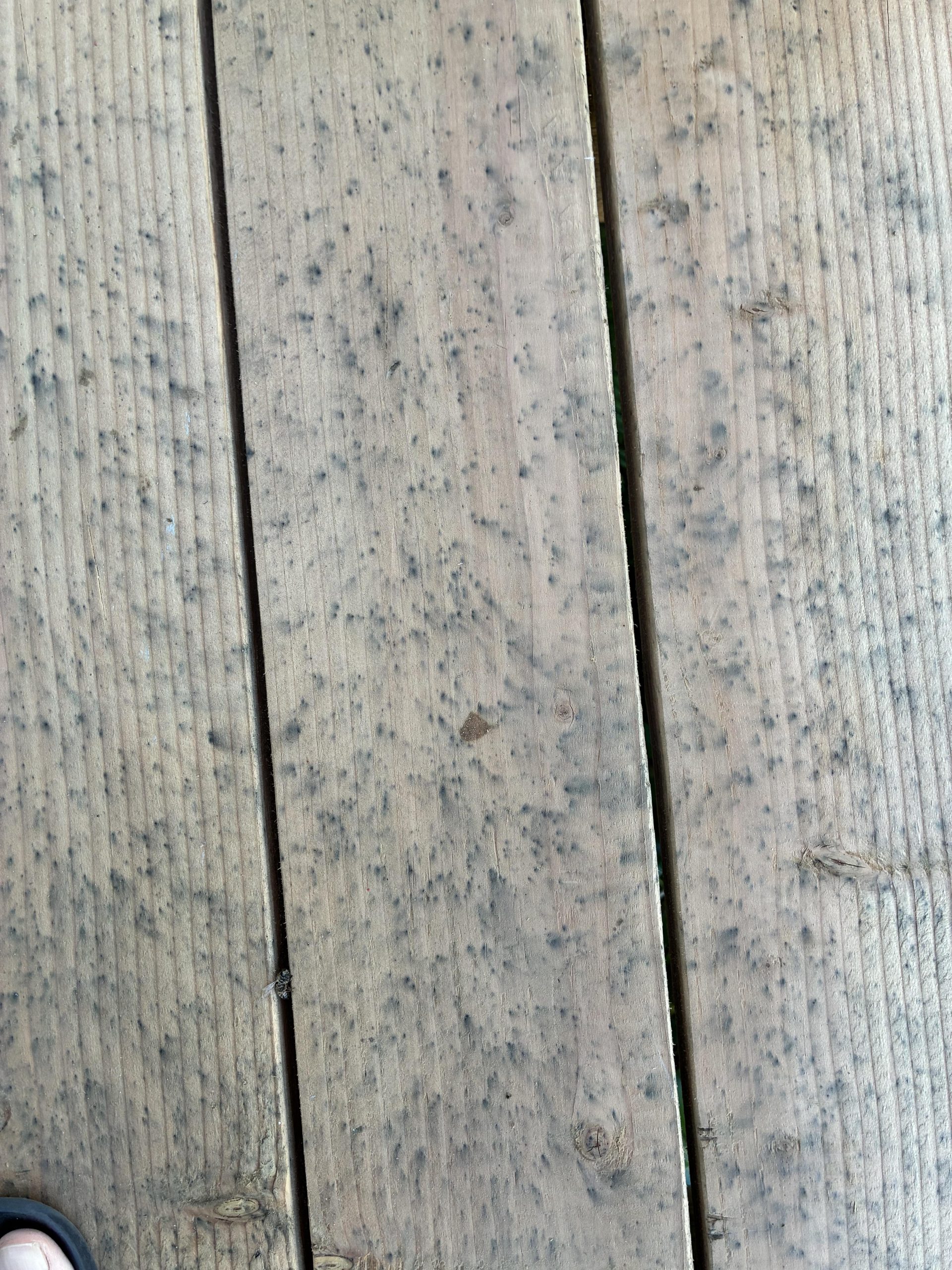

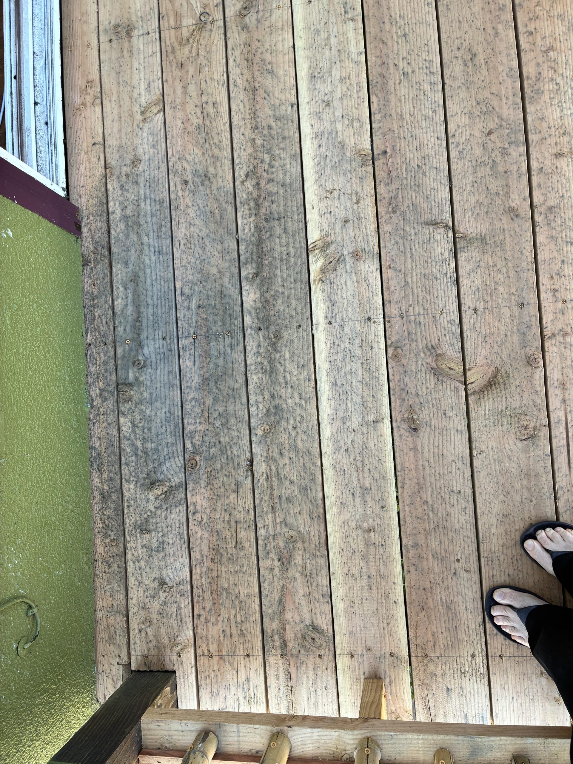

Just installed Doug fir planks to replace deck and it rained before staining. Looks like black mold. Any help appreciated north facing deck in Northern California.
Not mold but rust. Something was cut above that area, and metal shavings got into the wood. Read the article above.

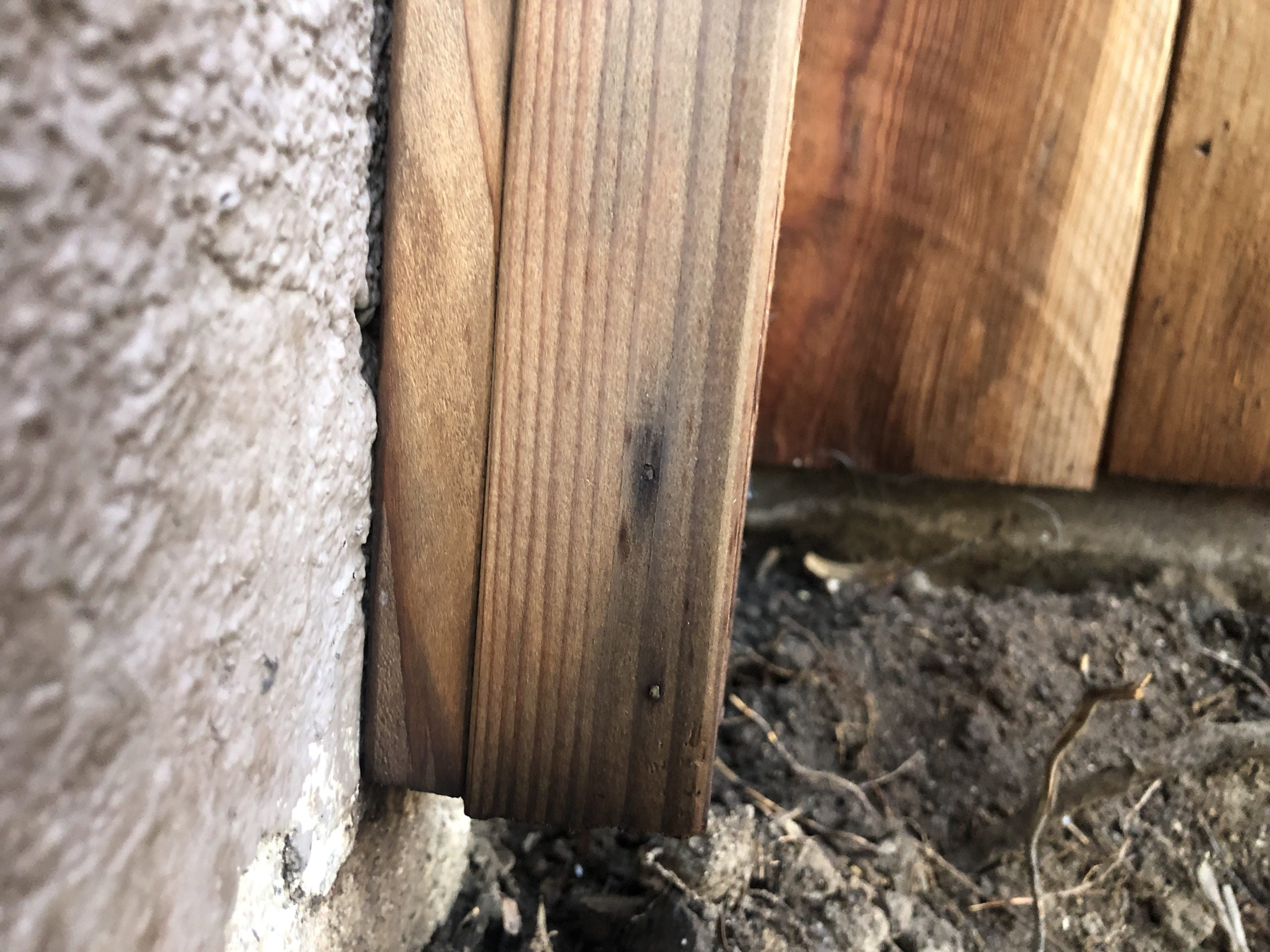

I have black rust spot from nails on my redwood fence- the redwood is untreated (we live in So Cal and have very good weather). The fence is beautiful other than the eye sores: black streaks around all the nails (just like your pictures show). Is there a way I can spot treat to remove the stains, without having to then stain the entire fence?
I have tries TSP (made the TSP, bleach and water mix, as well as the TSP water mix) , hydrogen peroxide solution, dawn soap (that cleaned the fence but did nothing to the black marks), oxalic acid. But all those change the color of the wood, significantly.
I’d love some feedback, guidance and help.
We love the color of the fence and do not want to change it at all by staining it.
Thanks in advance
Wood Brighteners will remove most rust spots but they will come back as soon as it rains. Applying a stain or sealer over it after will not prevent it from happening again. The only way to fix is to replace the nails and use properly treated nails or screws.
Thank you so much for the reply. Can I use the Wood Brightener to spot clean the rust spots?
Or would that change the color of the wood? In those spots
I am attaching pictures
Thank you in advance, if any of your products would work I would be thrilled
You cannot spot apply a brightener, all wood will need to be coated evenly.
