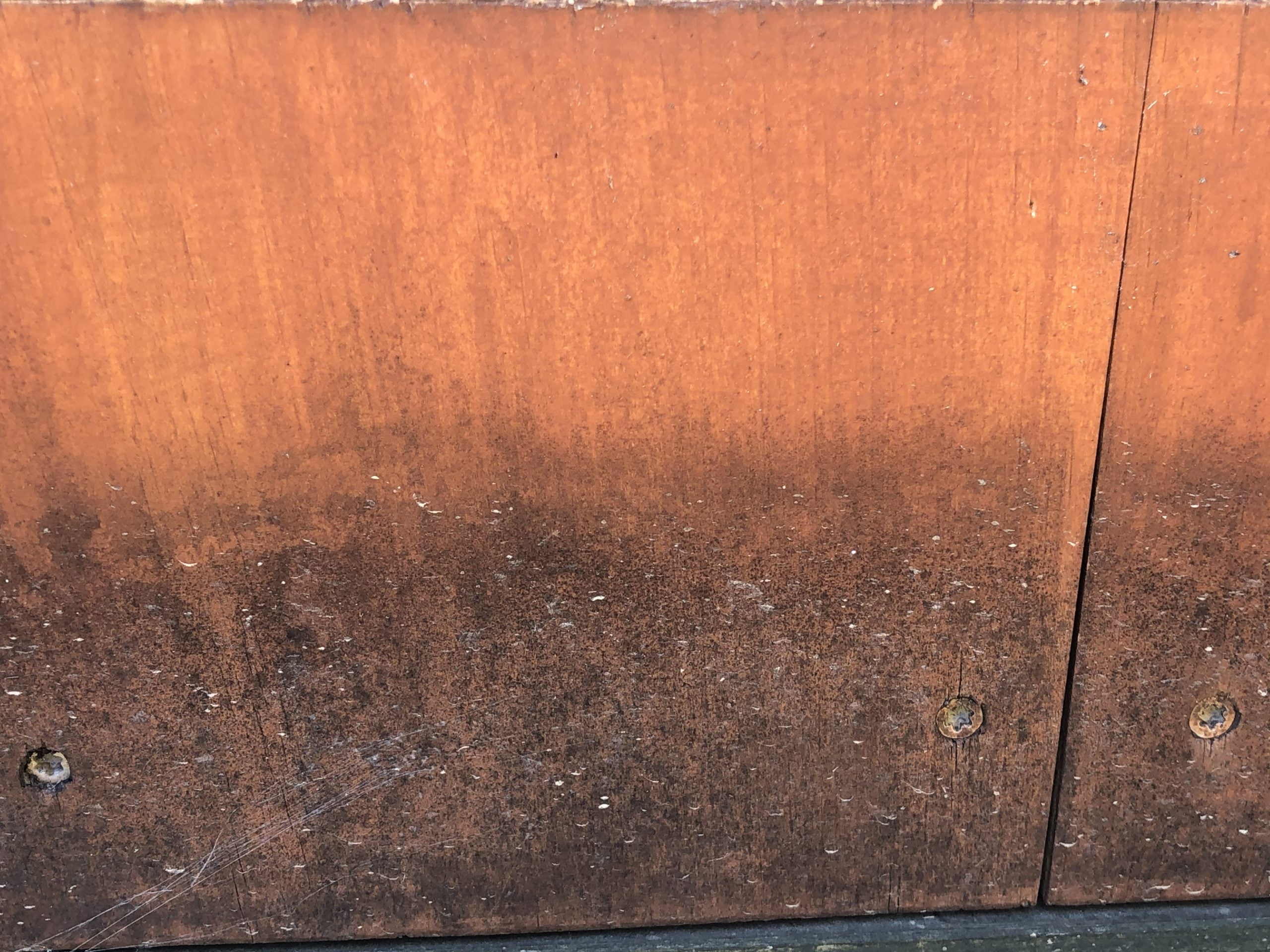

This product looked beautiful when we applied it….however after only 1 winter it’s wearing off!!!!
Everywhere the snow blew on it it wore off. After 8 months we have to re-stain it! It was so expensive.
Find something else!

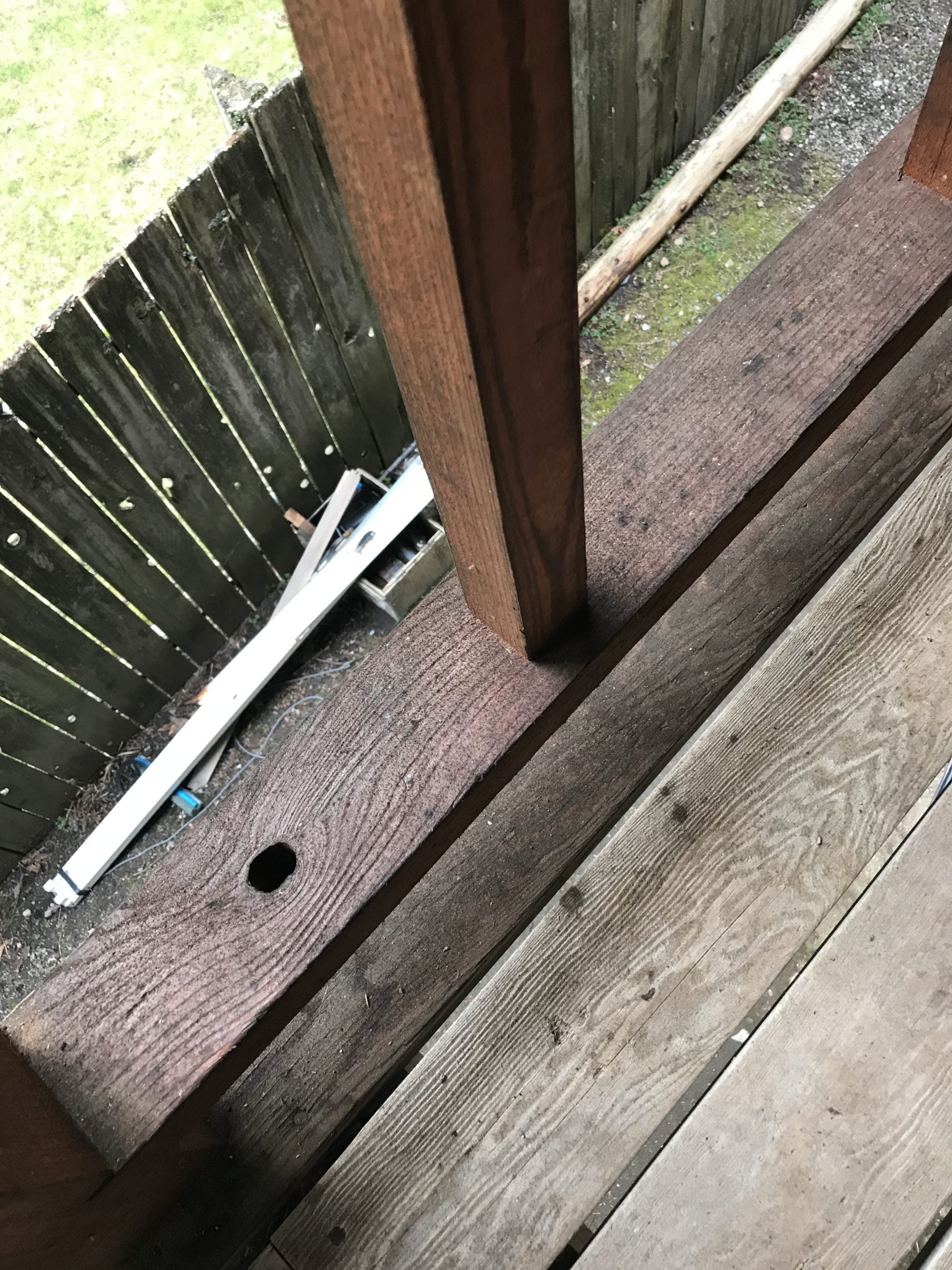

I followed the application instructions as provided by Sherwin Williams. Our cedar deck had aged for 10 months, was power washed 1 week prior to application, I applied one coat avoiding excess, and had no rain for > 24 hours after application. The initial appearance was great! There was no tackiness within a day and the natural appearance of the cedar came through. However, not even 4 months later, the > 2,000 sq ft deck, railing, posts are now grey to black. I spoke with the manager at SW and he stated Superdeck is a poor product and has a history of doing this. His recommendation – strip it, use a brightener/revive, followed by a higher end stain. I put close to 30 hours in and have at least twice that to completely redo the deck. AVOID this stain at all cost.

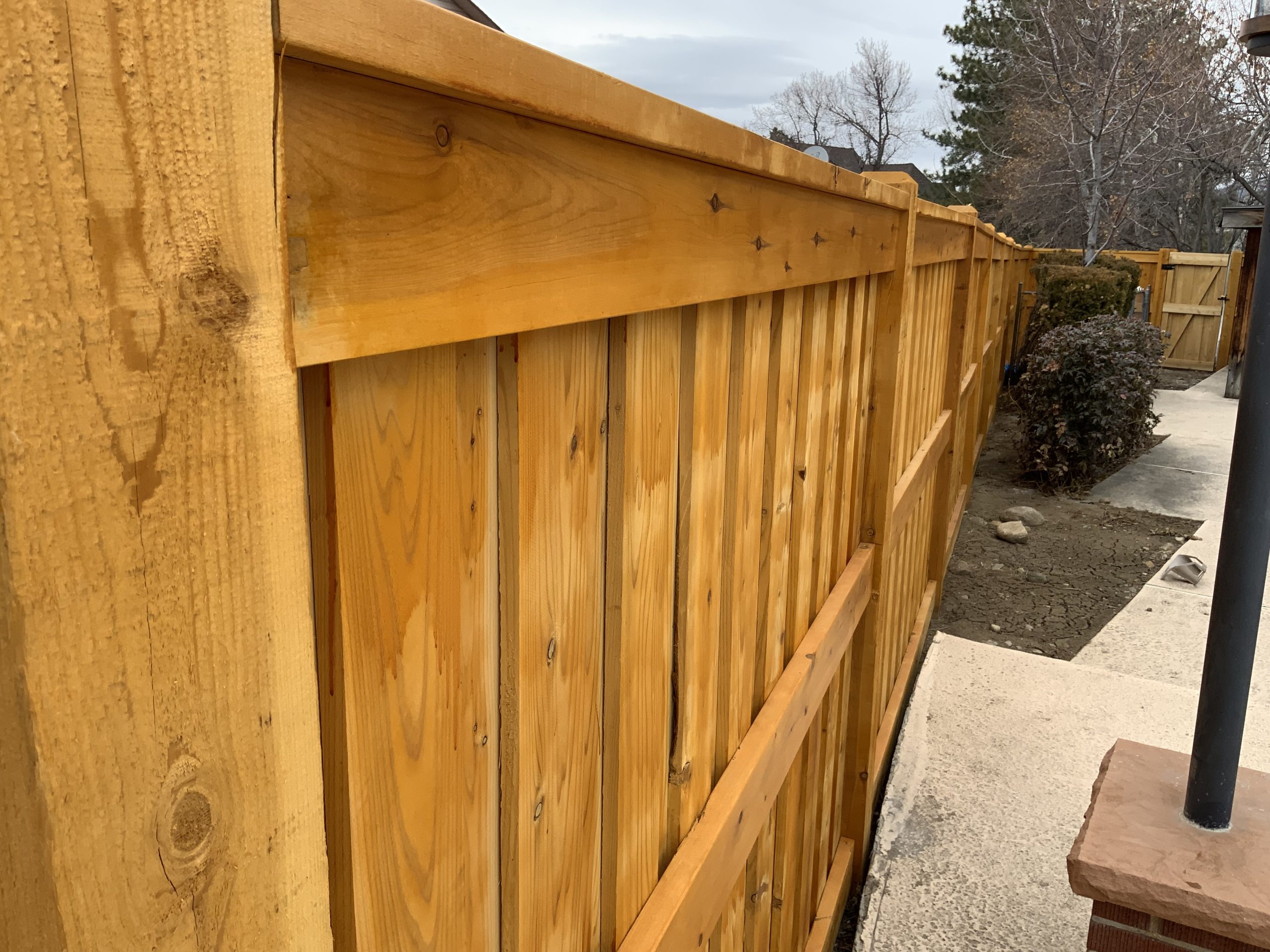

Sealed my new cedar fence with two coats Super Deck clear. Washed off the areas where the sprinkler hits in 6 weeks. Called Sherwin Williams, said I need to apply second coat within the first 2 hours for it not to wash off. I will never buy this product again at $50 gallon.

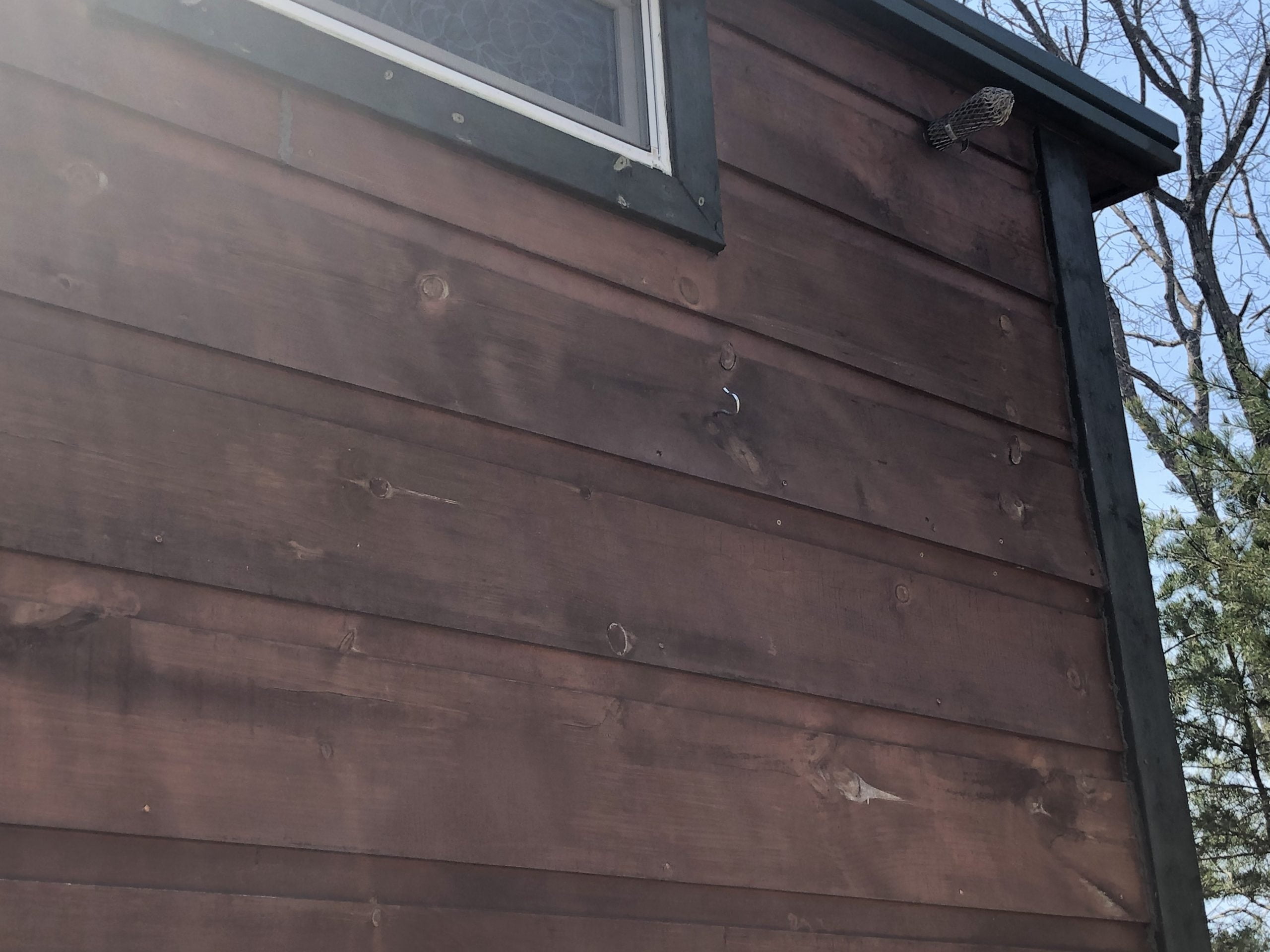

We used Sherwin-Williams super deck, semi transparent. Riverwood stain for three decks that we have. Within a year they started to crack, peel and fade. I had the company come out that sealed the deck and look at it, and they sent a Sherwin-Williams rep out to see it. His response was normal wear and tear. For a stain listed as three years we barely got one year out of it. I’m very disappointed in the quality of this stain. We’ve used Sherwin-Williams paints for years, but I would never ever recommend the stain. It’s costly, not worth it, you might as well buy the cheap stuff. If all you’re going to get is a year out of it.

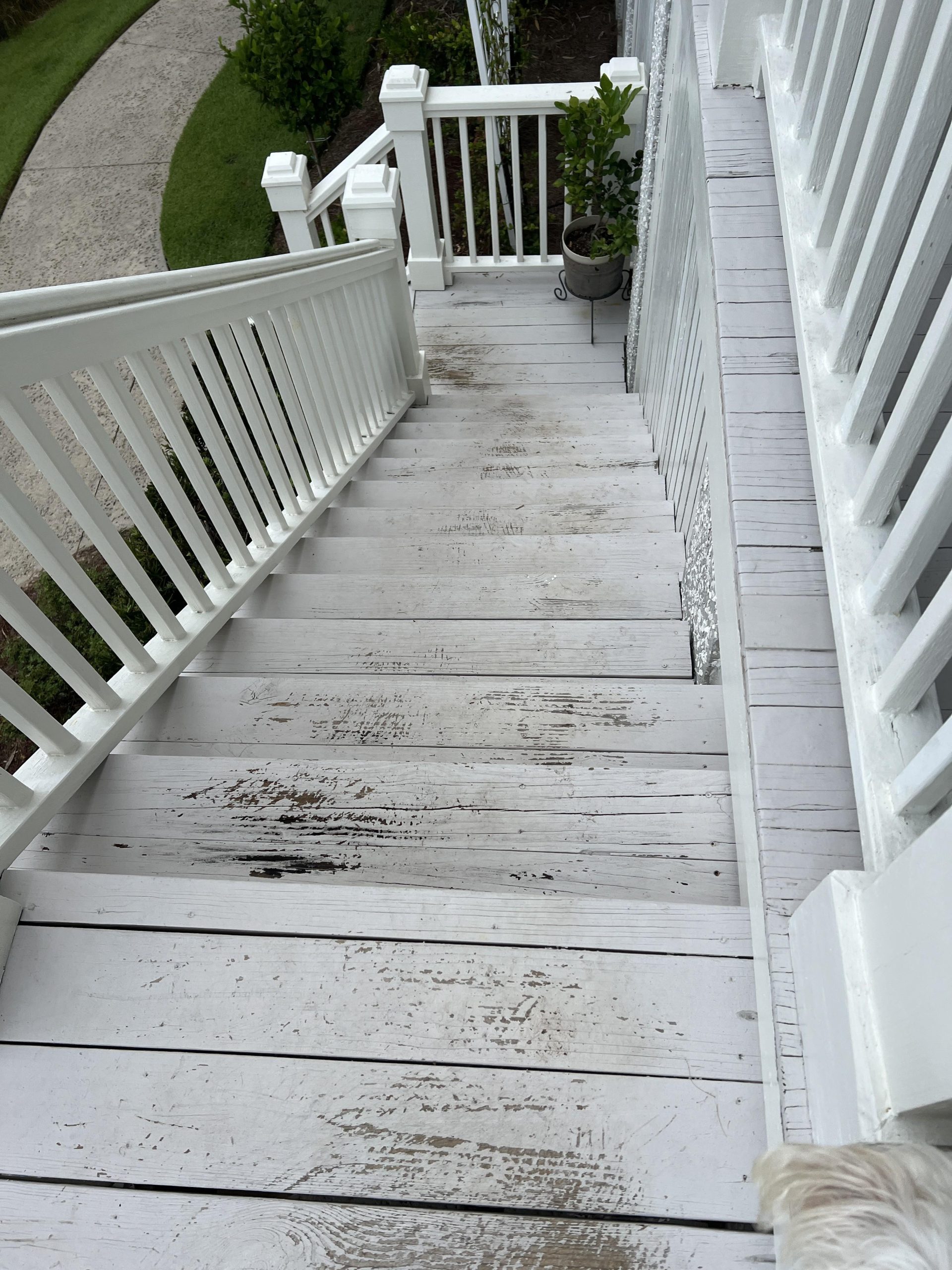

Unfortunately, our SW superdeck solid stain product did not actually “stain” the decking but is instead peeling, much like paint, leaving raw, unprotected wood. Sherwin Williams representative came to our house and indicated the “conditions” (sun and sometimes rain) made the product release from the decking. Coincidentally, the stain on our covered deck is also releasing from the decking. The pressure treated decking had been dried for approx 9 mos- 1 yr and pressure washed before product was applied. We will definitely be searching for another deck stain that will actually STAIN the wood but of course, we’ll wait til the SW superdeck has released. Hopefully, we can get stained color on our deck by next year.

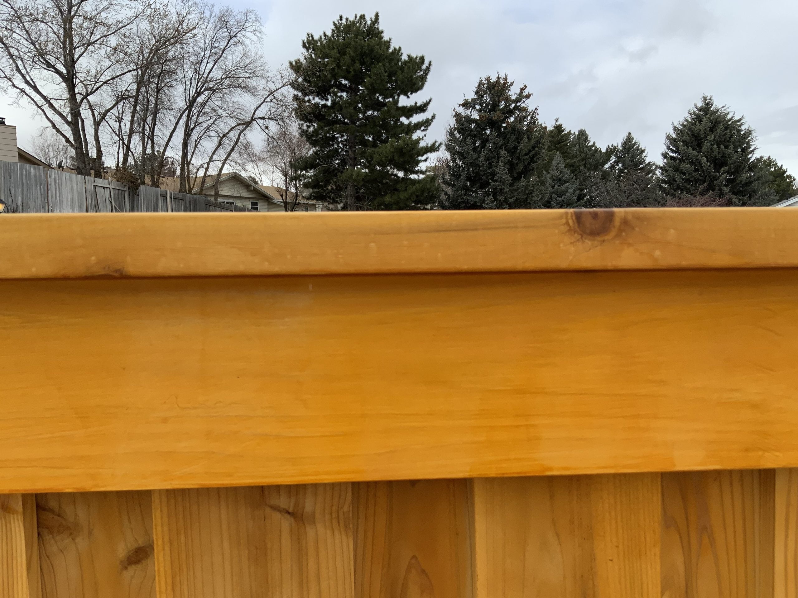

Hi:
I had a new cedar fence installed in September 2021. Sherwin Williams recommended Super Deck Cedar Semi Transparent stain applied at 250~300 Square feet/gal by spray application. Had a reputable painter spray, back roll with a guy coming behind and catching any drips with a bristle brush. Poor penetration and after 3 days or 75 – 80 degree temperature, parts of fence still tacky and splotchy PLUS- MY FENCE WAS YELLOW! Sherwin Customer Service in December told me to wait until Spring (March) and the splotchy sections would have evened out. It is now worse than before. Was told to get with SW store manager for resolution. SM told me to sand and start over. I reminded him of their 100% Customer Satisfaction policy. I was told they (SW) could do nothing more.
So what can I do. The fence cost $36,000.
Does anyone have any ideas???

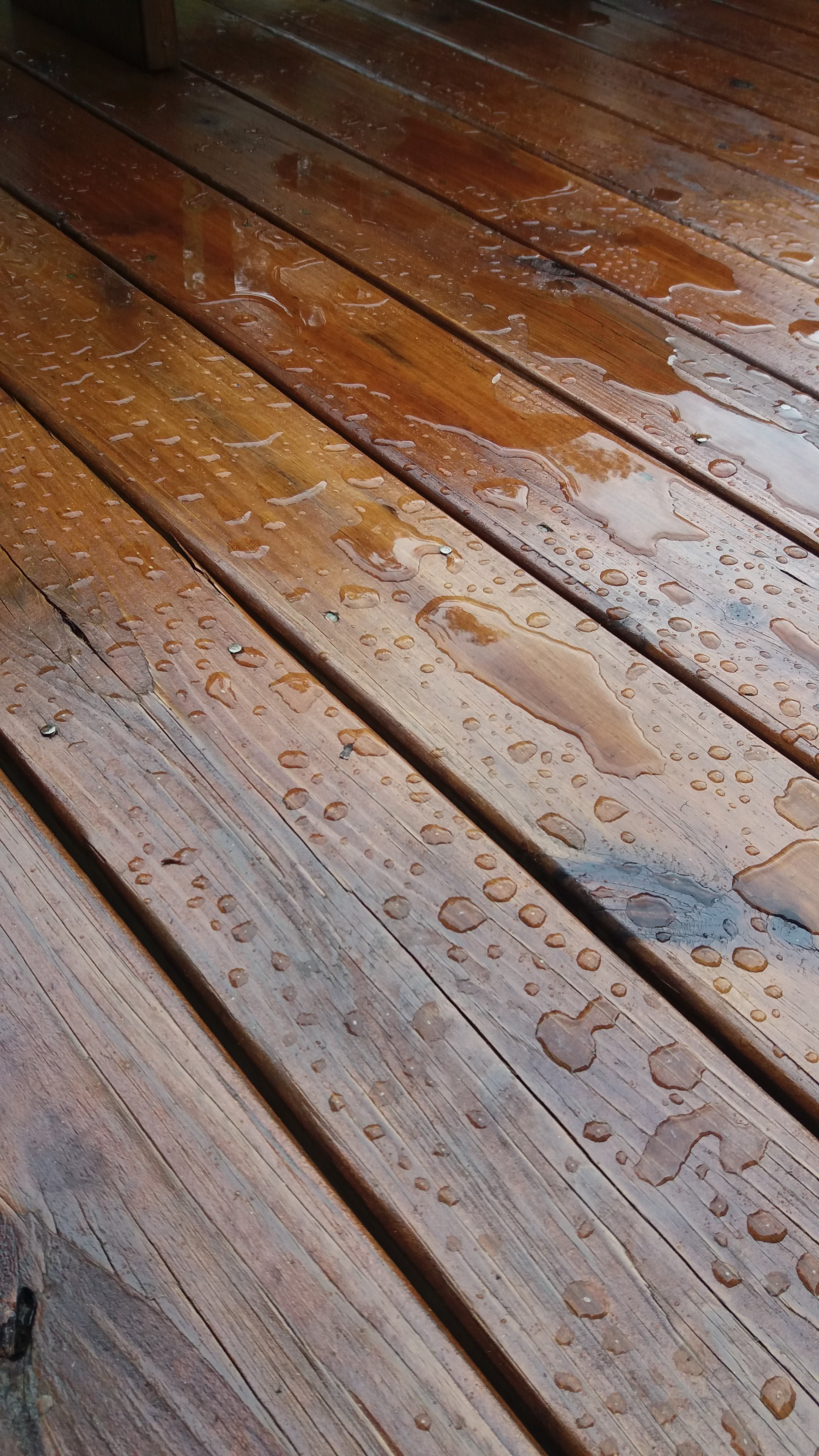

your article talks of the semi transparent which i had on my deck and it beaded (but I had a milky appearance problem and was suggested to use SOLID instead of semi transparent…the SOLID does NOT bead…is this your experience with the SOLID..water just lays on top or puddles…thanks for any help tim draper

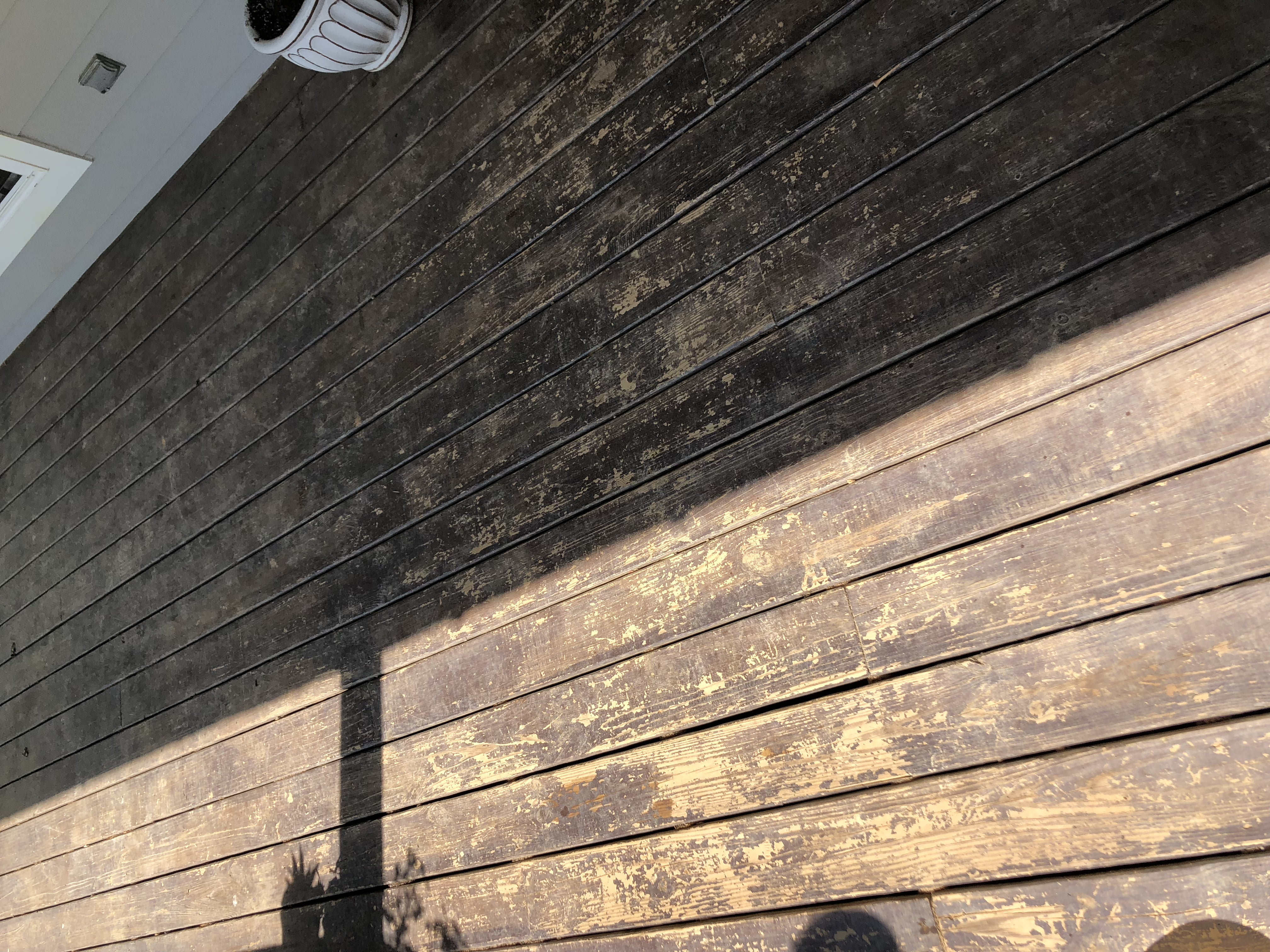

I used Super Deck and had extreme peeling. Even after power washing, Sherwin-Williams stripping products and some sanding, some decking is ok but boards that had not peeled are now peeling; I need to do something with my huge deck but, short of replacing everything, what can I do?

Was meticulous in preparation and waited for optimum application conditions. Within 1 year needed reapplication. Wore as if it were paint rather than stain. Will reuse same product, but if I had enough time to remove entirely, would use a different product.

My new cedar deck was stained using SuperDeck; within a two months a black mold was a serious problem and I’ve had to clean several times. Even though I have enough SuperDeck to restain I’m looking for an alternate better product to go with. I don’t recommend this product.

I bought this stain from my Sherwin Williams store last year. Why has it turned black in 1 years time?
