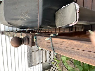

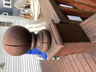

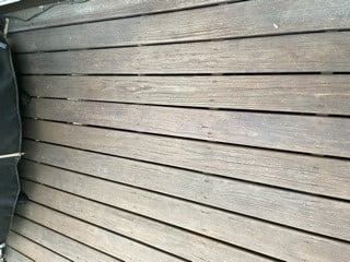

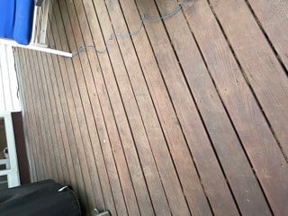

I have a 12X 16 pressure treated deck that’s going on 20+ years old and I took care of the deck – cleaning and using the original formula SIkkens Cetol SRD ( I think that was the name but I could no longer get the original formula in MA the past few years). I used the replacement product by SIkkens for the last couple applications (now PPG) but it’s been awful. The deck became sticky in some spots after application and it doesn’t last. The pressure treated wood is drying out much faster than it used to do. It’s a south facing deck – full sun all year and I have to look at restaining it again this summer when I did it in the Fall of 2019. It was a rich redwood coloring but now looks dirty brownish red because of the lame replacement “Healthy” product I had to buy. Please help recommend a product I can purchase in MA to help reclaim my once proud deck.
Jeff McGillicuddy
Jeff McGillicuddy
Thank you – Here are a few pics – there is some pollen on deck and furniture/grill, but the flat dull coloring and dried out wood still comes through.
