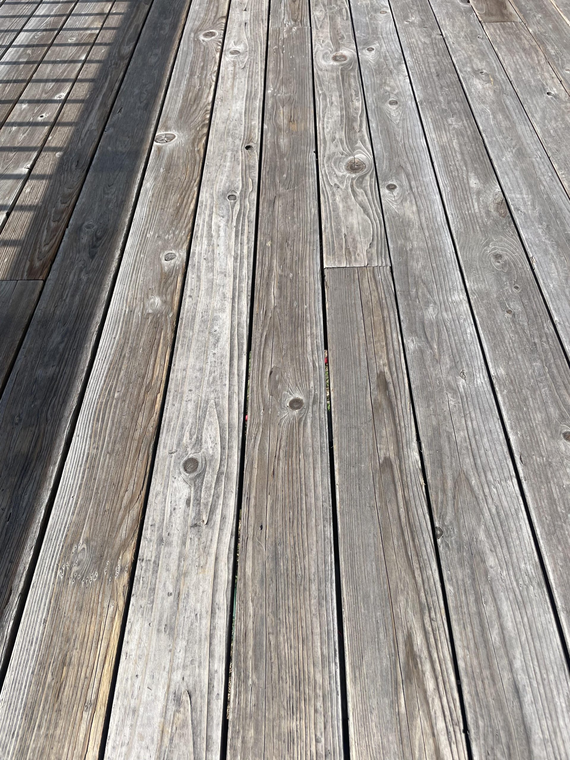

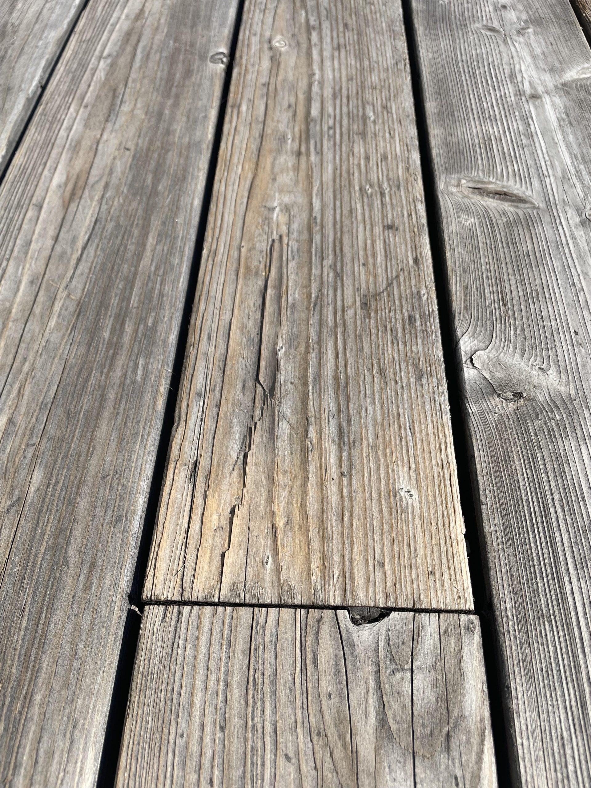

I am in Atlantic Canada opposite Msine’s a north east shore
The deck is Eastern cedar.
The deck is exposed all day yo the sun.
The deck is showing wear and cracking .
The previous covering as a Dwfy clear transparent, What should I do now- go for a semi transparent colour?
Strip and brighten for prep using the Restore A-Deck Kits:

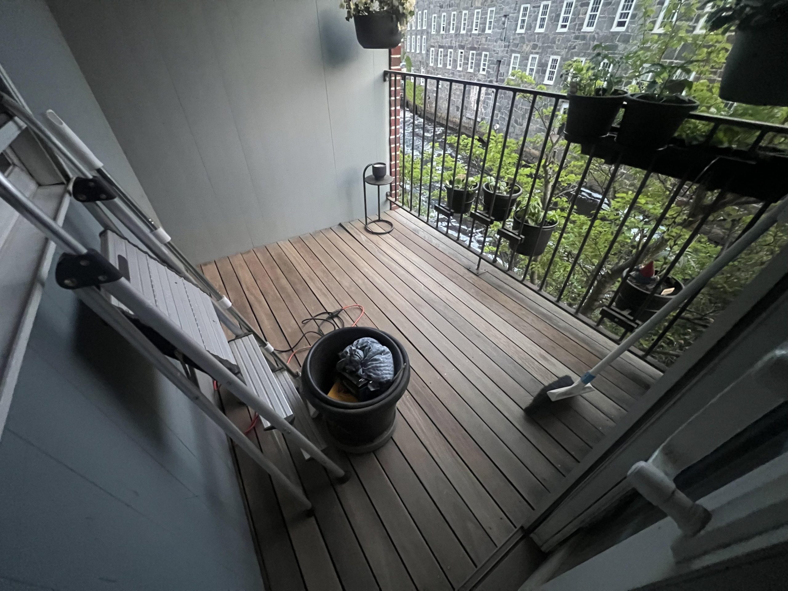

Hi Scott, Hope you can help me. My deck is a 27 year old Jatoba wood deck that is just cleaned and ready to stain. There are some small repairs but it is in good condition. I live in southeast Pennsylvania where weather can go through all seasons.
I’m hoping to get the stain down before the rain in a few days. What stain do you recommend?
You need an exotic hardwood stain. See here:

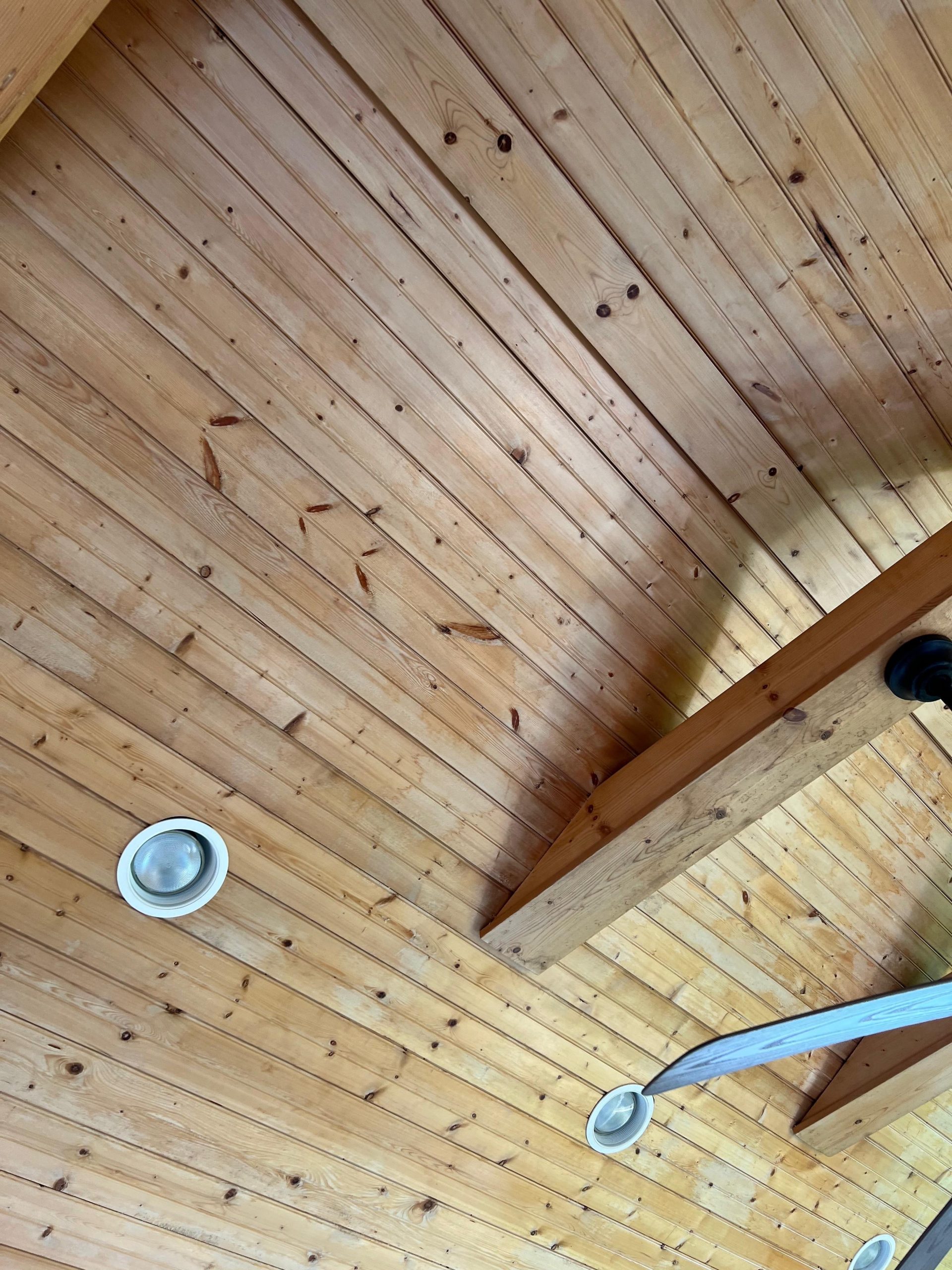

Hi Scott. Needing advice! We have a 13 yo porch with pine tongue-and-groove ceiling and wall needing some work!
Thanks!!!
You will need to power sand this ceiling and siding down to the bare wood. It won’t be easy, but it’s your only option. Use 60-80 grit paper.
Once prepped, try Restore-A-Deck Stain in Natural color.
Do you also recommend any of the cleaning, brightening or RAD products after sanding? Or are those products only for pressure-treated wood?
The type of wood does not matter when it comes to prep products. Yes, it will help to brighten the wood after the sanding to “open” the wood grain.

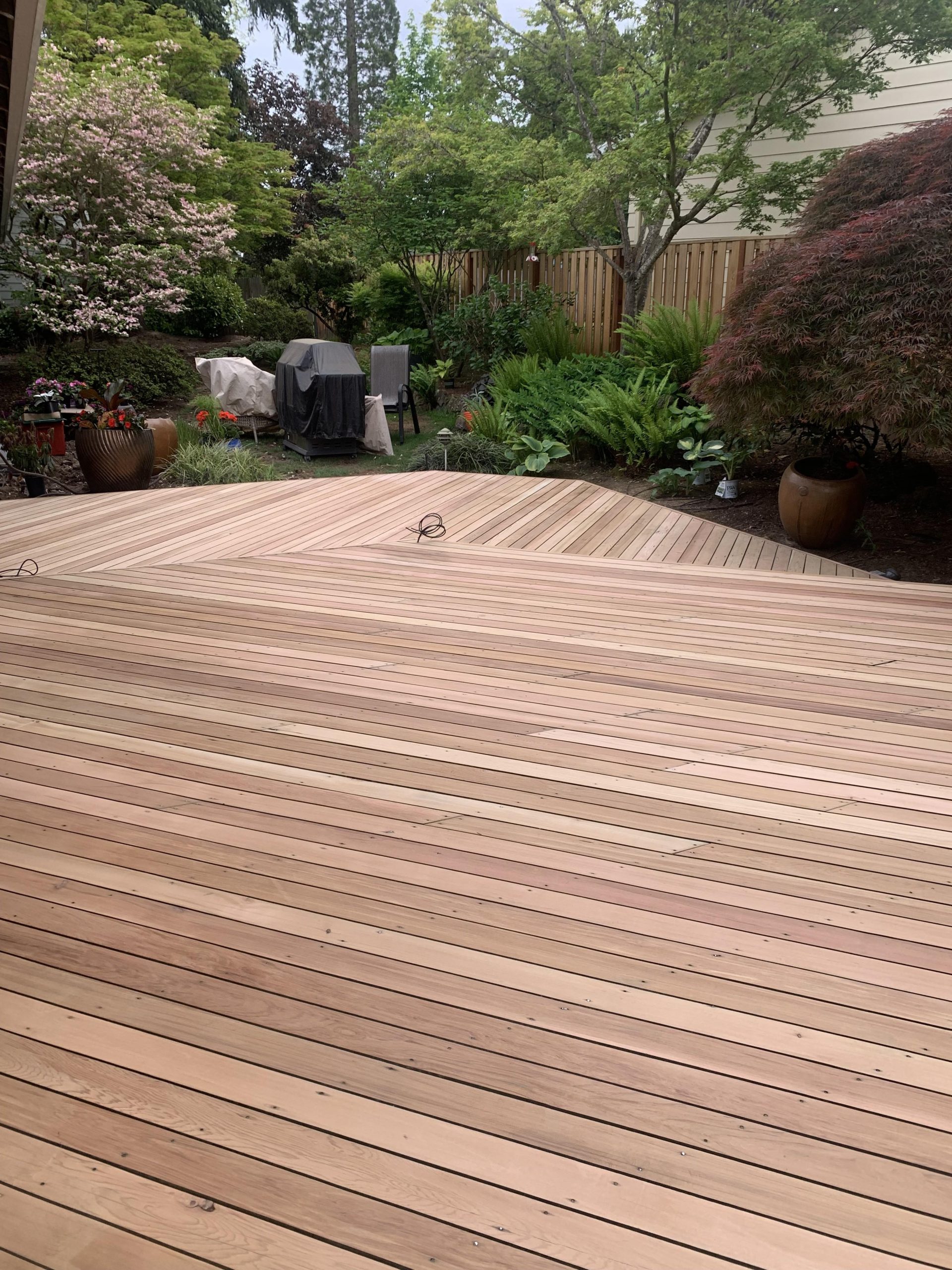

Hi Scott, I have a “still” beautiful Clear cedar 2×4 deck that has been sanded each year & stained Cedar Transparent or Semi-Trans. Super Deck now owned by Sherwin Williams but the reviews are awful! I am ready to stain this beauty once again. Need U.V. protection & one that lets the grain & character of each Cedar 2×4 show. Help! Not sure what brand to use now, nothing is the same
Thanks!!
Robin
Nice, clear (no knots) cedar! Is this a current picture after prep? How did you prep?
Orbital hand Sander & drum Sander. I just took this picture 4 days ago. Want to use some type of Semi-Transparent Stain on it. We get a good amount of rain in Oregon. Your recommendation would be welcome. Thanks!
How fine a grit sandpaper did you use? You should never use finer than 60-80 grit. Too fine, and the stain cannot soak into the wood grain.
Thanks for responding. I used 60 grit on deck & 80 on benches. Also I see the choices of Stain you recommended on your site. Will try the TWP brand- Semi Transparent. Thanks again!
The final prep should be the cleaner and the brightener kit, which will remove dust and help open up the wood pores for the stain.
TWP would be a great choice. What state are you located in, as some brands and versions are restricted in certain areas?
