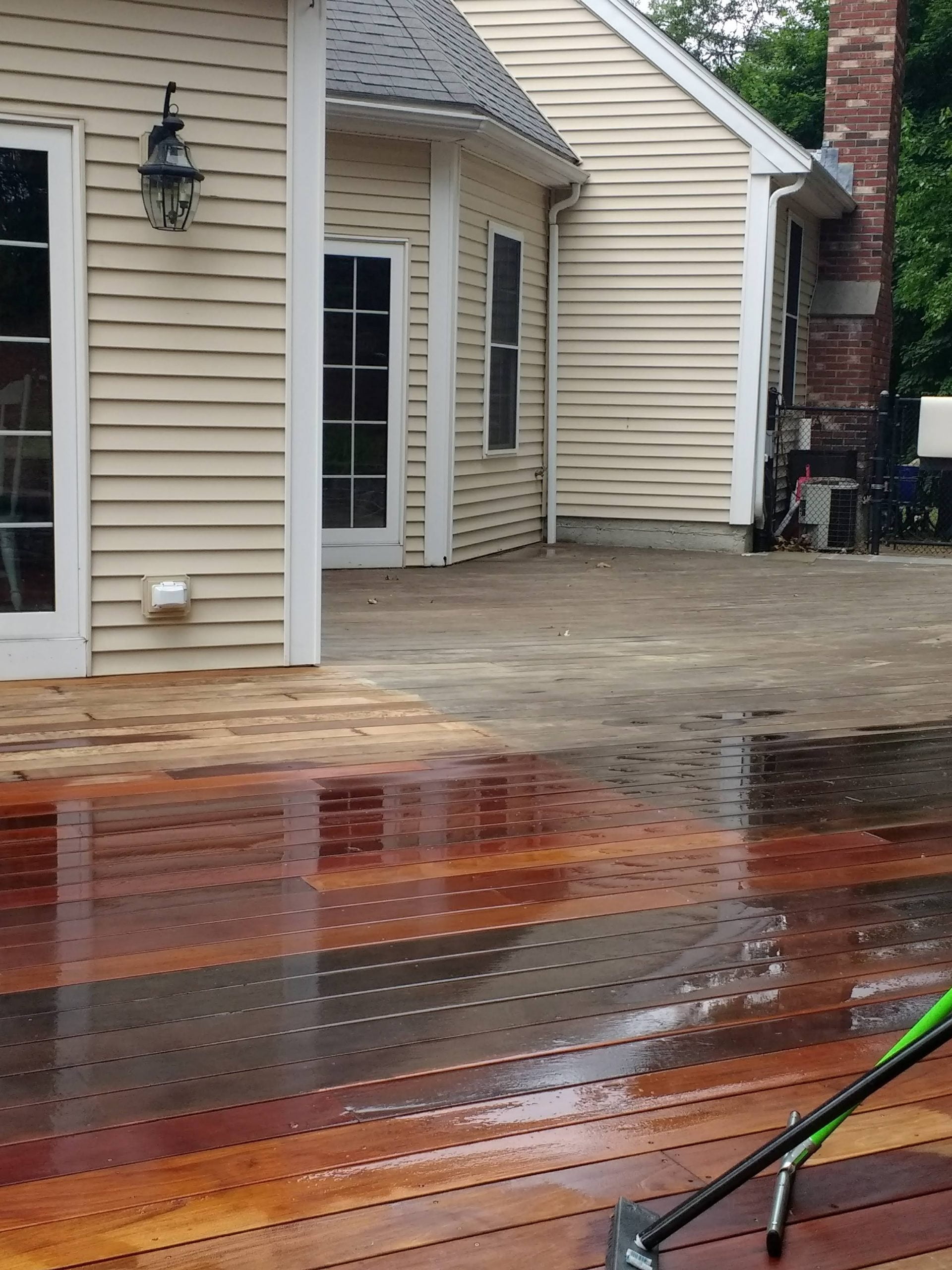

Can I use TWP on Ipe? We have a MASSIVE ipe deck, full sun and by a pool. We have tried a few different brands- I lived penofin the first year, but it seems like they changed something in formulation and it’s not as good. We did superdeck exotic as well. Nothing holds up for even a full summer. We are in Massachusetts. Debating on trying two or deckwise ipe oil- also thought about a marine grade teak oil.
Just finishing up washing it this weekend, and will need to apply a brightener(and recs for this?) Before applying a new oil.
TWP is not suggested for IPE. IPE, will require annual coatings, so best to use one that is easy to clean and re-coat.
Look at one of these brands. We like the Restore A Deck or Armstrong Clark hardwood stains: https://www.deckstainhelp.com/ipe-exotic-hardwood-stain-review/

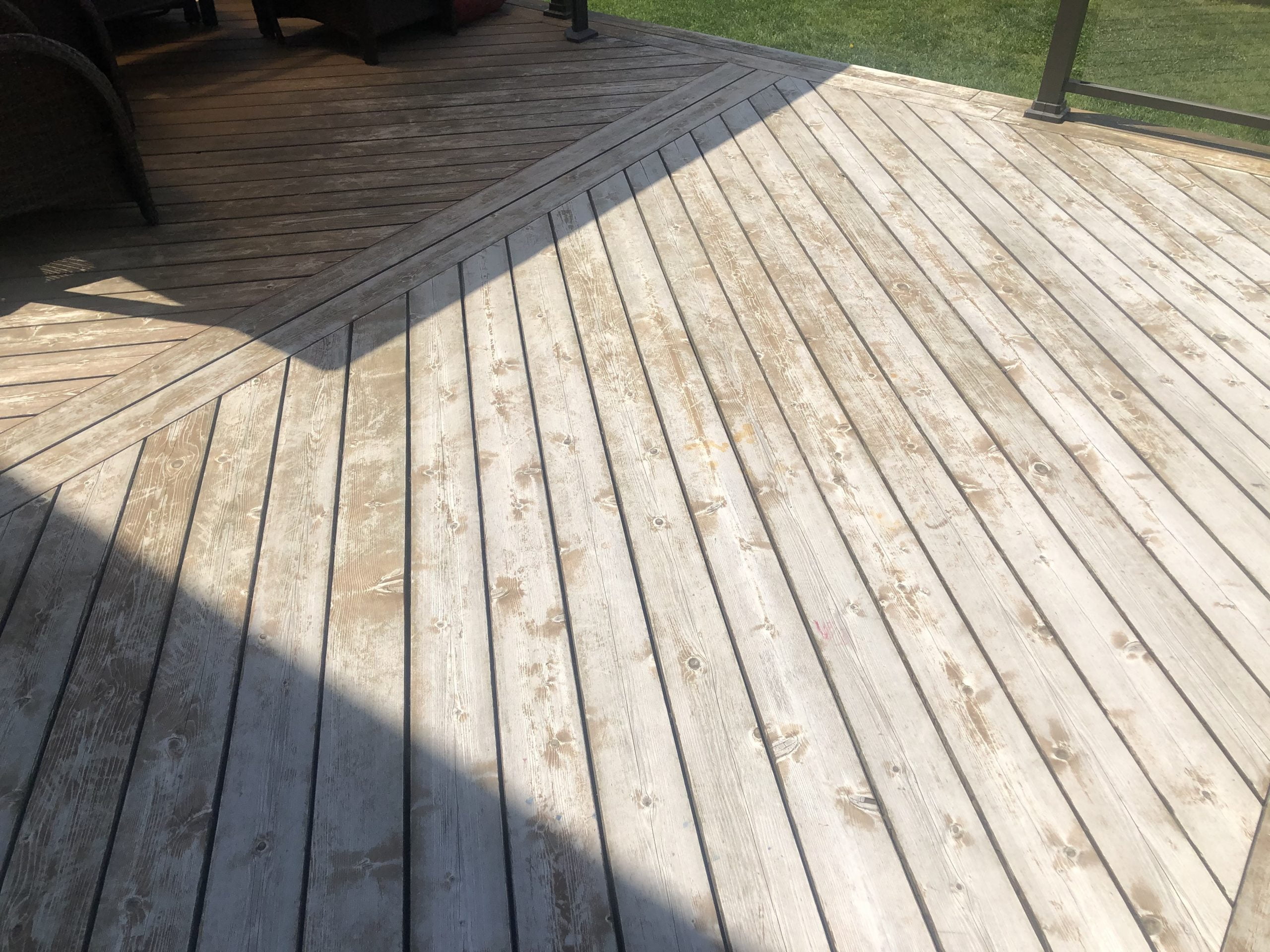

I stained my deck about 5 years ago with twp 102. I need to restain it. What do you recommend? Sand 60 than 80 grit and use Gemini cleaner and brightener after. They area covered by gazebo help up pretty good as seen in 2nd picture do I have to use a stripper for that area?
Do not sand. Use the Gemini Kit for prep. Strip for the second picture.
Ok so use the Gemini stripper and brightener for the area that held up well like in 2nd picture than do I need to rinse it off with a pressure washer? After thats done do I use Gemini restore a deck kit for entire deck?
Let it dry for minimum 48 hour than restain with twp102 2 coats wet on wet
You have to pressure wash after applying stripper, not just rinse. Do this first. Use the Gemini Cleaner on the rest of the deck. Brighten all after.
Thanks for your help

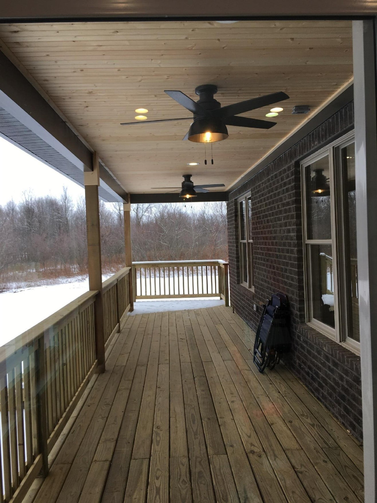

I am replacing picket railings on a covered porch with horizontal boards and wrapping columns. I want to stain and weatherproof the new railing. I was going to use white wood instead of pressure treated at the recommendation of the lumber yard. Which lumber do you recommend for your stain? How often will the railings need to be stained or sealed?
Wood type does not matter. Typically needs to be redone every 3-4 years with vertical ralings.
