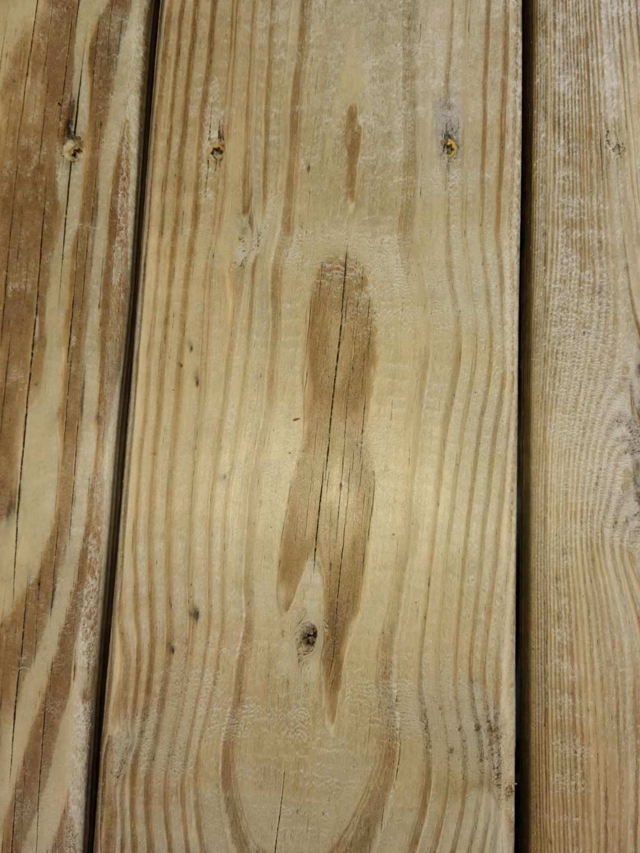

I have a little bit of an issue. I installed new pressure-treated deck boards in March of 2020 and I let it weather properly. March of this year I planned on prepping and staining but unfortunately got busy. So, last week I finally had the opportunity to start. After reading several online posts, I sanded with an orbital sander and 80 grit paper to remove the weathering and mill glaze. Well, I quickly realized that it was going to be a very long process so, I decided to just lightly sand to remove splinters, and then I would clean. After sanding, I used E-Z Deck cleaner and followed the directions exactly. After one day of drying, I noticed a white residue on most of the boards and the mill glaze was still present. I once again went back to the internet to research this issue and it was either let it wear off, sand with 60 grit, or clean it again. Yesterday, I attempted to sand it with a pole sander and 60 grit paper. I used a pretty good amount of pressure and nothing was coming off, residue or mill glaze. So, should I try to clean it again and use a pressure washer? Or, sand with an orbital sander and 60-80 grit paper? What is your thought on using a stripper to remove the residue and glaze? Thank you for any advice you can provide.
Post some pictures for help.

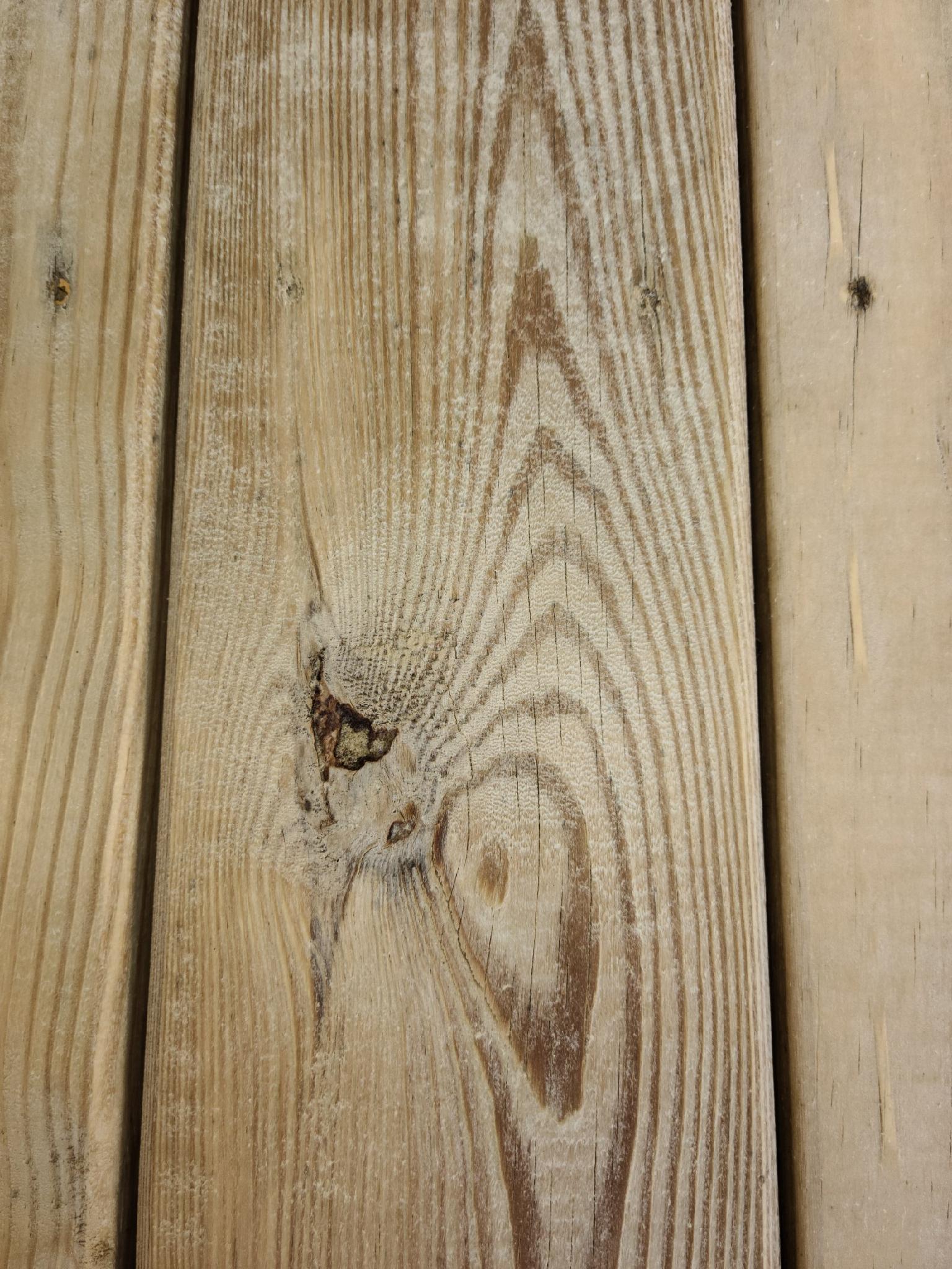

Not sure if you can see the mill glaze but it’s there.
That is not mill glaze but oxidation fuzzies. Typically does not show when stained.
