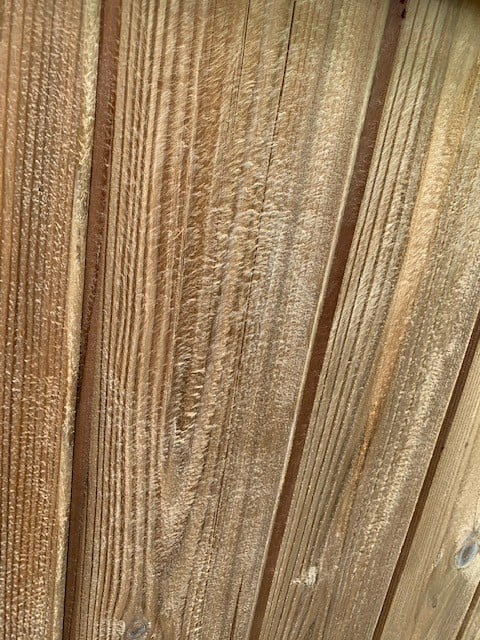

How to Remove Wood Fuzzies
If wood fuzzies appear after prepping, follow these steps to smooth out the surface before staining:
1. Rinse Thoroughly After Cleaning
- Use a garden hose or pressure washer to rinse away any loose wood fibers.
- Ensure the wood is completely free of excess pulp before letting it dry.

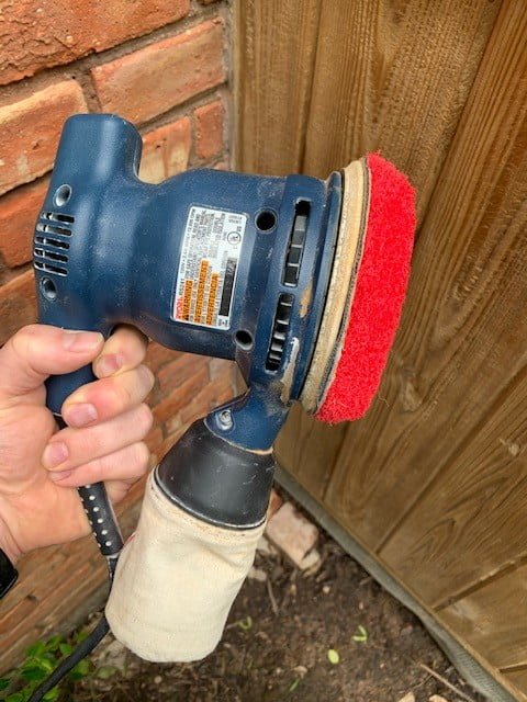

2. Lightly Sand or Buff the Surface
- Once the deck is dry, gently sand or buff the wood to remove the fuzzy texture.
- Use sanding buffing pads with a floor buffer instead of traditional sandpaper to prevent over-sanding.
3. Use a Floor Buffer for Large Decks
- Contractors often use a floor buffing machine (available for rent) with a sanding pad for quick and efficient removal of wood fuzzies.
- A 500 sq. ft. deck can be buffed in about 10 minutes using this method.
4. Hand Buff Railings and Tight Areas
- For railings and small spaces, use a handheld buffer or a handheld sander with a smaller pad.
💡 TIP: Never sand finer than 60 to 80 grit! See How to Properly Sand a Deck

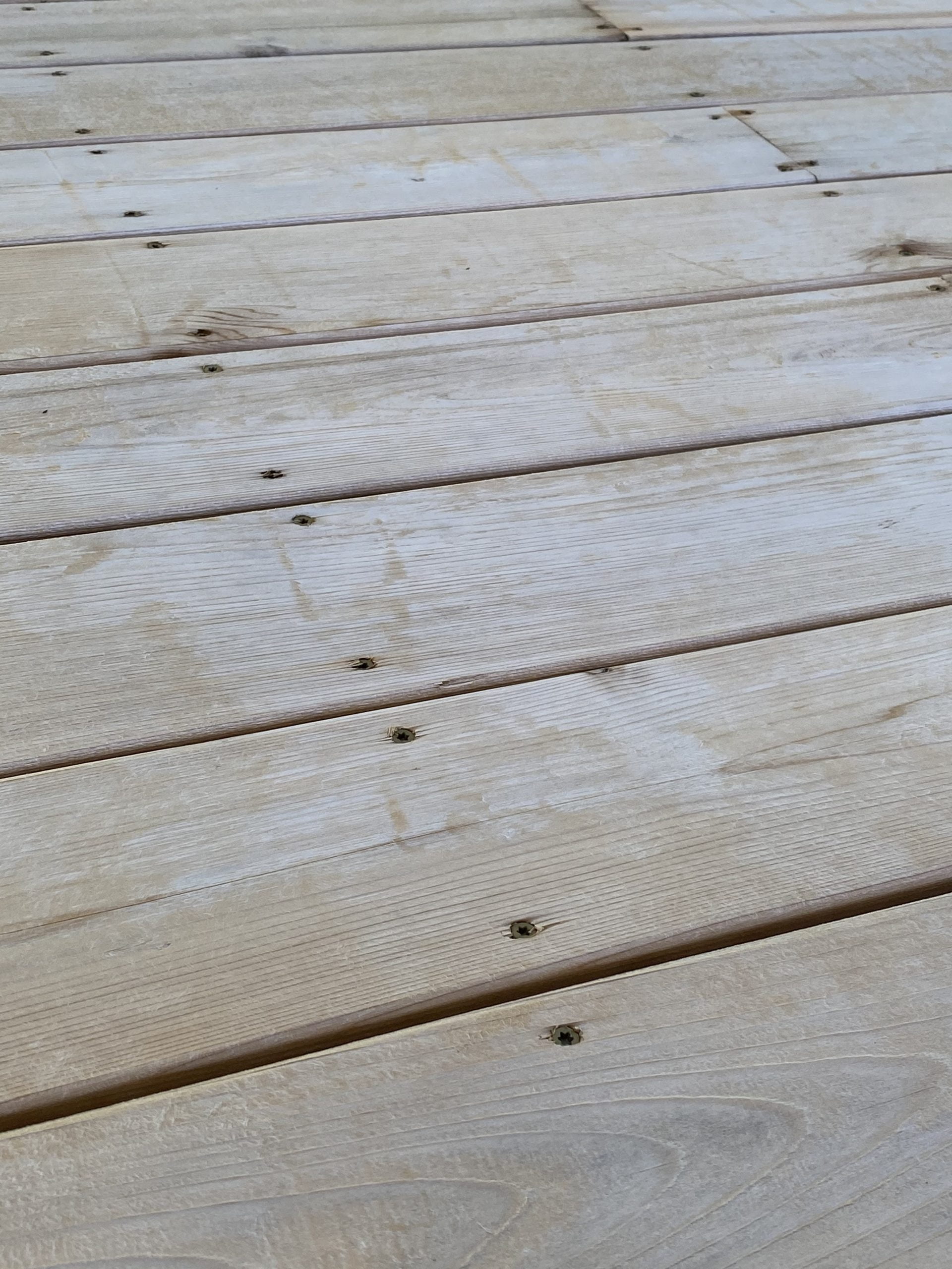

Thank you! I got the deck sanded. There are still some bleached out looking very light areas. When wet it looks great. Will the clear coat give it that look of when it’s wet or will the light areas return once sealer cures?
Clear coats do not give a wet look. You need a tinted stain color. Try Natural color by Restore A Deck or TWP in Honeytone for a wet look stain color.

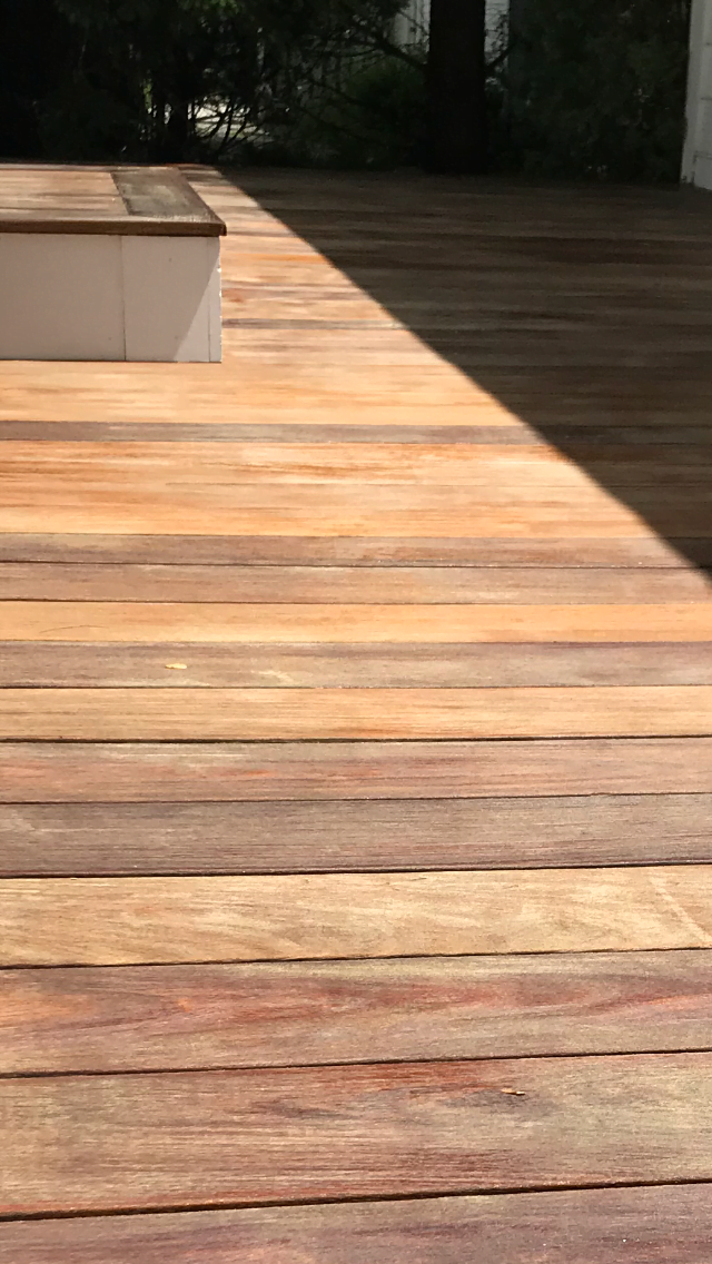

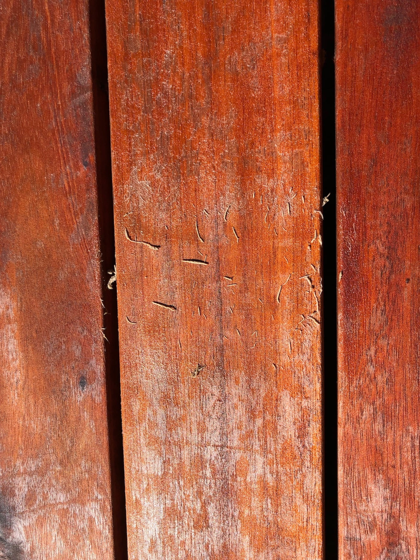

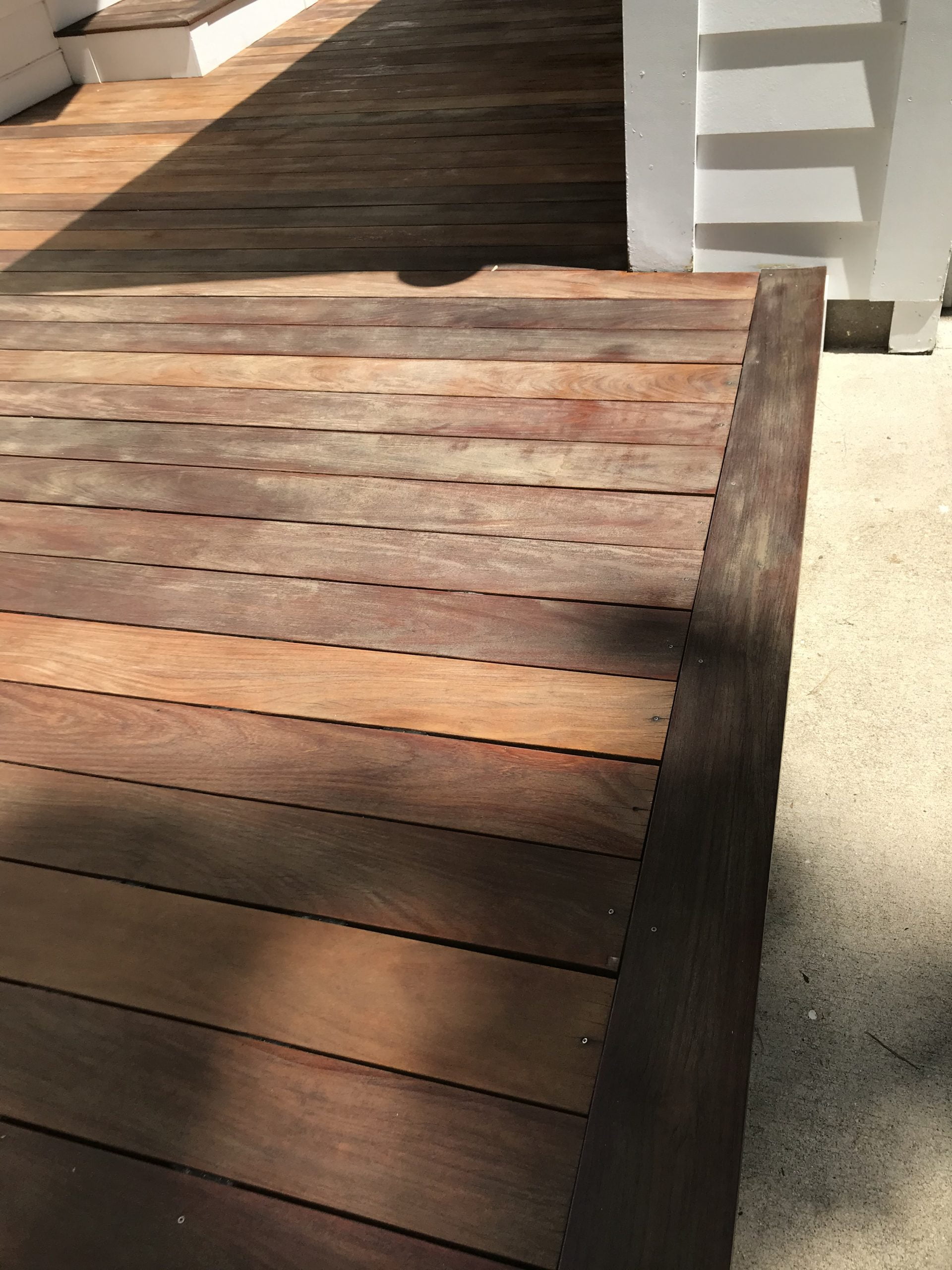

This site has been extremely helpful! I’m having trouble understanding why the deck came out a certain way in some spots and beautiful in 80-90% of the rest. I took some pictures where there are “spots” and then I assume fuzzing. Would we have to strip it and then sand it / redo everything? We did not sand but the employee used deck cleaner and then power washed it twice. Any advice on this would be great! If there is something we can do for this season to help us not have to redo the entire process that would be awesome.(ignore that white mark – he painted the bottom of the rocking chair and it didn’t completely dry before placing it back)
Is this porch mahogany or IPE? Or another hardwood? What stain brand did you use?
I’m honestly not sure what kind of wood it is. Is there a way for me to find out? We used Thompsons Water Seal. Didn’t use a stain (Previous owner said they didn’t and only used the water seal but I don’t know for sure and this is our first year at this property.) Last year it looked beautiful (they did it)- not sure what was the issue this time.
Thompons is useless, and yes, you need a hardwood stain. Strip it off and then brighten the wood. Use the Restore A Deck Stripper Kits. Stain with Restore A Deck Stain in Natural tint or Armstrong Clark in Amber tint.

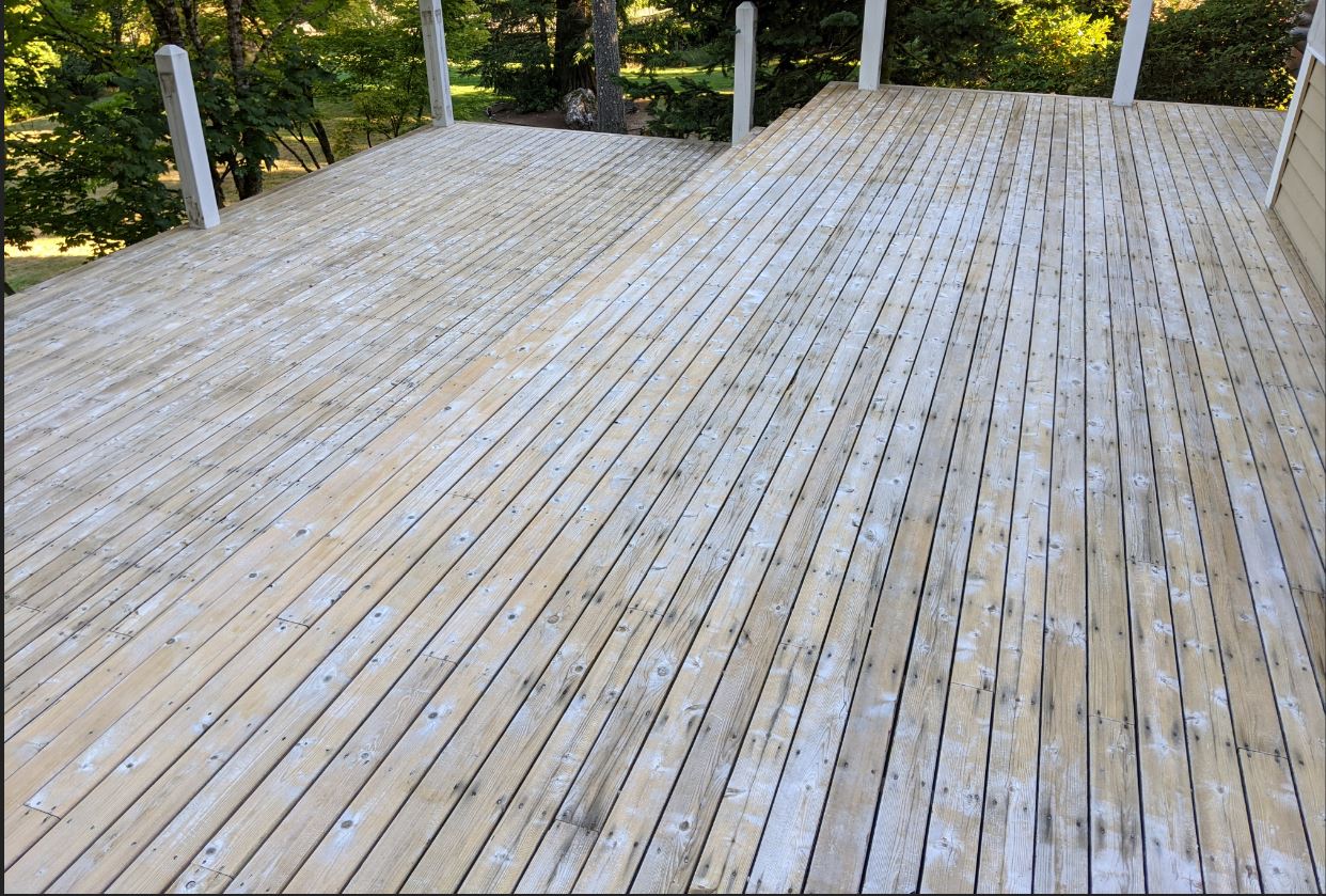

I sanded by deck with 80 grit to remove 2 coats of solid stain a month ago. I blew off the sanding dust and washed deck with a garden hose. The wood looks clean with no stains or mildew on it.. I plan on using RAD cleaner and brightener, if needed, before using RAD solid stain on the deck. I have several concerns.
1 Do I really need to use a cleaner and brightener if I am using a solid stain?
2 I read that the cleaner will cause furring and I would have to buff all of it off. I am elderly and have no one to help me. Also I have no way of renting a buffer and transporting it from the rental place. How can I prevent furring so I do not need to do the extra work?
3 If I need to use a cleaner and brightener can I still do it after the deck has been sitting without any prep work done on it?
4 I can not stain the same day if I do the prep work. Is that ok?
5 Do I need to use a pressure washer or can I use a garden hose with a strong spray nozzle?

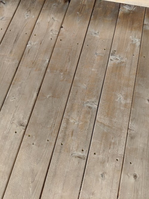

Attached is a picture of the deck after sanding. There is some spots where I could not get the old gray stain off. I would appreciate any help you can give me.
We sanded an old cedar deck to remove several coats of old solid stain. We are planning to stain with TWP-100 – cedartone. There was a light rain last night and hearing from some folks we need to resand because it raised the wood grain. Is that true or should we just wait the recommended dry time to ensure that the wood is sufficiently dry before staining?
Rain does not harm the wood and actually helps. No need to sand again. Wait 48 hours to stain.

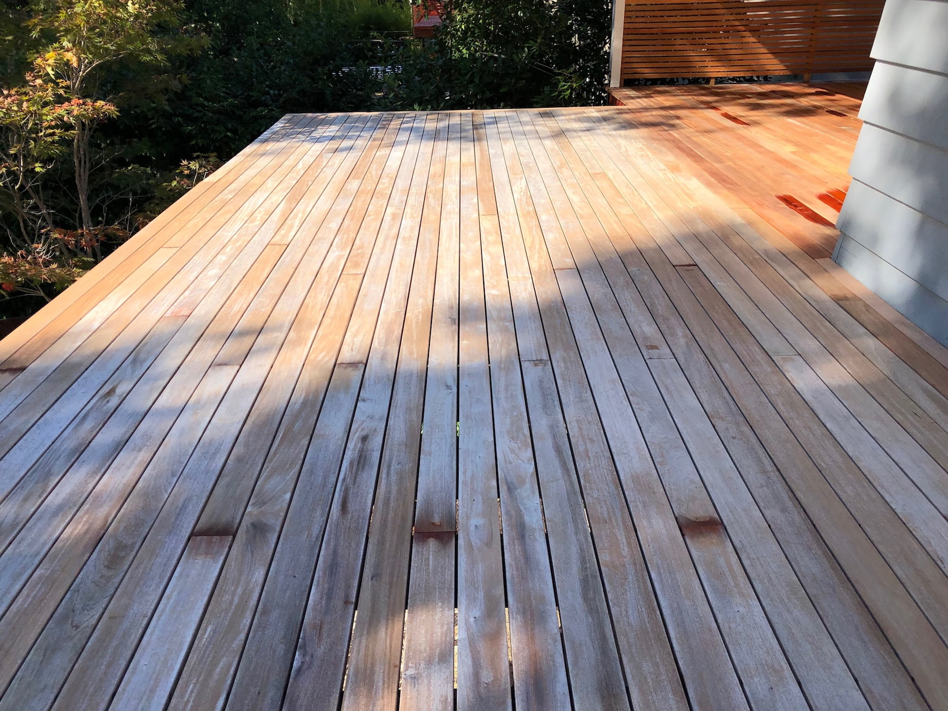

Next step after fuzzies-my deck is stripped now and I am ready to revive and sand to get ready to stain. Which should I do first? Sand and then use Revive or use Revive then sand? Thank you.
Revive? Do you mean brightener? You do that after sanding.

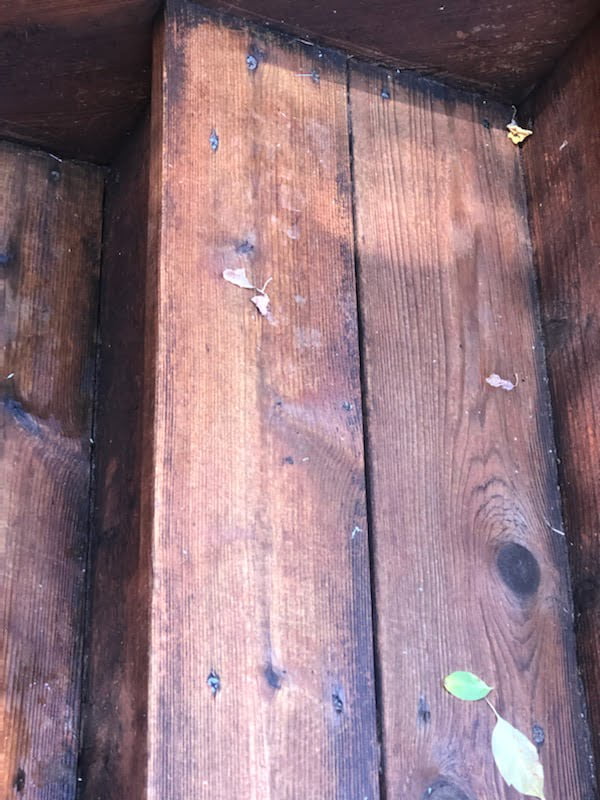

Hi. My husband stained our deck with redwood stain. Red red. I hate it! Ruined the deck and entire exterior look of home. Is there any way to fix this? I can not live with this red. Open to possibly painting over this stain. Wanted a much more natural and neutral color. Please advise. I cry everytime I see it. Also reflects red into my home. Could not hate it more! Please help! Heart broken.
How to remove depends on the stain type you used and the brand? Best to post pictures as well.

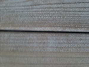

We are using RAD system to clean 4 month weathered kiln dried cedar. After step 1, we have furring. We’ve tried lightly sanding but it’s not really coming off. When we use the brightener, will that help? Can we stain over it or do we need to thoroughly remove the furring?
You can stain over it. Brighten now.

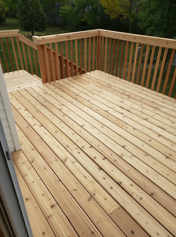

I have a new clear cedar deck that is 4 months old. I did a restore a deck cleaner and brightener. It had a lot of the white fuzzies on it so I tried a buffer but that didnt do anything then i tried power washing it gently (not too close to the wood) and made sure it was rinsed really well. It did look good when wet so the next day I put 1 coat of restore a deck semi transparent cedar stain temp was 70 deg no sun. it is a large deck. This is what the entire deck looks like the next day.
What do recommend I do? should I put another coat on it, etc?
Also can I wait until spring time since it is fall now?
Thanks Harry
Looking at all your brush marks, etc, it seems it was not applied evenly. We would wait until Spring. Prep by lightly pressure washing with a deck cleaner to remove any dirt.

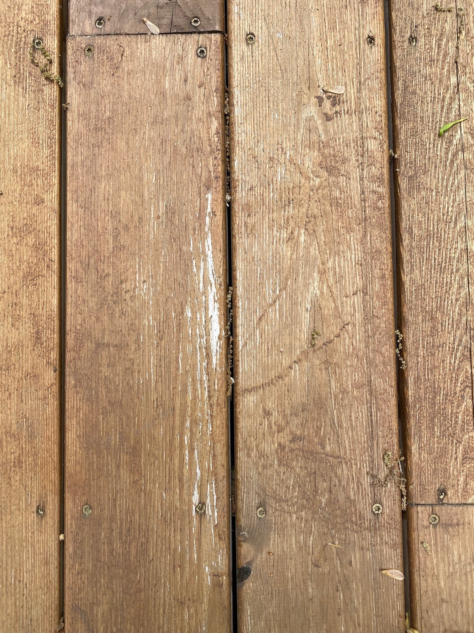

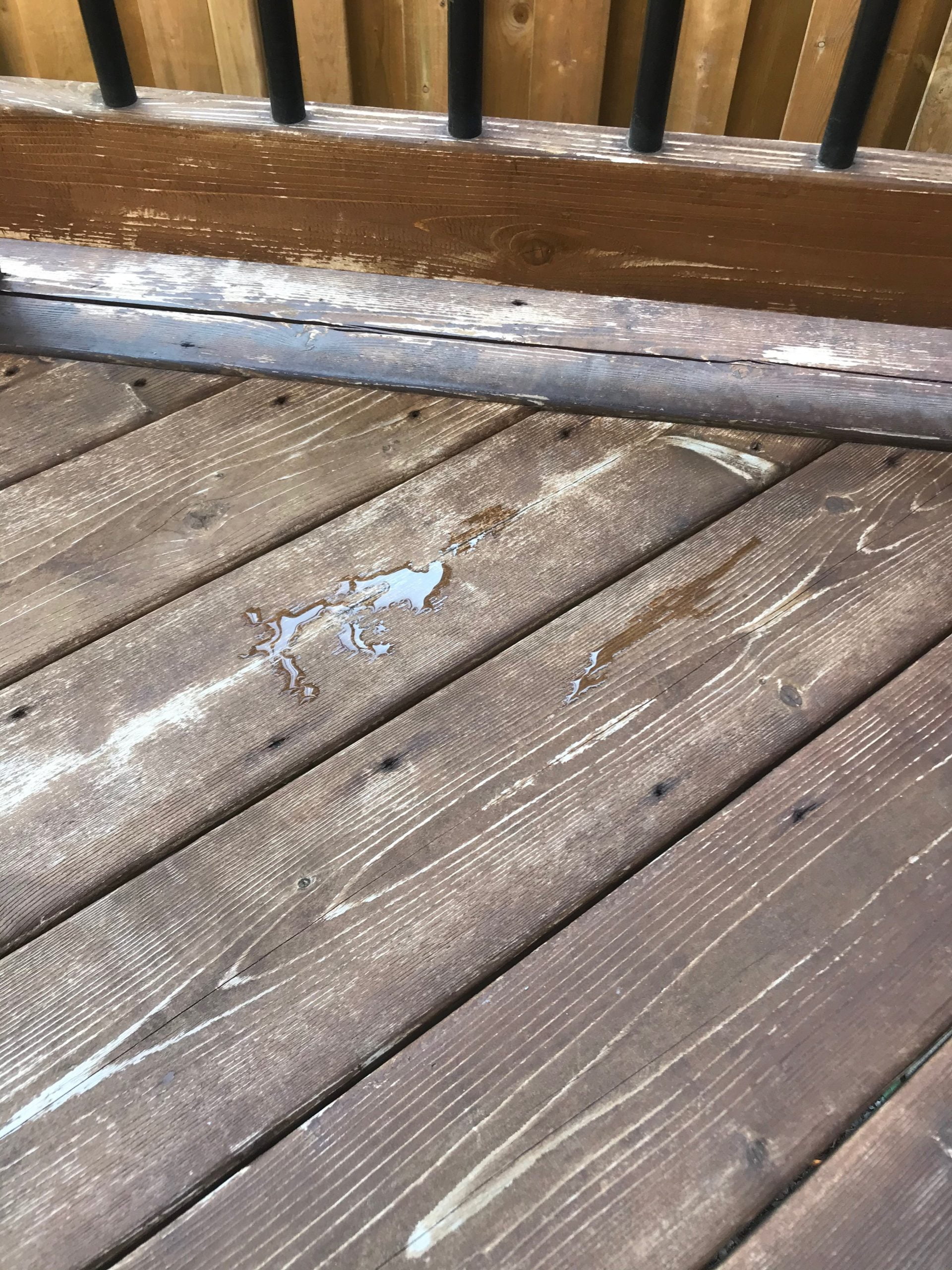

Hi, your tips worked. thanks….Deck is finally restained and looks nice. except for one issue.
It is a large deck and 1 place (of course right in front of the door) has a 2 foot section where i didnt get the excess stain off.
it left little stain dots. plz see my picture.
what is the best way to remove this?
I read to wipe it with lint free range and paint thinner and then lightly reapply?
but they didnt give details like how long to rub it, do you clean the thinner off with water and let dry before you reapply the stain etc…. thanks harry.
I do not think you can spot fix this. It will just make it worse. Best to leave alone.

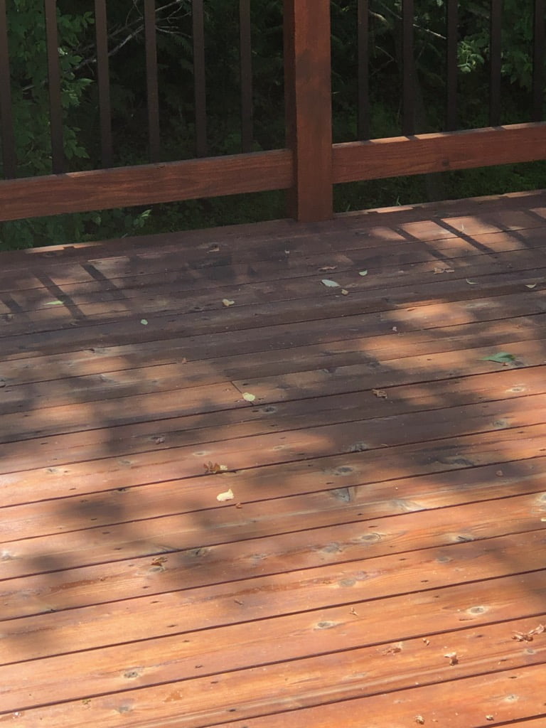

Hello, we had a 13′ x 17′ red cedar deck installed in July 2015, it looked gorgeous and smelled even better! August 2016 we were finally able to stain and protect. We power-washed the greying off deck (perhaps a little too aggressively), then used “C2 Guard Waterproofer Ultimate Wood Protection” (this stuff is NOT cheap at $115.00/gallon). It was recommended by our deck builder, so we bought it. The application is a “wet on damp” procedure, then second coat goes on while first coat is still damp. It took 2 gallons and looked good. We didn’t get all the areas around the edges, posts and sidewalls done because I ran out of energy and C2. Fall of 2017, I was about to protect the rest of the wood that wasn’t done the previous year, but someone insisted he had to power wash (again too aggressively) in order to have “everything looking the same”. Took another 2 coats of C2 after the power wash, and looked only ok this time. Fall 2018, floor of deck doesn’t look too great, so another light power wash and another gallon of C2. Fall 2019, you guessed it, another power wash and another gallon of C2. It is only on the horizontal areas though – floor of deck, top of the railings, and bottom of spindles that are looking crappy, the upright areas look great. Here we are fall of 2020, and after reading copious online Q&As, we are hesitant to sink more $$$ into this deck with C2. If you think we should stay with C2 Guard, we will. We have already put 6 gallons of C2 Guard into this deck and it looks horrible, but what to do? I would love the deck to all look like the vertical areas, but not sure how to get there. We did a water test yesterday and it beads in most places, only a few spots where the water sinks quicker, but not too quickly.
We would appreciate any insight or suggestions. Attached are photos of the current ugly deck, and 1 from 2018 showing it’s not looking good.
Remove all coating and start over. Use the Restore A Deck Stripper/Brightener Kits with both additives: https://www.deckstainhelp.com/restore-a-deck-stain-stripper-booster-thickening-gel-review/

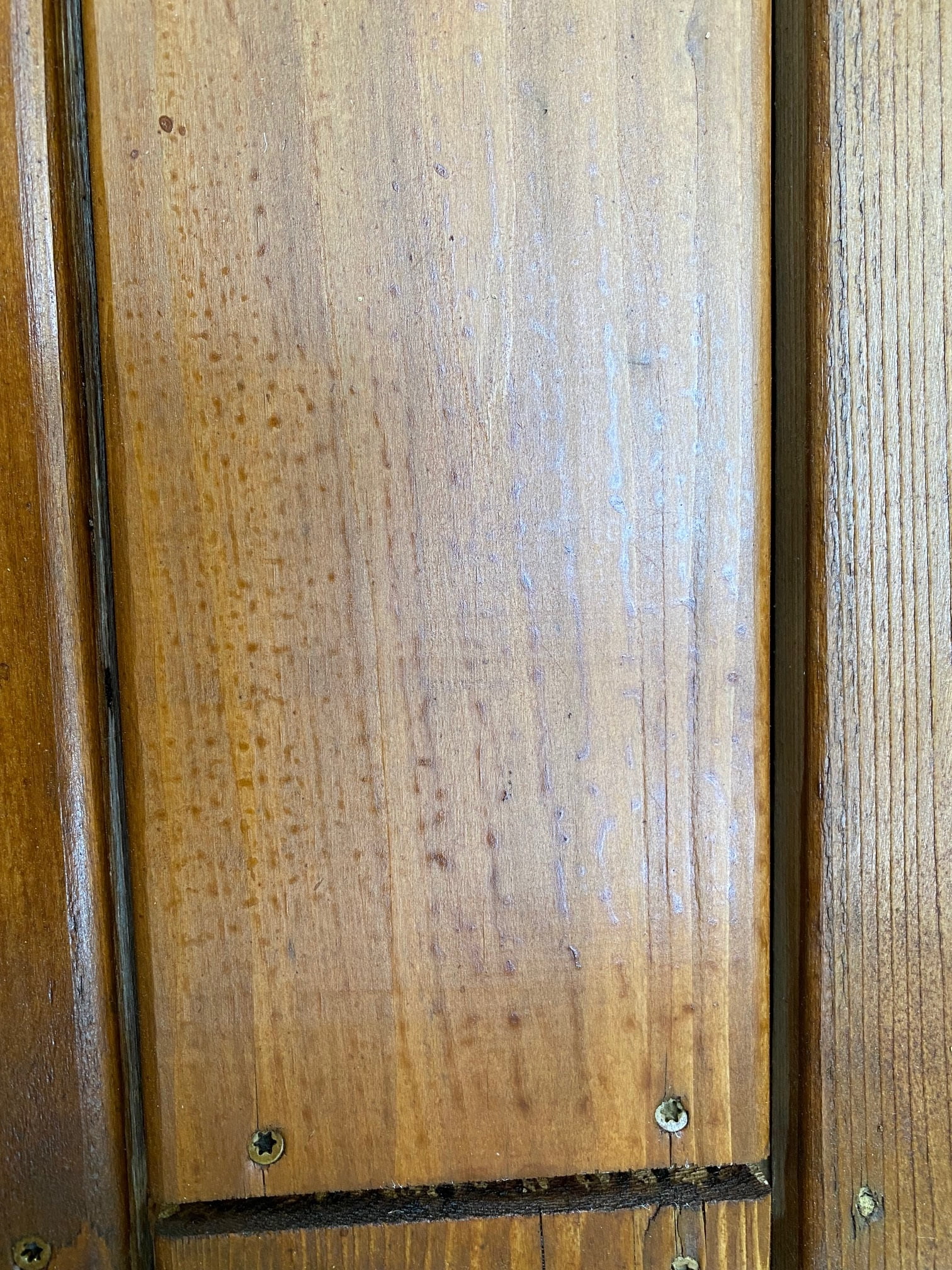

Loved TWP for my deck and porch. I have moved, though, and new issue. I had a company build a beautiful western red cedar fence that has almost NO knots…it’s beautiful. They recommended I go with an oil based, not water, UV, algae and mold protectants, clear stain/protection. We want to keep as close as possible to that new milled western red cedar color/appearance. Most sources say you need stain for UV protection. One said you MUST use a semi-transparent at the least. I am on the far north west coast butting up against Canada, about 1 mile from the sound/ocean. It is cool, wet, rainy, for almost 9 months. Summers are, ironically, almost drought like…lots of sun. While most discussions are for decks, what about the western red cedar fence? How can I give it UV, water, mold/algae protection while staying as close to natural as possible? Recommendations?
oops…I may have posted in wrong forum…how do I move it?
You must have a tint if you want UV protection. Use the TWP 100 Series. Honeytone is the lightest color.

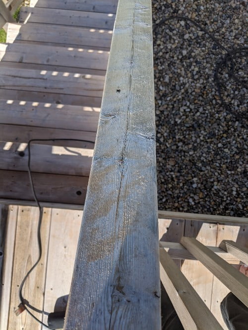

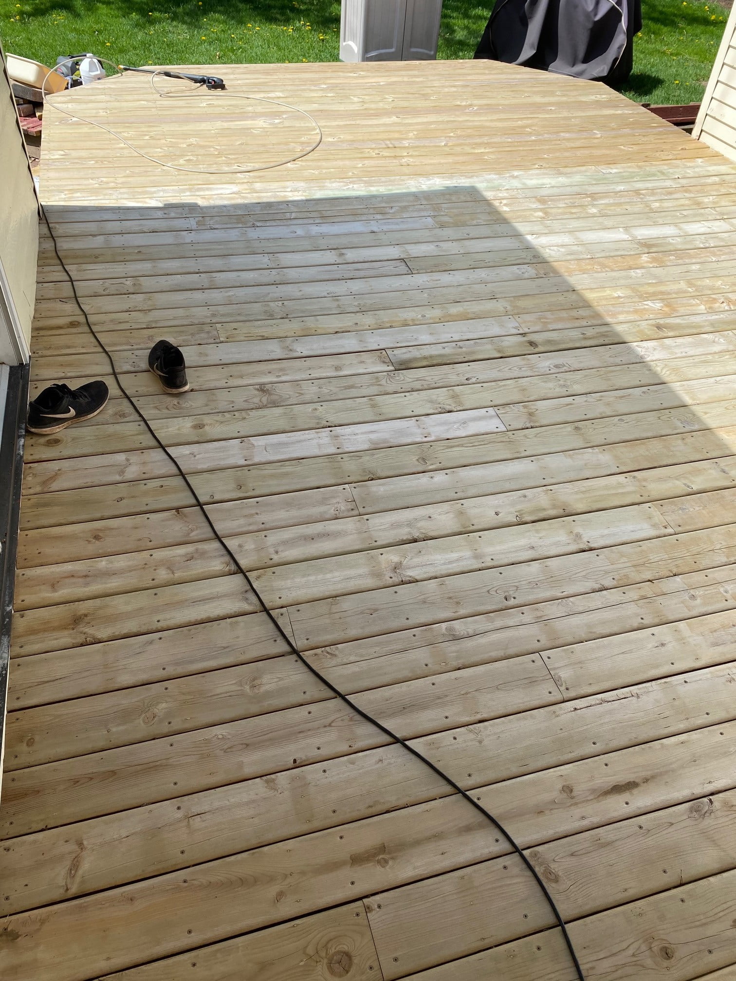

I’m to new to cleaning a deck and made a newbie mistake- I started power washing my deck last night with the spray pointed directly at the deck. I was so excited to see clean wood emerging that I didn’t realize I was gouging the deck a bit here and there. I have the fuzzies you mention in the article but also some unevenness. Will sanding/buffing smooth this out?
You have deep gouges and stop mark lines from your pressure washing. The only way to remove is heavy-duty sanding with a floor sanding machine. A buffer will not fix this.
Thanks for the reply. Should I power wash the rest of the deck (obviously more gently) first, or should I just go straight to sanding at this point?
Finish the pressure washing first.

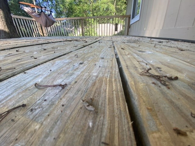

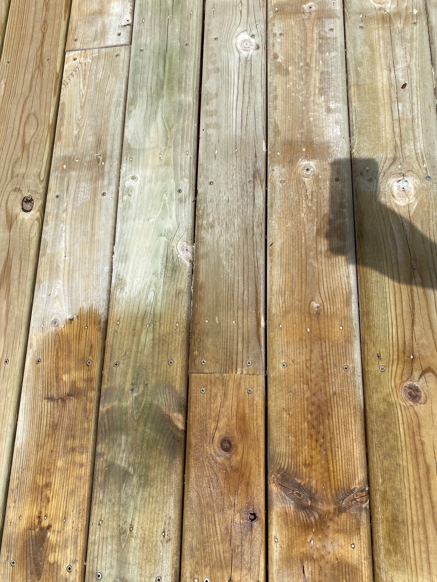

Hi, had a deck put up 2 summers ago, hasn’t been stained yet. I power washed it first. Boards looked grey. After using 1800 psi pressure washer the one section looked like regular wood again but there was I guess wood mulch all over and I thought I over did it, so I only did the rest of deck with lighter power but they still look grey.
Am I supposed to power wash it till it looks like normal wood color all over? And then sand it?
It’s 16×20 deck😫
I also bought a solid stain hoping it will cover it, but you mention after fuzzies, (mulch?)
So now I’m freaking out, was just gonna try solid stain over the whole thing but now from what you’ve said…… ack! Lol
Thank you for your input!
Kim
Get a quality deck cleaner and then pressure wash off. Brightener Last. No need to worry about any fuzzies if using a solid stain.

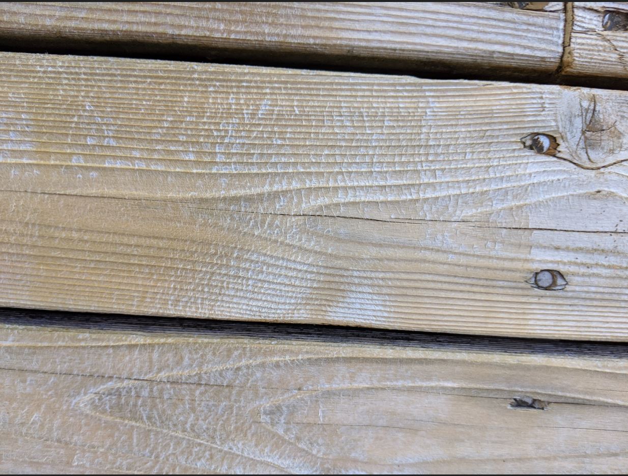

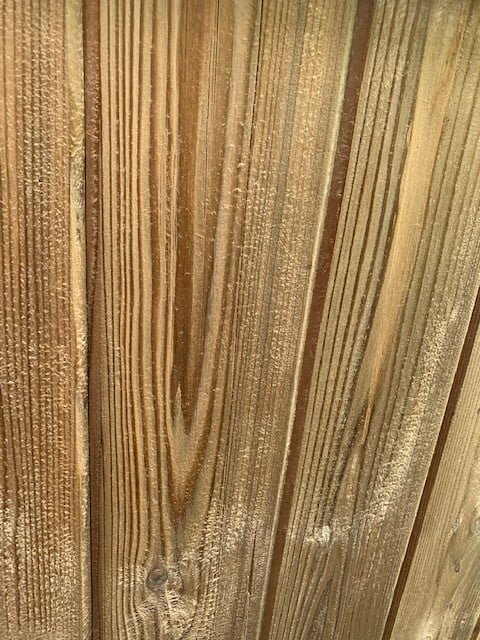

I’m having some troubles with furring on my deck after i stained. the deck is about 2 years old now.
I power washed then used a strip and stain remover, washed with a garden hose. Then used super deck Revive and brighter then washed the deck again (all shirwin willamns products). I then noticed deck furring. I used 150 grit sand paper paper sanded everything down. I stained the deck with oil based superdeck transparent stain. It looks horrible. the deck has fuzzy spots everywhere. Before i stained i thought i took care of all the deck furring. Any suggestion of what i should do next?
Do i need to start over and strip / revive the deck again?

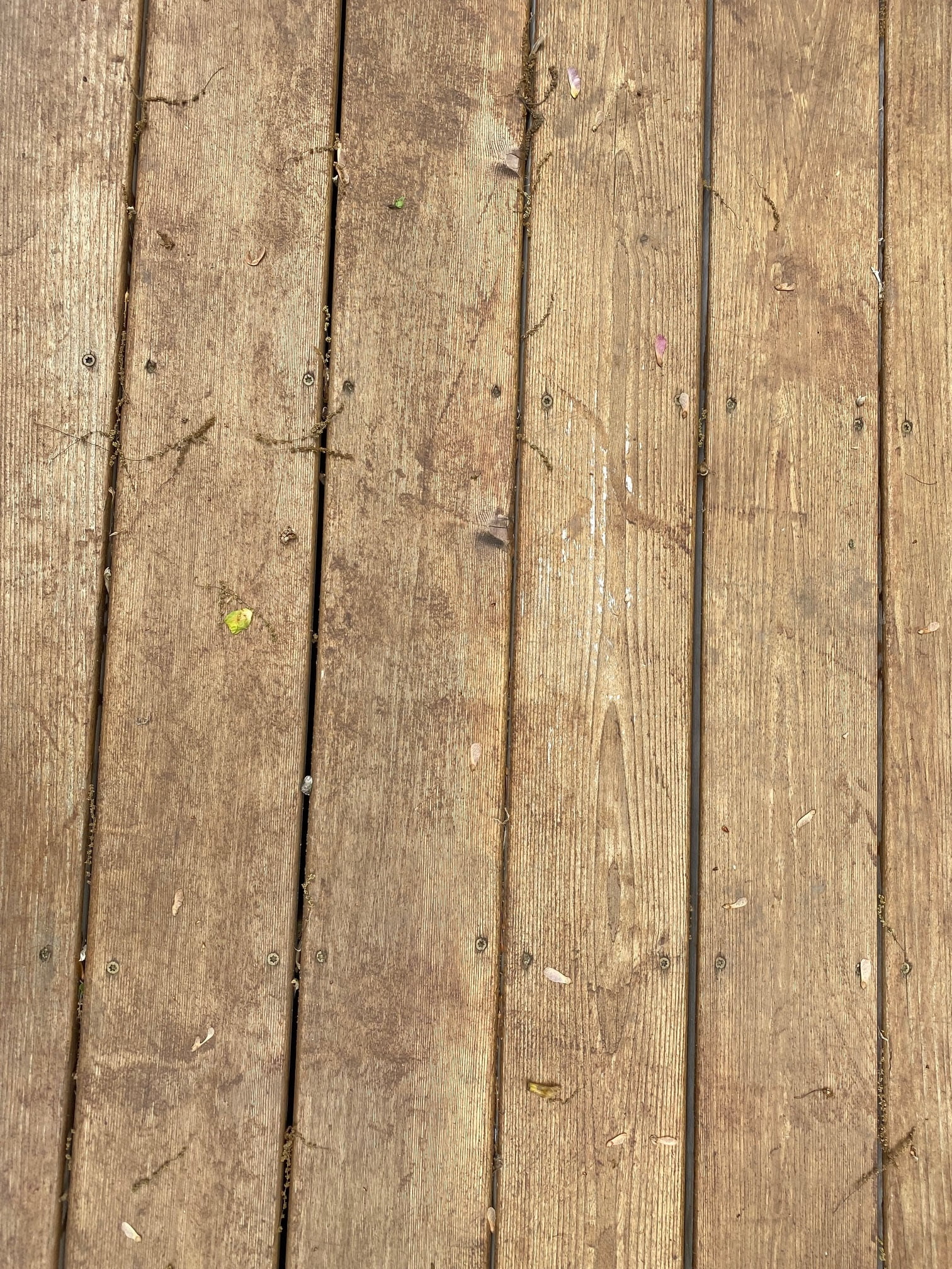

Do you think I could skip the brightening step. I will attach pictures.
We are also going to Home Depot today to rent a floor buffer. Can you please specify what type of buffer or attachment I will need for the machine!
Do not skip the brightener step. Use pads like this.

Refinished a deck for a customer and ended up with horrible mess of furring that I didn’t notice until AFTER the oil based product was put on! I really thought I studied and read and talked to enough people to know what I was doing…..To prep I stripped with Valspar deck stripper, rinsed thoroughly with sprayer (not pressure washer) and could still feel a “slime” (supposably no other product was needed to neutralize it, just water) so I called the customer service no# for the valspar and they said just rinse with True Green Cleaner to neutralize it. Five days later (today) I went back to stain it and noticed a slight furring so I sanded it lightly with a palm sander 60 grit. I didn’t think the slight amount left was anything uncommon so I applied the oil transparent and within half hour it began drying horribly. What now? I assume wait several day for it to dry ? and re-sand with ? and then lightly wipe on some more oil stain ? maybe ? OMG I’m in a panic.
You probably have to strip this off then sand/buff the deck to remove the fuzzies and then restain.
oh my… why wouldn’t I just be able to sand/buff it as is then restain it? knowing the stain will only stick to any particles of wood that have been stripped via the sanding process.
Because it may not dry evenly.

1. Why not just cut a 17-inch buffer pad down to 5-inches and glue to a random-orbit sander disc?
2. If that’s an option, which color buffing pad — red or white?
1. You could try this, let us know if it works.
2. Red.

OK, so I spent $7 on the 17-inch red floor buffer pad at Home Depot, cut out a 5-inch circle and glued it with Gorilla Glue to a sanding disc for my random-orbit sander.
A few observations:
1. It was very easy to do and technically worked as a hand-held buffer. See photo.
2. It seemed quite a bit less aggressive than the Scotch-Brite scouring pad, which I’d say was more effective but also left a more glossy surface.
3. It took off the most egregious fuzzies fairly easily, but left a lot. See middle board in photos. This may have been my technique as I did not apply a ton of pressure.
4. Perhaps a lot of the “smaller” fuzzies are just normal raised grain that I shouldn’t have been worried about in the first place?
5. For the railings, a light hand sanding with 80-grit was just as effective if not more so, but also took off quite a lot more wood.
Overall, not really sure how much difference it will make. In my case, most of the boards didn’t have as many fuzzies as the one in the photo, so the results weren’t really that noticeable.
Perhaps the experts here could comment on #4, above?
Thanks to everyone here for all the guidance. Hope this is helpful.
4. Correct.

Refresh: deck had rain on it 3 hours after being stained
Now has spotting. Can it be touched up after it dries or can a light coat of stain be applied?
The reply was to start over. Could you clarify in detail?
Would touching up or lightly coating work?
Central Mn. Powerwashed deck. Let it thoroughly dry. Applied semi trans stain with brushes. A sudden burst of unexpected rain came up 3 hours after we finished.
This mornind there are water spots in some areas especially where the deck was shaded.
How to proceed with getting rid of spotting???
You will need to remove all and start over most likely.
Do you mean strip stain? Can we let it dry and touch up spots? Can we put on a light coat of stain over all floor surfaces?
You cannot spot-treat as it will not blend and applying another coat on top does not always work. Send a picture.

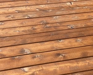

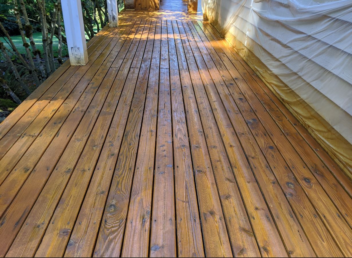

Pictures of spotting
It honestly does not look that bad. We would just leave it as is as it will be a lot of work to remove it all and start over.

We recently built our house/deck coming up on 2 years. First time power washing it and I’m wondering if we were too rough, I’m afraid I took too much off. It’s a cedar deck and kind of looks uneven..and there are some fuzzies. After power washing, used a deck cleaner and scrub brush, and now sanding. Will it look good with just a sealant on it or should i do a semi-transparent stain?
Pics
You will need a semi-transparent stain for this.

Yesterday I cleaned my deck with Olympic All -in-one deck cleaner. I scrubbed the deck with a brush while the cleaner was still on it. This morning I noticed a lot of fuzz. I sanded the deck with 80 grit but still have some fuzz left. The pictures below are after sanding. Do you think I should use scrub sand pad on it or do you think it is ok to stain. Thank you advance for you help.
Photo after sanding. Sorry can’t send more because the other pictures are over 4MB
I adjusted the size of the photos to fit.
Pics
Buff it off would be best.

NOTE: First picture is after my sanding (current state of deck). Second picture was taken last fall right after the deck was installed for comparison.
Try the brightener before staining to see if that will remove the darker internal spots. You will need to apply to all wood, not spot apply.
So I can sneak by with just wetting the deck and applying brightener?
Also, the pic I previously posted apparently wasn’t a current picture. These two are. I’m concerned the white stuff is residual cleaner that is embedded into the wood.
The white stuff is oxidation/graying of the wood that you did not remove fully when you cleaned. It typically does not show when stained.
Wet deck down and then brighen the wood.

Try a better hardwood stain: https://www.deckstainhelp.com/ipe-exotic-hardwood-stain-review/
Thanks for the tip! I’m going with Armstrong Clark Amber stain for hardwood, after I buff/sand the fuzzzies away.
Okay we change stain on our log home from sikkens to Wood guard they stripped the house with stripper and power washer then sand it some of it and now I added stain well it is furring what can we do they claim it will lay down in a couple weeks from the wood guard
It probably will not show when stained. Try a test spot.
Had a spot where it appears cleaner soaled into wood and didn’t rinse away, resulting in a spot where sealer failed, what is the best remedy?
It is not possible to spot treat an area and have it blend. You would have to redo all.
