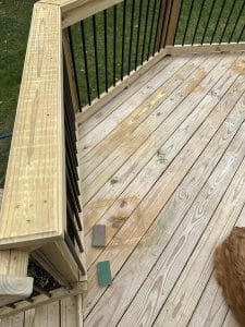

Hi Scott, I have a 3 year old cedar deck. It was originally treated with commercial waterproofing solution but it was a disaster, it all started peeling. I was ready to properly stain it, so stripped the old waterproofing solution with a render commercial buffer (and manual sander in tight spaces). I just used wood cleaner and power wash and I see a HUGE amount of fuzzies coming off during rinse as well as staying on visibly after wood is dry. I am planning on using C2 Guard stain in light color. Do I need to sand again the fuzzies away? So much work, I’m so frustrated, should I have cleaned and power washed first before sanding?
Need pics uploaded in the comments for proper help. Thanks
Pics1
Pics 2
Yes, you should sand to buff off the fuzzies.

Hi I have a treated 5 year old deck. I cleaned it and it was really gray Menards said to use a stripper even though it didn’t have anything on it. Now it’s a disaster.i used the hose because i was afraid to power wash it but i don’t think it was powerful enough to get all the product off now it’s gray, clean and fuzzies everywhere. I probably should have power washed it but now what?
Hi here’s the pictures I’m so frustrated. I just want to fix it and be done.
As our article above explains, you over-stripped. To fix, rent a floor buffer and sand the deck. Once that is done, you can stain it.

Hey sorry last question! So here’s what the deck looks like after cleaning. I posted 2 pics. The first is direct sunlight thr second shows how 1/2 of it looks out of direct sun. I’m sanding it next. As you can see it’s not grey or darkened but mostly a washed out pale yellow to whitish tone. It’s odd because later in the day or out of direct sunlight the deck looks really smooth and clean but in direct sun hitting different parts of it throughout the day you can really see the patchiness. My question is, after sanding off the fuzzies, will the brightener help bring the wood back to its more natural deep cedar tone and even out the patchiness we see or does that really matter if we’re re staining with a semi transparent Pecan pigmented penetrating oil stain like TWP?
Just brighen and then stain, you will be fine.
Sorry here are those pics to go along with my last question….

Post some pictures and what stain brand did you use?
