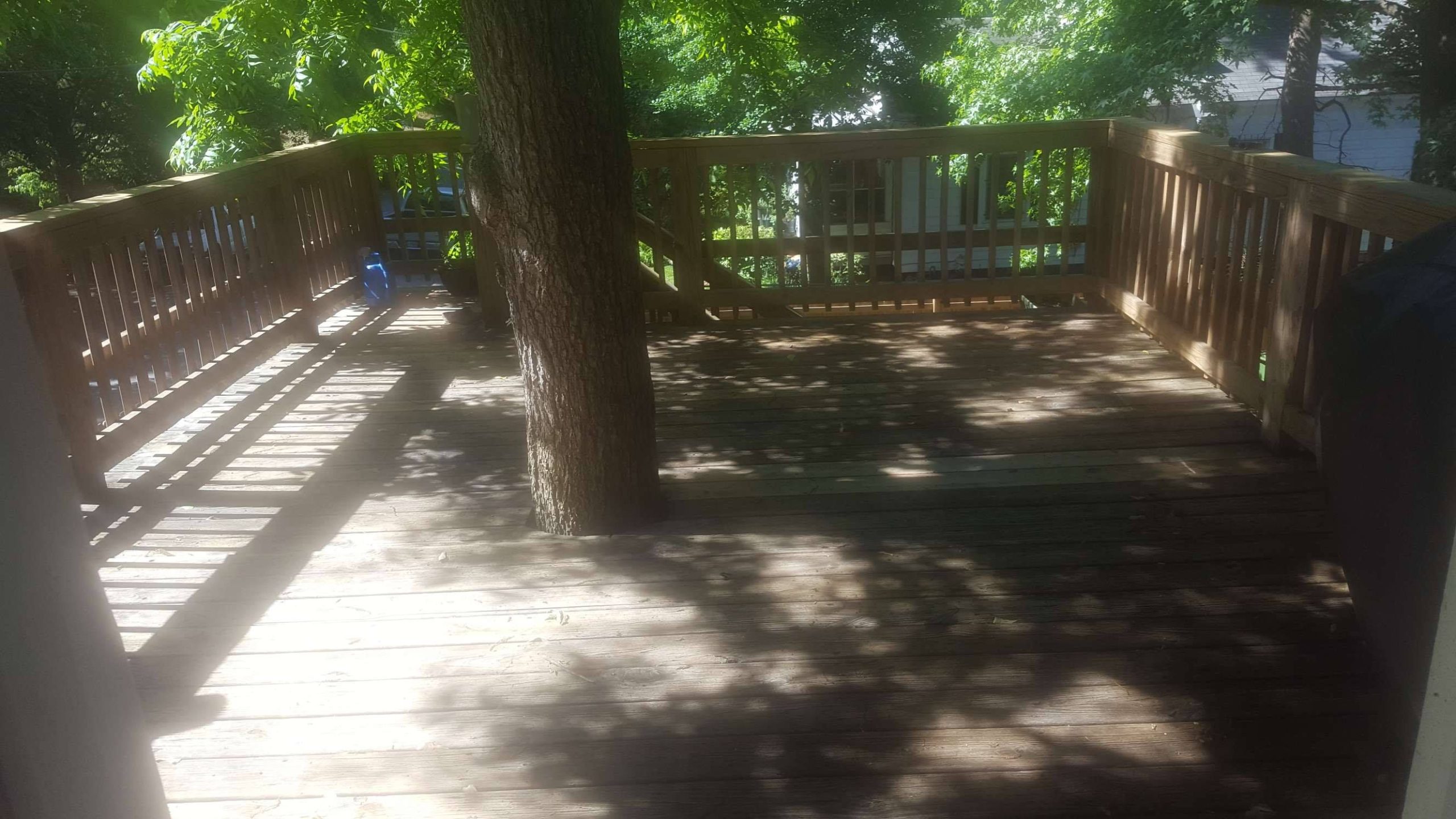

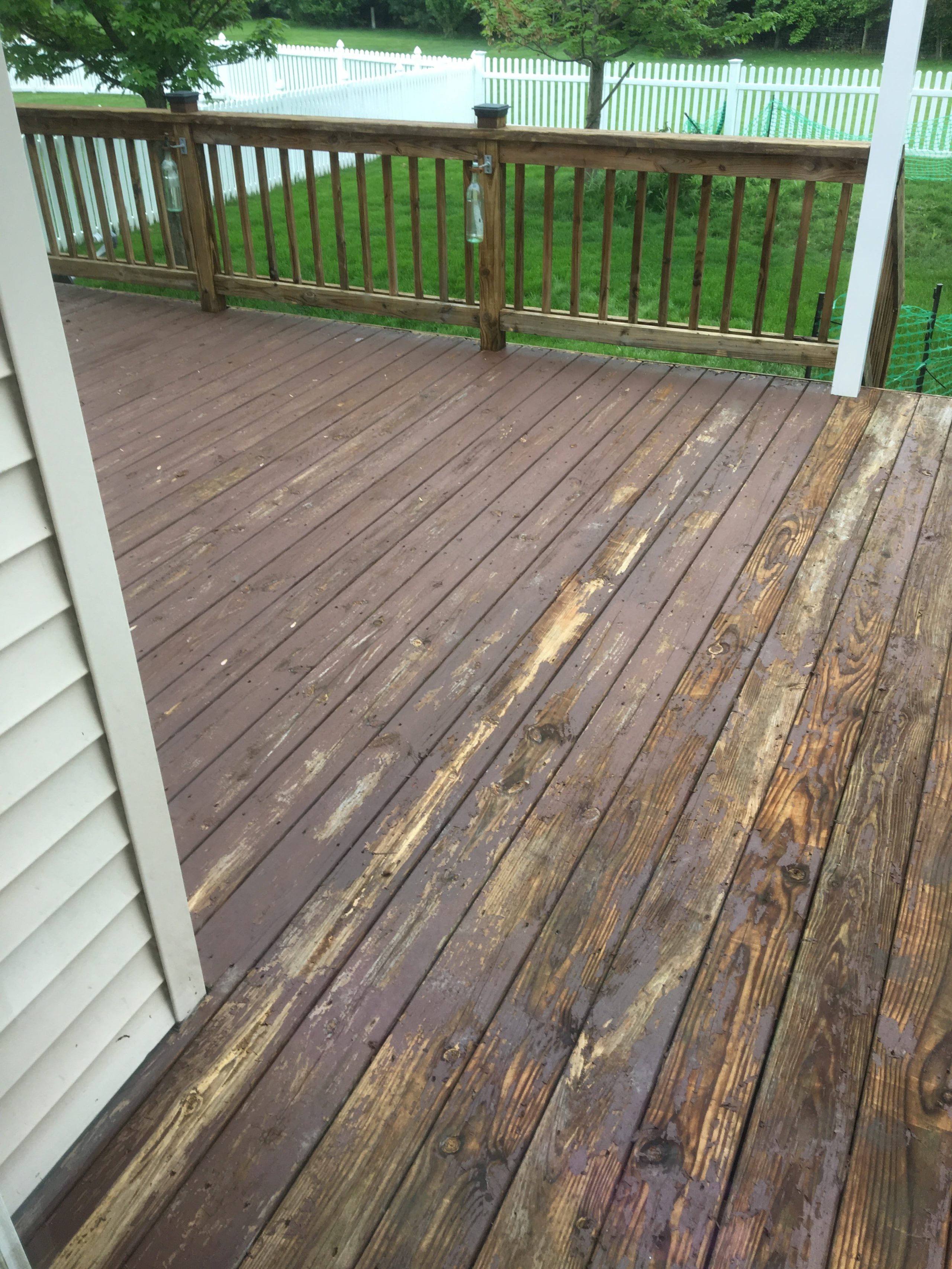

1. Wood is pressure treated – 2 years old.
2. Currently coated with a semi-transparent oil-based stain.
3. Switching brands based on your website’s recommendations.
4. current stain – Sikkens ProLuxe Cetol SRD
5. current stain – Oil-based, semi-transparent
6. Some mildew
7. Unknown reason for failure
I appreciate any advice you can give me for refinishing…thanks!
For prep, strip and brighten for prep with Restore A Deck Stripper/Brightener Kits. Stain with TWP or Armstrong Clark stains.

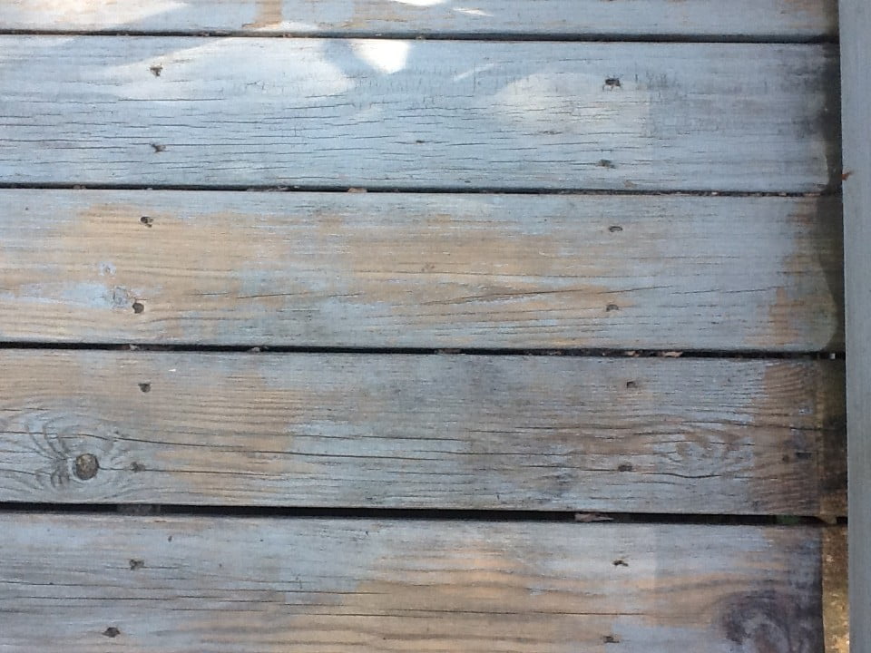

I used Thompson’s tinted water seal over their clear product that had been on the deck for several years and this is what happened after one winter. They told me that the two stains are different products are not compatible and must sand or strip to remove this mess. I am looking for a stripper product that is bio degradable so I won’t damage surrounding grass and plants.
Sorry, but you will need to power sand to fix this. Strippers will not work very well.

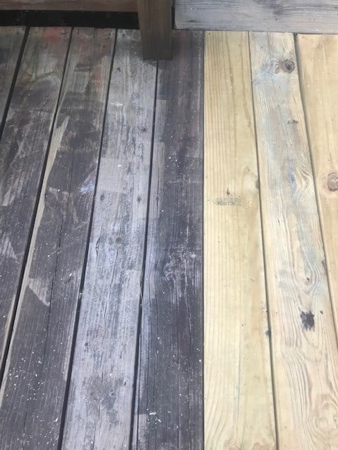

We have just replaced about 2/3 of our deck with brown treated decking due to rot. The deck was coated two years ago with Sherwin Williams solid color deck stain carefully following instructions. It has failed miserably. All the boards are peeling. I would rather not use solid color stain again, but since some boards are new and some old with peeling paint there doesn’t seem to be many options. I can’t imagine sanding it ( the deck is 30’x30′). I have used stripper on furniture, but with all the variations in levels and deck screws it would be hard. What do you use for stripper? Is there an easier way?
You cannot strip a solid stain effectively. Best to sand it all off or you will have to redo with a solid stain. Another option is to replace all the wood since you are 2/3 down.
See this for tips on your new wood. https://www.deckstainhelp.com/staining-a-new-deck/

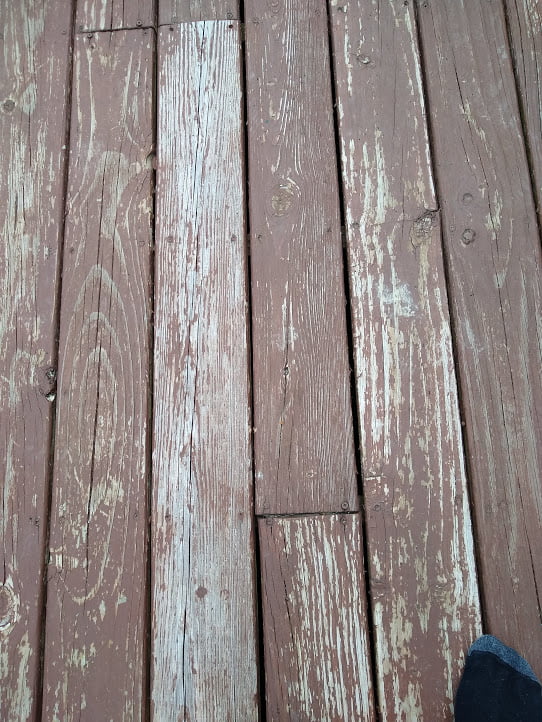

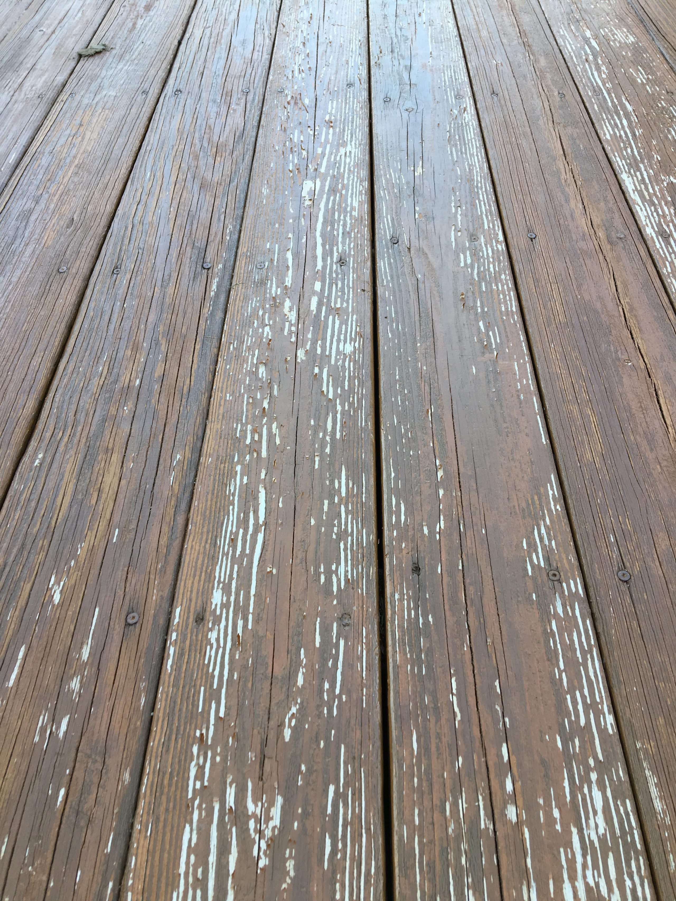

1. Old PT pine
2. peeling BEHR Premium semi-transparent stain
3. would like to “apply mx coat of same brand & color” but receptive to “switching brands”
4, BEHR
5. see #2
6. minor mildew
7. prep failure and using snow blower [rubber paddles]
If you want to switch brands you will need to strip and sand to remove. Brightener after. If staying with the same color and brand, use a deck cleaner for prep. Pressure wash while prepping with the prep products.

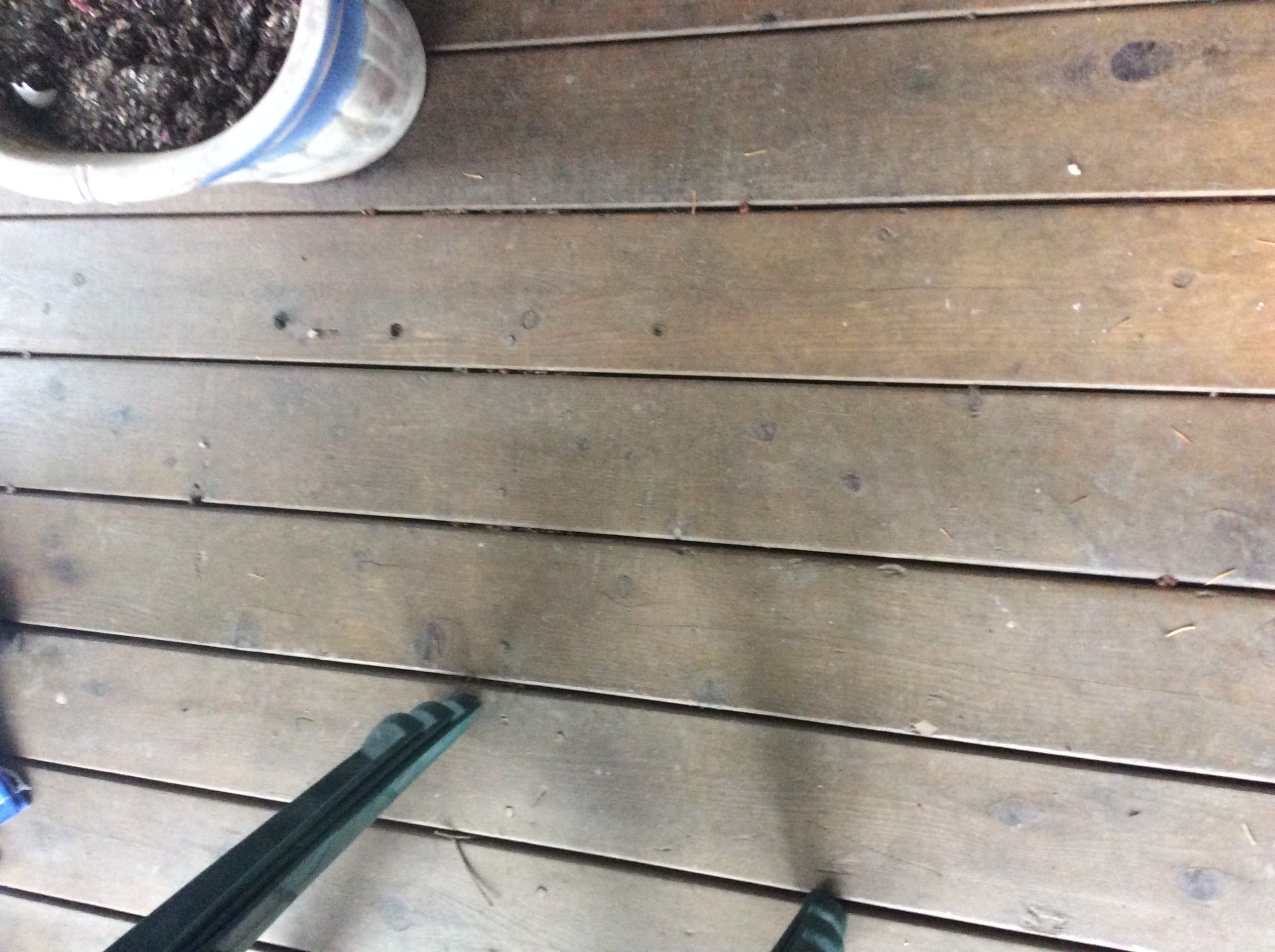

1. The deck is about 3-5 years old
2. The deck was stained about 1 year ago, it was stained with SuperDeck semi-solid stain but is starting to peel is certain areas.
3. I’m not sure what I will be using. I might stick with the semi-solid stain. I’m up for taking suggestions on what best to use. The deck gets a lot of sun.
4. SuperDeck semi-solid cedar color
5. Semi Solid
6. Yes mold and mildew issues
7. Not sure what the reason for failure was. I live in Southern Maryland.
I wasn’t sure if i could just use a cleaning & a brightener then use a similar semi solid stain. Looking for any advice here. Thanks for the input.
It will need to be removed. Strip and pressure wash first. Sand after to remove all. Brightener last.

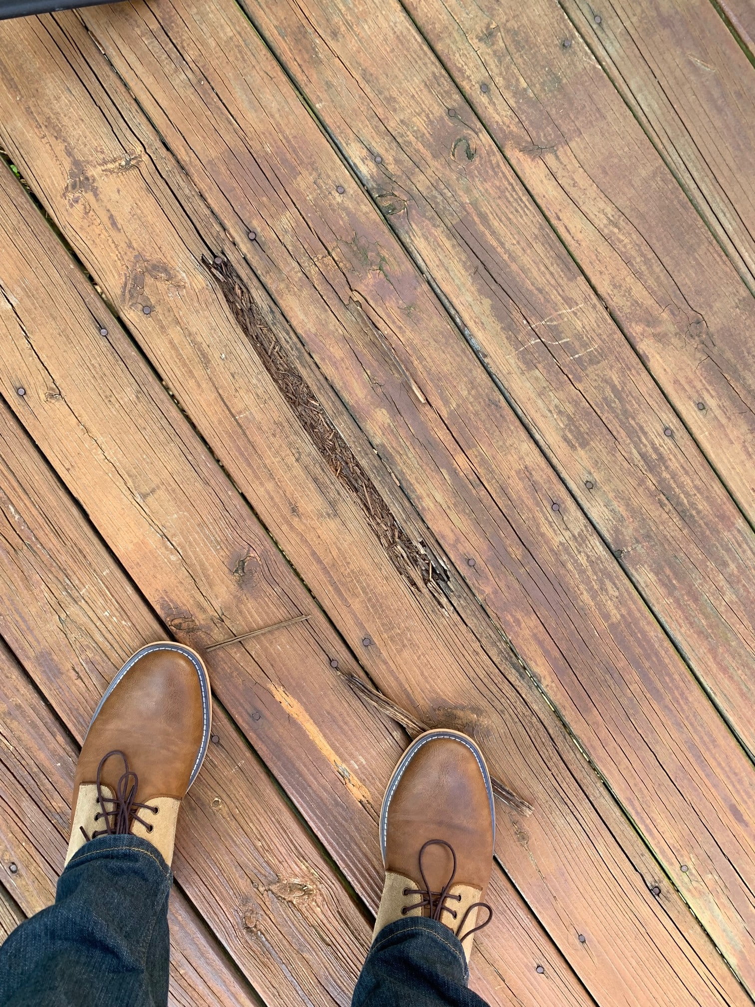

Deck is cedar, 7 years old
Did have a coating, that’s clearly coming off, that was put on 4 years ago
Switching brands
Used Cabot, water based previously, not sure about the finish
No mold or mildew issues
Deck faces east. Live in Michigan so deck will experience the 4 seasons — rain, snow, heat and humidity
Should I clean and sand or use a stripper and sand? What’s the purpose of a brightening solution and should I use one? Once the prep work is complete, do you suggest a stain or a penetrating timber oil? What about a sealer? So confusing with all the products on the market!
Thanks for your help!
Strip first. Sand if needed after. Brightener last. The brightener is needed to neutralize the stripper and it allows the stain to soak in better.

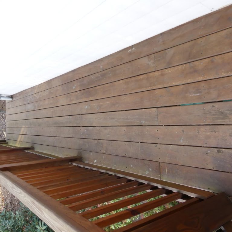

Deck that is 2 years old. this will be 3rd summer
Current coating Behr semi transparent stain 6year water based( terrible)
Switching to restore a deck
Lots of Peeling and some midew issues every year since application
It currently looks worse than photos taken after year 1.
I am on ocean front and covered portion has weathered well but part open to elements not well.
Thanks for input
Strip off what you can. Sand the rest off and then brighten all wood when done.

1. Old wood (except for the seven new planks I just installed to replace the rotting ones)
2. Current coating (applied about four years ago) is basically gone, except for the railings.
3. Haven’t chosen a new coat yet
4. Thompson’s Woodland Cedar semi-transparent
5. Haven’t chosen one yet
6. Some mold/mildew in cracks of wood
7. Waited too long to stain again.
I’ve pressure-washed the deck, and and now wondering if I need to strip the railings. Also, I’m wondering if I need to sand, and then clean and brighten, and what order all this should come in.
Also, since I just recently installed seven new planks, how long should I wait before staining them?
Thanks so much. Your site is invaluable.
-You should strip and brighten all wood. No need to clean
-You do not need to sand, unless you want to remove all the pressure washing marks that you did to the wood. That will show through with a transparent deck stain.
-See this about new wood: https://www.deckstainhelp.com/staining-a-new-deck/

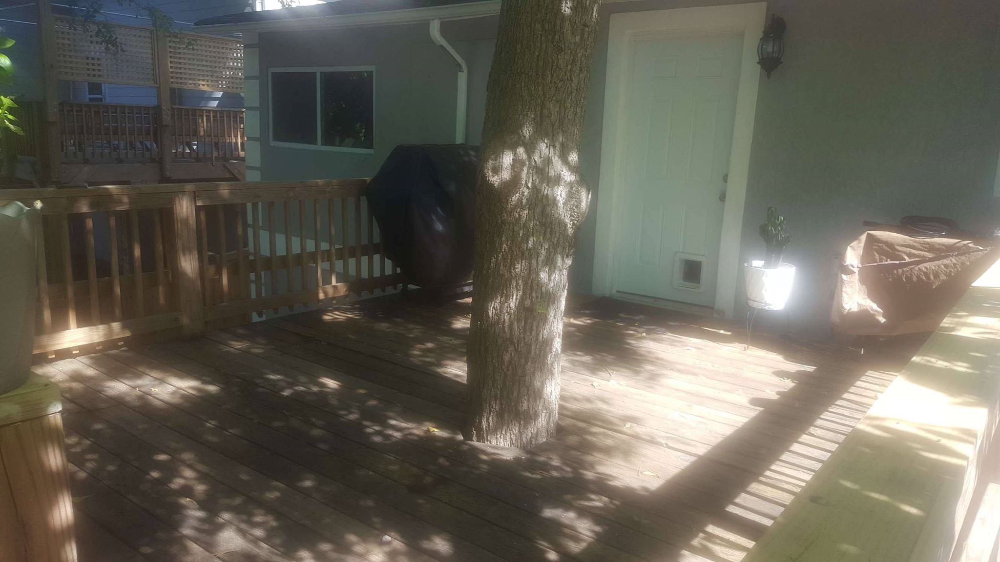

My 2000 sq ft deck is a mess. Brand new deck that I let cure for one year and followed the Behr directions to a T in prep and application. The semi transparent deck stain started to peel after year one. Also lots of mildew. It was tacky forever after application. Vertical boards seem to be ok and I have a covered porch area that is also fine with no peeling. I have power washed and will apply the Behr cleaner…I would like to use a different product this time but because the deck wraps all the way around my house and the vertical boards are all ok it would save a LOT of time if I could just reapply what was on there. I do not want to strip and sand everything off. Ugh. Any suggestions? FYI – Behr paid me $5000 for ruining my deck. I had to sign an agreement that I would not sue them later. Lol.
Also of note – The house is in the woods by a lake…so the deck is in the shade most of the day and we live in Ohio. I am not sure that any stain will work well.
You have no choice but to remove all the Behr unless you want to repeat the same issues. Strip and sand to remove. Brightener after. If you received $5000, then hire someone who knows how to remove it. It will be your best option.

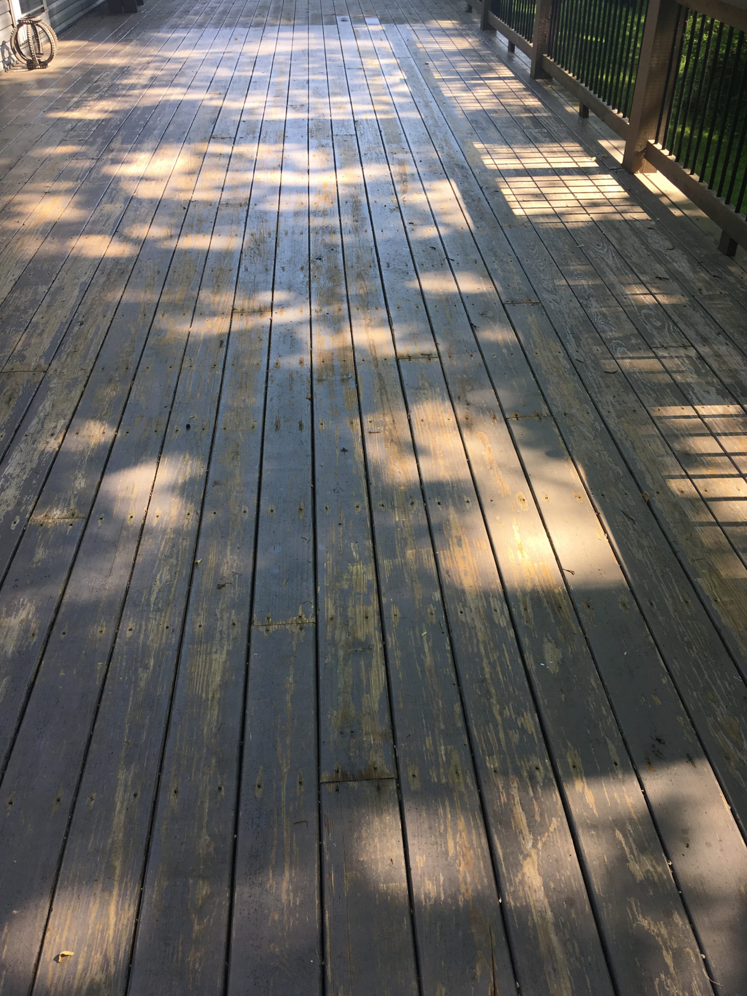

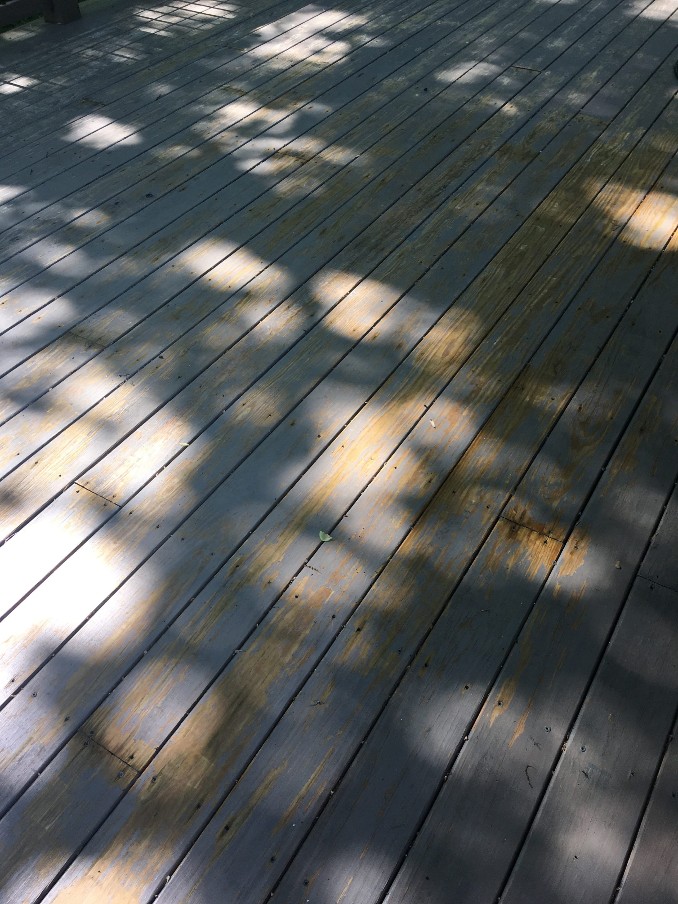

Brand new deck in spring 2016. Sanded, cleaned, stained with Olympic Maximum semi-trans in fall 2016. Stain failed miserably within 18 months. Reapplied in fall 2018 following same steps and failed within 6 months! Planning to now do probably with your well-rated Restore-A-Deck. Want to be sure I do it right so it doesn’t fail again!
1) Wood is now 3 years old
2) Yes – Has partially failed coatings of Olympic Maximum
3) Switching brands
4) Olympic Maximum water-based Semi-transparent in Caramel
5) water-based semi-transparent
6) no mold or mildew
7)Reason for previous failure – product formulation
What do I need to do for prep this time? Want to stay with semi-transparent stain and as close in color to the Olympic Caramel as I can. I’m thinking the Light Walnut for Restore-A-Deck. Pictures attached are of the above mentioned deck as it looks now.

You will have to remove this product when switching brands. Strip and brighten the wood. Sand after to remove all. Once it is down to the bare wood, you can switch to the RAD Light Walnut.
For the other decks, you cannot use a clear sealer over a deck stain. You will need to strip and brighten those as well if switching brands.

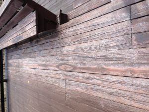

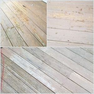

We are currently redoing our deck. We will be adding new wood and saving some of the old wood. The new wood is Western cedar which we have cut and milled from dead trees on our land and the old is Port Orford cedar.
The first picture is of part of the deck that is badly damaged and will be replaced, second picture is the part of the deck that is covered and in good condition and the third is some of the deck that I have applied stain stripper to and I am waiting for it to dry.
My main question is since we are combining the two different woods as well as using some old and new woods together, should i stain the deck with a solid stain to get more consistency or would I be able to use a semi transparent? What steps should I take to prepare the deck. Thank you so much
The pictures are out of order 1st pic old good wood, second pic stripped, third old damaged wood.
We would stay semi-transparent. The new wood will be lighter but will blend over time. Strip and brighten all for prep.

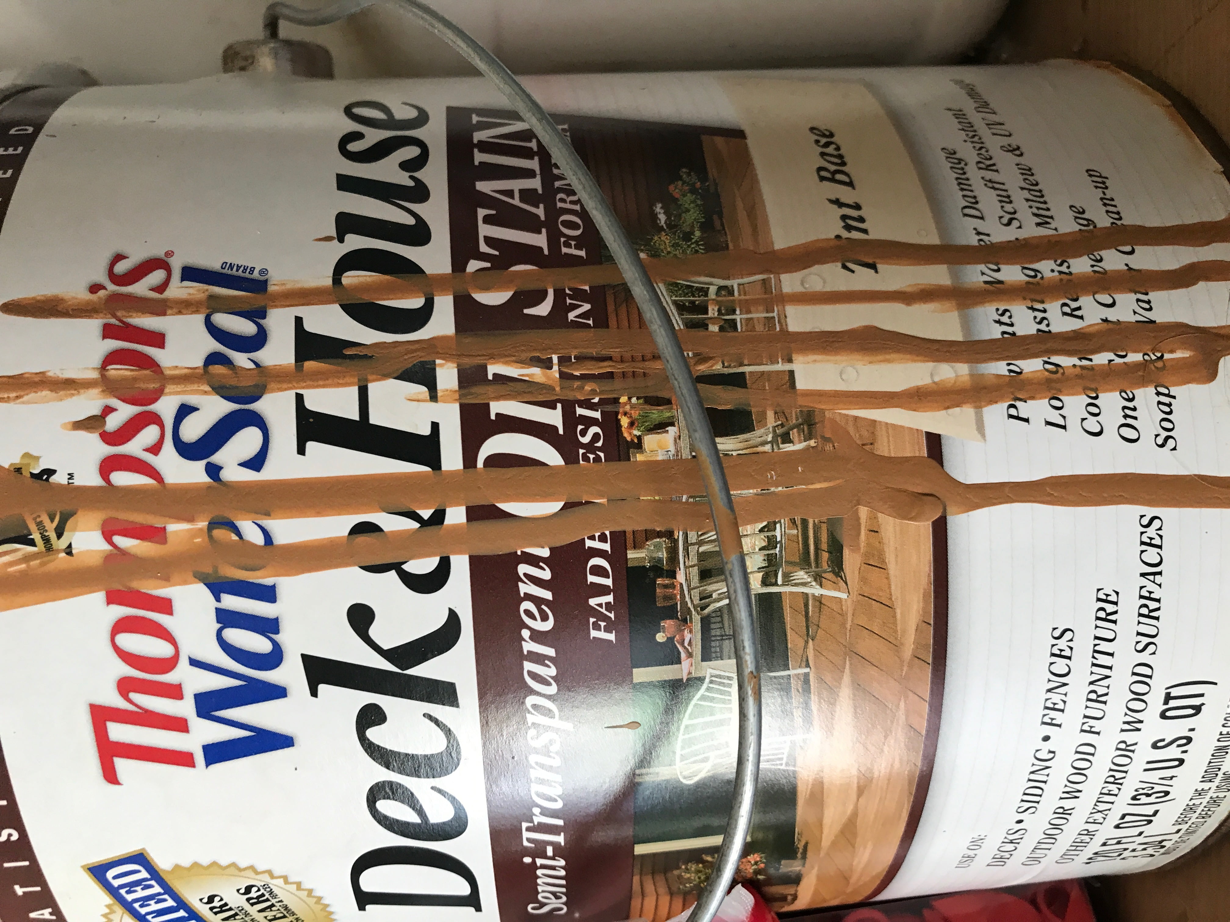

So I cleaned and brightened my deck to prep for stain a week ago only to open my leftover can of stain and find that it was now jelly (lessons were learned). I am now waiting for some new TWP 100 to arrive. In the interim I have kept my deck sealed off from people and dogs walking on it, to try to keep it somewhat clean. I’m not sure how soon the weather will allow me to stain once my stain arrives. If my deck has been kept clean would I need to re-clean and brighten again before staining? How much time can elapse between cleaning and staining? Thanks. Obviously going for best results here.
As long as you stain within 2 weeks of prep, you are okay.

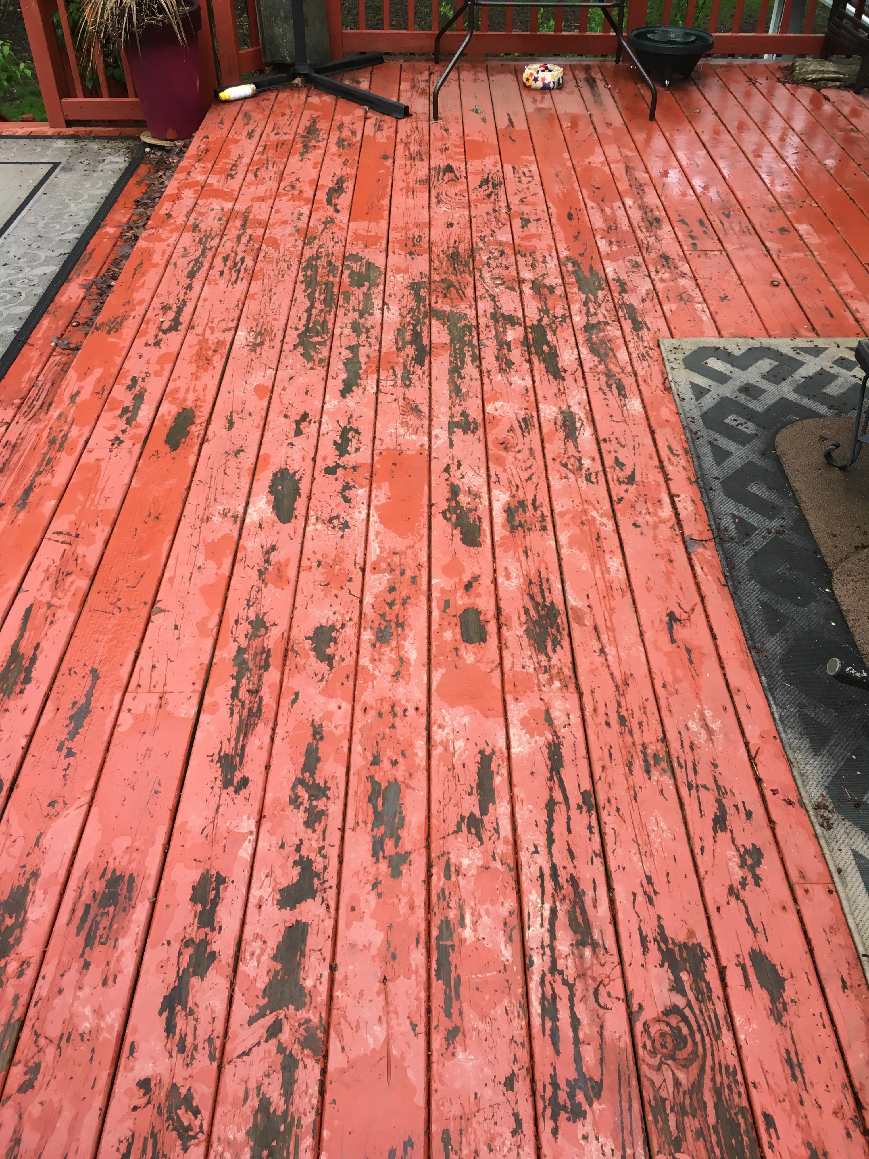

I have an older deck, which I stained with a semi-transparent Behr stain 4 years ago. To prep for new stain, I cleaned and power washed a portion of the deck, as shown in the first photo. I still have a lot of deck to go; the second photo shows the green grime. A few questions:
– should I stop power washing and strip, brighten and stain? Or keep washing then strip?
– can I use another product? I’d like to get away from the Behr semi-transparent product as it didn’t hold well. If so, must I stick with semi-transparent?
That looks solid, not semi-transparent and will not fully strip off. If you want to switch brands, you will need to strip what you can (maybe 50%) and then sand the rest off. If you do not want to power sand, then you will need to use a solid stain to cover the stain that does not strip off.
Ok, thanks – I appreciate the quick reply. I know it may look solid, but it’s Behr’s Premium Semi-Transparent Weather Proofing all in one stain and sealer. If I keep that brand and use the exact same product, am I ok stripping and then reapplying the same product? If I strip, what product would you recommend. Thanks again.
If you want to use the same color and brand, then you do not need to strip fully. You can try cleaning and reapplying.

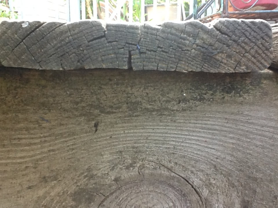

We are trying to get our fence in shape to stain it. It’s about 2 – 3 years old, never been stained. We have power washed it and scrubbed and bleached and scrubbed the bottom and the algae and mold continue to be there. My goal is to keep the fence up and functional for as long as we can. Is it imperative for us to remove the mold and algae? I am thinking so; it’s just been so much work thus far! After reading here, it sounds as if sanding may be our only option. These stains are just above ground level. We will take any advise you can give us. Thanks in advance!
That is a combination of water stains with algae and mildew and much of it is internal. Try 1 part bleach to 4 parts water. Apply and see if that helps.
Thanks! When you say internal damage, does that mean rot? And, how long should I leave the water/bleach on before I rinse it off?
Internally stained with the water, not damaged. I doubt it is rotting yet. Leave on for 10 minutes and then rinse.

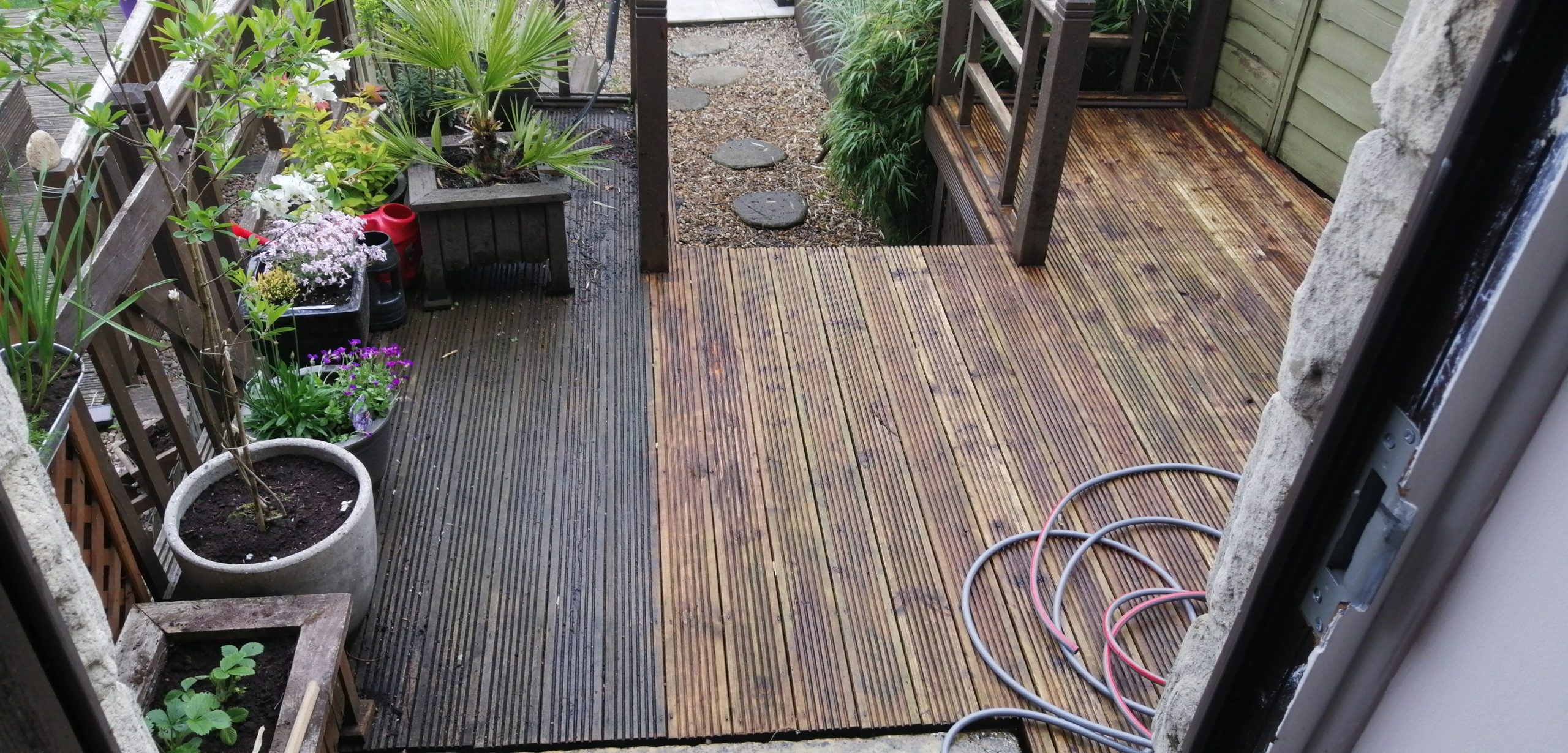

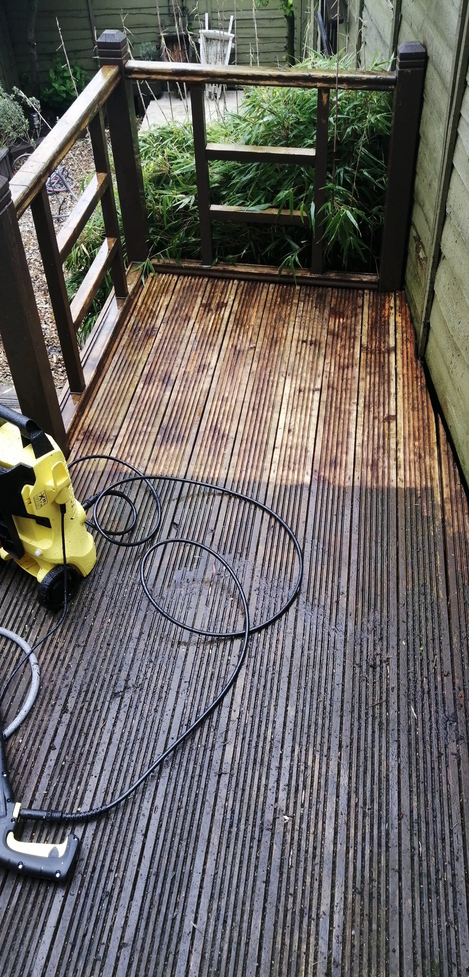

Hey, bought a house in the autumn and looking to rejuvenate the deck. We’re in the process of jet washing but it looks very tired and there’s still some paint/stain left, especially in the grooves.
Just wondering what to do next, whether it’s worth applying any stripper or cleaner or whether to crack on with treating it.
Also whether we’d be best using oil or stain (we’re in the UK for the record).
Use a deck cleaner and then a wood brightener with the pressure washing for best results. Stain with a penetrating semi-transparent oil based stain.

I’m in western NC and have a lot of deck space: largest on the SE side, with 2/3 of it getting full sun; small one on the NE side which gets sun in the morning; and a small one on the SW side which is mostly shaded. They’re all on the second level, so there are also about 15 steps – which are on the NE side. I’m pretty certain it’s all PT pine. It’s been fairly well maintained but was NOT properly prepped in the past prior to being stained.
Answers to your questions:
1) 15 years old
2) Yes, but it varies tremendously from almost none on the SE side to almost new under the doormat on the NE side.
3) I plan to use the TWP 100.
4 & 5) Last couple of times: Olympic Wood Protector / Sealant / Clear – which I’m pretty sure is oil based; prior to that I don’t know other than that it was semi-transparent.
6) Some but not extensive
7) I can’t say that it failed, just that it’s been two years and the horizontal surfaces need a new coat.
Now my questions:
1) For the HORIZONTAL surfaces, I plan to use RAD stripper then citric acid (want to avoid oxalic acid for environmental reasons). Would those be the proper steps?
2) For the VERTICAL surfaces, they are in pretty good shape so only need a good cleaning. Would using sodium percarbonate on them damage the coating that’s there? Would I need to follow with citric acid if I’m not staining, or would just the SP be OK?
Again, thanks a million!
Need pictures.
So sorry; I totally spaced on attaching them, even tho I took them several days ago.
These are all of the SE deck.
The first one is under the doormat on the NE deck. The others are the SW deck.
You will need the two additives for the RAD stripper. Your current coating(s) look thick on the floors: https://www.deckstainhelp.com/restore-a-deck-stain-stripper-booster-thickening-gel-review/
You have to stip the railings as well as you cannot apply a different brand of stain like TWP over what you currently have on it.
The RAD Brightener contains citric acid as well. A buffered blend.

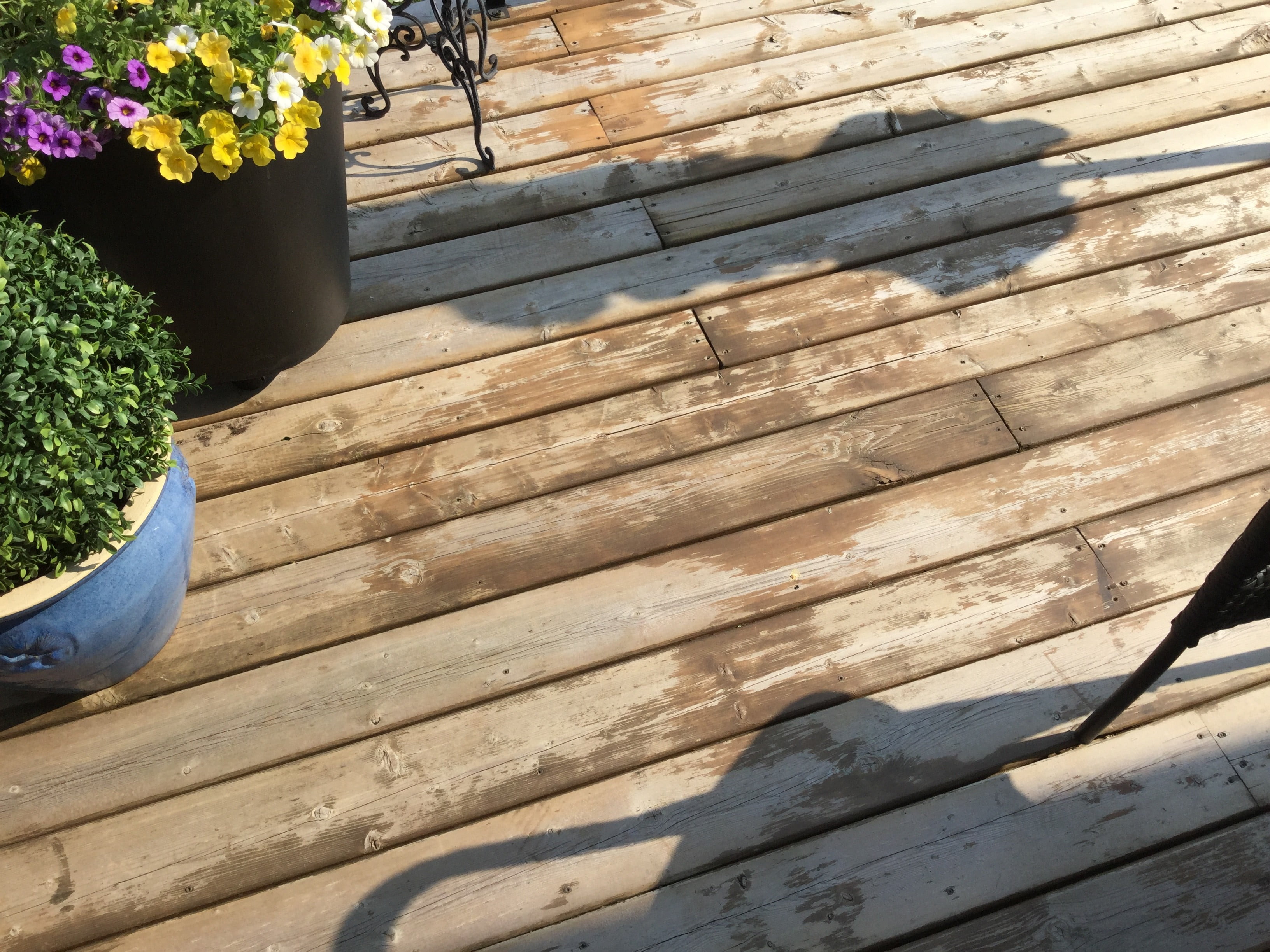

7 – While aged, the previous stain is acceptable, but some of the boards are rotting; stain was potentially applied in order to sell with wood already in a compromised state
8 – See pictures below
You can use Stripper on all wood. Brightener after.
You have multiple layers of stain. Try the Restore A Deck Stripper with the Additives for best results: https://www.deckstainhelp.com/restore-a-deck-stain-stripper-booster-thickening-gel-review/
Thanks a bunch. Any thoughts on whether I should replace all the boards, a major section (where the rot is located) or just the ones that are rotting currently? Said differently, from what you can see, does it look like other boards are about to go?
Replace rotting only.
We have a cedar pergola that we purchased from Costco years ago. It had gotten very gray and weathered so I sanded and stained it with Thompson’s water seal in the fall of 2017. It was peeling a nasty within weeks! It continued to get worse over the course of the past year. We power washed it a couple of weeks ago and most of the Thompson’s came off easily. There are a few surfaces that are hard to reach that still have a little bit of the stain on them. I have been trying to sand it all off, but it is difficult to get it all. Would it be better to use a stripper on it instead or should I just try to power wash it more? Also, after that do I need to use a brightener ? This thing is such a pain to stain. I want to do it right so it lasts as long as possible! I live in Utah so we get both really hot and cold weather. Which product would you recommend using on it?
Try the Restore A Deck Stripper with the additives for best results: https://www.deckstainhelp.com/restore-a-deck-stain-stripper-booster-thickening-gel-review/
Yes, you have to brighten after. Try Armstrong Clark in a semi-solid color.
We have a cedar deck that is 3 years old and we haven’t re applied a stain since we built it. We used a Sikkens deck stain and it looked good initially, but after about 3-6 months, it started to dry out. We are in Moab, UT so we get A LOT of sun! We want something better. After looking on your site we think that the Armstrong Clark is the way to go. We don’t want to change the color of it by going with a darker pigmentation of stain. Is the Armstrong Clark the best option for us? Do we need to sand before re applying? Then go with a deck cleaner/brightener? What would be the step process for that? Thanks!
You do need to remove the Sikkens and that would entail stripping and brightening for prep. The AC would work well after.
We stained our large deck in Oct 2018 with Behr premium solid color waterproofing stain and sealer. No rain predicted but it did as we finished the project. We watched in horror as blue and white puddles formed on our 30 year old pressure treated cedar deck and benches. Due to weather and life interfering, , we are only now facing what to do with this deck, short of replacing it. Please let us know what we need to do. Thanks so much
If you want to remove it and go with a semi-transparent then you will need to sand it fully off. Another option is to clean it and recoat with another solid color stain.
Please help with my deck disaster!
1. 2 years old cedar
2. Yes
3. Want to remove the coating
4. Behr Deckover
5. Supposed to last 5 years. Solid paint type coating.
6. No mildew
7. Peeling bad
This product is terrible! Applied last year and it is peeling in chunks. What can I do to remove it? It makes me feel sick to my stomoch when I look at it!
The only way you will be able to remove the Behr Deckover is by scraping and heavy-duty power sanding.

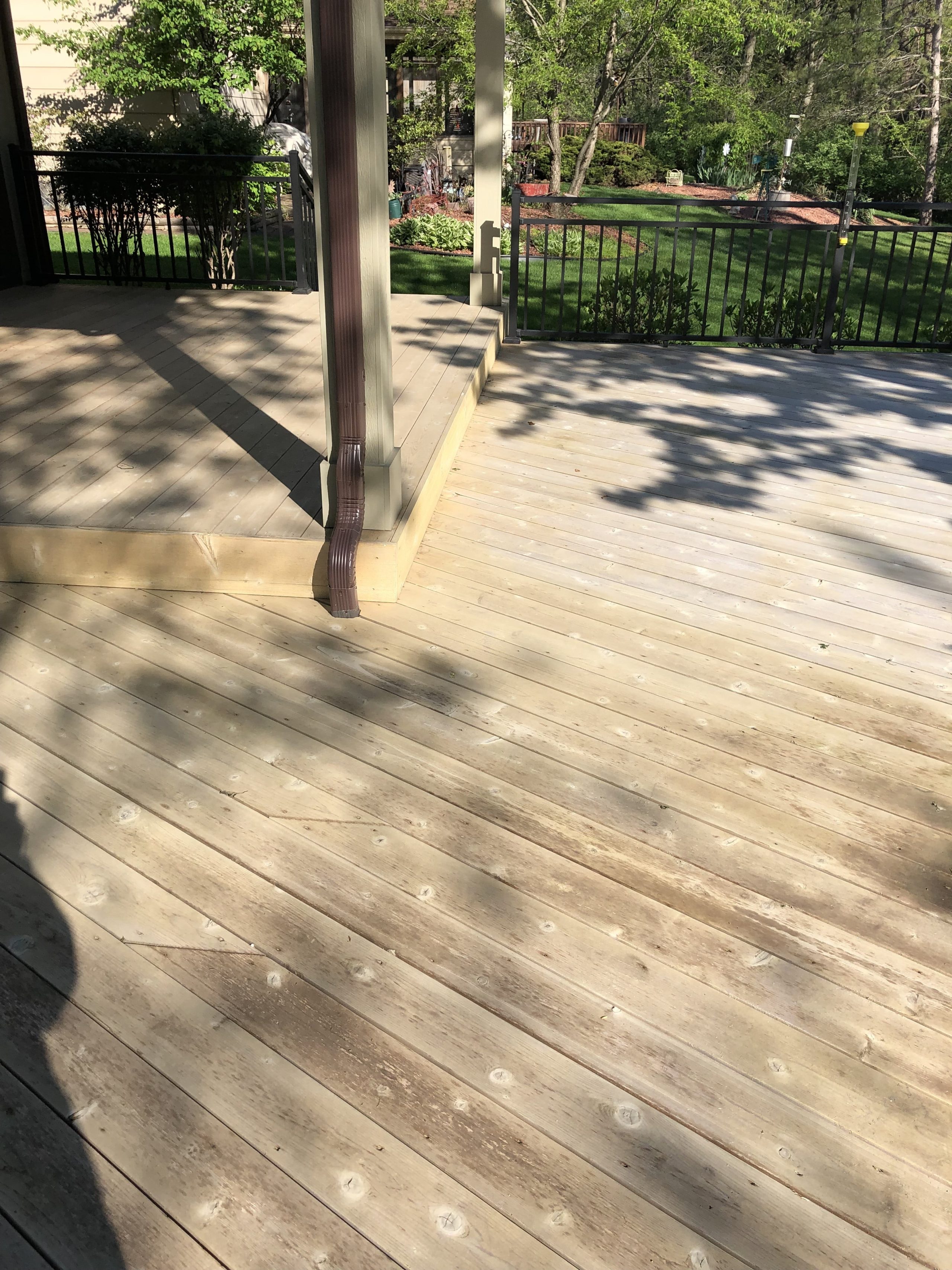

1. 10 years olf
2. Yes
3. I want to use the TWP 100 Series
4. Behr Stain from Home Depot
5. Water Based. Semi-Transparent
6. No mold
7. Peeled
Pictures attached.
You will need to strip, brighten, and possibly sand this deck. The Behr can be stubborn to remove. Use the Restore-a-Deck Stripper with the additives for increased strength: https://www.deckstainhelp.com/restore-a-deck-stain-stripper-booster-thickening-gel-review/
If needed, sand the rest off when done stripping as much as you can. Use the Brightener after.
