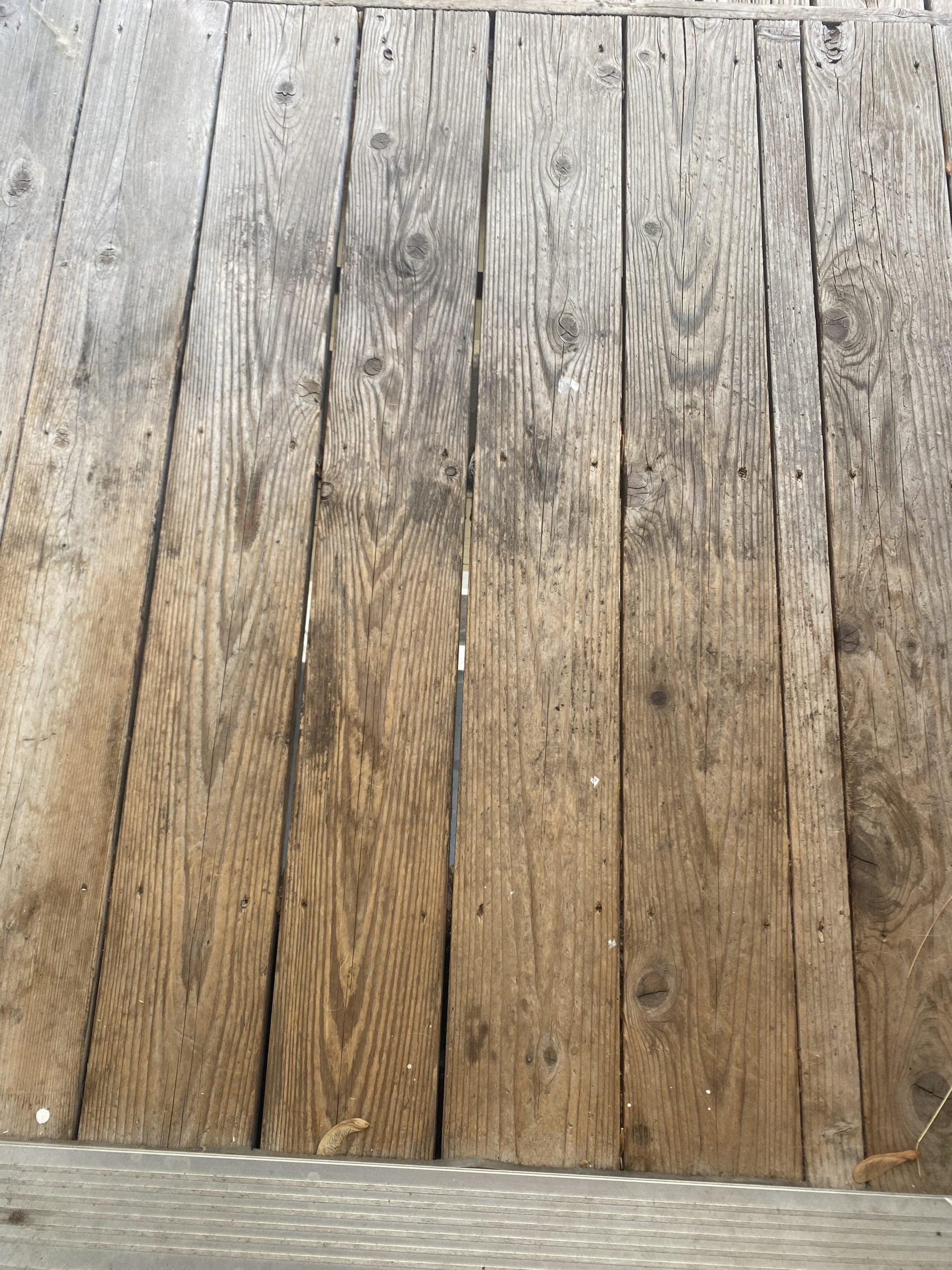

I have an older deck around a pool for a house I just bought. It appears to have an old solid stain on it that’s peeling in some small areas. I plan on using RAD solid stain but I will have to replace a couple boards that are rotting. Firstly, do I need to wait a couple months to restore the deck to allow the few boards to weather after replacing them. Also, when I do restore the deck I know I need to get rid of any peeling areas but what else do I need to apply prior to application of the solid stain. From what I can tell I need to use cleaner and stripper but in what order and do I need to sand at any point if I’m just adding a layer of solid stain. And if I do need to sand how much am I looking to remove.
Thanks for your help.
  1. New Wood or Older Wood? old
  2. Does the Deck have a Current Coating? yes
  3. Are you Switching Brands of Deck Stain or Applying a Maintenance Coat of the same Brand and Color? assume switching to RAD solid stain
  4. Deck Stain Brand Previously Used? Enter “unknown” if you do not know. unknown
  5. What is the Current Deck Stain Type? Oil-based or Water-Based? Clear, Transparent, Semi-Transparent, Semi-Solid, or Solid Stain? appears to be be solid stain
  6. Mold or Mildew Issues? small area with mildew that can be pressure washed
  7. Reason for Previous Stain Failure? old
  8. You Must Include Picture(s) of the Current Condition.

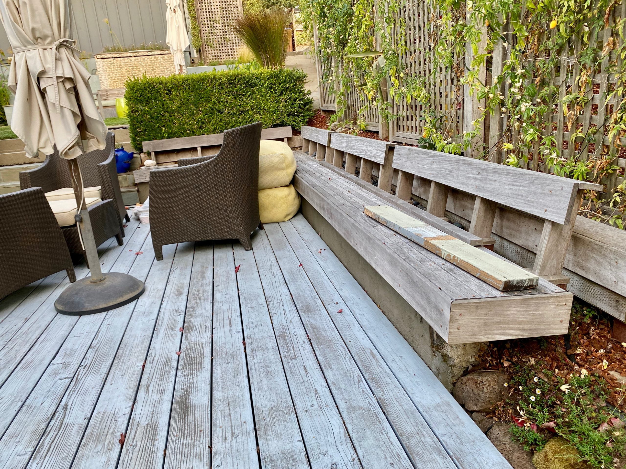

My deck is old and was last coated with a basic Thompsons sealer about 2 years ago. It gets a lot of hot afternoon sun and appears all dried out with some black streaks. Is it necessary to strip or can I just use the Restore-A-Deck wash and then stain?

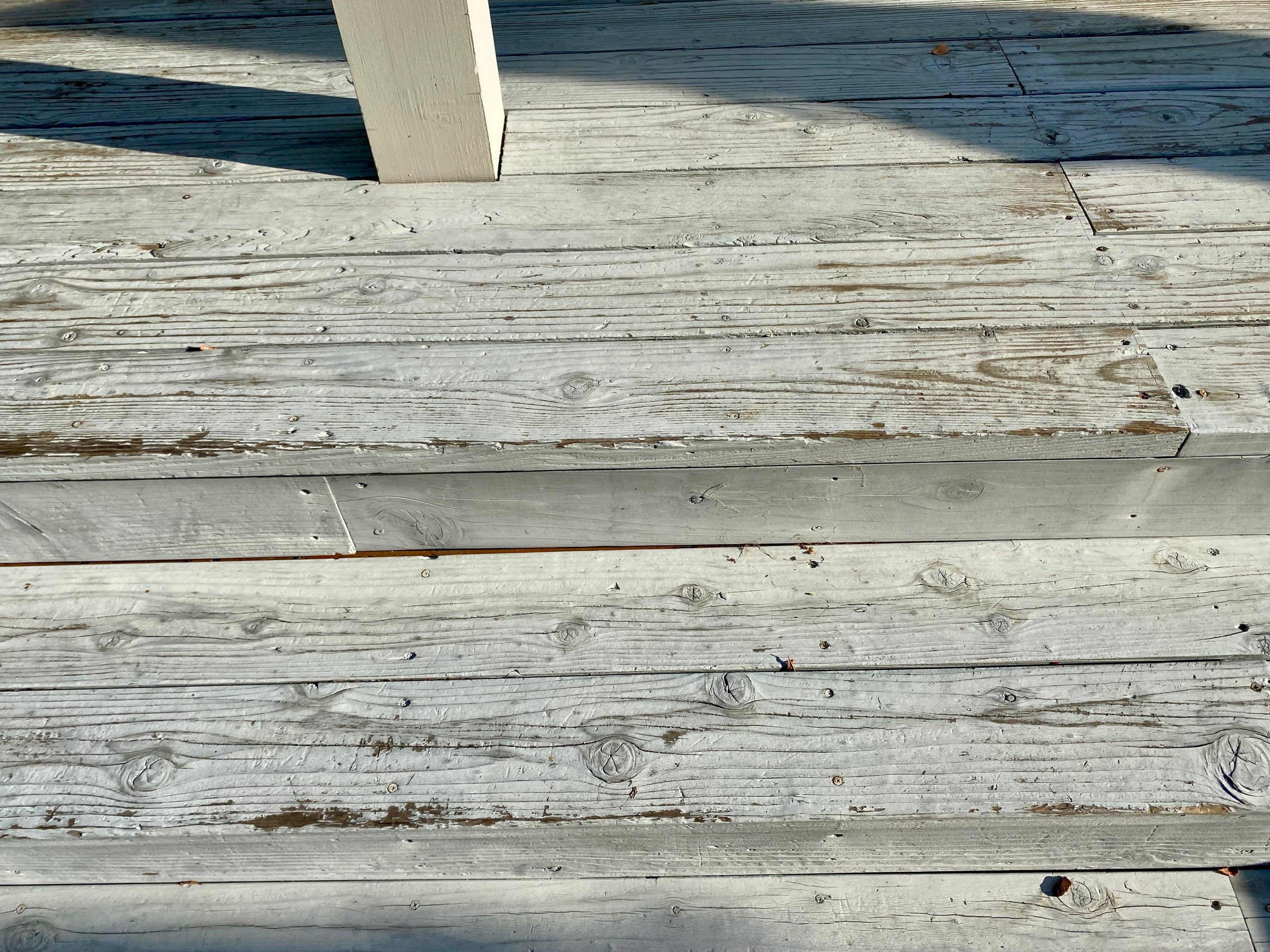

My deck is old, I pressure washed it but left it unstainef fir 1 year. A professional Restorstion outfit. Changed some wood planks and applied a water based stain both old and new wood without prepping it. Sherri brilliant us the water based stain. It was done on a Friday. I guess it’s cured, it’s been 30 or so more hours since. I hope the stain sticks . I could have five the staining myself if I would have known that tg were is no sanding or prep application of the deck

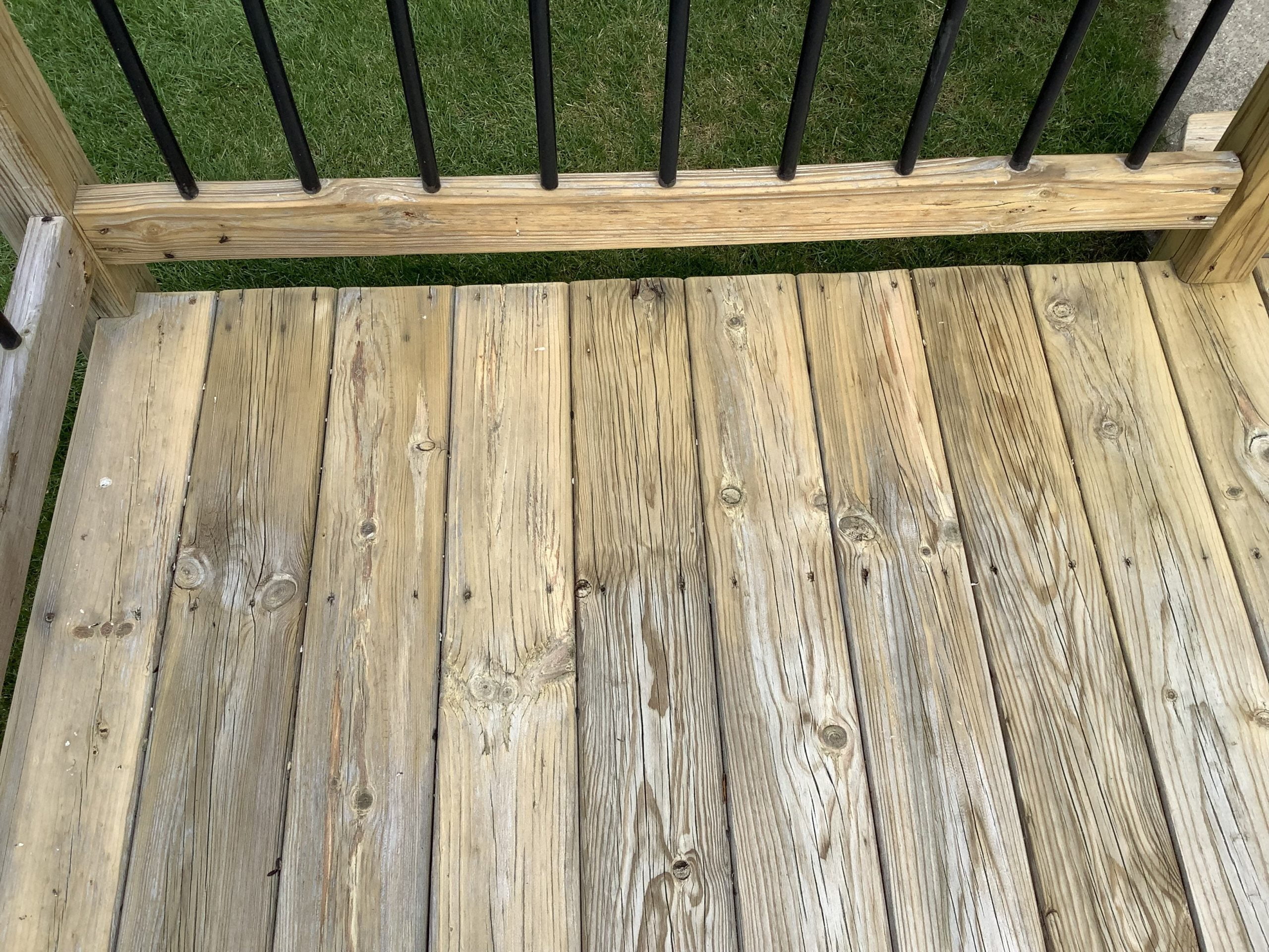

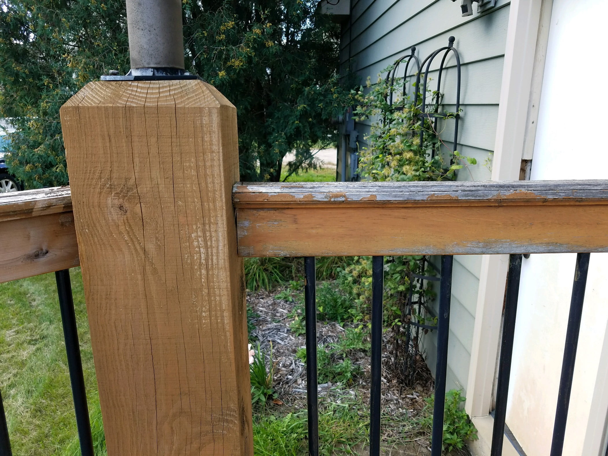

  1. New Wood or Older Wood? 4 years old
  2. Does the Deck have a Current Coating? AC2 CedarTone from Menards, factory applied
  3. Are you Switching Brands of Deck Stain or Applying a Maintenance Coat of the same Brand and Color? never been stained
  4. Deck Stain Brand Previously Used? N\A
  5. What is the Current Deck Stain Type? Factory applied CedarTone, see attached PDF
  6. Mold or Mildew Issues? some mildew (green patches)
  7. Reason for Previous Stain Failure? age?
Looking to apply new stain to deck, has been in place for 4 years and I think it could use attention to keep it looking nice. Thanks.
Anton
Anton
Awesome, Thanks for the info, much appreciated.

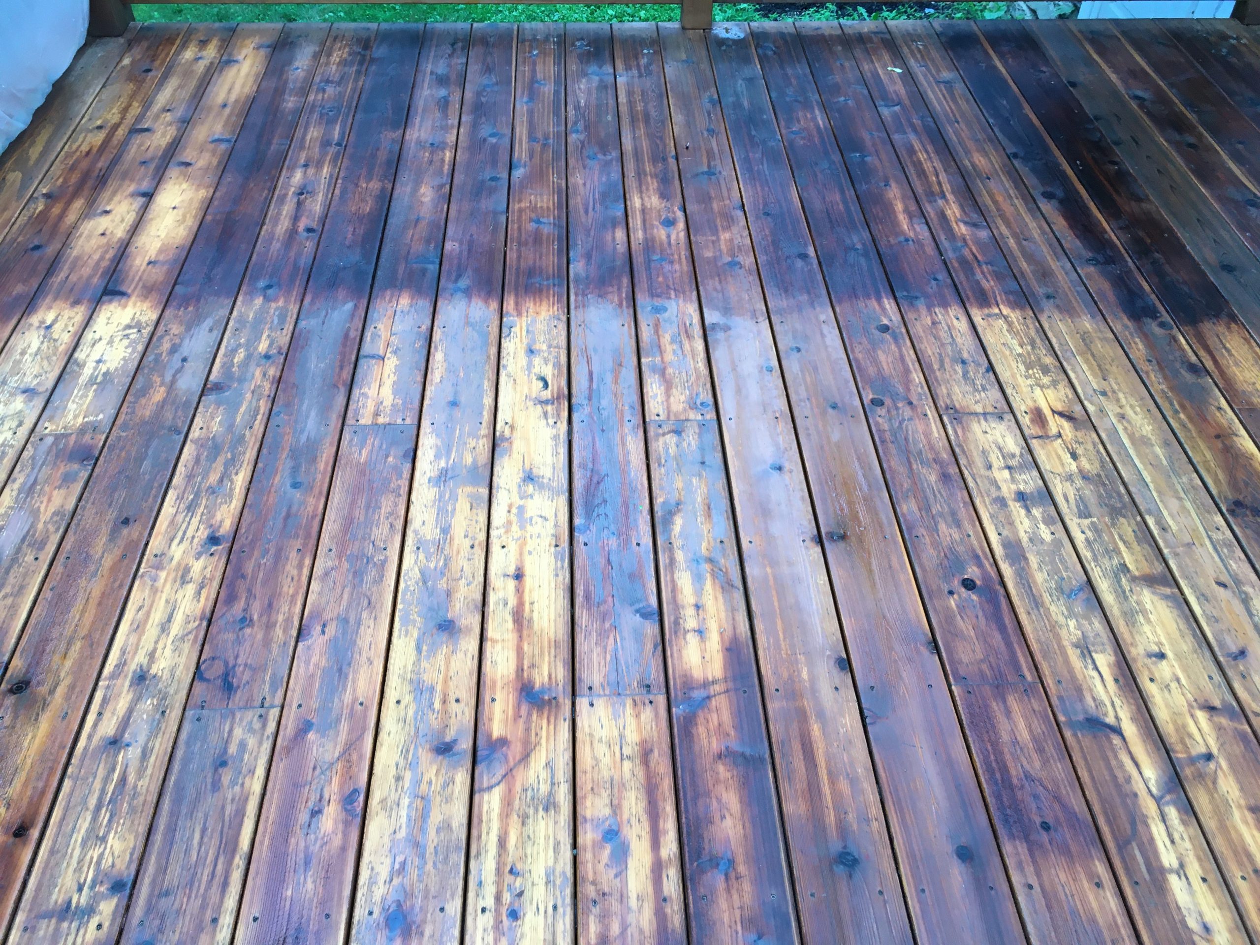

  1. New Wood or Older Wood? Older wood, 8+ year Southern Yellow Pine. Knots and sap in the “premium” grade are fairly common.
  2. Does the Deck have a Current Coating? No, the following has been done:
  3. Heavy power wash to strip old stain, mold, & mildew.
  4. Deck surface drum sanded with 40 grit followed by 60 grit.
  5. Deck surface edges vibration hand sanded with 50/60 grit where drum sander didn’t reach (~6″ out from and under rail bottoms.
  6. Rails, posts, skirt, & steps random orbital hand sanded with 60 grit.
  7. Vacuumed after sanding sessions.
  8. Are you Switching Brands of Deck Stain or Applying a Maintenance Coat of the same Brand and Color? Changing the color slightly and possibly the brand.
  9. Deck Stain Brand Previously Used? Cabot.
  10. What is the Current Deck Stain Type? Oil-based or Water-Based? Clear, Transparent, Semi-Transparent, Semi-Solid, or Solid Stain? 3 in 1 Semi-Transparent Oil neutral base tinted.
  11. Mold or Mildew Issues? Yes
  12. Reason for Previous Stain Failure? Lack of maintenance coating.
  13. You Must Include Picture(s) of the Current Condition.
The drum sanding was done in July and then due to rain patterns the remaining hand sanding has been done over the last 2 months. Hence the silvering from sun aging butting up to the fresher sanded edges at the rails. I also have 2 patch boards in the deck that came from unused original deck material which are yellow compared to the rest.
At this point will the RAD Cleaner and Brightener kill off any remaining mildew and even out the sun silvering and patch boards?

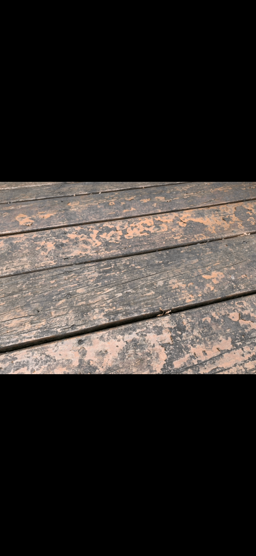

Here are my answers to the 8 questions:
1. Older wood (deck built in 2006)
2. Current coating: Cabot deck stain (two coats)
3. I am switching color and probably switching brand.
4. Deck Stain Brand: Cabot
5. Deck Stain Type: Oil-based, Semi-Solid (but the two coats made it look Solid)
6. No Mold or Mildew Issues
7. Previous Stain Failure: We put it on too thick and it was the wrong color!
8. See attached photos.

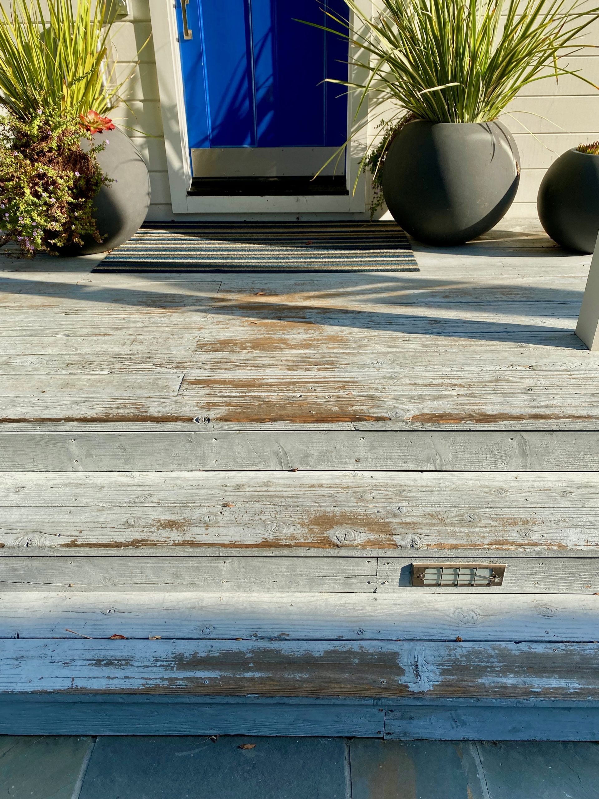

In this final photo, you can see how I tried to use a palm sander to sand off the old stain from the plank along the wall on the left.
TommyLu
TommyLu
Reply to  TommyLu
Here come the photos:
TommyLu
TommyLu
Thank you. What kind of sander do you recommend? My palm sander is not sufficient. In my research on this, I have come across a lot of people using a stand-up orbital floor sander…?

I have a 9 year old cedar deck that has been stained a few times with TWP. Half the deck is covered and remains in fairly good condition, and the other half that is exposed and resists the stain and is rather worn. Should I sand the entire deck and restain with TWP or do you recommend something else. Live in midwest and deck receives afternoon sunlight and harsh winters. Will use the same TWP as previously used.

Hi! I’d like to change to a two-tone stain for my older deck. The previous stain was a water-based semi-trans reddish cedar that is stubbornly clinging on to verticals despite two applications of Thompson’s Heavy Duty Deck Cleaner and pressure washing. Am i ok to use a solid white stain over the verticals as is? And a dark walnut oil based semi-trans on the floor boards? Thanks! Love your videos!
New Wood or Older Wood? Older 15+ Years (except top railing which is 2 years old)
Does the Deck have a Current Coating? Very little stain left on deck boards. Some areas more than others where furniture has sat and protected. Railings seem to have decent amount of stain left. Top railings have not been stained.
Are you Switching Brands of Deck Stain or Applying a Maintenance Coat of the same Brand and Color? I do not know what was last used.
Deck Stain Brand Previously Used? Enter “unknown” if you do not know. Unknown

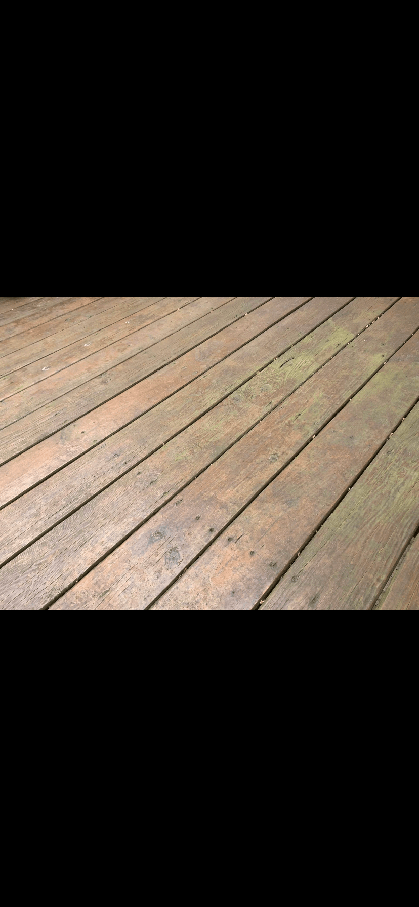

Good Morning,
There is white residue after applying deck cleaner solution and power washing yesterday afternoon. Is this oxidation due to the bleach content in the cleaner, and is it a significant concern, or is it ok to proceed to stain at this point once the deck dries completely? Thinking TWP 1500.
If it matters, deck is a few years old PT pine and has not been previously stained.
S.G
S.G
Thanks for the quick response! How necessary is it to re-clean at this point, I don’t have access to the pressure washer anymore. Would it be really bad if I were to just stain it at the point (I understand it might not be perfect)? I have attached done before and after pictures just for reference.
S.G
S.G
Picture after cleaning again (taken about an hour after re-cleaning) would it be really bad to go ahead and stain at this point once the deck dries out?
S.G
S.G
Sorry could not attach the correct picture after re-cleaning to previous message…it is attached to this message, so I will just repeat the question here for clarity: would it be really bad to go ahead and stain at this point once the deck dries out?

It rained today for the first time after I had done my prep for staining. Pictures attached show cleaned deck after and before rain, and deck (dry) before cleaning.
This raises several questions:
1. Why all the black spots when wet? Could these be a result of tannins (leached into the wood from unswept leaves left on the deck) rising to the surface from the rain, that were not noticeable prior to cleaning? Something else?
2.. Is this the appearance I can expect after staining?
3. Do I need to do further cleaning/prep prior to staining to remedy this? Prep so far has consisted of applying a bleach based solution, then rinsing with pressure washer, applying Defy wood cleaner, then rinsing that with garden hose.
Thanks again for your guidance

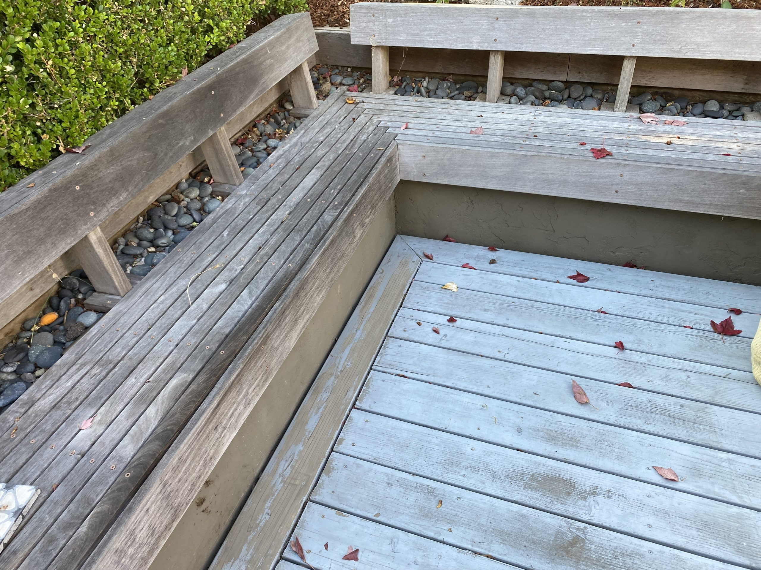

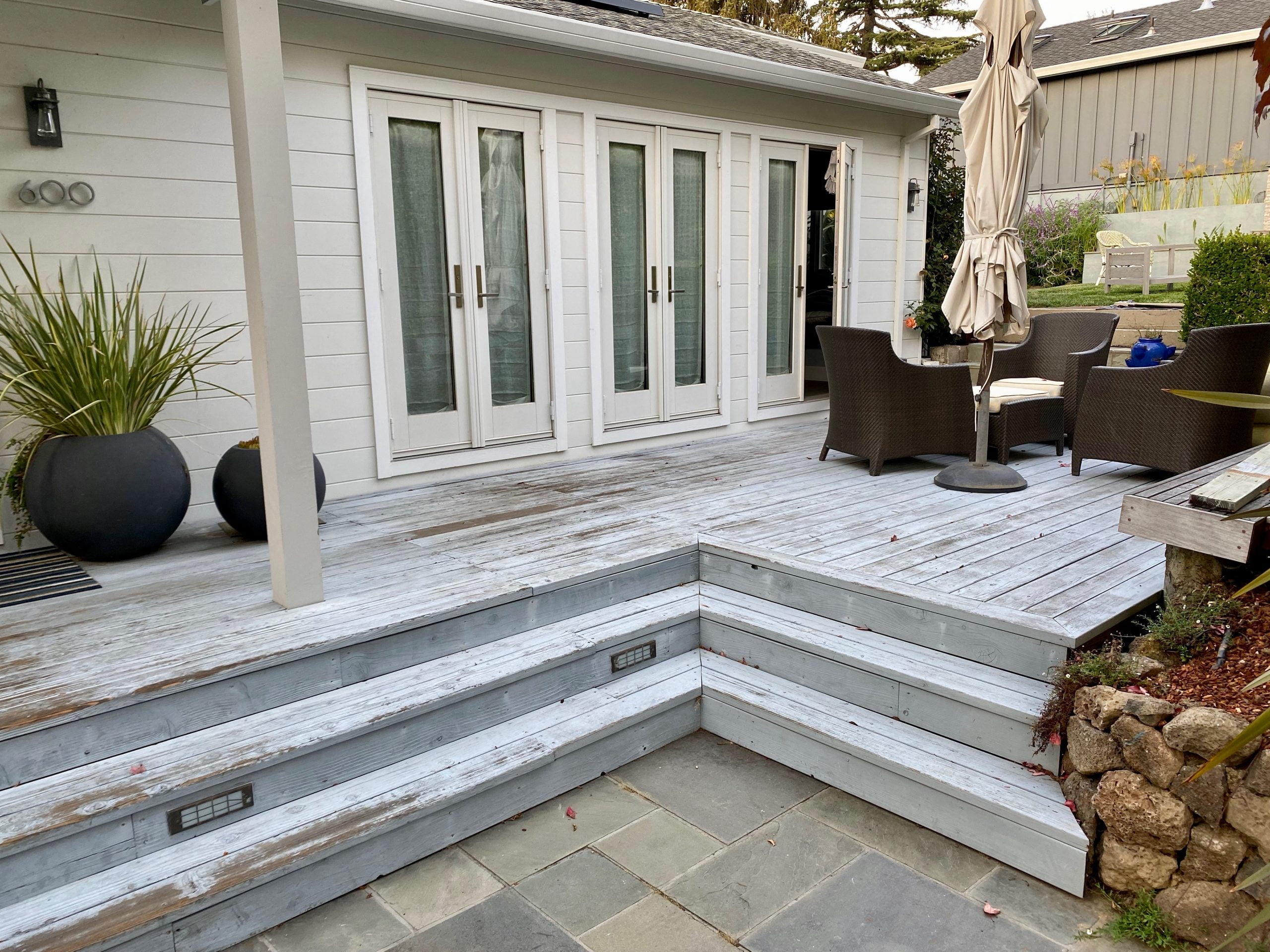

I have a 13 year old, 3 level cedar deck in need of a lot of help. FIRST PHOTO from the left.
  1. SECOND PHOTO from the left: The larger deck surface has been power washed only. No cleaners etc. We intend to replace a few boards, sand down to the bare wood with a commercial sander (which, fortunately, we’ve had experience with). Based on the leftover spots should I re-powerwash with a product. (I intend to use RAD products) and/or stripper and then sand & stain? On the horizontal surfaces that have been power washed, how should I proceed?
  2. THIRD PHOTO from the left.The uprights have some sort of paint that won’t come off with a 3400 psi power washer. How do I go about getting to the bare wood?
  3. FOURTH PHOTO from the left: You may be able to see there are multiple finishes on each surface…We are old & there is absolutely no way we can finish all this before winter sets in (Central Minnesota) & unfortunately can’t afford to pay a professional to do the work My plan is to at least get the power washed horizontal surfaces painted/stained next week & then next year do the lower level & the uprights.
  4. We really, really hope to find a product that we can clean & recoat every 2 years.
  5. This is a mess & we need clear directions on how to proceed. Thank you!

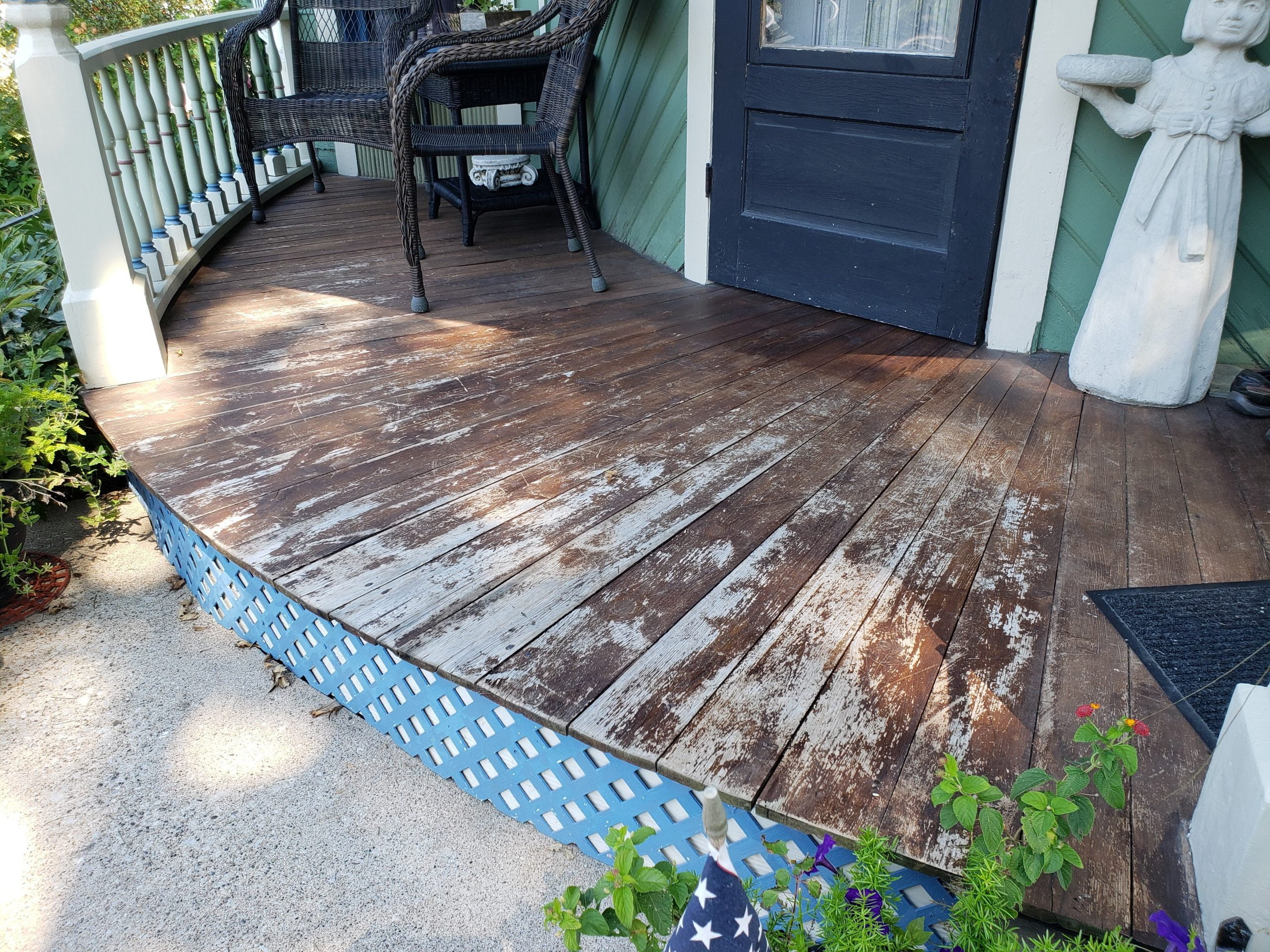

Hi, I found your after watching a Youtube review of Behr Deckover which I was considering for my deck. I live in Pittsburgh, PA and the current deck urgently needs restored. I will answer your questions below and hope to hear from you soon. Thank you
  2. Does the Deck have a Current Coating? Yes. It is peeling mut i’m not sure what kind it is.
  3. Are you Switching Brands of Deck Stain or Applying a Maintenance Coat of the same Brand and Color? I would like to switch brands & color. Something more natural and brown
  4. Deck Stain Brand Previously Used? Enter “unknown” if you do not know. Unknown
  5. What is the Current Deck Stain Type? Oil-based or Water-Based? Clear, Transparent, Semi-Transparent, Semi-Solid, or Solid Stain? I don’t know what kind it is. It is definitely a solid and may be something like Behr Deckover
  6. Mold or Mildew Issues? No
  7. Reason for Previous Stain Failure? Neglect
The current stain is peeling and some of the boards will need to be replaced. Otherwise the boards are worn but seem sound. I was going to clean, sand & powerwash everything and try and remove the current stain and change the color but am looking for some advice.

Leo Pecchia
Leo Pecchia
Live in Vancouver BC Canada -just finish building a new 400 square foot cedar deck .It’s been weather for 3 months now but with working Mon-Fri and with the weekends coming up that I won’t be able to attend staining my deck until mid October ….traditionally by mid October and November can be constant rainy days so I don’t see a chance to complete to stain the deck.Do I leave it until next spring or should I put on just a sealer to get me by until next spring.FYI I bought Restore semi transparent stain .Please advise

My deck was built with brown ptw and is a year old and has never been washed or sealed. I am adding a covered porch being built with brown ptw. How do I prep for seal and semi-transparent stain when I will have old and new wood?
Julie
Julie
How long should I wait to stain the new wood. Doesn’t it have to weather first?

My deck is 3-4 years old, installed by the builder. The pained the deck with Sherwin Williams SuperDeck solid deck stain. I HATE the solid stain!! I am trying to figure out the best option, that isn’t replacing the whole (which has been a thought) The paint peels, mildews and always looks dirty.
Lindsay
Lindsay
If I can’t remove it all, should I sand down and then paint again with sherwin williams or is there another option?

New Wood or Older Wood? 15yrs+
Does the deck have a current coating? Yes
Are you switching brands of deck stain or applying a maintenance coat of the same brand and color? Yes. Maintenance coat of current brand last applied in 2017.
Deck stain brand previously used? Sikkens – Cetol DEK Finish, Natural color
What is the current deck stain type? I think it is oil-based, had to use mineral spirits for clean up. Transparent, satin finish.
Mold or mildew issues? Deck is in HEAVY shade. It has some mildew and algae.
Reason for previous stain failure? The last coat of stain is peeling. It did not get rained on during last application, but there was a heavy dew several hours (5+hrs) after application. Not sure why it peels. I had been very happy with Sikkens until last couple of applications (had been using it for almost 30yrs, guests commented that my deck looked like furniture) – heard they changed their formula since the initial application 13+yrs ago.

  1. New Wood or Older Wood? Older Wood
  2. Does the Deck have a Current Coating? YES
  3. Are you Switching Brands of Deck Stain or Applying a Maintenance Coat of the same Brand and Color? YES
  5. What is the Current Deck Stain Type? Oil-based or Water-Based? Clear, Transparent, Semi-Transparent, Semi-Solid, or Solid Stain? I am not sure – Just bought the house – Looks like a semi solid
  6. Mold or Mildew Issues? Mildew

I have a 4 year old deck that gets full sun in Minnesota. Just completed sanding off Behr stain that peeled and looked terrible after six months. Given our weather changes and the full sun, what would be your recommendation for a new stain to use? Also, do I need to use a deck stripper or brightener before staining? Thanks.
Andy
Andy
Here’s some photos. Just started raining here.

I have 2 sets of photos. One we painted with a tinted sealant. It is pealing and cracking. The seond set has had nothing done to it. It’s just weathered by the sun and rain. Looking for something for both surfaces that will withstand the 100+ degree temperatures in the summer. No shade or building to cover any of this. It’s completely out in the sun. Thank you.
Andres de la Garza
Andres de la Garza
I have 2 sets of photos. One is just weathered from the sun and rain. The second set we painted with a tinted sealant but it is already pealing. I want something that will maintain the health and longevity of the wood. It needs to be able to stand the heat of 100+ summers.

Just bought an older home with a cedar deck that is in rough condition. We want to replace a few of the boards but are hoping the majority of it can be restored. I’m not sure if it was ever stained. Someone told me pressure washing may be too harsh & do damage to this old deck. What cleanser would you recommend? Does it need to be stripped? Do rough surfaces need to be filled in with wood filler? Does it need to be sanded? What products would you recommend for cleaning, brightening? staining? sealing? There is one place, under an overhang, where it looks as if it had been stained at some point. Does the whole deck need stripping or just that one small area??
KFS
KFS
Reply to  KFS
Most of our deck looks as if it has never been stained except for a 2’x2′ space under an overhang. Does the entire deck need to be stripped, brightened & the stained with a semi transparent or solid stain? I would love it if we could see the wood grain when finished.

We purchased our 15 year old home 2 years ago and are just now getting to the deck. I was told that there was some kind of tinted spray applied to the deck a few years back, but aside from the mildew, the wood looks pretty bare to my amateur eye. I already powerwashed it (water only) and am wondering how long this wood will last and whether it would be worth investing in semi-trans stain or going with the free solid stain we were given. From the reviews I’ve seen, semi-trans is the best long-term option, but I’d also like an expert’s opinion on whether we’d be needing to replace some of these boards soon anyway? I didn’t want to go much harder on the power washing for fear of tearing of wood. Any help wood be appreciated.
