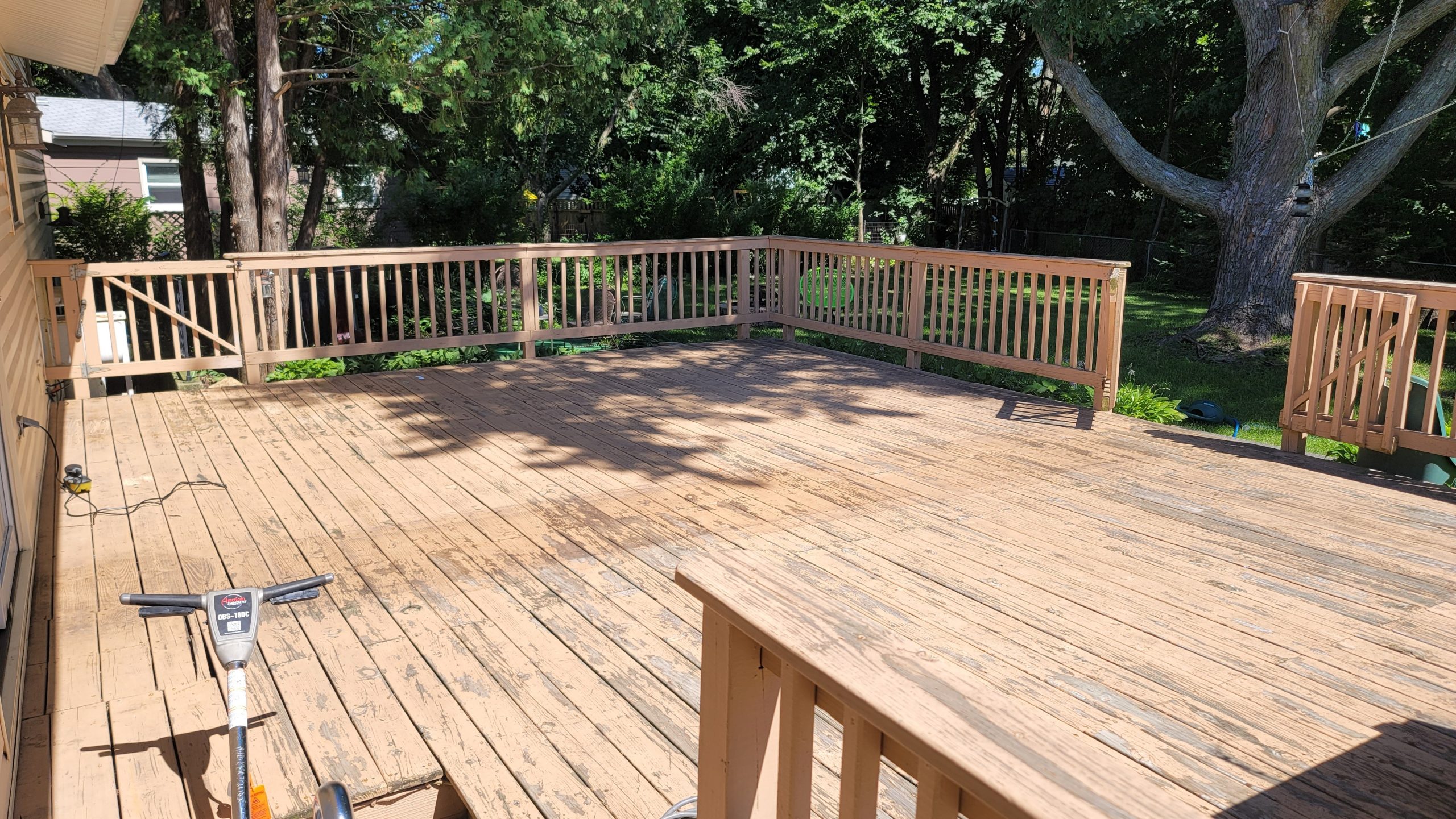

Jean
Jean
Hi Scott
Here are answers to the questions.
1. Old wood
2.Yes for current coating
3.Same brand -different color
4.Sherwin Williams
5.Waterborne Semi Solid
6.No mold/mildew
7. Not sure. Nothing done for over 4 years. Maybe not done properly the first time. The elements have taken its toll.
Stain is peeling. Not sure what steps to take.

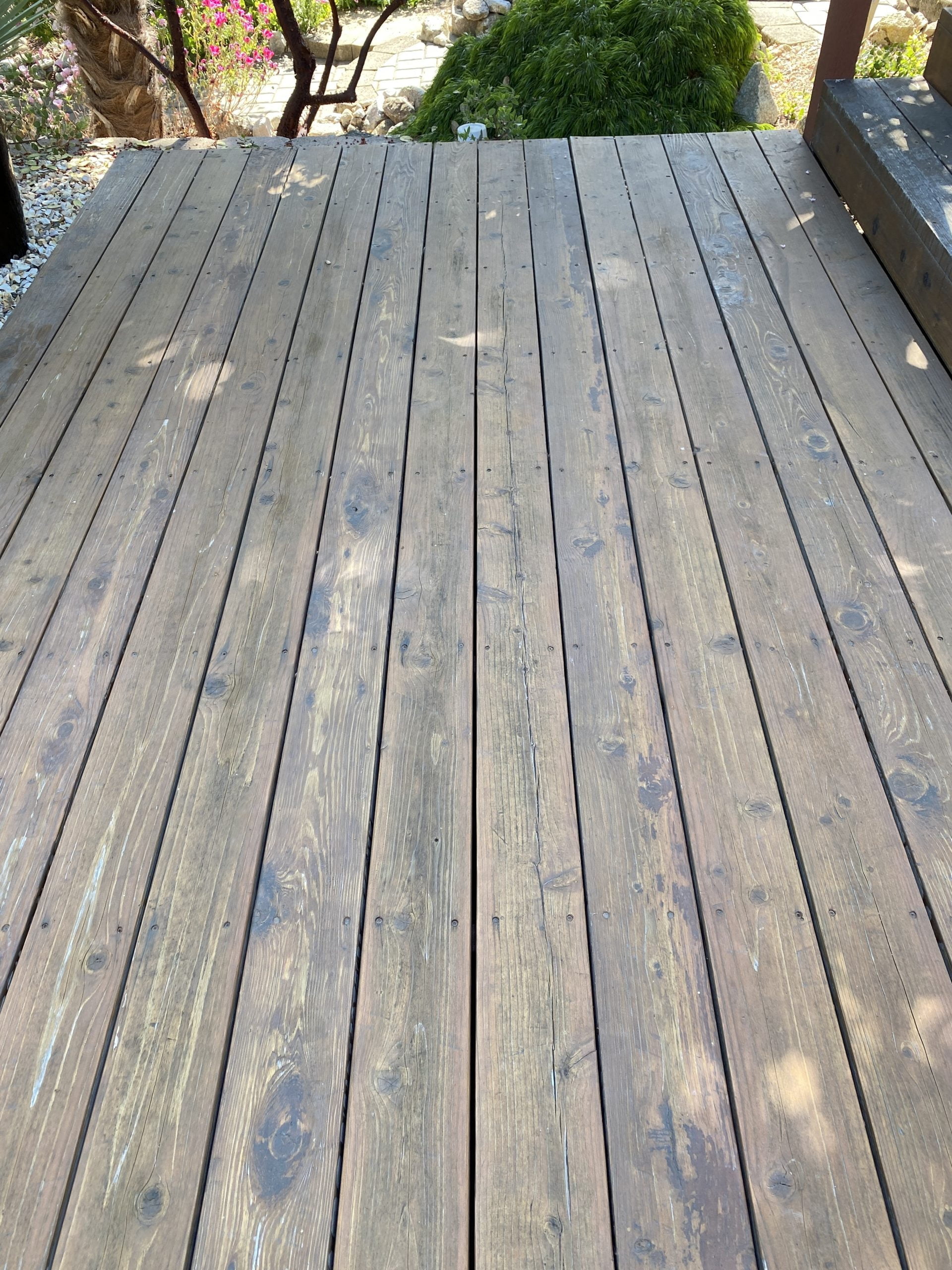

Hey Scott – awesome how involved you are on this site… We have Ipe railings and a bar top on our deck, and after several years of cleaning/applying Ipe Oil, we’re looking to switch brands. (I know it has to be maintained once a year or more, but I’m having to redo the railings 3-4 times a year). From your articles, it seems like Armstrong Clark is the way to go but wanted to get your take on it. Here are the answers to your questions:
New Wood or Older Wood?
Ipe railings + bar top are 5 years old
Does the Deck have a Current Coating?
Ipe Oil
Are you Switching Brands of Deck Stain or Applying a Maintenance Coat of the same Brand and Color?
Looking to switch to Armstrong Clark or even RAD (our biggest problem is mildew but not sure we can switch to water based without sanding the railings down…? Can we strip them and then use water based?)
Deck Stain Brand Previously Used?
Ipe Oil
What is the Current Deck Stain Type? Oil-based or Water-Based? Clear, Transparent, Semi-Transparent, Semi-Solid, or Solid Stain?
Oil-based (I *think* Ipe Oil is semi-transparent?)
Mold or Mildew Issues?
Yes
Reason for Previous Stain Failure?
Not sure. We live in Nashville (humid) and the deck gets a decent amount of sun… quite a bit in the winter.
Would love to know if you recommend just using a cleaner/brightener and then using Armstrong Clark or if we need to strip it first, then cleaner/brightener… if should maybe try the RAD water-based for mildew control…? Thanks ahead of time for your help!
Gavin
Pics attached – I last cleaned and applied Ipe Oil about 4-5 months ago
Gavin
Gavin
Awesome, Scott. Thanks so much for the quick reply. So I saw the RAD clean + brighten kit… is there a strip + brighten? And do I need to re-strip every year when I redo or just clean + brighten from then on?
Gavin
Gavin
Perfect. Thanks again for your help, Scott!
Gavin
Gavin
Sorry, Scott, last thing… just double-checking this is the correct stain? Didn’t see one specifically marked for exotic hardwoods:
https://www.restore-a-deck.com/restore-a-deck-wood-stain/restore-a-deck-wood-stain-1-gallon/flypage.tpl.html
Gavin
Gavin
Brilliant. Thanks again!
Gavin
Gavin

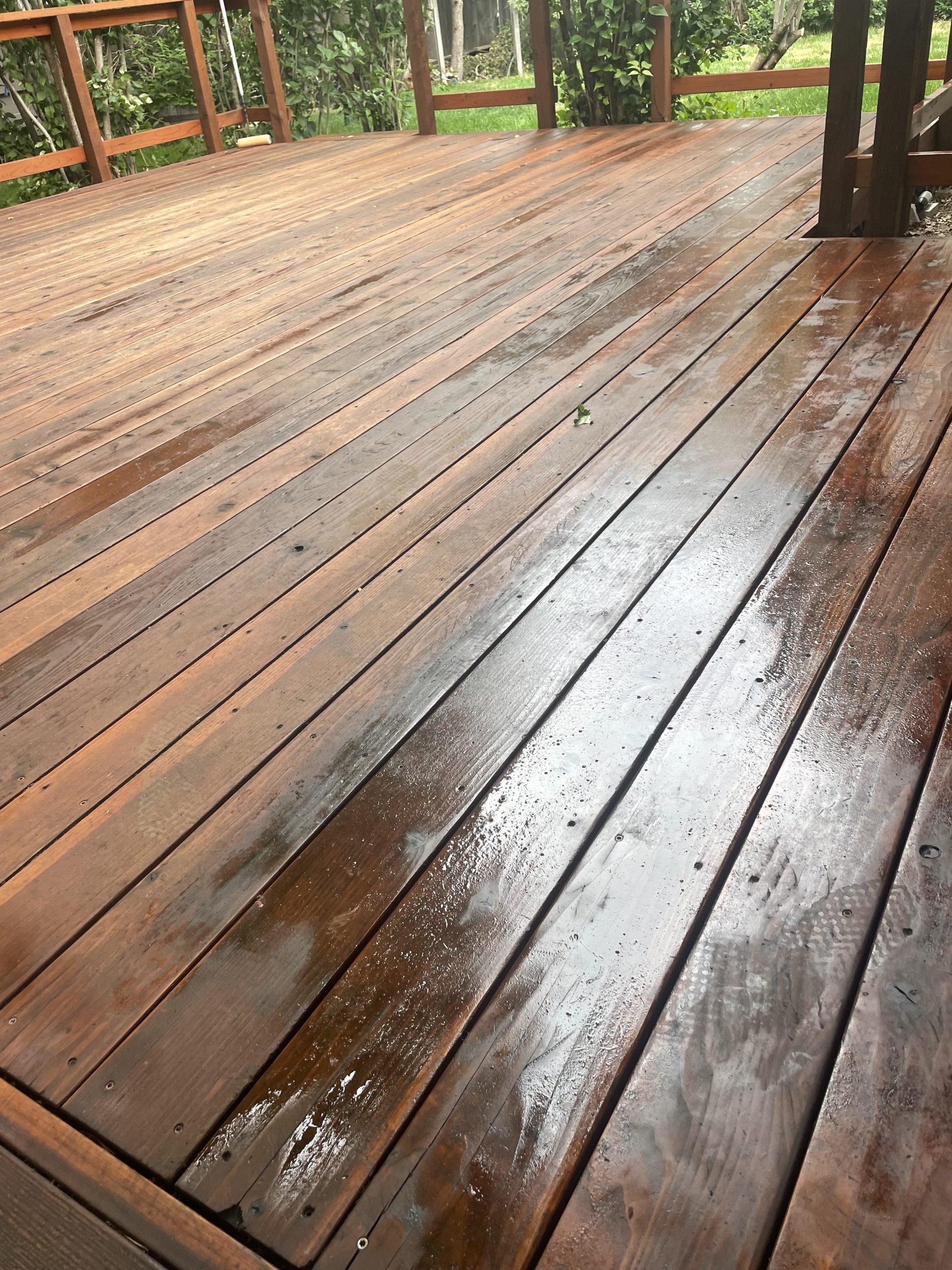

Hey Scott – got the RAD stripper/brightener kit and started stripping the wood railing. We just noticed that the stripper is also taking the black paint off our black metallic posts…! How can we strip the wood without damaging our posts/cable rail? And, the deck itself is composite… is it possible the stripper will damage that as well?
Gavin
Gavin
I think we let it sit on the spindles too long… So, at this point, to avoid that happening any more, we’re sanding all the railings down. (including the one that already got treated with stripper) On that one already-treated rail, once we sand it, do we still need to do brightener before staining? What about the remaining rails that are just getting sanded? Brightener necessary or just go straight from sanding to staining?
Gavin
Gavin
Cool, thanks. Can the brightener have any adverse affects like the stripper? (i.e. – causing discoloration or paint issues with the posts/composite decking)
Gavin
Gavin
Sounds good. Thanks, Scott…

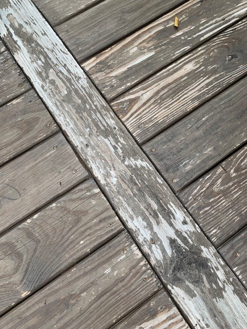

P. Hettich
P. Hettich
Hello Scott. Here are my answers to your questions.
  1. Wolmanized wood deck is about 35 years old and restained several times. Not sure which type of wood used, but is not cedar or oak.
  2. About 2/3 of defective Behr Deckover has been scraped and/or sanded (coarse then medium) since attached photo taken. The posts and cross rails still adhere well.
  3. I must maintain color (light green) to match house trim but very willing to change stain brands. Your best rated brands seem to offer limited colors w/o option to match.
  4. defective Behr Deckover used twice.
  5. Deckover was water based but willing to use either oil or water.
  6. No mold or mildew was decteced
  7. Stain failure: class action suit against Behr Deckover. Should I now use a cleaner, or would a power wash be sufficient?
  8. Have attempted to attach photo.
Thank you in advance for your advice. P Hettich
P. Hettich
P. Hettich
Scott,
Thank you for your prompt reply.
Since that photo was taken, I have spent many, many, many hours sanding and scraping but some of the old stain still remains (about 1/4 of total) in crevices, nail holes, and low areas. I am aware that staining would reveal a contrast between the rougher wood surfaces and the smooth remaining Deckover, but I cannot spend any more time on this project. What are my options? Thank you. PH

Angela
Angela
New Wood or Older Wood? New pressure treated pine- about 2 years old
Does the Deck have a Current Coating? Husband and I applied Cabot Australian Timber Oil in Natural 2 days ago on Saturday.
Are you Switching Brands of Deck Stain or Applying a Maintenance Coat of the same Brand and Color? First application- will use Armstrong Clark next time.
Deck Stain Brand Previously used? Cabot Australian Timber Oil
What is the Current Deck Stain Type? Oil-based- semi-transparent
Mold or Mildew Issues? No.
Reason for Previous Stain Failure? Several wet, shiny and sticky areas. Mineral spirits didn’t remove all of it – should we sand or use the stripper/brightener suggested?
Angela
Angela
It says Superior 3 oil formula. Thanks!
Angela
Angela
Thanks so much for responding. Do you think I’ll need to add the additives to the Restore-A-Deck stripper?
Angela
Angela
Ok! One more question! We stopped staining when we got to our stairs. They are about 1 year old and have not been prepped so no stain was applied. Should I also order the RAD cleaner for those or just use the stripper since we will be stripping our deck? And of course brightener on both!
Angela
Angela
New wood – pressure treated pine.
Husband and I applied Cabot Australian Timber Oil in Natural on Saturday (semi-transparent.)
We have numerous areas that have wet looking/sticky areas. After reading your articles we realize our mistakes. We tried mineral spirits on a couple of spots but it didn’t help much. Should we try sanding or just use the stripper and brightener that’s been suggested and start over?

Christian Ramirez
Christian Ramirez
Hi Scott, your site has helped me a bunch already, thanks in advance.
New Wood or Older Wood? Older Wood
Does the Deck have a Current Coating? Yes
Are you Switching Brands of Deck Stain or Applying a Maintenance Coat of the same Brand and Color? Switching brands
Deck Stain Brand Previously Used? Enter “unknown” if you do not know. I believe previous owner used ACE hardware Wood Royal Semi-Transparent Latex.
What is the Current Deck Stain Type? Oil-based or Water-Based? Clear, Transparent, Semi-Transparent, Semi-Solid, or Solid Stain? Semi-Transparent Acrylic Latex
Mold or Mildew Issues? Not really, few small spots (see pictures)
Reason for Previous Stain Failure? Deck stain is fading / chipping & wood is cracking. Deck was installed in 2018 by the previous owner and we live in Michigan so the deck is subject to hot humid & dry freezing climate cycles.
Christian Ramirez
Christian Ramirez
Great, thank you so much for the quick response!! After completing the prep and applying a Restore A Deck semi transparent stain, how do you recommend maintaining it after? Hoping to not have to strip & sand every 2-3 years. Thanks!
Christian Ramirez
Christian Ramirez
Thanks Scott, you rock!
Darci
Darci
New Wood or Older Wood? Old wood
Are you Switching Brands of Deck Stain or Applying a Maintenance Coat of the same Brand and Color? Same brand and same color
Deck Stain Brand Previously Used? TWP
Mold or Mildew Issues? In a few spots
Reason for Previous Stain Failure? Faded
You Must Include Picture(s) of the Current Condition
Is there a way I can fill in where the wood has splintered?
Darci
Darci
Do I need to strip it or can I just clean and brighten it with RAD?

Shannon Nehrbaa
Shannon Nehrbaa
  1. New Wood or Older Wood? Older wood
  2. Does the Deck have a Current Coating? Yes, some sort of white paint
  3. Are you Switching Brands of Deck Stain or Applying a Maintenance Coat of the same Brand and Color? Right now there is chipped white paint from the previous owner. I want to strip the white paint and stain the wood.
  4. Deck Stain Brand Previously Used? Enter “unknown” if you do not know. Unknown
  5. What is the Current Deck Stain Type? Oil-based or Water-Based? Clear, Transparent, Semi-Transparent, Semi-Solid, or Solid Stain? No stain. Chipped white paint
  6. Mold or Mildew Issues? No
  7. Reason for Previous Stain Failure? N/A
  8. You Must Include Picture(s) of the Current Condition. See attached photos
Hi! My husband and I just bought our first home. Fixing our deck is at the top of our to do list. The previous owner painted it white. The paint is chipping everywhere and the white is extremely bright and blinding to your eyes when it is sunny out. Ideally, we would love to strip the paint and stain the deck a pretty natural color (open to color suggestions). We of course want to do this correctly, so we can enjoy our deck for years to come. We are looking for any and all advice! Thank you 😊
Shannon Nehrbas
Shannon Nehrbas
Thank you so much for your response. My apologies, I guess ‘strip’ was the wrong term. Regardless, we would like to completely remove the white paint so that we can stain it (we feel a nice stain will last a lot longer than paint). Do you agree? Is power sanding it off the best and only way to remove it all? We are clueless on where to even begin with this project. Thank you!
