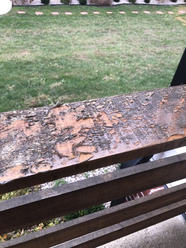

Peeling Polyurethane Deck
The Consequences of Using Polyurethane on Exterior Wood
Polyurethane is not designed for outdoor decks. While it works well for interior wood projects, it does not flex with outdoor temperature changes and will eventually crack, peel, and trap moisture underneath. Once this happens, maintaining your deck becomes a nightmare—you’ll need to remove all traces of the polyurethane before you can re-stain.

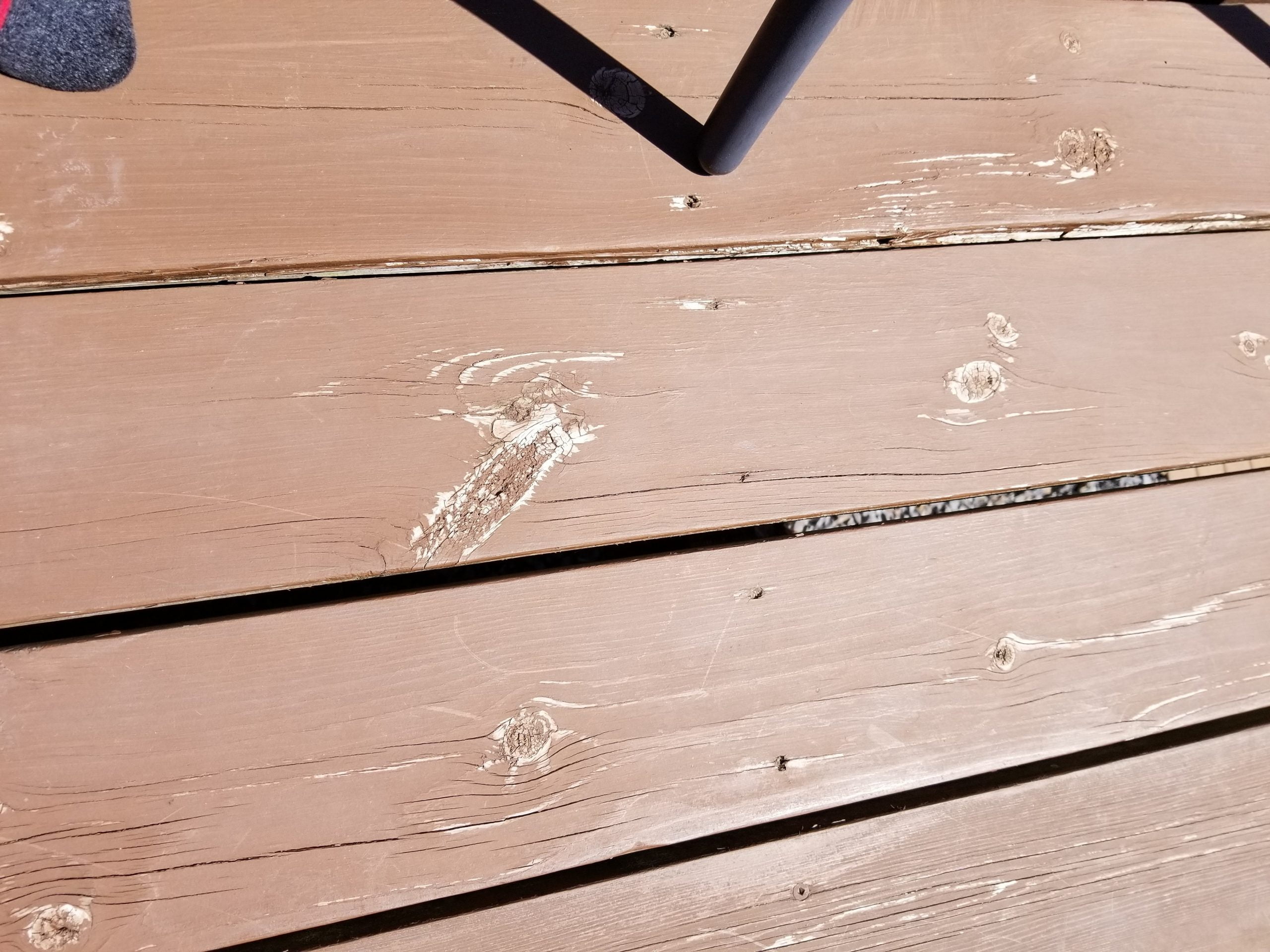

Hi I live in Ontario Canada and I have a problem with my deck.
I completely sanded the deck last year and applied a Home Hardware stain that has a plant oil base.
The stain went on well however the this spring where ever there was a knot or imperfection in the boards the stain came off.
I do not want to sand the deck again so looking for a product to cover the knots and imperfections and apply the same stain or a product that I can apply over the complete deck.
See file for picture.
Cover with a quality solid stain: https://www.deckstainhelp.com/what-are-the-best-solid-color-deck-stains/

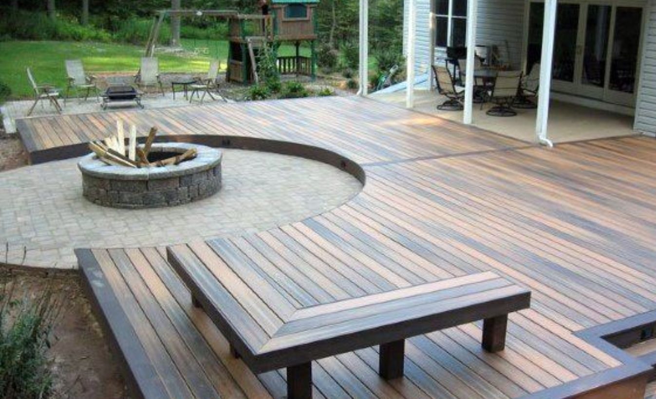

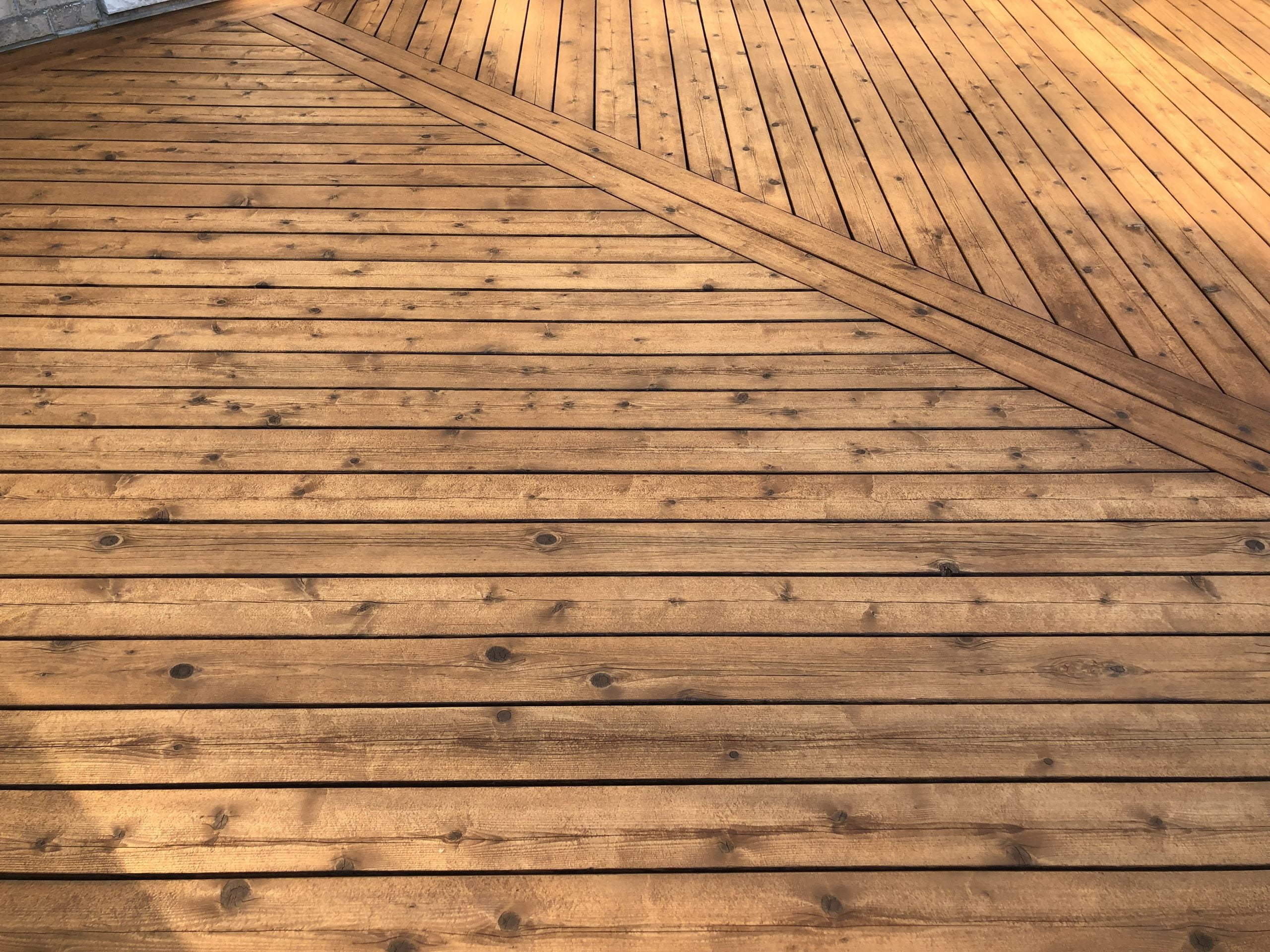

Hi. I am about to stain and seal my new deck (new treated pine wood and has never has been stained or sealed) and want to know if I can use two different colors of stain + sealer. I want to have dark highlights on the flooring. I’ll attach a pic of what I am trying to achieve. Is it possible to use two different colored stain + sealers to do this or should i use another technique or product? Basically how can i get my deck to look similiar to the pic? I have tried to look up DIY tutorials and haven’t had any luck. Thanks!
No picture.
I attached a pic.
That is IPE wood, you will not get your pine to look like this. You can use a dark color for borders and a light color for other areas though. Maybe Restore A Deck Stain in Dark Walnut and then the Natural color. Another option is TWP in Dark Oak and Honeytone. See this first about new wood: https://www.deckstainhelp.com/how-long-should-you-wait-to-stain-a-new-deck/
Thanks for the quick reply and for the info. .. So are all milticolored wood deck flooring IPE then? For example this pic attached doesnt look like IPE to me. It looksnasnif someone stained the wood to get that effect. I was originally going to do the picture frame edge I have in a darker color as suggested but was hoping I could blend in some of the darker color into the flooring as well. But I seriously do not want to make a mess of it and have to redo anything. As per my previous post, can you layer over a lighter colored semitransparent stain and seal with a darker colored one to create that kind of effect? Or will that cause peeling or other problems? Thanks again.
That is fake wood in the last picture. You cannot get a stain to look like that.
Ok thank you for your help.
