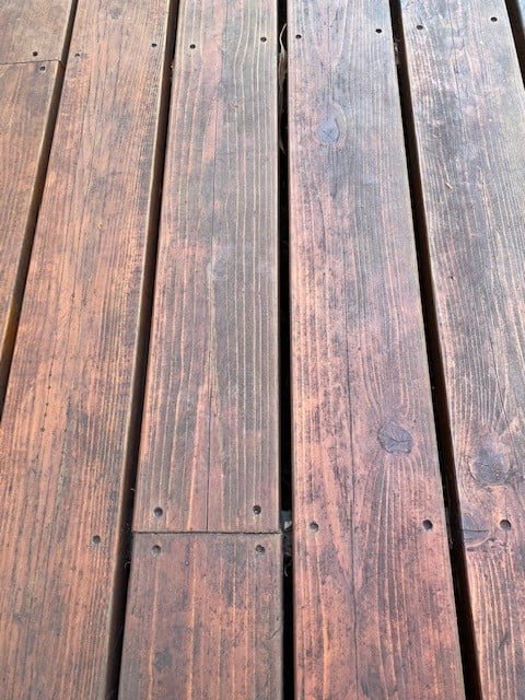

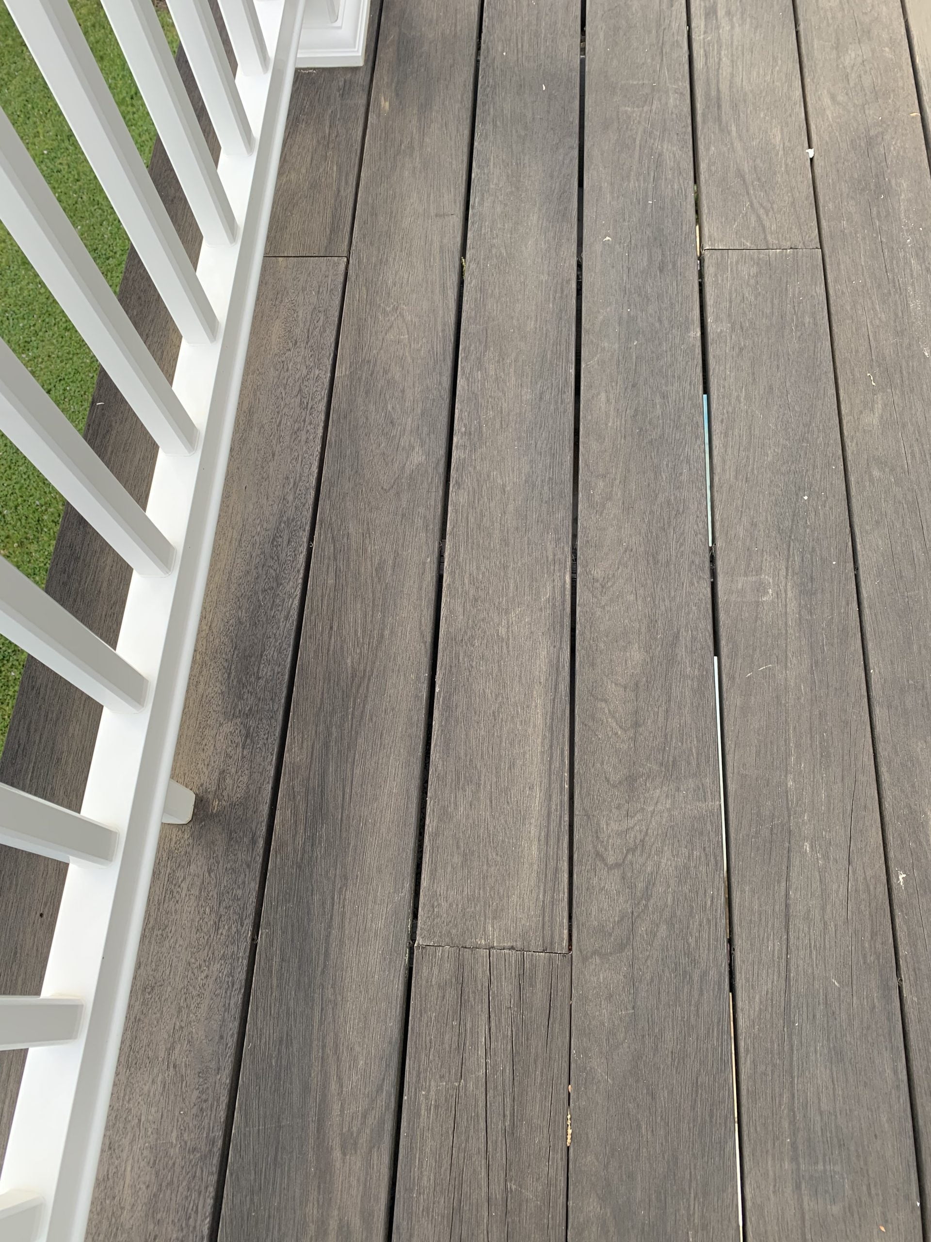

We had a new redwood deck installed 4 years ago and stained it with PPG ProLuxe SRD RE wood finish. The stain has held up well, but dirt and grime has built up on the surface. I intend to reapply the same stain this year. My question is should I strip the old stain and brighten the wood before re-staining, or can I simply clean and then reapply the stain?
The photos are typical of the condition of the deck. Thanks for taking a look.
Clean and recoat should work if using the same exact stain and colot.

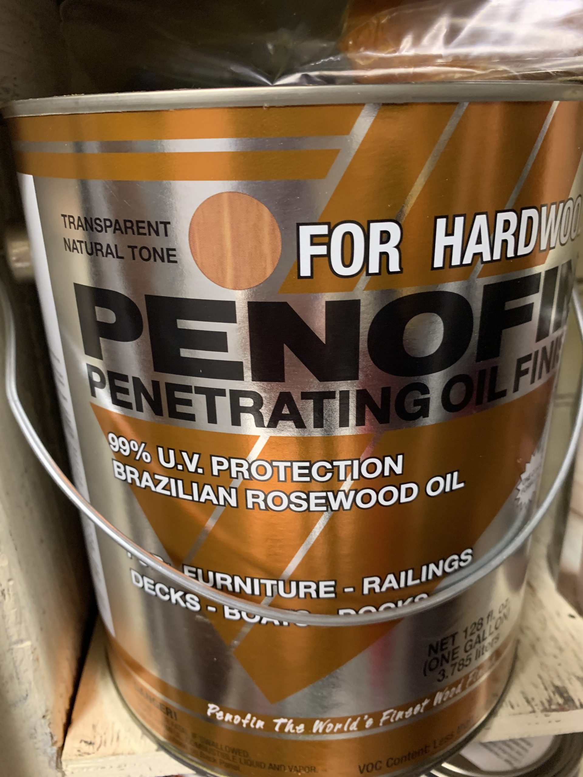

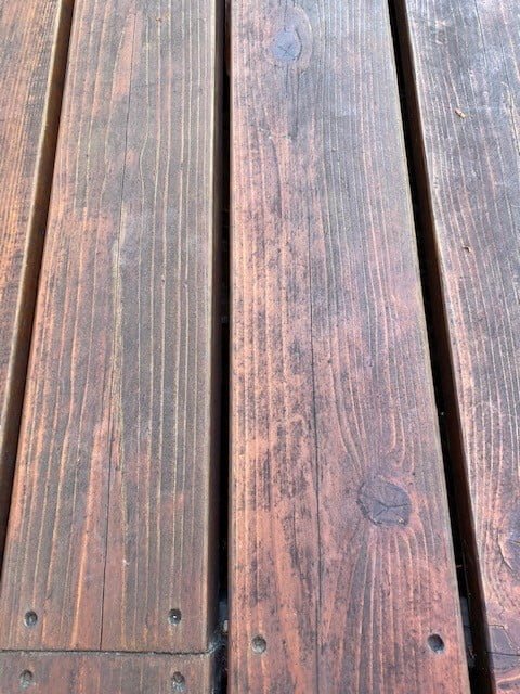

I have a mahogany deck about 7 years old. Every year I clean it with 30 second cleaner then seal with Penofin transparent oil finish. Within a month the wood has darkened each time. I live on the coast with full sun and high winds. The wood has never looked like it did when new. I would like to use the Restore a deck water cleaner and water based semi transparent. Do I have to strip this first? It has been a year since I applied the Penofin.
The issue is Penofin has known issues with turning black: https://www.deckstainhelp.com/penofin-exotic-wood-stain-review/
You do need to strip and brighten for prep. The only good thing about Penofin, is that it is easily strippable. Use the RAD Stripper/Brightener Kit for prep and then the RAD stain in Light Walnut
Thanks for the prompt answer. Why would I want to put a color stain on the deck and not keep natural?
Clear (no color) offers zero UV protection from graying. It must be tinted for UV protection. Penofin was tinted as well.

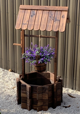

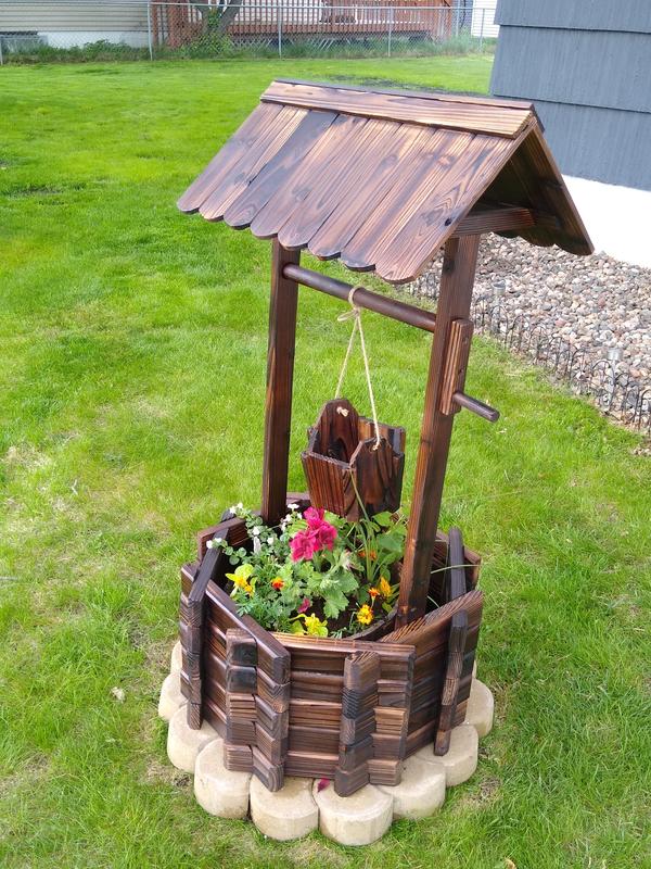

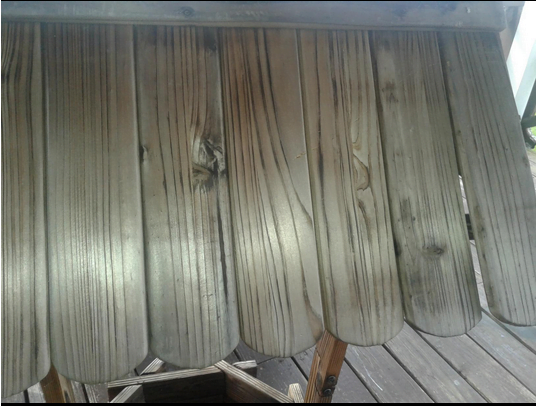

I’m a confused newbie. I’ve done hours of research for this planter (first photo) that I just purchased.
According to many reviews, if some kind of protection is not applied it will look like photo 3 within a few months. Some reviewers have advise water seal or poly with shine to give it a beautiful shine.
After reading your many responses here, my plan is all shut to hell. I had bought on the advise of L*wes worker, Valspar semi transparent Stain and water seal Sunlit copper to give it a reddish tone.
And I was planning on mixing this with Spar varnish to give the Valspar flat color stain some shine in it. Dirt rolls off better off of smooth shiny surfaces than flat coarse like feeling ones.
But you say that these products don’t mix and will peel. What can I use to achieve my goal?

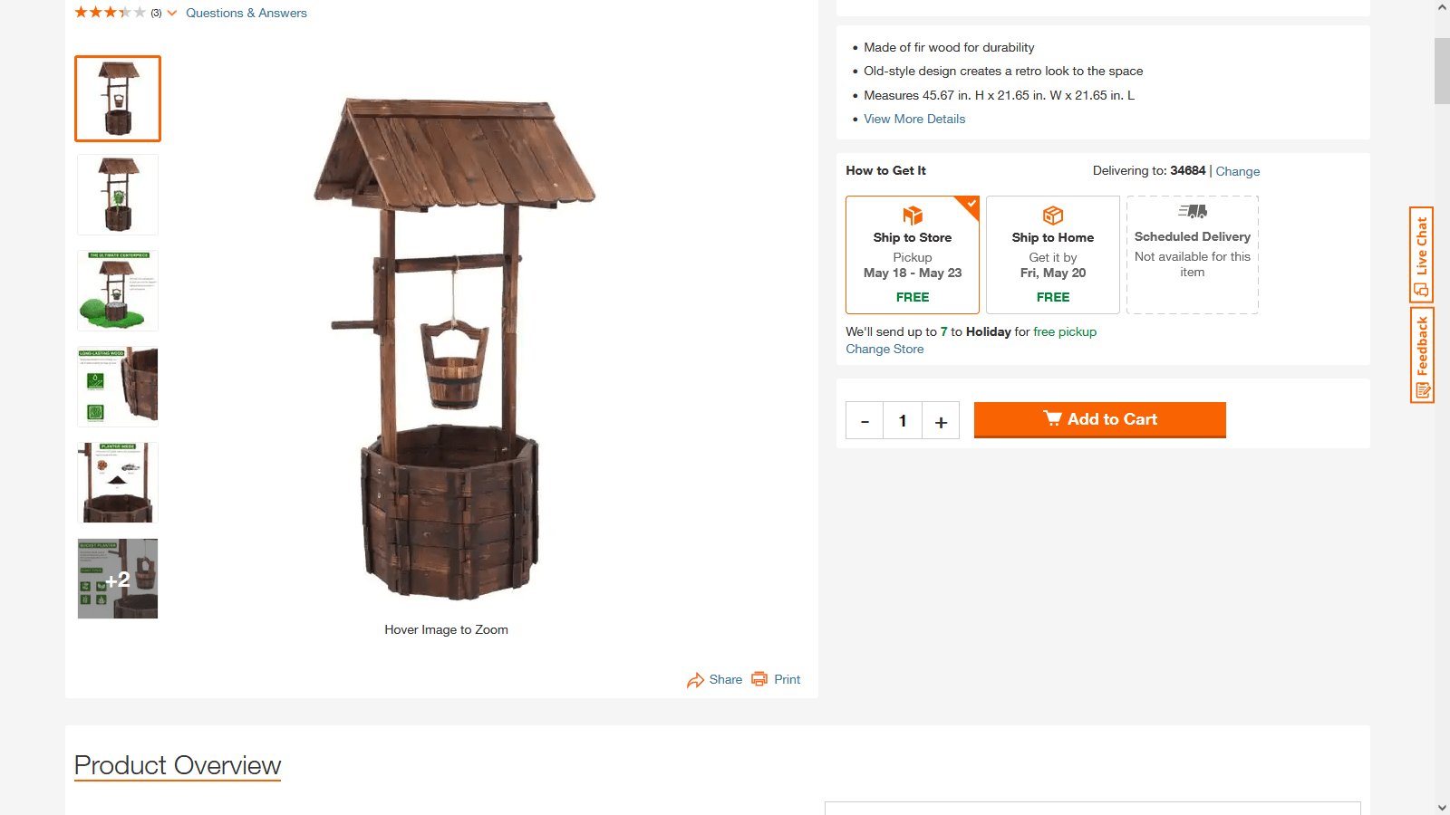

Below is the wishing well description and photos of reviewers.
Thanks in advance for your help.
The planter made of solid wood has a heavy texture, durable and firm. The surface of the board is smooth, after many times of shaping and grinding, the texture is clear, and the corrosion resistance is durable for a longer time. The surface undergoes high-temperature carbonization treatment.
Fir wood is more secure
Carbonized at high temperature
Surface protection
Rural retro style
Durable and firm
Material: fir wood
Color: carbonized color
It is already stained. Leaver as is until time to redo in 1-2 years. Use a penetrating stain when time to redo. Never apply poly to exterior wood.

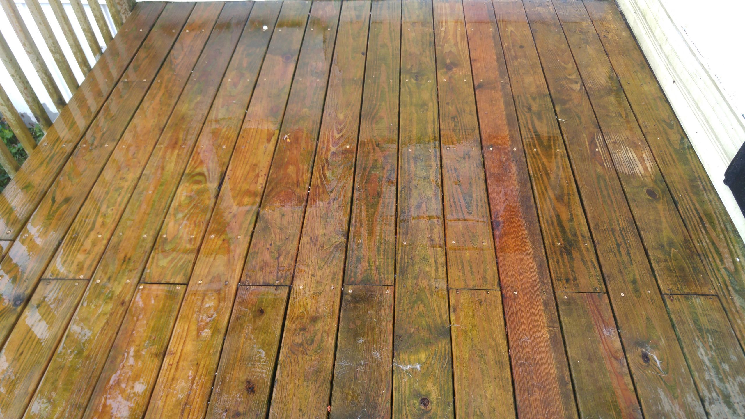

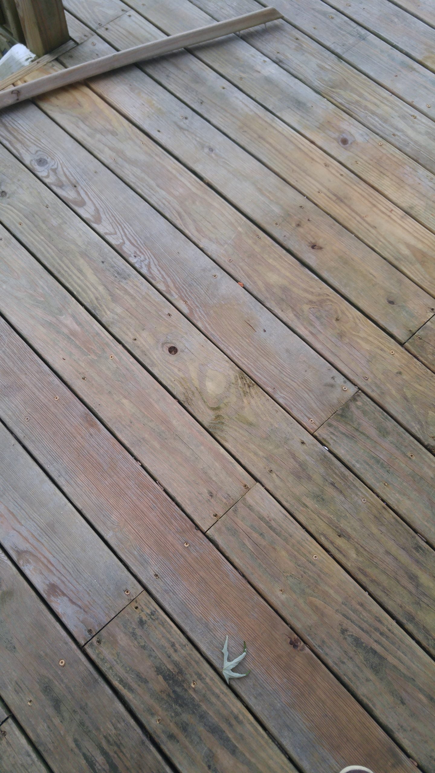

I have a new deck made of pressure treated pine deck boards. its now 5 months old and ready to seal it or waterproof it. I want to protect it but I want a natural look, no color. Even like the graying as it gets weathered. what product do you suggest we use?
Defy Extreme Clear or TWP 1500 Series in clear. Both have no color but will protect while graying naturally.

I power washed my deck and most of the stain came off I want to know if I can seal it or re stain it
Post some pictures of your prep.
My small deck is 3 years old, never had anything put on it. After powerwashing it, I really like the colors that popped out. Blendings of gold, red, and green. They faded as it dried. Anything I can put on it to bring out those colors and then a recommendation for a sealer to protect it?
Use Restore A Deck Stain in Natural or Armstrong Clark in Amber color. Never apply a sealer over a deck stain.
