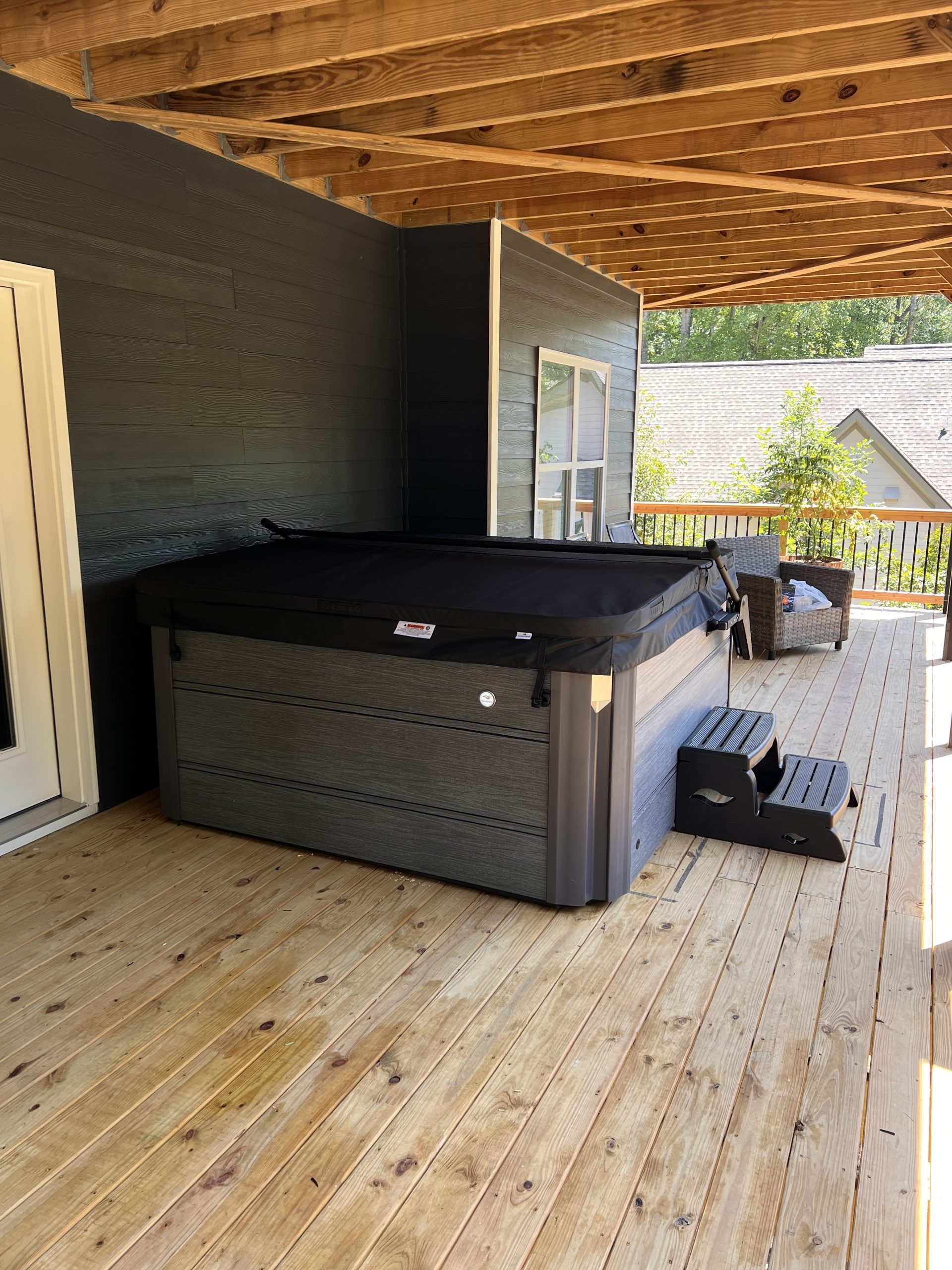

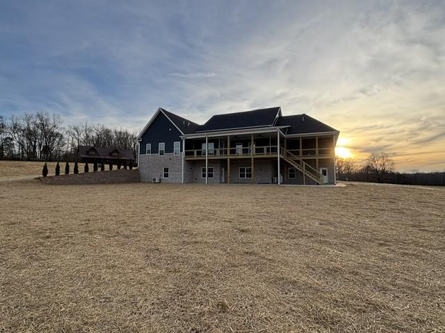

Hello, I have a new deck on the second story of my house (walk out basement underneath). The deck boards are trex but the posts, rails, and joists are wood. How do I treat the wood to keep wood bees from boring into it (including the joists)? Are there any products/methods you would recommend for just the rail system and posts for staining/finishing?
Would a clear coat on the top board of the rail work or will it just flake off?
The wood is treated pine. I’m in Tennessee just north of Nashville.
New wood needs to weather for a few months be prepped. Never apply a clear coat over a stain. It would peel.
New wood tips:
Thanks Scott. Will an oil based stain keep wood bees from boring into the wood?
No. No stain does this, but you can add products such as Bug Juice to help.

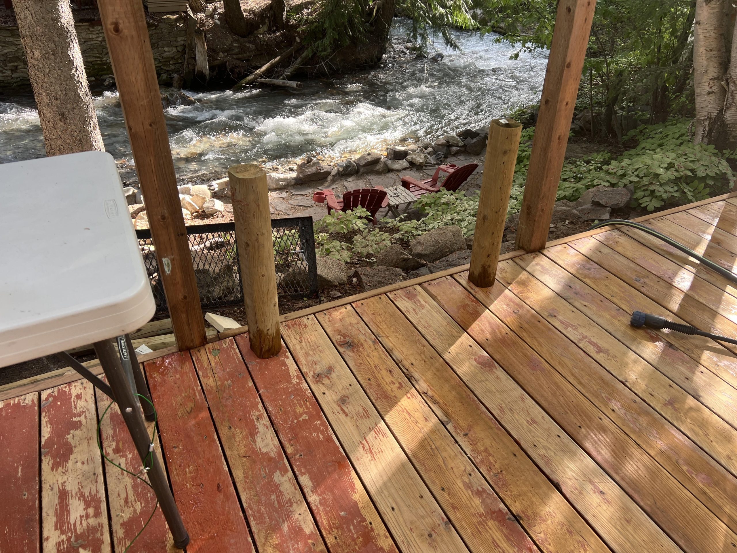

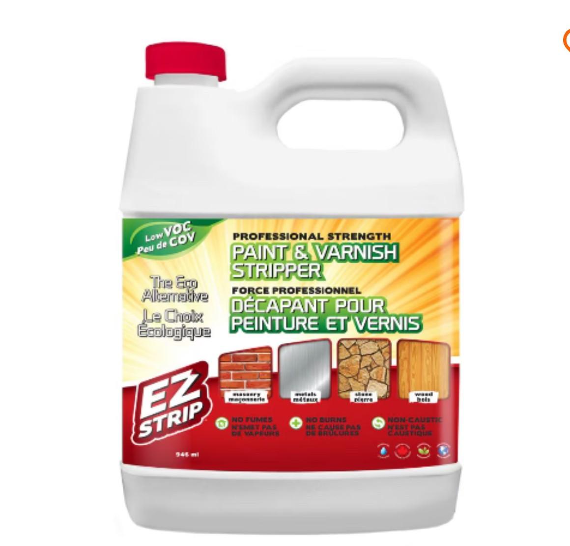

I used “EZ Strip” to strip the multiple coats of unknown type of paint off an older cedar deck (painted the stripper on, dwell time, then pressure washed it off). The instructions said to remove it with water and to “neutralize it with water”. So to remove any residual solvent, I then pressure washed each board, until the water ran clear from that board. However, I noticed that if I ran the pressure washer over that same board a couple of minutes later, more solvent appeared and so I would again pressure wash that board until the water ran clear. Unfortunately, the solvent continues to appear when I respray the boards. So I’m not sure what to do next? Do I need to used a wood cleaner / brightener to somehow neutralize that solvent? Or just keep pressure washing? I’m worried if there is residual stripper remaining in that old porous wood, my stain won’t penetrate properly. Thanks!
FYI: I’m from Canada (British Columbia), my deck is beside a fast flowing creek, and is full sun for a couple hours a day, but otherwise mostly shade.
I would not worry about it. Just rinse when done stripping.

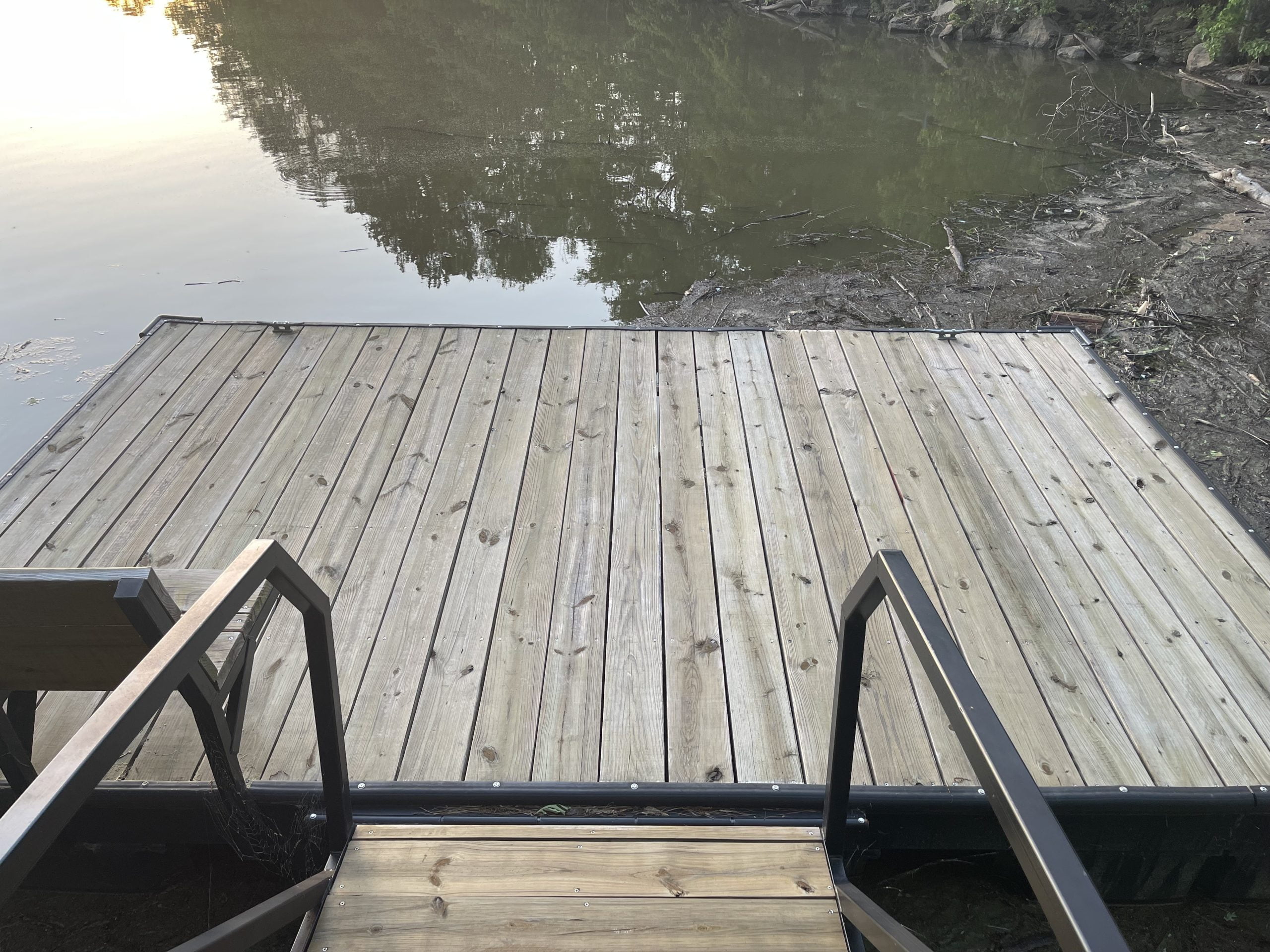

5 year old PT pine deck, never stained. It is about 20 yards from our lake. Have you had anyone have aquatic animal/fish problems after using restore a deck? TWP tech did say the cleaner/brightener is “harmful to aquatic animal”, according to the specs. I can’t believe the small amount that might be washed into the water would be enough to hurt anything. My family does not want to use it, but will use a dilute bleach, with sanding. I’ve read that bleach isn’t good to use, and it can do the same to the fish. Comments?
The RAD Cleaner and Brightener should not harm any fish in the water.

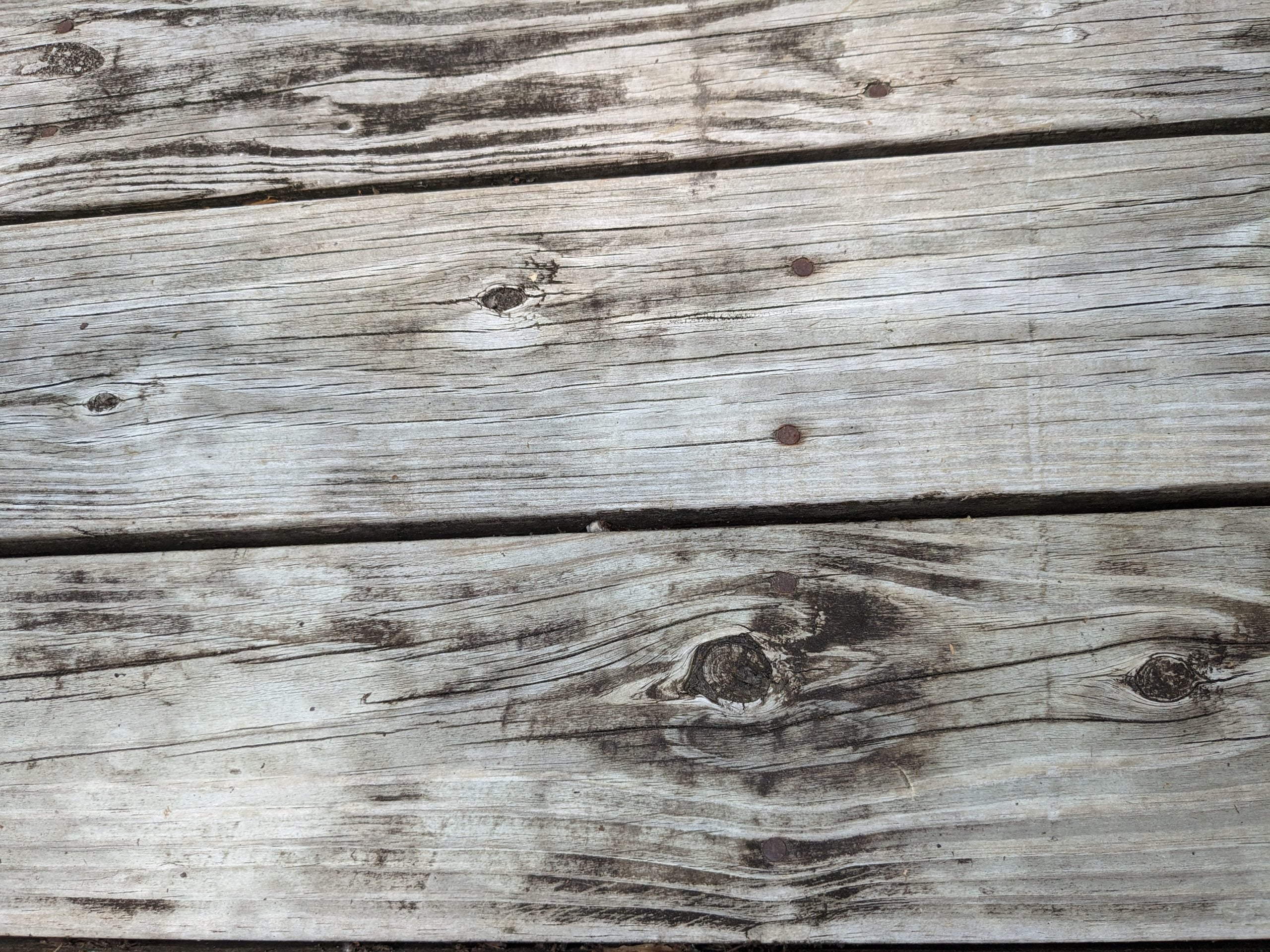

2 year old deck, pine. Eastern NC. Was told to wait until following spring to stain. Original staining job was done by a local contractor using Ready Seal Exterior Wood Stain, Pecan. Dried streaky and uneven. Wore quickly and unevenly. Would like to go darker next go around.
Can you confirm what Restore A Deck products to use?
Should I wait until Spring? We’ll be only averaging highs in the 50s soon.
THANKS!
Eric
Strip and brighten for prep. No need for the RAD Stripper Additives. Stain with the RAD semi-transparent stain after the prep. Spring is good.

What is the best stain, preferably not a solid color, for a floating dock?
Also, what is the best prep method for a 2 year old dock where there is no access to power or water (ie pressure washer/hose) except for the water from the lake?
Thank you and God Bless!
If you have a sprinkler pump from the lake, hook up your pressure washer there. Use a deck cleaner and wood brightener for prep. Use Restore A Deck Prep products and their semi-transparent stain:
Thank you Scott! I have not looked into this stain. The recommendations I had received so far were solid stain from Cabot. Sherman Williams Deck stain, which utterly failed with flaking on my back deck, and TWP 100, 200, or 1,500 series. I’ve been over with options to say the least! I do not have a sprinkler pump but can research one.
I was told by the dock builder that Cabot Natural was applied to the walkway when installed. But they cannot confirm their crew applied it to the dock itself. Do I need to use a product in addition to what you listed above? I’ll attach pictures. Thank you again and God Bless!
TWP stains would also be a top choice. Just use a cleaner and brightener for the dock. No need to strip it as there is not any stain on it.
That is awesome! I am amazed by the help I’ve re here!
If I may, I’d like to lean on your experience, and yes opinion, and ask what color from either brand would you think would look good with the black railing of the dock? I know this is subjective, but I also don’t have an eye for this and know that you have done over 10k docks! So I very much value you opinion! Thank you so much Sir. As a wounded Vet, I salute you and this outstanding customer service! God Bless!
Maybe Light Walnut or Dark Walnut in the Restore A Deck stain or in TWP, Dark Oak or Pecan colors.
I stripped my deck with Restore a Deck stripper. I washed the stripper with a high pressure hose. The deck looked okay but railing was pretty bad. We tried stripping all again per their recommendation, then we sanded with 60 grit orbital sander and tried pressure washing. The sealer on it was a penetrating one that was not effective. The power washing damaged the wood, the deck seems okay but railings not looking good. Should we sand again in areas that have sealer and are damaged ? Brighten… not sure how to deal with it. Thank you!
Did you use the R-A-D Stripper with the Booster and the Thickening Gel? That would help. Also, you could try some of the RAD PaintStrip on those railings. Brighten when done.
I just used the regular Stripper, not the paint stripper. So I have to strip with paint stripper again just the railings? Will that damage the deck when it drips?. Can I sand the flat and damaged areas to even out the texture where power strip blew out the wood? Does the deck itself look good for brightening? Thanks Scott…
Strip the rails to get the old coating off. it should not harm the wood below but brighen all wood when done for an even appearance. Hard to fix when you over-pressure washed and made grooves. You would have to heavy power sand to get those out.

So I bought a home with existing deck approx 20 yrs old with 2×6 cedar that’s rotted in various locations. Ive been replacing bad boards with treated 2×6 over past several years and applying PPG Timeless semi transparent/ semi solid water base which in some areas is going over new wood and majority over old which has several coats of who knows. This summer I replaced another 20 deck boards and all the rotted 2×2 balusters on railing that I’m replacing with hog wire. I bought RAD stripper with additives but some of the older stain looks solid which I read it will not remove so I may have to go back to solid. I want to use AC oil but if I can’t remove all of the old stain which I believe is latex will it adhere? I’d like to avoid sanding. Also the deck has new green stripes everywhere and I read stripper will make them fuzzy? I’m thinking I’ll complete the rail system for safety and wait till spring to strip, brighten and stain the deck so the treated has time to weather. Will the stripper solution remain active for 6 months or should I make a smaller quantity? Sorry this sounds so convoluted. Thankyou
Post pics.
The decking is stripping nicely but I can’t remove baluster marks and I’ve noticed flexible strings of what appears to be paint on some of the railing. Thanks
Okay Scott I’ve read enough that I’ll use a solid on the areas that won’t strip and go with semi transparent oil on decking. I’ll make sure whatever solid is left on has good adhesion after sanding. Maybe a two tone. Thanks again
One more thing I keep reading is semi solid and semi transparent. What’s the difference?
Opacity. Less grain shows with a semi-solid.

In early March of this year, we added a lower level PTP deck to the house we purchased 2 years ago (on a lake in N. Georgia. The house is only 5 years old). The top deck already has white balusters and we just can’t remove and update. I’ve established (through your articles) the prep process and that we’ll use semi-transparent TWC or Armstrong Clark. My question involves color: do you (or do you have have anyone) who will help with color ideas? We need to tie in the white (I think). Our son (who does advertising in NYC and has the technology) mocked up one idea (also included in pics).
1. How do we “stain” white? Or does this have to be paint?
2. We need to do the actual deck floor area in a brown or cedar color, I think, because we have too much gray (hot tub will not be moved to stain)
3. Should top handrail be the same as the floor?
4. Thinking we need dark gray for all the underneath area to help it all “disappear” (we’ll plant in front of the underneath area later).
Adding pics of the deck and one that was colorized. It is NOT currently stained or painted!) Any help is greatly appreciated!!
You have a two-toned deck. See here for tips: https://www.deckstainhelp.com/why-have-a-two-toned-deck/
Keep all verticals white with a solid stain, try Restore A Deck. Use a brown semi-transparent color for the floors. Try TWP in Dark Oak or Restore A Deck in Dark Walnut.
No need to stain the undersides outside of aesthetic reasons.
Thank you. One more question: Should we use oil based? I’m guessing yes, but thought I’d ask. TWP 100 will penetrate better than 1500, correct? (I’m aware Georgia doesn’t have a VOC law; we used TWP in our last house) OR, is water based better here?
OK, 2 more questions: We are going to stain the sports and underneath. A 3rd color (charcoal?) would look ok, in your opinion, correct?
Both TWP 100 and 1500 are oil-based. Water-based and oil-based will work equally well as long as you are using a high-end penetrating wood stain.
Color choices would be up to you. We do not like to offer advice on this as everyone has different tastes.
