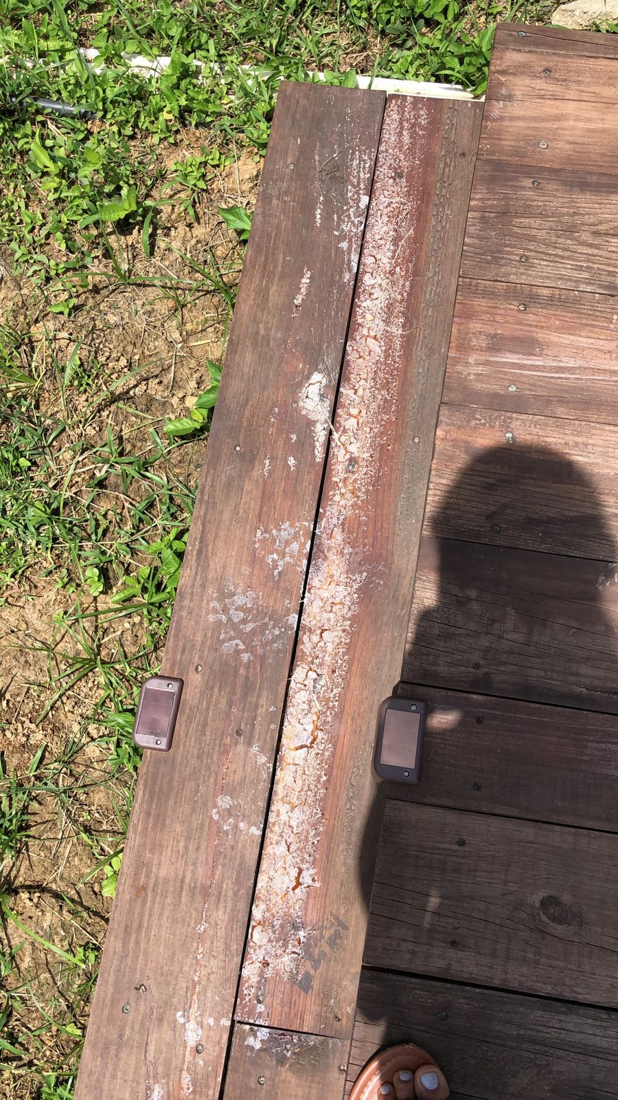

I stained my deck in direct sunlight(big mistake) now the surface is looks blotchy and bubbly. Amy suggestions on how to fix it without sanding? It a big deck.
