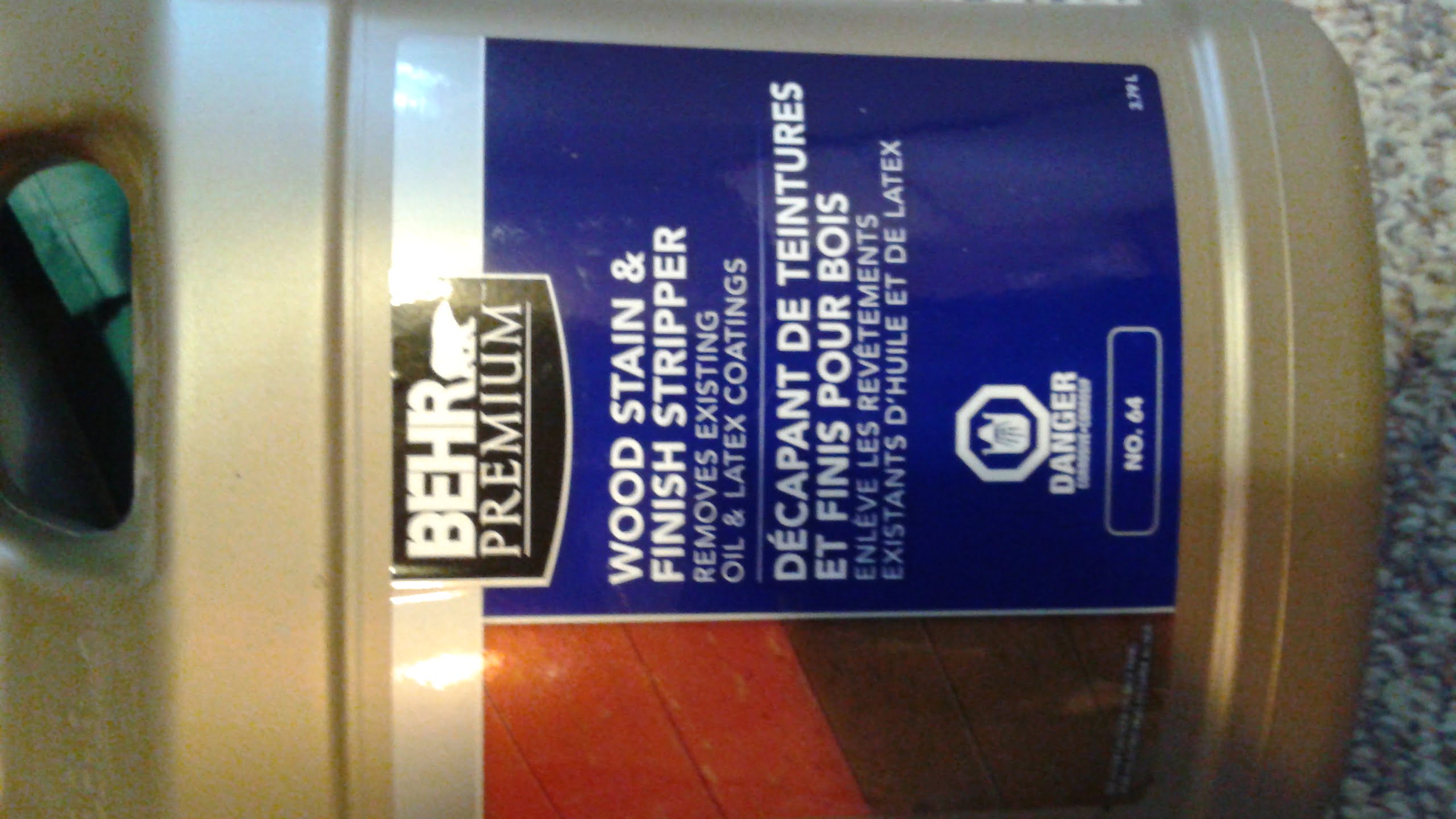

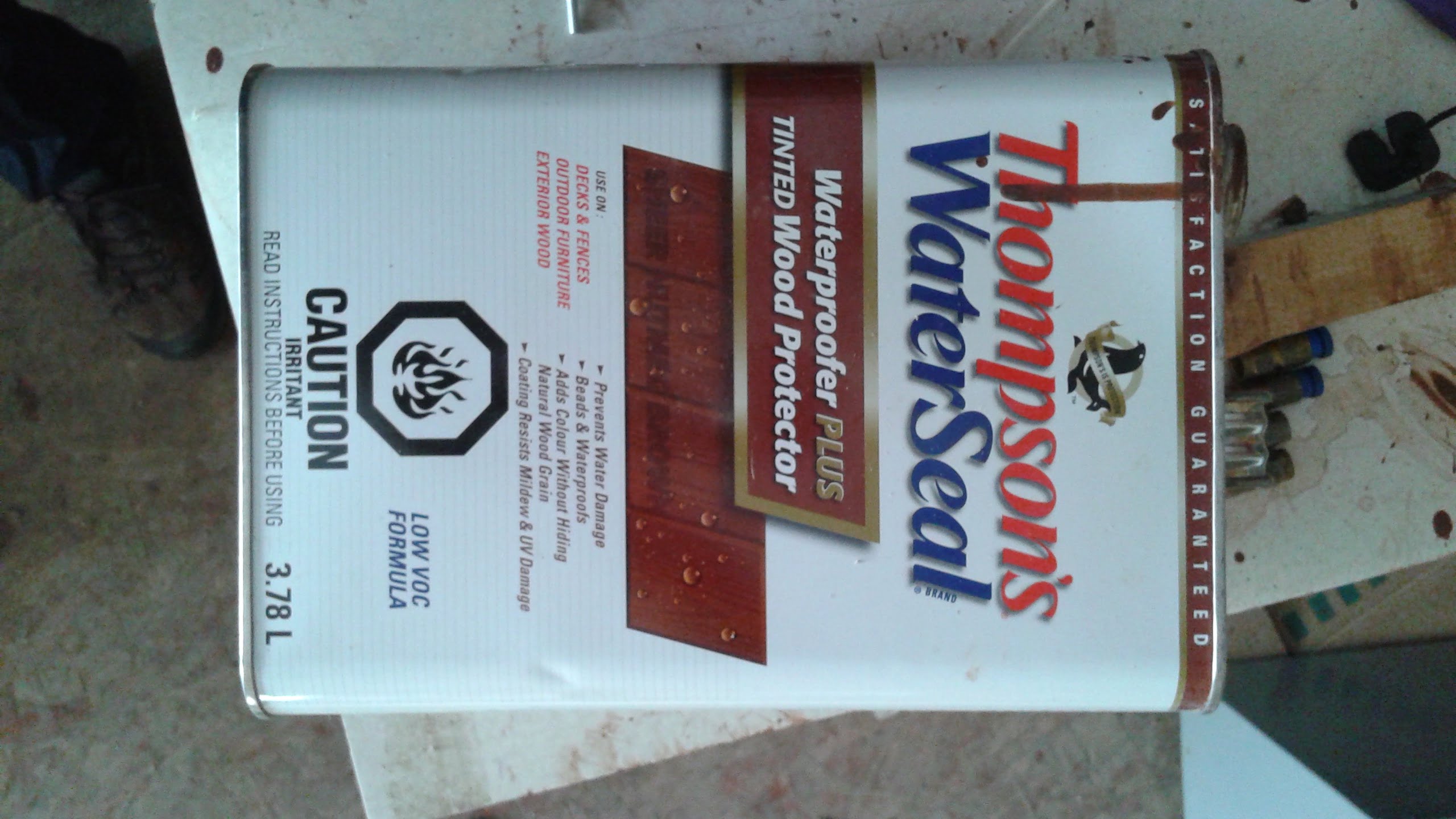

I have purchased Behr #64 stain and finish remover for removing Thompson’s Weather Seal semi transparent stain. Do you believe it will be an adequate combination?
We have never used Behr’s stripper on Thompsons. Behr is an average stripper and we normally do not use it. Posts your results if you can.

Do I need to strip off all of the old stain? I am using Behr Premium Deck Over over the same product. Some of the areas more exposed to sun have peeled. I was going to just sand those areas smooth but thought is might be easier to use a stripper only on the peeled areas. Will this work or do I have to strip the entire deck?
Strippers will not remove the Deck Over. Just sand and reapply same.

Have a major problem …… I own a pressure treated deck …. Approximately 10 years old …. and I applied Thompson's WaterSeal (Waterproof PLUS clear Wood Protector) on my greying deck. I cleaned the deck first with a deck cleaner …. don't want to hear about what I should or shouldn't have done …. I need to remove the cleaner from deck as the WaterSealer has darkened the original light grey tone of the deck so much so my wife hates it …. really hates it!
Question:
What's the best way possible to remove the Thompson's sealer to somehow get the old look back?
I'm at fault for presuming the "clear" version of the sealer would not affect the outcome of the colour …. just need some serious professional advice as to how to regain the old look of the deck …. have to agree with my wife, I don't like the look …. please advise me on what to do next (deck stripper, sanding, etc?)
Thanks ….. Please hurray, my wife is pissed 🙂
You cannot remove the Thompsons without removing the old weather graying look as well. the only way to get it off is to strip it and that will remove the graying.
