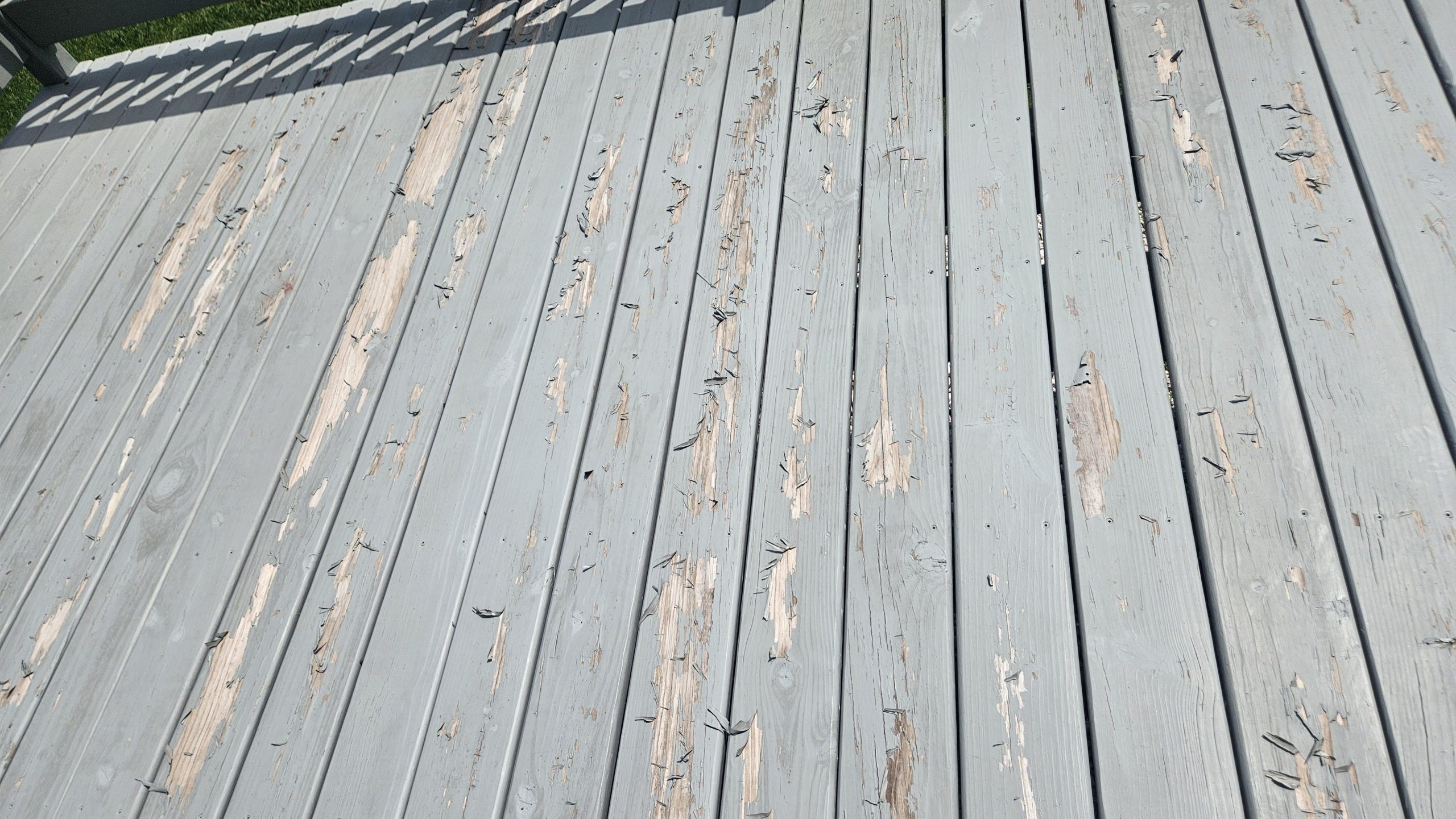

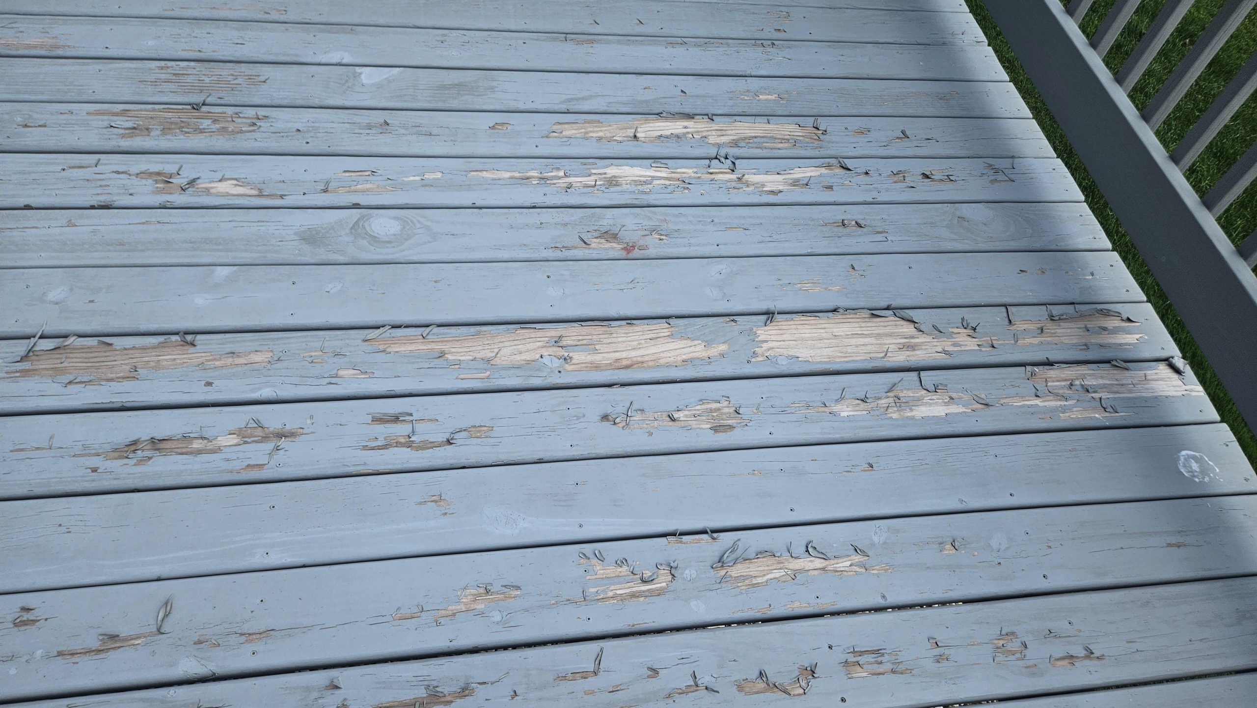

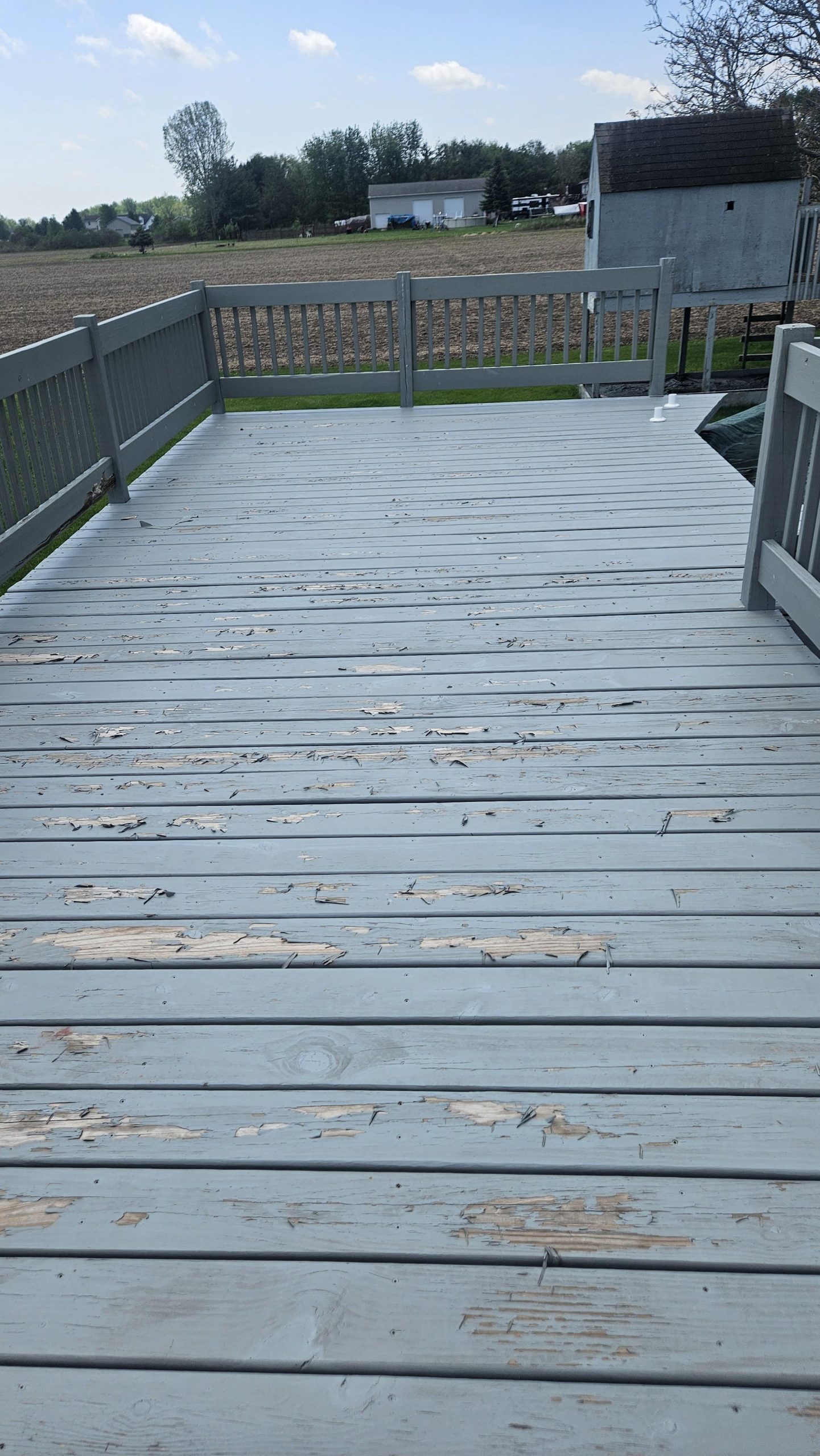

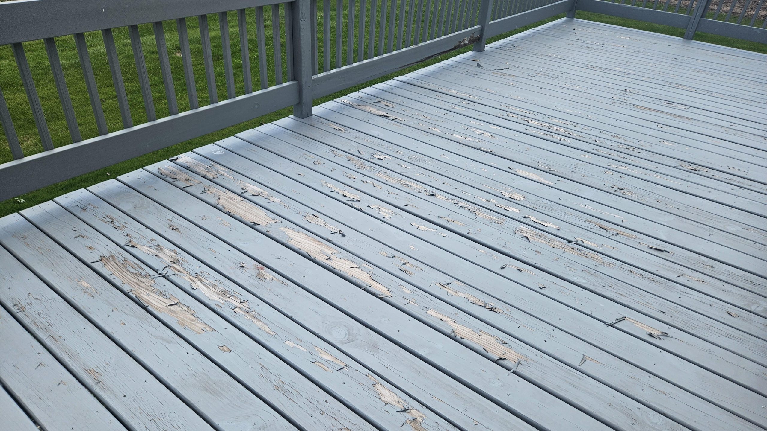

I have a large deck that is painted with a solid color stain (previous owners didn’t take care of this house). You can see there are two colors going on here. What do you recommend for removing absolutely all color? There are also a lot of areas with wood rot that need to be replaced. I want to get our deck back to a beautiful brown wood stained color.
Strip off as much as possible and then sand the rest as needed.
