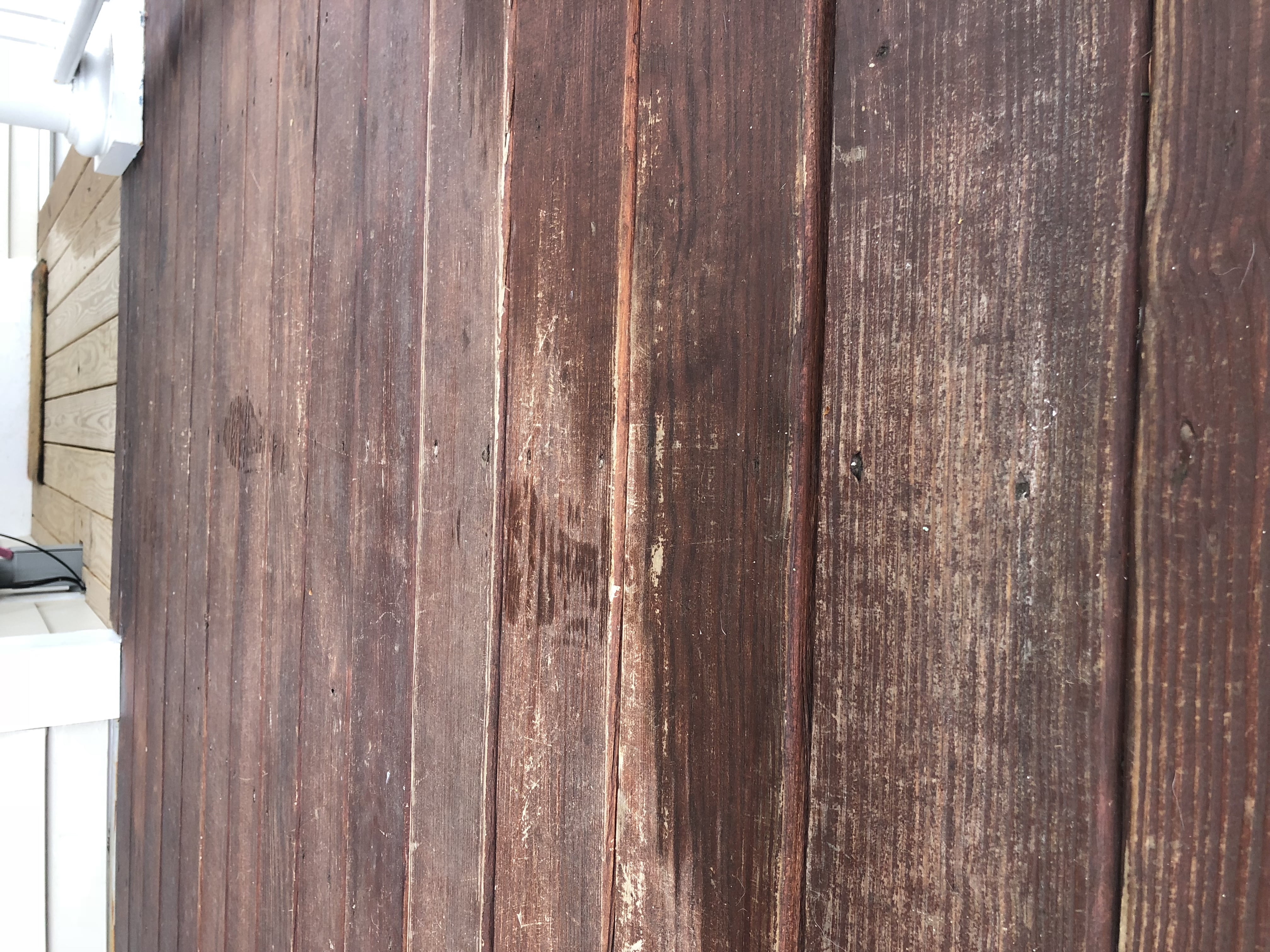

My deck is over ten years old and was not maintained at all by the previous owner. There isn’t much color left and I am unsure if they used stain or solid color paint. How can I tell?
Post a picture please.

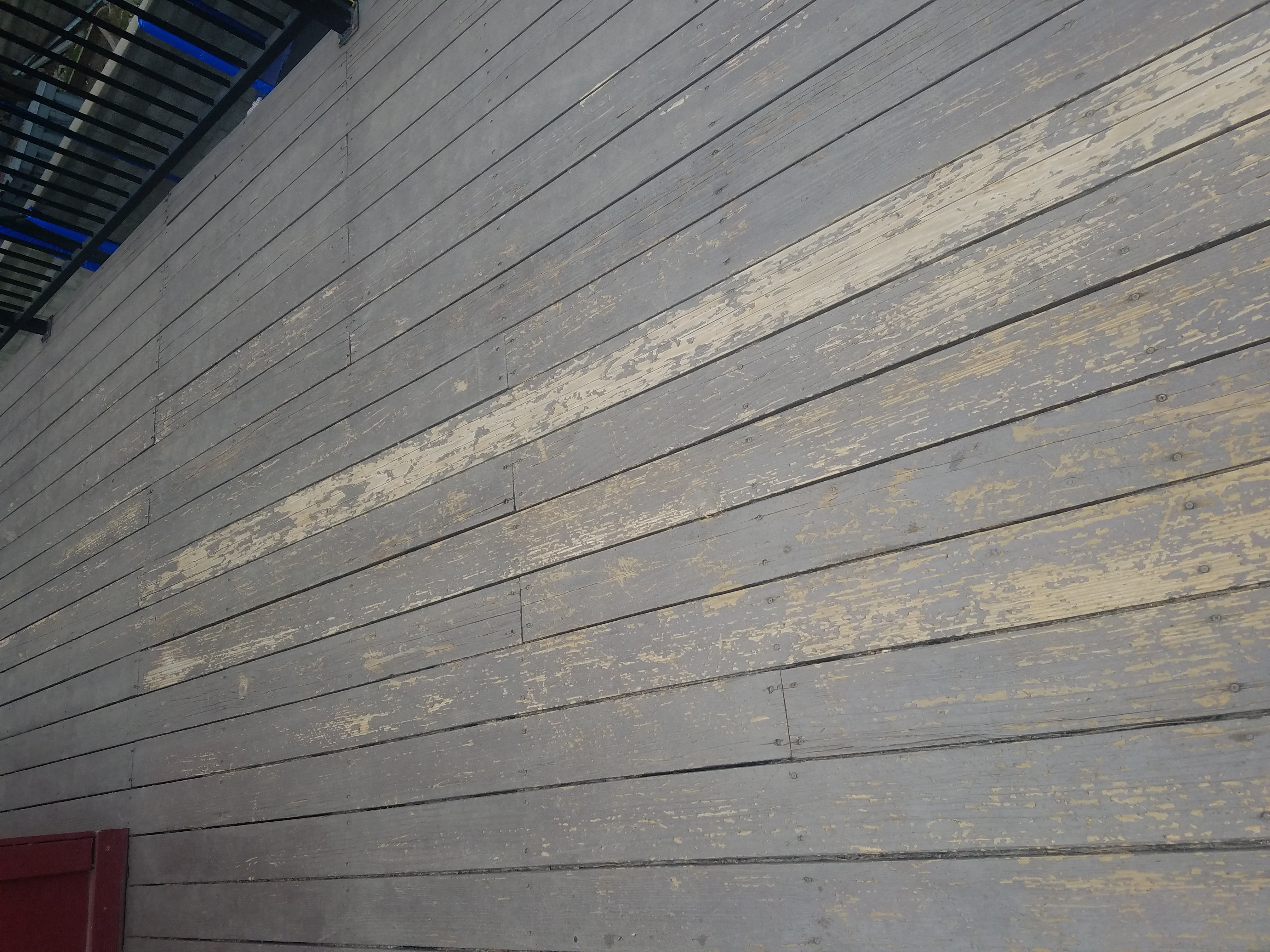

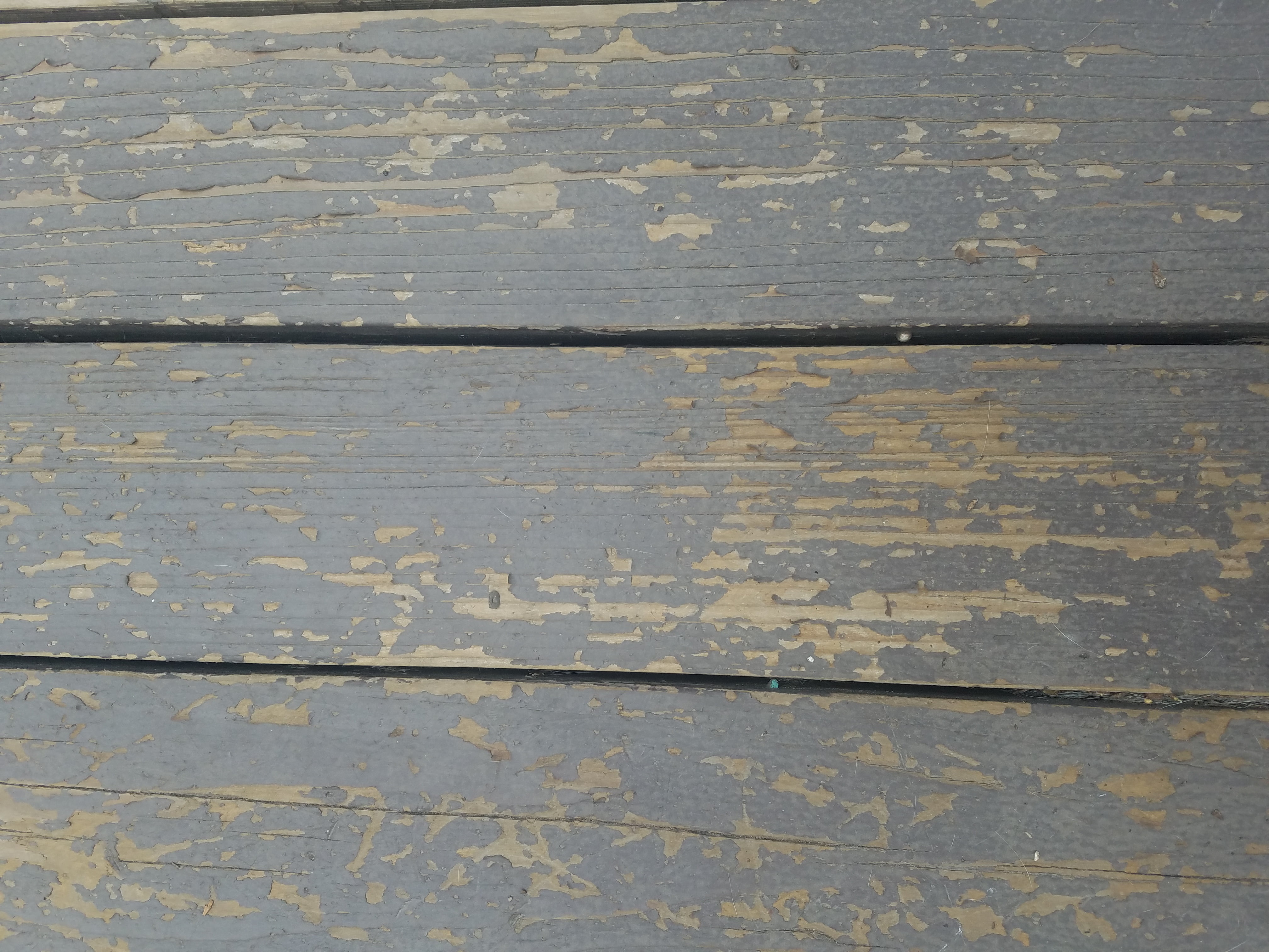

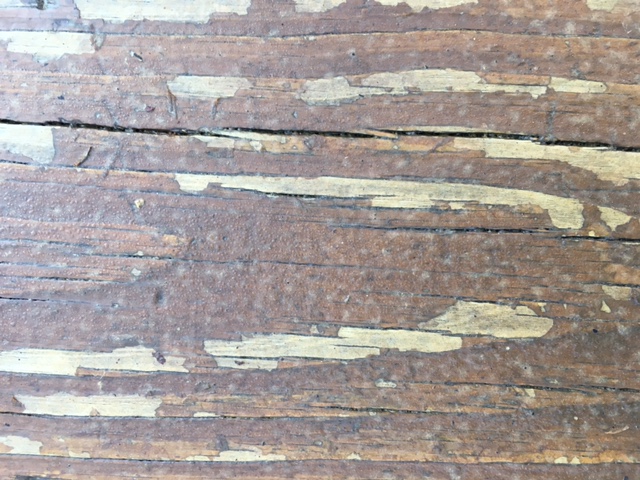

We just bought a house and I’d like to strip the deck of chipping paint and mold prior to staining or painting. After the deck stripper is washed off with the power washer into the lawn, could the chemical potentially harm our dog?
Solid color paint? That cannot be stripped. Sanding is the only way to remove effectively.
Great! Thank you for the speedy response!

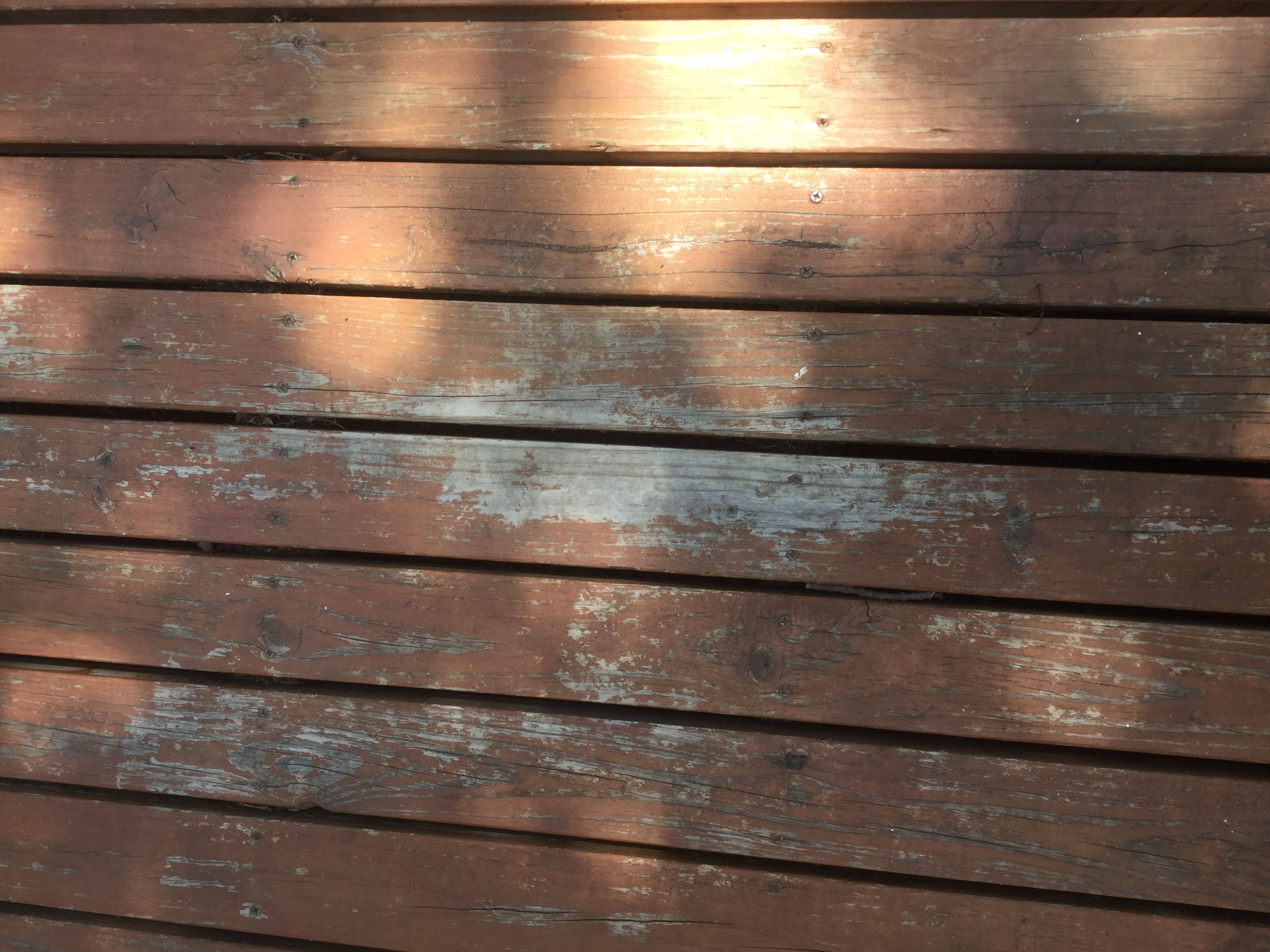

Here is the photo from my question. Would a solid color cover this up? Do I need to power wash again with stronger preasure?
You need a stain stripper first and then pressure wash off. Brighten when done.

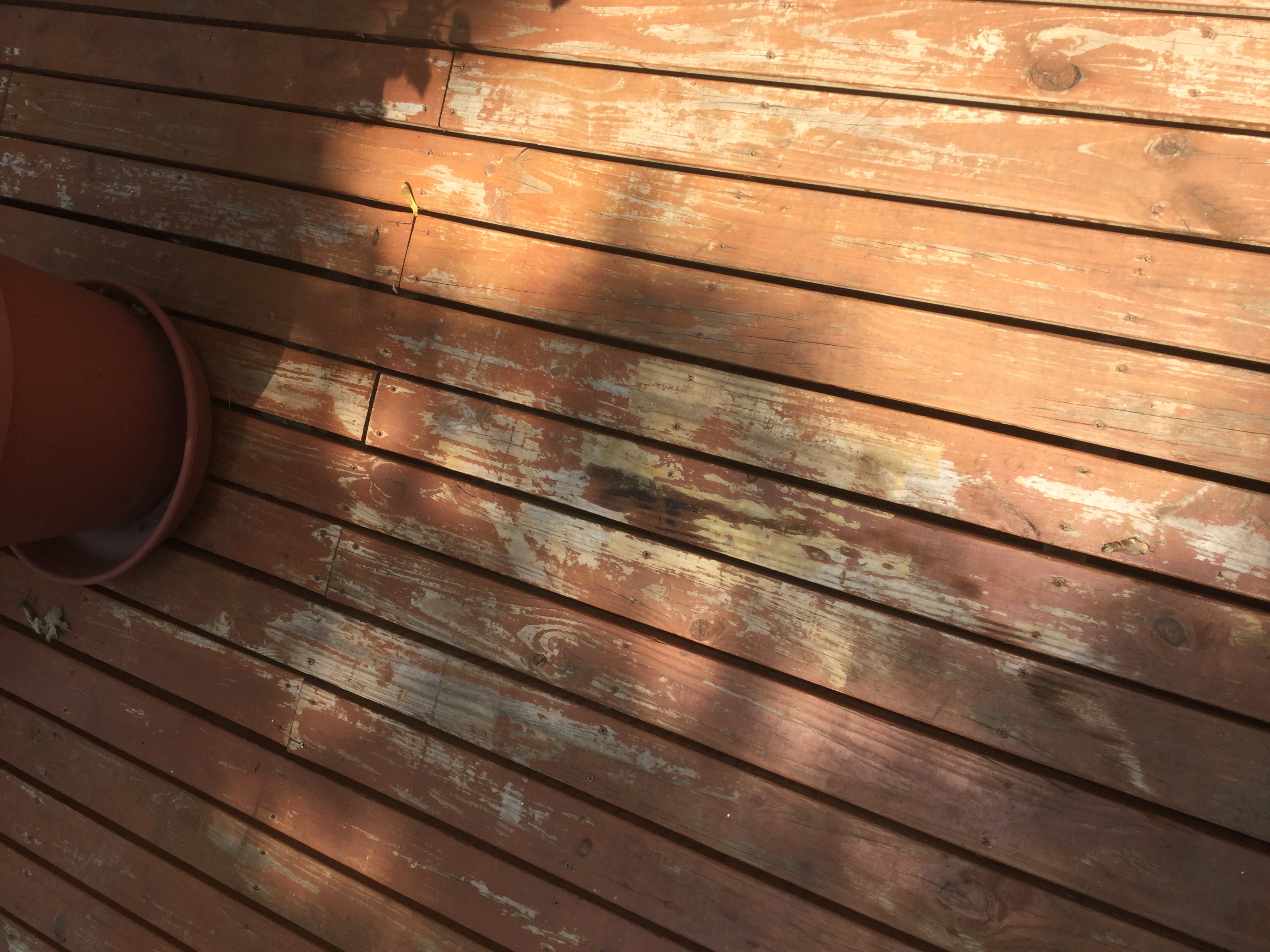

Hi! I power washed my deck two days ago with a harbor freight power washer and I feel it didn’t work. Can it look at these photos and please give me some advice? I’ll do anything except sanding! Thank you!

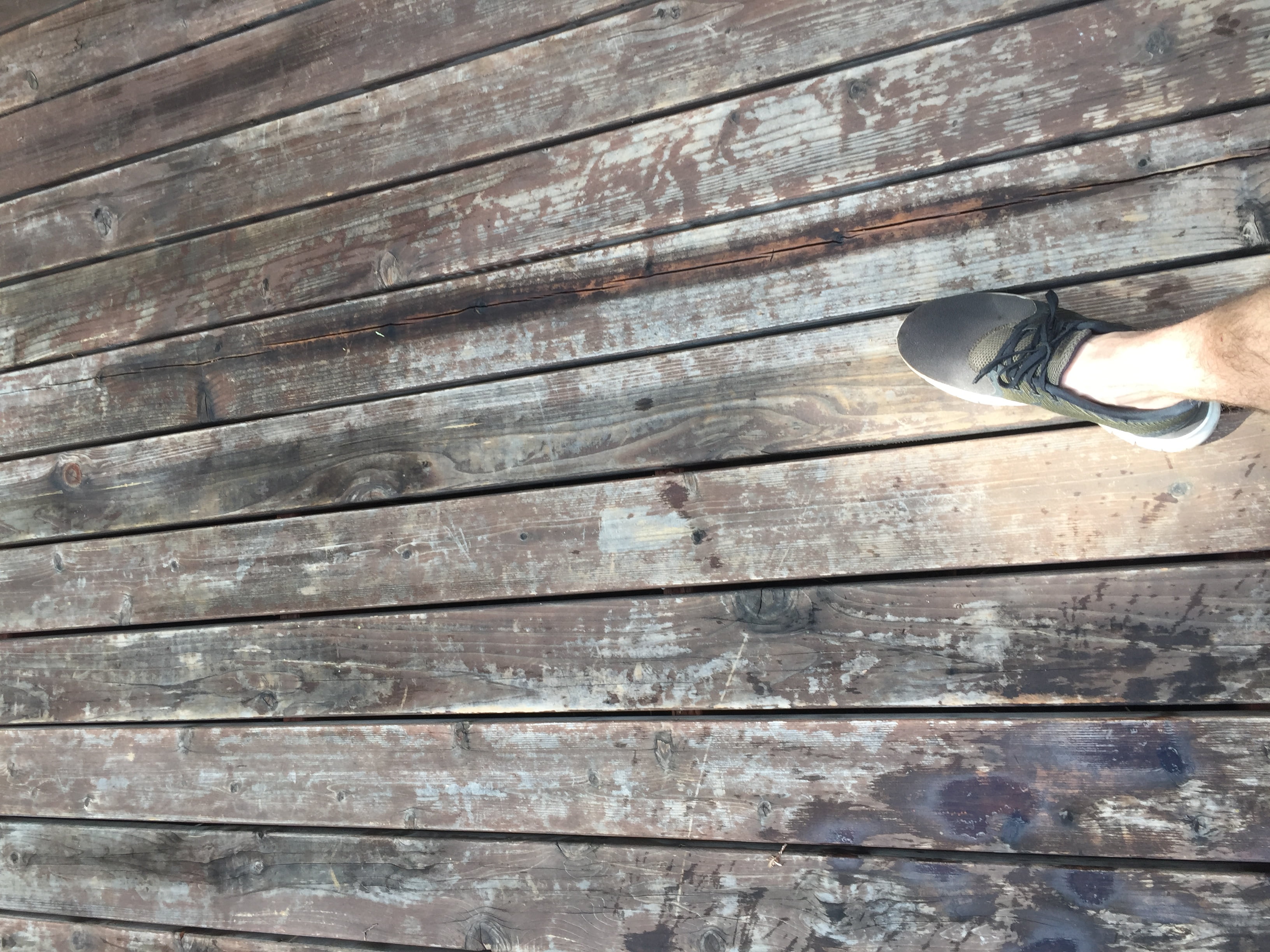

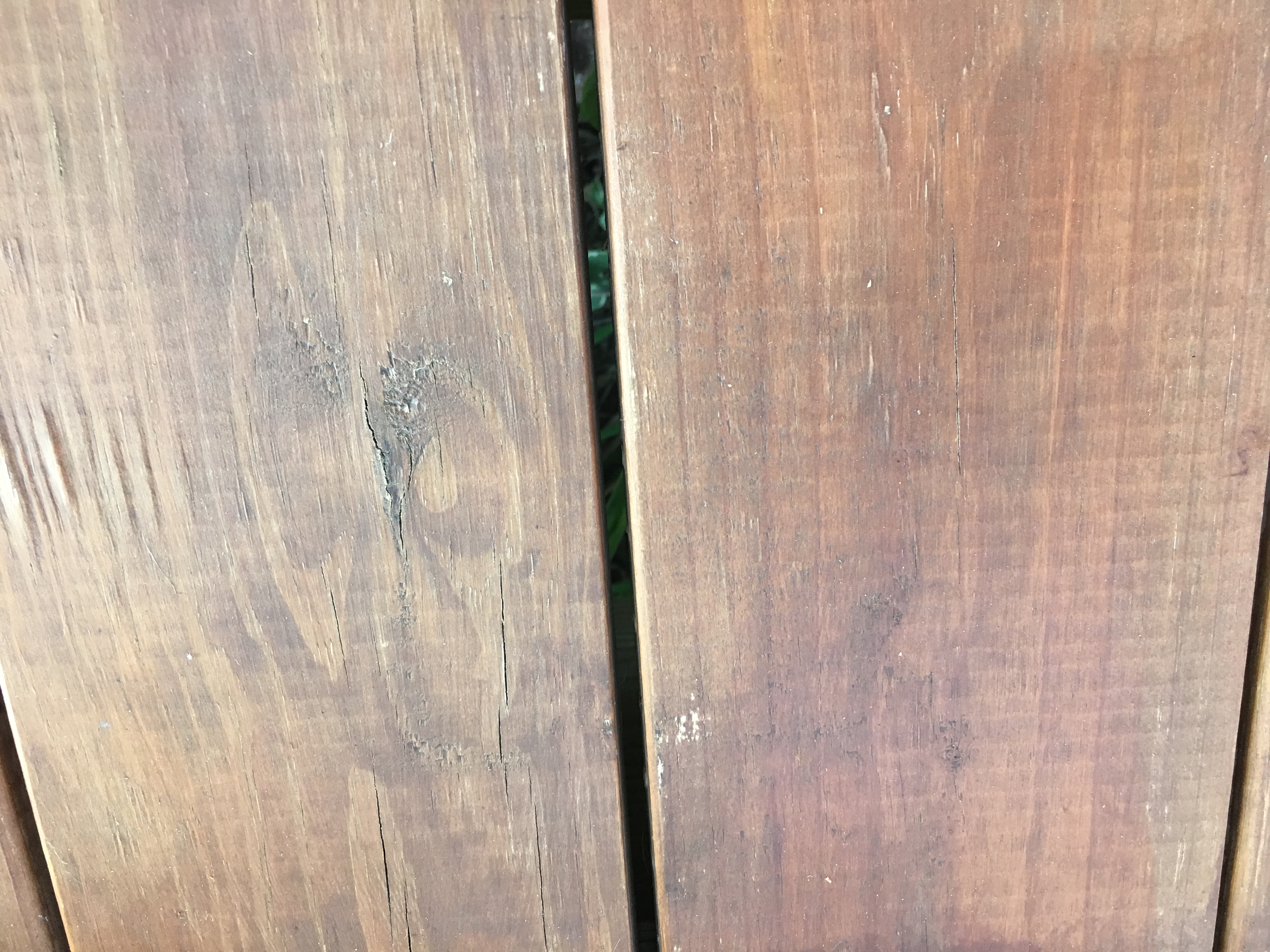

1 year ago we added to our deck using pressure treated wood that I have not treated or done anything to. The older section is pressure treated wood that was treated by previous house owners but not sure what they used for a stain. It’s a darker color stain and I want the old and new sections to match and my wife wants a lighter color final stain for all. Some areas of the deck (common walk areas) worn down to the wood and some areas look pristine (low traffic areas). Do I strip/clean then stain? Any help is appreciated.
Please post a picture of the older stain. How to remove depends on the type it is.
hope this helps…thanks
That looks “thick” Strip off what you can and sand the rest. Brighten when done.

I put a dark stain on my porch and I want to remove it and put a lighter stain on. How do I get the dark stain off?
How to remove depends on the brand and type of deck stain you used. Do you know this?
yes, it was minwax wood finish Red mahogany
Minwax is not designed for exterior wood or decking. It cannot be stripped off. You will need to sand it off.

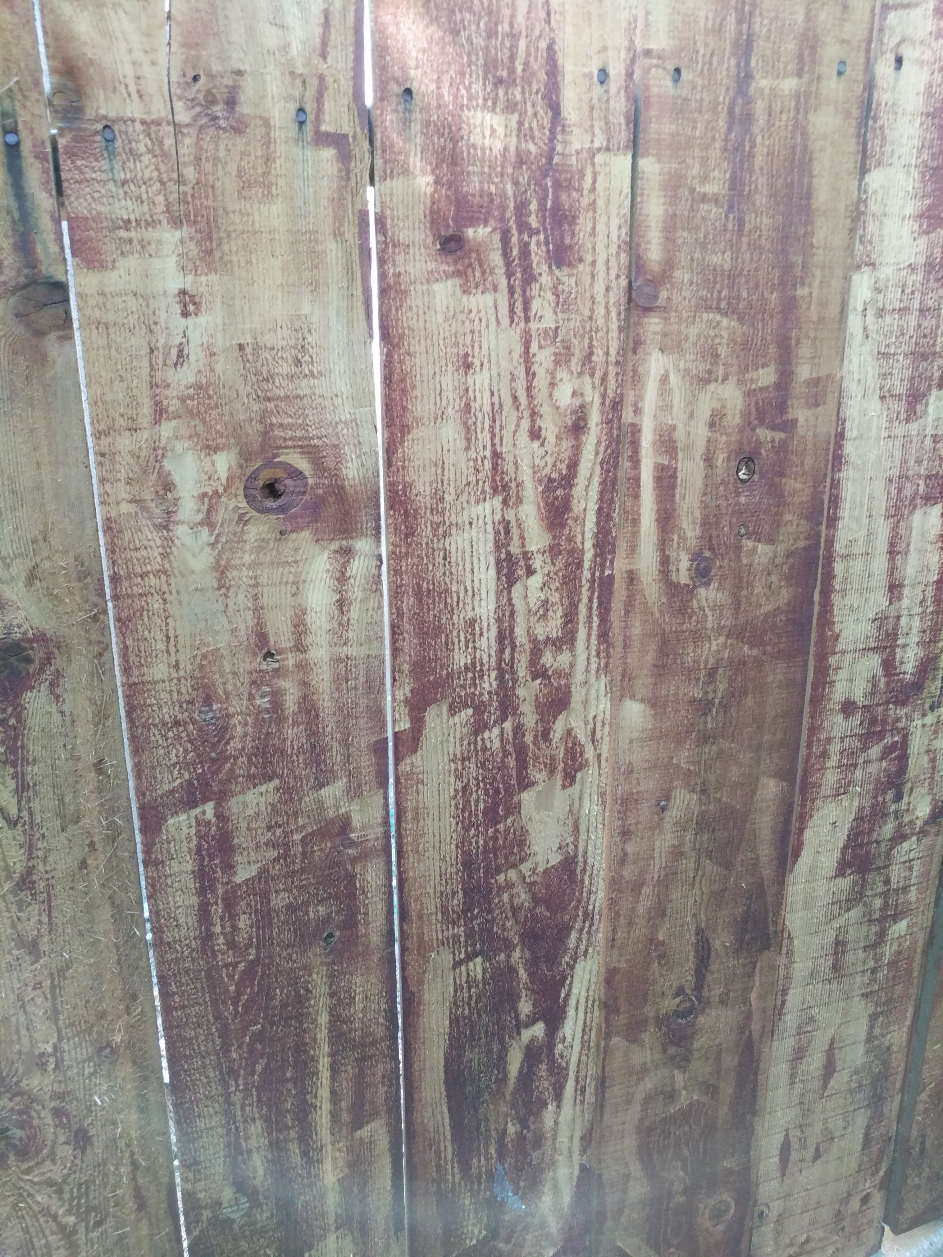

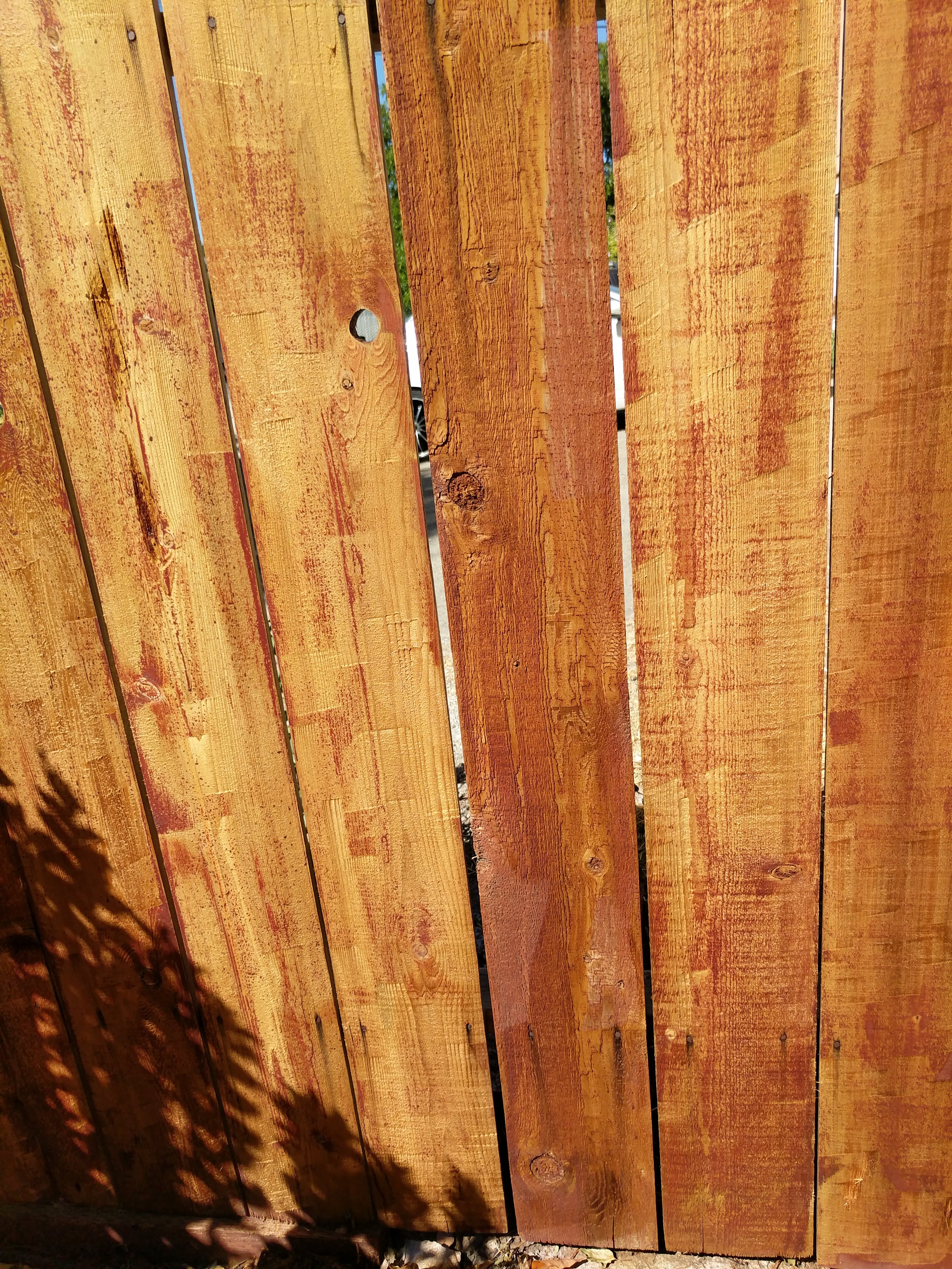

We messed up our transparent stain on brand new redwood deck. Will using a deck stripper this early damage the wood? Also, since we used a transparent stain, we don’t need to use a sander? Deck stripper and cleaning/brightening should be sufficient prep? Thank you!
What brand of stain did you use?
Behr Transparent in Cedar. We cleaned/brightened then applied stain less than 24 hours later.
Strippers will not damage the wood but your issue is that Behr is not an easy product to strip, especially when just applied. You may have to sand as well to remove all.

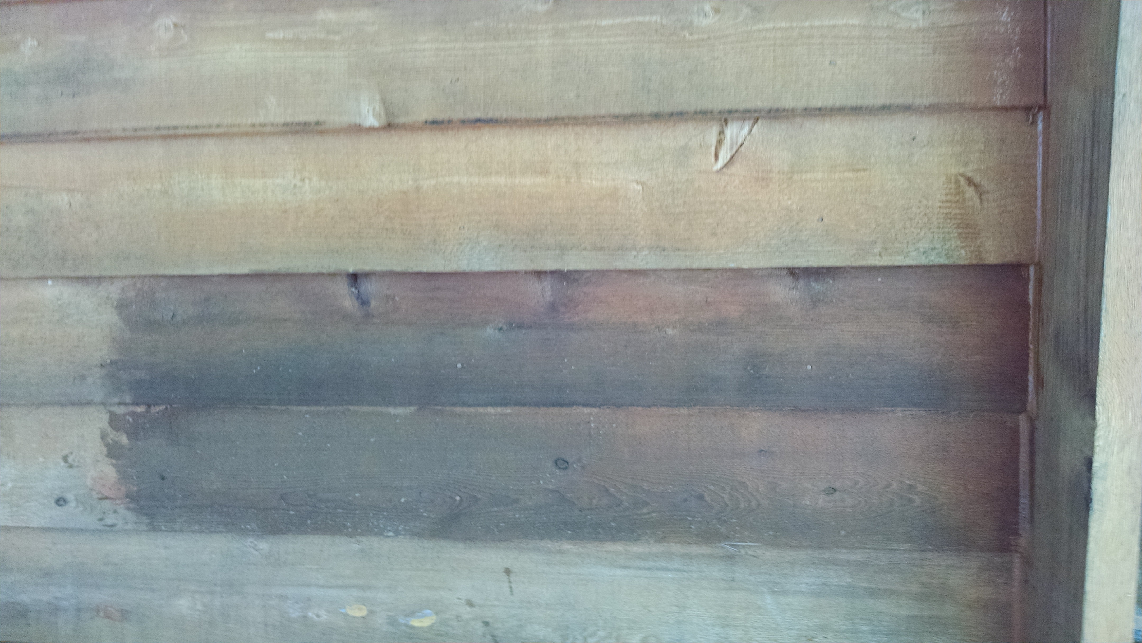

I replaced the flat portion of my deck with new cedar two months ago, but left the existing vertical hand rails and spindles, which have an old solid stain on them, and have some random dark stains(mold?). I would like to use solid stain on the vertical railings, and semi-transparent on the flat areas. To prep, do I need to strip the spindles, or just remove the dark spots? Does the new cedar need to be brightened, or can I just apply the semi-transparent stain?
The verticals should be pressure washed with a deck cleaner to remove dirt and mold. This will prep it for a new coating of solid stain.

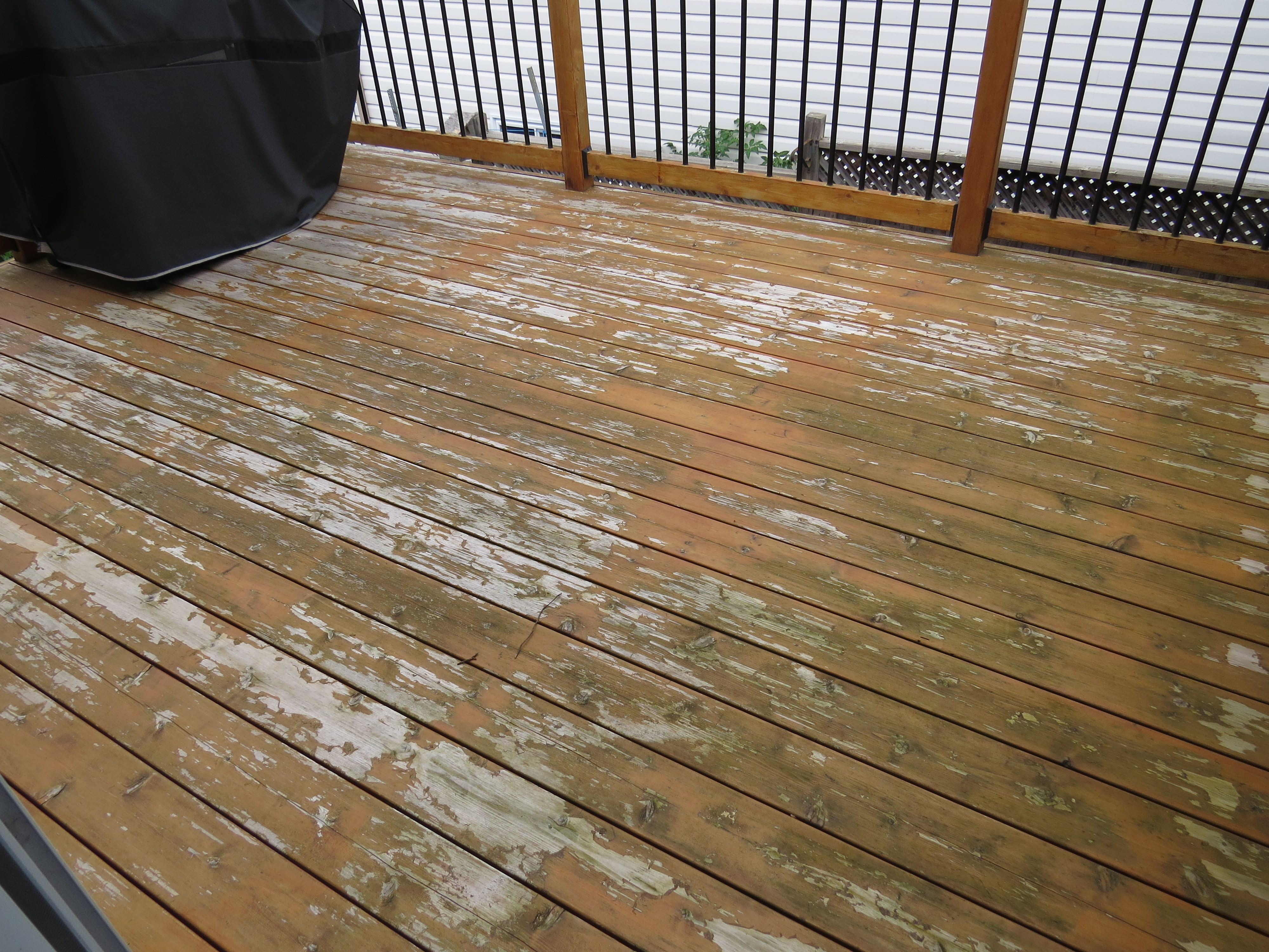

Hello and greetings from NW Iowa! We stained this deck 2 summers ago with Pittsburgh Ultra. Had a hail storm come through and insurance company is paying for a deck re-stain. We were totally disappointed with the Pittsburgh product. What do we do now? Thanks!
You will need to remove this and start over. Unfortunately, it does not look like it will be an easy strip as it almost looks like a solid stain on the wood in parts. Start by stripping and pressure washing off as much as you can. Most likley you will need to do some power sanding to remove what does not come off with the stripping. Once fully removed, you can apply a wood brightener.

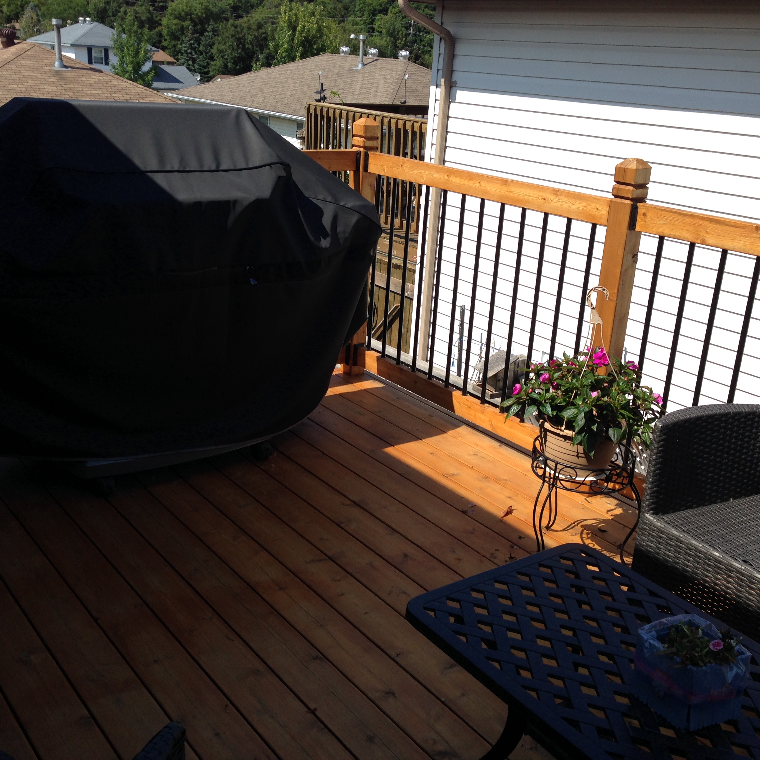

Last year I replaced my old deck with a brand new cedar one. I waited 60 days after install and stained the deck with Armstrong Clark Amber Semi Transparent. It came out beautifully (see picture).
However, this summer I decided to clean the deck and I mistook the “agitate cleaner with hard bristle brush” part of the instructions for using some real elbow grease, and in the process of cleaning I ended up taking half the deck stain off. I am mad at myself and a little embarrassed lol.
Do I strip off the existing stain that is on the deck and stain, or can I stain over the whole thing after a good cleaning and brightening? (using the same stain I used last year). Thanks.
Probbaly would be best to remove all so the new coating goes on evenely and not blotchy.

I have a cedar fence that was stained with Behr transparent redwood stain about 10 years ago. We want to restain with the same color, we have power washed the fence but aren’t sure if we need to strip ALL of the old color off or is this good enough and we can apply the new coat of stain?
Stripping it all off and then brightening would be the best thing to do.
Uugggh! I was hoping you wouldn’t say that 😉. What stripper would you recommend? Is the home Depot brand stripper good for the job?
Try the Restore A Deck Stripper.

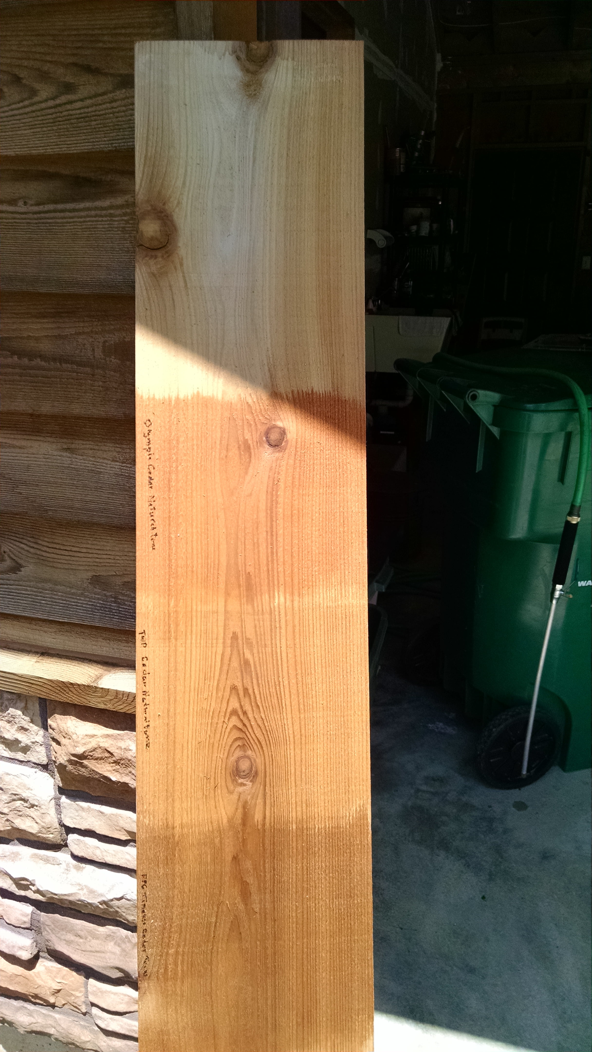

Here they are: Right pic is TWP (among others) on sample of new cedar siding. Leftt pic is same TWP on a sample of installed siding after it was brightened.
We have cedar siding on our house, about 5 years old. One side showed excessive bleedthrough–almost like tar. We removed that with Cabot Wood Brightener and a rinse, which worked well. But it took some stain with it. We wanted to restore that with a new coat of stain. What we’ve tried on cedar siding samples — PPG and TWP, both Cedar Tone — work well on new wood. We let the siding we’d treated dry for three days, and then tried them both on a sample of that. They go on nearly black — nothing like the cedar. What should we do?
Picture please.
Sorry. Pics sent in separate post.

I have a small decking area 5ft by 20ft, I have small area’s to remove old dark stain which seems to be stuck fast! Can I tell me, what grade of sandpaper would I use?
60 – 80 grit paper.

Why does my decks solid stain peel, just in high traffic area’s, every year?
Solid stains are filming stains which means they dry on top of the wood. Whenever you have this, you are prone to wearing and peeling, especially in exposed areas and in areas of high traffic.

Will deck cleaner help remove chipping stain? About 90% of my deck is free of stain, just covered with grime and dirt. The other 10% still has some remnants of stain from the previous owner. I bought deck cleaner before realizing this issue, will I also have to buy stain stripper just for the small spots of stain left over or will I be able to get by with the cleaner?
Cleaners will not remove chipping stains. As for stripper working, it depends on the type of stain you are trying to remove. Do you know?

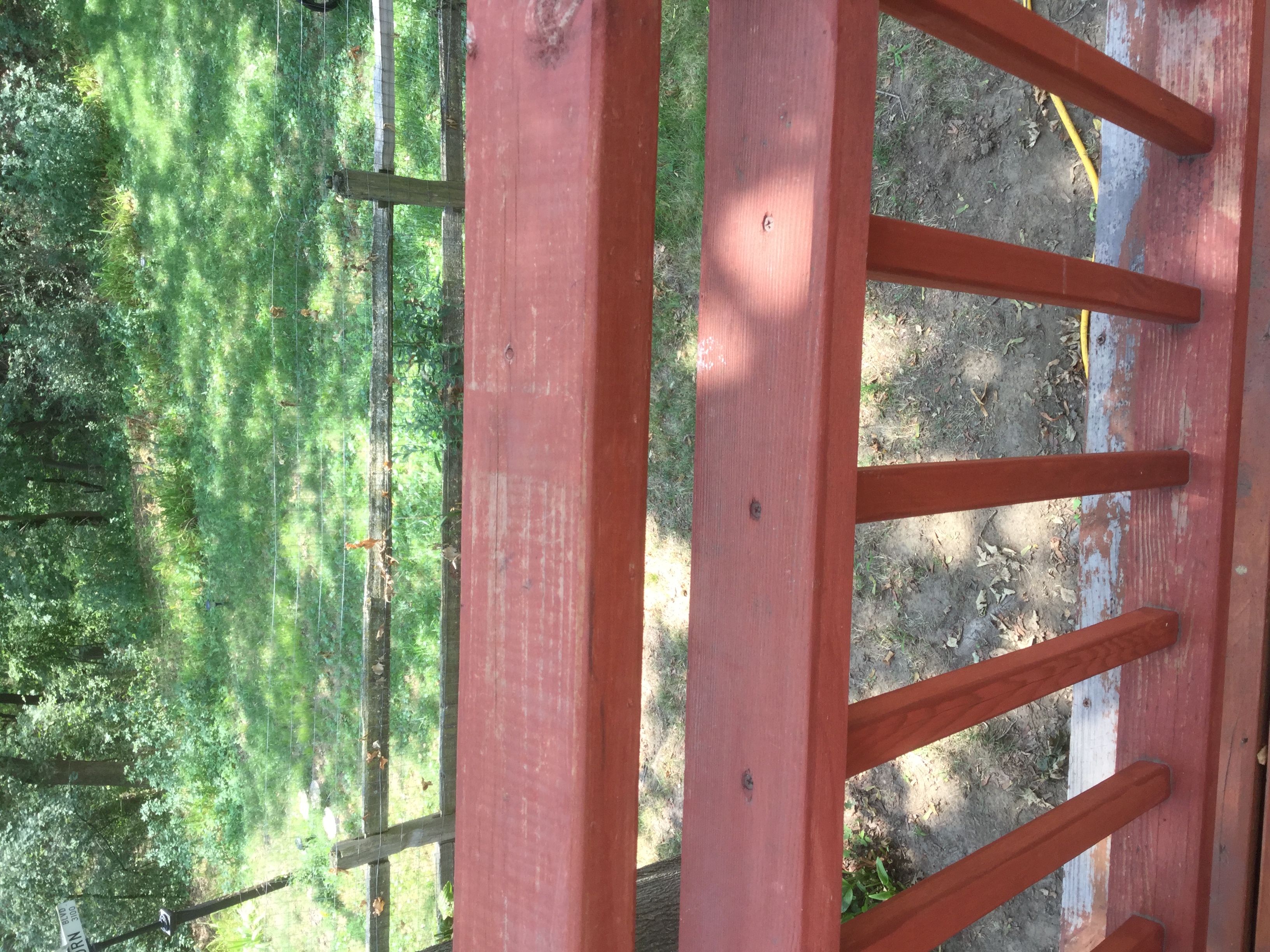

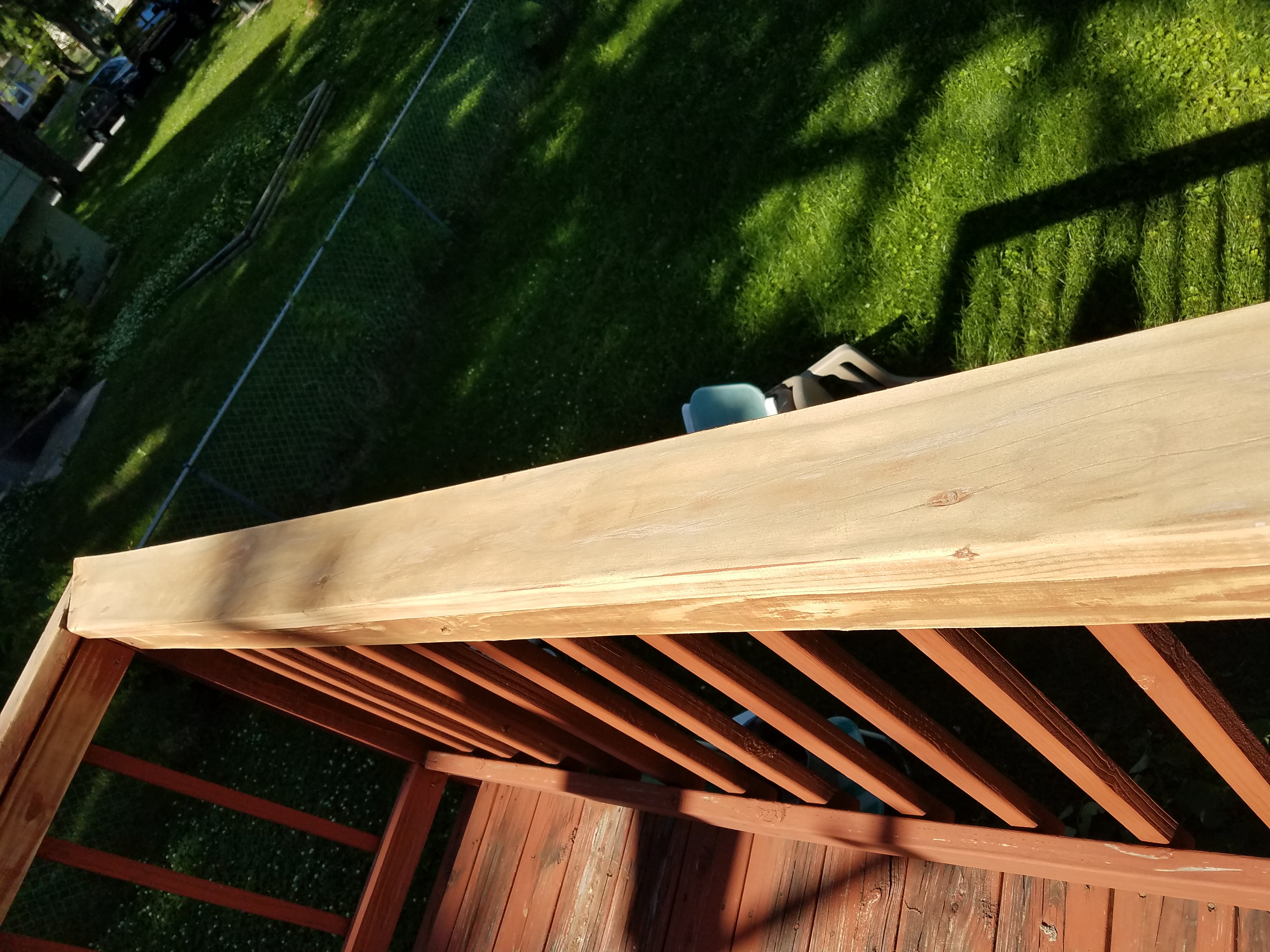

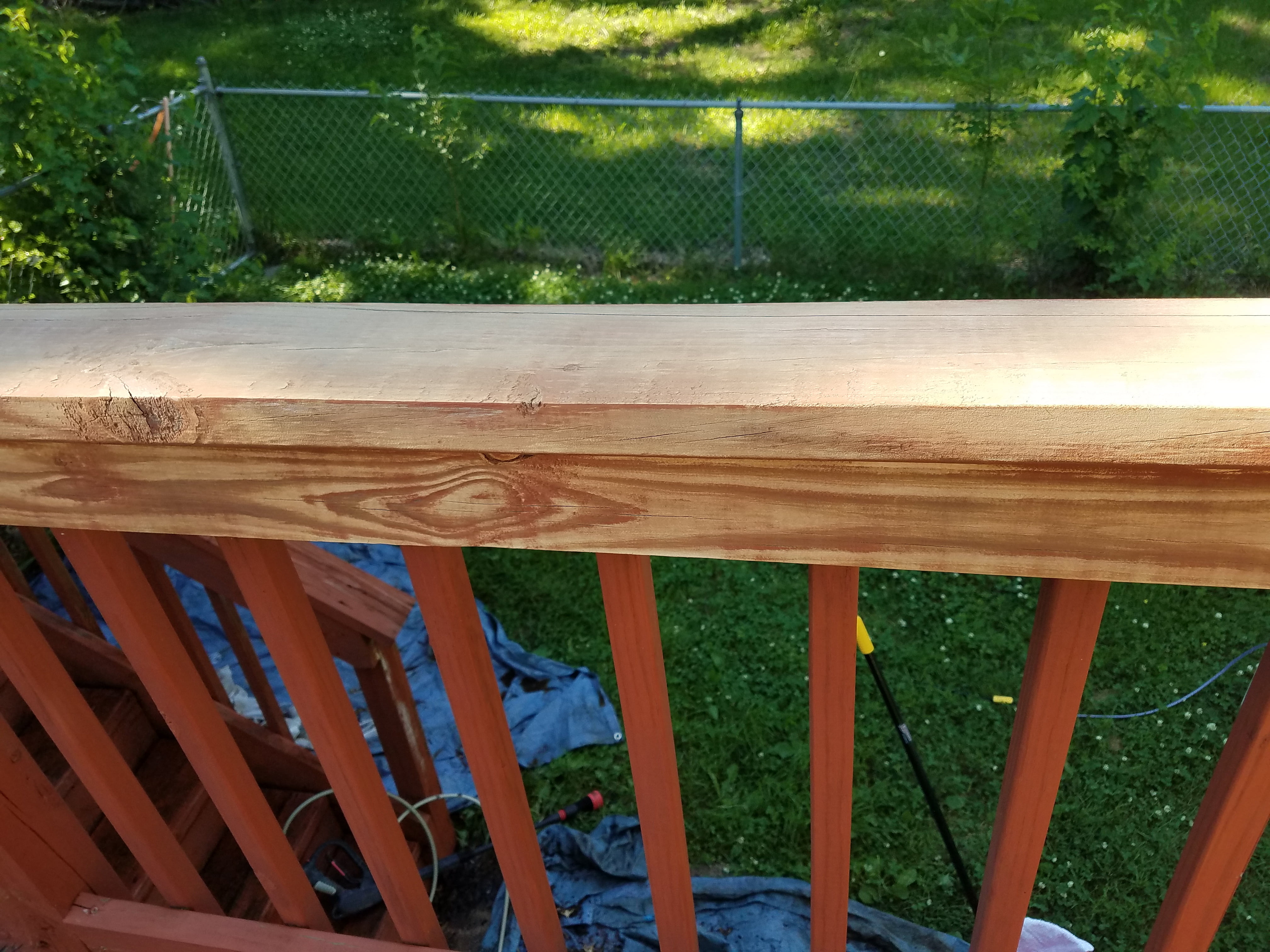

Hi. Love your forum. I stained my deck with a red semi transparent from Behr 4 years ago. It has faded/blackened on majority of horizontal but the vertical spindles still have more than adequate color. I decided to start stripping/sanding the railings and it is a slow go. Using a hand sander and 40 grit I am getting about 70% of the railings done but there are flashes of red. Does it all have to be off or just a majority for it to adhere to new stain? I am using a dark brown from TWO. I have also tried stripping with the Behr stripper and it is slow. It doesn’t seem to remove a majority of stain after scrubbing and 2 applications. And I am getting exhausted after just an hour of this. Any help to get this off? Thx
95% or more removal when switching to a brand like the TWP. Apply the stripper and pressure wash off.
Some reason I can’t post a pic. Trying to see if this is considered 95%. 40 grit
Pretty close for the top rails. I think it is good if you get all of the deck to look like this.
Ok thx. I think when I get it all like that I will still apply stripper. Then clean. Then stain
