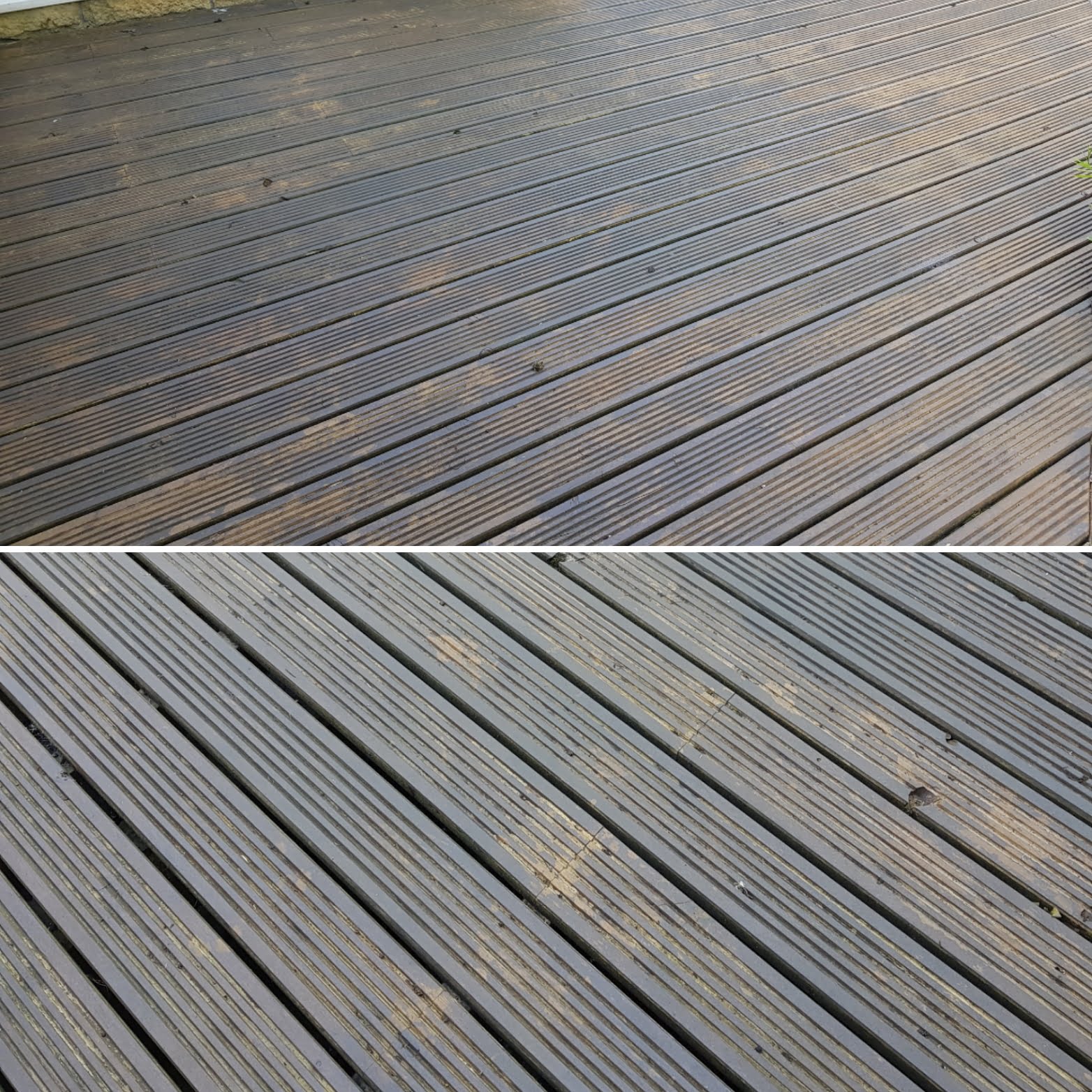

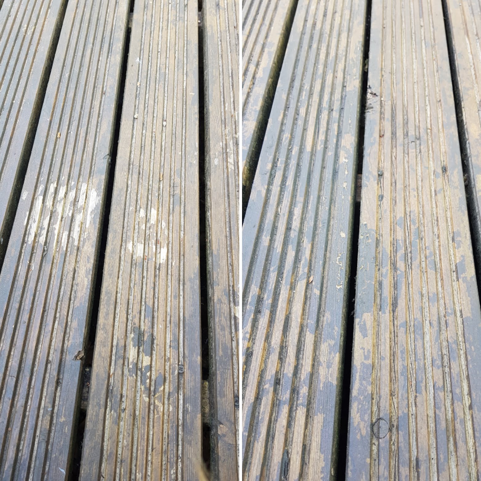

I have bought some Ronseal Paint Stripper – will that do the job?
Many thanks
Photo 1
Photo 2
Please let me know if you require any more
Looks like a solid stain and that cannot be stripped. You will have to power sand to remove.
Thanks, can you still power sand when the wood is grooved?
Thanks, will power sand be effective even though the wood has lots of grooves?
Probably not. You may be stuck with another solid stain.
Thanks for the advice – at least I know not to waste my time trying to remove!

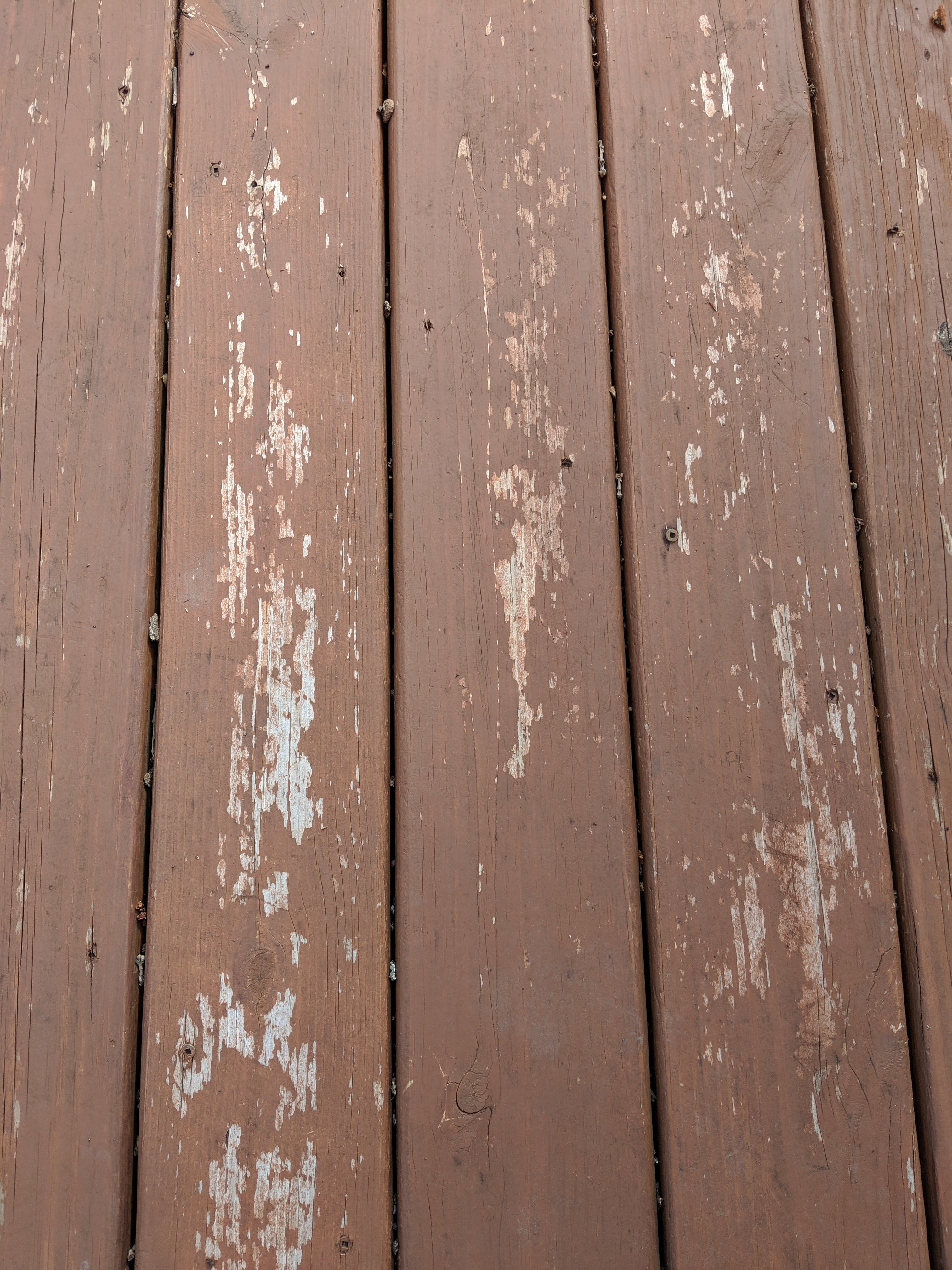

My deck is about 8 years old pressure treated wood quite large last summer, my contractor cleaned it with Pittsburgh ultra deck cleaner and restained it with Cabot semi-solid redwood stain. now everything is peeling what do we have to do to fix this? I live in Central ohio.Thanks so much for advice.
Most likely have to power sand this to fix. Feel free to post a picture.
Following up had to wait for rain to stop. Two photos today.
Yes, you will need to power sand this all off to fix.

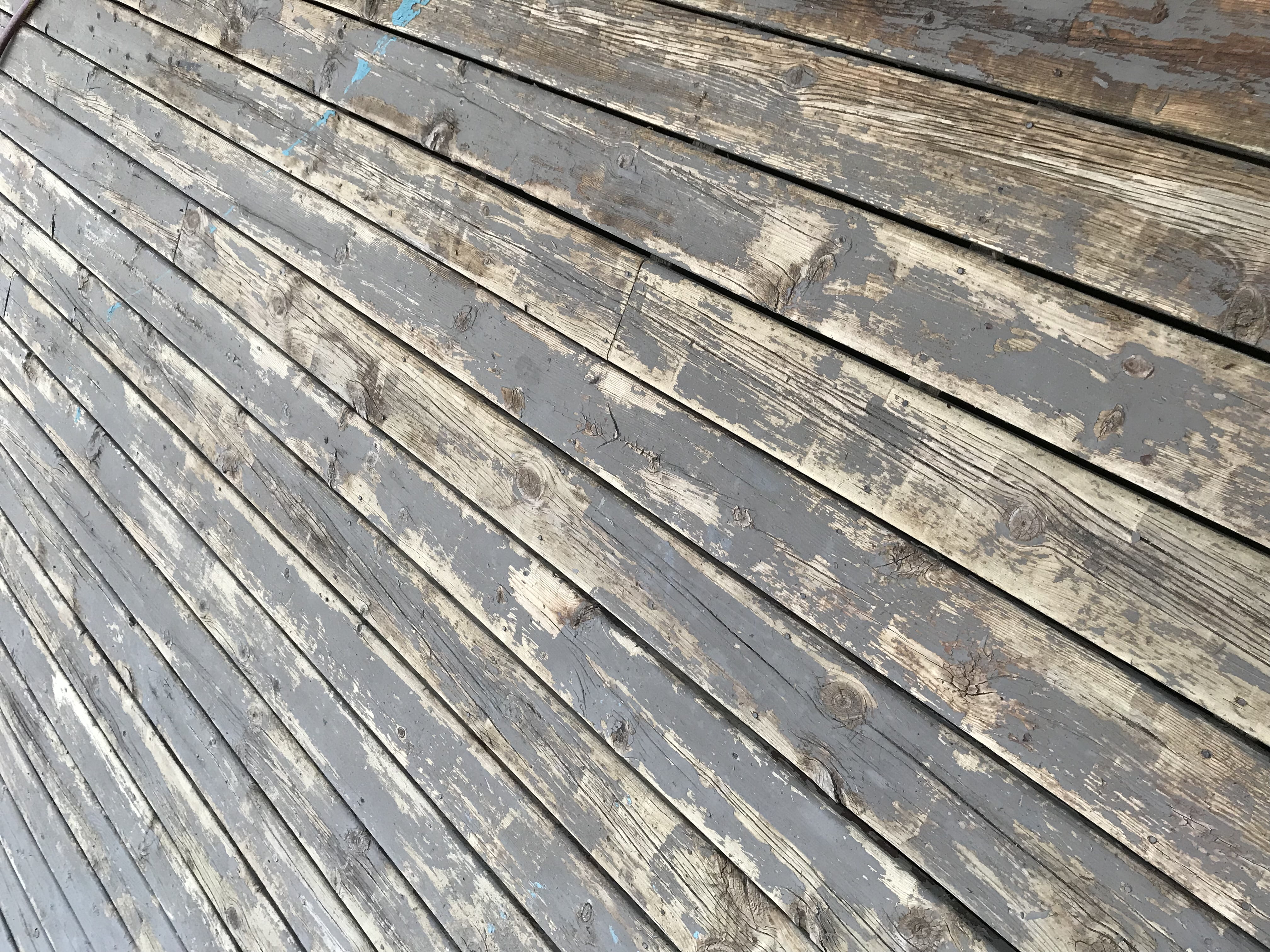

I have power washed off as much as possible. Is there a stripper that is pet friendly? What stain would you recommend for a redwood color?
You cannot strip this coating. It is multiple layers of a solid stain or paint. You will have to power sand this to remove it.

I used a semi-solid oil stain (BM) on my deck last spring/summer and it’s peeling on some boards already. Should I chemically strip what comes off then belt sand any remaining stain? (Usually I use semi-transparent but liked the colour the semi-solid provided.) Duh! Thx.
Arborcoat? That cannot be stripped effectively. You may get some off with the stripper but you will need up sanding to remove all. Make sure and do a light wash after the sanding for the final prep.
Yes. Arborcoat. Belt sander? 60 grit? Thanks.
Yes. 60-80 grit.
