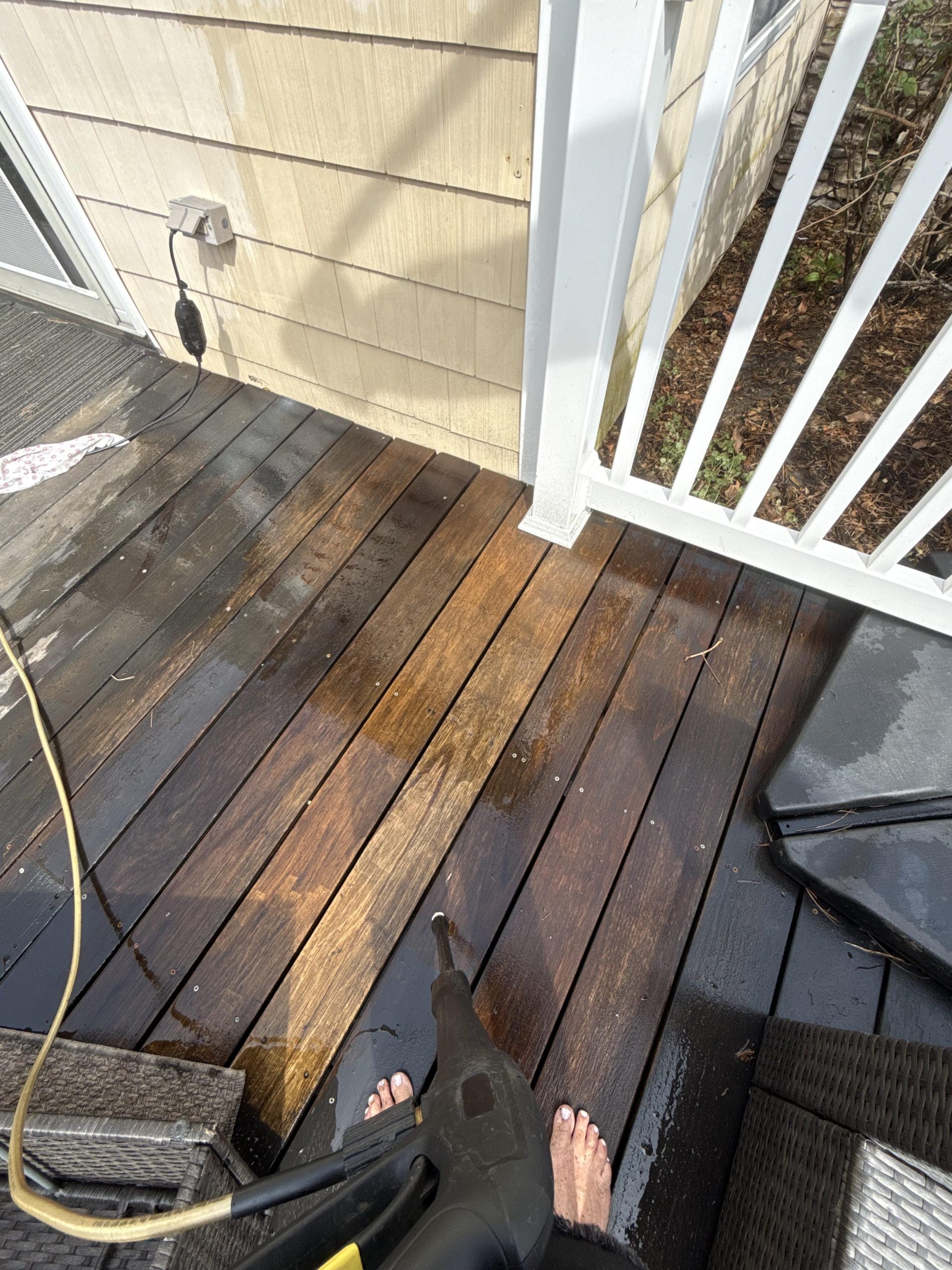

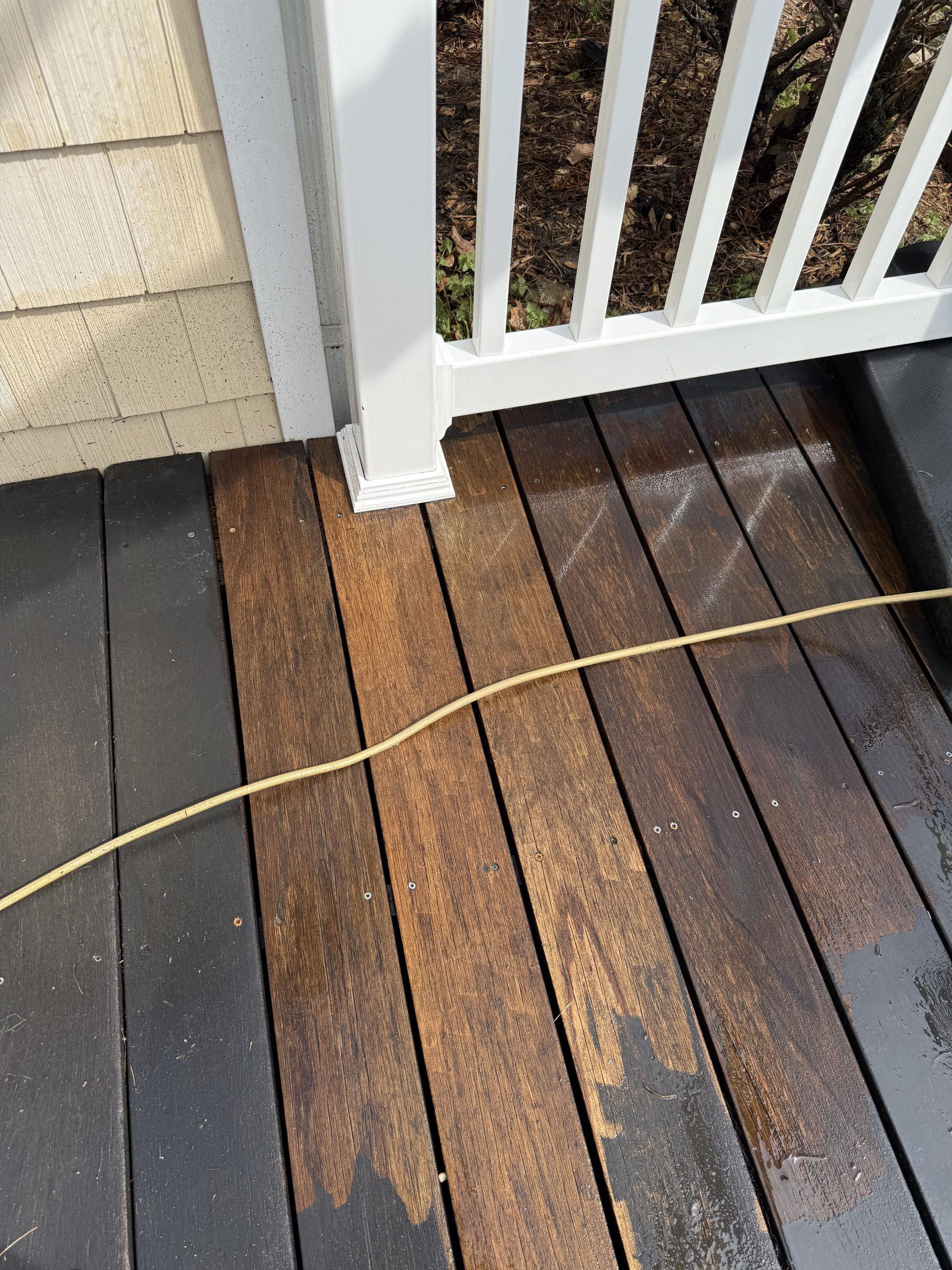

Our deck had been stained black by previous owners. I started power washing it and the black is coming off. Although, I figure out what type of wood it was built with. Is there a way to figure that out?
Your information was great to read.

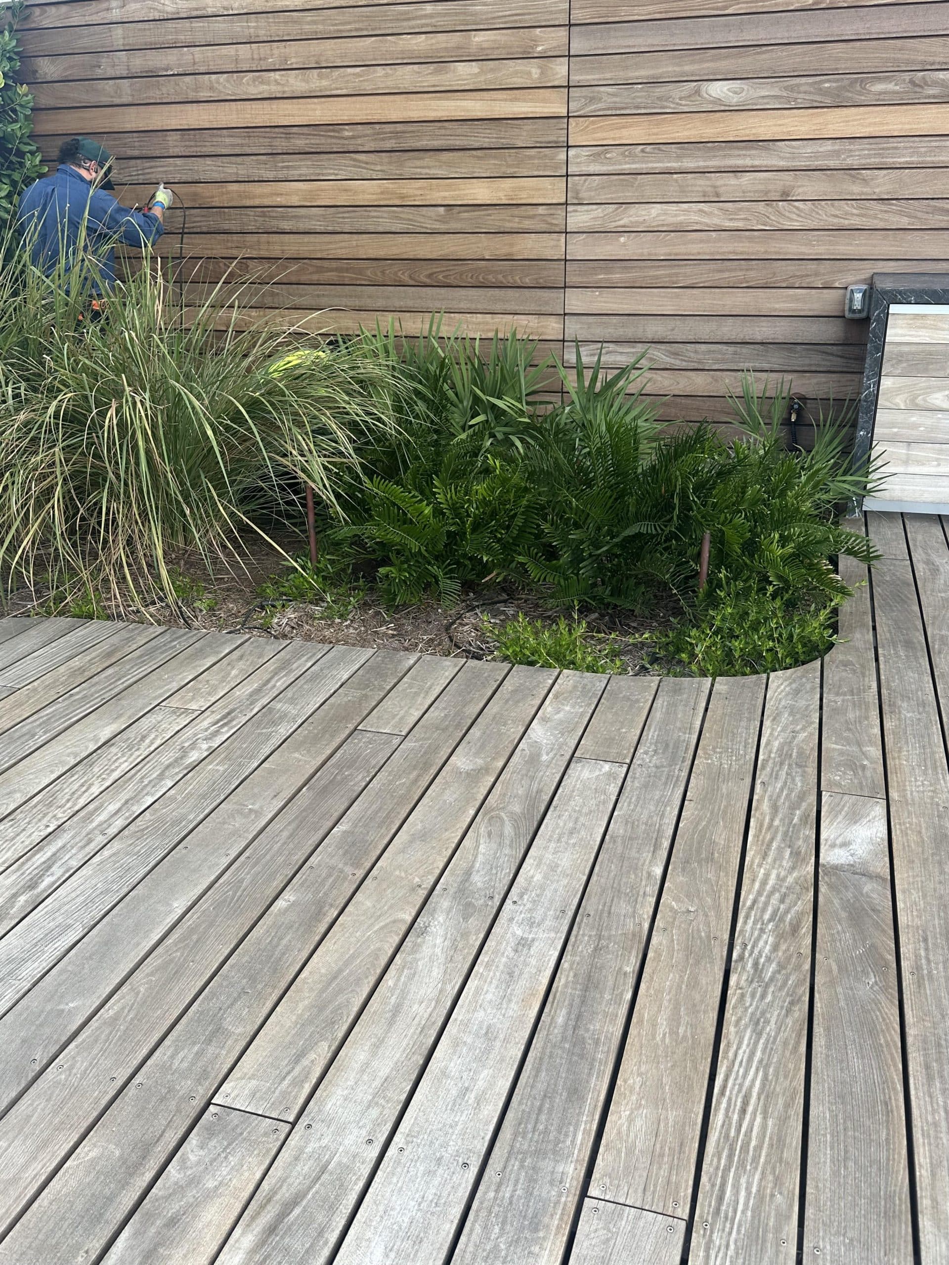

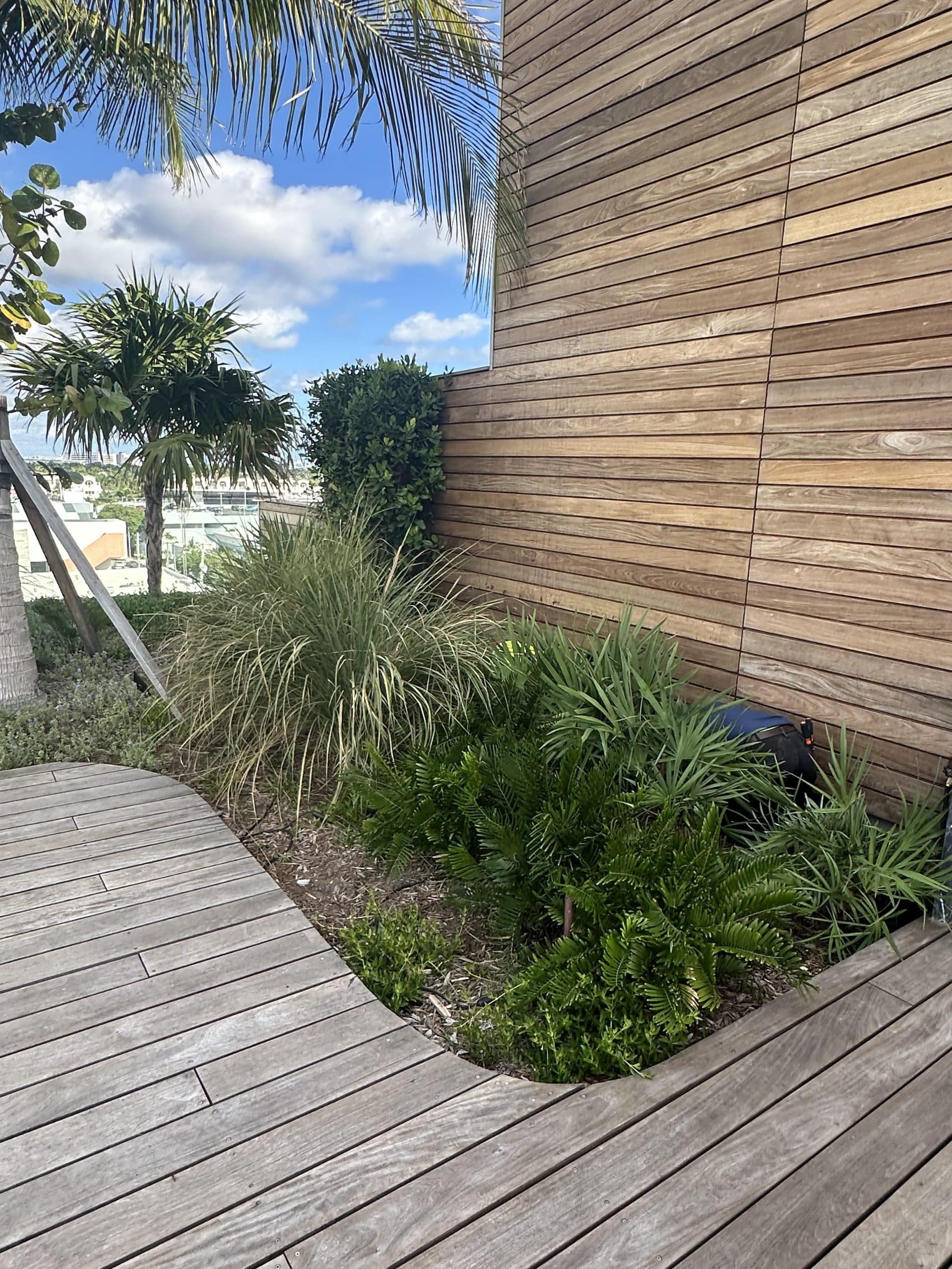

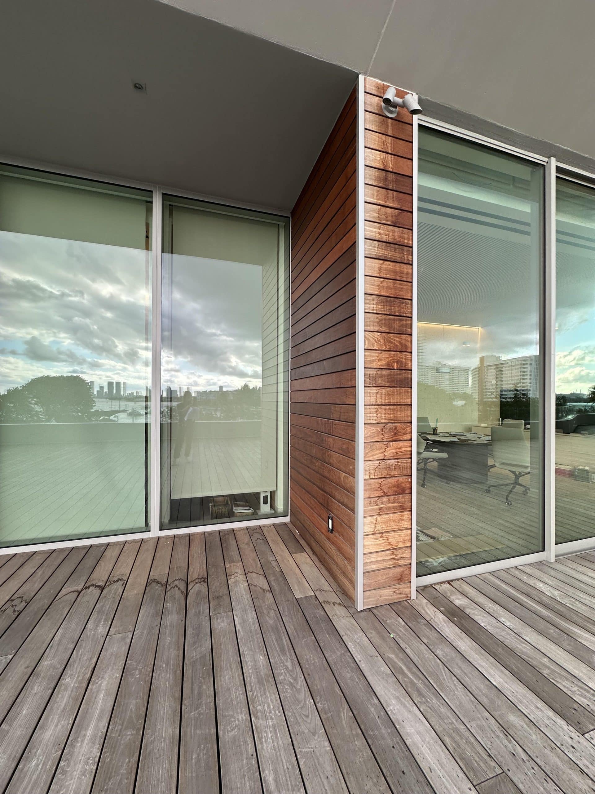

Hi, I have ipe wood decks, walls and roof deck in Miami Beach. If I want to let it gray naturally, do I still need to clean and brighten annually?
If I want to oil it, what’s the best cleaner, brightener and oil for uv, salty air, and a clear oil for a natural look!
If you clean and brighten annually, you will remove the gray oxidation.
If you want a clear oil with no tint that allows the wood to gray naturally, consider the TWP 150 Series in “Clear”.
FYI, colors that say “natural” are tinted, not clear. It must be clear if you want it to gray naturally.
Do I need to oil it annually? Do I need to clean and brighten it annually? And are there other products to use to clean and brighten than the typical ones? We have waterproofing under the deck and I’m concerned about damaging it. Also, what ongoing maintenance do I need to do between cleaning and brightening (assuming that I have to each year). Part of my issue is not everything is changing at the same rate. And also the wood looks dirty.
I need to figure something out that’s relatively easy to do so it doesn’t disrupt tenants. Thanks!!
Yes, prep and redo every year. You use the same products for prep every time, then recoat with the same stain. It will not harm the waterproofing.

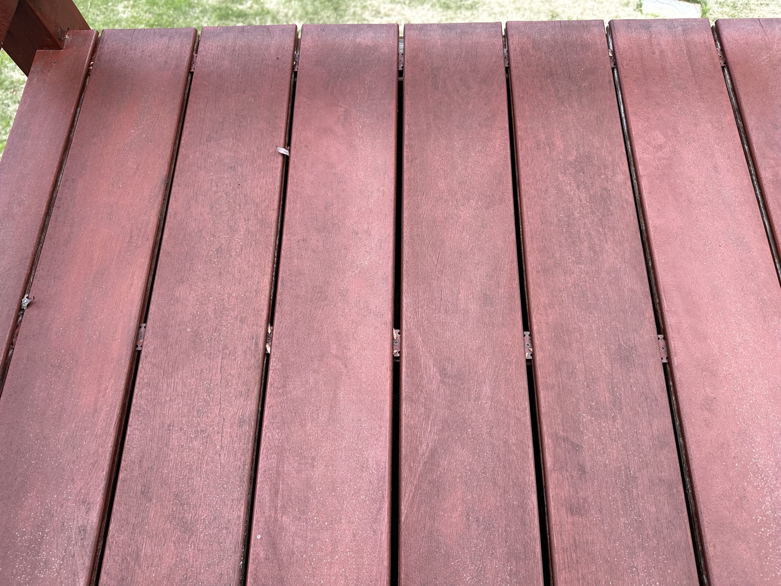

I stripped / brightened my deck 2 years ago then stained with TWP 100 redwood. I then cleaned and brightened 1 year ago and applied TWP 100 redwood. I just ordered and received a 5 gallon bucket of TWP 100. I now learned that my deck is IPE wood (I didn’t know that). I read you don’t recommend TWP 100 on IPE. Should I return the stain, and use restore-a-deck?
Are you sure it is IPE? Post a picture in the comments.
FYI, TWP will work on IPE as long as you know it will need to be recoated annually due to the density of the IPE.
Pics attached; it is dirty, have not yet cleaned this spring
It is a hardwood, not sure if IPE though. Honestly if this is one year old then the TWP is doing an excellent job. I would keep with it.
Thx! Will stay w TWP. Last question: after using cleaner is it still recommended to use brightner on hardwood before re-staining?

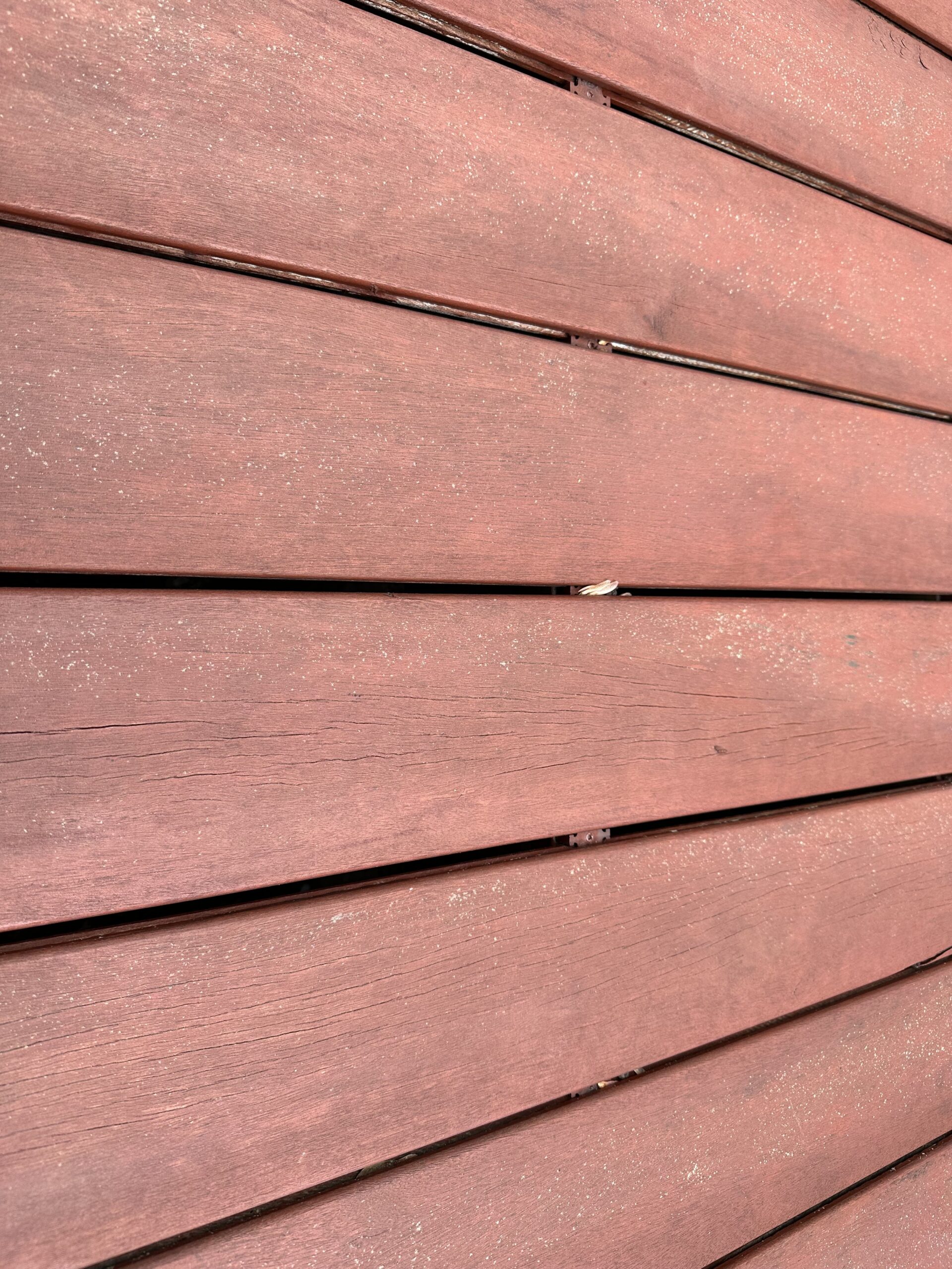

I have a mahogany porch that I’ve used Defy Deck Stain for Hardwood in Pine. I have trouble doing the wet on wet 2 coat application as it dries so quickly. I also find that I have to wait at least 2 years before I can reapply the stain because the stain doesn’t adhere over the old coat until it’s very worn and I haven’t had much success with the stripper products that I used.
Does anyone have a recommendation for a better stain to use such as the Restore-A-Deck, Armstrong Clark or some other that is designed for an exotic hardwood such as mahogany? Thank you.
Try the AC but make sure to fully remove the old coatings first.

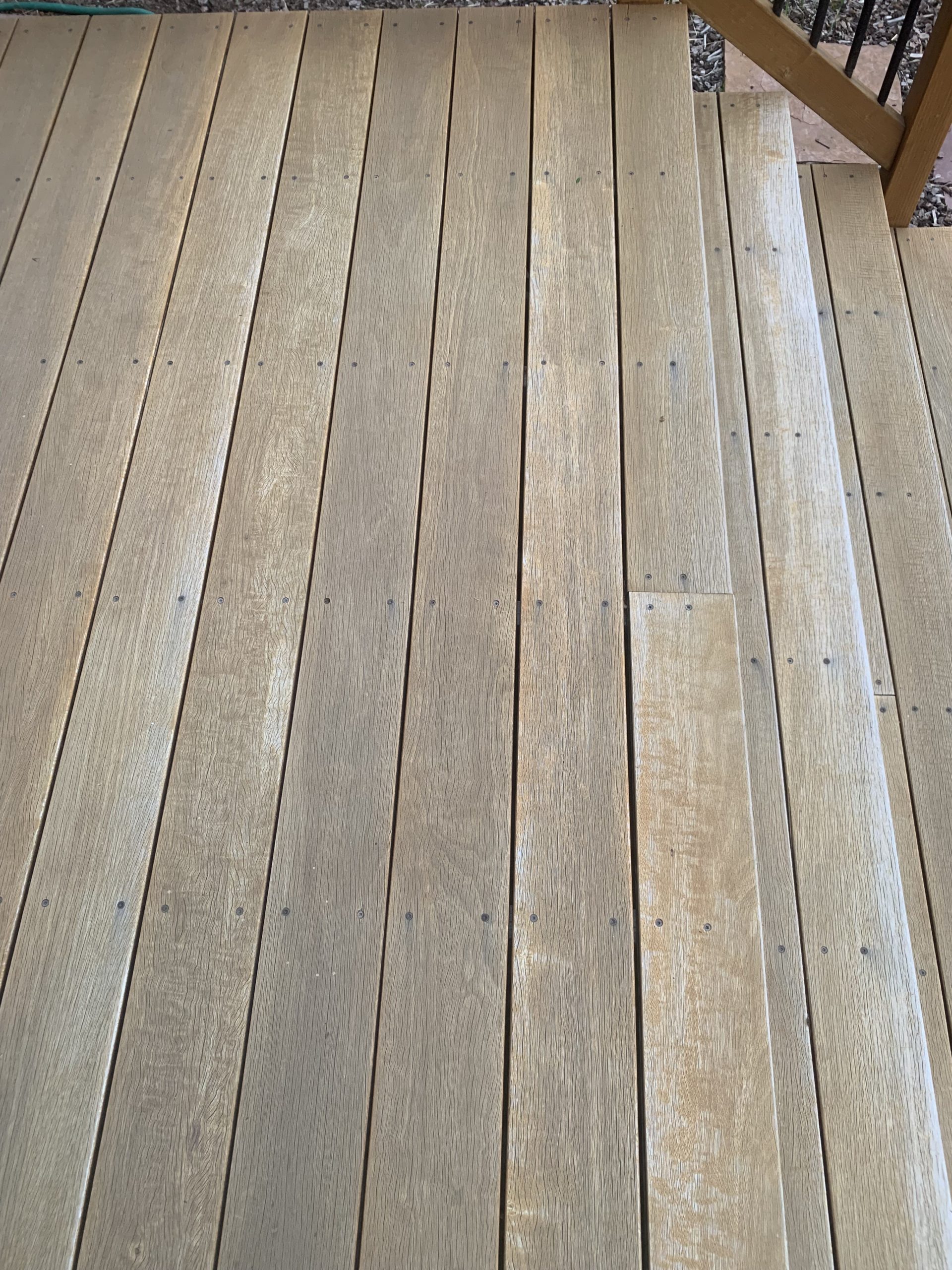

I am not sure what type wood this is or what I would need to use to protect or make uniform in color. I’m in New England so don’t mind the weathered gray look. Just need to treat / refresh so it looks more uniform.
Looks like IPE or Mahogany. You will need to clean and brighten the wood first and then use a hardwood stain like the ones mentioned in the article above.

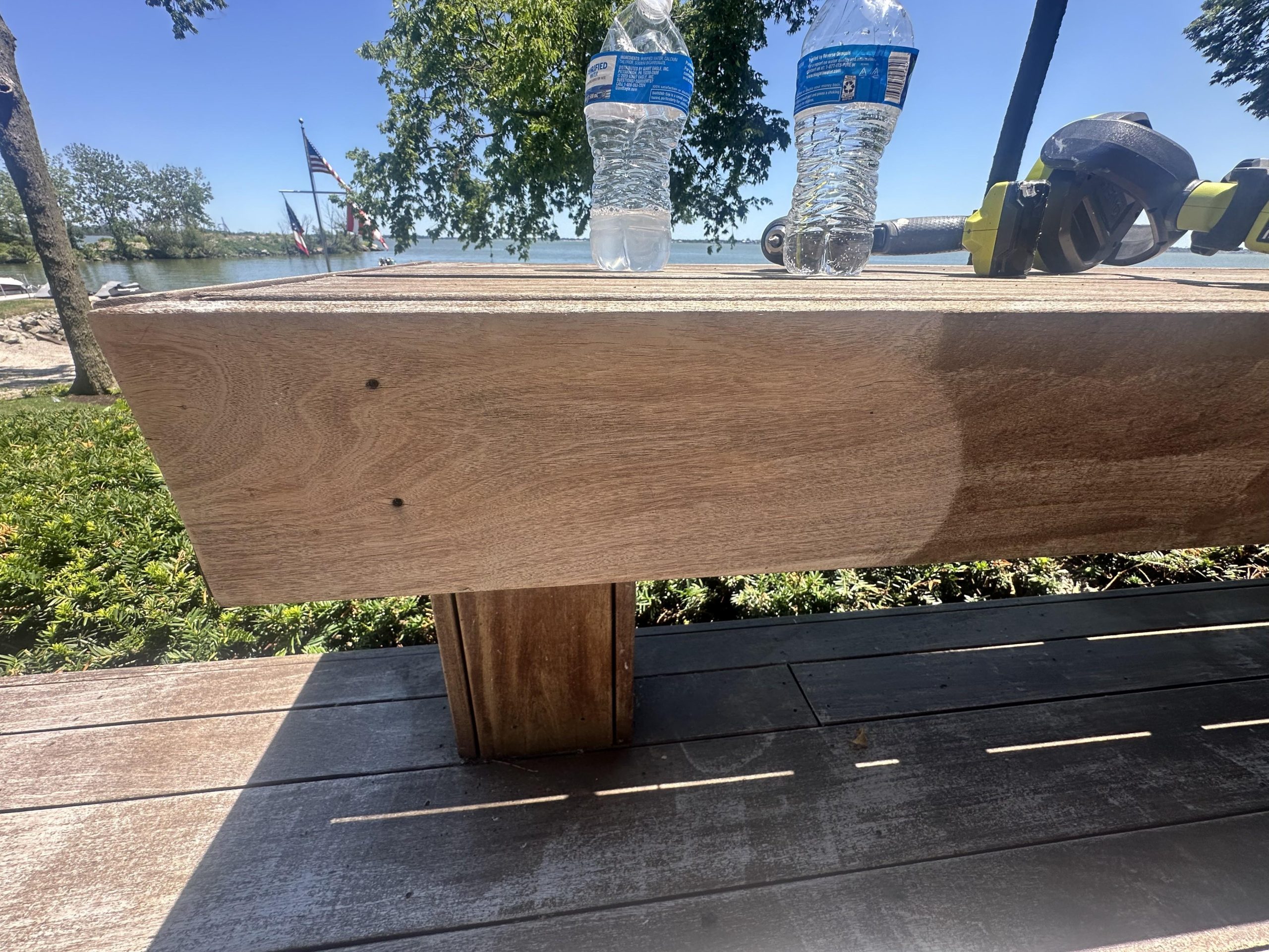

What is the best clear sealer for a mahogany wood deck?
Must be tinted for UV protection from graying. Try Amber from Armstrong Clark or Restore a Deck Stain in Natural.
I do not mind if the deck turns gray. I just want to give the mahogany some protection. The deck is one year old and I am planning to powerwash it and then apply something. I am trying to figure out what to apply.
Use TWP in Clear. It will gray naturally but protected from other elements.
I have 5 month old ipe deck that weathered Ct. shoreline winter. I want to stain it. I’ve decided on Messmer but torn between natural and mahogany semi-transparent. I want to retain the natural color. I’ve read the natural will a) fade more quickly and b) won’t protect against silvering- which is the point. But I’ve also read that it does protect against silvering. Which is correct? Will the mahogany change the color forever?
The Messmers Natural is tinted, not clear so it will provide UV graying protection. Both colors will fade naturally and will need to be applied annually on IPE.

I was getting ready to grab some Penofin and I was told that I can’t or maybe shouldn’t apply it to a deck that had been previously treated with another product. If it does have another product on it then I need to wash it and sand it down …. I really don;t want to go through sanding the deck down because it looks “fine” and just dry. Was the representative correct in telling me not to put Penofin down over a different product?
Yes, and that goes with any brand of stain. You have to remove current coatings when switching brands. You will have to do this when you switch from Penofin after it turns black or dirty on you.
