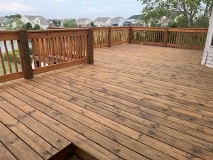

I am in love with the deck at the very top of this web page. Was wondering what color that was so I could do my deck the same.
