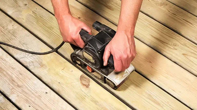

- Belt Sanders: Ideal for less-experienced DIYers, these handheld tools are effective at removing old coatings and evening out surfaces.
- Orbital Sanders: Best for small to medium-sized decks. Be cautious, as they can leave circular marks if misused.
- Floor Sanders: These large machines cover more area quickly and work well for larger decks.
- Detail Sanders: Essential for corners and tight spaces, ensuring a professional finish.

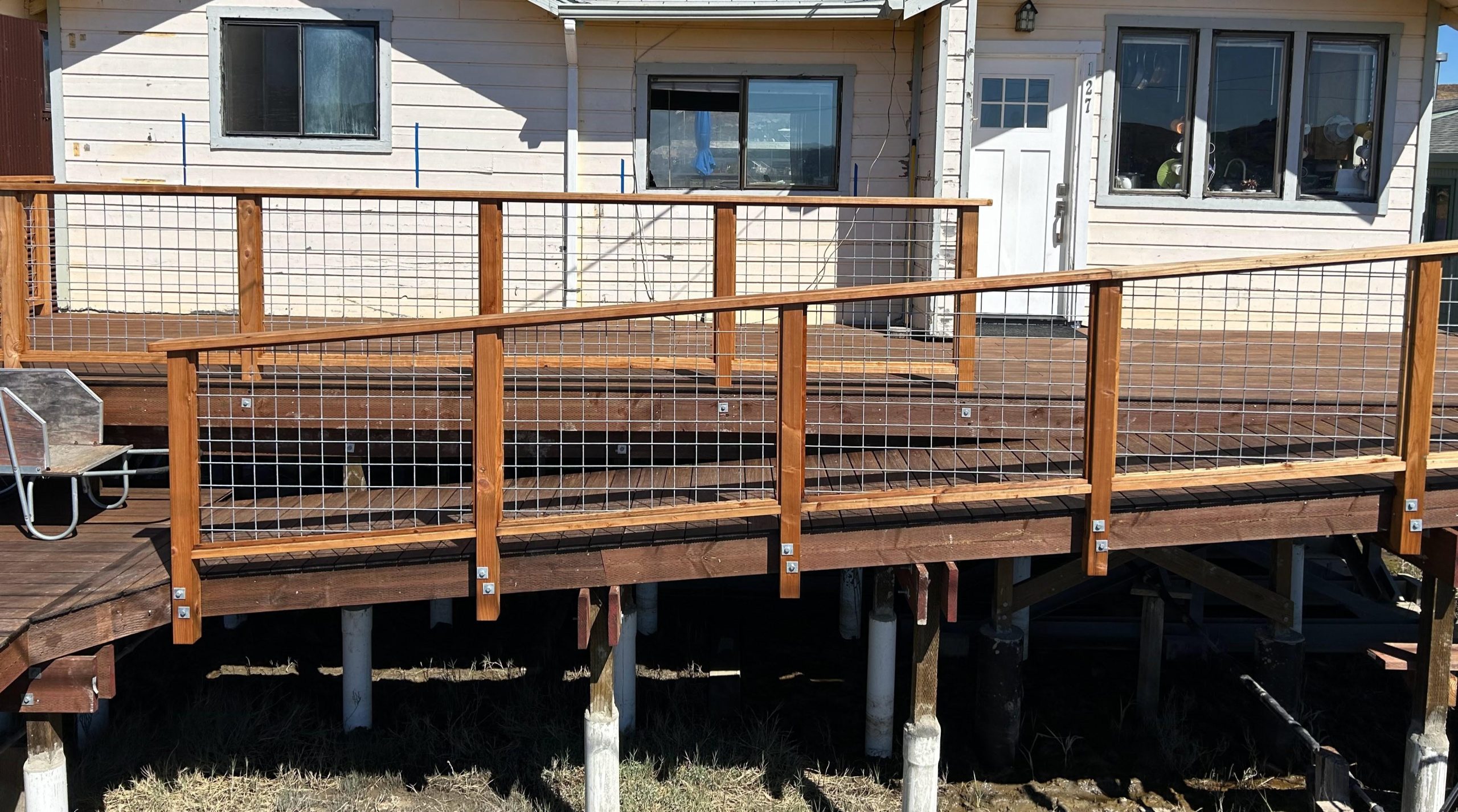

We have a small house by the water of the SF Bay sitting on a marsh .Without trees for shade and with direct exposure to marine winds and elements, it is a pretty challenging environment for wood finishes.

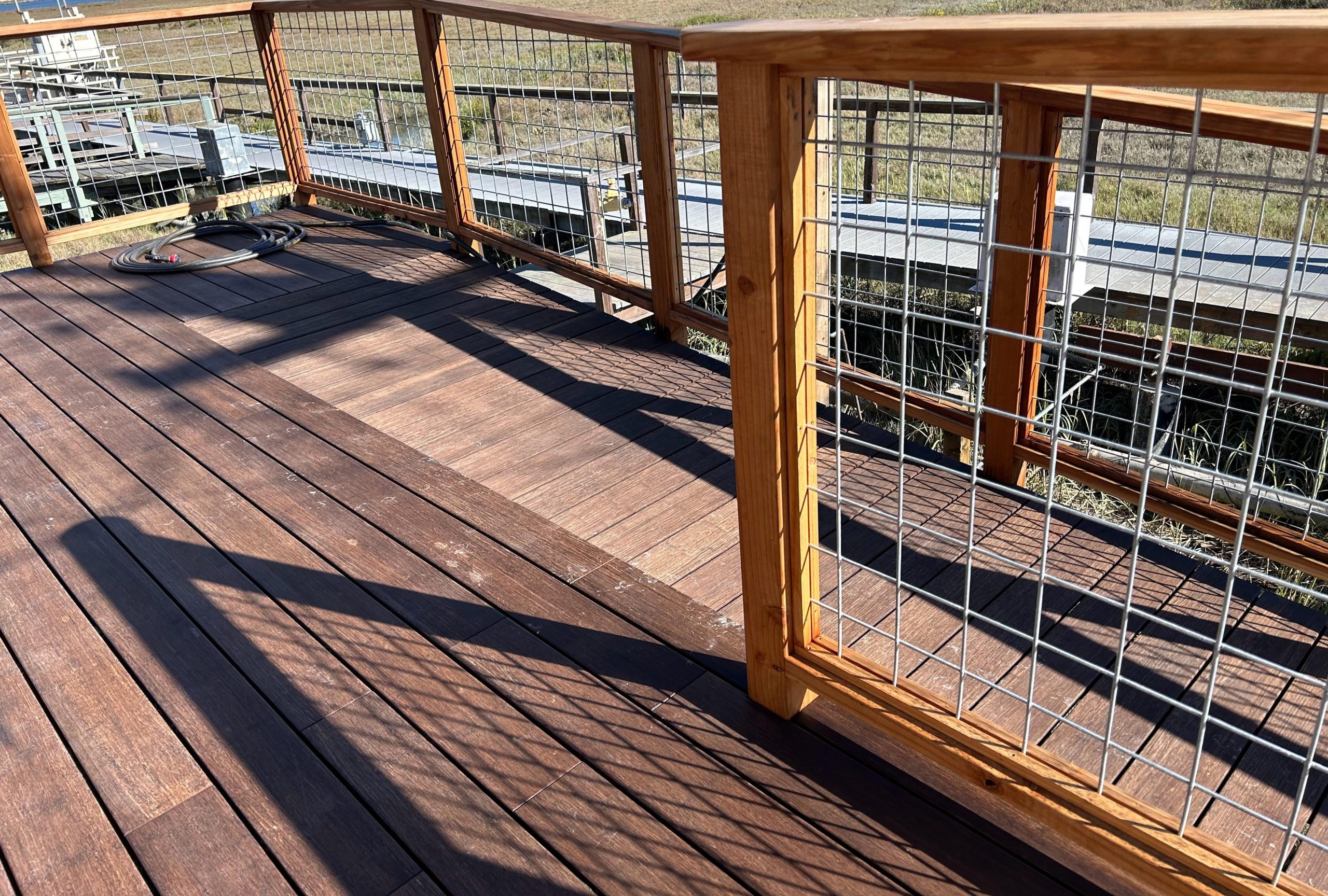

We just had a new deck and ramp installed which has MOSO thermally modified bamboo decking, with heart redwood posts and railings.
We presume the ipe-like decking may be ready to put an initial finish on? Use a hardwood finish product? Lightly sand and/or just use cleaner/brightener before finishing?
What we should use on the railing posts and top boards, and whether to sand the redwood before finishing it (what grit?)
Decking installed late June 2024 and redwood handrails installed August 1.
We will be leaving the country for some months and probably not returning until late summer or fall of 2025.
Thanks for your expertise and experience .
Clean and brighten all wood. Use a hardwood stain for all wood (it can be used on the redwood). No sanding should be needed.

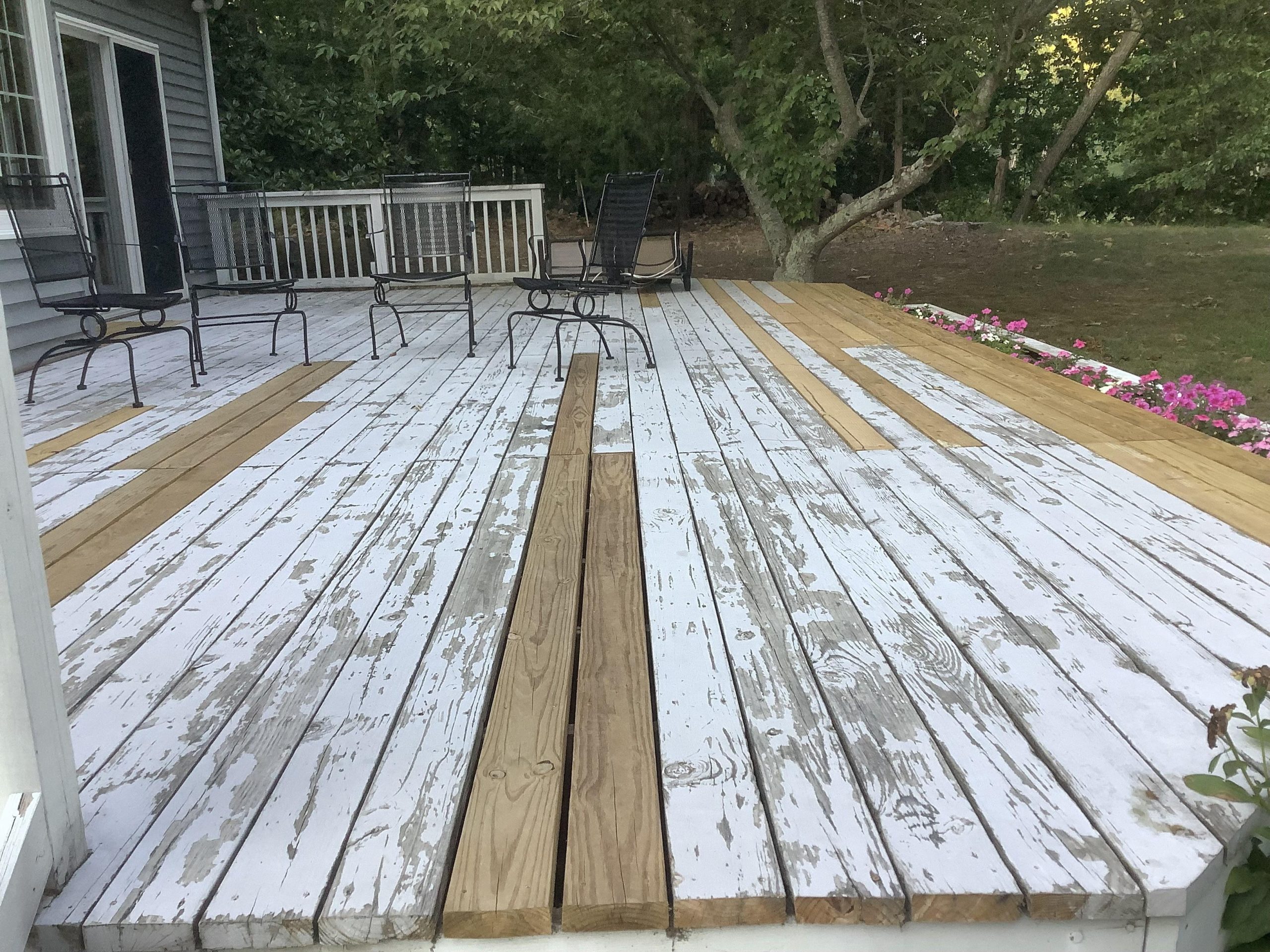

I have a large deck with solid color stain that is worn off and peeling off in places. A mix of now stained areas and bare wood on each board. I have replaced some boards. The “boards” are actually 2x6s. I want to sand the deck. What floor sander is best to use, an orbital sander or belt / drum sander?
Are you removing 100% to switch to a different opacity stain or reapplying a solid stain?
Scott,
I found your questions about refinishing, see below. To answer directly I am thinking of replying a solid color, as I understand that is supposed to be the most durable?
Some new wood otherwise 15 years old see picture
Some solid color stain remains
As above thinking the same.
Ben Moore arborcoat waterborne exterior stain, solid color
see previous question
Some mold? Narrow gaps caused water retention and rot. Replaced boards and tried to open gaps.
Water retention I think. Thought we had go adherence initially but didn’t last two years.
Should I clean? Strip? And sand? And in what order? Should I wait to restrain given the replaced boards?
