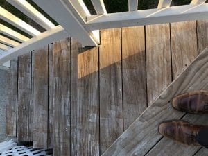

We have a 17 year old pie deck that some moron stained with a water based stain!!!!
Can you suggest a process to refurbish the deck?
Picture, please of the current condition.
Photo from today
Strip and brighten the wood for the prep. Stain with Armstrong Clark in one of their hardwood colors.
Thanks for the fast response. Sorry I did not respond sooner.
As soon as I find a suitable contractor I will be ordering the stripper and brightner along with theAC stain.
My deck is approximately 500 ft2. How much of each would you estimate?
TD
About 3 gallons of stain. If using RAD prep products, you will need one of each Stripper and Brightener.
