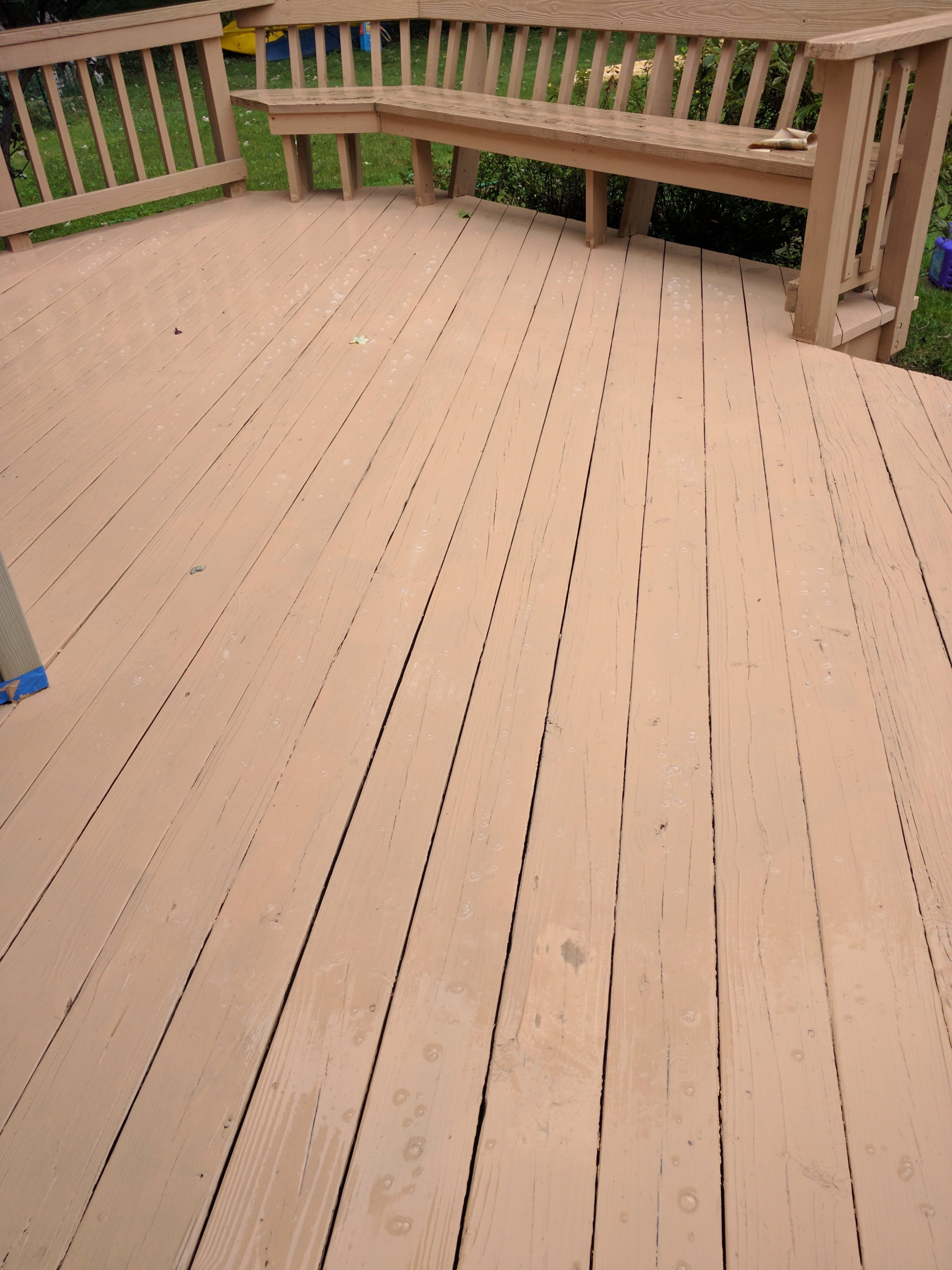

I used a Benjamin Moore Arborcoat, Translucent Classic Oil Finish on my year old deck. It was a nice warm day but that night it rained. Now it has horrible white patches of water damage in areas in shade. I have squeegeed it dry and am hoping the next few days of warm dry weather will help it cure and fade the white spots… any suggestions as to what to do if they do not go away on their own? See picture attached. Thank you!
Ugh, that does not look good. Not sure if it can be fixed. I would contact BM and see what they say.

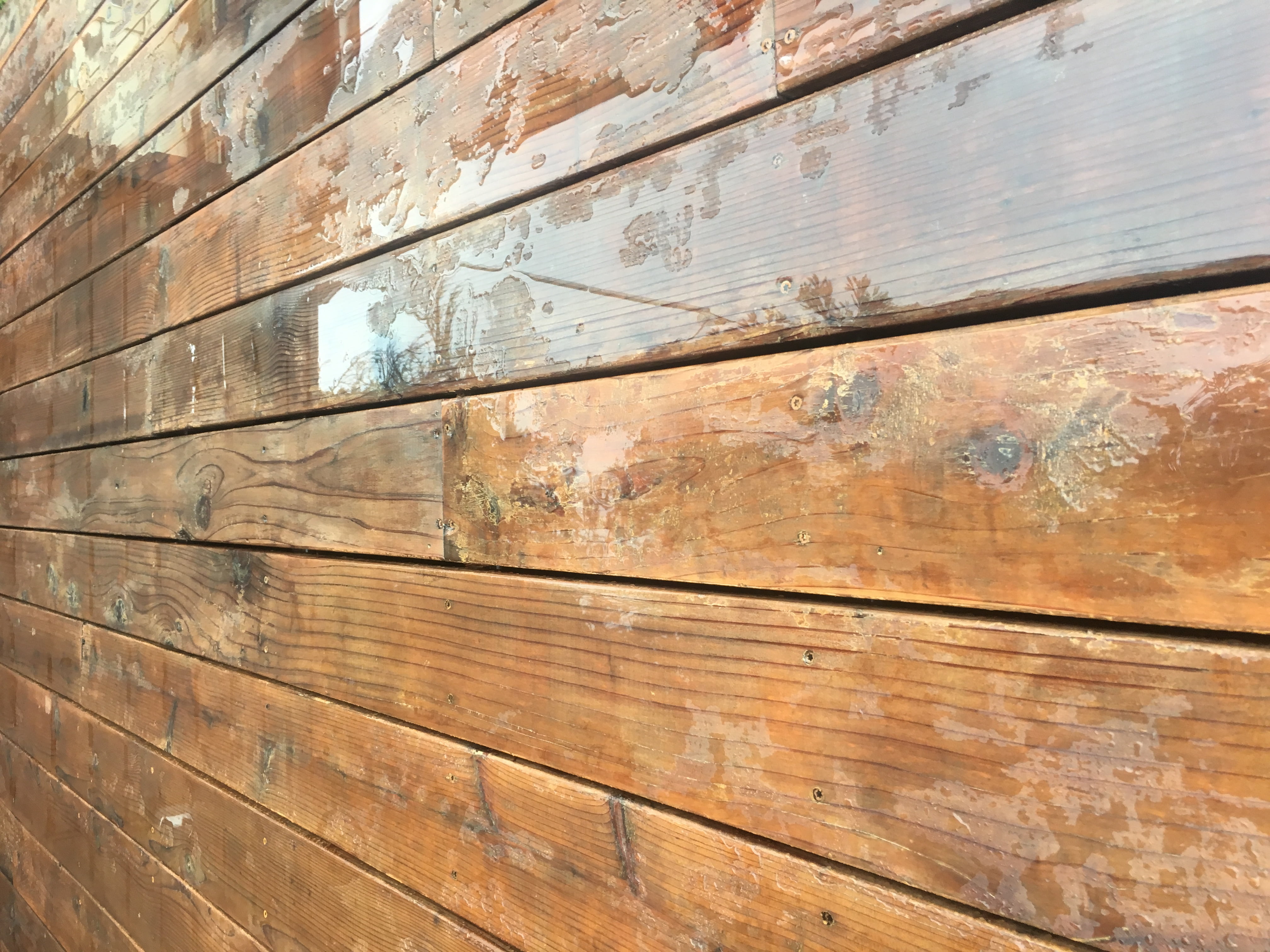

Hi, I stained my deck with Bears waterproofing wood finish and an hr later it rained. It had discolored in some areas so i let it dry for 1 week, but it was still sticky. I put on another coat 2 weeks after, and now one week after that i went to move the plans using a dolly and when i turned the dolly wheel it smeared the stain and it is still sticky. What advise do you have for me please? i live in Fl where it is hard to predict the rain and rains almost daily here….Thank you.
You will have to remove all and start over and that will require scraping and sanding. A stripper will not remove it.

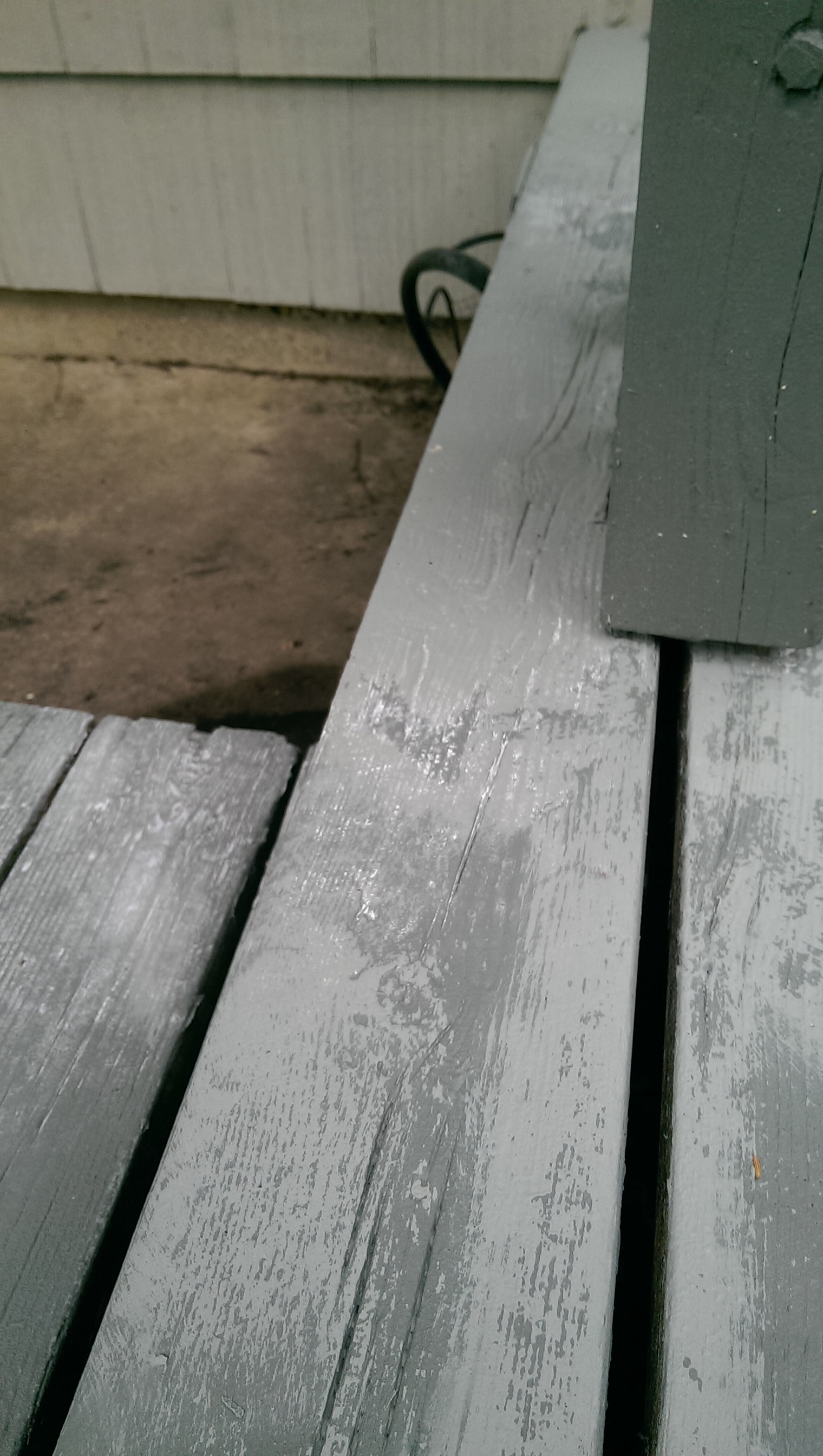

URGENT: Hi, we stained (first coat only due to time) last weekend and everything went well, rained yesterday (6 days later) a little and it’s beading Off and looks as you’d want it to look. My question is can we put the second coat on today 7 days later with no issue? If so any advice? We have Cabot Gold Satin sunlit walnut stain. The package says 24 hours to 7 days, we didn’t have time during the week to get it done. Thanks!!
Sorry but no idea with this new product. Most likely will peel anyhow since it is a film-forming product.

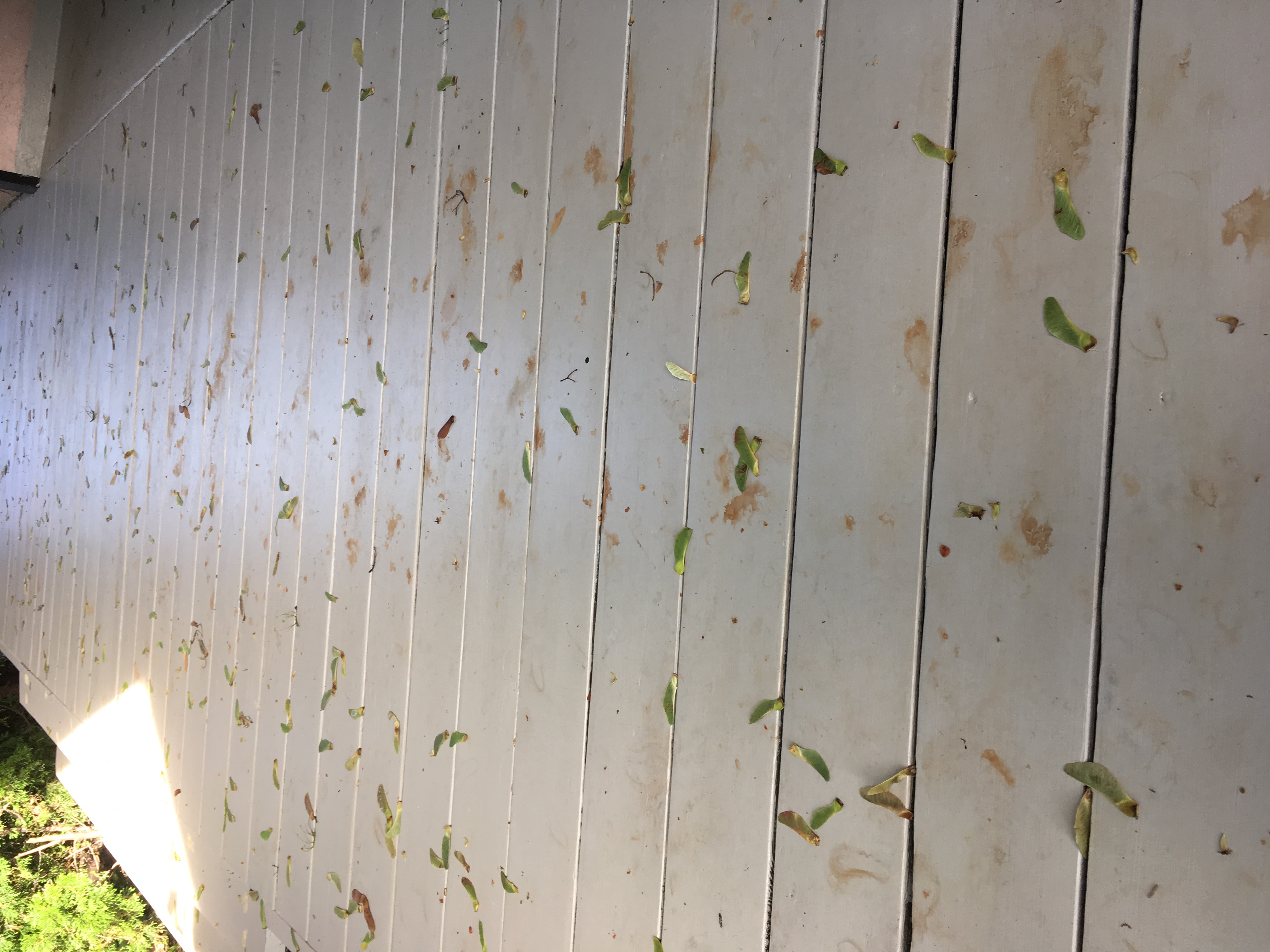

Hello. I love your website. I sanded, cleaned, stripped and brightened in that order. Waited 4 days of dry weather to stain with TWP 100 Cedartone. It was cool and overcast. Finished by 11:30 am yesterday. This morning about 7:30 am it rained. Not a downpour but it left puddle looking water in top of stain. Like beading kind of. I noticed what hasn’t dried yet has a milky look to it. Should I just leave alone? I put on one coat nice and even with a brush and then wiped down with an old T-shirt when finished and it looked amazing. Now worried about the puddling look and the milky spots. Help! I am so upset after following all directions and working so hard to prep and then not forecasted rain!!! WhT should I do? Tomorrow the weather will be high 80’s today is cloudy. Advice please. Ps will it be tacky? Should I apply another coat?
Yes, just leave it alone until the rain stops and it fully cures and dries. Assess after a week to see if it needs anything.
Today it looks better. Sunny and hot today. There just looks like some crystallized small streaks where there is a slight crack in the wood. Think it’s stain. Should I wait a week and run those down with a wet rag? It is supposed to rain tomorrow again. Is the puddles in top of stain mean it’s protecting the wood already? Is that normal. The problem area is the shaded part of the deck where it gets no sun. Last question. How long should I wait to put furniture etc on it for best outcome? Thank you so much for all your help. I feel I have learned a lot from your site!!!
-You can wipe anything now.

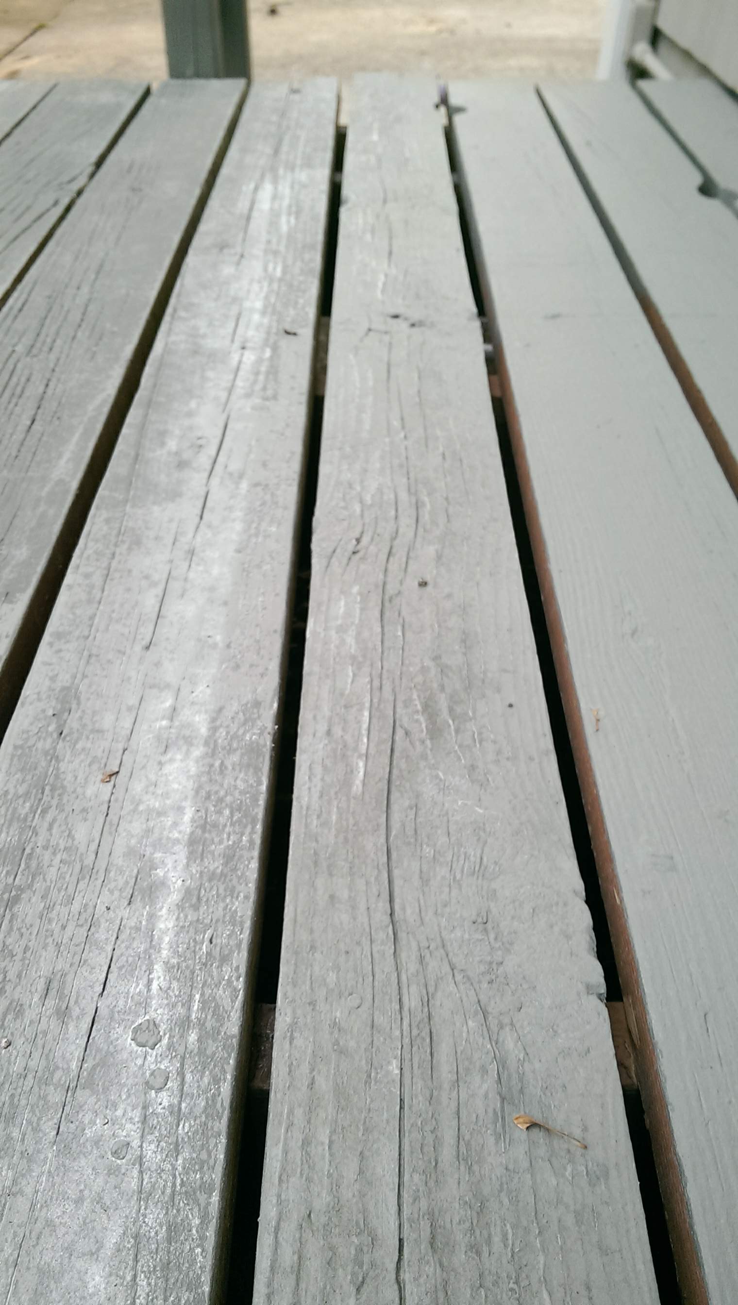

I put cetol on the deck and it got down to 8 degrees and in the morning the deck turned white. What can I do? Is it okay to put the next coat over the white.
No I do not think you can fix this by adding more. You will most likely need to strip if off and start over but best to ask Sikkens for advice.

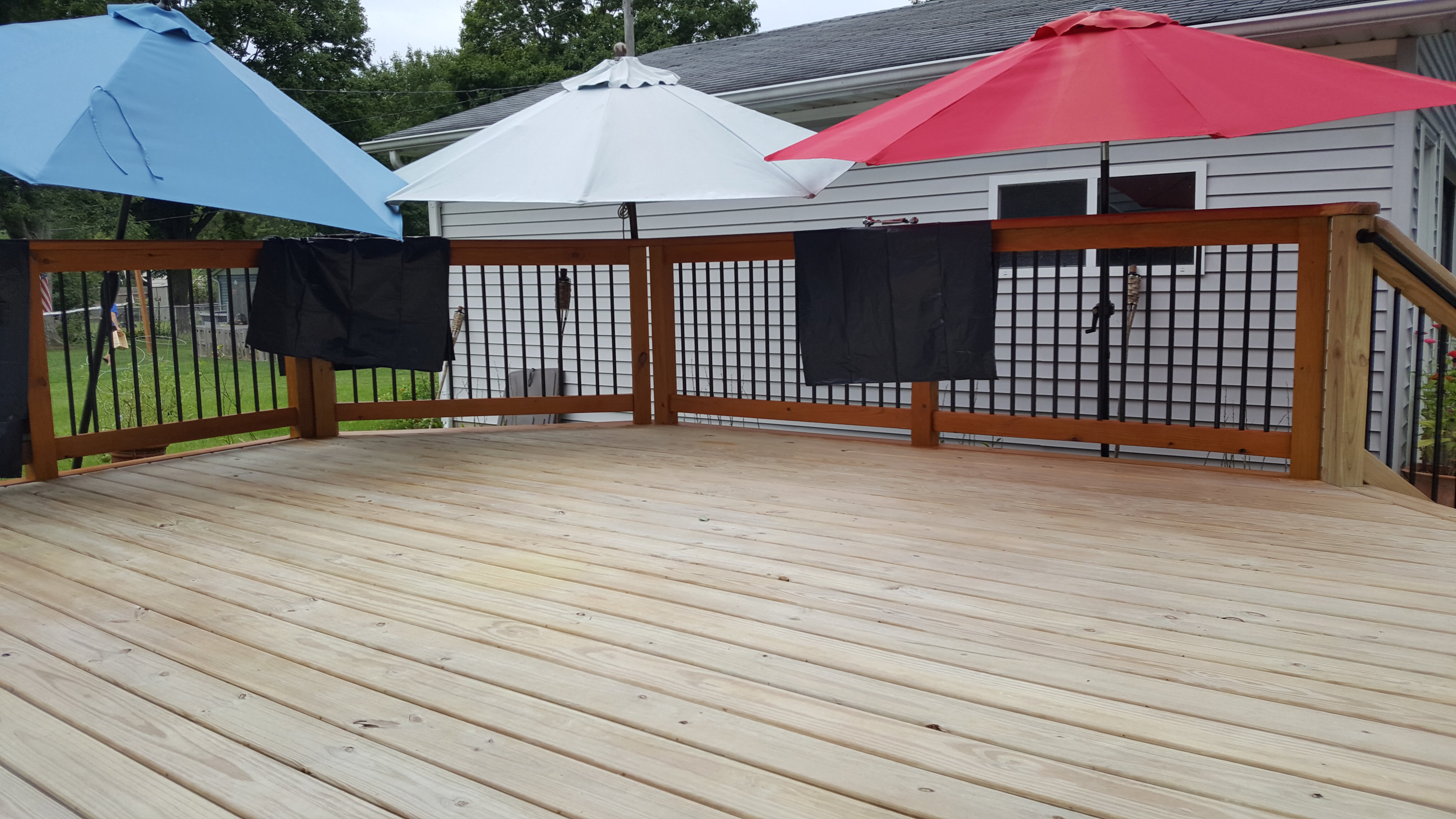

Great forum. Thanks. Used slight tint thompsons water seal. Started early morning, finished half by noon, other half in evening, unforcasted moderate rain around midnight. Next day, no blotches, looks good, but water seems to bead (nicely/correctly) on part finished before noon, and no beading/seal on part finished a few hours before rain. Any input appreciated. Thx
Leave alone. Beading water is not important anyhow. You want it to shed water as the atain should not be 100% sealing the wood and be breathable.

I sanded down deck, then stained, next day rain. The customer complained about how it looks. This was two weeks ago. Can I throw a second coat on? I used sikkens srd re 1 coat oil transparent. Can I just wash it with something then apply another coat. I’m at a loss as to what to say or do as she’s not paying me until it’s solved. Any advice without having to resand would be great as it’s a week worth of sanding and I’m not willing to do it for free as the customer will probably expect.
There is nothing wrong with it in the pictures and the rain did not have any effect on it. I would suggest getting Sikkens to back you up on this.
