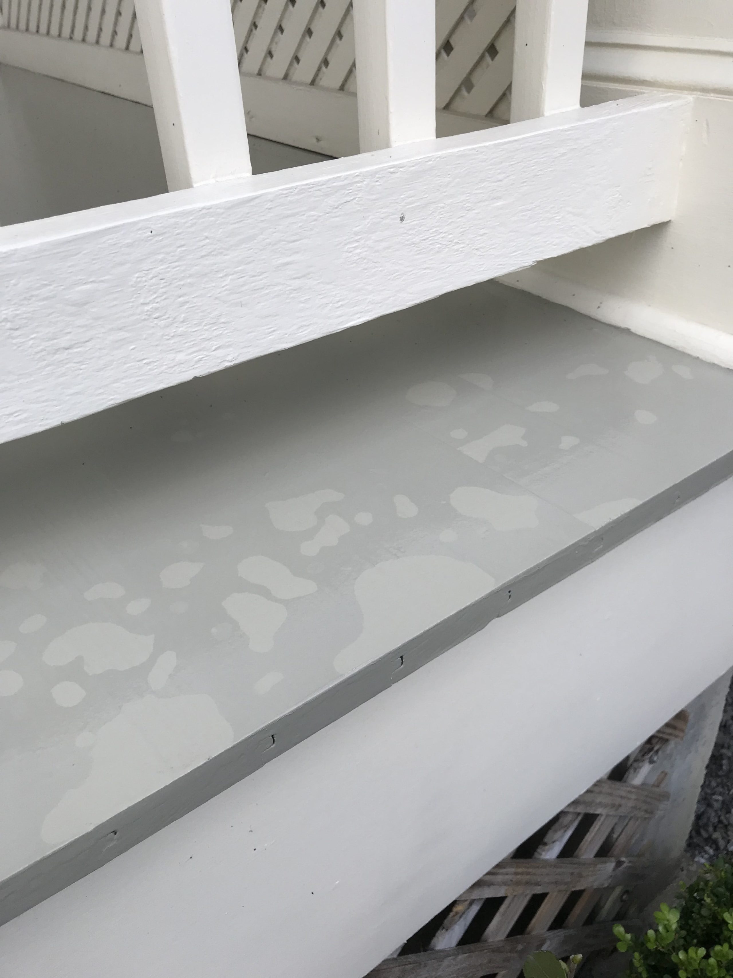

I used cuprinol water repellent wood stain on my fence.Once dried two weeks later I then painted on a Exterior wood varnish.. Trouble was 30 minutes later it decided to Rain. It’s now left a slight gray looking colour and very small pimples on it all.. (Help) What can I do to rectify this awful mess..
You would have to sand this all off to fix it. Strippers will not work. BTW, you cannot use a Varnish on exterior wood.

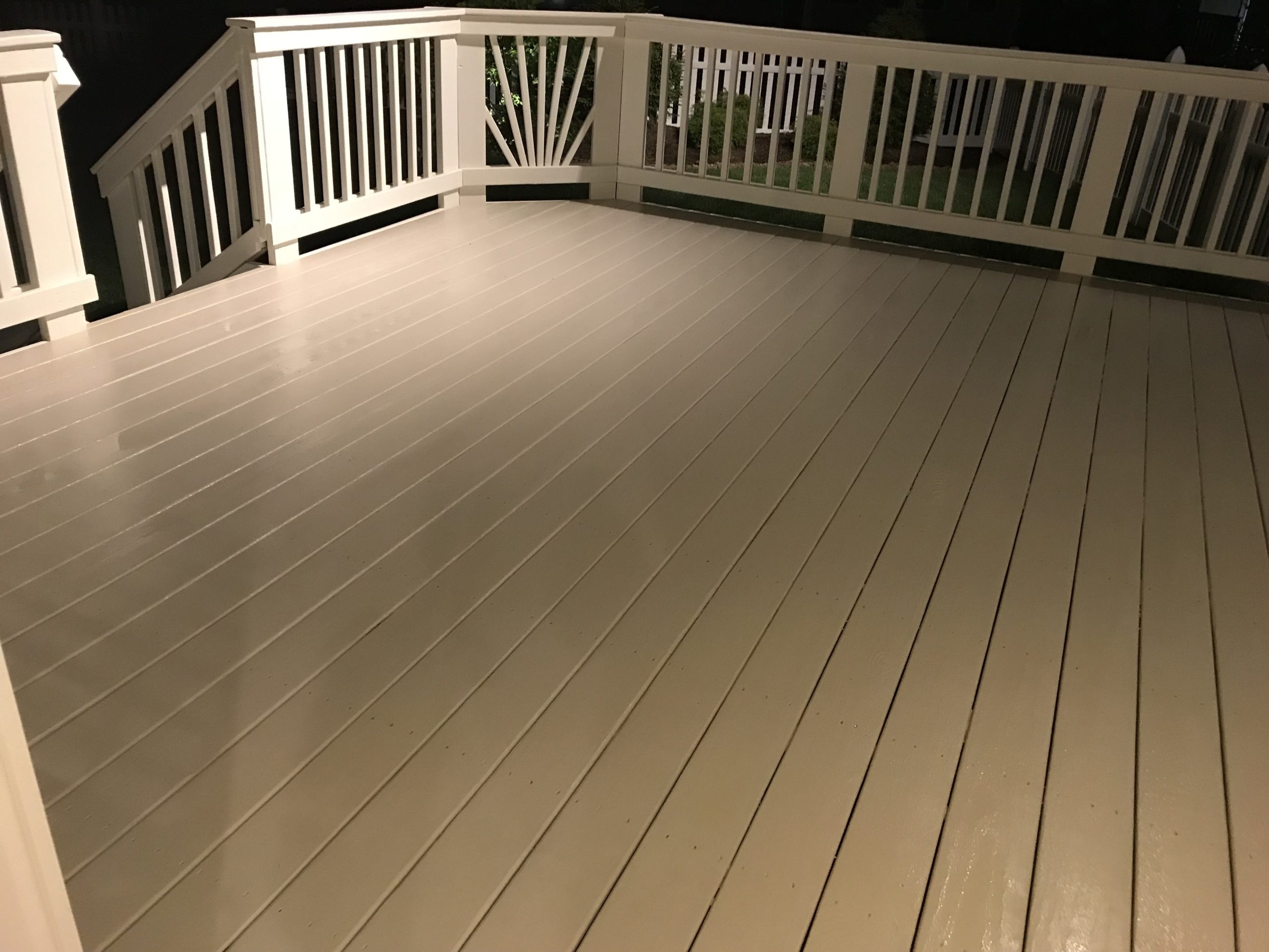

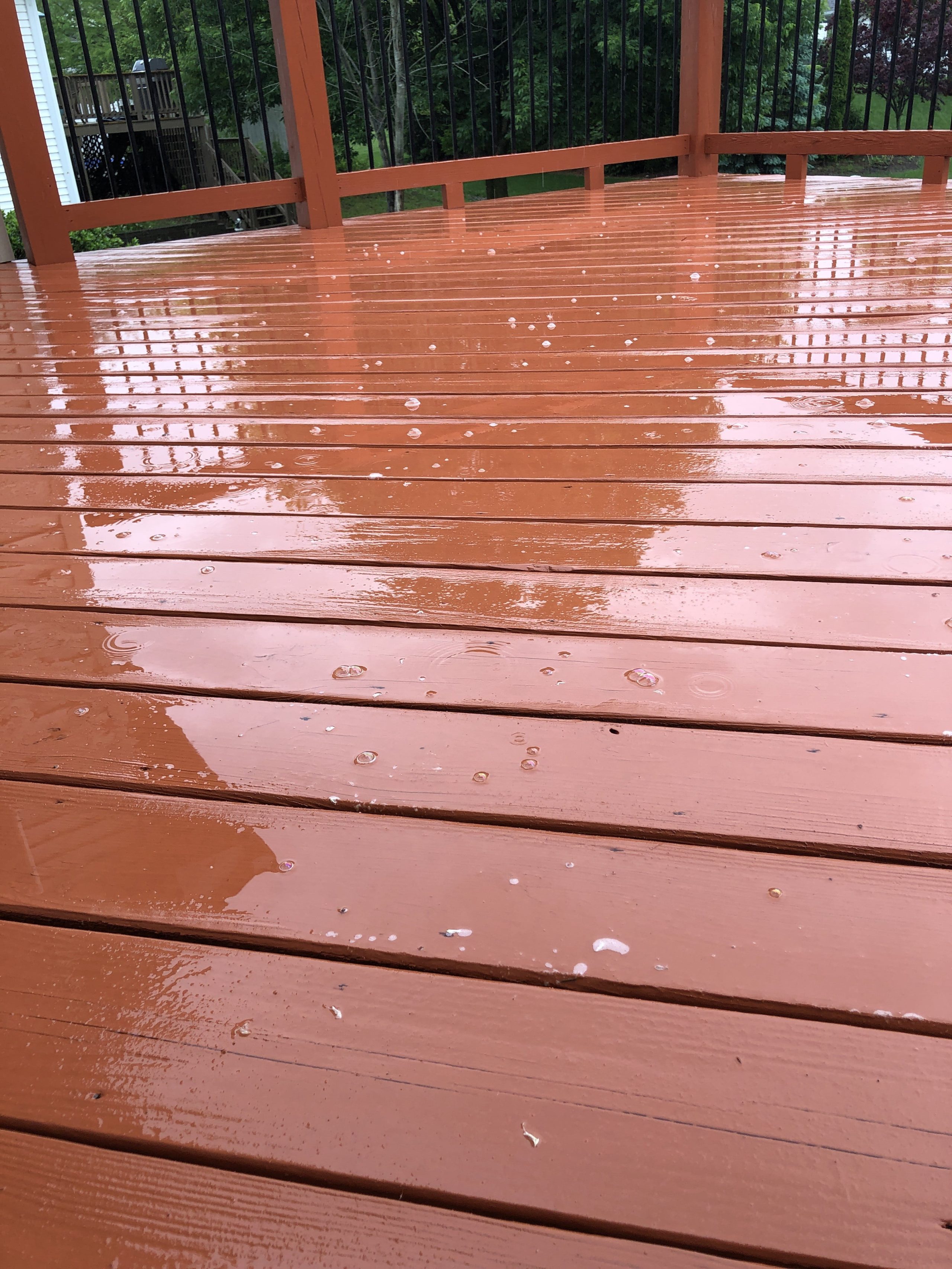

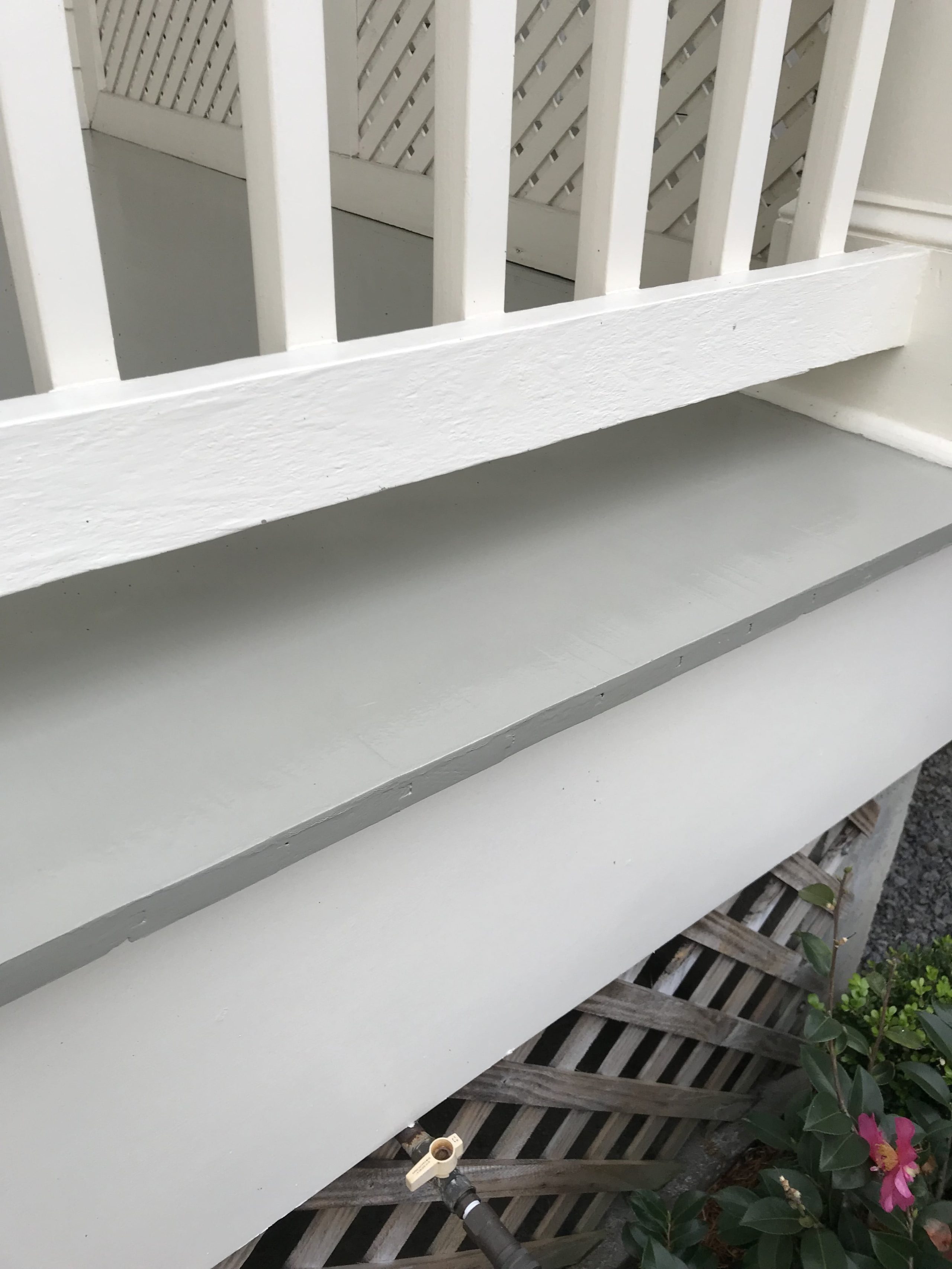

I stained last week (Benjamin Moore) and it was dry the next day, rained a ton last night and woke up to this. I may try a second coat tomorrow while it’s dry for a few days. It’s a tough time of year with all the leaves! Any advice is appreciated.
That does not look right. Best to call BM and see what the issue is.

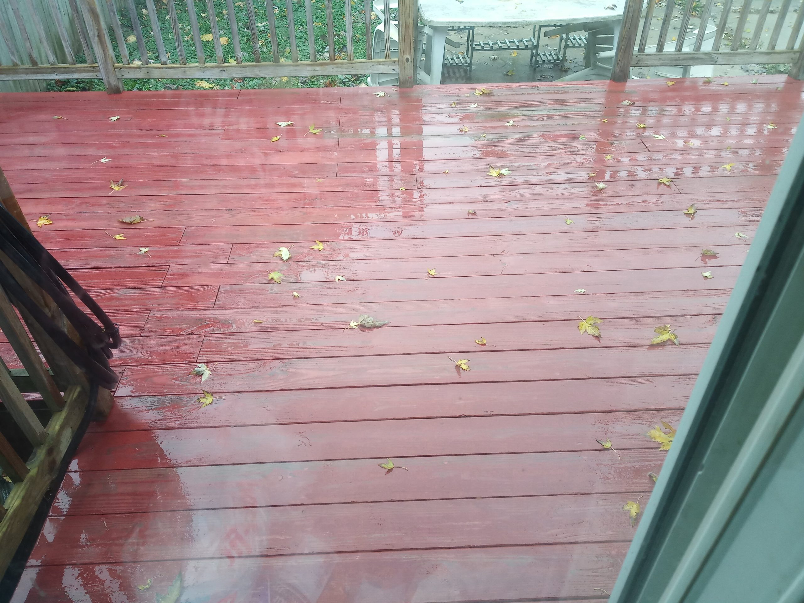

Put down ValsparPro clear exterior wood finish on my new cedar deck yesterday (Tuesday) qhile it was overcast, started at 11am finished at 6pm. Says rain proof after 4 hours. Started raining cats and dogs overnight about 2 am this am and all day. Where i started at 11 looks great. But places where I finished have a thick white residue that seems to want to come off with heavy scrubbing. Tried mopping it off and it turns the rain water chalky but doesn’t remove it. Supposed to rain thru tomorrow. Should I do something prior or hope it cures when the sun comes back out Friday? Will upload a pic when the rain lets up. Thanks
It is comprised and cannot be easily fixed. You will have to remove all and start over. Sorry.

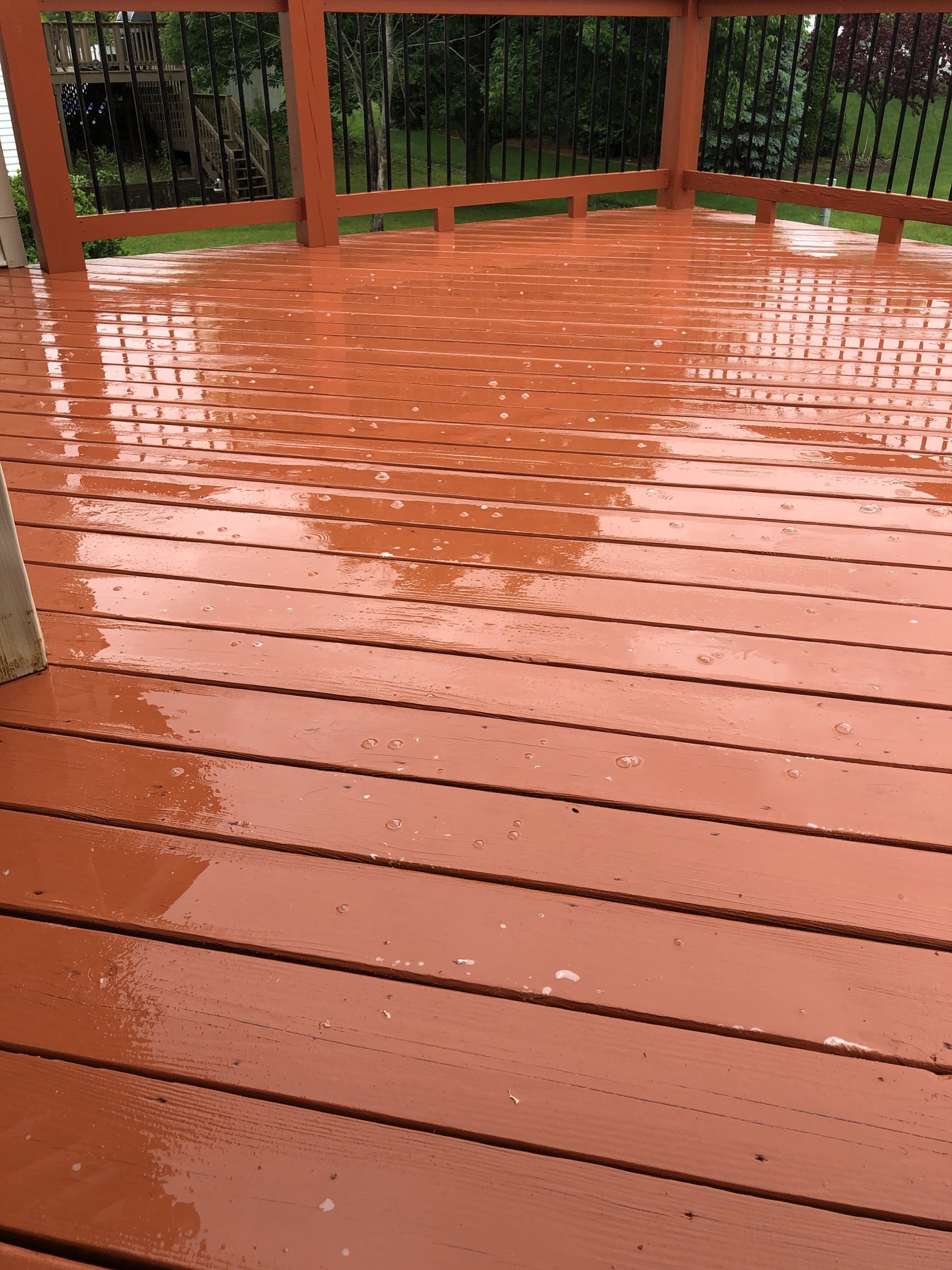

I stained all vertical surfaces on my deck yesterday with Benjamin Moore Semi-Solid. Getting a light rain this AM, ~ 16 hours after the final spindle was painted. When I checked the surfaces this AM they were tacky in spots.
Any ideas on how to best mitigate the rain? Should i attempt to cover the rails/posts with a tarp? Blow dry with a leaf blower? Let nature run its course and assess afterwards?
Just leave it alone. It should dry and cure okay since it had 16 hours before the first rain drop.

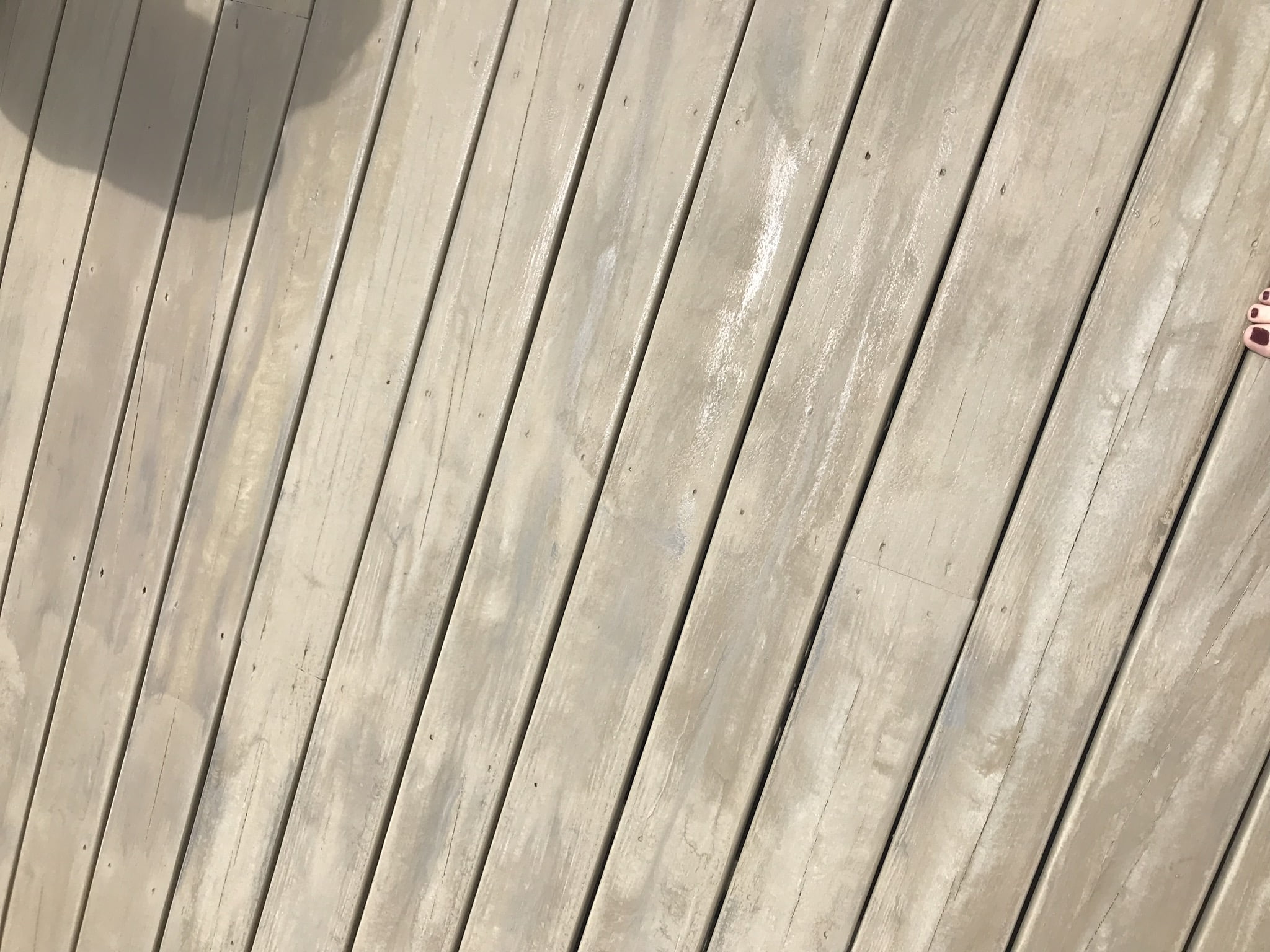

I use Thompson water proof clear stain after 24 hour it rain now it looks like the water is just sitting there what do I do
Nothing to do. It will not last anyhow so best to remove the Thompsons and redo in the Spring.

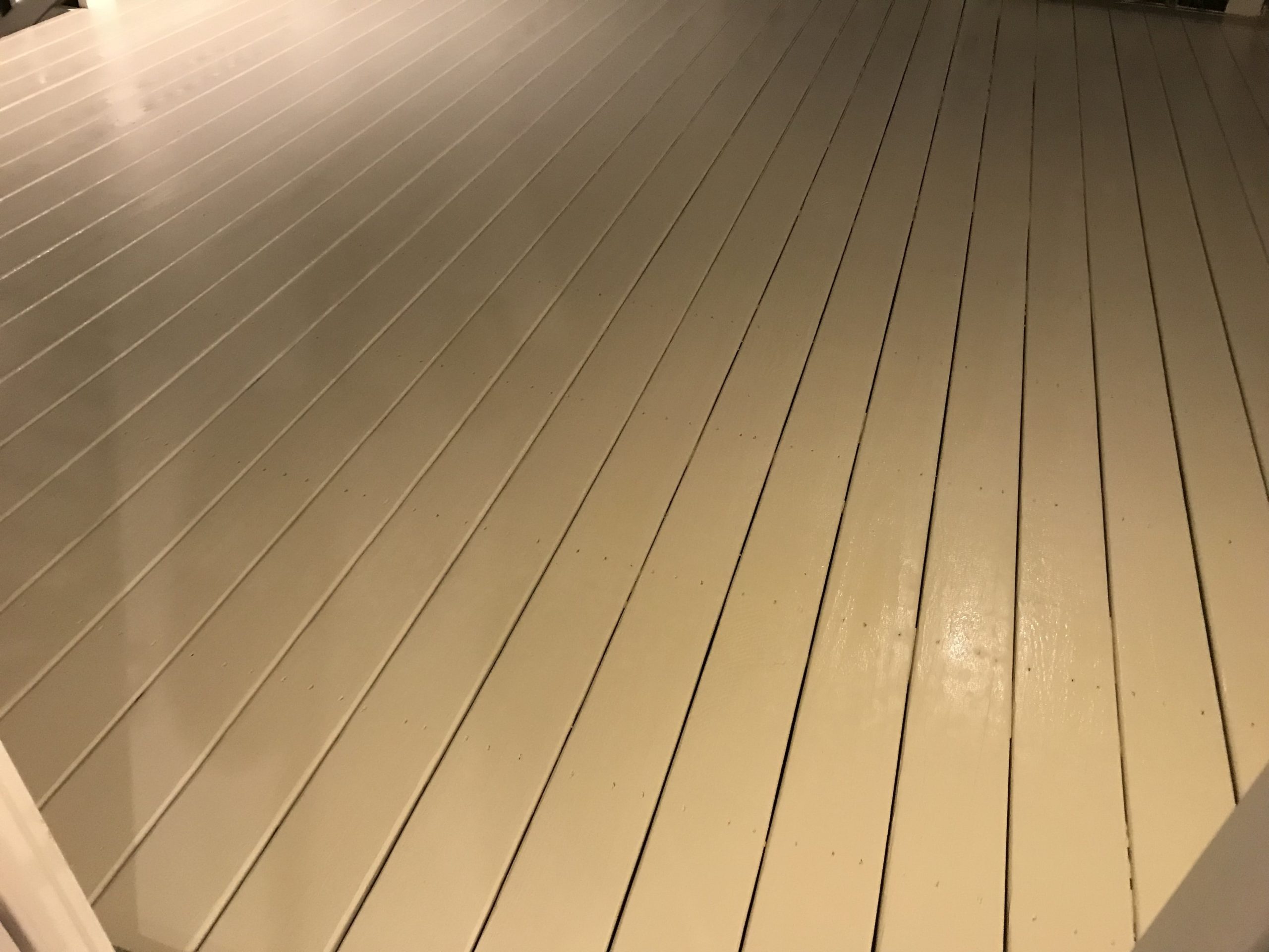

I used Shark Skin white stain from Cloverdale paints in Alberta. I prepared the previous painted deck according to instructions as best I could. A lot of the old paint just would not come off even after renting a large orbital sander. So I put down the shark skin primer as they suggested due to age of the deck and old paint left behind. I have a partially covered deck. The covered part looks good (I think) we keep getting rain without even seeing it in the forecast so I painted the covered part and just tried yesterday to do the exposed part. However I finished just before dark. It was dry to touch (after 1hr) then it rained sometime in the night. I’m guessing 3am. It looks wet right now, not beaded but wet. Do you think it might be ok? So frustrating this year trying to plan this deck repair. Every time I sanded it would rain so I would have to wait again for it to dry. Any ideas would be great! Thank you.
No way to tell until it stops raining and the rainwater dries off the deck. Most likely okay since it was dry before it rained.

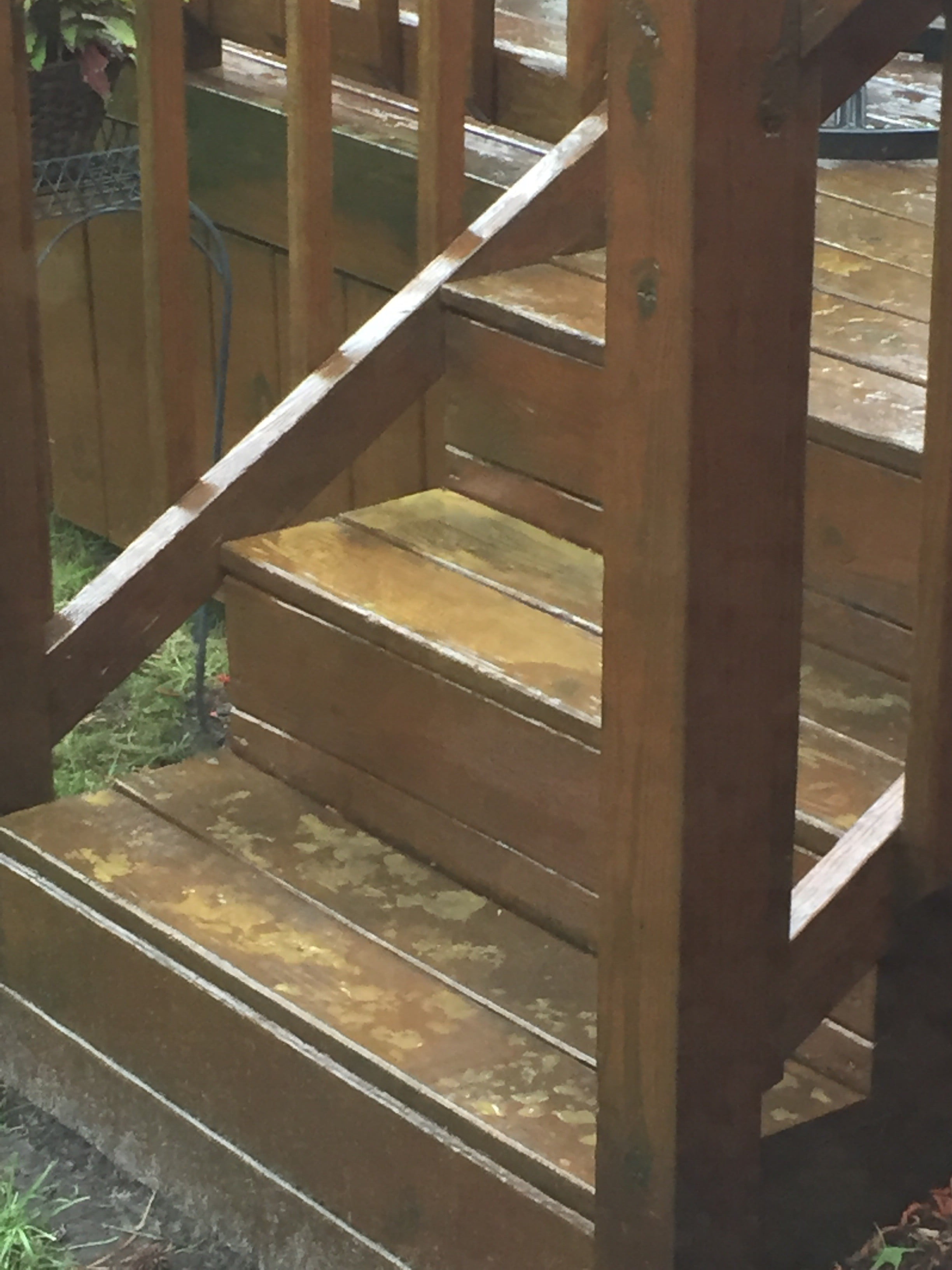

we used cabot gold mahogany stain and sealer, dried for 6 hours, still tacky, then light rain/mist overnight. woke up to see boards still tacky and has small puddles not quite evaporated in the day on some boards, then heavy shower just happened at 7p tonight -24 hours after staining. what to do? wait to see once it dries? had no rain in forecast, sigh. btw this was our 2nd coat after 2 years from original coat of this same product. we washed, prepped with deck cleaning product, dried, and then applied product. temps are in the 50-70’s
Hopefully, it dries. If it does not, you will probably need to remove all down to the bare wood and start over.

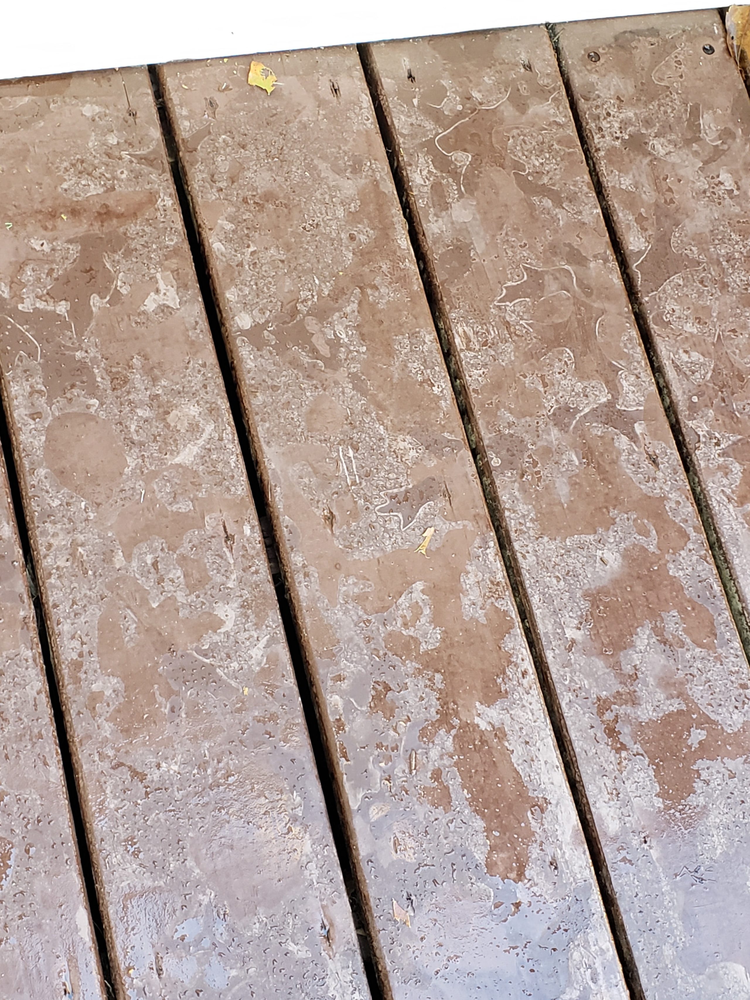

The areas where it puddled basically dissolved the stain, down nearly to the wood itself, which is amazing considering it was a 2nd layer on a 2 year old surface. It also looks orange peel texture in some areas. Letting it dry completely today, and then deciding what to do. All non flat areas are fine, just not hard-dry, but they look like they should. I think we only need to repeat the flat areas, and I’m considering testing mineral spirits on a small area to see if I can get the orange peeling off. Then neutralize and recoat.

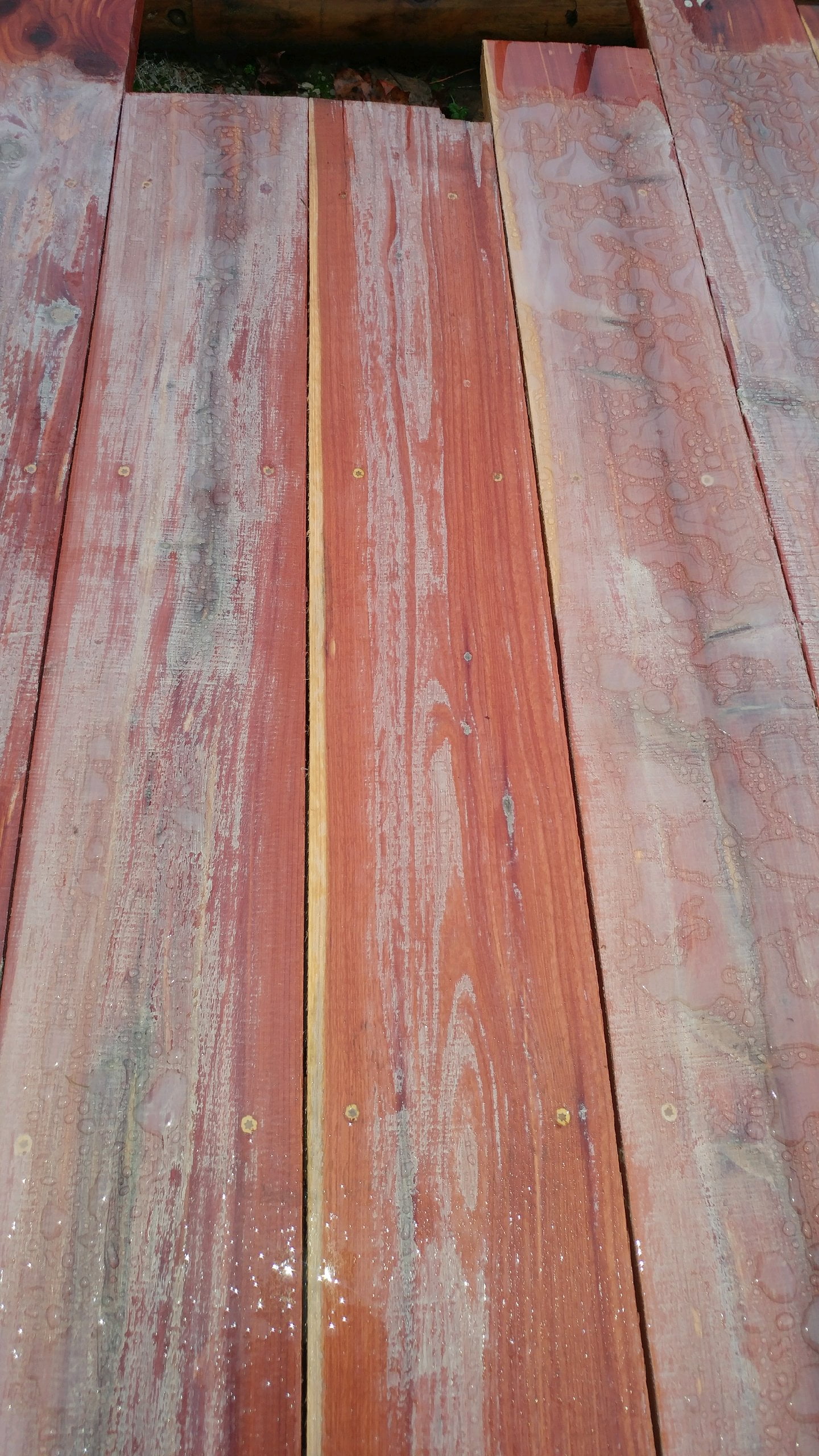

I stained my deck with super deck transparent stain cedar and it rained about 2 hours later (light rain). When I woke up I found beads of water on it…the shape of the water bead remains on the deck once water is moved. I swept the whole deck (about 14 hours after first coat) and am wondering if the deck will be ok or if i should restain? Also, did I damage the stain by sweeping with a large room ?
Let it dry and see if the posts go away in a day or two. If they do, it should be okay.

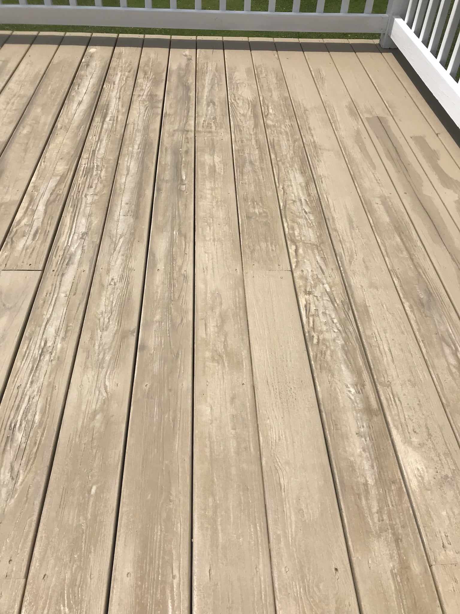

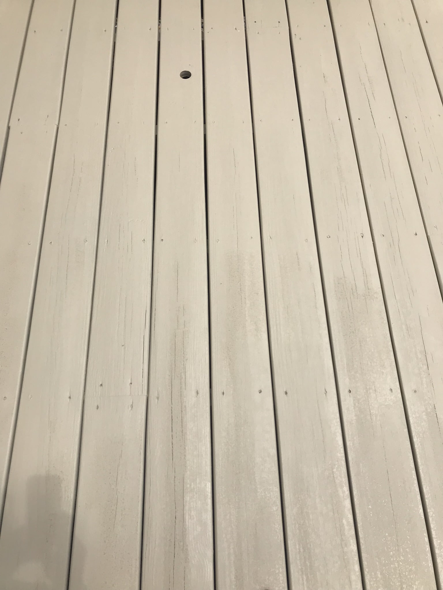

I power washed my deck and after fully drying I used Thompson’s solid deck stain. It rained before it cured all the way. It rained all night. I don’t have the white spots you spoke of but I do have spots where I see unstained wood. The Thompson’s can says a second coat must be applied within 4 hours of the first coat. What do I do?
Not much you can do outside of sanding and recoating. Best to contact them for help as we do not use their products since they have such poor results.

We just finished staining our deck today at 12 PM with a solid colored stain non oil based and now rain is predicted in next hour! That gives it 7-8 hours drying time on the floor as rest was painted yesterday. Is this going to be really bad? Paint info said 6 hours to dry but 48 to cure.
You should be fine.
Thanks for the quick reply. This is what it looks like so far. Will check in AM.

I had my deck pressure washed and stained a week later with Sikkens Cetol Dek finish. Have used this product many times before. Heavy rain downpours 4 days later which was last night. Deck is still wet from rain. Now many splotchy areas all over deck. Looks terrible. Is it ruined?
Hopefully the spots will go away when it dries. Give it a few days. If not, you will have to sand it all off to fix.
It’s all over the deck. Would it require pressure washing again as well?
Not if you have to sand it off.

Hello. I’m hoping someone can help me with this question. I painted a deck with a grey exterior oil based paint with a anti mildew agent added in and a few days later it rained. Wherever the rain puddled up on the edge of the deck if you wipe the puddle away it would leave a temporary white stain for about 2 hours then would return back to its normal color. How do you prevent this and what causes this? The deck had days to dry before it rained. Any help would be great. Thank you. Tre
Post a picture of it happening.
These are the water stains right after I wipe the water off the deck and dry with a clean rag. The second pic is about an hour later, after it sat dry
Most likely that is happening as the stain is not fully cured. Give it a week or two and hopefully, it stops. There is not a way to stop or prevent this though so it needs to go away on its own.
