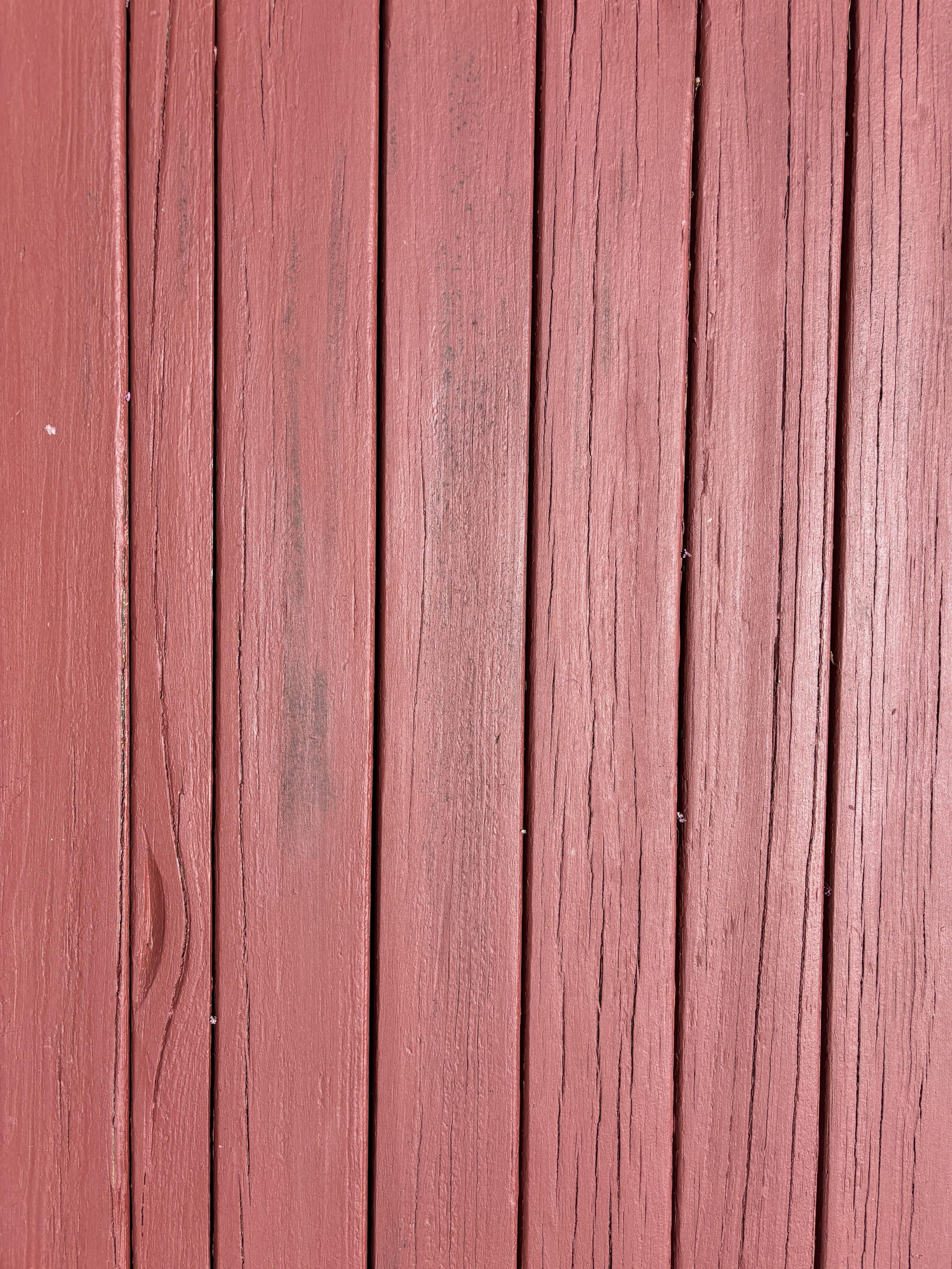

I just applied the stain yesterday and it was pretty noticeable immediately following applying the stain. I don’t imagine it would change throughout the day..would there be a difference on how to approach. I was just afraid there was more mildew from letting it sit. Thanks again for your help!
It is not mildew but internal discoloration from the 30 second cleaner or sanding. Brightener typically fixes it.

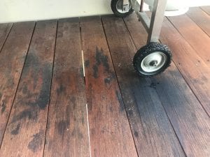

Help! I have this big mark on the deck next to the wheel… The rest is grease marks from a bbq, not sure if this is the same or something more suspect?
It will not fully come out, too deep in the wood.
Do you think that all of it is grease stain?
Mostly grease, possibly some burn.

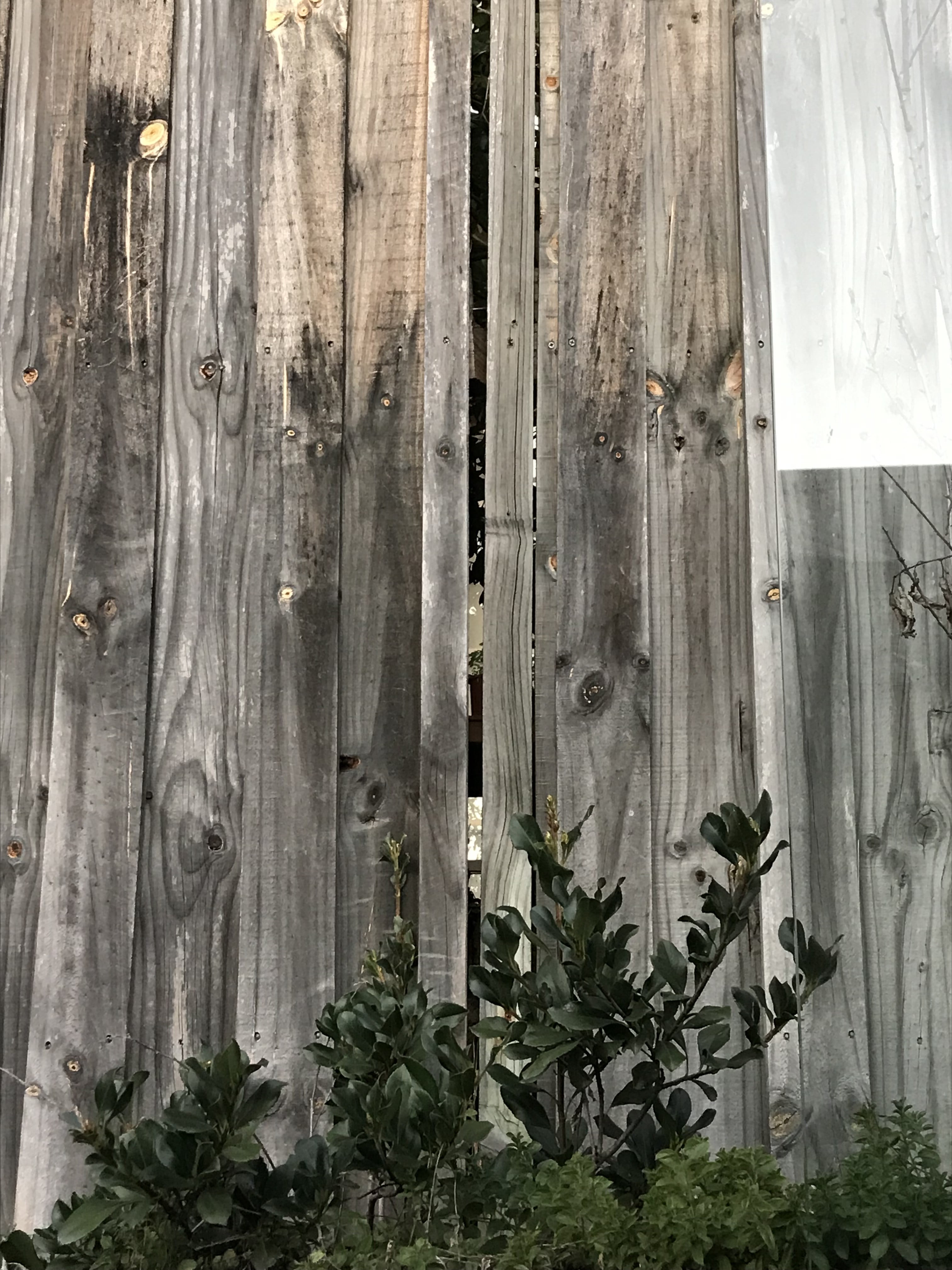

I have black dots over half of a brand new cedar floating dock for I built for our pond … it’s been in my garage since Mother’s Day I just pushed it out Friday July 17th, it rained on it Sunday, Monday morning black specks all over half the deck… it has not been stained or treated with anything….is it mildew?? I tried power washing it out with no luck it sanded out a little but not easily. What can I use to remove the specks??
Thanks Michael M
It is mildew or rust. Bleach removes mildew. A wood brightener removes rust.

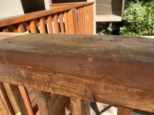

I thought I was doing everything right restaining a cedar sided house. It’s originally stained with Penofin Transparent Cedar red label and I am applying the same thing.
The house was last stained probably 5 years ago, working on the south facing side, the cedar has lots of black or dark patches at the bottom of the vertical cedar siding. The upper 2/3rds is in relatively nice shape still.
My prep-
Using Penofin Cleaner – dissolving in water and applying with a pump sprayer, letting it activate for about 20 minutes and then scrubbing the surfaces, doing a second application on the lower areas that have the blackest staining. Hosing off with garden hose
Using Penofin Brightener – dissolving in water and applying with a pump sprayer, letting it activate for about 20 minutes and then doing a second application on the lower areas that have the blackest staining. I can visually see the dark areas lightening during application. Hosing very thoroughly with power sprayer, making sure not to damage the wood, but enough that some mushy wood fibers are showing up and being washed off during the spraying.
Letting dry 24 hours.
The surfaces look great, much lighter, black staining gone, cedar looks almost brand new.
Reapplying 2 coats of Penofin red label. However, this is where I am having the problem, as soon as I apply the first coat, the darkness at the bottom if the cedar, very ugly seems to reappear. The nice bright even surface is dark again at the bottom as if I never did any prep.
I stopped, only covered a small section with one coat, I don’t want to go any further until I know what steps to take, or is it possible the wood is so old it’s just beyond coming back to like new?
Picture below -shows before, after cleaning, after restaining
Looks internals water stains near the bottom causing the darkening. Nothing you can do about this as far as prep or a different stain brand.
Hi thankjs for the quick reply. I’m confused, what are “internal water stains”?
THanks
Water damage in wood turns black in color and cannot come out. Most likely moisture wicked up from the froof and started to degrade the wood cell structure. It is a permanent discoloration.

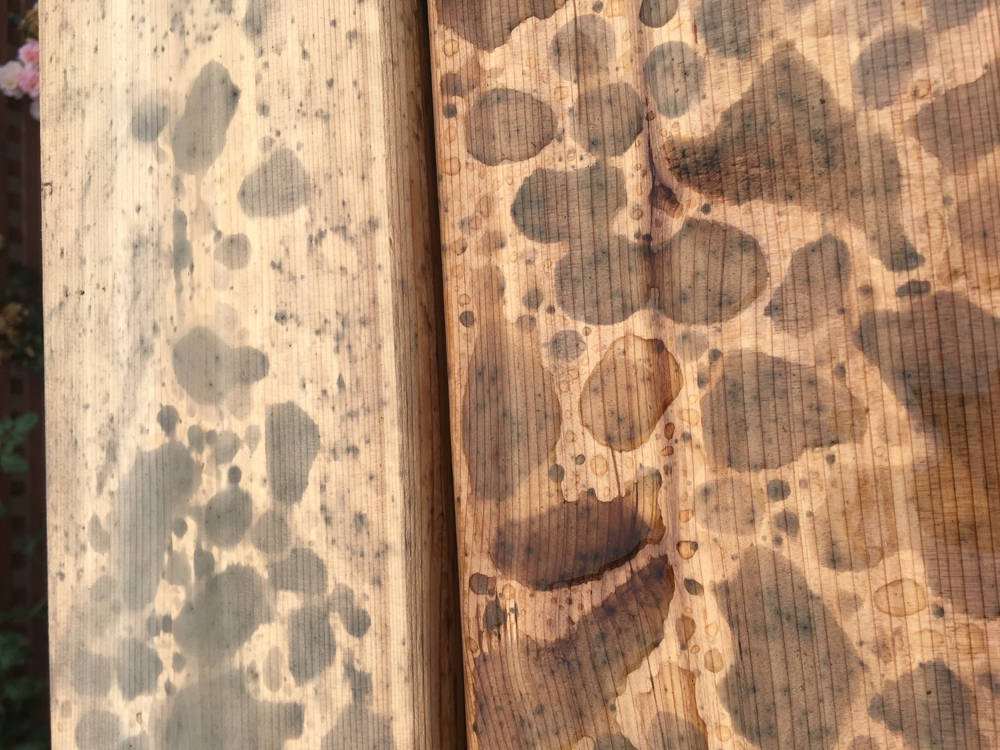

Brand new cedar deck has all these black leopard print like splodges all over it. It appeared after the first rain. No metal sanding as been done anywhere near it. No railings even installed yet! Almost looks burnt in places. This is a professional install.
Any suggestions?!
Definitely, something in the rainwater caused this but not sure what. Hopefully, a good cleaning and brightener will fix this/ See here about new wood: https://www.deckstainhelp.com/staining-a-new-deck/

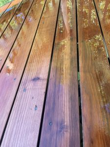

Hi – this is my merbau deck that was put down 10 months ago. It has gone black apart from area that were covered with furniture? Any advice on best way to deal with this? Thank you Jackie. ps please ignore one picture there it’s my fence- sorry can’t work our how to delete it now!
Has it been stained before? If so, strip and brighten for the prep: https://www.deckstainhelp.com/restore-a-deck-injectable-deck-stain-stripper-review/
If not, clean and brighten for the prep: https://www.deckstainhelp.com/restore-a-deck-cleaner-system-review/

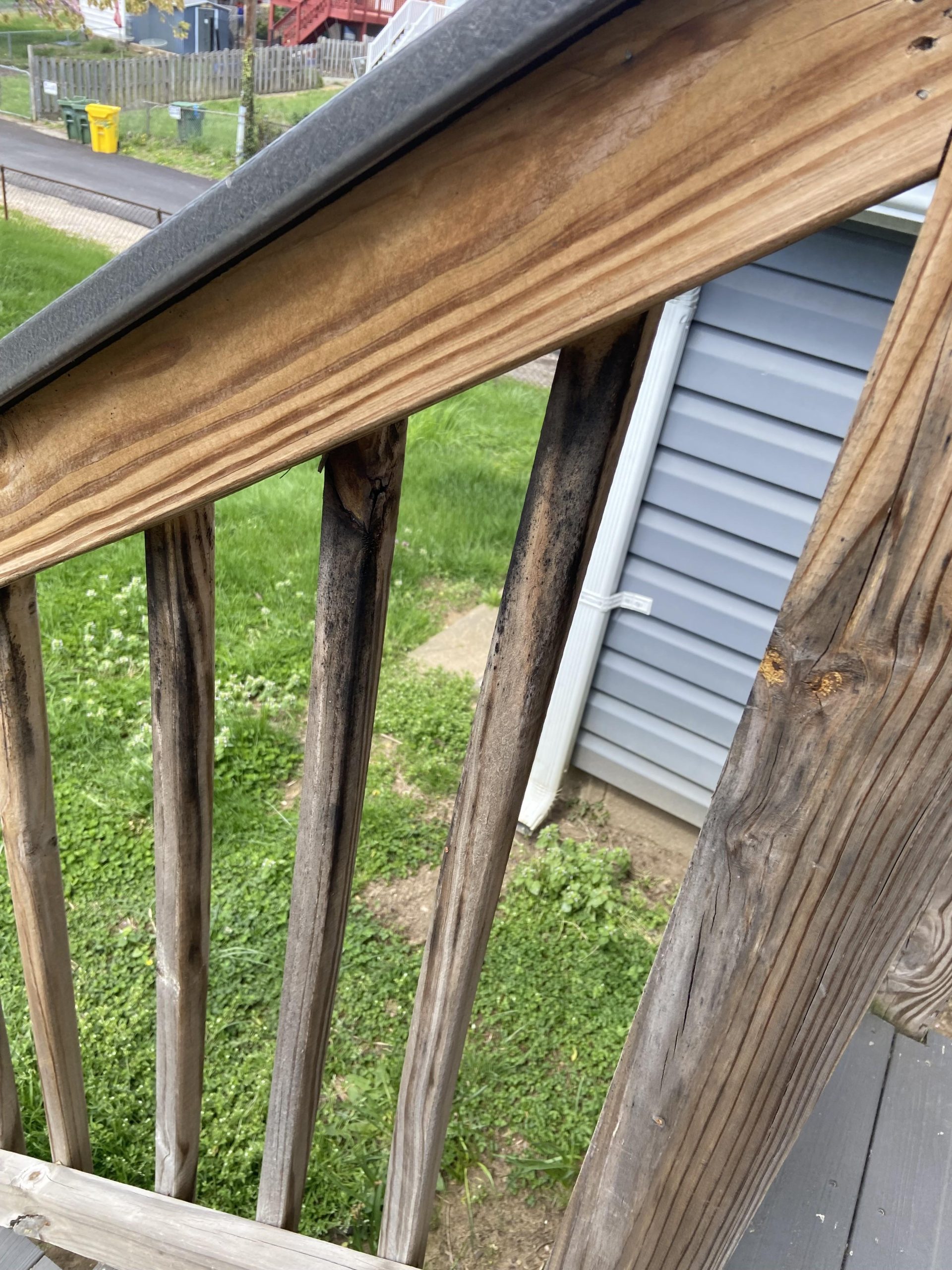

Just wondering what these black marks are
Probably rust coming from your metal gate. Turns black in wood.
I don’t have a metal gate
The deck is only one week old
Yes, you have a black metal or painted hinge in your photo.
How do I remove it
If it is rust, a wood brightener will help to remove it. Your bigger issue is it will continue to rust from the hinge unless you fix that.

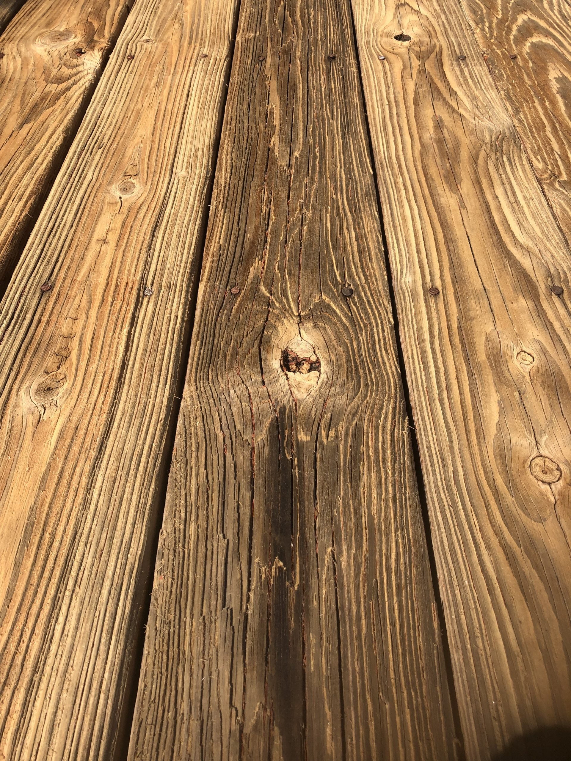

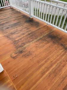

Our deck went without staining or 4 +/- years. I bought Sherwin-Williams Revive and cleaned, scrubbed and washed/power-washed the deck. After drying for 48+ hours I applied Sherwin-Williams Superdeck oil based stain. We have no nearby trees/shrubs. The deck showed no black spots prior to staining. It was just dry. Can I fix this by applying another brand of stain?
No, you will need to strip it off and then brighten the wood. The black was there internally in the wood. The SD just enhanced it.

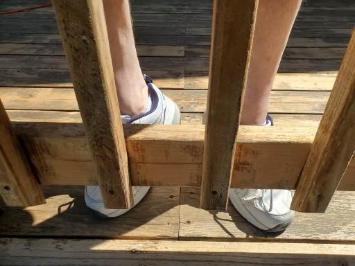

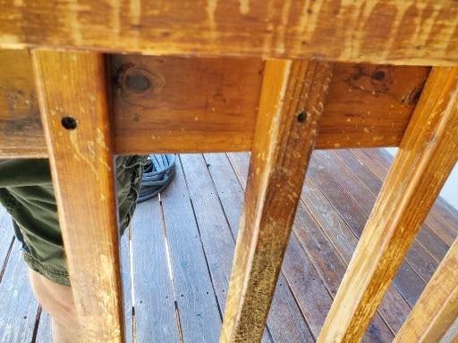

I had my deck sanded to the bare wood. Then I used a brightener twice and let it dry completely. After mucho research, I chose the Armstrong Clark stain and applied one coat which looked okay. It dried and after a couple of weeks I applied a 2nd coat. The deck has turned black from what I suppose is mildew even though this stain supposedly has a mildewcide. I have not idea what I could have done differently. I was very careful to follow directions for each step. I’m disgusted.
It may not be the stain’s fault but improper prep and over application. Basically, if the stain cannot so into the wood it can have issues curring correctly. This can lead to dirt and grime collection or even mildew. Sanding reduces stain absorption and adding the second coat two weeks later will enhance this issue.
At this point, it would be best to strip and brighten to remove and use a stain that will not have a curring issue like the Defy Extreme. Defy is water-based (AC is oil) and will cure 100% though you still have to watch for over-application as that could reduce in wearing and peeling with a water-based stain.
