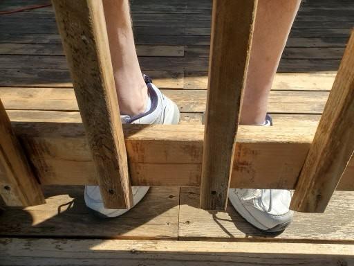

I stained my deck in early July. I cleaned, power washed, sanded…waited more than a week for drying…no rain. Then I used Sherwin-Williams Super Deck Solid Stain. I gave deck two coats. No walking on deck for over a week. Just recently 5 weeks later I noticed some black residue or spotting on several of the boards. They were not there earlier. May I paint over them? And also, what is your opinion in giving the deck another coat after it’s been 5 weeks? Thanks. Robert, West Laurel, MD Here are pics.

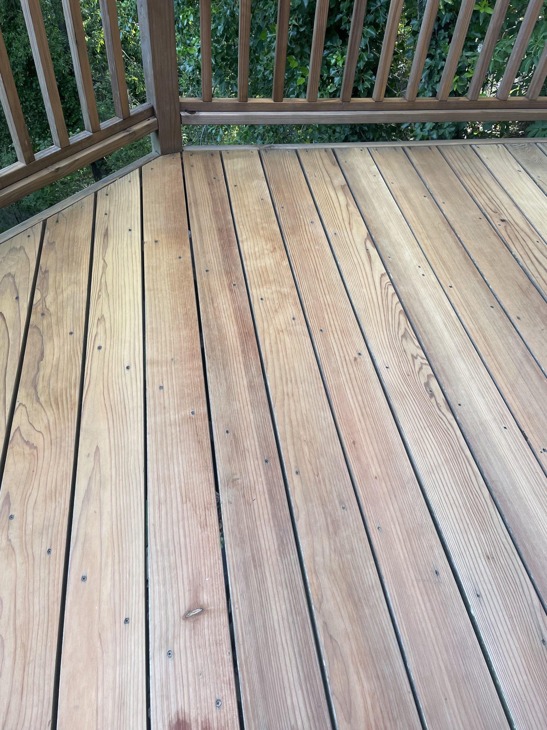

Thanks for your help but need more guidance. Stripped and brightened most of the deck but it looks like it needs sanding or more stripping. I am sending pics. If I need to sanding I anticipate using a belt sander on the deck. What is the best grit to use if sanding is the solution? Also, I am sending pics of some areas where some of the old stain is not coming off. It has a sheen. Should I give the stripper one more shot or will some sanding on it make it receptive to stain? Some white residue appears on posts. Try removing it with power sprayer and some came off. It looks as if it may be a non issue when stained. If not let me know

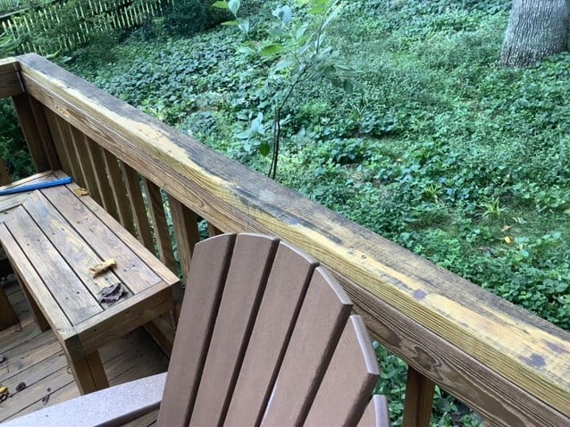

Why is my decking looking this is. I have now used red label to strip the Ron seal deck stain off. It was put down last year and just looks dirty all the time.
We have Penofin red label on our deck for 3 years. It has darkened the most where exposed to the sun. We don’t want another coating of the Penofin. What can we use instead?
PS We don’t want to sand the deck.

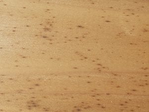

I have black dots over half of a brand new cedar floating dock for I built for our pond … it’s been in my garage since Mother’s Day I just pushed it out Friday July 17th, it rained on it Sunday, Monday morning black specks all over half the deck… it has not been stained or treated with anything….is it mildew?? I tried power washing it out with no luck it sanded out a little but not easily. What can I use to remove the specks??

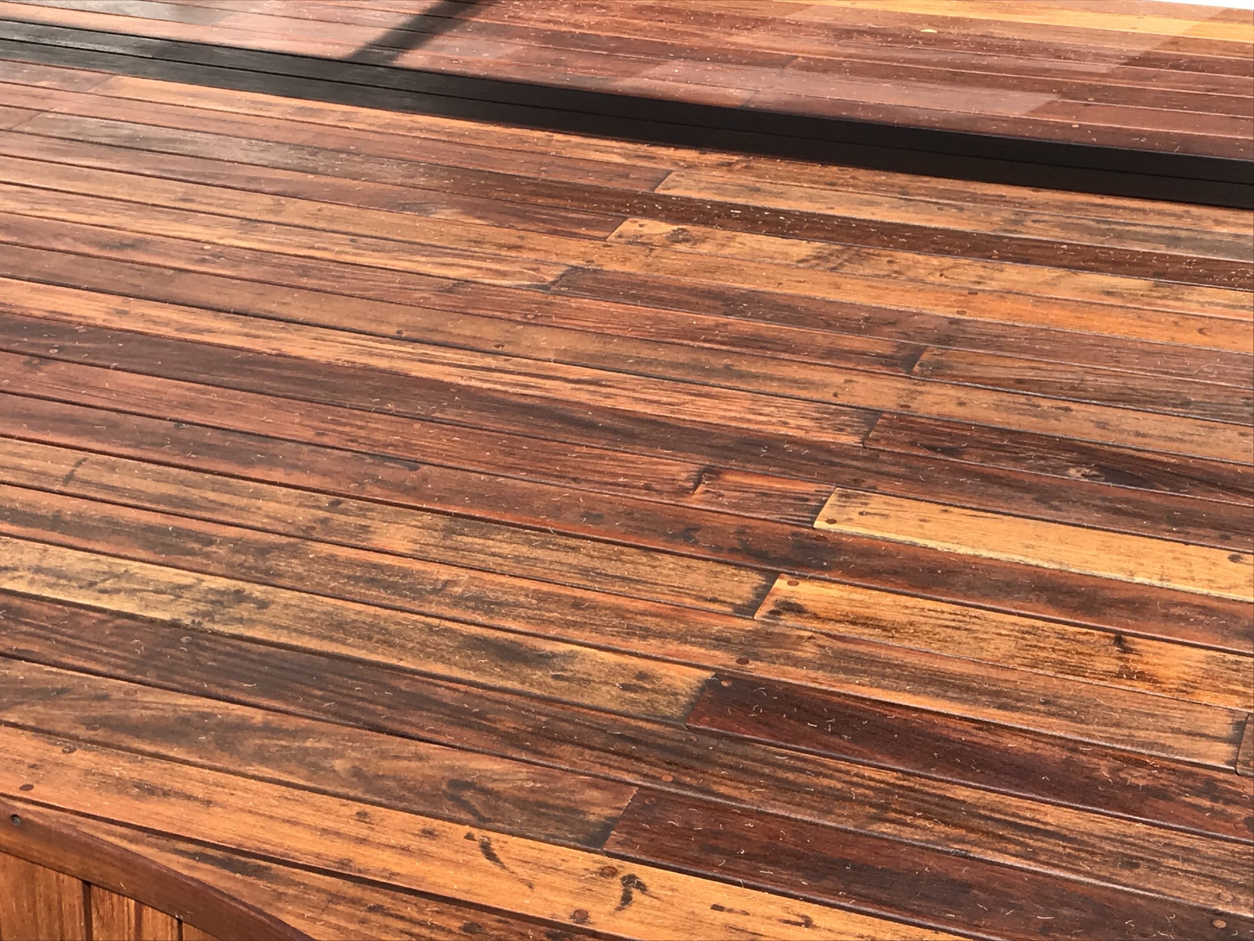

Hi – this is my merbau deck that was put down 10 months ago. It has gone black apart from area that were covered with furniture? Any advice on best way to deal with this? Thank you Jackie. ps please ignore one picture there it’s my fence- sorry can’t work our how to delete it now!
