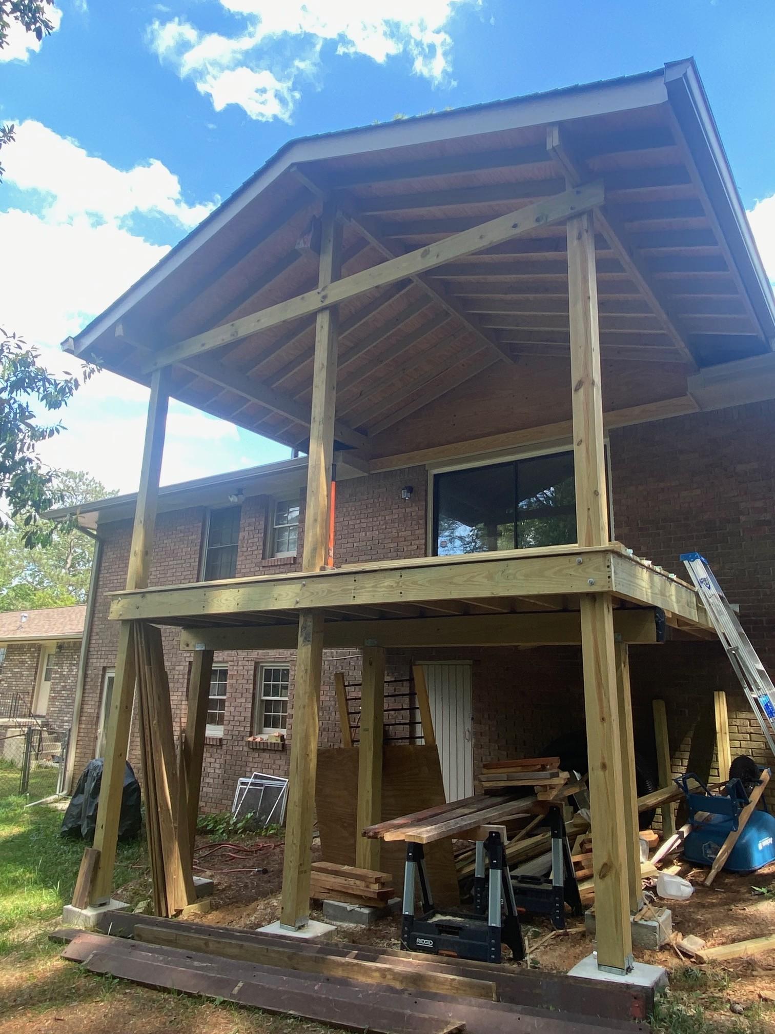

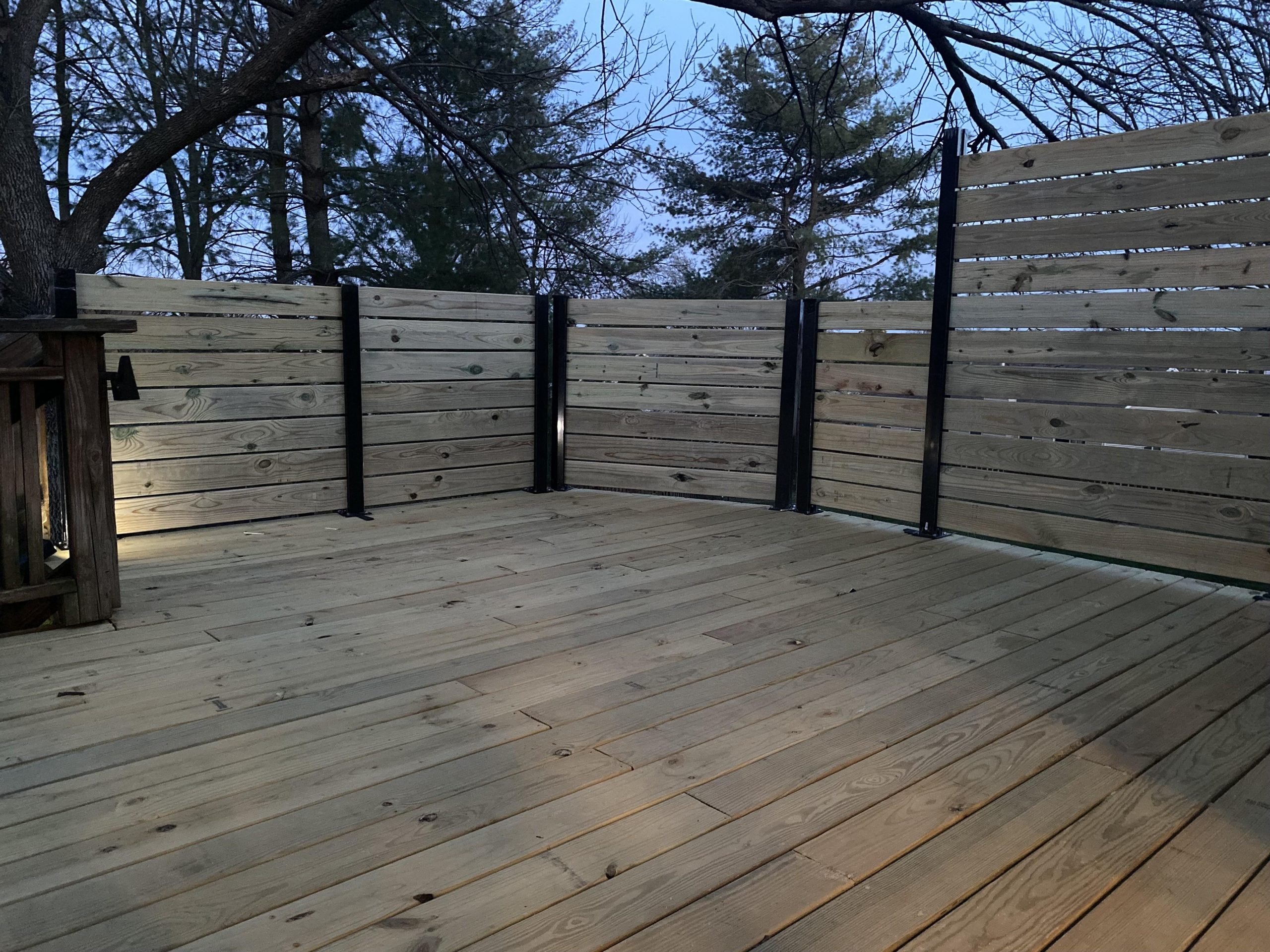

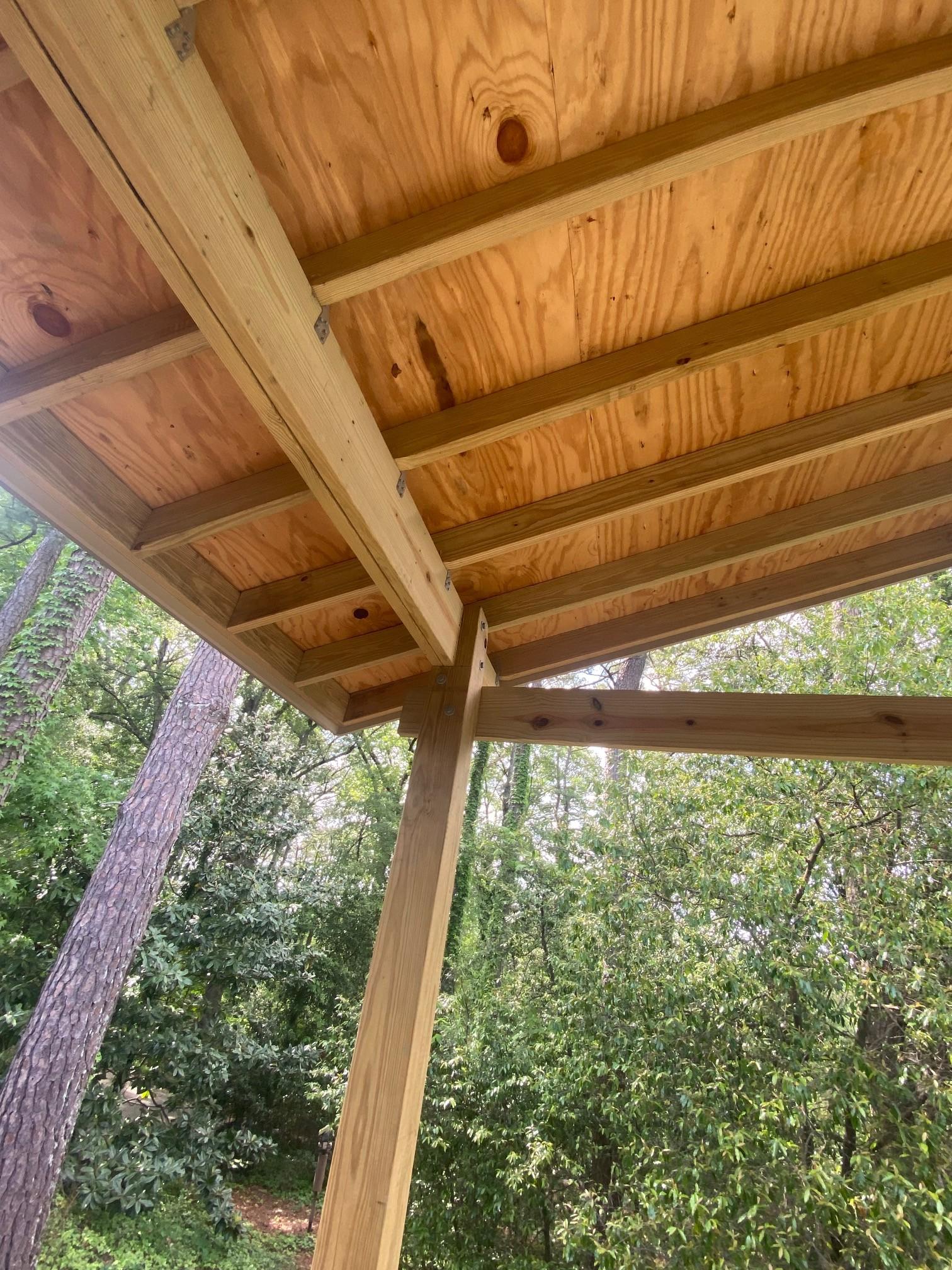

Hi there,
I live in the PNW and just finished a cedar deck build. I can wait until next spring/summer to stain, but any suggestions on how to protect the deck from furniture marks in the meantime? We currently have a metal patio set that’s heavy – deck isn’t currently covered but it hopefully will be by the rainy season.
I could do an outdoor carpet but a bit worried about mould over the winter.

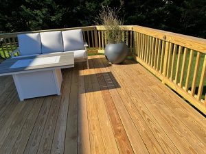

Outdoor carpet is your best option. Many are mildew-resistant.

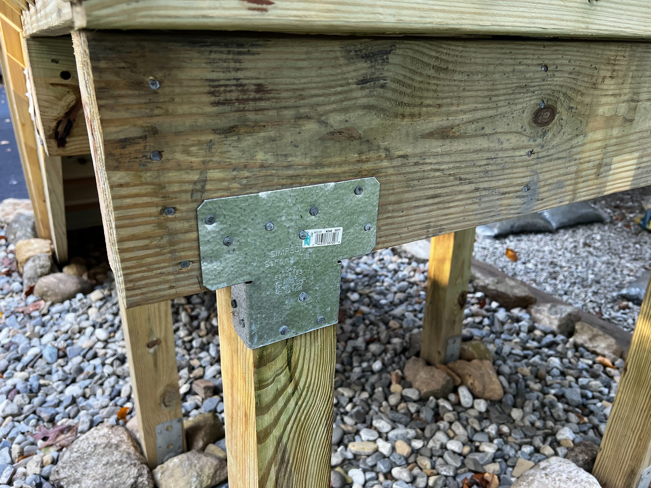

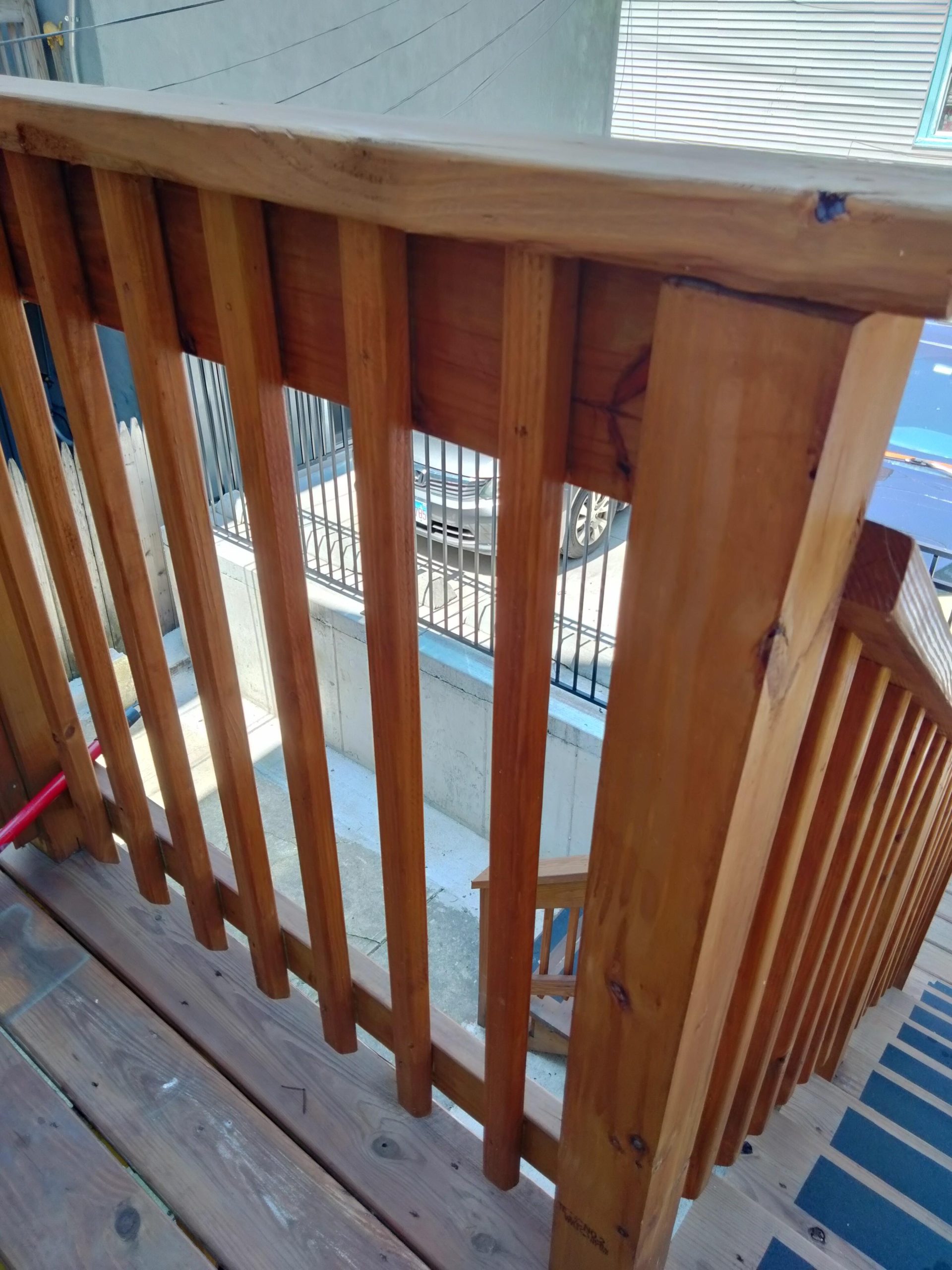

3 more pics re: previous comment

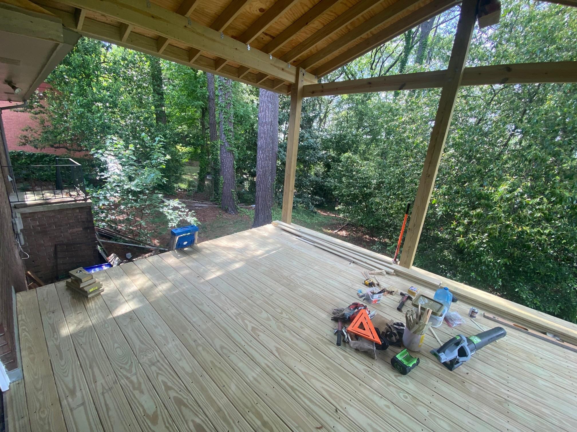

Hey Scott,
Wow, your website is a tremendous resource. Thank you for creating it and answering so many questions!
I live in Atlanta, GA.

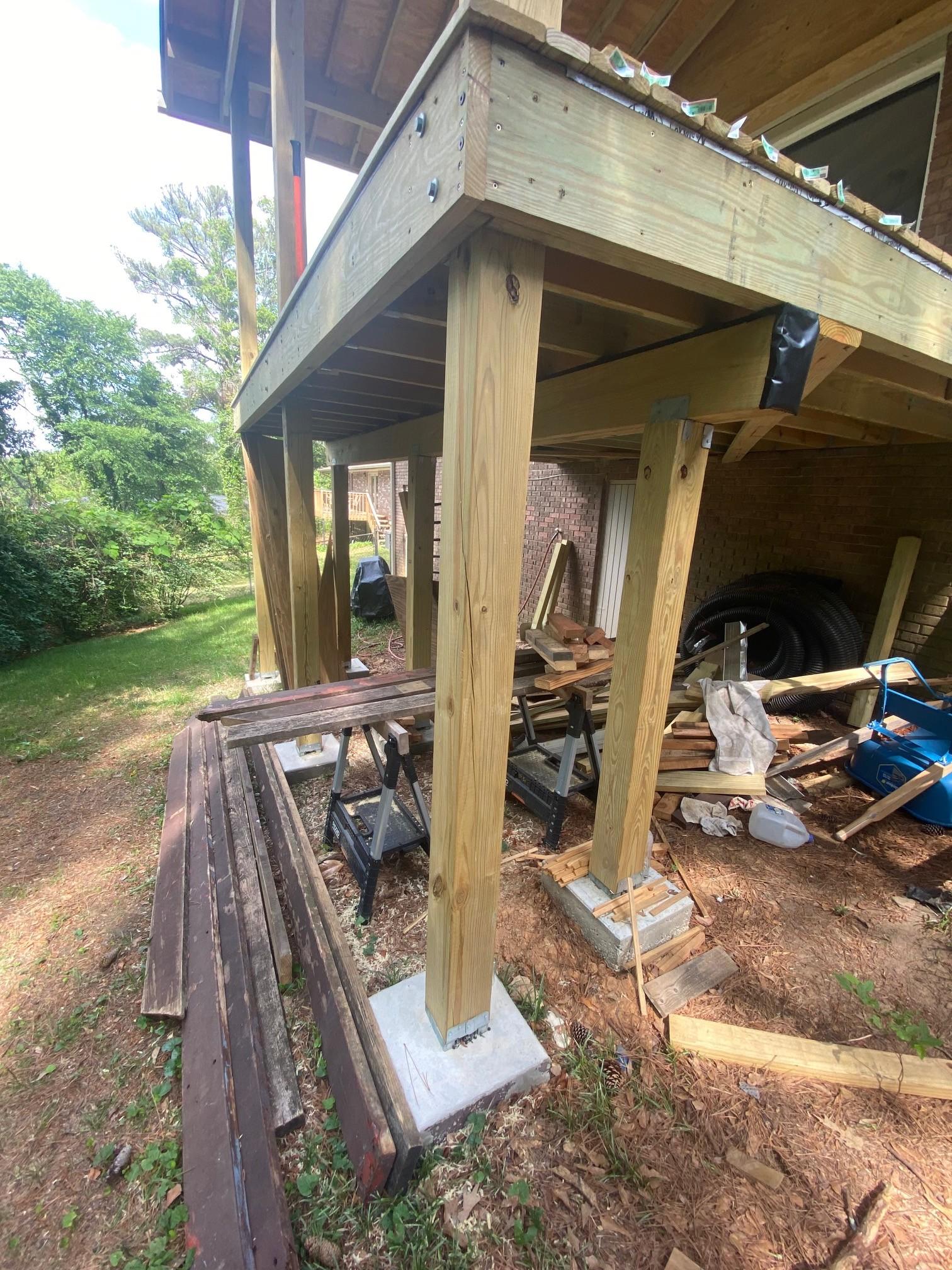

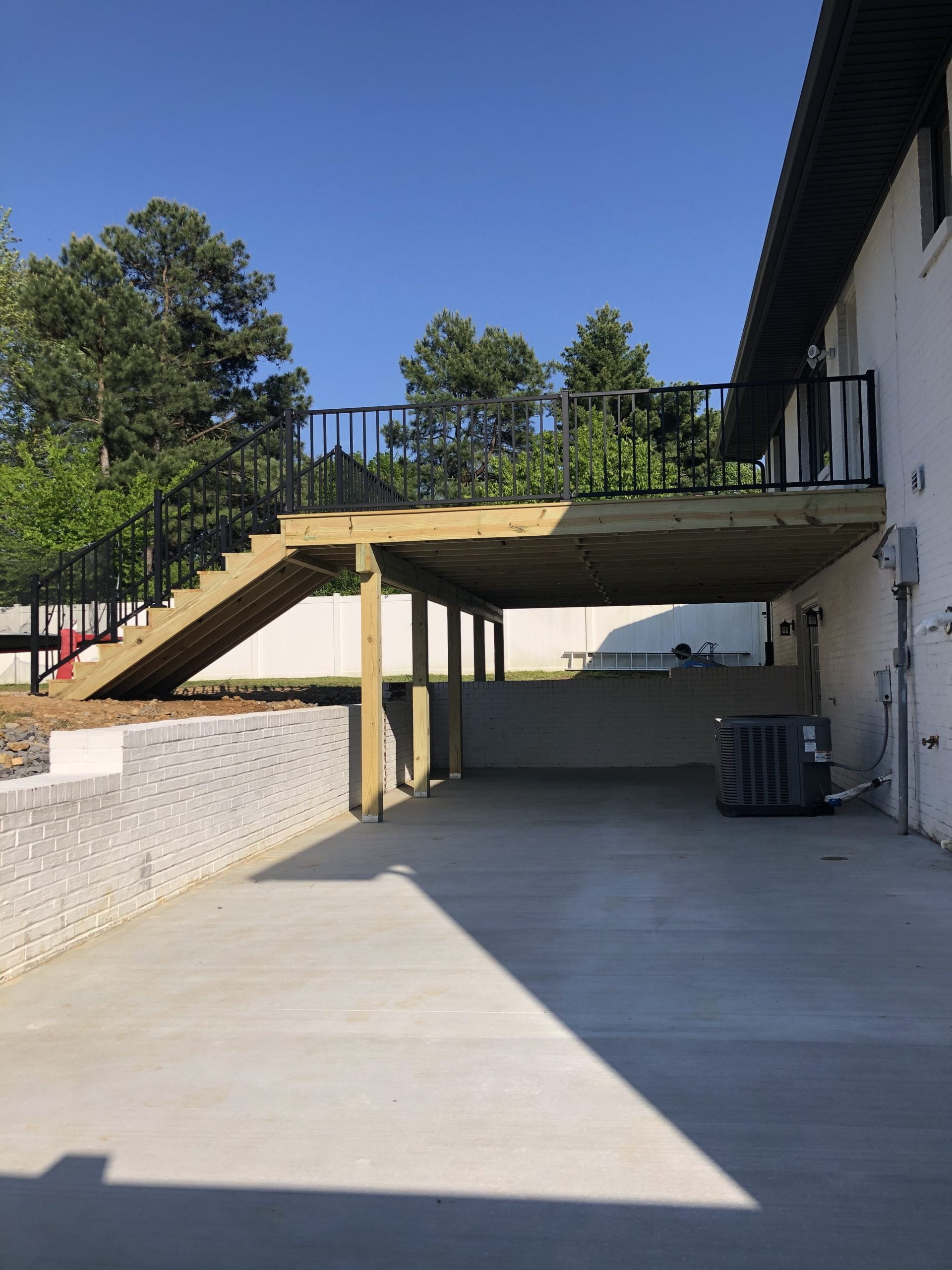

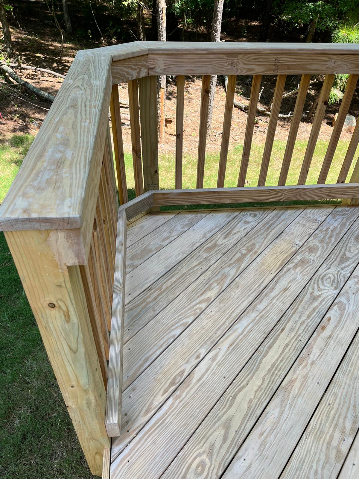

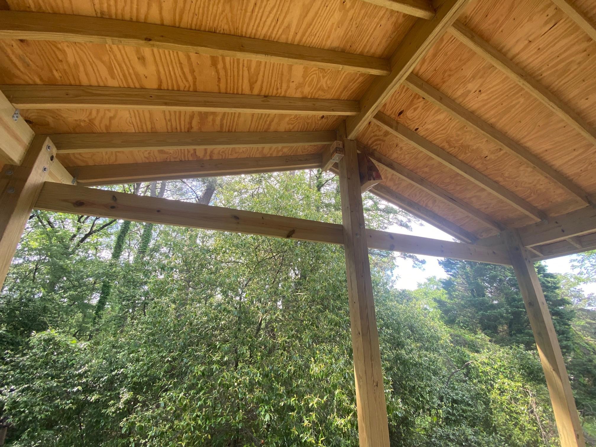

I started my new deck with treated 6×6 posts and floor joists July 2024 (10 months ago)
Added 6×6 treated posts for deck roof Nov. 28, ’24 (5 months)
Bought 5/4 treated decking Mar. 23, ’25 and let it dry outside for 3 weeks before installation.
(5 weeks total time outside)
My friend says I need to stain before installing the railing.
I did water drop test on decking. On half of the boards the water beads, the other half, not as much.
There are manufacturer ink spots on the decking which I will remove w/ 60-80 grit sandpaper,
as per your instruction.
The outer band boards of the roof are covered with pvc fascia all the way around.
Roof boards are 1/4” plywood(not treated). Roof joists and 3 roof beams are treated.
1. I believe I only need to stain the 6×6 posts, outer deck band, front cross member, and decking, but please let me know. Which parts of the deck need staining/sealing?
2. Do I need to clean and brighten the with “Restore-A-Deck”, or can I just go ahead and apply stain, since it’s all relatively new wood?
3. I would like to see the grain as much as possible, and not color the deck any more than necessary. Deck has a roof, so it gets no sun the first half of the day, and maybe 15% of deck gets sun the latter half of the day. I would like to use the same stain for all, and agree with your preference for semi-transparent stain, but I think the only one you recommend for less than 2 months weathering is Woodrich Timber Oil, or maybe Armstrong. Which one(s) do you recommend?
4. I don’t think I need to stain the plywood or roof joists, but please let me know what you think.

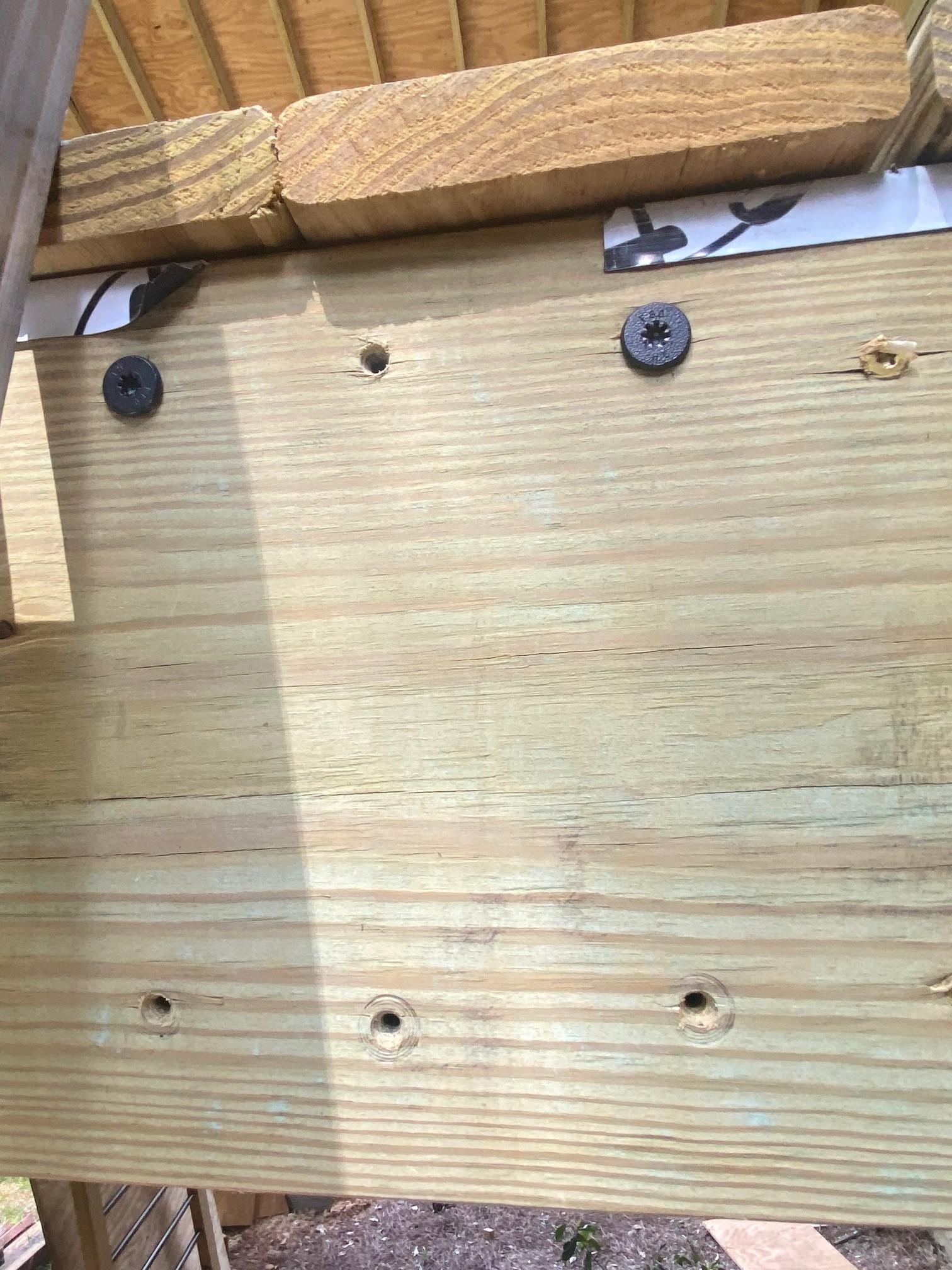

5. There are some unused screw holes in the outer rim. What is the best way to fill them?
6. I know I’m supposed to let the boards weather more after sanding, but I want to stain soon before humidity kicks in (May 15). Is that ok?
thank you for your help!
Martin
FYI, “My friend says I need to stain before installing the railing.” Is wrong.
You have lots of questions but the main issue is the ink stamps. Sand those now and then let all wood sit for 3 months. Clean and and brighten after, and then use a penetrating semi-transparent stain when ready.
-Ony stain exposed wood that is visible to you or the UV.
-MUST weather and prep. Do not skip this.
-TWP, AC stains or Restore-A-Deck.
-No need.
-Do not use a wood filler. Fillers do not work for exterior decking and will not “stain” to blend. You cannot stain now.

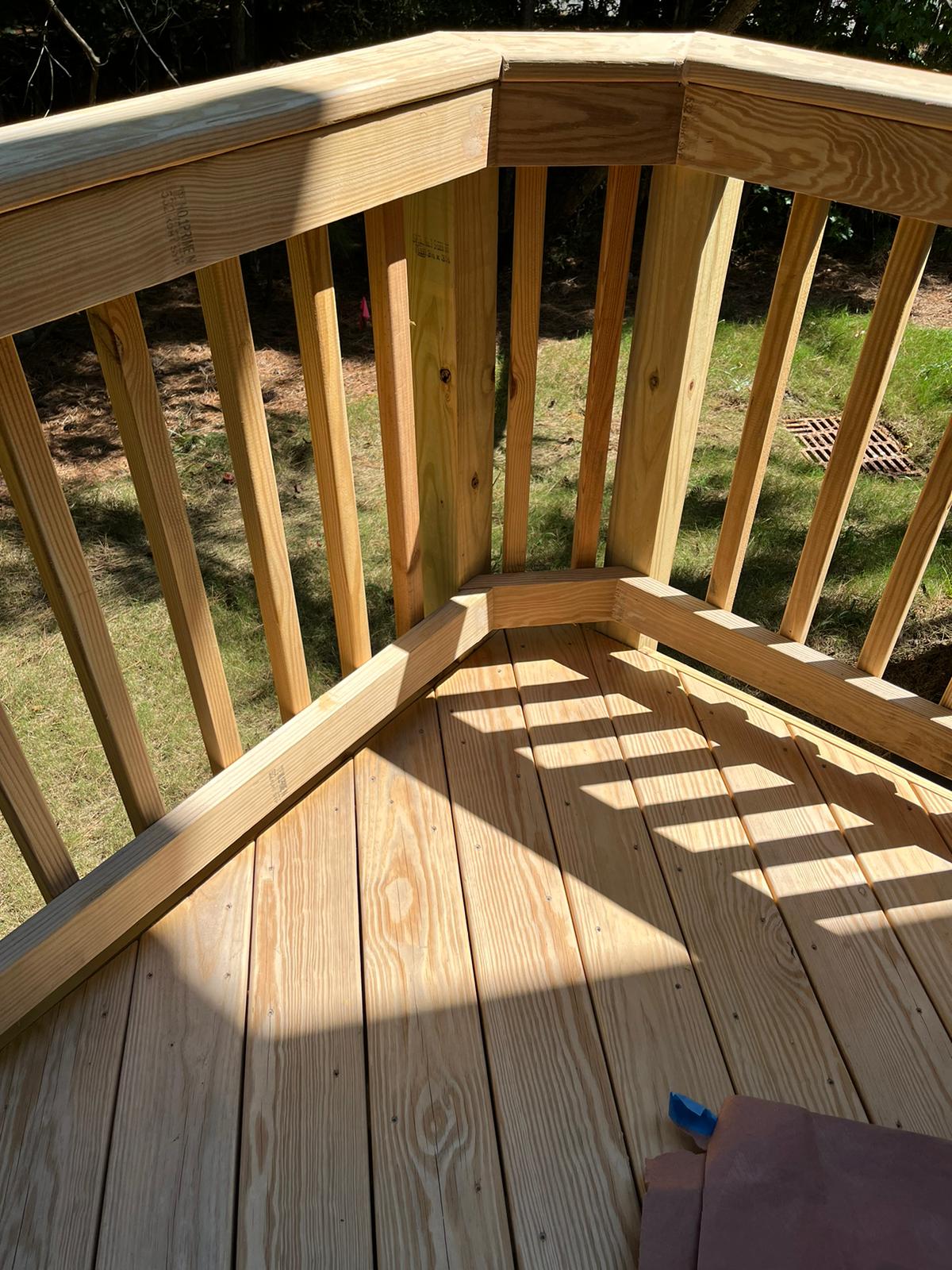

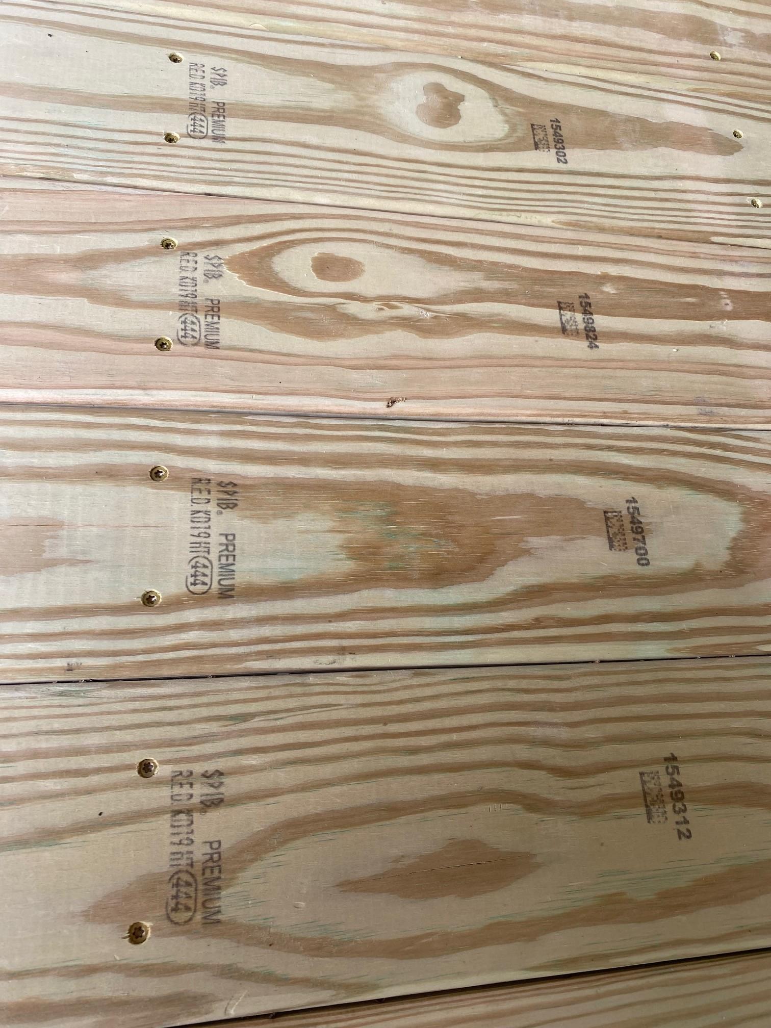

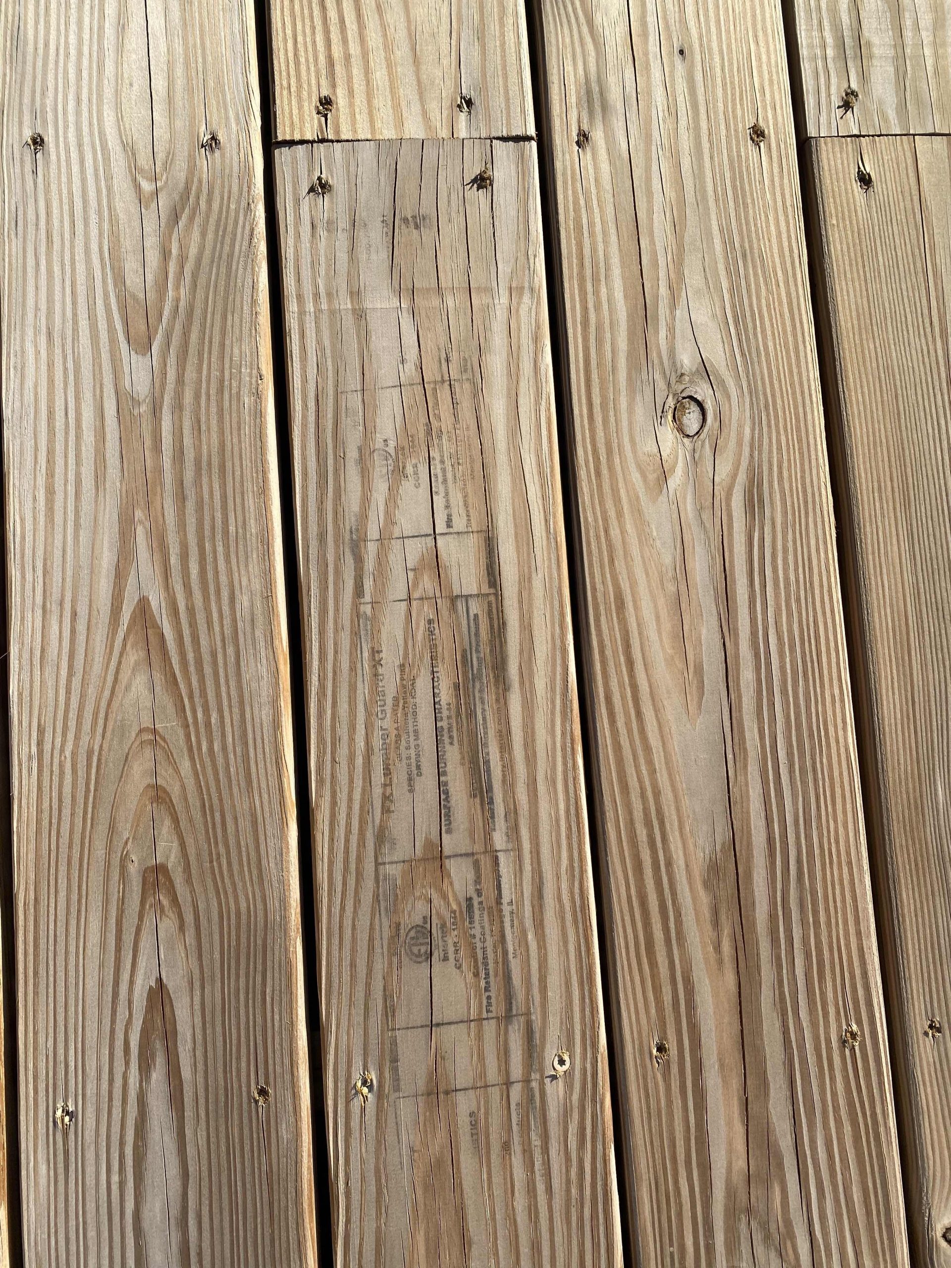

Hi Scott, I have a new deck that is ready to be stained according to the water penetrating after a rain. I have Sherwin Williams Super Deck semi-transparent stain. These deck boards are stamped on the face side! Not real heavy lettering but it is there none the less. I cannot just sand those spots. It will stain differently. I am reading where sanding is a must on new wood to remove the glazing for better penetration, to sanding will seal the wood and cause shallow penetration. I hate to spend the time to sand, but I think I must because of the stamped wood. Also I hate looking at the mill marks. I am a woodworker and that is a big no no. What are your thoughts? I think this is pine boards and I should use 80 grit.
When to stain new wood is not based on water penetration. See this for a more in-depth article:
We would spot sand the ink stamps now, let the wood continue to weather (this will even out your spot sanding) over the Winter, clean and brighten for prep (do not sand for prep) in the Spring, and stain after.
Ink stamp tips:
https://www.deckstainhelp.com/how-to-remove-the-ink-stamps-from-new-decking/

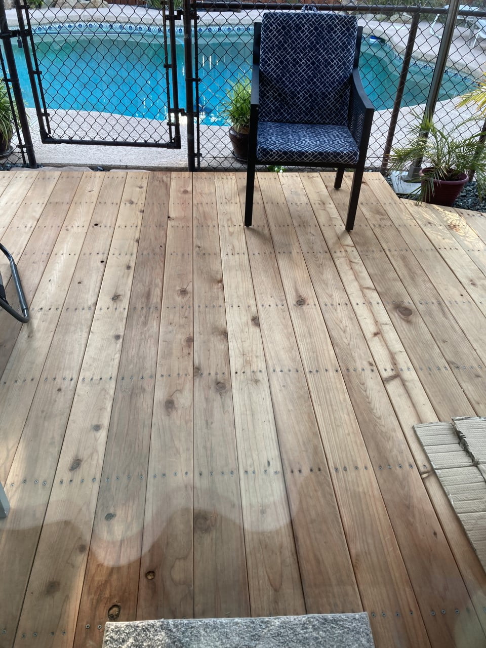

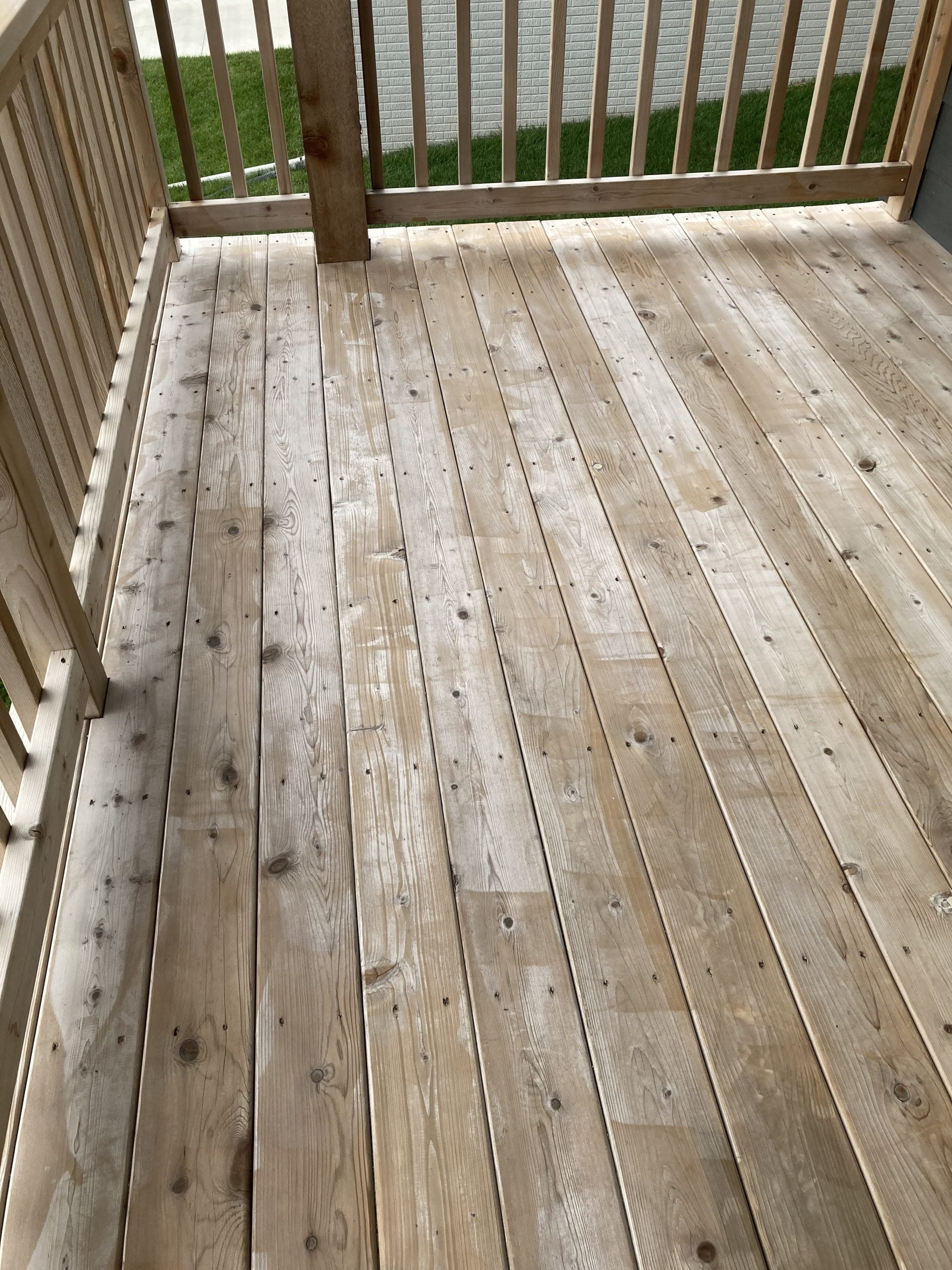

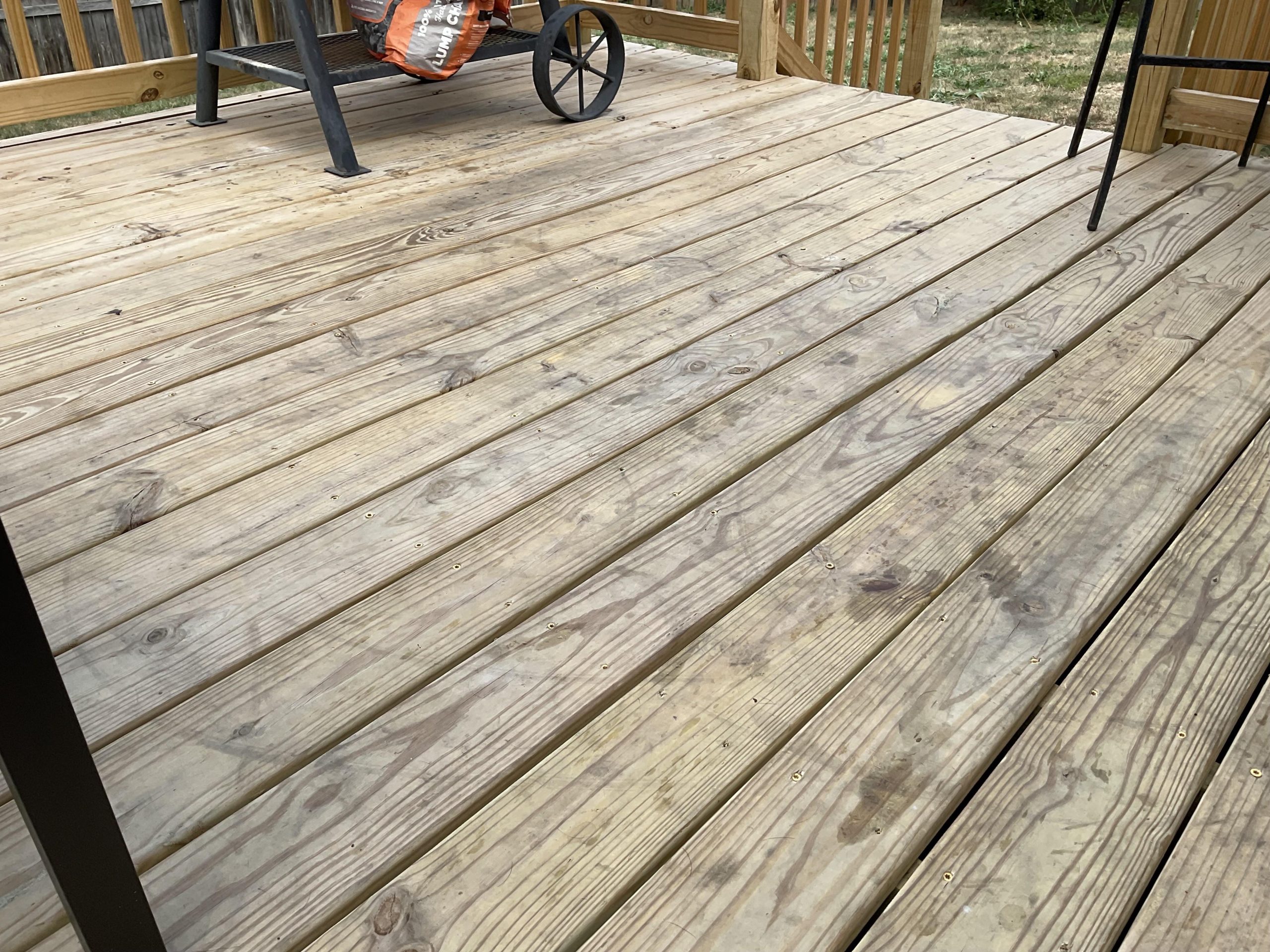

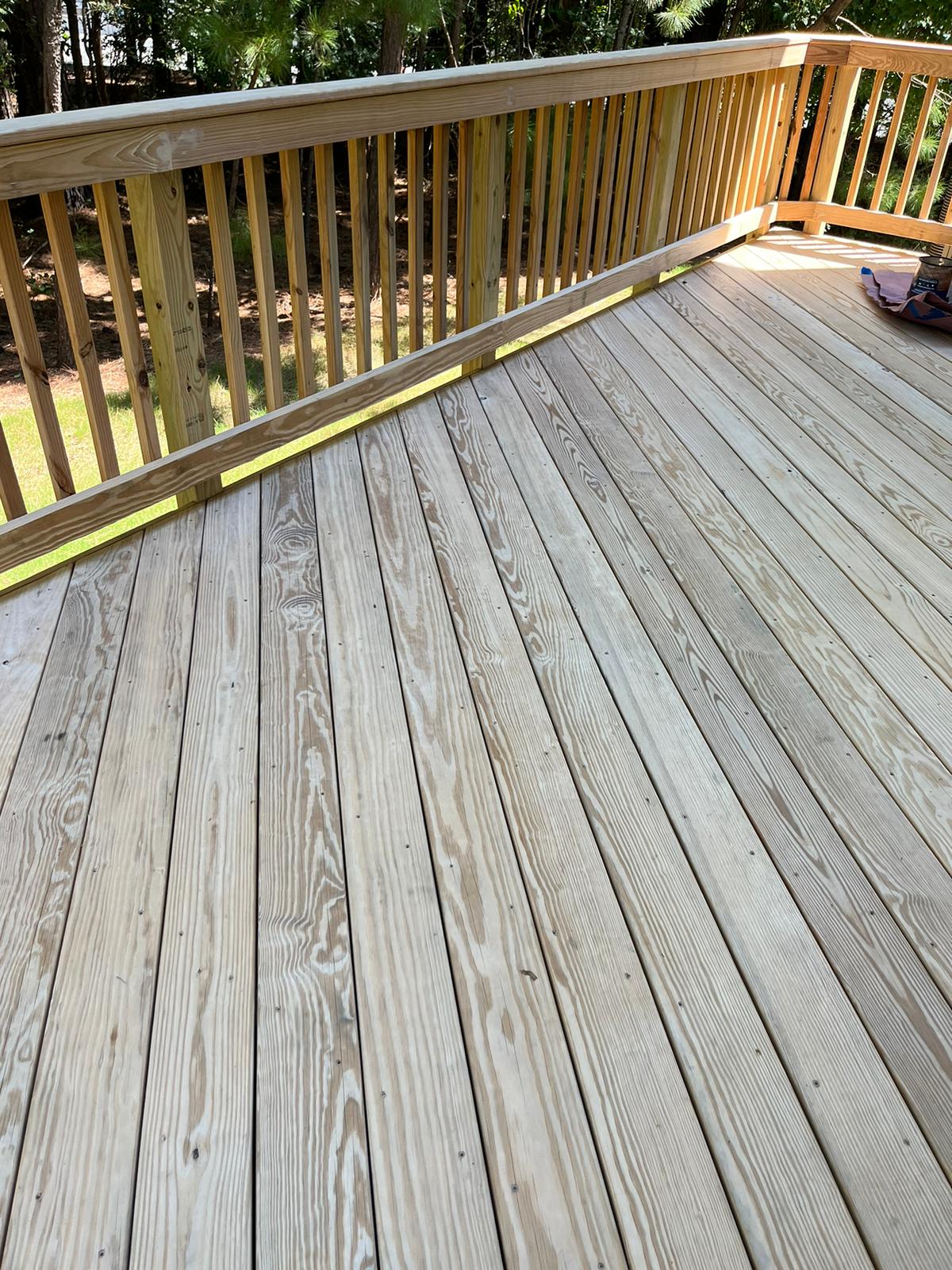

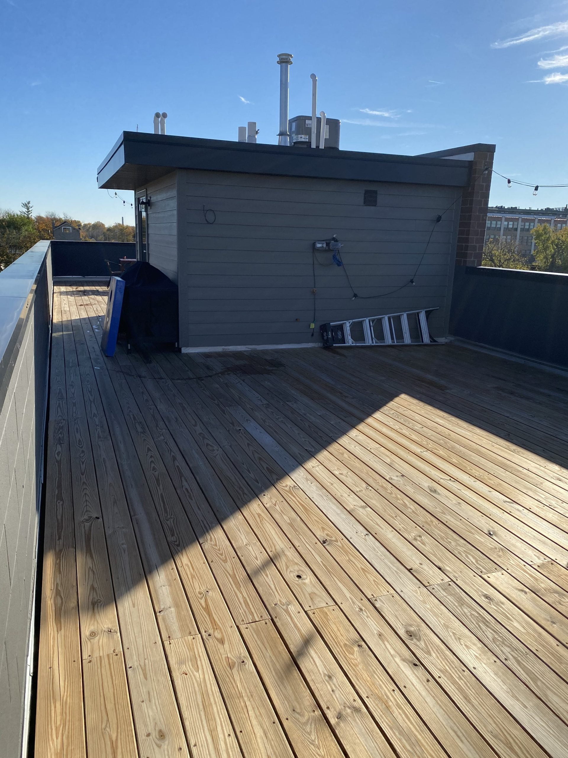

Here is a picture. We have high traffic area on our deck.

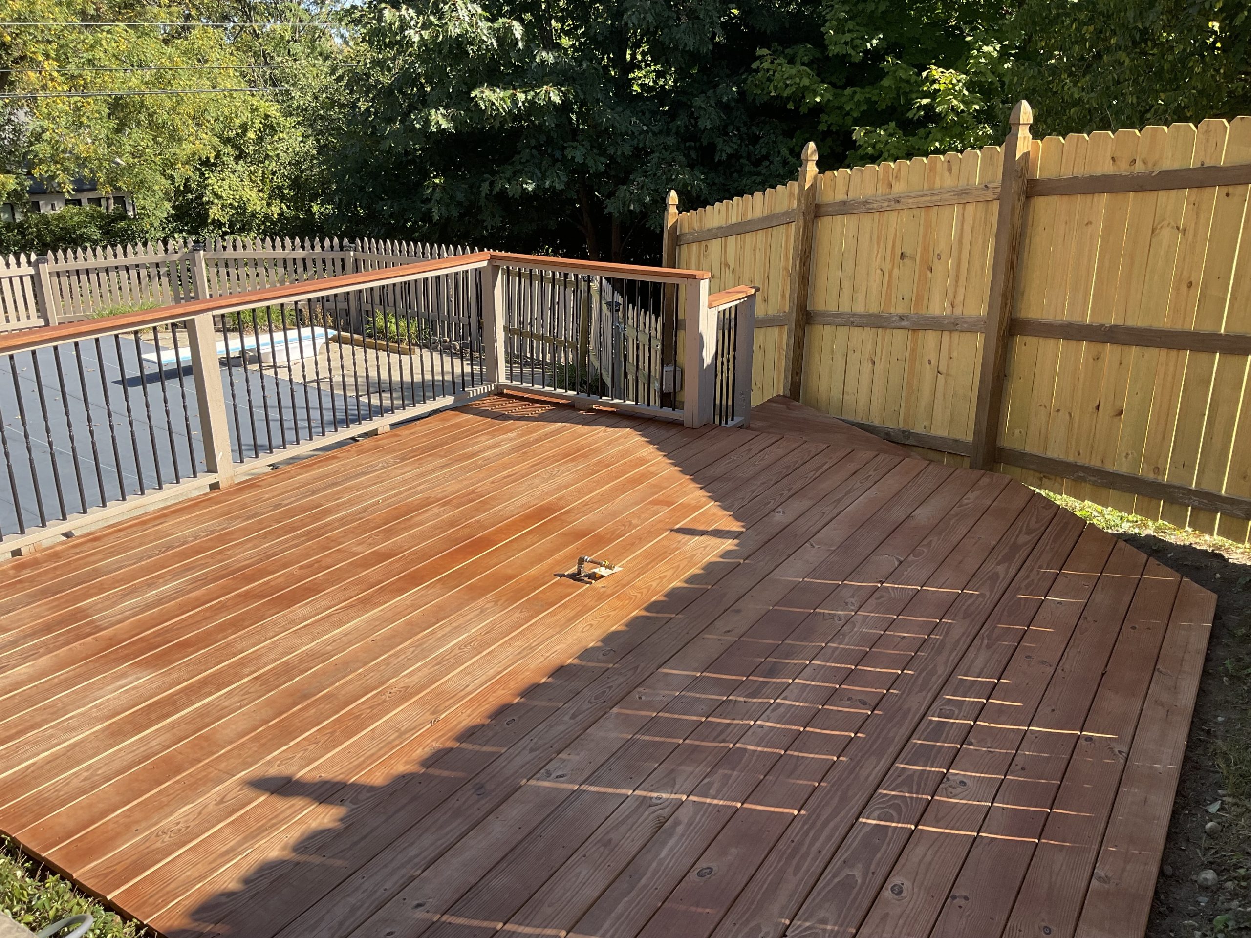

Hello. We just got our deck built in April and was told to stain it in 4 months (which would have been August). It is now the the beginning of Sept, should we wait maybe until the spring? I worry about the wood is not dried out enough due to the rain. Also, I am still to use the wood cleaner and brightener first,correct? Then only one coat of deck stain.
You can do it now or in the Spring. Clean and brighten for prep. BTW, it looks you are scratching/denting your deck when moving stuf arround. That probably will not come out unless you sand it all evenely.

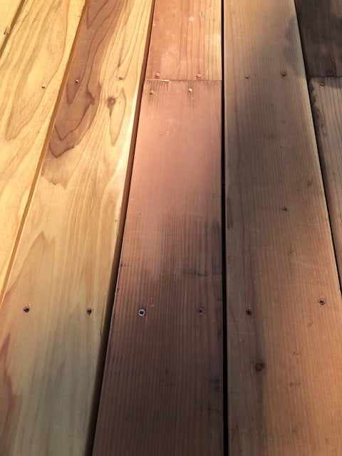

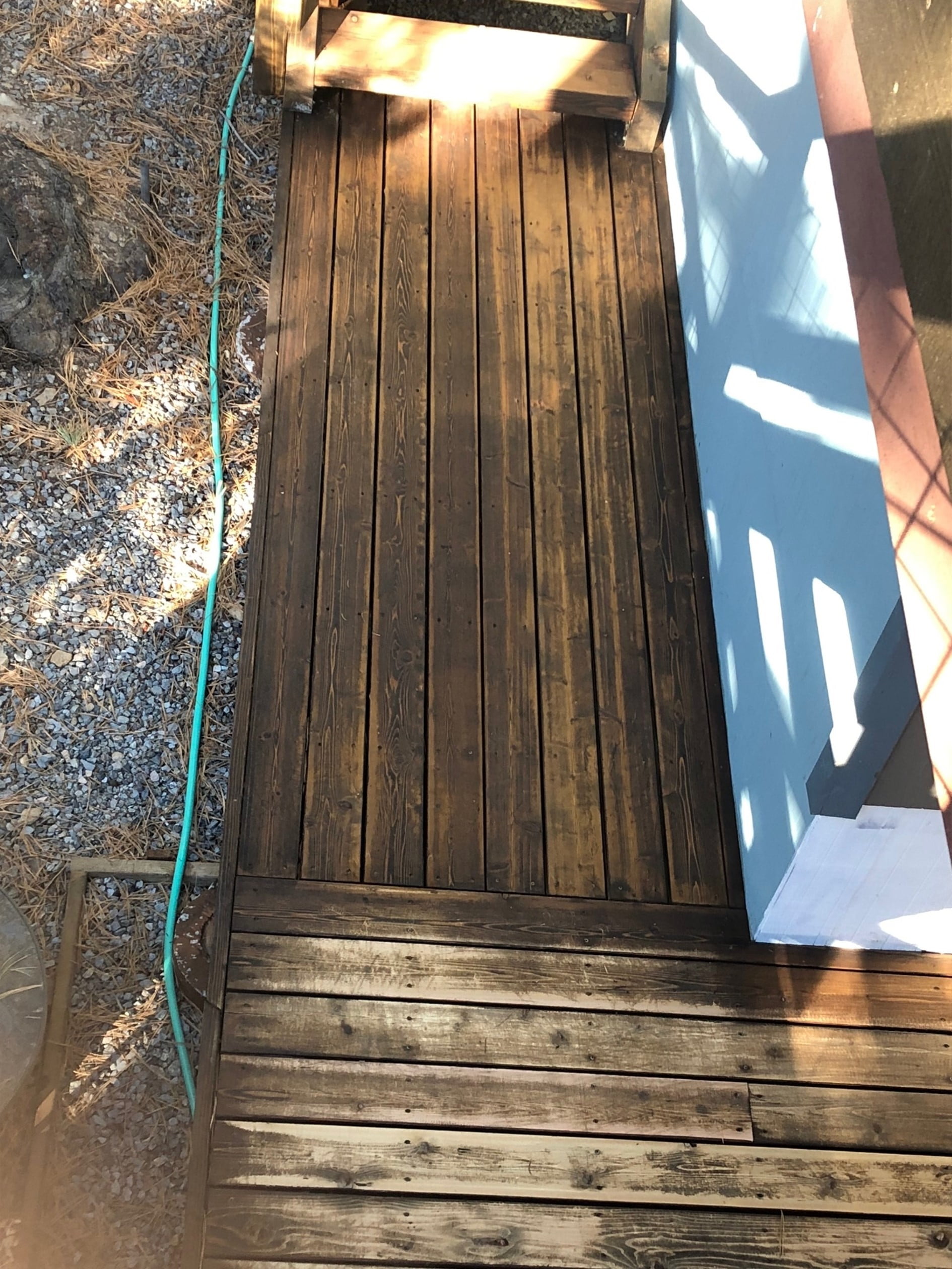

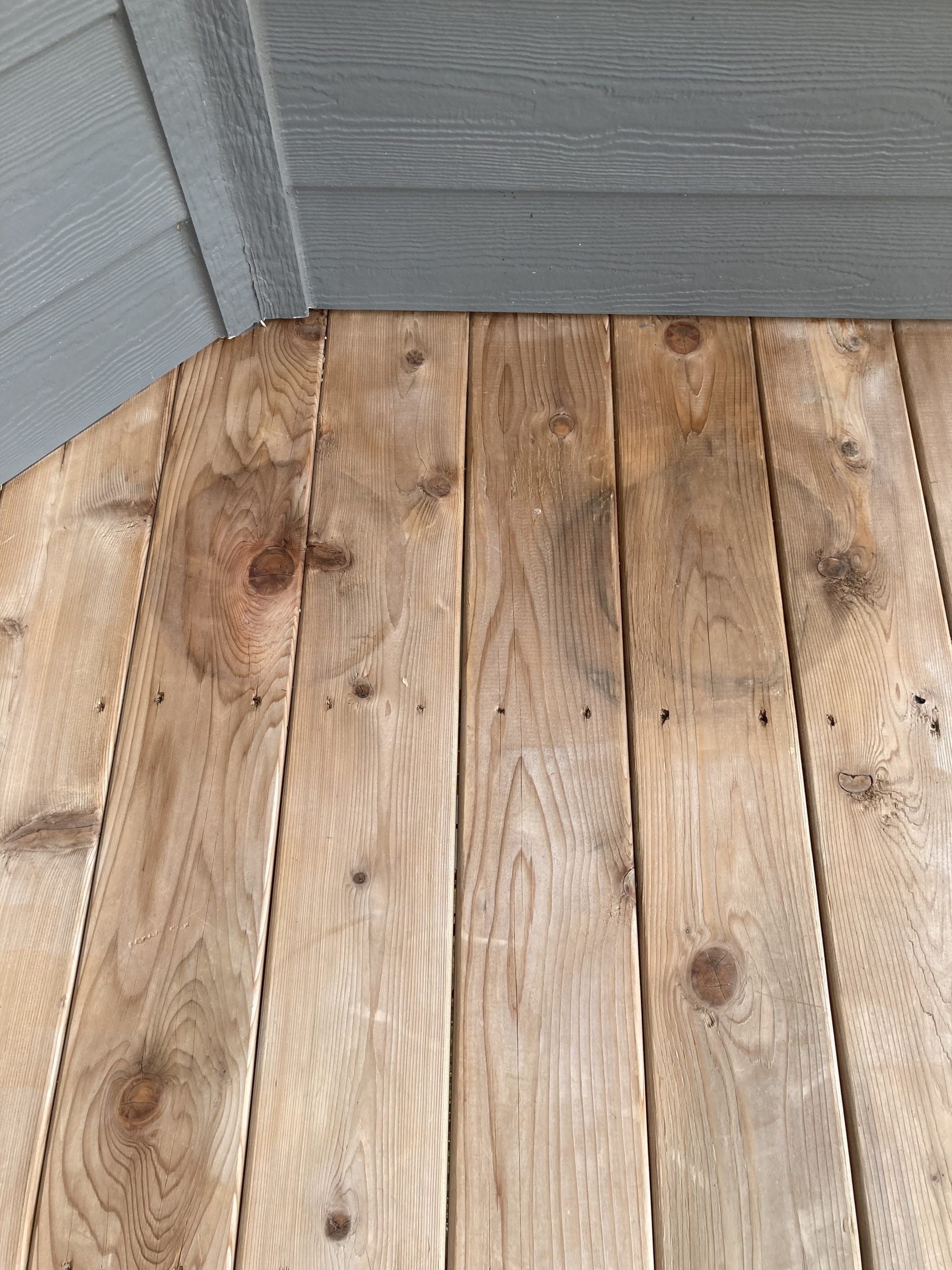

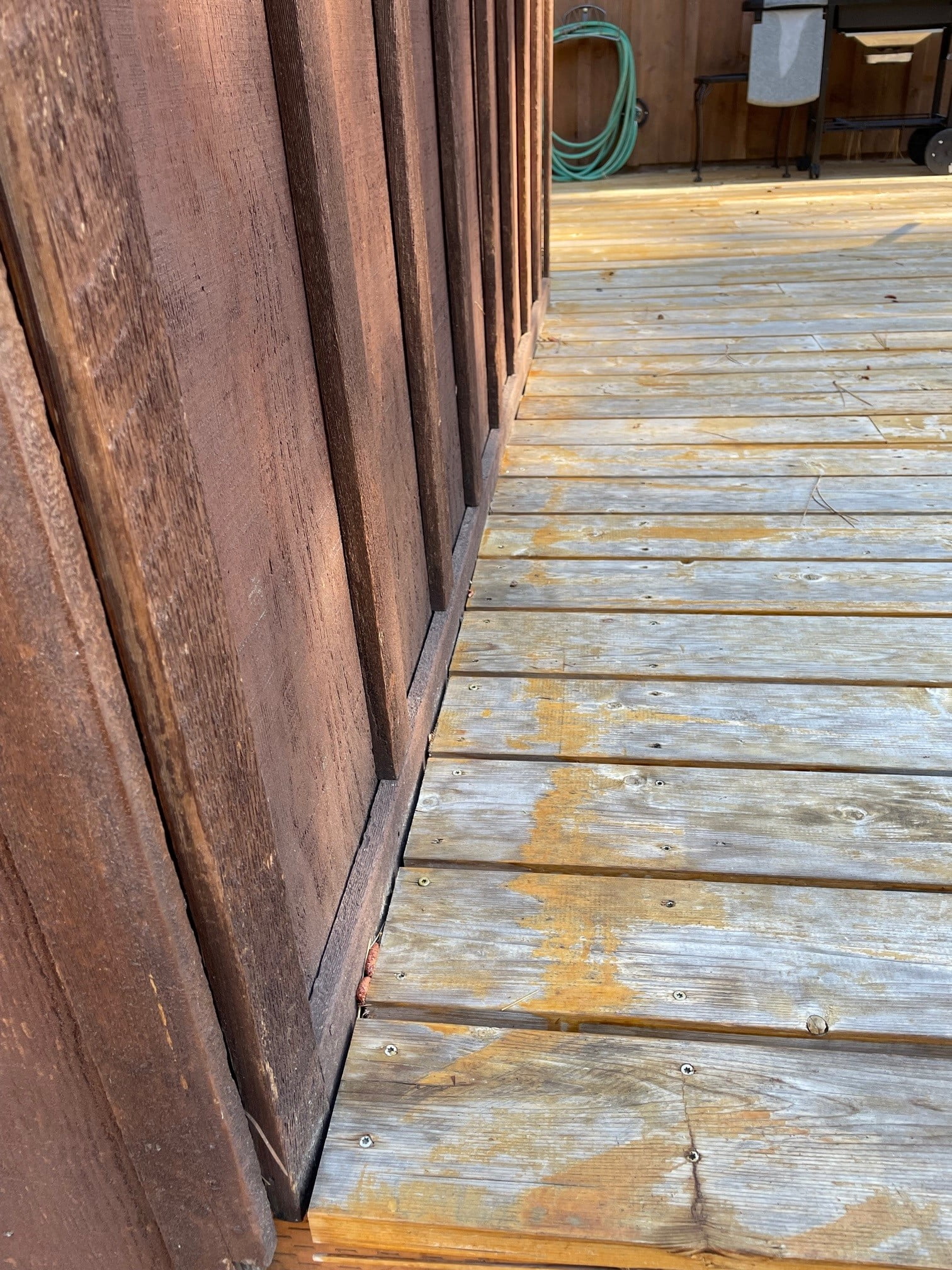

Thanks to your great info I was able to apply a first coat of Restore-a-deck semi-transparent stain to my stairs/deck last August. The wood was new and dry, so the final result was pretty great! You suggested to do another coat of stain 12 months later. I am getting ready for the second coat and wanted to know if I am supposed to do any special prep (strip, brighten, etc.) prior to applying the second coat or can I just pressure wash and apply the second coat?
For future maintenance, about how often should I plan to stain? Since I used restore-a-deck on new wood, can I just keep putting new coats on top of the old after pressure washing or will it need to be stripped eventually?

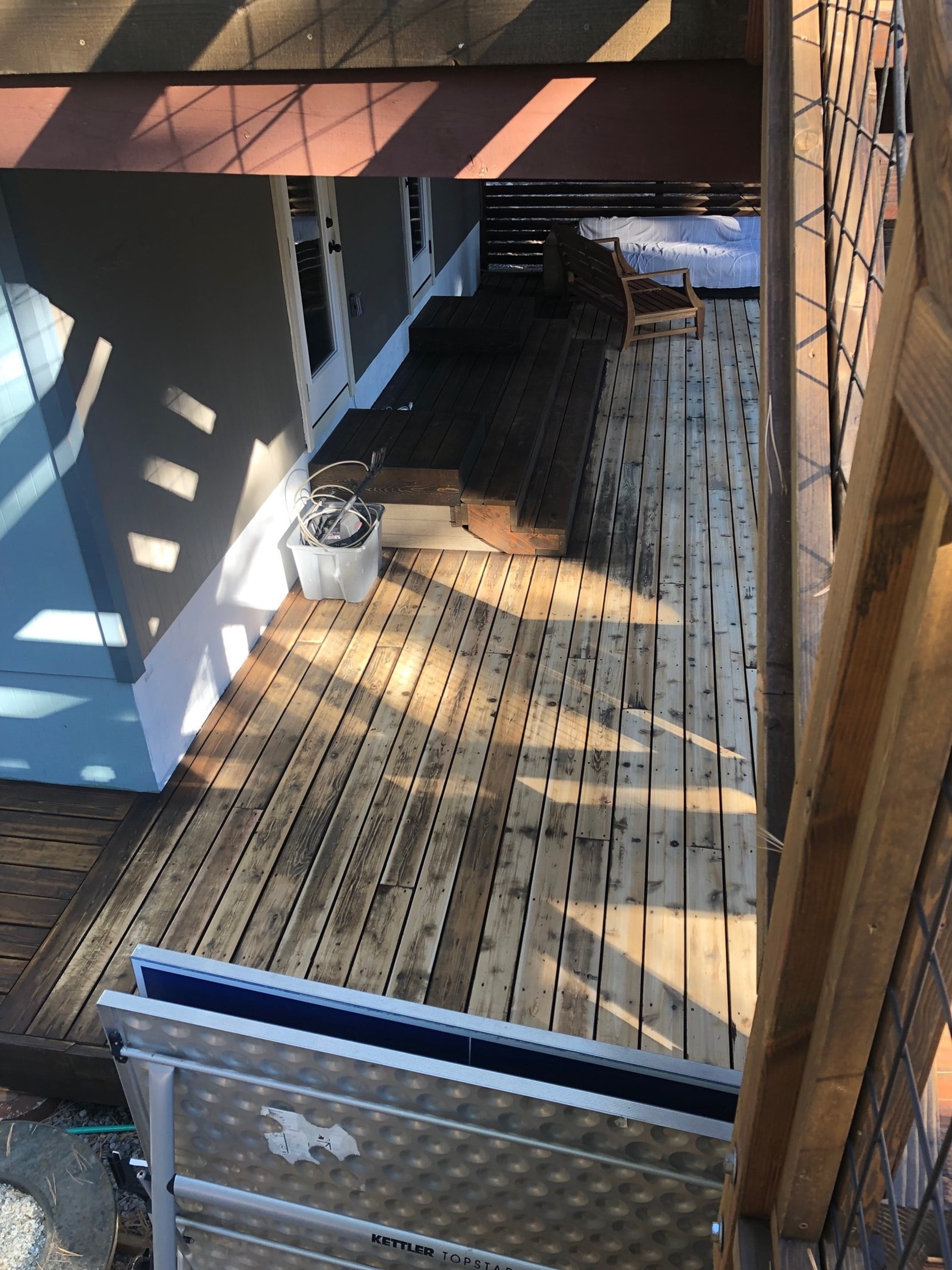

Could you post some pics in the comments for prep tips? Typically you need the RAD Cleaner and pressure washing for prep.
For future applications, you can just clean and recoat as needed.

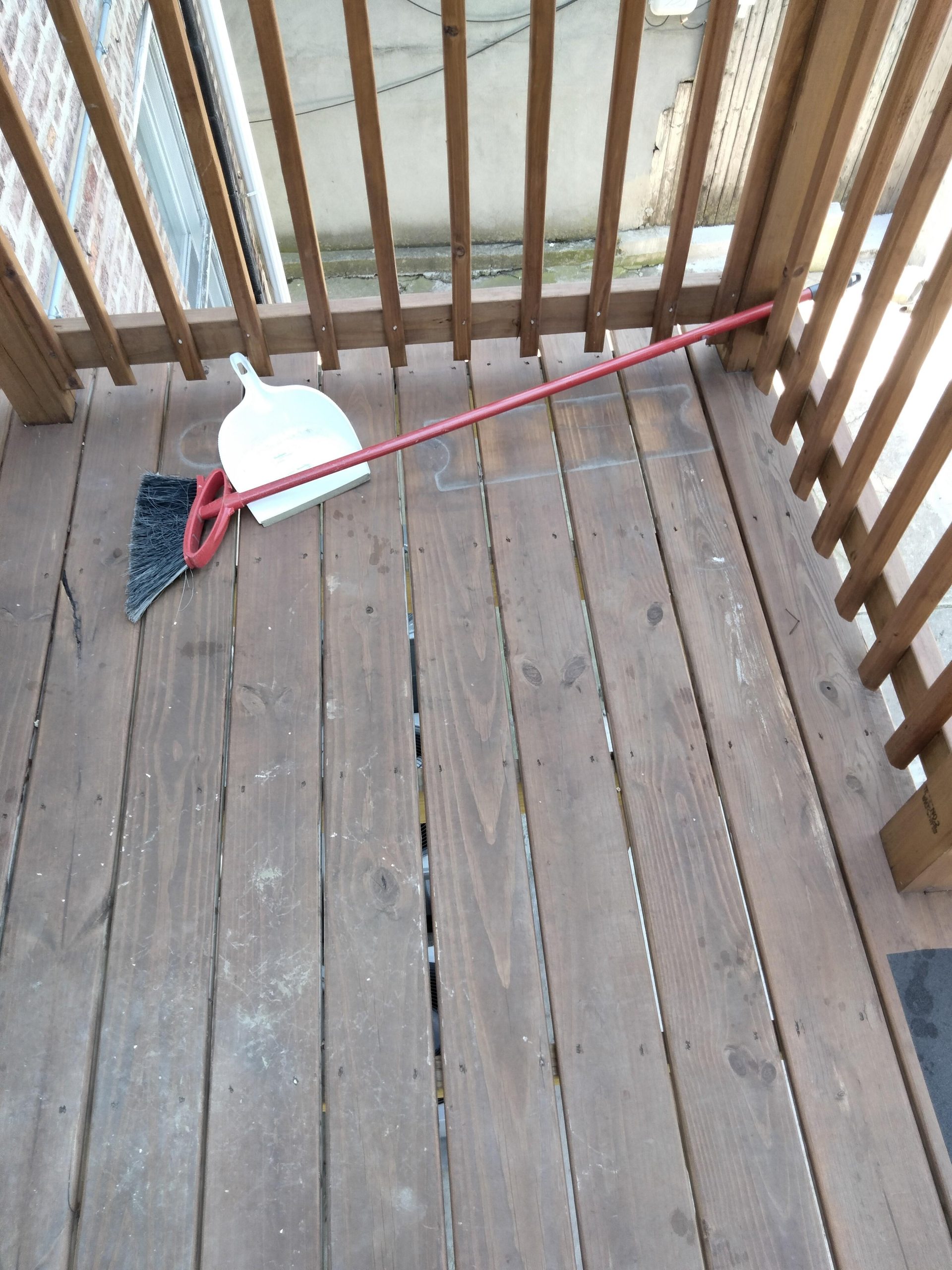

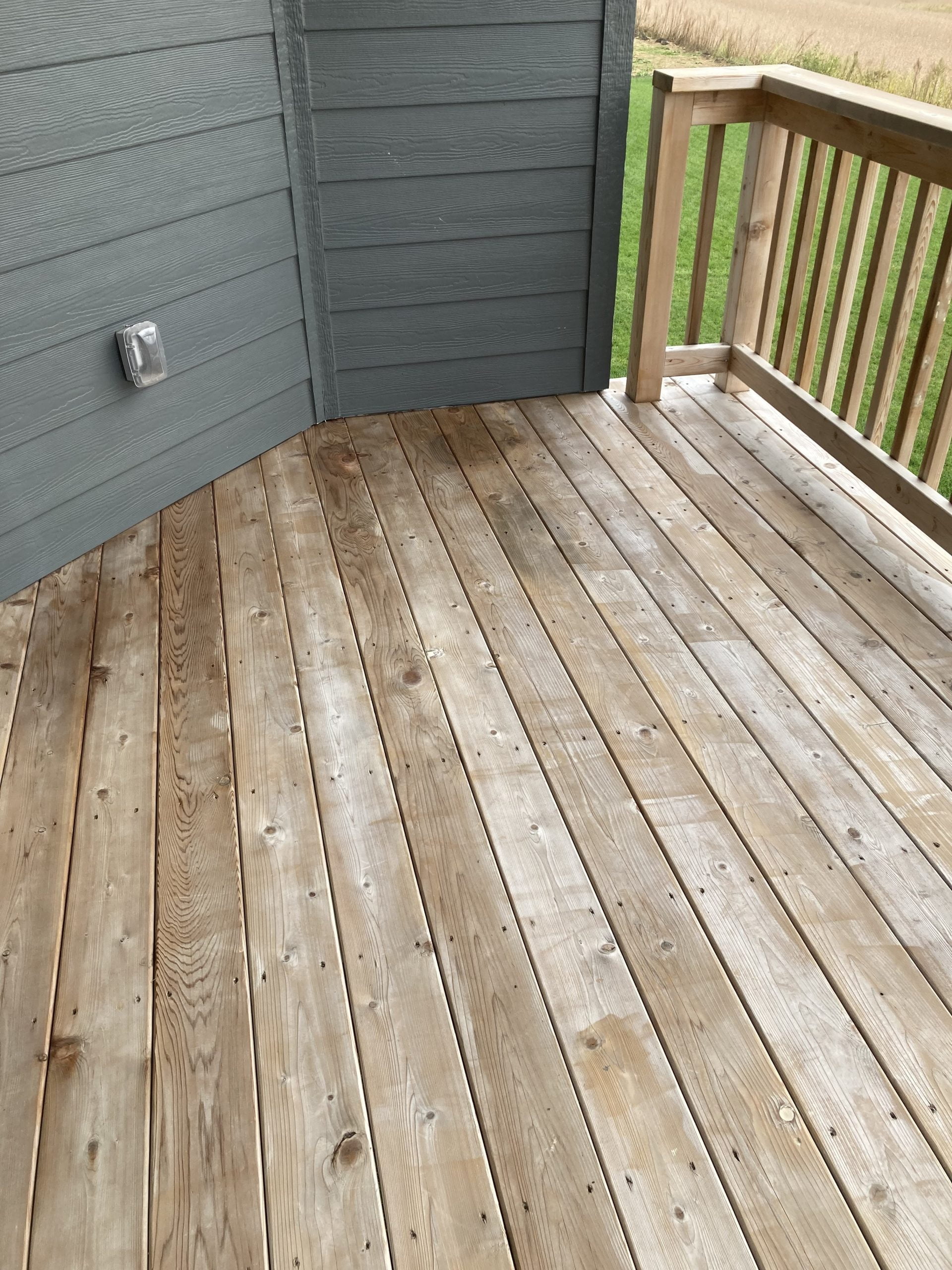

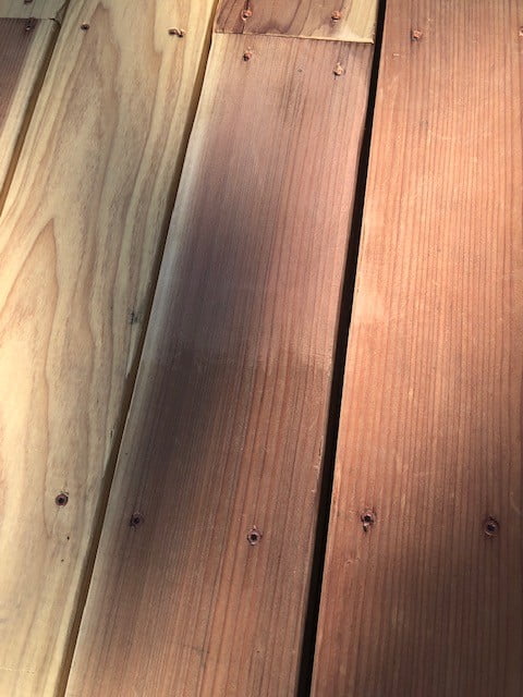

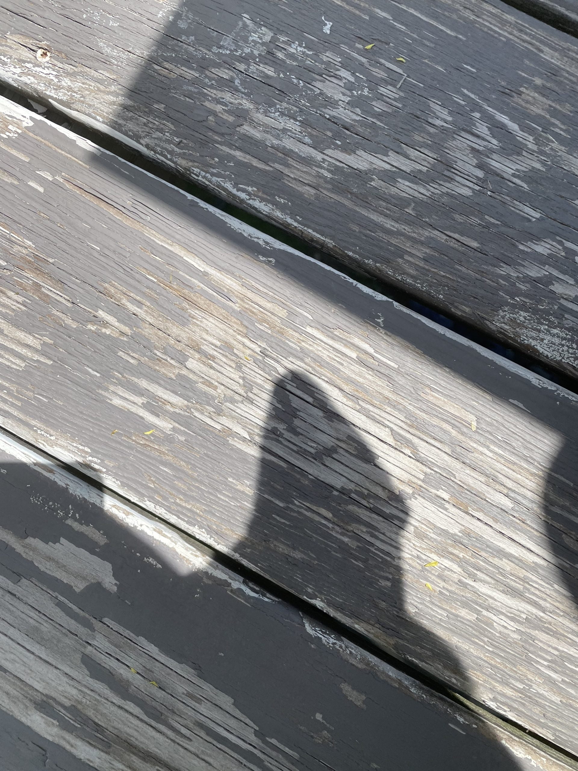

Thanks for the clarification. Here are some pics. Is it okay to skip sections, like the vertical wood slats, if they look good or is it best to just do the whole deck/stairs again?
We would use the cleaner at 1/2 strength (2-3 oz. per gallon) and a light pressure washing for prep. The goal is to remove an dirt, etc. Apply one coat to all wood.

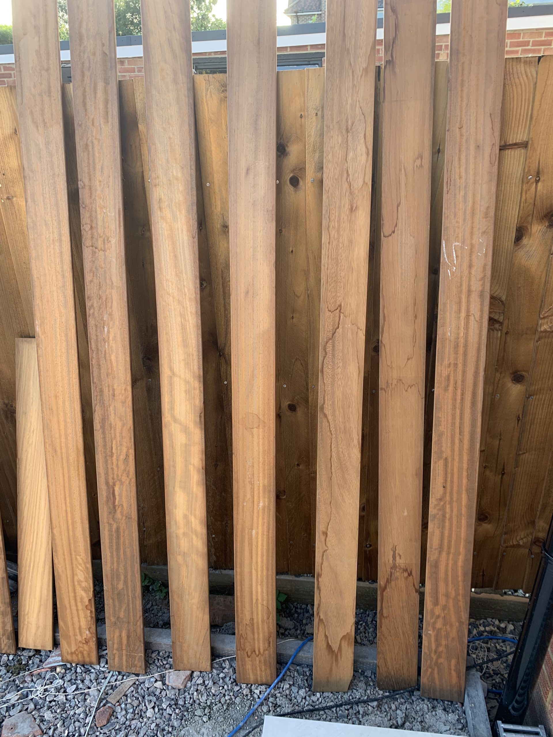

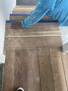

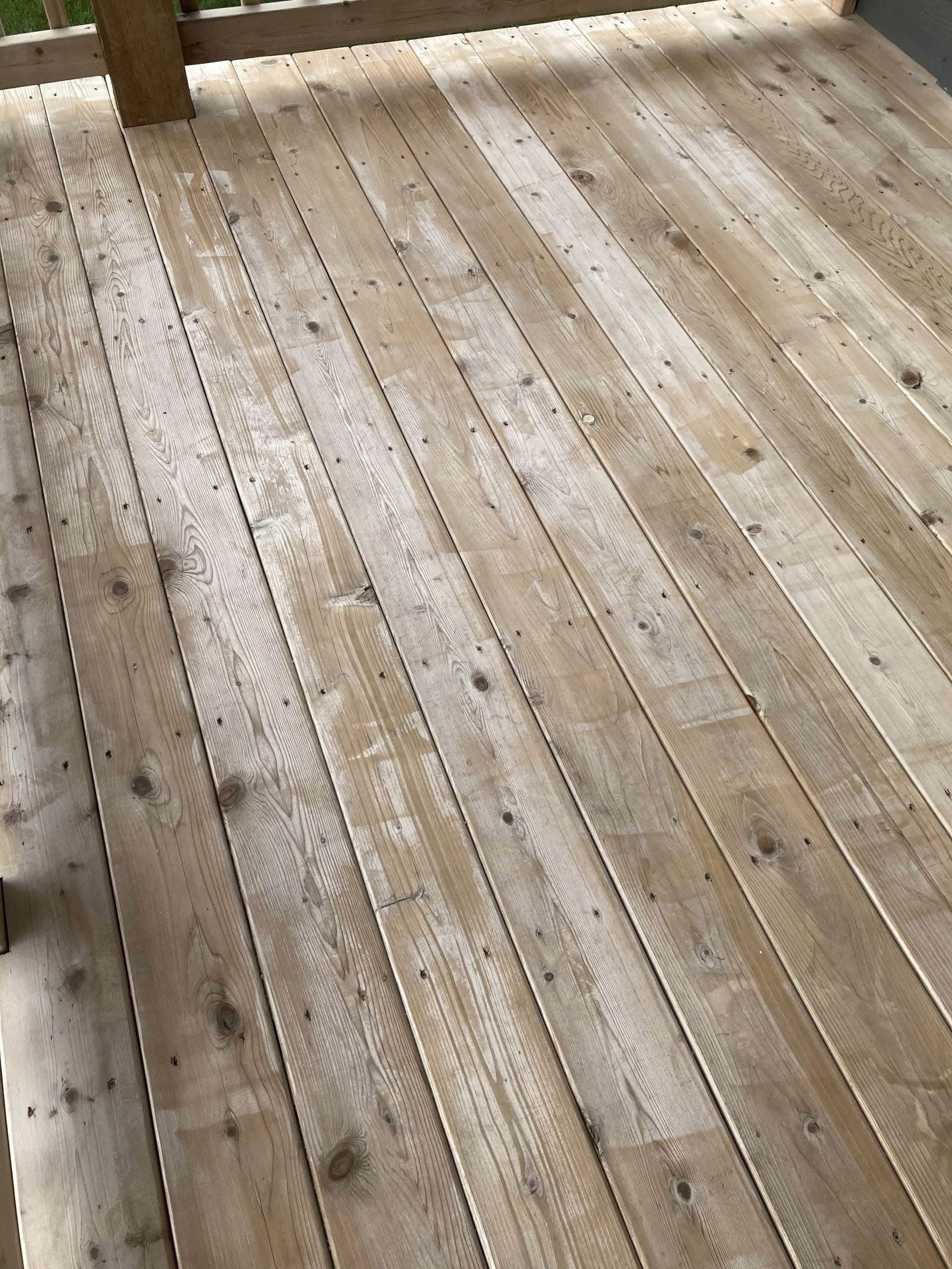

We have new-old decking, pressure treated pine at least 6 years old, which we removed to flip each board. The top was painted black and it was peeling (we removed the loose paint). Now we have the old underside facing up. Along with cleaning, I will be sanding to smooth because some boards are cupped. I will use a floor sander because I have done many interior hardwood floors with one in the past, so I have experience. Do you think I can use 36 or 40 grit, or would 60 be safer on the pine? Once it is sanded I plan to leave it for 3-4 months (very sunny location in northern Michigan), then clean and brighten, then stain with Restore-a-Deck water base formula. Is this stain a best option, or would you recommend another?
36-60 is good. Sanding tips:
The rest is a good plan. Only one coat of stain.
Thank you! I read the how-to-sand page and it was helpful, as are all the pages here. Here are before and after pictures so far, before sanding.
No pics.

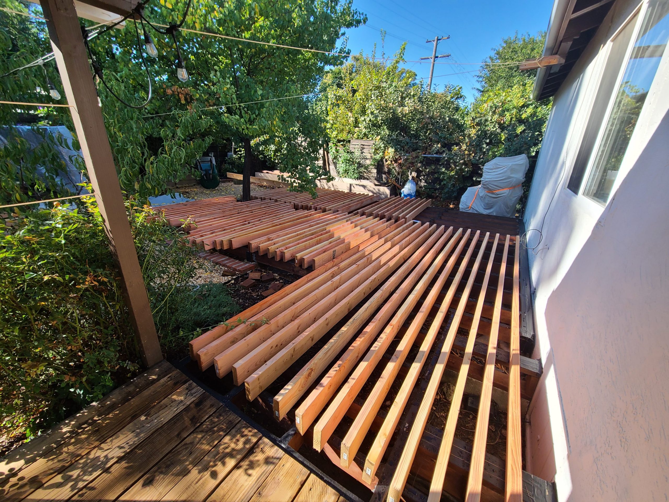

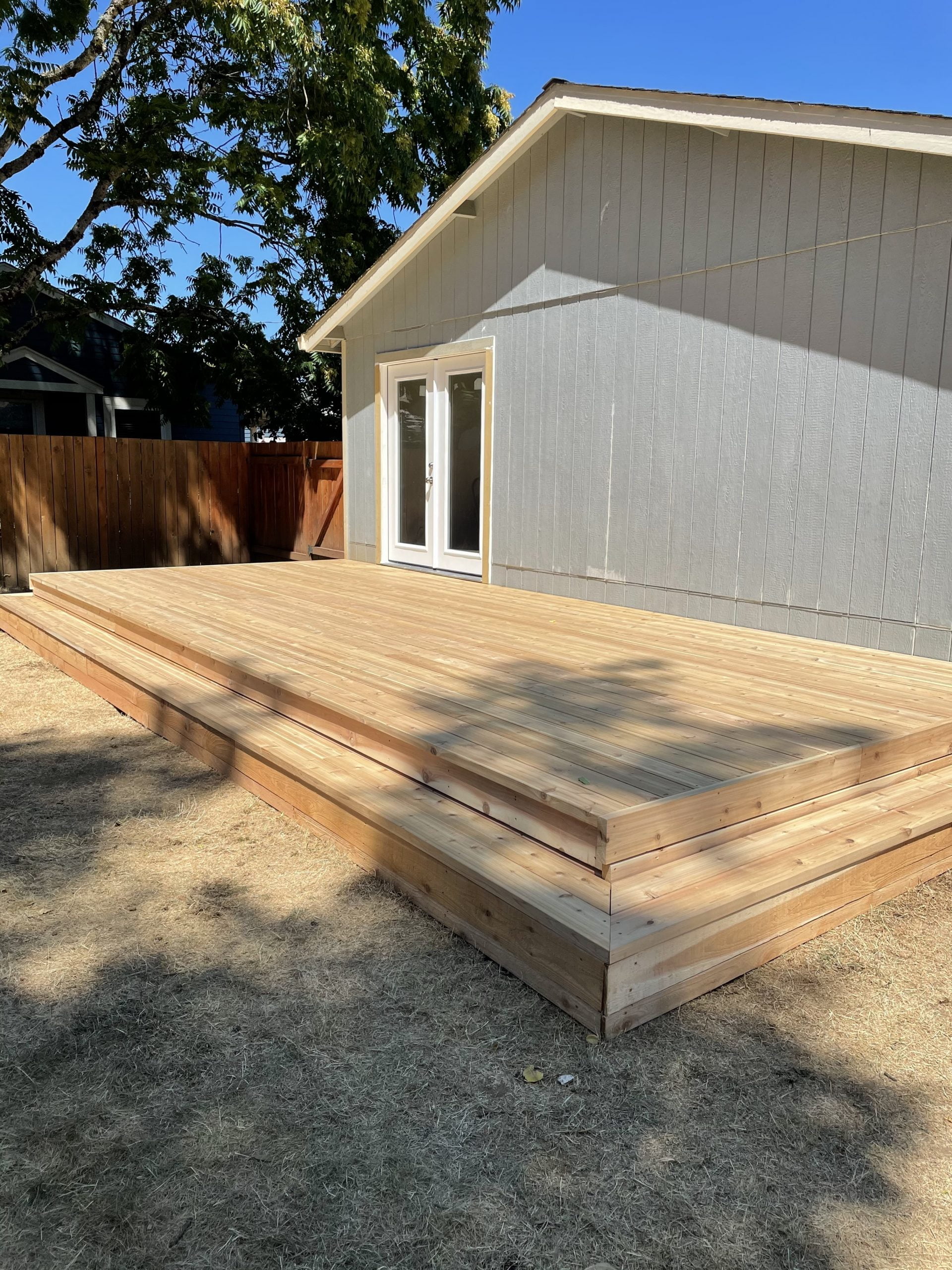

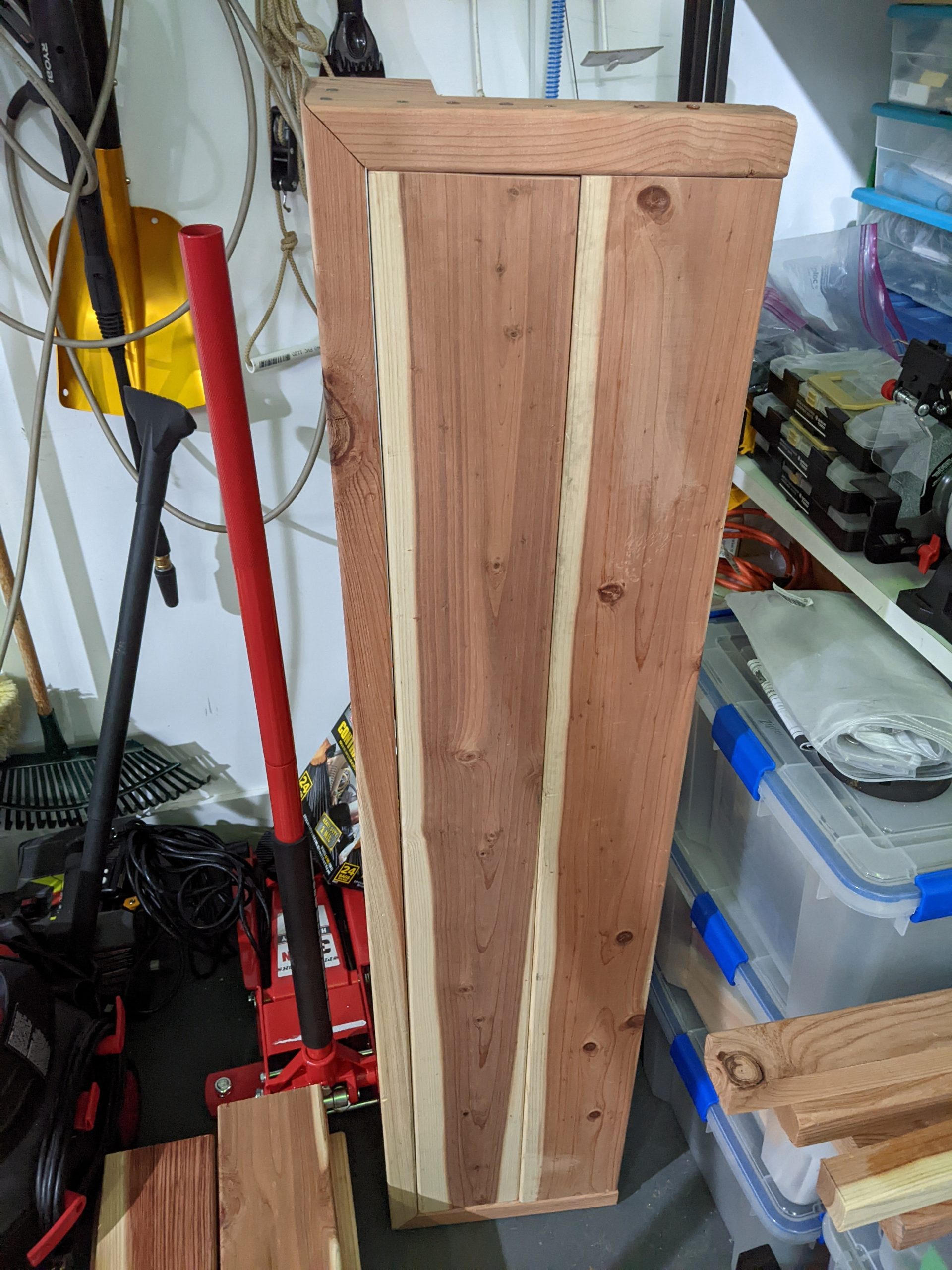

Building a new deck in Northern California using doug fir 2×6 decking. The deck is at grade, so will have minimal ventilation underneath. Is there an advantage, in this situation, to use the penetrating oil stain on the underside as well to help fend off rot?
Also, I must say it feels wrong to let the deck get rained on for months before staining. Is there a penetrating oil stain that you would recommend after weathering for 1 month?
No advantage or need to stain the undersides and in fact, in many cases, it can create issues:
https://www.deckstainhelp.com/staining-undersides-of-deck-boards/
You cannot skip the weathering process and you are incorrect about it “feeling wrong” about waiting. It will not harm the wood and helps the staining process.
Thanks for the quick response! So, there’s no concern about cupping with a deck that has poor ventilation underneath? People say that the top of the deck board drying faster than the bottom creates this, and I was wondering if by using penetrating oil on the bottom it might help fend off some of that underdeck moisture?
No, it would not help and would feed mildew at some point. Only thing you can do is create as much airflow as possible to allow the underneath to dry out.
Here’s a photo, in case that helps.
Looks like plenty of ventilation, as long as you space between each board rather than butting them tightly. We just took up all of the deck boards at the house we bought last year, because they were not spaced, and refastened with a 1/4″ space. Much better breathing!
Yes. Spring of 2024.

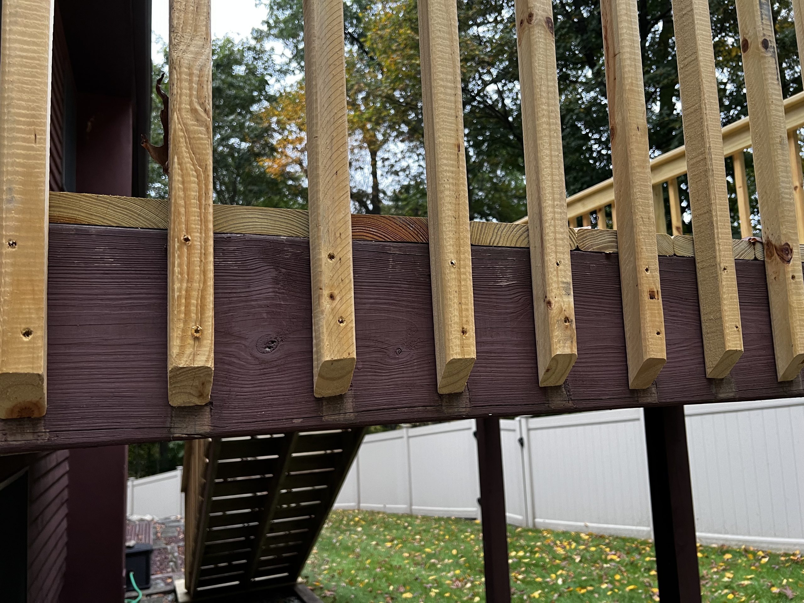

Just had porch redone late June up in northern New Jersey so it’s been about 3 months. Constructed out of WeatherShield appearance grade pressure-treated board southern yellow pine lumber (Product/Purchase tags stapled on wood stated – “weathershield premium wood products awpa u1a uc4a mca reten std 0.15”)

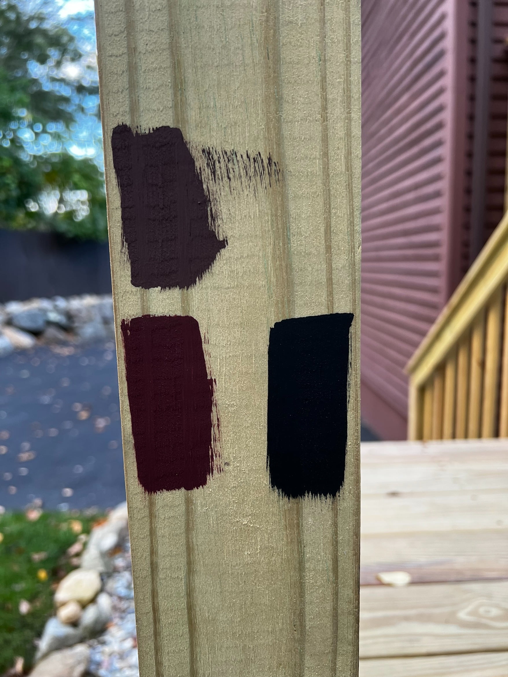

The samples stains we are using is Benjamin Moore’s arborcoat waterborne exterior SOLID stain.
1) Is it necessary to sand/clean up in general the screw holes & other impurities before staining? If truly desired, how would I go about it – sanding?
2) Adding onto the last question their are places where the wood has yellow marks & cement dust. Is this a definite place where I would need to sand?
3) Adding even further to the last 2 questions, I did a stain & single paint color tests. For stains one being black & other maroon, lastly single paint test in maroon. How would I deal with cleaning this up, sand off the color? Especially before winter before it really soaks into the wood?
4) Unfortunately, the contractor left some old boards that had old paint on them – image included. In order to fix this critical error, can I just sand off the old paint and then stain?
5) Is there a specific way to protect / deal with the porch metal braces, & obviously don’t stain over them?
6) With the humidity reader set to yellow pine selection – it reads around 7% – 9%, so safely under the advised 15% marker. While doing a water drop test in several places & letting sit for 10 minutes, the water did not soak into the wood – images included (mind you this was done at 6pm). By this information is the porch ready to stain?
7) Since it’s fall, there’s going to be a lot of debris like leaves, falling onto the porch, I would like to get the porch stained in October or November before snowfall. Though perhaps overall I just need to wait till spring as the earliest to stain?
8) Lastly if I do ultimately need to wait until after winter, do I need to protect the porch with a tarp so the wood doesn’t become too weathered? Additionally, when spring does come around since the porch weathered for so long in the winter would the staining preparation process be different? Meaning, will I have to use a degreaser or borate to clean the porch first, or is it just a simple rinse before officially staining?
Wait until Spring to prep and stain. It is not ready yet. Do not tarp it. Leave it fully exposed.
-No need to sand anything. Clean and brighten for prep. You can sand off your stain marks now.

Then lastly to go back to my previous question #4. As I look back, I didn’t supply the photo.
(Image included this time)
Prep: https://www.restore-a-deck.com/restore-a-deck-package-300.html
Yes, you can sand it but it looks like a solid stain. That means it is difficult to remove and even more so due to the tight spaces.

I have a new wood deck that was installed one year ago and not stained until 9/21/23. Two weeks prior the deck was pressure washed but not cleaned and brightened as you recommend. One coat of Flood pro series semi-transparent acrylic/oil stain was sprayed on. The application is very uneven darker in some areas and lighter in others. Should I have the contractor apply another spray coat and back roll or would you recommend another course of action? I am willing to wait until next year if that is best per your recommendation. I do not want peeling or make matters worse with the second coat now.
Do not add more now. It needs to be stripped and brightened to fix. You can do this in the Spring.
Pictures from my above comment. Thanks!

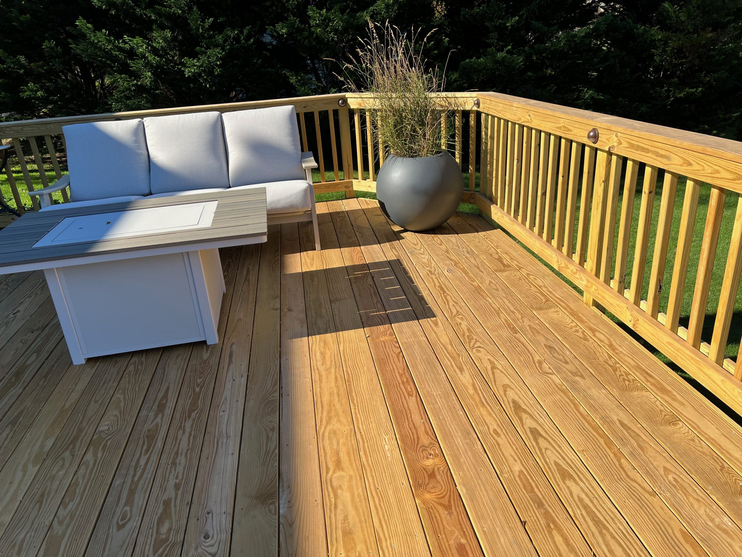

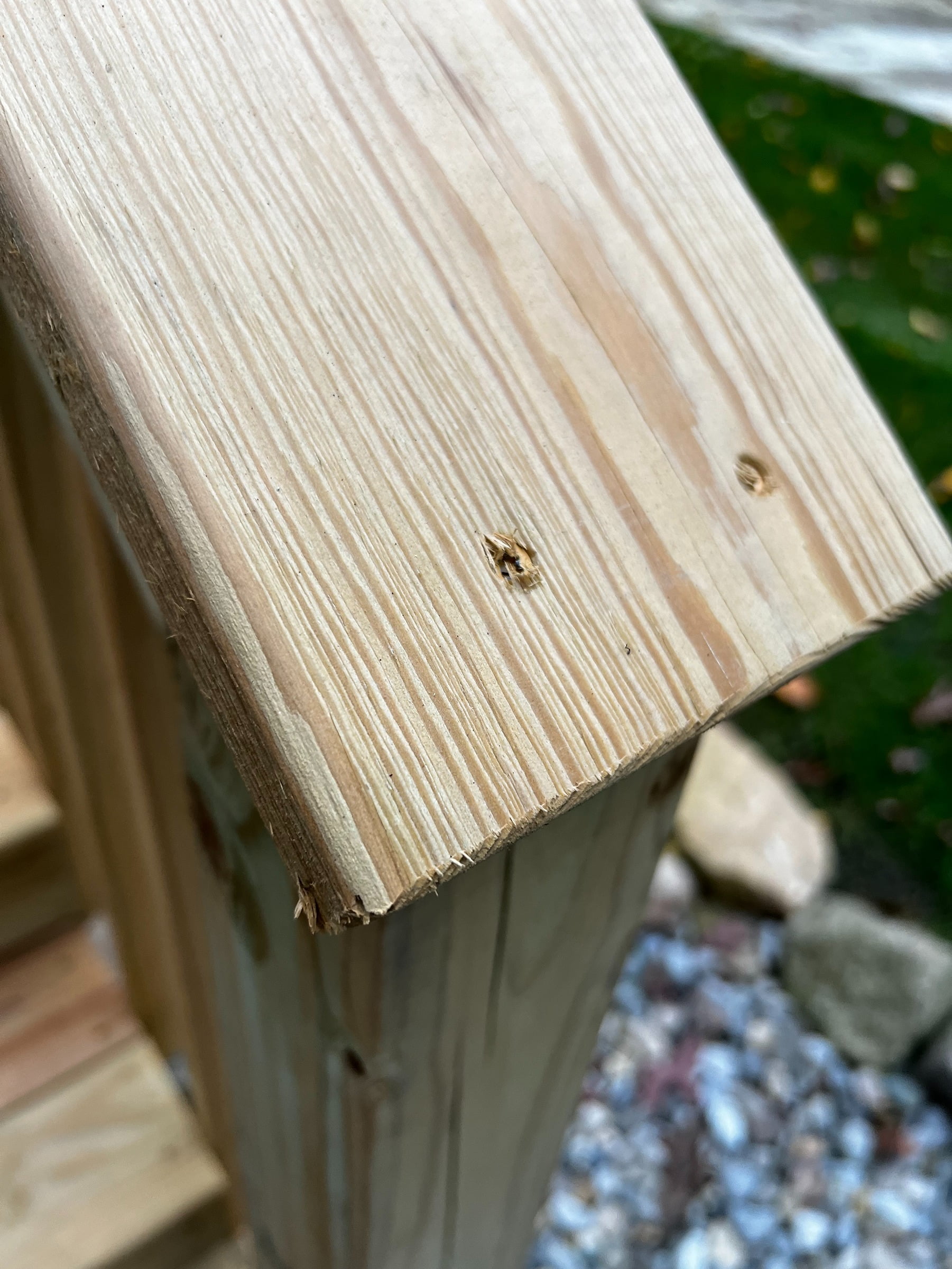

I have a NEW brand deck at a new home in Charlotte NC location (Hot weather, with unusual rains this year ’23), looks like made of Pine threated wood. Built in Feb ’23.
Now looking to have it stained for the first time. I have done the prep with Valspar all in one wood prep. But stopped trying to figure it out if I should cover the screws heads with wood filler to create a neat look? That’s my first question.
Wood looks and feel kind of smooth still, very few screws look like have moved from straight to slightly inclined position, that’s what most concerns me. I am ready to Staining it, should I do it now? that’s my second question.
We most probably continue to have good conditions through October from there I should have to wait until March ’24, But that will be more than 12 months from the time it was built. The Builder emphasized to have it stained ASAP.
Last one, got Valspar stain and sealer for exteriors, I saw your review about this product :( what should I use instead to secure a long life of service? Pictures attached taken today.
Thank you very much!
No, never use wood filler on a deck. It doesn’t work. You are okay to stain now. Return the Valspar stain, it not good.

I have a home in Bend, Oregon (dry high Oregon desert). We installed a new deck in April 2022 which the contractor immediately stained when it was finished. Attached is the picture of what it looks like today 18mo later. Sure looks different! Another contractor said it needs to now be sanded down before it is re-stained. I plan to do the work this week. After watching your video, can I just use deck cleaner and then a brighter before I stain? I’d rather not sand it down. What process do you suggest? Also, what brand stain works best for the high Oregon desert? Thanks much for your advice.
Strip (not cleaner) and brighten while pressure washing for prep. Use Restore A Deck Kits.

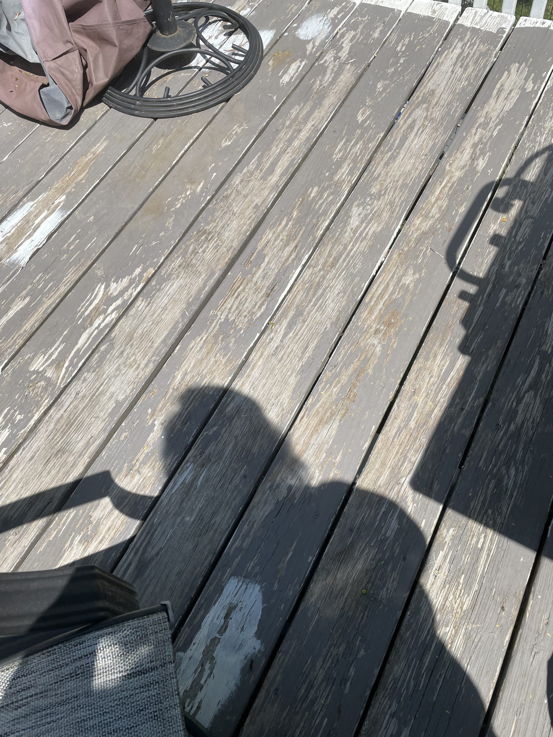

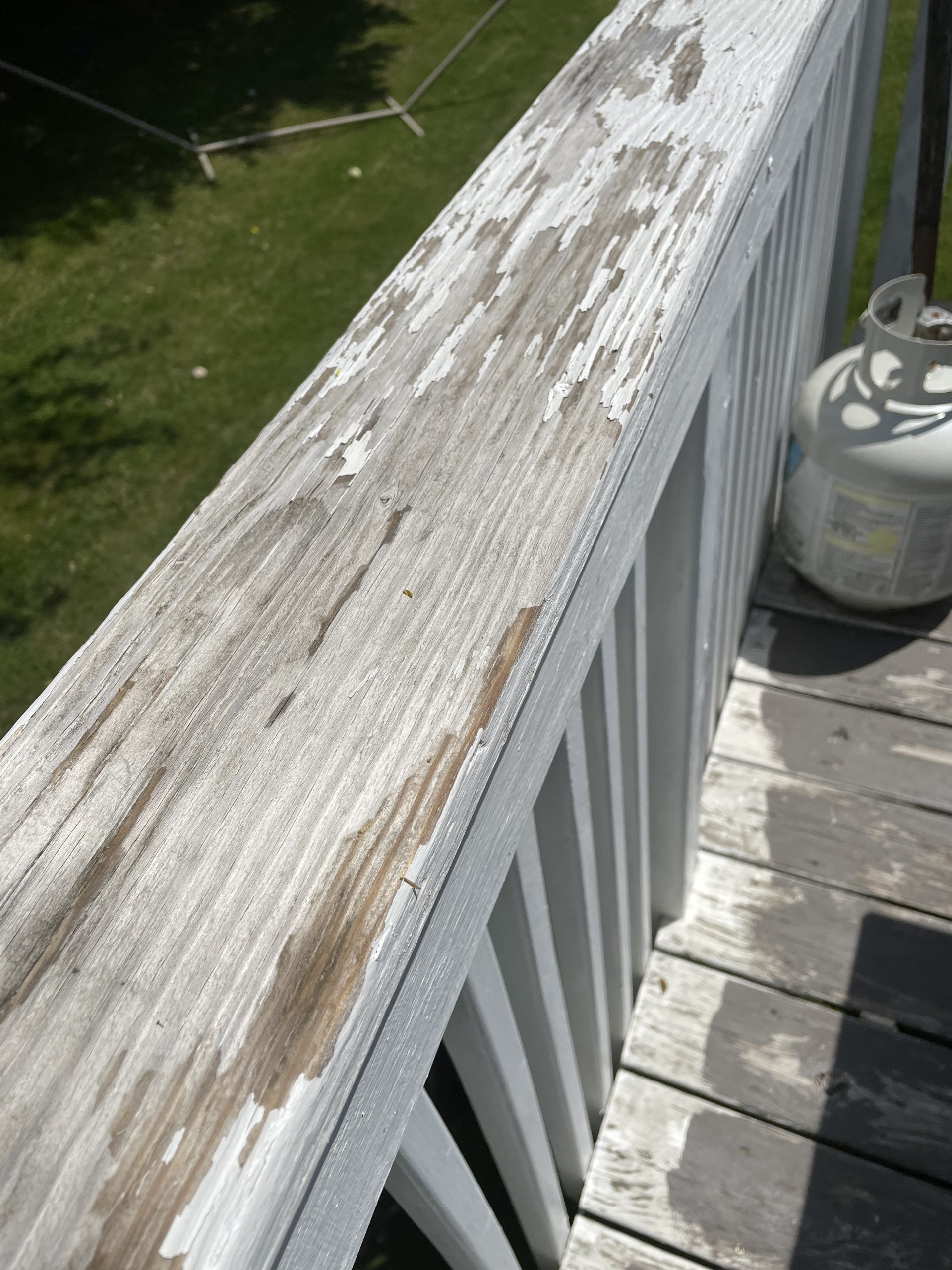

I have a deck that’s about four years old. I was told I could use a specific paint from a local paint store. Instead, it has peeled horribly on the rails and the floors? I’ve been told to replace the boards and slash told to scape and paint. What is the easiest way to fix this? I plan on staining it after whatever fixes I need to do.
Post some pics so we can offer prep advice.
Here you go!
Strip off the floors and tops of the rails.
Do a two-toned deck after.
Hi Scott, We repaired/replaced our 30 year old redwood deck one month ago, with beautiful new redwood. We will let it weather for 3-4 months and treat before painting the entire building. We are in Northern California, get lots of direct sun; it’s an entry deck for a small condo complex so gets a lot of use. Previously the deck would become slippery when it rained. Is there a treatment for the new deck that will not result in a slippery surface when wet? (Sorry I don’t know what product was used previously).
Penetrating stains will make the surface slippery: https://www.deckstainhelp.com/best-semi-transparent-deck-stain-reviews/

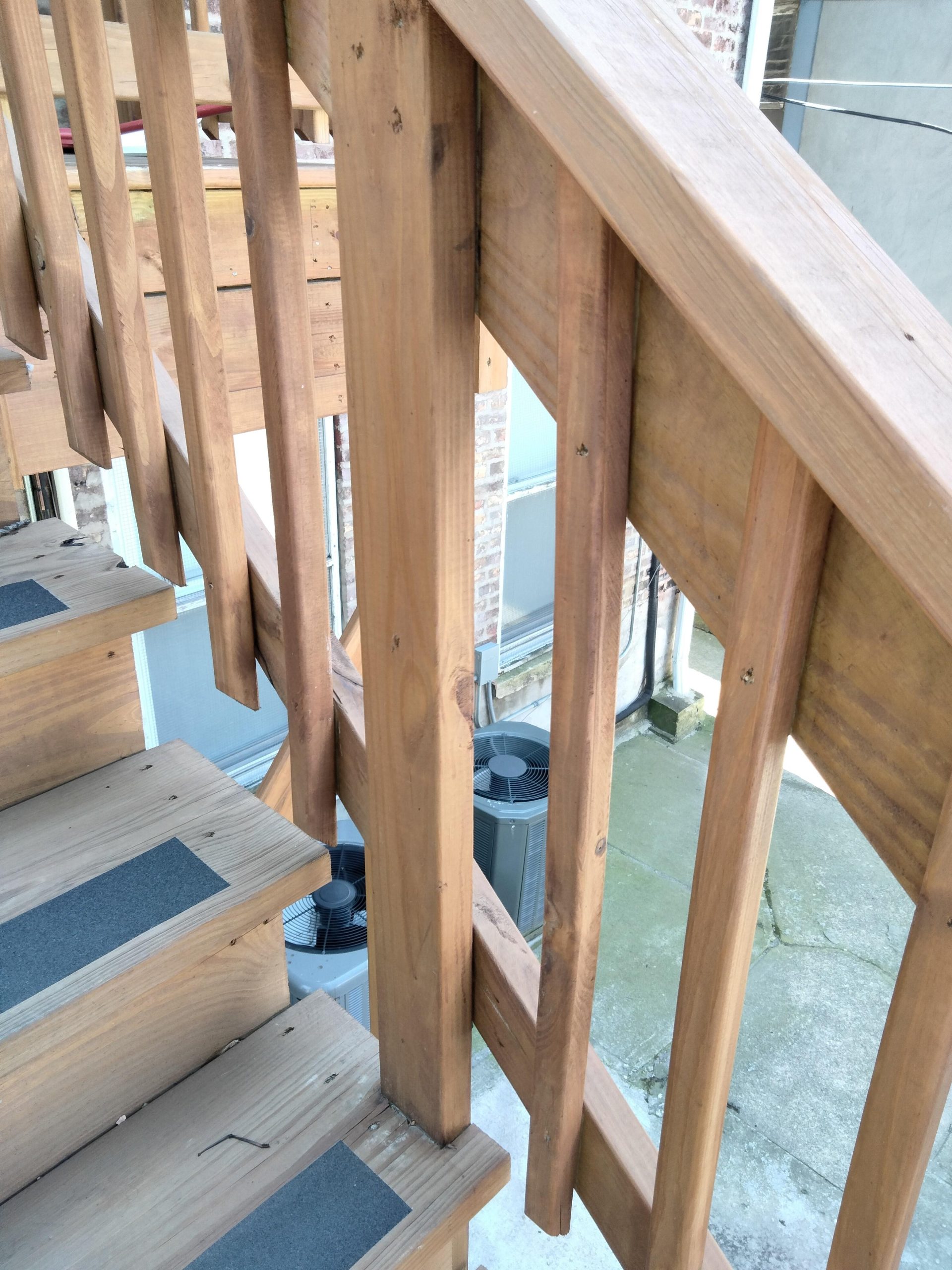

Hello – I have a couple questions regarding a new rooftop deck.
Location, Chicago IL.
Deck Installed, May 2022
Rooftop deck, direct exposure to rain and sun
Wood type: Souther Yellow Pine / Drying method: KDAL
Treated: Fire Retardant Pressure Treated lumber (brand: FX Lumber Guard XT)
Questions:
**See attach pictures.
Thanks in advance,
Rodrigo
1. No.
2. Yes, you need to stain and protect the exposed wood.
3. No.
4. TWP 1500 Series or Restore A Deck Stains.
5. 50-90
6. Same
7. Varies on the stain brand and type of stain.
8. Varies on the stain brand and type of stain.
9. Varies on the stain brand and type of stain.
10. 3-12 months but varies on the stain brand and type of stain.

I have a new redwood deck that I’d like to stain before winter and have read so many conflicting things about sanding/staining, some say sanding opens pores others say it closes them!? As of now I’ve just cleaned it with oxiclean but there are chalk/paint like marks on some of the boards that washing did not remove I’m not sure if I should sand to get them off… Also I did sand just my top railing cap before installing it so it wouldn’t cause any splinters is this going to be an issue? I’m planning on using Ready Seal semi transparent stain. Thx!
We are not fans of sanding as it can lead to issues: https://www.deckstainhelp.com/why-sanding-a-deck-can-be-an-issue/
Also, the Ready Seal is not your best option.
Ok, so since I have already sanded the railing do you have a suggestion? And do you have an alternative for how I may get the marks that came on the wood off?

If you have ink stamps you will need to sand them off: https://www.deckstainhelp.com/how-to-remove-the-ink-stamps-from-new-decking/
Do it now and then leave the wood until spring for final prep and stain.

Hi Scott. We had a redwood deck built last fall in Lake Tahoe. TWP stain, dark oak, was applied in 15 degree weather after 6 weeks install, to protect wood from winter snow. At snow melt, brand new deck was very blotchy, seems stain penetrated very unevenly. Contracter sanded and powerwashed. Deck is almost free of stain but lots of little circular squiggles. Please advise on steps to get the deck to look nice again! THANK YOU!
They did not follow the directions for new wood and TWP. https://www.twpstainhelp.com/prepping-new-wood-for-twp-stains/
You should remove all and start over. Strip and brighten for prep: https://www.twpstain.com/restore-a-deck-stripper-brightener-kit-detail

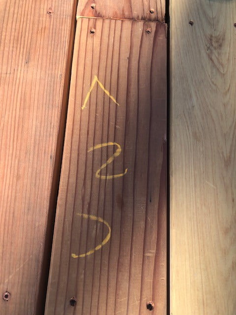

We have a new redwood deck. We were actually told to do a sanding with 80 grit to open up the wood. If we apply a clear oil sealer, will the wood still weather to a soft grey? Should we wait more than 3 months to seal if we want to seal it at the grey stage?
Sanding closes the wood grain, it does not open it up. Wait, prep, then seal.

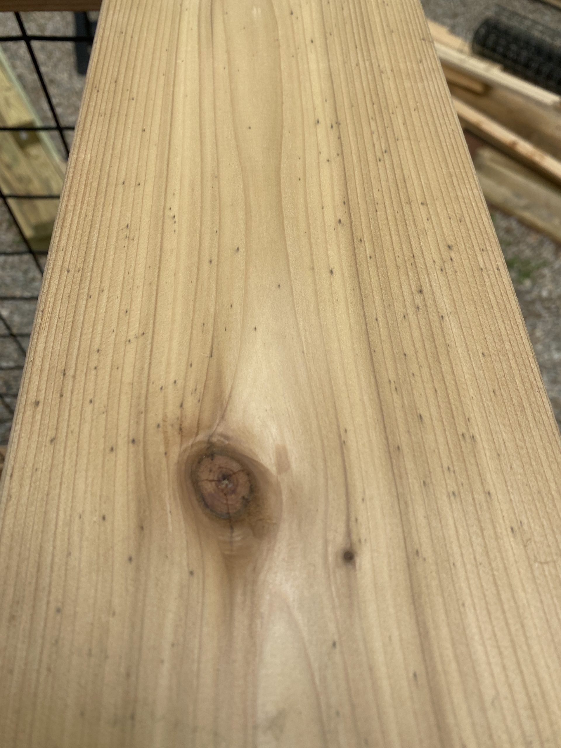

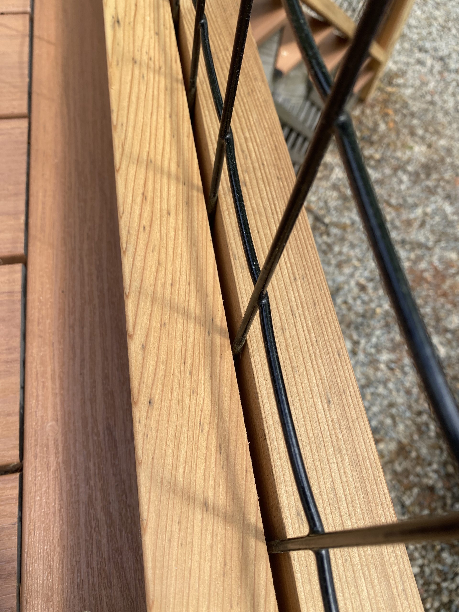

What are these black marks? They look like something is bleeding out in the wood? This is brand-new, Kiln dried western red cedar, 1×6 railing tops and also split 2x4s. These black marks emerged within about a week of having been constructed. I am planning to wait 6-8 weeks, use the RAD clean/brighten system, and then stain with Armstrong Clark Semi-Transparent. Railing only, no decking. But now I see these black marks. Not sure what they are and what I’m going to need to do about them. Thanks!
It could be mildew or rust spots. Cleaner should help remove if mildew. The Brightener will remove rust spots.
On further research I think it’s rust spots. They were grinding the galvanized mesh to cut the ends. Do you think it matters if I do it ASAP or wait a month or so until I stain? And could I do it now and then again in a month? I’ve heard rust spots come back… trying not to cry or scream. I wanted a natural and beautiful railing. Wondering if I made a big mistake. Finally, what happens if it keeps coming back? Can I apply stain over the rust? Will it just be ugly, or prevent the stain from doing its job? Gaming out my worst case scenario. Thanks.
It does not matter when you do it. They will go away with the prep (brightener) and not come back.

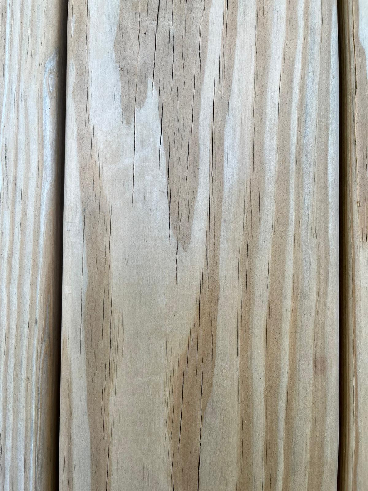

I have a new deck of pressure treated pine, and there are some green stains around the knots as a result of the treatment . How should I handle these when it comes to staining the deck? Should I let the deck weather and hope the green stains disappear? Sand them off at the risk of removing the treatment? Hope that the stain will conceal them?
Thanks so much!
There is nothing you can do about this permanently. Just prep and stain after the wood weathers. You can stain over it.

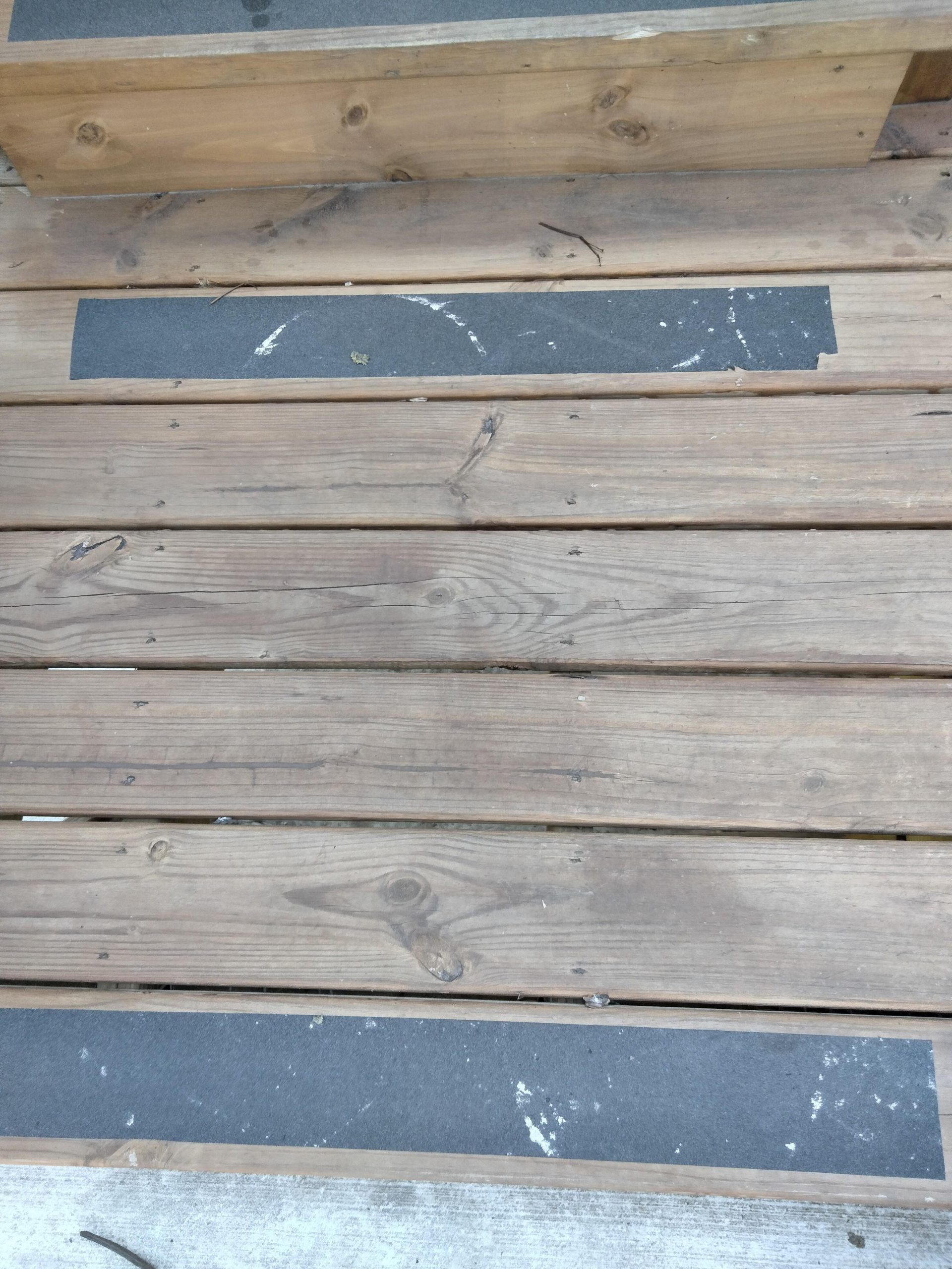

Pressure treated wood deck completed 12/20
Now ready to stain
Rubber doormat and stair treads used since 4/21
Stain suggestions?
Will Armstrong Clark semisolid not penetrate all areas because mats and treads were used?
It should be fine as long as you prep correctly.

Is there any special consideration that the Cumaru is directly next to a salt water pool? It seems weird that I would put bare wood there for 3 months, especially the end grain, as I need to cut them all with a slight curve.
No, nothing special or more you can do.

Help? Very frustrated and I am holding up the contractor. We have a beautiful new pressure treated pine deck. It was built in July. For weeks, I’ve been looking for a stain that I like and we would go top of the line. The contractor uses Behr (open to others). I’ve had help at the store adjusting Behr color pigments and have tried 13 samples. No luck ugh. Art is a hobby so I am sensitive to colors. The yellow in the wood is an issue and I’ve used a color wheel and research to try to figure out how to compensate. In Northern Va, it is very warm for the next couple of weeks. 1- What should we do? Can the contractor use a waterproof sealer only for now and then stain in the Spring? Deck is large and gets sun. 2- Any quick advice or stain recommendations are appreciate. 3- Does a stain with gray hue help lessen the yellow? We don’t want solid but semitransparent and was hoping for an earthy, light brown or brownish gray. Feel free to email me. Photo of deck below. Thank you!

I installed a new pressure treated pine (YWood) in May, 2021. The deck was built over a brand new poured-concrete patio. I planned to seal (no stain) the decking, stairs, support posts, and exposed framing for the first time this fall. Will any of the chemicals you recommended for prep and sealing new decks damage/stain new concrete or painted brick? I’ll try to cover everything as best I can but something’s bound to splash or drip onto the concrete. I’m in Western Kentucky. Great website. Very informative. Thanks!
You must use a tinted stain if you want to prevent UV graying. A clear sealer will gray naturally.

I have a new 16×20 pressure treated pine deck in Alabama which was just completed. Plan for stain at least 3 months from now (gets a lot of direct sunlight)…. after reading your website (which is fantastic!) I am concerned about my stain choice coming up. I have a smaller deck on the other side of the house that I used Cabot Australian Timber Oil – Honey Teak on about 4 months ago and we love the look of it (did it about 6 months after it was built). Seems like you’re a bigger fan of the TWP 100. Given the size of my new deck I want to get this right and make maintenance as easy as possible… and it seems like maintenance is easier with TWP 100..? We had planned to use Cabot again to match the other deck but given the time and money invested in this large deck I want to use the best product (for look, wood preserving, and maintenance) regardless.. we’re okay if the match isn’t perfect if it saves headaches every 2-3 years. I guess I am saying should I use Cabot Timber Oil to match or switch to TWP 100 Thanks for this awesome website!
Use the TWP 100 Series. Honeytone 115 is the closest in color. Make sure to prep first.

I had a new covered deck built in May. The steps and 4×4 posts are ready to seal but the rest of the deck still beads water. Should I seal steps and posts now or wait till rest of deck is ready?
Wait until next Spring to prep and stain.

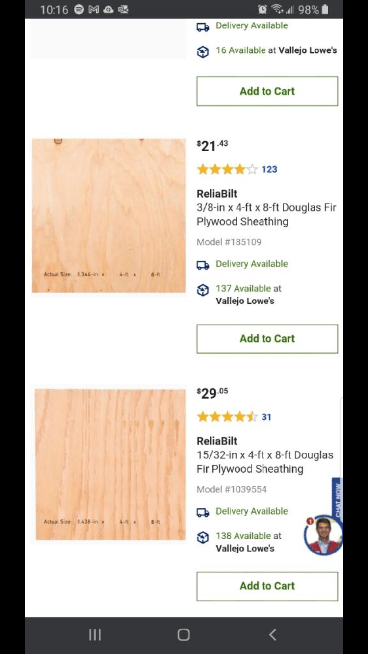

Do you have to weather Douglas Fir Plywood Sheathing? Or can you stain it immediately? Are there any special staining instructions for Plywood sheathing since we aren’t using traditional deck planks? We live by the coast.
If smooth wood you will need to weather and prep just as the article above explains. Any quality deck stain should work: https://www.deckstainhelp.com/best-semi-transparent-deck-stain-reviews/

We have just purchased freshly sawn, vertical gain, incense cedar 2×6 deck boards that were planed and then sanded. It was our intention to oil stain with semi-transparent oil based deck stain on all sides of the boards prior to installation. We live within a mile of the ocean and it rains (hopefully) quite a bit here in the PNW and our intention is to use (Sikken) or now, PDG oil based, tinted semi-transparent stain/sealer. This wood hss 12 to16% moisture content. Not wanting to wait for weathering, what other tips might be helpful?
You cannot pretreat and only need to stain the exposed side(s) after install, weather, and prep. We also would not suggest the PPG/Sikkens. Much better products out there now: https://www.deckstainhelp.com/the-5-best-deck-stain-reviews-and-ratings/

I have a new wood deck that was power washed and then stained 3 months after installation. The wood has what appears to be “etched” stains on it as if it were dirty/muddy. The stainer used a combination product from Home Depot of stain and sealer. I attached pic of deck. Any suggestions as to what these “spots” are and how they can be removed? Thank you.
Not sure what it is but you cannot get this out as it is internal. It does not look like a sealer but a solid stain. Maybe recoat those areas will fix it?

Hi, we’re about to install a new wood deck (decking boards will be doug fir). I’ve read the article and know that we’ll need to wait to stain. First question: Once installed, can we sand the deck and then let it weather for a couple of months before we stain it? The reason I ask is because there are a lot of splintered bits along the edges, and I want to prevent them from getting in my children’s feet. If we rent a deck sander, will this also knock off any of the mill stamps? We live in Montana, so our weather window for staining is either within this first 3 months after installing the decking, or next summer. Next question: my husband wants to stain all four sides of the boards to help the deck last longer, but I read on your site that the wood needs to breathe. We’ve already stained what will be the bottom board of about 12 boards — should we stop doing that? Will it harm the deck that we stained those boards? We’re planning to use Armstrong Clark stain, as it was one recommended for new wood. Thanks in advance for your help.
You can lightly sand to remove splinters and stamps after install and then weather and prep before staining.
Do not stain all sides, just the exposed side when ready.
Hi – we just had a new redwood deck installed (two days ago). there are contractor crayon marks on some of the planks. He advised to sand those off before staining. I did sand two off but it has made the plank look patchy. Does this mean i have to sand the whole deck to even it out? or will the patches go after some weathering? thanks! Photos attached.
It should go away with weathering and prep.
thank you for the quick response. Can i also ask why it goes a different shade – is there a coating on the boards as part of the lumber process that comes off when sanded?
That happened as you spot sanded it finer that the rest of the wood.
