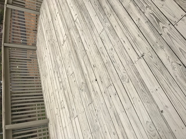

TWP 100 series stain
Used Gemini 2 part cleaner
https://youtu.be/xH6RnzN4M-c
Looks really good!
