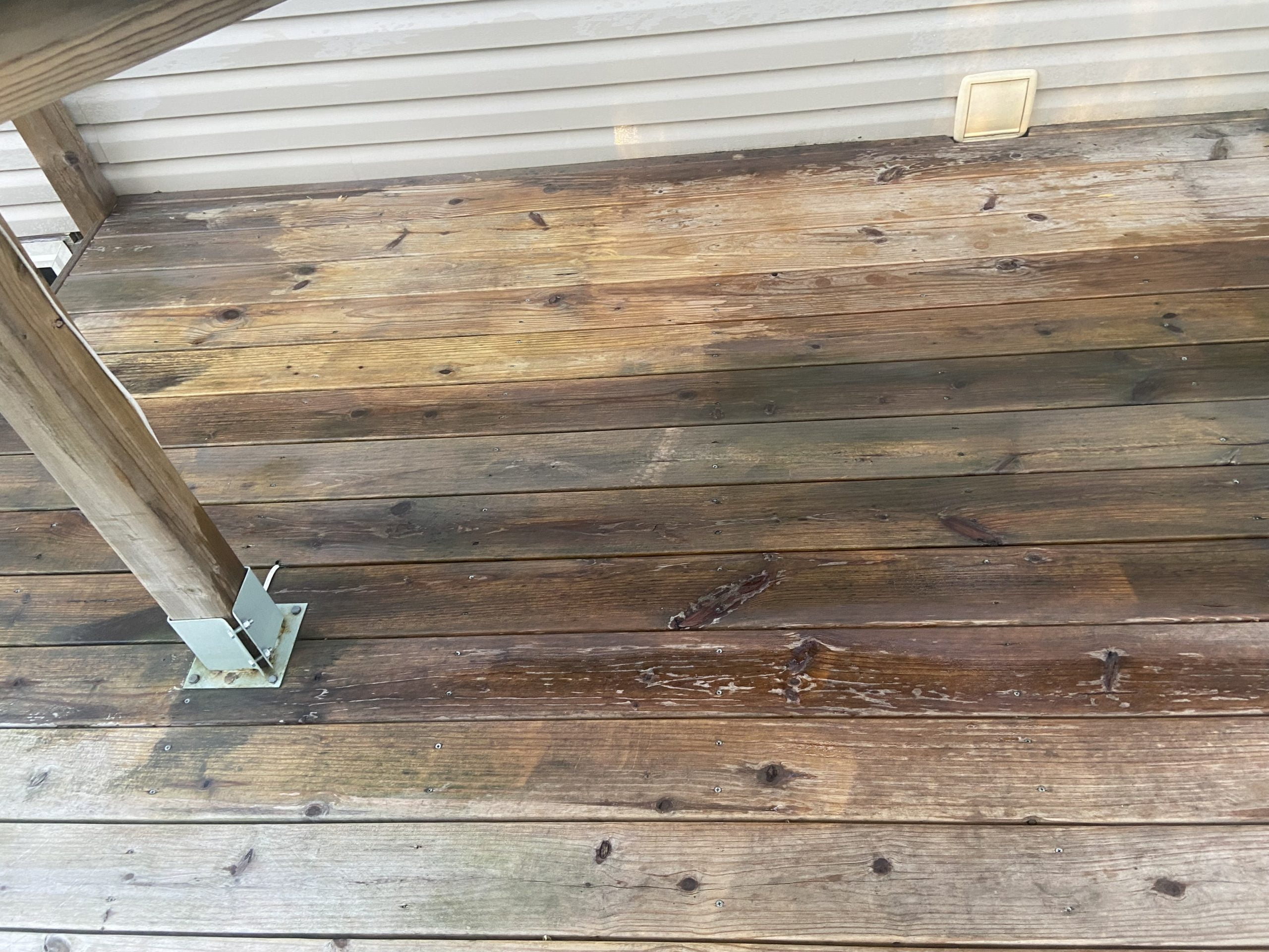

Thank you for quick response! My deck is 16’x46. Unfortunately there are some deepish marks from pressure washer and feathering from bleach. I’m currently sanding to remove most of these issues. 1.How much is too much sanding on these spots? I’m thinking of using an electric sander at this point. 2.Since so much time has transpired since I bleached, do I need to clean again before I use RAD brighten? 3. Also, How long is too long between brightener and stain if deck isn’t exposed to traffic?
Stacey
Stacey
Ok I’m finding that the pressure washer marks come out fairly easily However the feathering from the bleach takes a bit more elbow grease than the pw marks 🙁

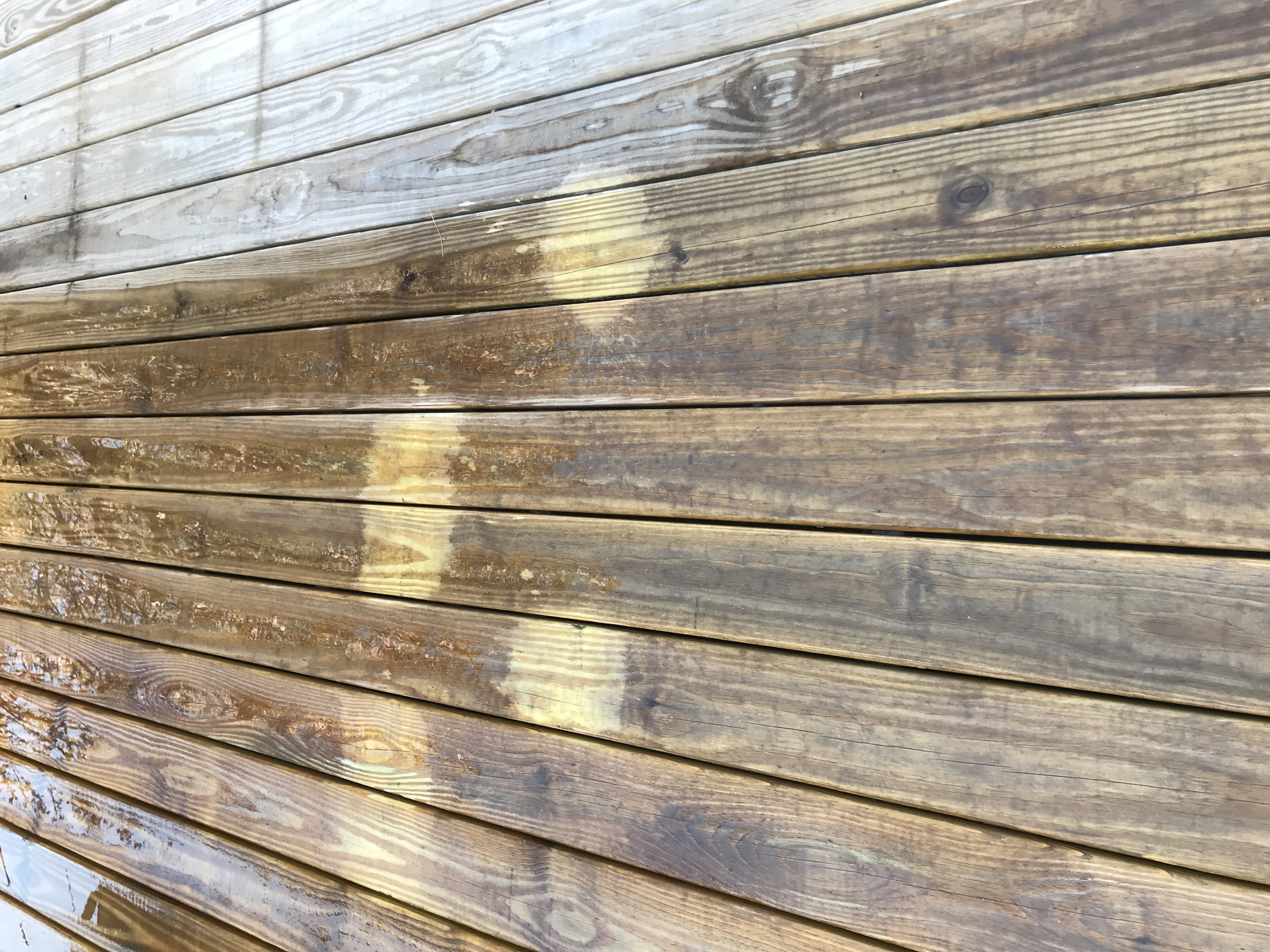

my new deck has weathered for 7 months. I used chlorine bleach on my new deck to clean off mold and mildew. It shows some of the wood fibers on many parts of the deck. Should I sand them off, or use RAD deck brightner before I use RAD semi-transparent stain? Or, what is the best solution to utilize in this case. it is pressure treated wood.

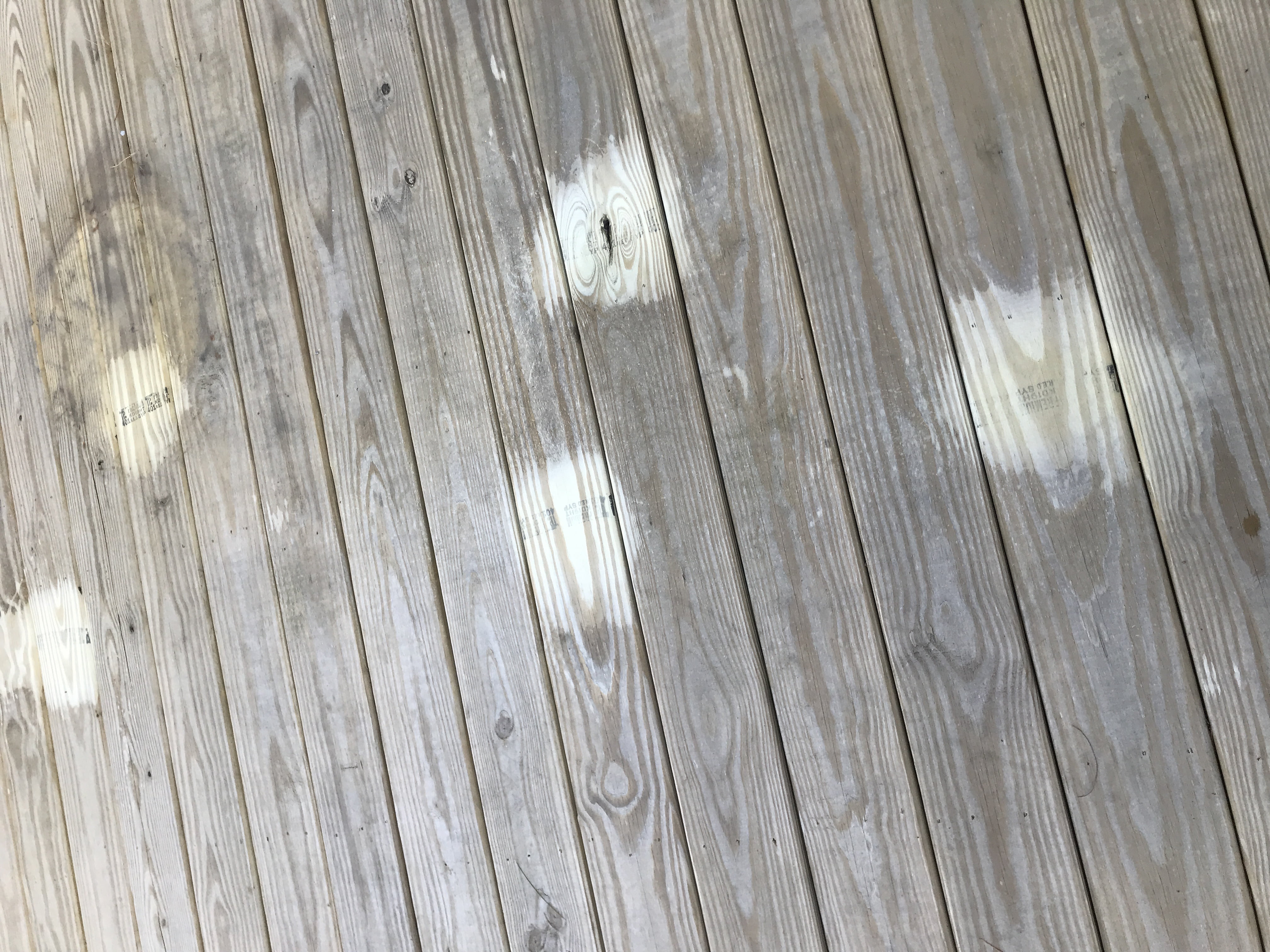

I used chlorine beach mixed with water to scrub lumber stamps on pressure treated deck (about 1 yr old). It partially worked but bleached out the areas badly. I want to clean/stain deck. Got RAD cleaner and brightener. Put cleaner on part of deck. After scrubbing, it was not lightened like the spots I bleached (didn’t put on brightener). Planning on using translucent or semi-transparent stains but these white spots will show thru! See pics. What can i do get the deck uniform in color? Would pressure washer do it?

Thanks but that would basically mean cleaning entire deck with Clorox bleach (diluted 1 part bleach to 1 part water). Won’t that be really bad for my deck (according to everything I’ve read). If instead I just continue doing rest of deck with RAD cleaner and the brightener, and spots still show, would semi-solid stain cover up enough so that it all looks uniform. I was planning to use a semitransparent but I don’t think it would cover the problem. Don’t want to use a semi solid but may be only choice now. Would semi solid cover this? I was thinking of the Armstrong brand since it got better ratings than other semi solids.
Rosemary
Rosemary
Ok thanks. Can you advise what ratio of beach to water. For the deck stamps I used even parts. But I’m afraid to use it that strong as your site says using beach is very bad.
Rosemary
Rosemary
Sorry one more follow up question. If I do use the bleach/water on the whole deck should I use the RAD brightener after that?
