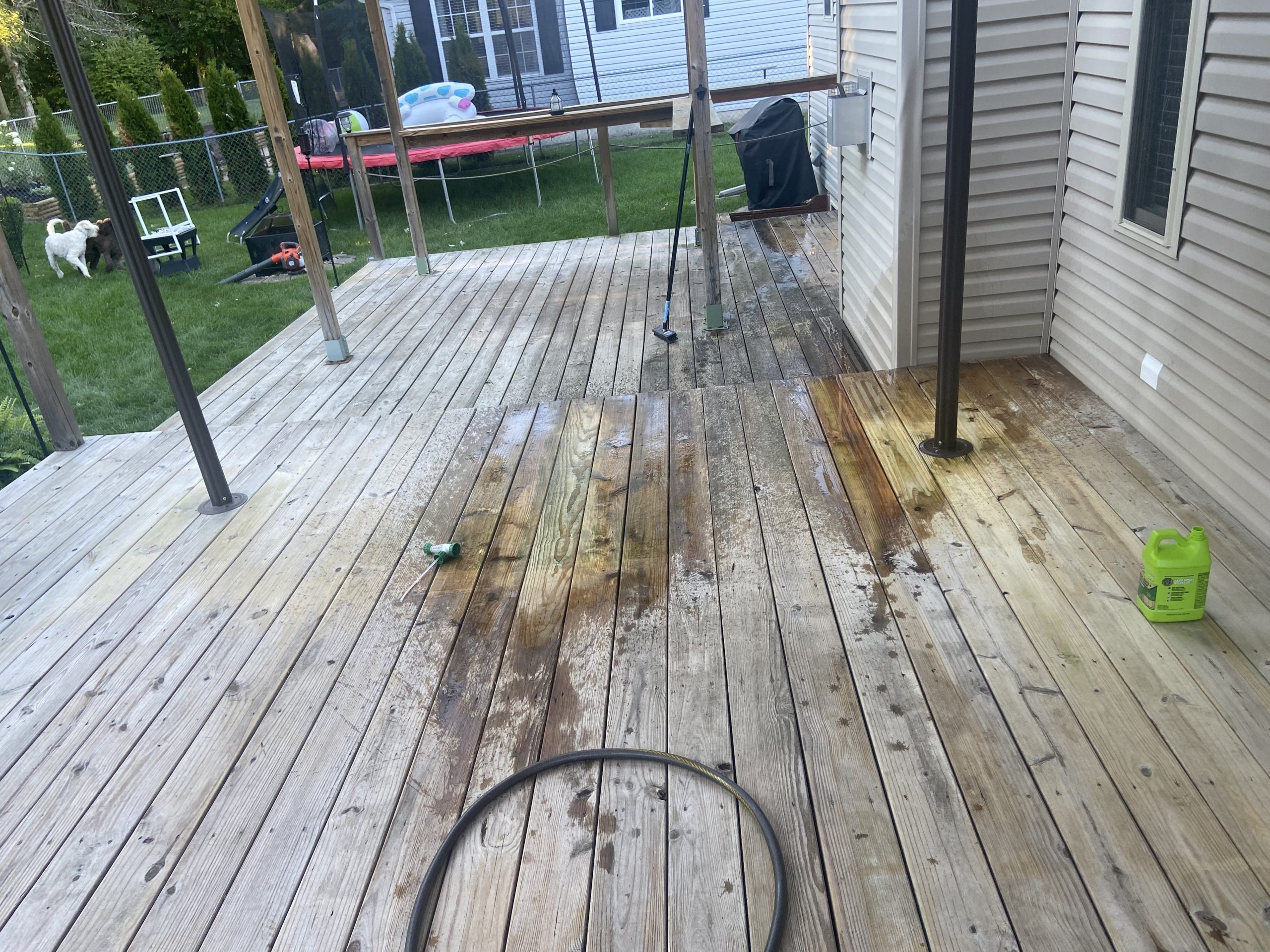

I used chlorine beach mixed with water to scrub lumber stamps on pressure treated deck (about 1 yr old). It partially worked but bleached out the areas badly. I want to clean/stain deck. Got RAD cleaner and brightener. Put cleaner on part of deck. After scrubbing, it was not lightened like the spots I bleached (didn’t put on brightener). Planning on using translucent or semi-transparent stains but these white spots will show thru! See pics. What can i do get the deck uniform in color? Would pressure washer do it?
You will probably have to use the beach on all the wood so it evens out. Basically, make the rest of the deck look like the spots.
Thanks but that would basically mean cleaning entire deck with Clorox bleach (diluted 1 part bleach to 1 part water). Won’t that be really bad for my deck (according to everything I’ve read). If instead I just continue doing rest of deck with RAD cleaner and the brightener, and spots still show, would semi-solid stain cover up enough so that it all looks uniform. I was planning to use a semitransparent but I don’t think it would cover the problem. Don’t want to use a semi solid but may be only choice now. Would semi solid cover this? I was thinking of the Armstrong brand since it got better ratings than other semi solids.
Unfortunately, that is the only way to fix it. A semi-solid will not cover or blend this.
Ok thanks. Can you advise what ratio of beach to water. For the deck stamps I used even parts. But I’m afraid to use it that strong as your site says using beach is very bad.
Same ratio as before. At this point it is the only way to even out.
Sorry one more follow up question. If I do use the bleach/water on the whole deck should I use the RAD brightener after that?
