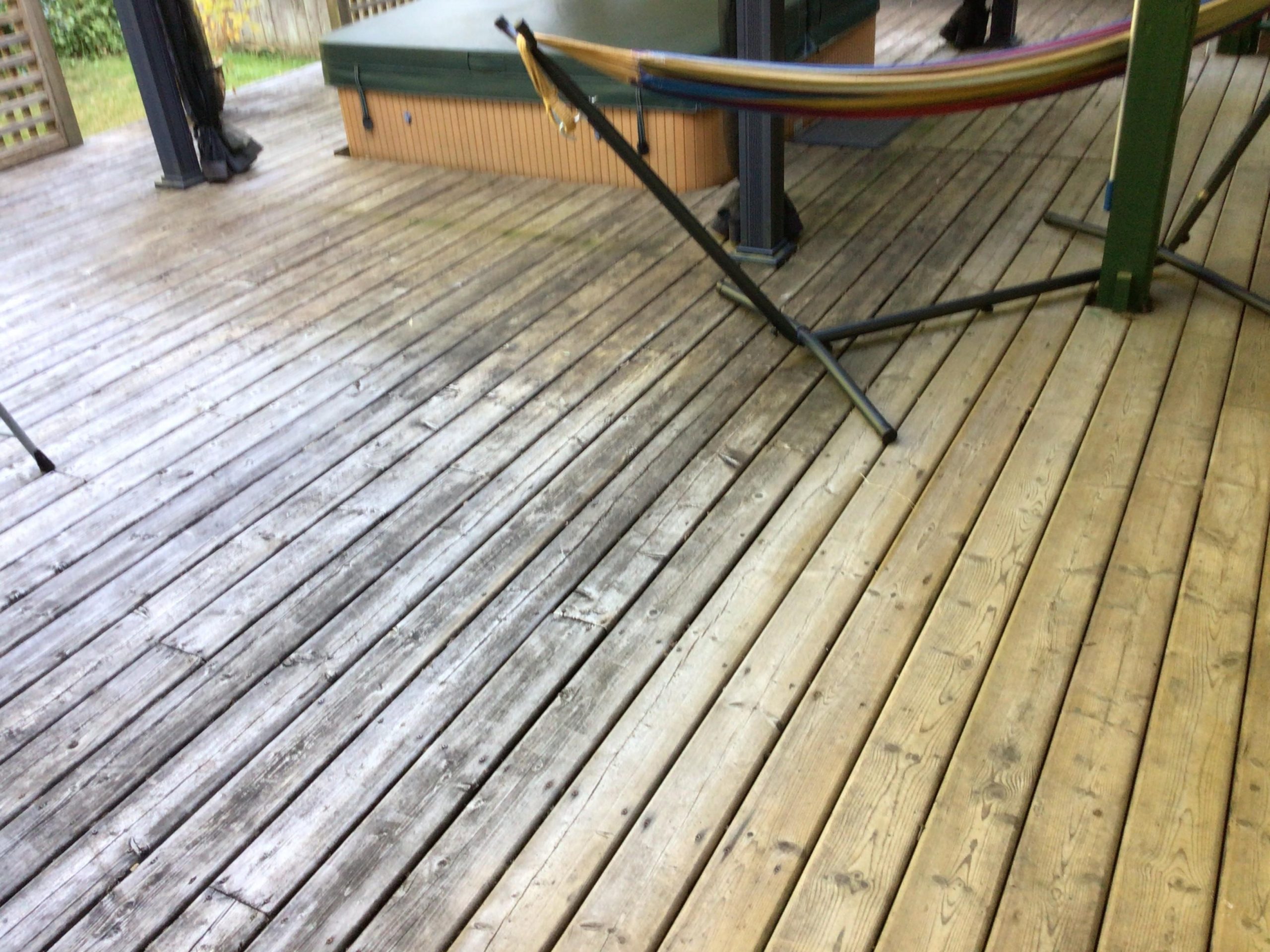

We have a “new construction” deck that has sat unstained for 2 years. Pressure treated 2 by 6 wood with no stain or coating on it. We see some cracking, minimal cupping, but boards are uneven in places due to poor construction. We recently replaced some of the worst boards. There is no mold or mildew. We have a power planer we have used in some spots to even out adjacent boards. We need to know if we should sand down the whole deck and/or power wash, then what type of stain for full sun. Appreciate your expert advice!
Let the new wood weather for 3-4 months, clean and brighten all wood, then stain with a penetrating stain like Armstrong Clark or TWP 1500 Series.

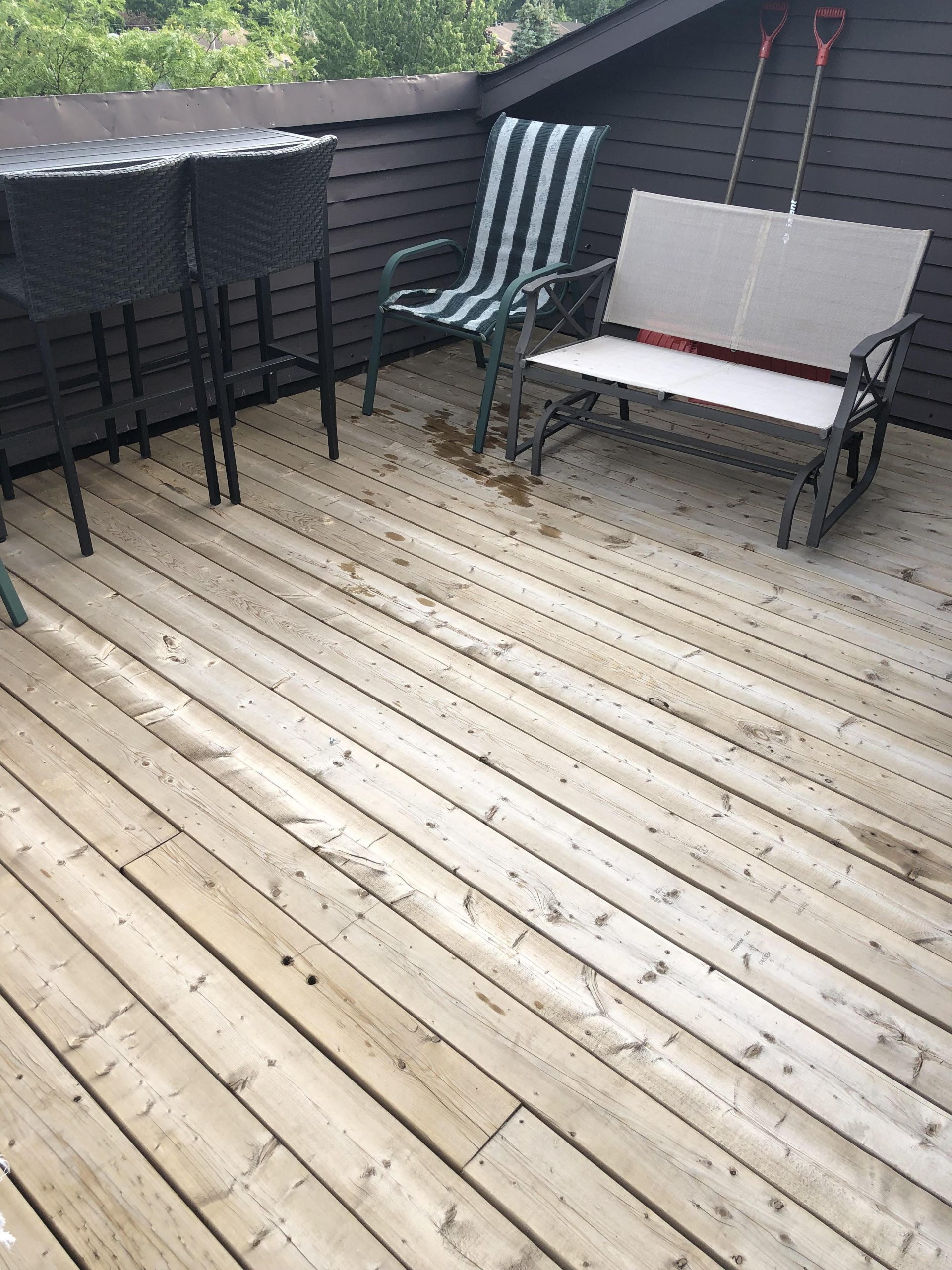

We have a situation on our hands! We had a pressure-treated wood deck installed one year ago. We let it weather, cleaned it, and brightened it.
Before staining the deck, the contractor used Bondo to fill knots and any minor imperfection in the deck; more repair was done than necessary, in hindsight I would have done no repair.
He then tested the penetrating oil-based translucent stain (natural color) on a board and realized that the stain would not cover the grey Bondo… The stain only calls for one coat.
He then removed all the Bondo by hand (mostly scraping) and in the process used an orbital sander on the deck.
The next day (yesterday), he applied the stain. This led to multiple light spots all around most knots on the deck where the Bondo was removed and the deck was sanded.
I called the stain manufacturer, and they said it could be alright to try to add additional stain only to the lighter spots but to first test in a small area. I’d like the deck to look more uniform, and the staining was a big job that took two men a full day to brush on by hand.
Is this the best approach, or is there another path I should take?
Thanks for your help,
Liam
It will not work to blend by spot applying. The only way to get it even is to sand it all evenly and reapply. You will need to remove the current coating fully first, sand all wood evenly with 60-80 grit, apply a new ocating.
Thank you for the response. Is it alright if I wait to strip and sand until the spring, or is it better do it now? The deck has been through a lot in the last week – cleaned, brightened, filled, unfilled, spot sanded, etc. And this fresh coat of stain just applied. Any downside to waiting until spring? Will it weather unevenly, or will the lighter spots catch up to the rest of the deck?
No issues and would be easier to remove/fix in the Spring.

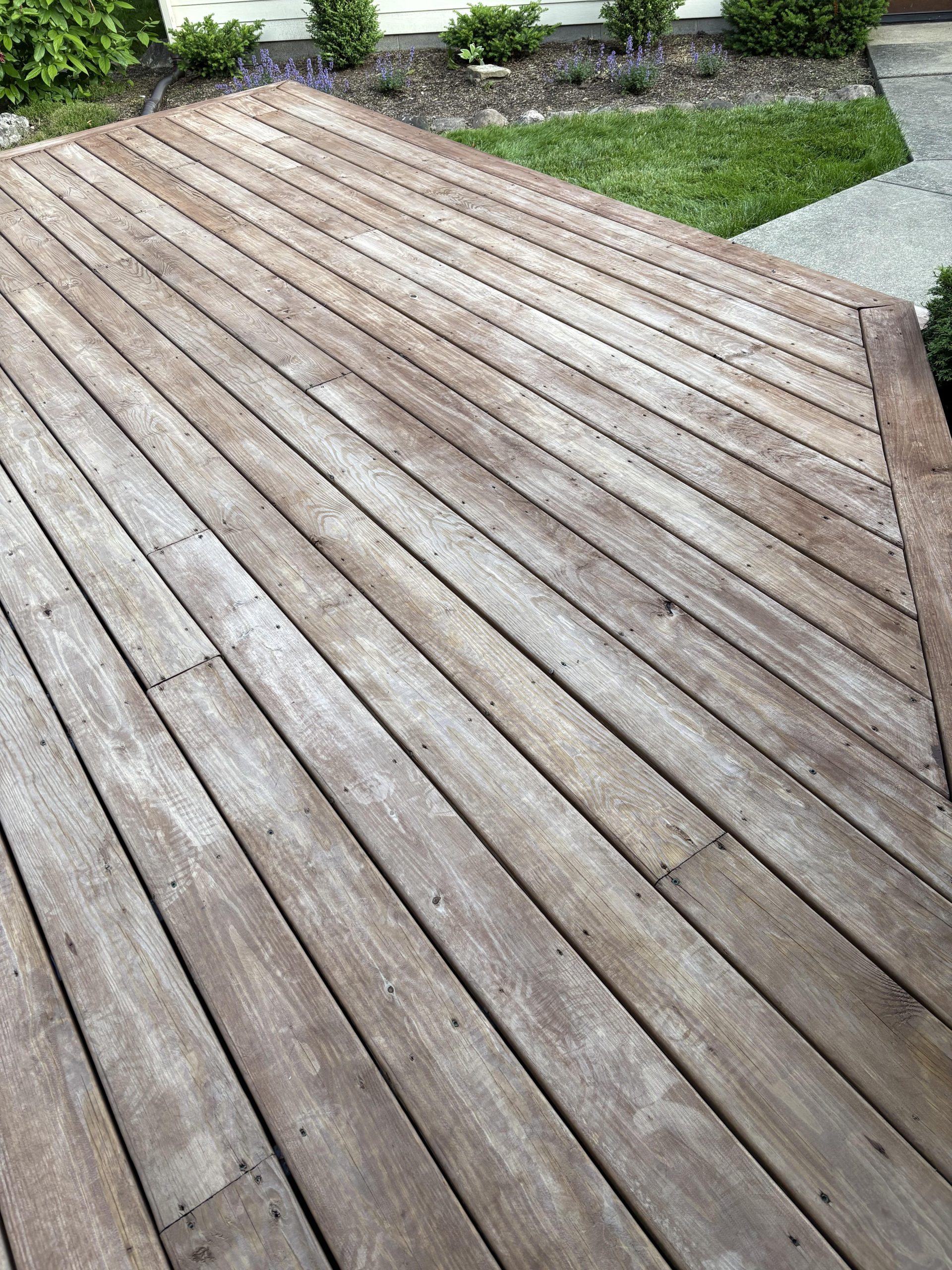

I have a 30 year old pressure treated deck. We recently bought the house and the previous owner only knows that they used a waterproofing stain. It is semi transparent, and wipes off with alcohol. It is a very large deck 12 feet off ground. We do not want to strip, we are in our 80s. I want to clean and brighten and use solid stain, but my husband is concerned it will peel. Half of the deck is covered by an awning and the rest exposed with a basic western exposure, so late beating sun.We live in south central Pa. All advice appreciated
Post some pics for prep help.
See this for tips on how to coat this with a solid stain:
I have read this, but it does not say how to prep over semi transparent stain. I want to avoid stripping but will clean thoroughly. My concern is can I do this and avoid a peeling situation. I would use Restore A deck solid
It is the same thing. Just make sure all current stain is cleaned, any peeling stain is removed, and the left over stain is fully intact before applying the RAD Solid stain.

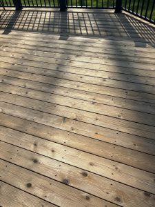

I have a decent amount of decking that was stained by a recommended contractor with Proluxe (PPG) transparent matte SRD RE. Didn’t last a year and they didn’t prep properly as I observed when they came back to “fix” it and then quit. They pressure washed and then ghosted me.
Can I strip and brighten and try a new stain or will I need to sand?
Deck is 7 years old.
Pressure treated yellow pine. Virginia so heat, sun and rain.
Strip and brighten. Use the Restore a Deck Stripper with both additives:

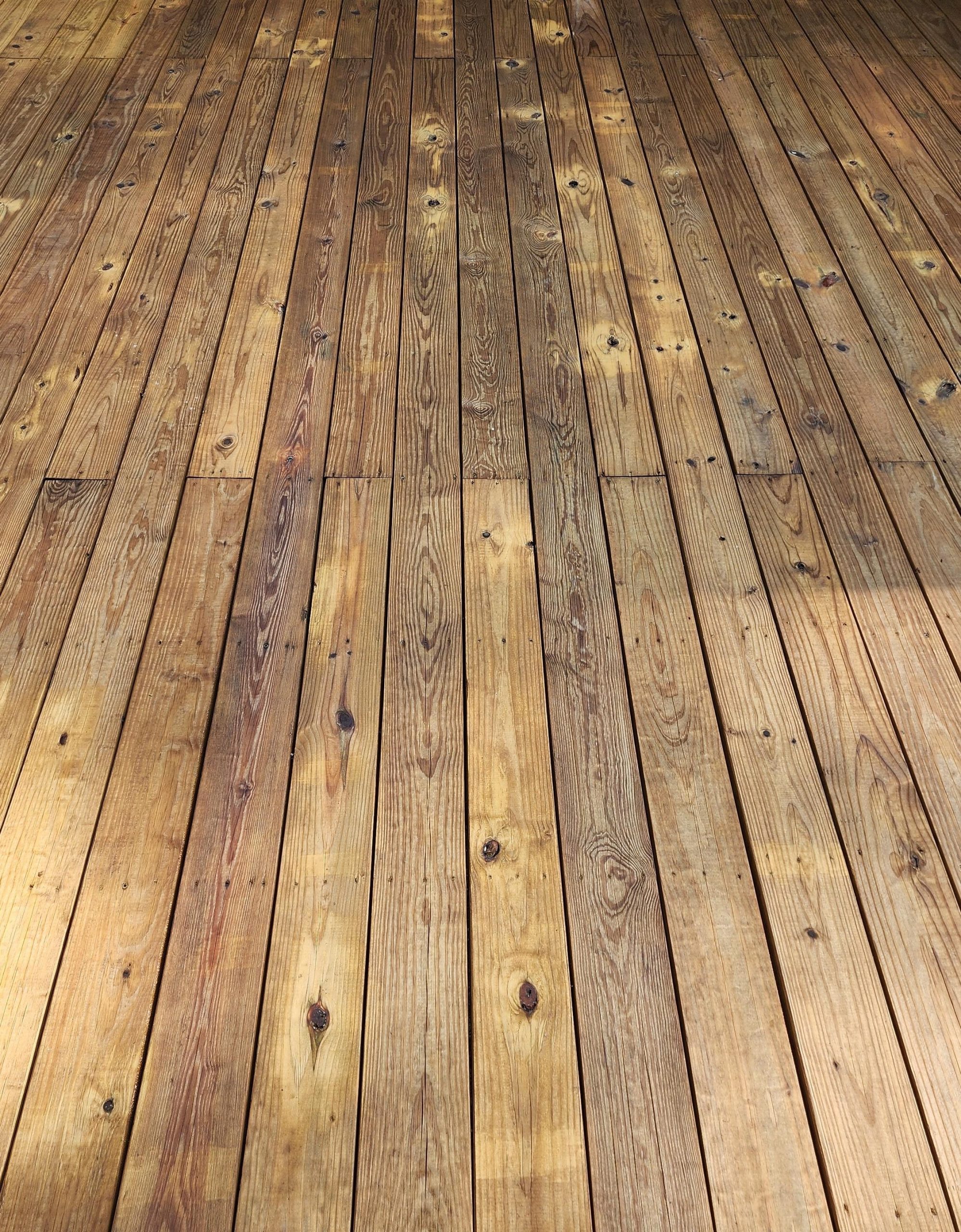

We’re wondering what we should do with this finish that is failing unevenly and boards are slightly gray. Our deets:
Thanks in advance!
Use the Restore A Deck Stain Stripper with both additives for prep:
Brightener after.

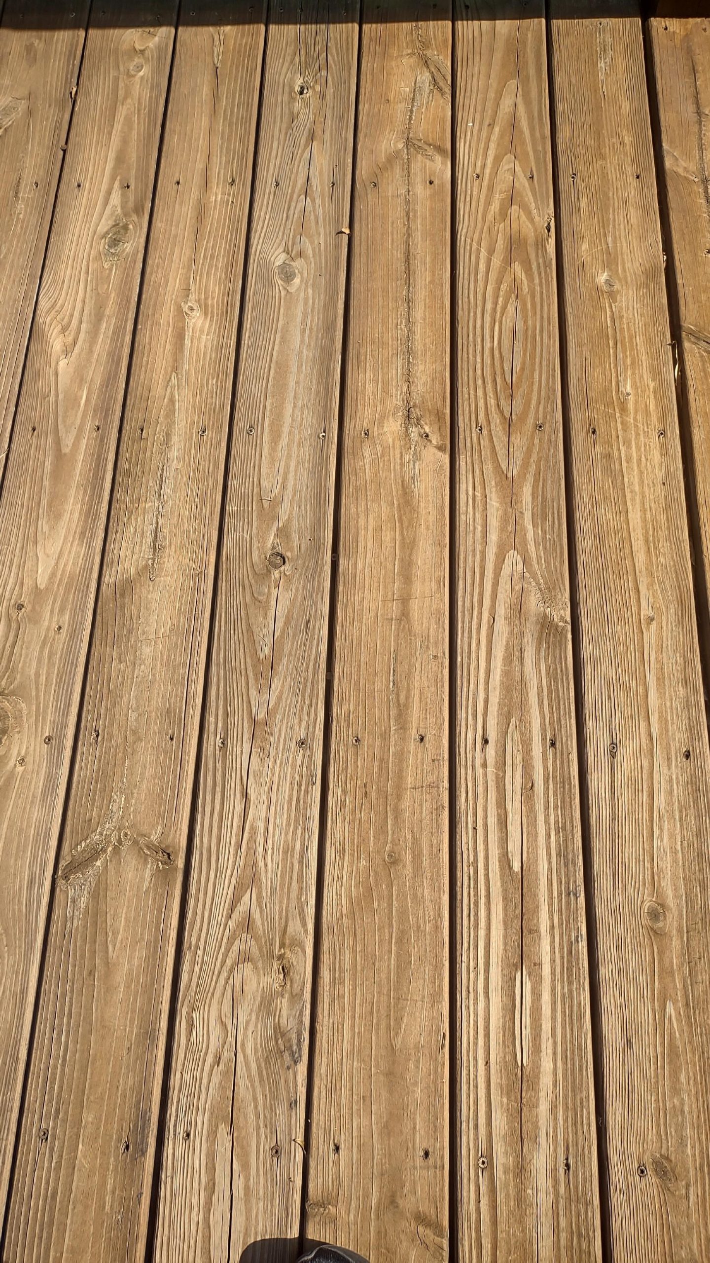

We are planning to re-stain our deck but unsure of preparation steps. Deck built new in 2021; stained same year with Cabot Semi-transparent Stain + Sealer. Will use the same shade to re-stain; focusing on the horizontal boards (deck, rail, steps). Deck is on east side of house; in metro Kansas City. And advice is appreciated. Thank you.
New Wood or Older Wood? 3 years old
Does the Deck have a Current Coating? Yes Cabot Semi-transparent Stain + Sealer (oil based).
Are you Switching Brands of Deck Stain or Applying a Maintenance Coat of the same Brand and Color? Will use the same brand and shade to re-stain
Mold or Mildew Issues? no
Reason for Previous Stain Failure? not sure
We would strip and brigthen this for prep so when you reapply, it stains evenly.
