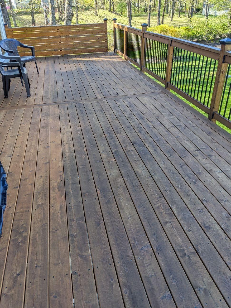

Hey Scott,
Finished up Monday afternnon. The deck came out ok, certainly much better than it was. I used 1 coat of RAD dark waknut, expected the deck the whole to be darker like the perpendicular board(looks true dark walnut in person). The pic makes the deck appear darker than it is. I think the darker board is that color because I had to go over it a few times when I was doing the butt ends of the other boards. Anyways, Thanks again for your expertise and help. Can’t wait to do the second coat for the true color on the entire deck.
Looking good. FYI, seconds coats must be applied wet on wet with the the Restore A Deck Dark Walnut. Not wet on dry.

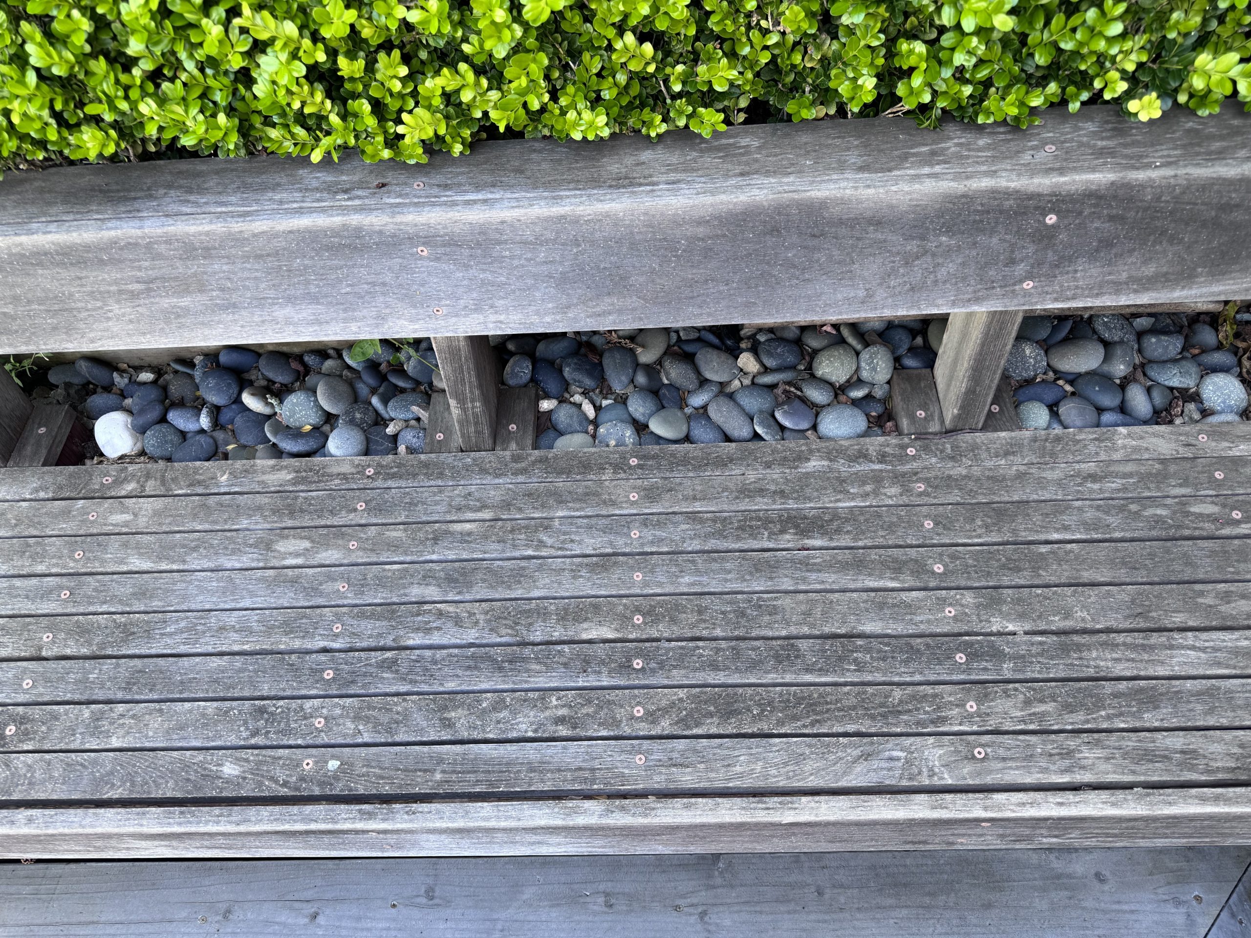

I’ll take this opportunity to ask about some benches next to the deck. (See photos.) They were built out of ipe (tropical hardwood) around 2008 and never coated, treated, or restored in any way. My feeling is that a good pressure wash will make them look great again. But then do I need to coat/treat in some way?
Use a deck cleaner while pressure washing. When done, stain with a hardwood stain:
