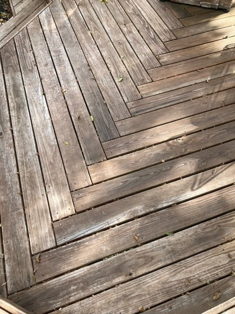

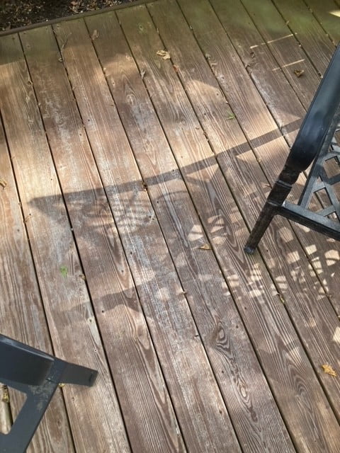

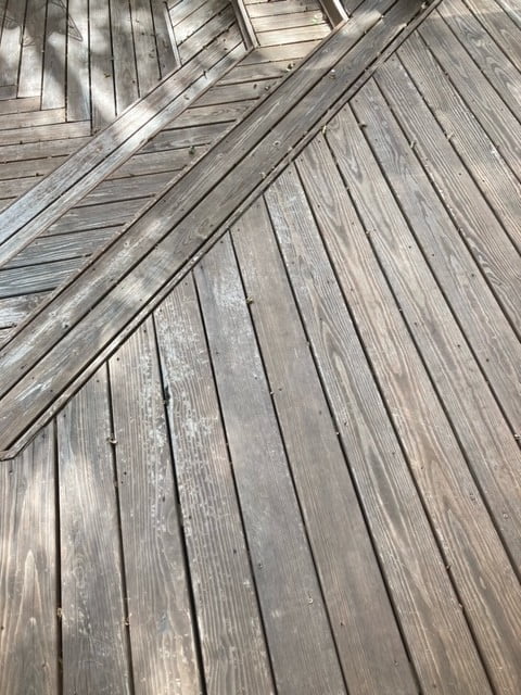

Lisa W.
Lisa W.
  1. New Wood or Older Wood? – OLD
  2. Does the Deck have a Current Coating? YES
  3. Are you Switching Brands of Deck Stain or Applying a Maintenance Coat of the same Brand and Color? SWITCHING BRANDS
  4. Deck Stain Brand Previously Used? Enter “unknown” if you do not know. UNKNOWN
  5. What is the Current Deck Stain Type? Oil-based or Water-Based? Clear, Transparent, Semi-Transparent, Semi-Solid, or Solid Stain? SOLID STAIN, UNKNOWN TYPE
  6. Mold or Mildew Issues? NO
  7. Reason for Previous Stain Failure? AGED OUT
  8. You Must Include Picture(s) of the Current Condition.

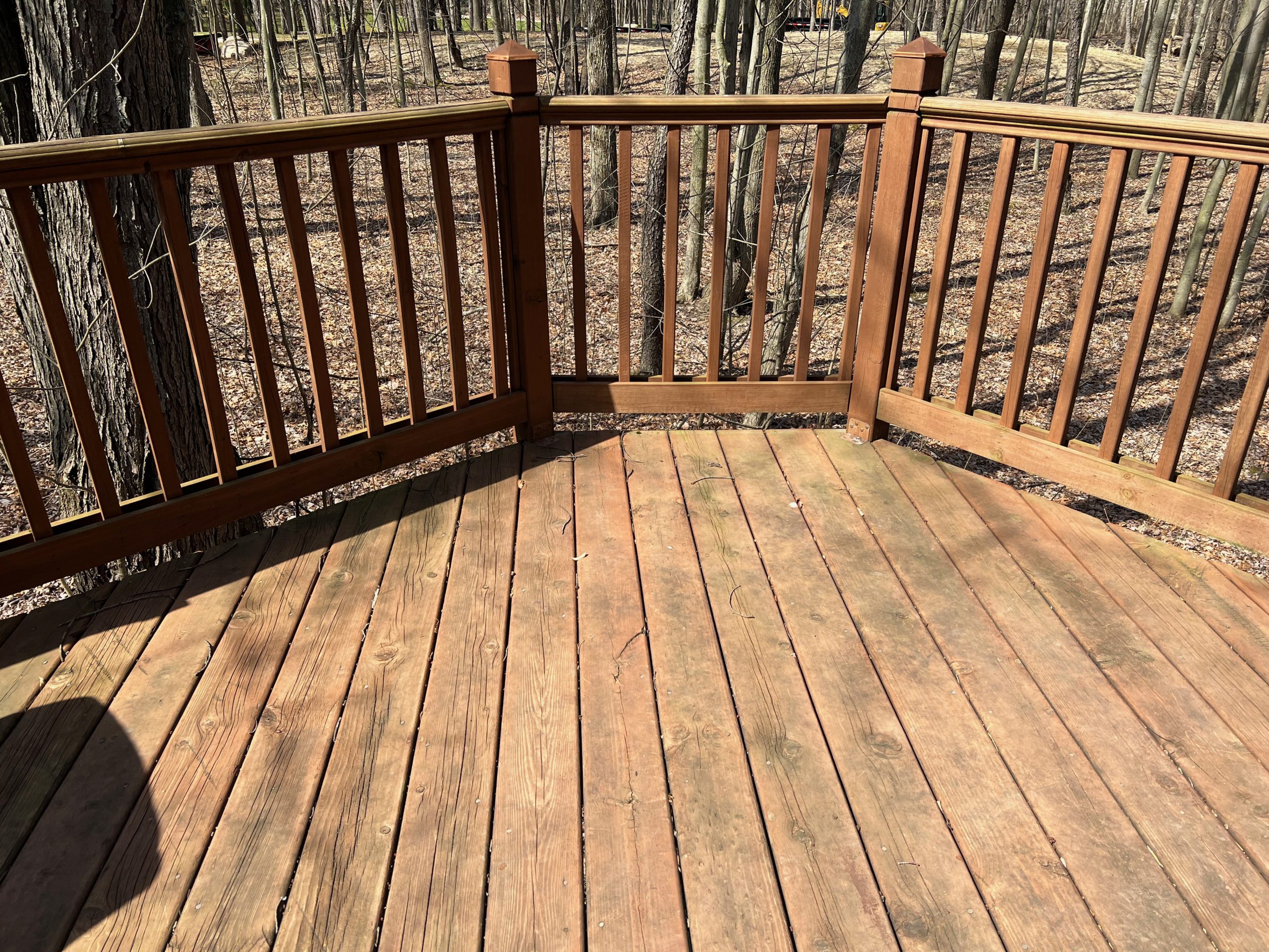

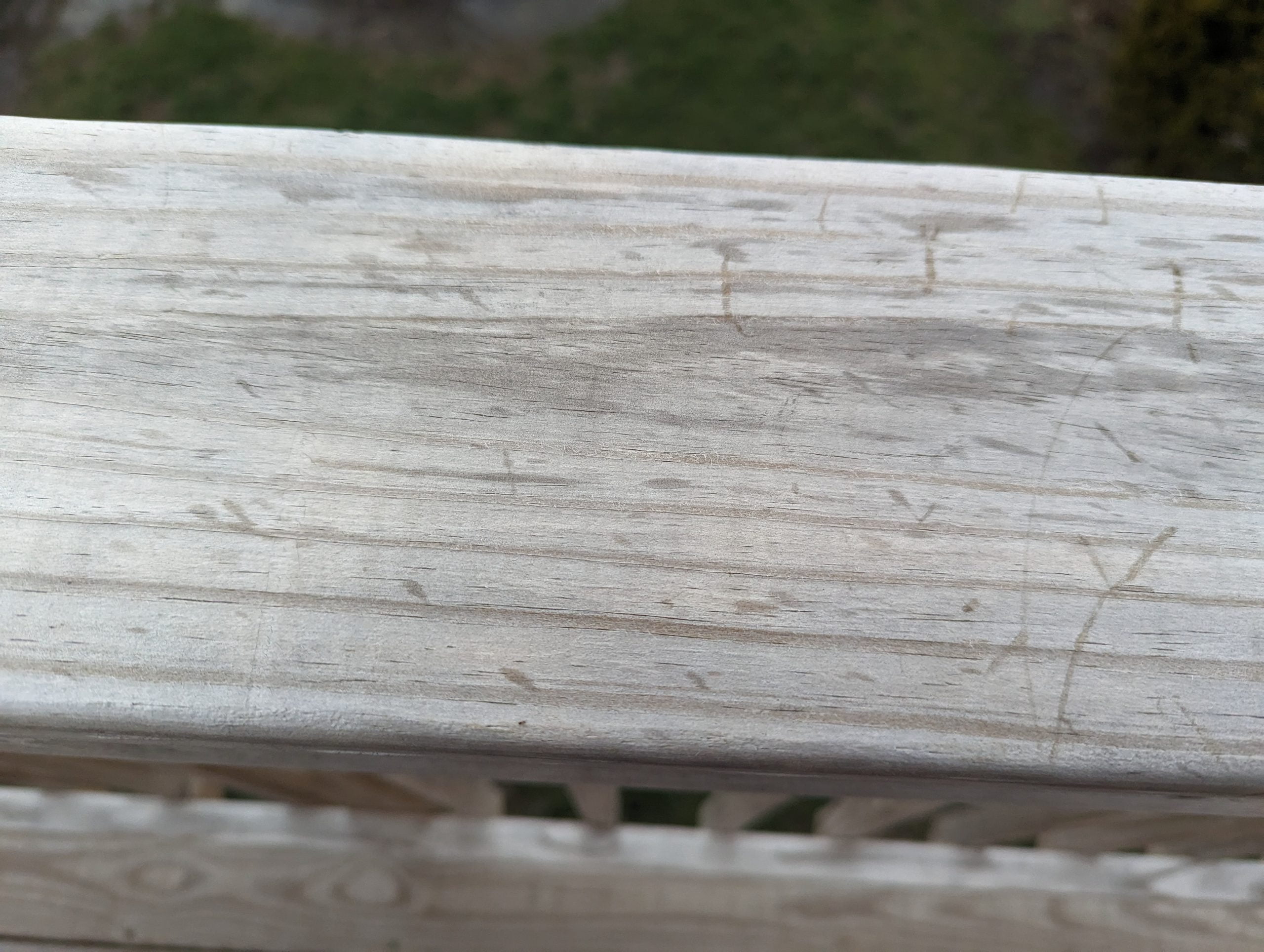

Andrea Gunter
Andrea Gunter
  1. New Wood or Older Wood? – Old Wood
  2. Does the Deck have a Current Coating? -Yes
  3. Are you Switching Brands of Deck Stain or Applying a Maintenance Coat of the same Brand and Color? – Applying same brand, unless you recommend something else.
  4. Deck Stain Brand Previously Used? Enter “unknown” if you do not know. – Behr waterproofing stain and sealer
  5. What is the Current Deck Stain Type? Oil-based or Water-Based? Clear, Transparent, Semi-Transparent, Semi-Solid, or Solid Stain? – I think it’s water based, semi-transparent
  6. Mold or Mildew Issues? No
  7. Reason for Previous Stain Failure? Most likely applicator error. Although it’s been a couple of years and I’m in the Pacific Northwest.
Thank you for any advice! I’m doing this to try and save my mother money, but have no idea what I’m doing!
Andrea Gunter
Andrea Gunter
Thank you for your reply. We ordered the RAD stripper with both additives, the RAD brightener and 3 gallons of the RAD solid stain. Got all my supplies, planning on starting bright and early to get it all done tomorrow. As I was clearing everything off the deck tonight, I realized I’m an idiot. The siding doesn’t seem like real wood. It seems like a composite of some sort? I realize I should know what it is but I don’t. My question is can you tell what it is from the pictures? Do I treat it like the rest of the wood, strip it, brighten it and then stain it? Or do I need to protect it somehow?
Andrea Gunter
Andrea Gunter
Ok, I’m finally done. And it looks fabulous if I do say so myself! Anyone that has any hesitation about purchasing the RAD products – do it. If I can use them, anyone can. It was so simple to do, and it came out great. I tried to take pictures after each step, but they don’t do it justice. First 2 pictures are the before, with the Behr product. 3rd is after stripping. I can only put 4 pics per post, so end results in next comment.
Andrea Gunter
Andrea Gunter
My results after using the Restore a Deck stripper, brightener, and solid stain in cypress. This stuff is amazing. I’m a 45 year old vet tech who’s pretty lazy. If I can use these products, anyone can. See previous comment for other pictures. First 2 pictures are after brightener. That stuff is amazing. Final 2 pics are after applying 2 coats of stain with a roller. At 10pm at night. There are a few spots where it’s a little lighter than the rest, and I was wanting to go back and get in between the boards. Can I touch up the light spots and do in between boards or did I miss my opportunity?
Thank you again for all your help. You saved my mom $1800, and made me the hero!

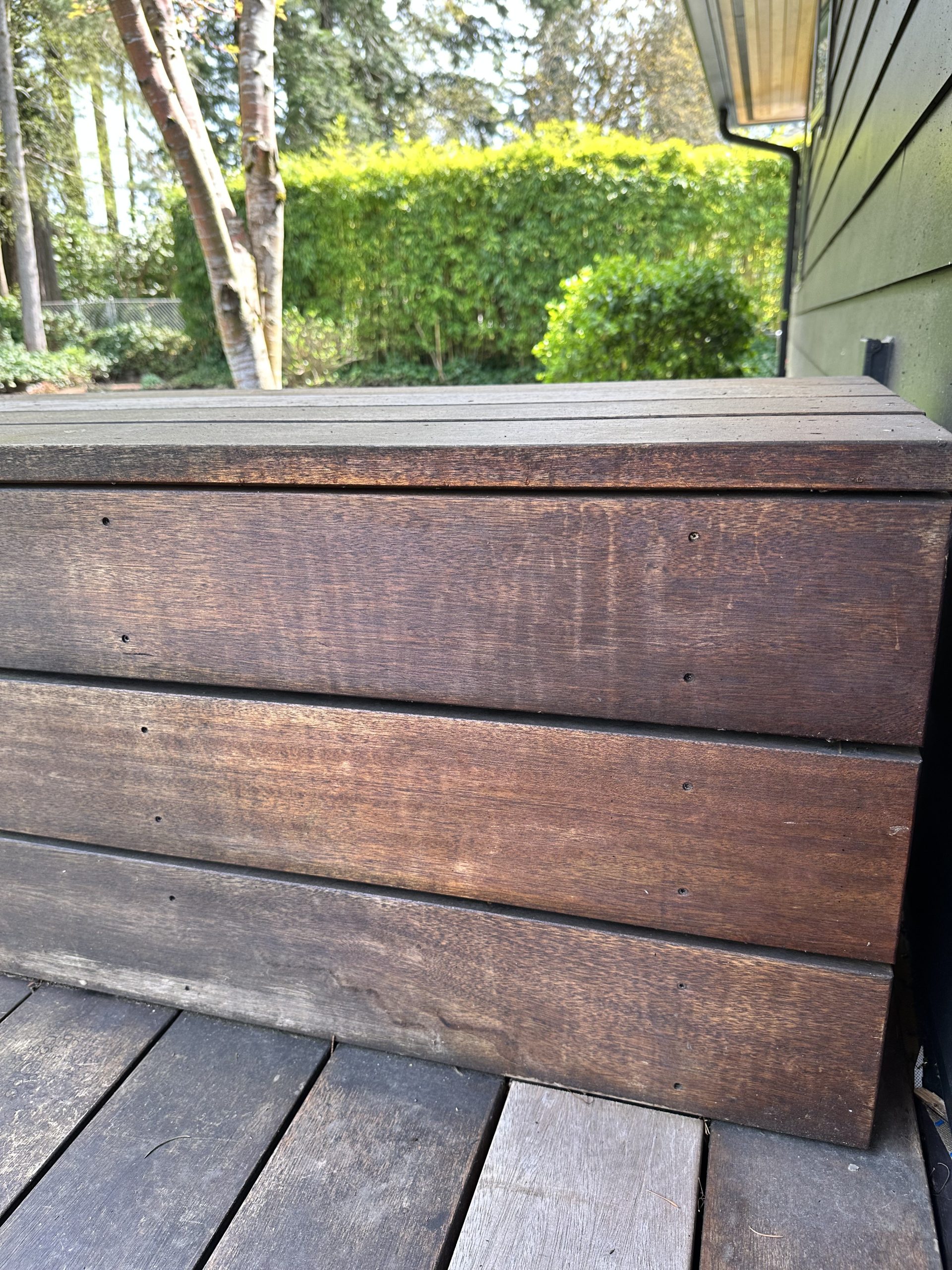

Raymond Wade
Raymond Wade
New or old wood?
Old 10 years cedar wood
Does deck have a current coating?
Yes,Australia timber oil cedar tone
Are you switching brands of deck stain or applying maintenance coat of the same brand and color?
Maintenance coat, not sure of same brand
Deck stain previously used?
Cabot Australian timber oil cedar tone. Nothing before
Mold or mildew issues?
No
Reason for previous stain failure
Cabot started failing before end of first year

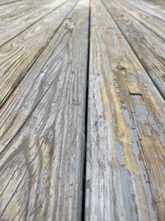

CAROLYN VAN DE ROSTYNE
OLD >15 YRS
SOLID STAIN (BOX STORE BRAND) OVER A SEMI TRANSPARENT? OIL OR WATER NOT SURE
REMOVING OLD AND APPLYING TWP SEMI SOLID IN A DARKER BROWN
UNKNOWN
SOLID STAIN
NO
SOLID STAIN APPLIED OVER UNPREPPED FAILING PREVIOUS COAT
ATTACHED – BEFORE (RAINING) AND AFTER STRIPPING THEN POWERWASH
Thank you – getting it sanded down – drum sander made the job easy – now preferring semi transparent TWP – over semi-solid – should be good right?

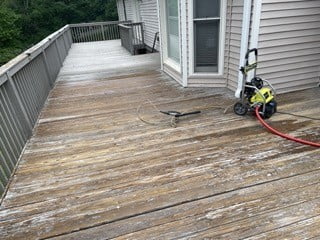

  1. New Wood or Older Wood? OLD
  5. What is the Current Deck Stain Type? Oil-based or Water-Based? Clear, Transparent, Semi-Transparent, Semi-Solid, or Solid Stain? I THINK SEMI-TRANSPARENT?
  7. Reason for Previous Stain Failure? JUST VERY OLD
Bought the house three years ago and haven’t done anything to it. Looks horizontal boards haven’t been stained in a long time. The vertical boards look like they were stained again, but at least 5 years ago.
I want to do the whole thing in a semi-transparent.
Do I need to strip this? Or can I just clean, brighten, re-stain?

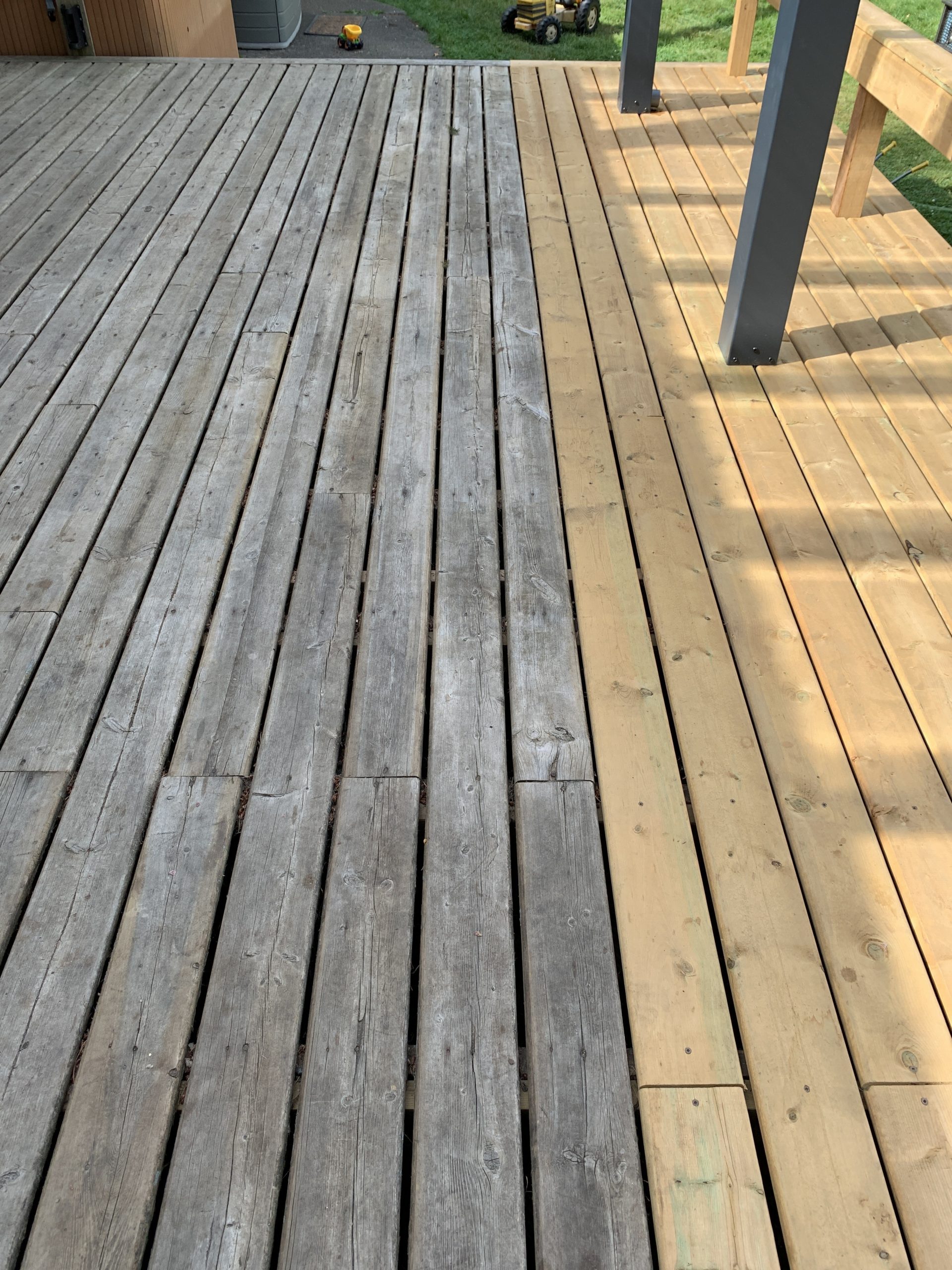

Marty
Marty

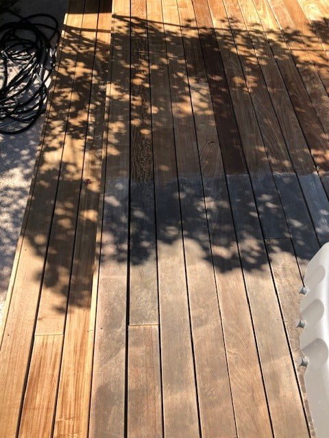

Installed new red cedar decking last fall. I used the RAD cleaner and brightner yesterday. This morning the deck has white blotches aroung the knots and some on the boards. I misread the brightner instructions and did the entire decking at one time rather than a litlle at a time. What can I do to resolve this? Thanks.
Marty
Marty
After my post I used clean water and a stiff brush to go over a small section. There is this ‘gunk’ that comes up. I can wipe it up with a sponge. Is there value in removing this? Which choice (remove ‘oxidation’ or not) will leave me with the best, most consistent look with my A/C semi-transparent stain?
Marty
Marty
Did a ‘good’ power wash again(no RAD, just water) and it did indeed remove all the gunk. There is a very fine line when power washing.. After all this should I expect to have good/appropriate absorption of the stain in the cedar?

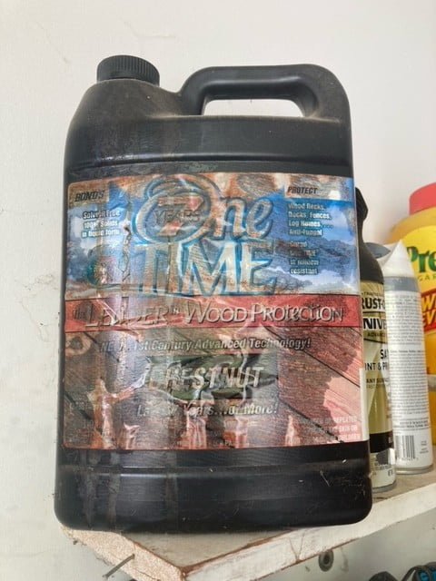

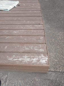

Cindy Belleau
Cindy Belleau
I’ve got a 30 yr old deck in fair condition. I hired a guy to work on it 3 years ago who put a Sherman Williams solid paint like stain on it.
It’s peeling off in pieces but some areas are still stuck on.
I plan on power washing it lightly to blow all of the loose stuff off and then use stripper on the parts that didn’t come off.

Hi, we expanded our deck and our budget didn’t allow all the boards to be replaced. I’m starting to prep for staining and wondering what you recommend. I’m guessing I will have to sand quite extensively to renew the old boards as much a possible. I know I won’t get them to match the new boards that closely and don’t mind that but any tips that will help and what kind of stain do you recommend? I’d like to use a semi-transparent for easier upkeep.
  1. New And old wood-pressure treated
  2. was painted (solid colour with grit) but has peeled/has been removed off
  3. was thinking semi-transparent
  4. unknown
  5. think it was paint or a Solid Stain with added in grit
  6. yes
  7. it bubbled and peeled (maybe because it was pain?) done by previous owners.
Tamara
Tamara
Should I sand the old boards?

Greetings – I live in a tiny home community and built a tiny deck addition onto an existing decked area. I had the bottom railing of existing covered porch deck Sawzalled off so I could better blow off the decking but it left bare areas in the stained flooring. I now want to refresh the entire covered porch flooring and stairs and blend into new decking. I’ve read your posts on how to stain new decking…so I’m all set there. No clue on whether to use oil or water-based stain. Answers to questions and pictures:
1- 3 year old wood
2- has coating
3- switching brands to one you recommend
4- current brand unknown
5- no idea what type of stain it is
6- no mold/mildew issues
7- time for refresh and would like to try to blend old into new decking knowing it will never match perfectly

Hello! We are having trouble preparing our deck to get stained. When power washing and cleaning and brightening, the wood ended up with splinters. So then we have sanded with an orbital sander, and hope to stain next, but is it okay to use a damp cloth to dust away some of the fine particles? How long before we can stain if we do use a damp cloth? We are planning on using the Armstrong Clark stain for Hardwood (we will be sampling the Amber and Black Walnut colors to figure out the color, I don’t like the deep red and black color we got when we did a sample of the Natural Messmer stain).
  1. New Wood or Older Wood? The wood is Ipe, and has been installed for about a year, and has oxidized to a gray color we don’t like.
  2. Does the Deck have a Current Coating? No.
  3. Are you Switching Brands of Deck Stain or Applying a Maintenance Coat of the same Brand and Color? No.
  4. Deck Stain Brand Previously Used? Enter “unknown” if you do not know. No.
  5. What is the Current Deck Stain Type? Oil-based or Water-Based? Clear, Transparent, Semi-Transparent, Semi-Solid, or Solid Stain? None.
  6. Mold or Mildew Issues? No, since it has been cleaned and brightened.
The photo shows the cleaned area with the lower right part of the photo showing the not-yet-cleaned area.
Celeste Warner
Celeste Warner
So then do I first use the cleaner, rinse, then use the brighener, then rinse, then wait 3 days to dry, then do the stain? I sure hope I’ve got this right!

Have been reading over all the wonderful info here, thank you! We have a 30 year old deck that we will be trying to revive and since we are in Canada limited to which products are available here. Leaning towards the Armstrong but what “brightener” would work best and is available in Canada?
Like others here, we too used Behrs and it began peeling the next winter … what a drag … do we have to pressure wash to remove excess peeling if we sand throughly? Many thanks.
Vimto
Vimto
Thank you so much – I know that you say the same thing over and over ha but am I missing a “Best Brightener List?” We are in Canada and not everything is available here. I want something to go with Armstrong which we can definitely get.
This is the best website of its kind I have seen incidentally 🙂
Vimto
Vimto
Sorry for the confusion and thank you for your patience – and maybe I have now answered my own question. I presume that “brightener” and “cleaners” are the SAME thing then? If yes, I see your list …
