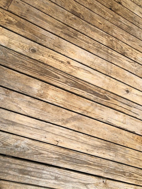

photos 1-3 of 4
“One of the biggest mistakes DIY homeowners make in cleaning and preparing a wood deck for stain is not removing all remnants of old deck stain.”
Boy, did I find out how true this is! I spent two weekends doing the following prep work: 1) applied Defy Stain Stripper, 2) scrubbed entire deck with stiff bristled brushes, 3) pressure washed, 4) sanded the deck with 80 grit paper and 5) applied brightener.
Even after all these steps, some old stain remained and since I was staining with a darker color, I didn’t think it would be a problem. Just stained it yesterday and you can see EVERY SINGLE spot where the old stain wasn’t removed. I’m just sick about it. When you say “ALL” remnants you aren’t kidding!
So, two questions:
1) Do I have to re-strip and start all over to fix this? Can I do that right away, when I just stained it 24 hours ago?
2) If the answer to #1 is yes, how in the world do I get all of that stubborn old stain off? (especially between the boards)
I’ve included some photos.The old stain is a TWP 101, color Cedartone Natural (the orange you see) and the new stain is C2 Guard, color Cordova.
1. Yes, you would have to redo all. Now or whenever you want.
2. Sand is probably your best bet. Between boards, you probably will not get out.
No pics.
Thank you for your quick reply! I added the pics in separate posts.

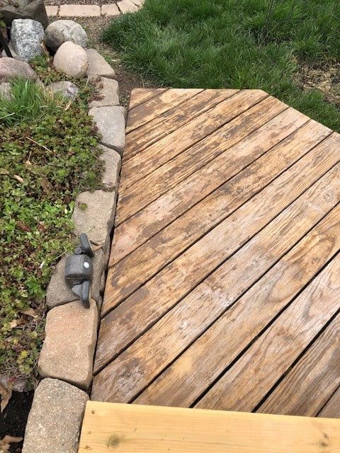

I would like to have the solid removed off the deck floor boards but wasn’t sure if this was even an option. Would you try and chemically strip it first with the Restore A Deck stripper and then mechanically sand?
I have attached pictures of the deck as well as a photo of the solid deck stain that was used on the floor boards. Thanks
You can try and strip some but you will need to sand to get this off the floor.

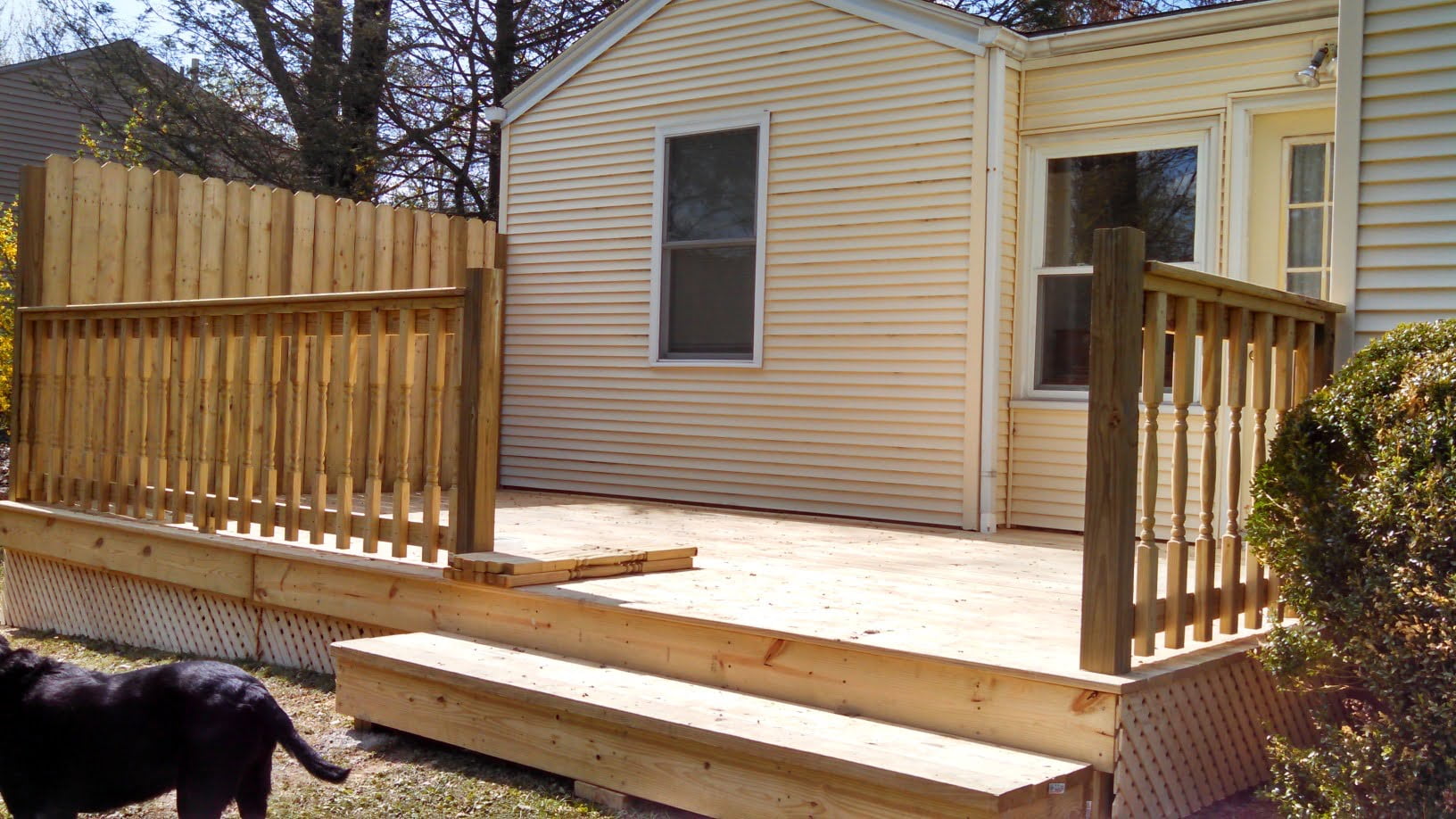

Our deck is less than a year old…made with Southern Yellow Pine #1 KDAT, pressure treated…good stuff, ready to stain immediately. We stained it using top of the line semi transparent stain…it looks horrible, not because of the stain/color or the wood…it was the way it was applied…blotchy, uneven, total amateurish…its been stained now thru a very mild winter for about 6 months…should I just restain over the applied or power sand it off and start clean? Its big, about 750 sq/ft
You should remove and start over. How would depend on the stain brand and type? Pictures would help as well.
Can the old deck boards be removed, turned upside down, reinstalled and stained again on top.
It doesn’t always work so well when you do this as the framing joists can stain the undersides and it does not come out.

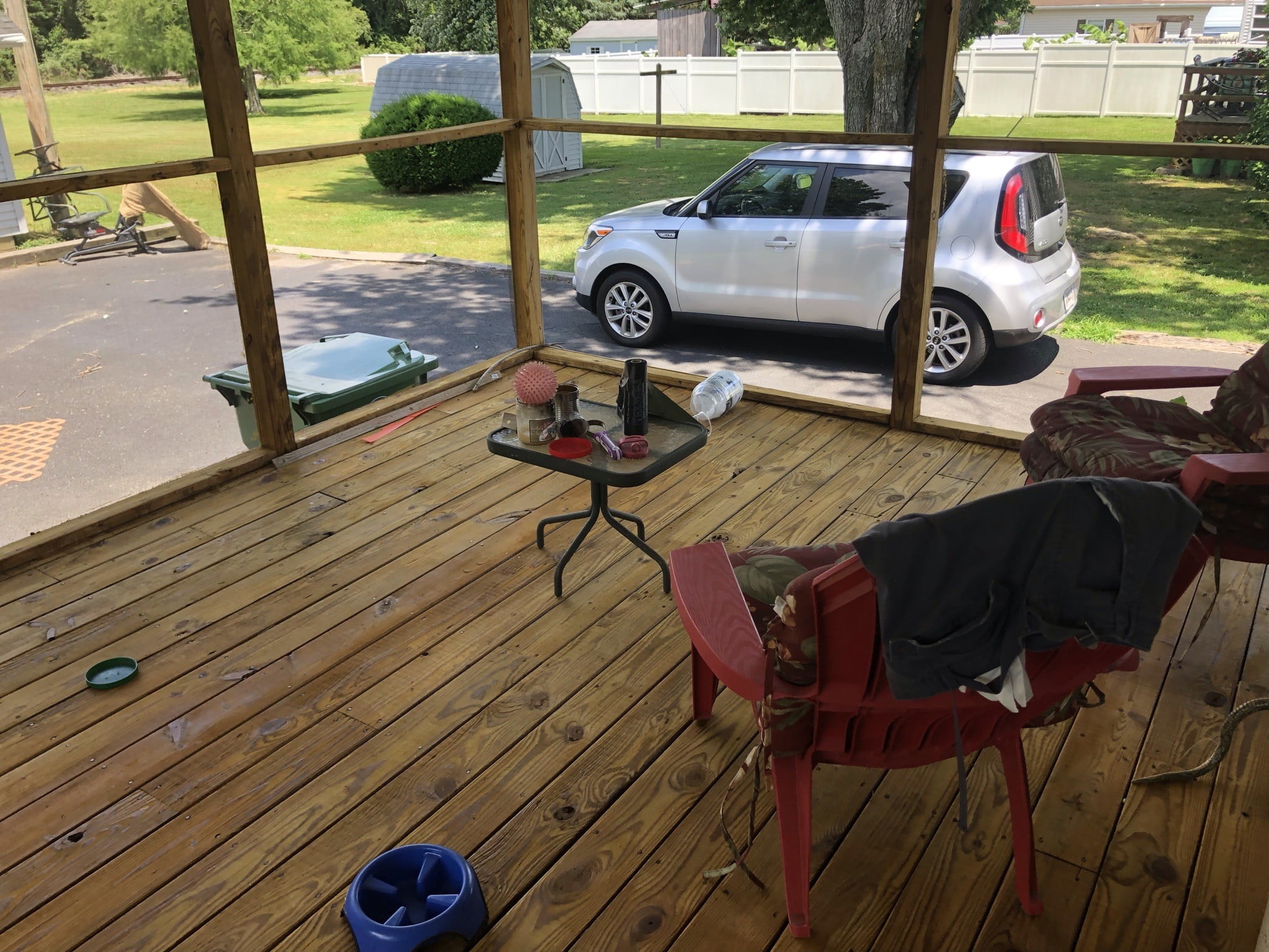

I bought a house a year ago with a deck that is partially covered, with an uncovered catwalk that was moldy and in need of replacement. The new boards and new railing have been put in and the deck is now ready to be stripped/cleaned/stained. But I can’t tell if the old stain can be removed with a stain stripper, or if its more like a paint and needs to be sanded off. I plan on using a transparent sealer over the entire deck to keep a natural look, so I want the old wood to look good natural instead of needing to cover it up with another dark stain. Any advice? I’m new to all this and I’m hoping to be able to do it myself.
Looks like you will have to power sand this off.
Thanks! Should I rent a drum sander? The paint is also on posts. What type of sander would you recommend for those small spaces?

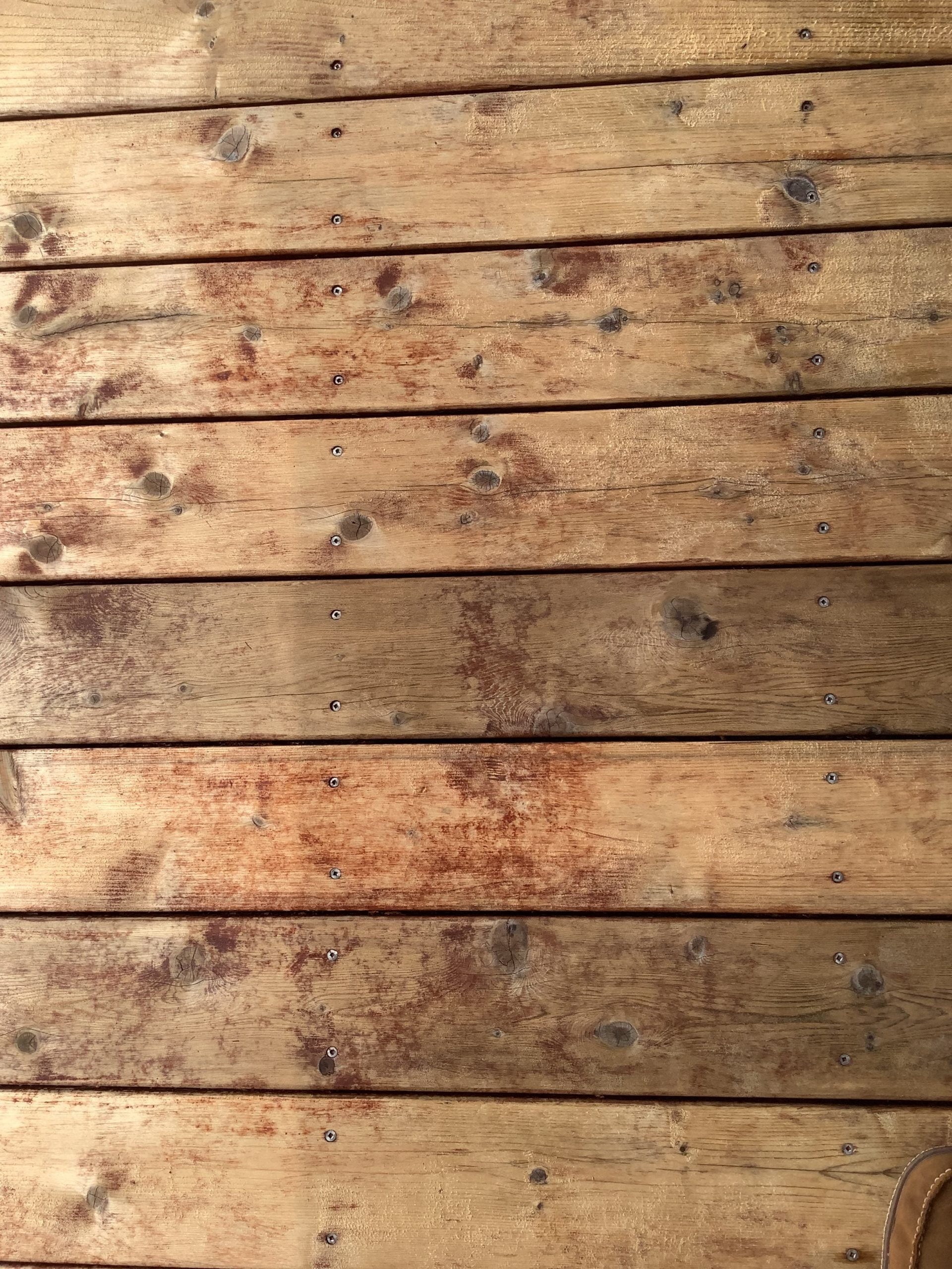

Title: Trying to Fix Mistake of Changing to Water Based Stain
Stained my deck 4 years ago with TWP 1500 Dark Oak. It was beautiful. It needed a recoat. The local pressure washer and deck supply guy recommended I go with a water based stain because all stains with VOC, like TWP, were going to be banned soon. So I got the closest color stain and stripped a small landing deck as a trial. Stripping the TWP was a major job on the 80 sf landing deck and I was not looking forward to that on the big deck (1000 sf).
When I started staining it applied and looked terrible compared to the TWP. After staining 3 boards I stopped to figure out what to do. I decided then to stay with the TWP 1500. That was a couple weeks ago. I still have the 3 boards I stained with the water based stain. I tried a sodium hydroxide stripper but it didn’t work to get the water based stain off. What do I need to use to strip the water based stain before applying the TWP 1500.
What brand of stain is it and best to post a picture. BTW, oil-based stains are not going to be banned.
The stain is a house brand. I do not know who makes it. This is the only description on the bucket that might give a sense of the type of stain it is: “With other Deck and Fence Sealing products, you have to wait for the surface to dry and worry about rain showers. Our stain can be applied to a damp wood surface so you can complete the job the same day. This fast drying wood deck and fence sealer can be brushed, rolled, or sprayed with an airless sprayer.”
Attached are pictures.
Strippers will not remove this so power sanding is your only option to remove it.
It may be easier to just replace the boards.
Sanding would be easier and you wouldn’t have to let the new wood season: https://www.deckstainhelp.com/staining-a-new-deck/

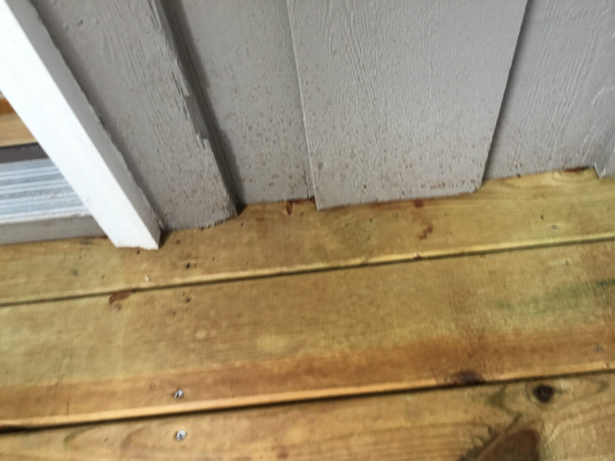

My deck was built exactly 14 months ago and I did not apply sealer or anything else. The pressure treated wood is still solid and it still looks good . I did pressure wash it with a cleaner about 2wks ago. Now I want to use a semi-transparent stain. Do I need to seal it separately? Or will a sealer/stain combo be enough?? Thanks.
You cannot seal over a deck stain. Deck stains are sealers as well.
We have a cedar deck that is one year old. Clear sealer was applied when installed, and then another coat of sealer was applied but not immediately after first coat of sealer. Apparently the deck was not cleaned between coats of sealer. Now the deck has mold and large gray areas with obvious peeling sealer. We will need to strip the deck before applying new stain. What are the recommendations for stripper and stain for a cedar deck? Will we need to use a brighter before applying stain, even tho deck is only one year old. Thanks
Could you post a picture, please? Yes, you will need to remove. Strip and brighten for this.
