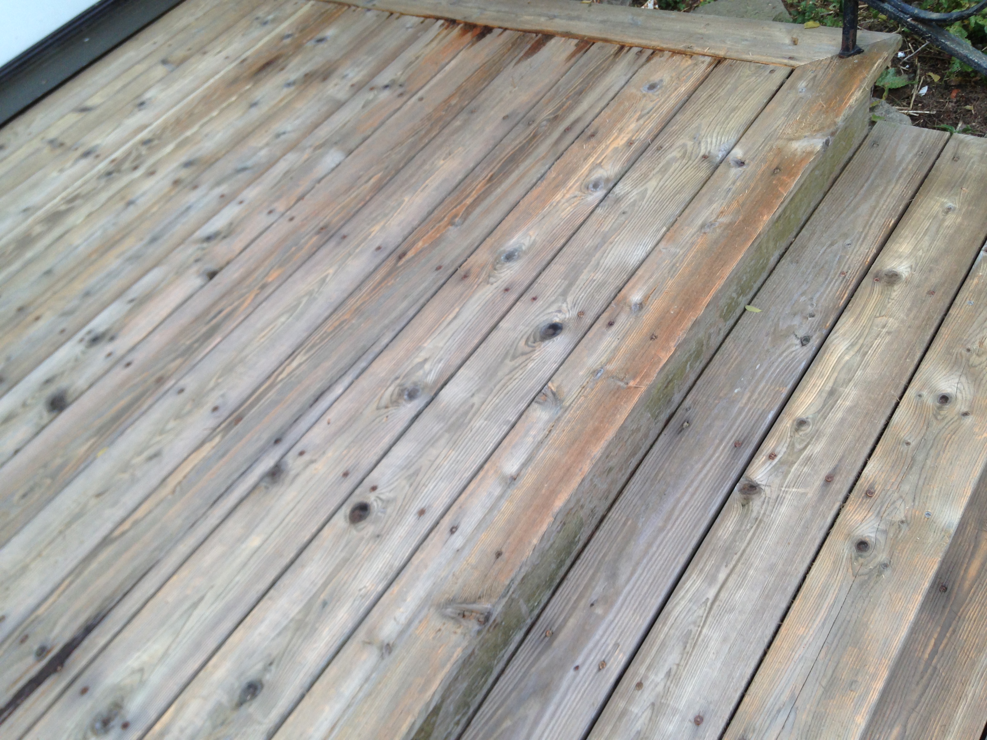

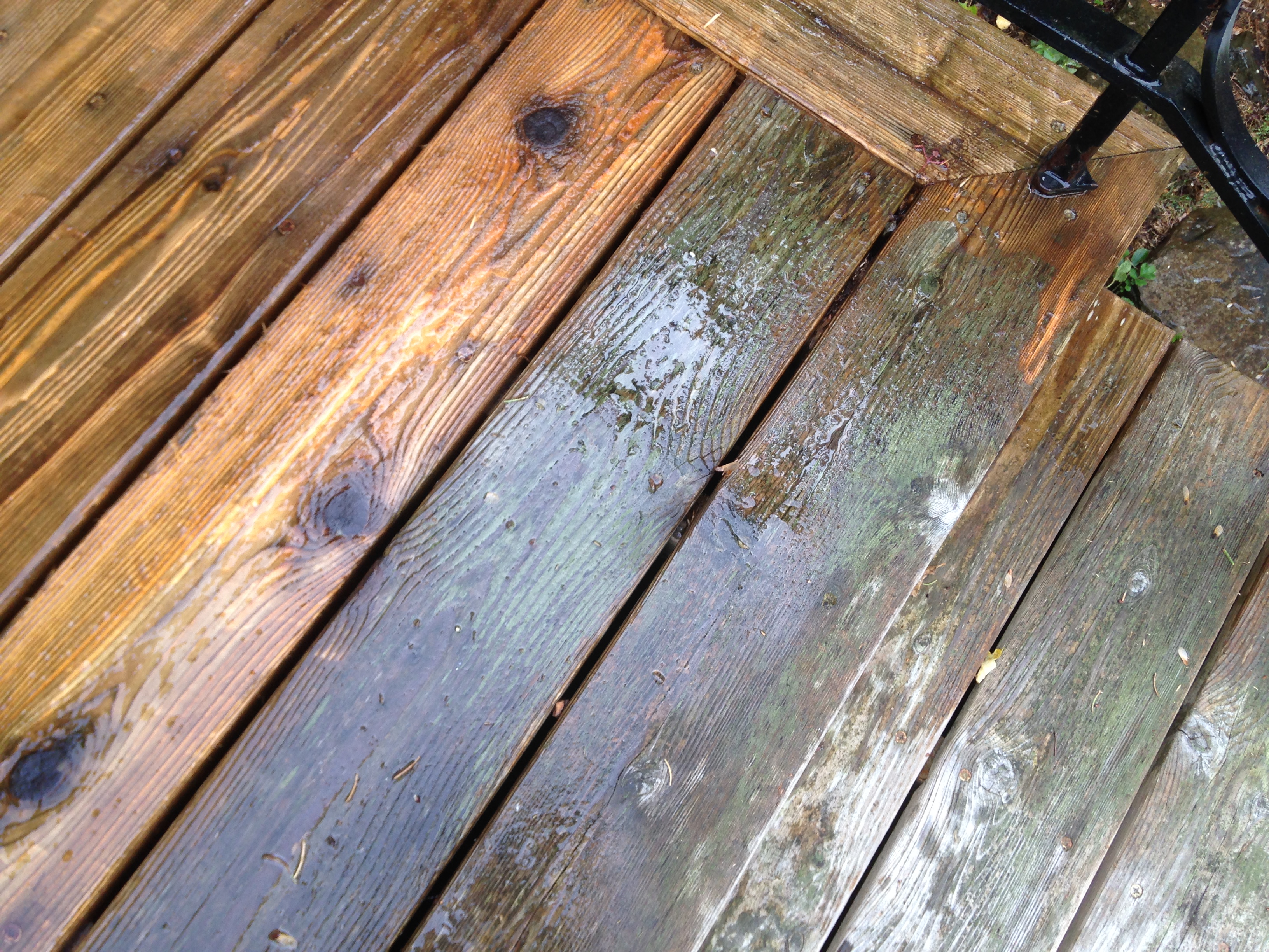

Mildew On Deck Stain Photos

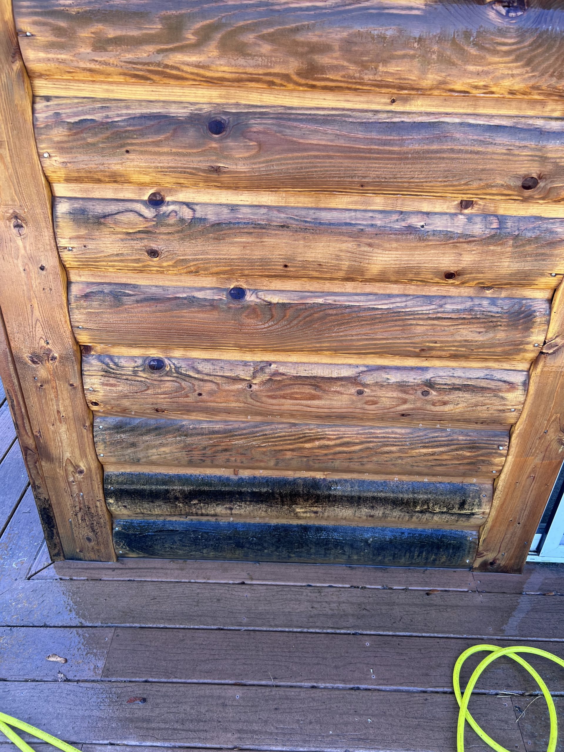

Working on restoring this faux log siding, used mold armor house wash then pressure washed, then belt sanded. When we applyed the data in two days after cleaning, then wood turned really dark. Tips on what to do.
You need to remove all down to the bare wood and then brighten it for prep. To remove Messmers Timberflex, you will need to media blast the coating from all wood.
