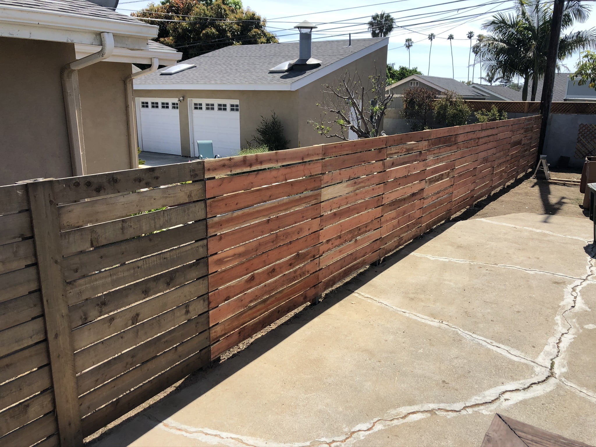

Hello! We just installed a redwood fence two weeks ago to match an existing redwood fence that was installed in 2017. My neighbor used a Sherwin Williams semi-transparent stain immediately after installing the fence and hasn’t done anything to it since. You can see the difference in the two in the photo attached. My questions are: can we get the old fence to look more like the new one? If so, what products do you recommend? Also, what stain do you recommend for the new fence that will maintain as much of the original color/texture as possible, but also protect it. (I realize the color will have to change some because that’s what protects it!). Thanks 🙂
New redwood deck laid, sanded and stained with Cabots Australian Timber Oil. It turned out terrible and now I know why. How do I remove the Cabots so the deck looks freshly laid so I can let it age to follow your guidelines. I have started sanding with 80 grit by hand but it is 300’ and am I continuing to degrade the wood?
You want to strip and brighten to remove it. Use the Restore A Deck Kits.

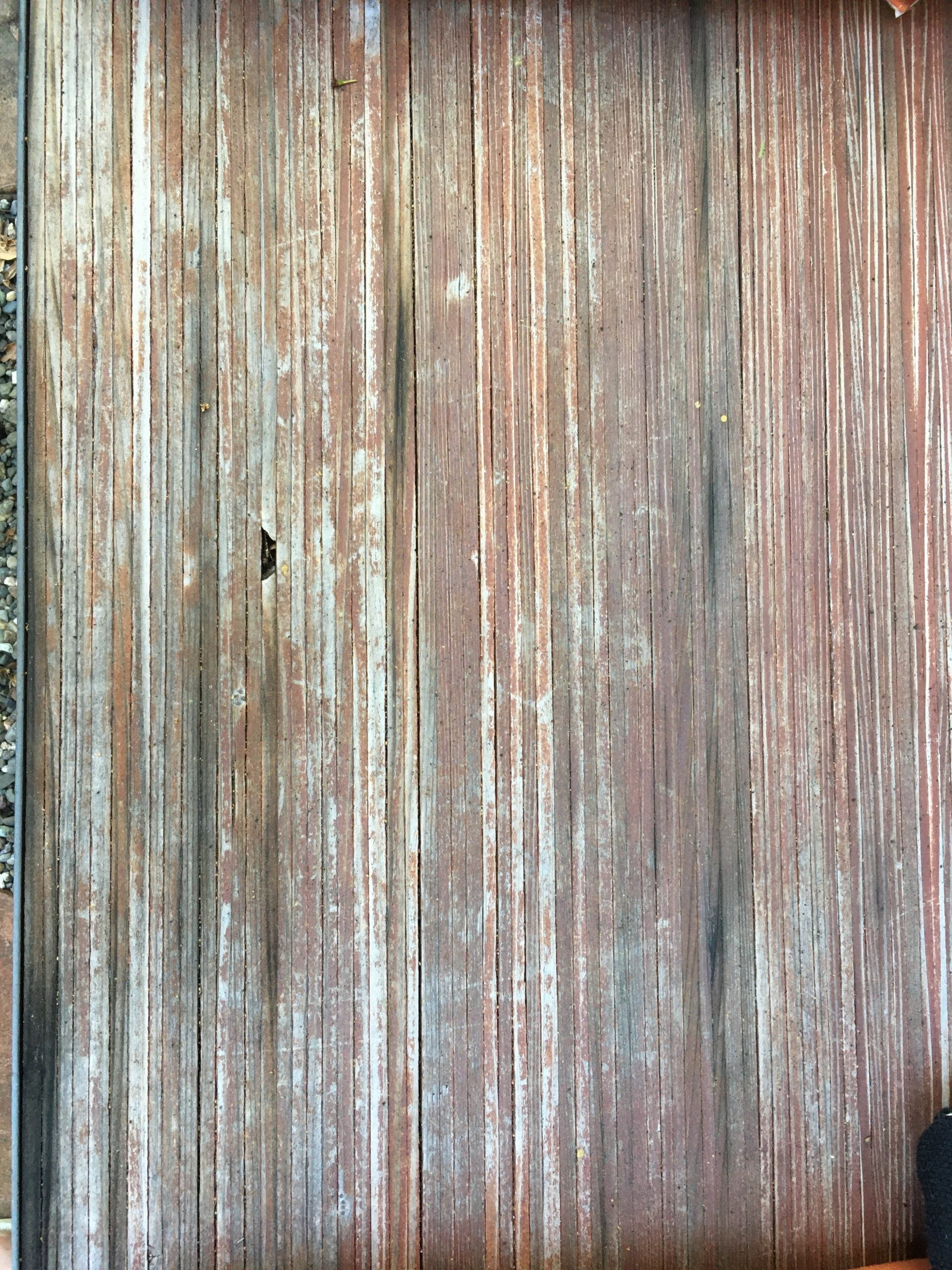

I have a redwood bench about 5 years old. It is made of thin strips put together. Not sure if is stained originally but looking worn now. I think I need to clean and stain. Recommendations?
Strip and brighten for prep. Stain after.

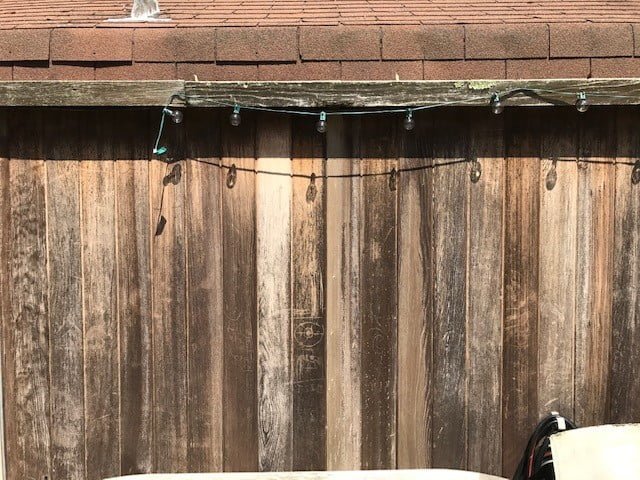

We own a redwood mid-century modern home in eastern long island that needs to be stained after many years of not getting treated. I believe we need to remove the current stain first which is so worn out that you can rub it off with the tip of your finger. We plan to stain it with a darker color, charcoal/grey.
My questions are as follows: 1. what should we do to remove the existing stain and some mildew spots – can we scrub with a brush and solution? 2. Do we need to treat the wood with a primer before we apply the new stain? 3. What is the ideal temperature to do this project and 4. what brands of stain would you recommend for this project.
Post some pictures.
Photos below. Please advise on my above questions.
Use a deck stripper with pressure washing for prep. Brightener after. Stain with Armstrong Clark or TWP 200 Series. Do not use a primer.

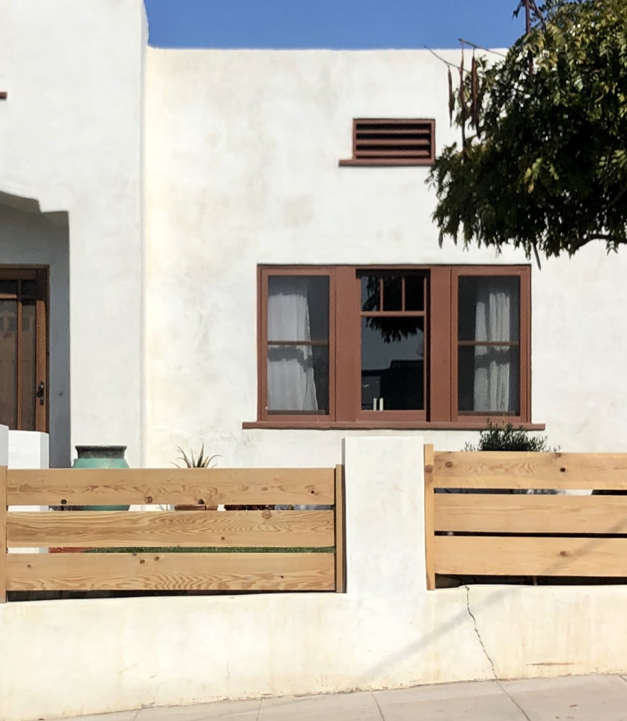

Hello, we have a rough sawn redwood fence. I recently cleaned and brightened the wood (2 years old here in Southern California). I want to add a protectant but want to main the clean look and color we now see as a result of the wood cleaning. Can you recommend a sealer / stain that we can use which will maintain the look we see. Pics attached. Thank you.
It is impossible to maintain the current color as it is in the picture. If you want UV protection from graying then the stain must be tinted and that will enhance/change the wood’s color based on the tint you use. The darker or richer the color, the better the UV protection.
Thank you for the feedback. If we use TWP clear cost how long do you think it will take before it grays and we will need to clean / brighten again and re apply the clear? What is the lightest stain you have as well? Thank you.
The TWP Clear (and all clear sealers) will not prevent UV graying and will gray naturally in a matter of months. Many stain brands will have light tints and vary by name. With TWP they have a Honeytone color that is similar to a clean wet look. Other brands may carry a Natural color that is tinted lightly as well.

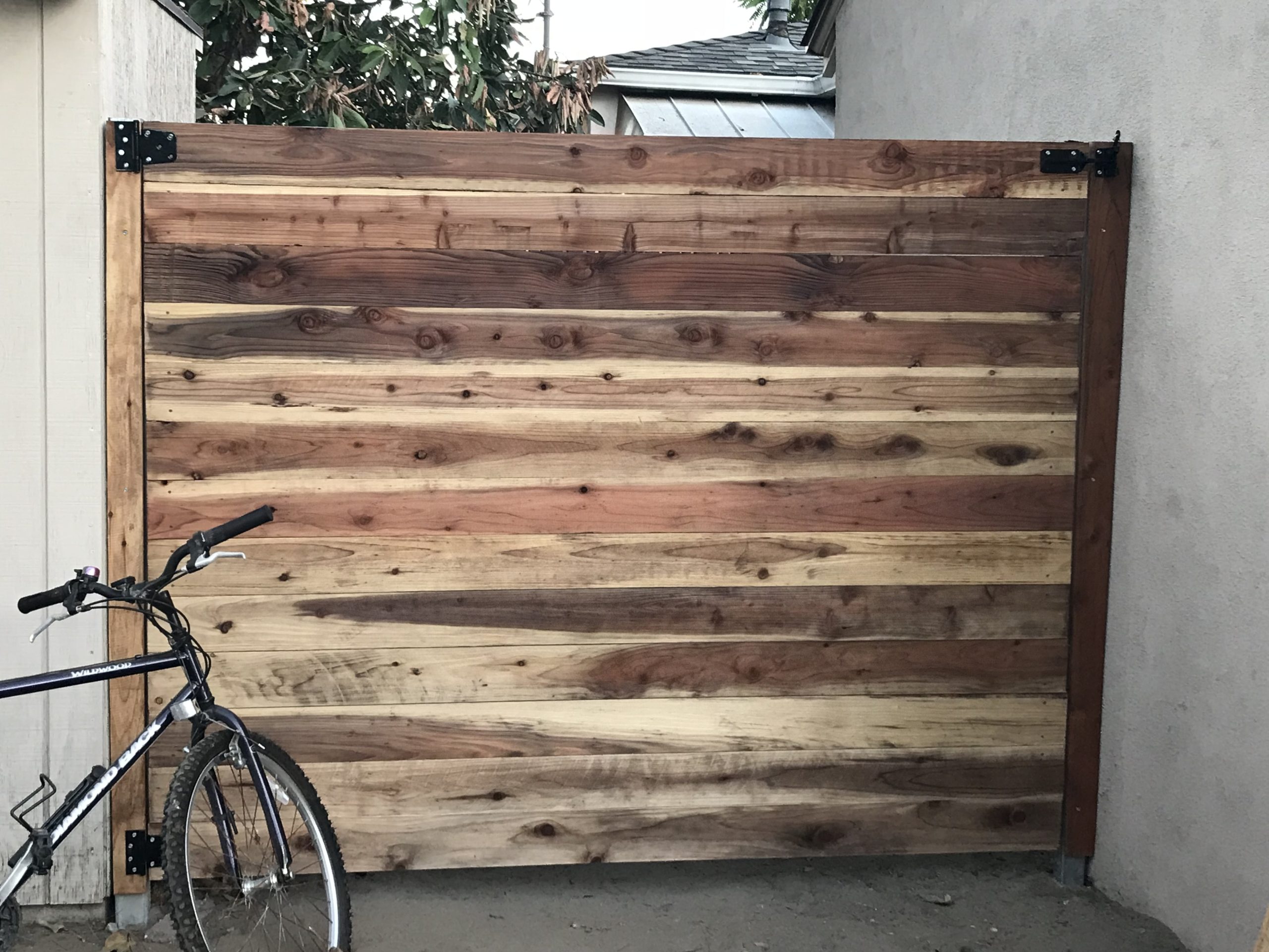

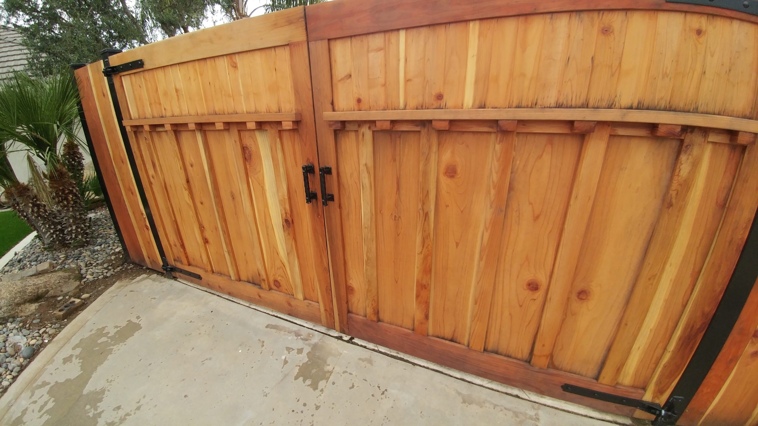

I just had a redwood double gate made and installed about 4 weeks ago. I was told to wait a few weeks to let the wood dry out before sealing it on one side. I didnt get around to sealing it and the rains came and now there are black streaks all over the gate. Is it mold and how can I remove the black. I am in central Calif and its still raining.
That is mildew. You will need to clean and brighten to remove. Stain with Defy Extreme or Restore A Deck Wood Stains after.

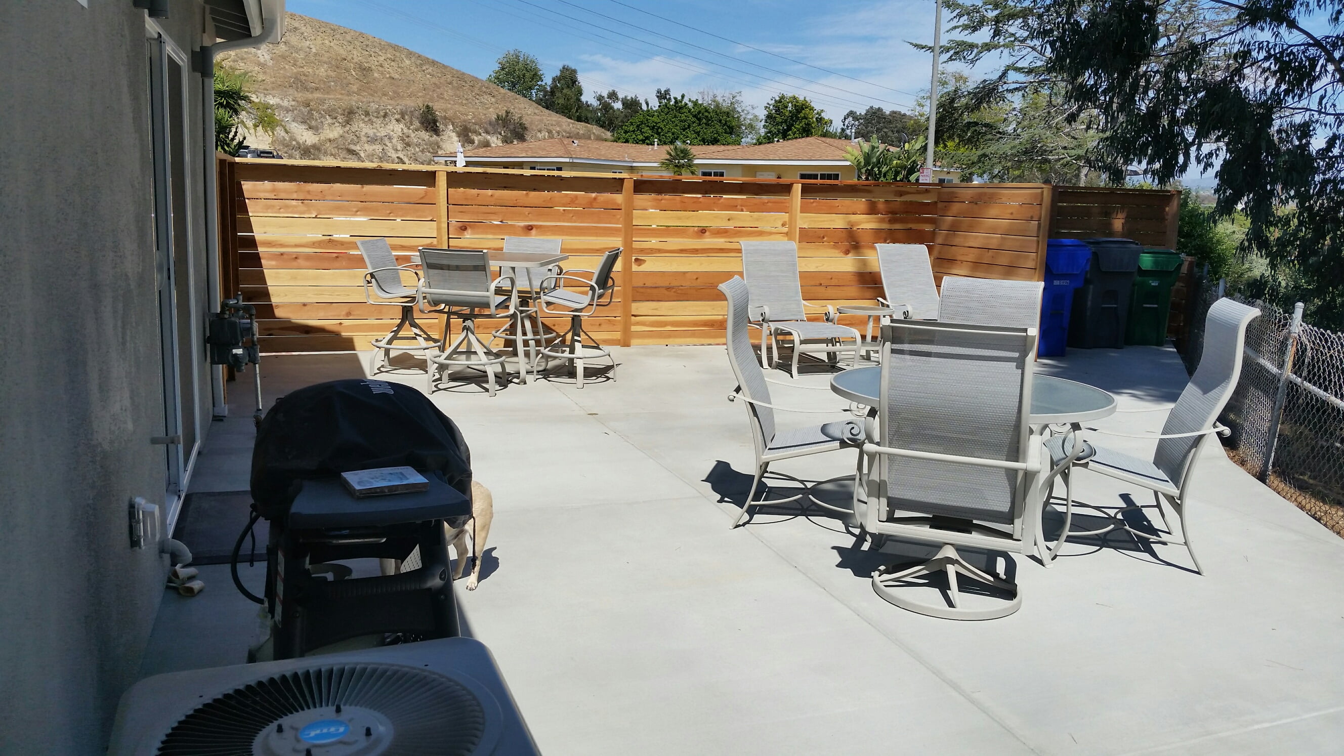

We have a new rough sewn redwood fence that we just put up, it is beautiful with lots of variation in wood tones. We don’t want to loose that but want to use Defy to protect the fence. We got samples of Cedar and Light Walnut, they are very small samples (1 oz) and they seem exactly the same. My fear is that the Brown tones will be very uniform and we will loose all of the variation in the Redwood. I think the Pine would be too yellowing. Can you comment on the differences between these two stain colors, and if you think we will still see lots of variation with the Cedar or Light Walnut stain? Thank you!
Both colors enhance the natural grain of your wood tones. Personally, we like the Light Walnut better as it is not as “orange” as the cedartone color.
