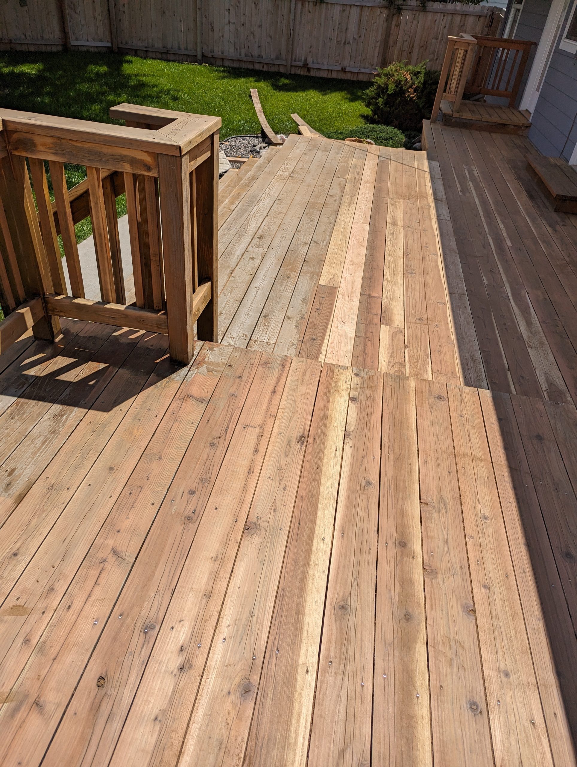

Great article! I have just had a new redwood deck built and it is weathering well. I live in SW Colorado at altitude and get a lot of snow and a lot of intense sun.
The redwood was beautiful initially but is now fading and looks a bit more tan. Should I use a semitransparent stain like TWP 1500 redwood or the Armstrong-Clark stain (not sure if they have redwood)? Or should I use a different tone? I really want it too look like redwood but not red like the fence in the review of TWP 1500.
Thoughts?
You can use any color you would like, it does not have to be “redwood”. Both the AC stain and the TWP 1500 are excellent. Best to test some samples to see what color you like. Make sure to weather and prep.

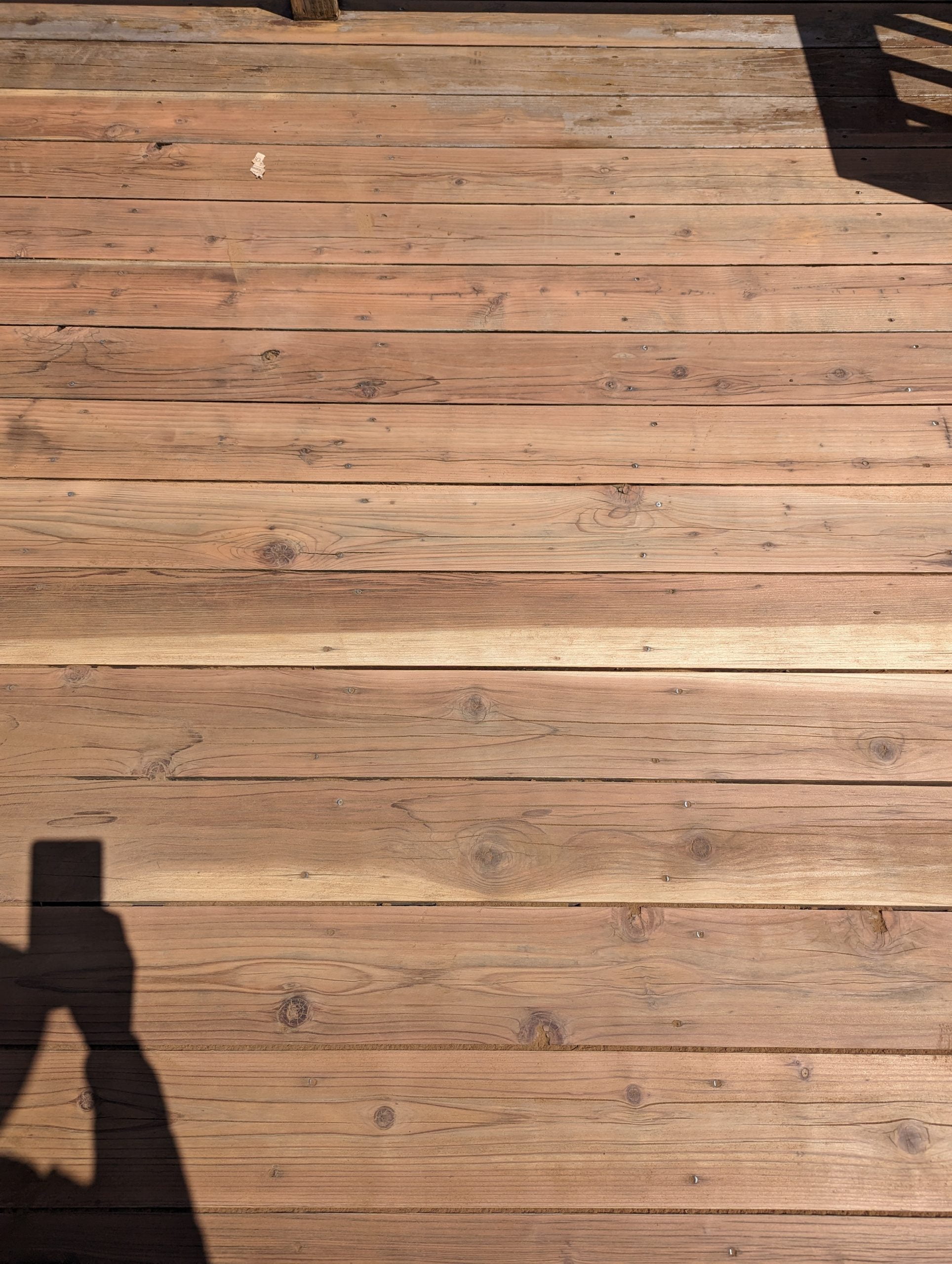

Decided to restore our deck. Purchased home back in 2021 and the deck was in rough shape. Sanded off the peeling old stain to reveal what I think is Redwood?
Now that the deck has been completely sanded do I need to use a cleaner and a brightener on it before staining? Would like to use something transparent since the wood looks so good.
1. Looks like it.
2. Yes, clean and brighten for prep.
Try Restore A Deck Stains or Armstrong Clark Stains.

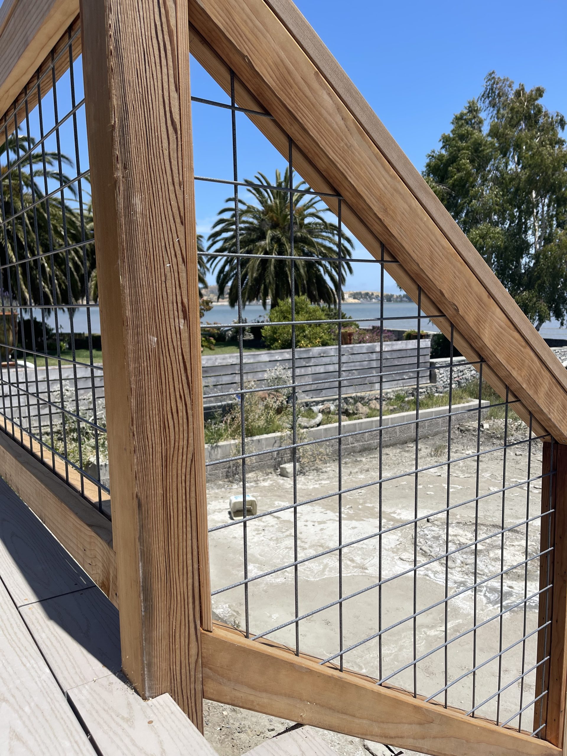

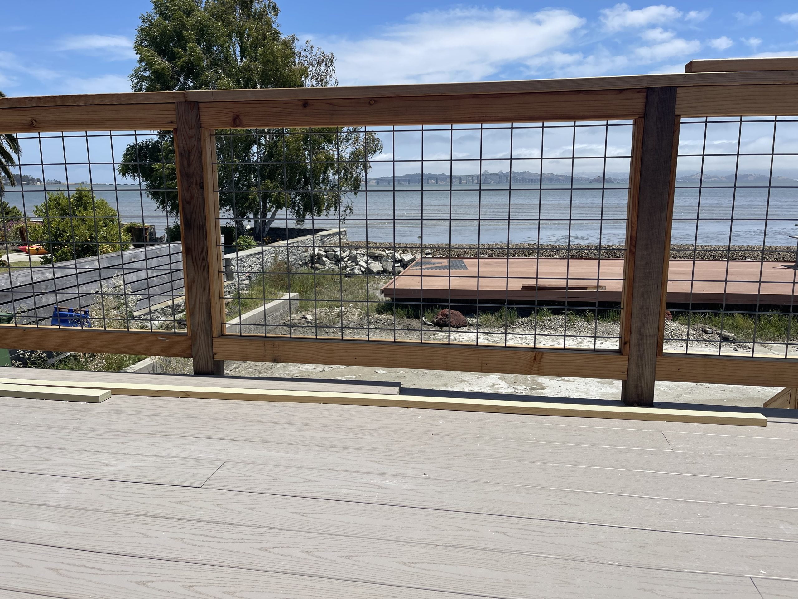

Hi! Great article. We have a new timbertech composite deck ( harvest collection; slate gray) with redwood railings. Im wondering if you have a product suggestion for preserving the redwood to match the timbertech deck?
thanks!
Where are you located?
Bay Area; california
bay area- california
Look at Armstrong Clark stain in Driftwood Gray.

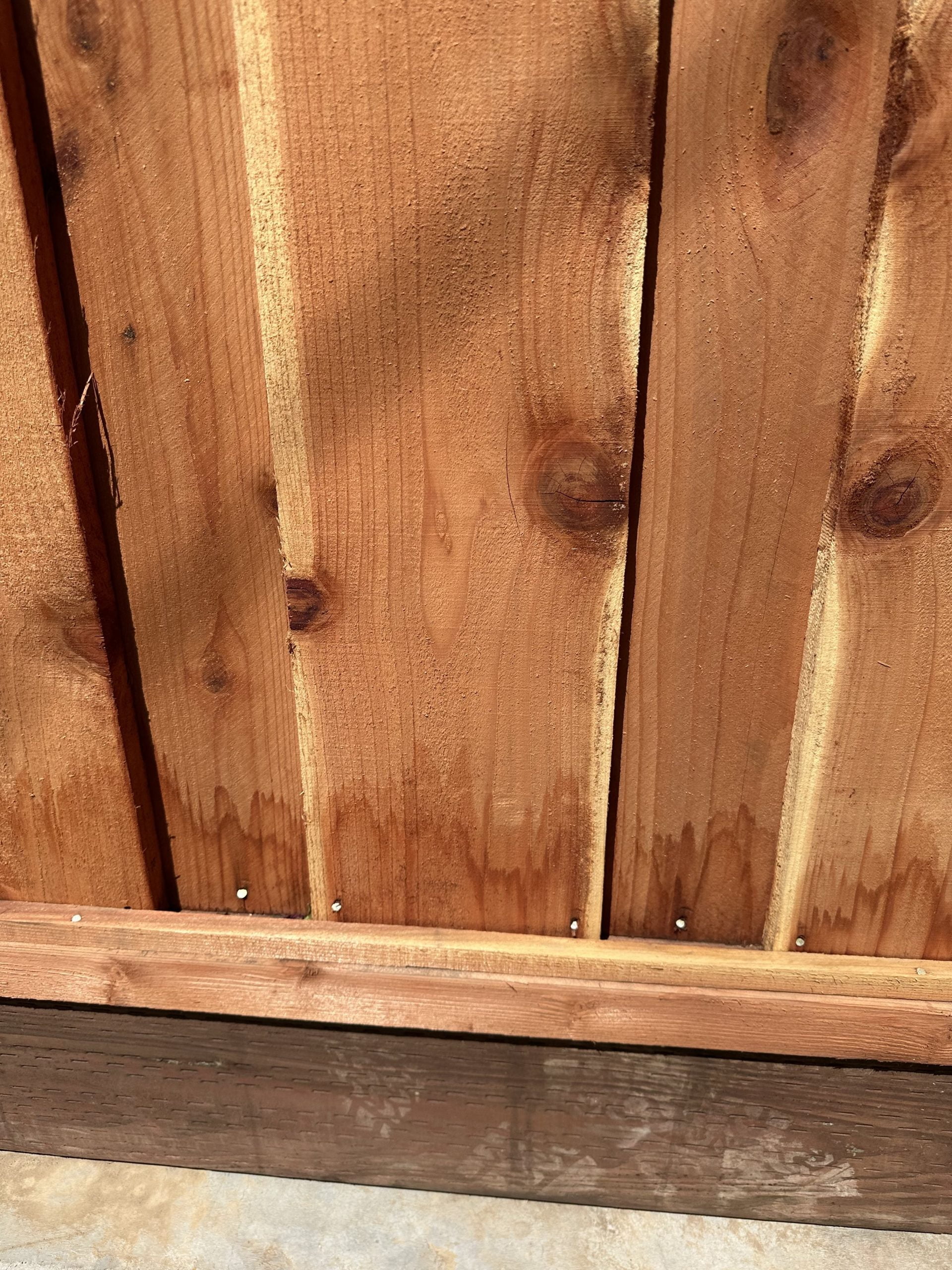

We recently had a new redwood fence last week and reading your article sounds like I can use a stain & seal. Going through the comments, I may still need to wait a bit before this can be done. The edges are not smooth, and sap is leaking through the boards. I also don’t want to wait too long as I already see watermarks from my neighbor’s sprinkling system. What do you suggest?
Liz
That is rough-sawn wood so you can stain it now. Look at TWP 1500 Series or Armstrong Clark Stains. Tip: Have the neighbor adjust the sprinklers as best he can to avoid the fence as constant water will “discolor” the wood and stain over time.

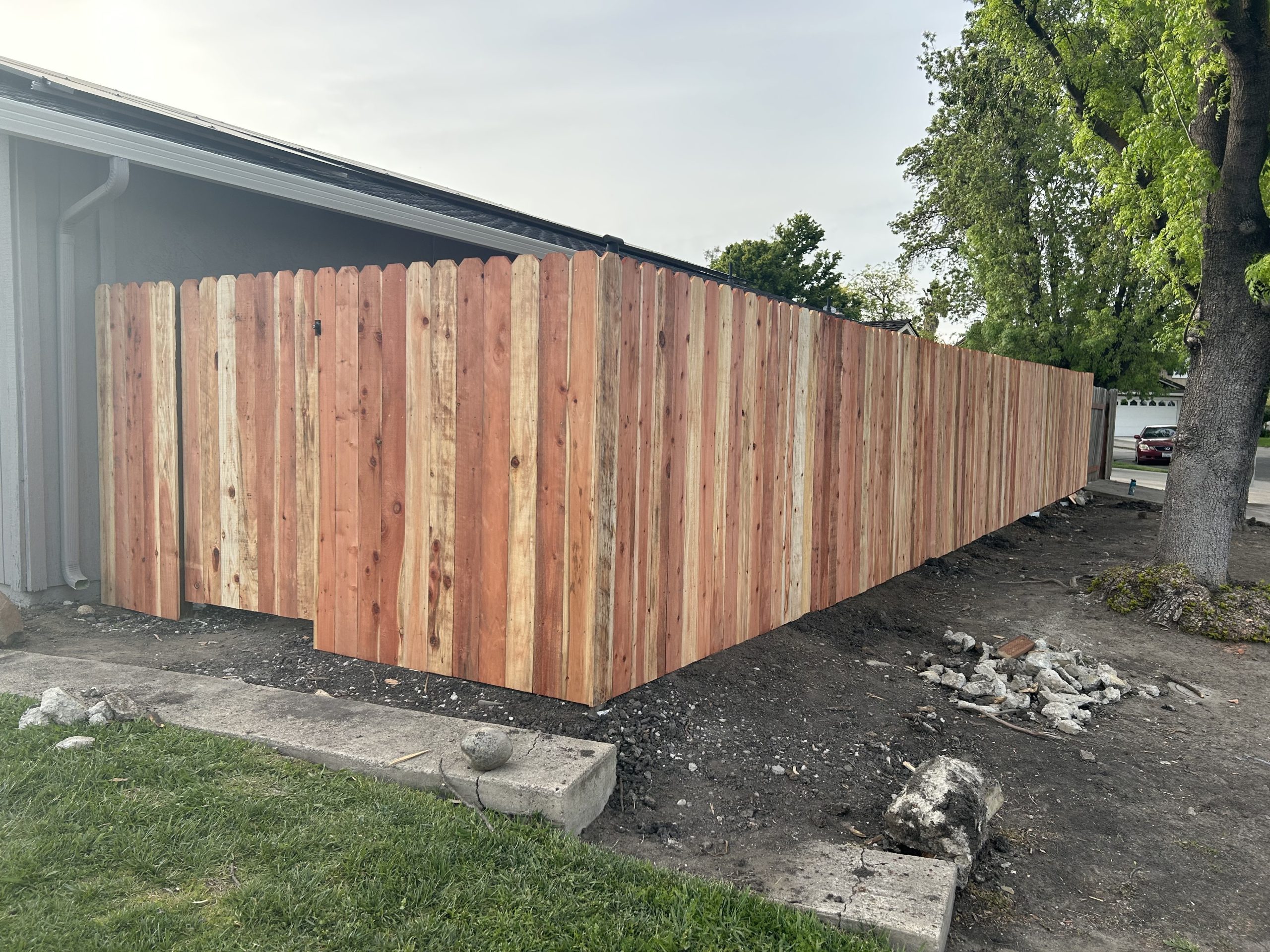

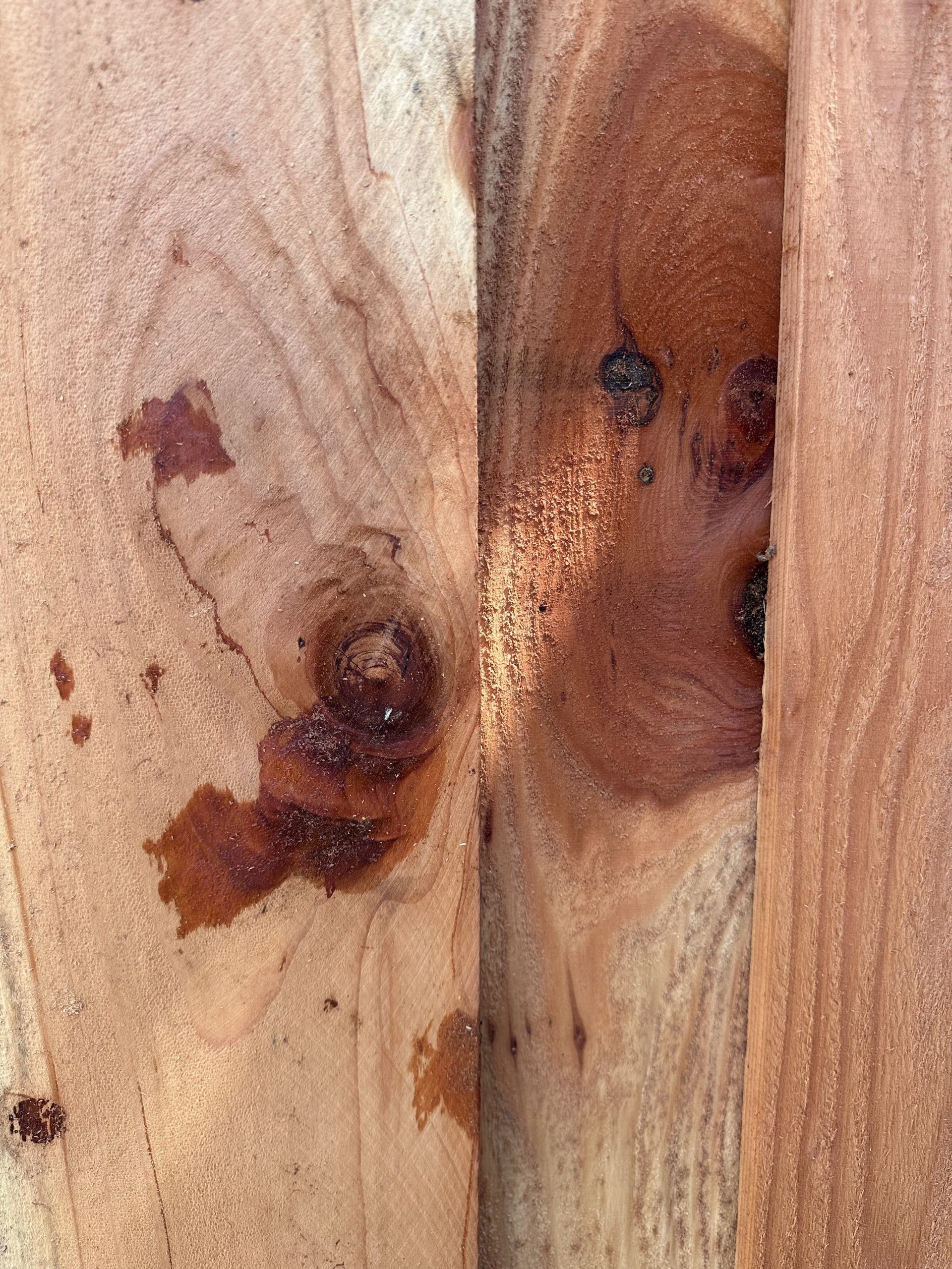

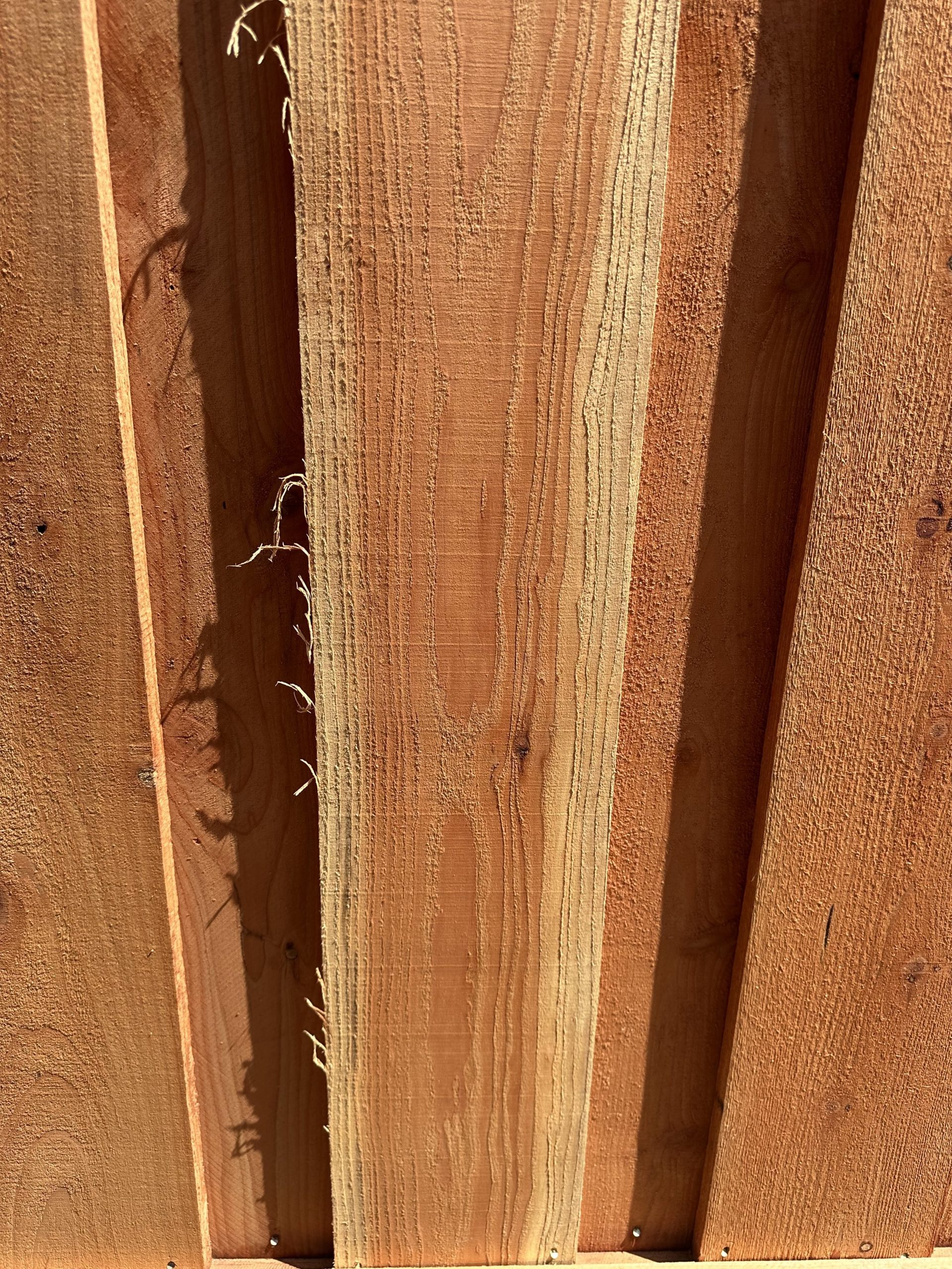

Hi! I read through the comments, but I’m a little confused. We just installed a redwood fence today. We also have pressure-treated posts and rails pine… I think? I think the pickets are rough hewn, because they are DEFINITELY not smooth. However, when installing it, moisture was bleeding out of every screw-hole, so it is definitely wet. I also want to preserve the life of my fence, and I love deep red redwoods… but this wood is surprisingly light. 🙁 Can you recommend a drying time, product, and color? (It must be a stain. We aren’t allowed to paint in our HOA.) Also, easy application is important to me as my last staining project (a chair) was not uniform AT ALL and it really disappointed me. (So obviously I’m not great at this.) Please see attached picture. I live in the San Joaquin Valley, and spring is pretty much here!
Please send a closeup pic of the wood planks.
