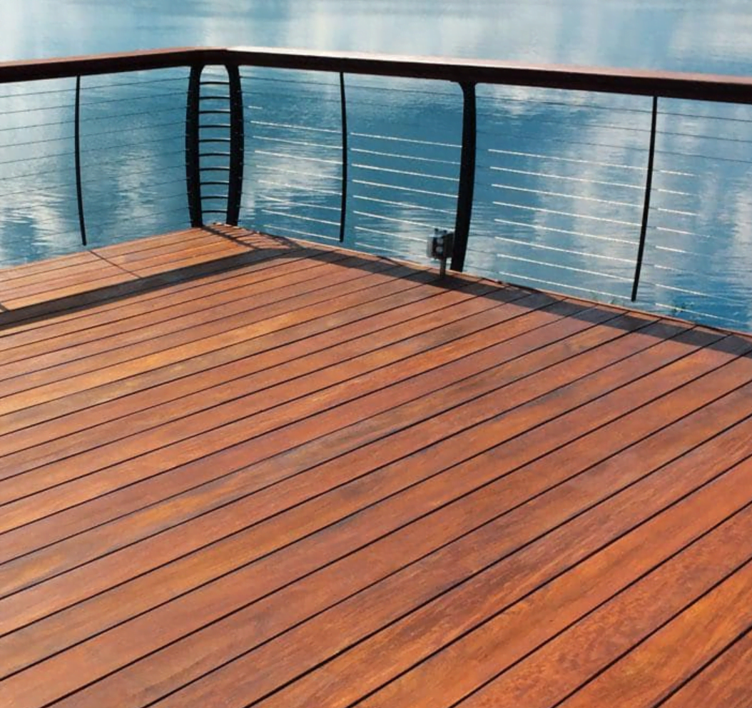

4. No, you cannot get redwood to look like IPE.

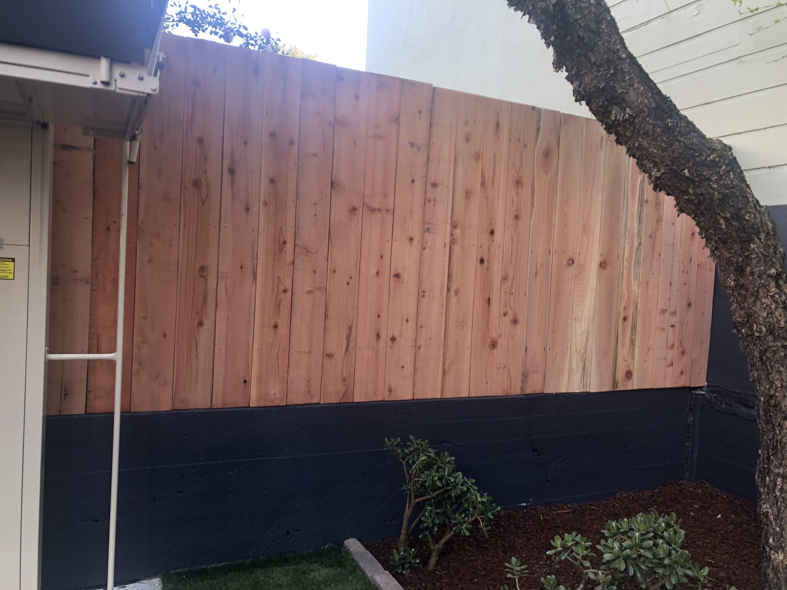

I would like to even out the colors of a. Redwood sided wall. The 2 or 3 lower planks were hit with water. Will just staining the lower portion only work?
You cannot spot-fix the bottom boards and have it all match. You would have to do the entire wall. Strip it all down and stain it all. This would be the only way to get it to match evenly.

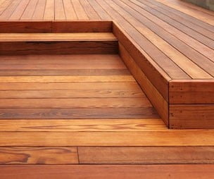

What stain was used in the photo above in the article? I tested out Valspar Redwood semi-transparent and I’m losing all of the variations between the natural colors and want the more natural look shown. Thank you!
Valspar is a very poor stain, we would never use it: https://www.deckstainhelp.com/valspar-one-coat-stain-sealer-review/
The picture of the redwood above has no stain on it.

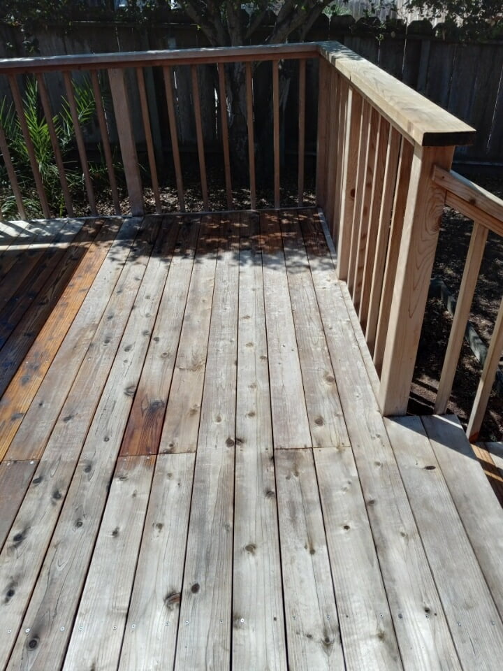

My redwood deck is about 1 year old. We are in San Francisco, California and it gets full sun in mild temperatures most of the time, although we get fog in summer months. It was coated with Preserva clear penetrating oil and sealer and has turned gray. (See photos). I believe the sealer has worn off because water does not bead. The plan is to use a cleaner and power wash (hoping not to have to strip or sand), use a brightener and then reseal with a transparent redwood tinted sealer. I was planning on using Penofin Red Label but then read too many reviews about mildew and darkening. Do you agree we don’t have to strip and what products would you recommend for cleaning, brightening and sealing. Thanks!
You need to strip and brighten. Do not use Penofin. Try Restore A Deck Prep kits and their stain or Armstrong Clark Stains.

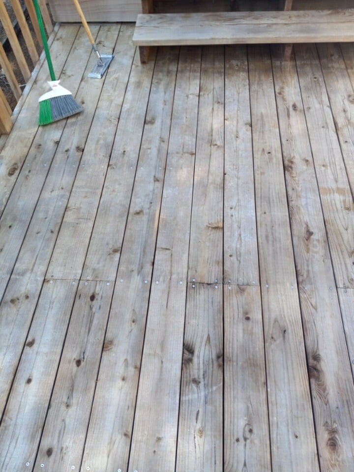

Unfortunately, the the cleaner i used contained bleach and was nearly two weeks ago. Is it to late to use a brightener and should I sand or buff the fuzzies before or after the brightener?

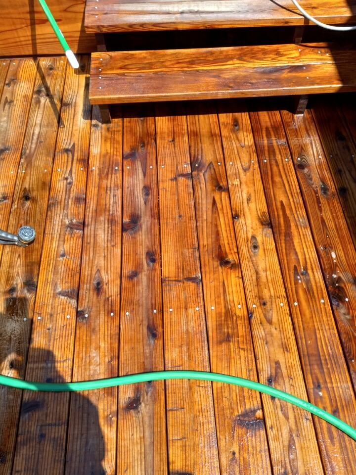

Post a picture of the prep so far.
Installed new redwood deck 1 year ago. Due to medical reasons had to wait until now to prep and stain. A local paint store that was recommended by a very respected painter gave me a wood cleaner in 21/2 gallon containers with what appears to be self labeled as FLD51/S2 Flood Wood Cleaner and has a manufacturers label on the back that says Premium Olympic Wood Cleaner. I followed the instructions by covering liberally with a pump sprayer,waiting 10 min. then using a pressure washer.The result is that the wood now has no natural color and ugly brown and. light to darker grey streaks and blotches with widespread fuzzies.I would like to stain now with a Armstrong Clark semi transparent stain but am afraid of what the result may be. Can you HELP?
Posting pictures on behalf of Jim S
Try a wood brightener first before staining with the AC. See here if you want to remove the fuzzies: https://www.deckstainhelp.com/wood-fuzzies-furring-on-deck/
the pics below show what it looked like wet and then what it looked like (bleached out with various greys and brown streaks and blotches)when dry. pics sent by Eric s

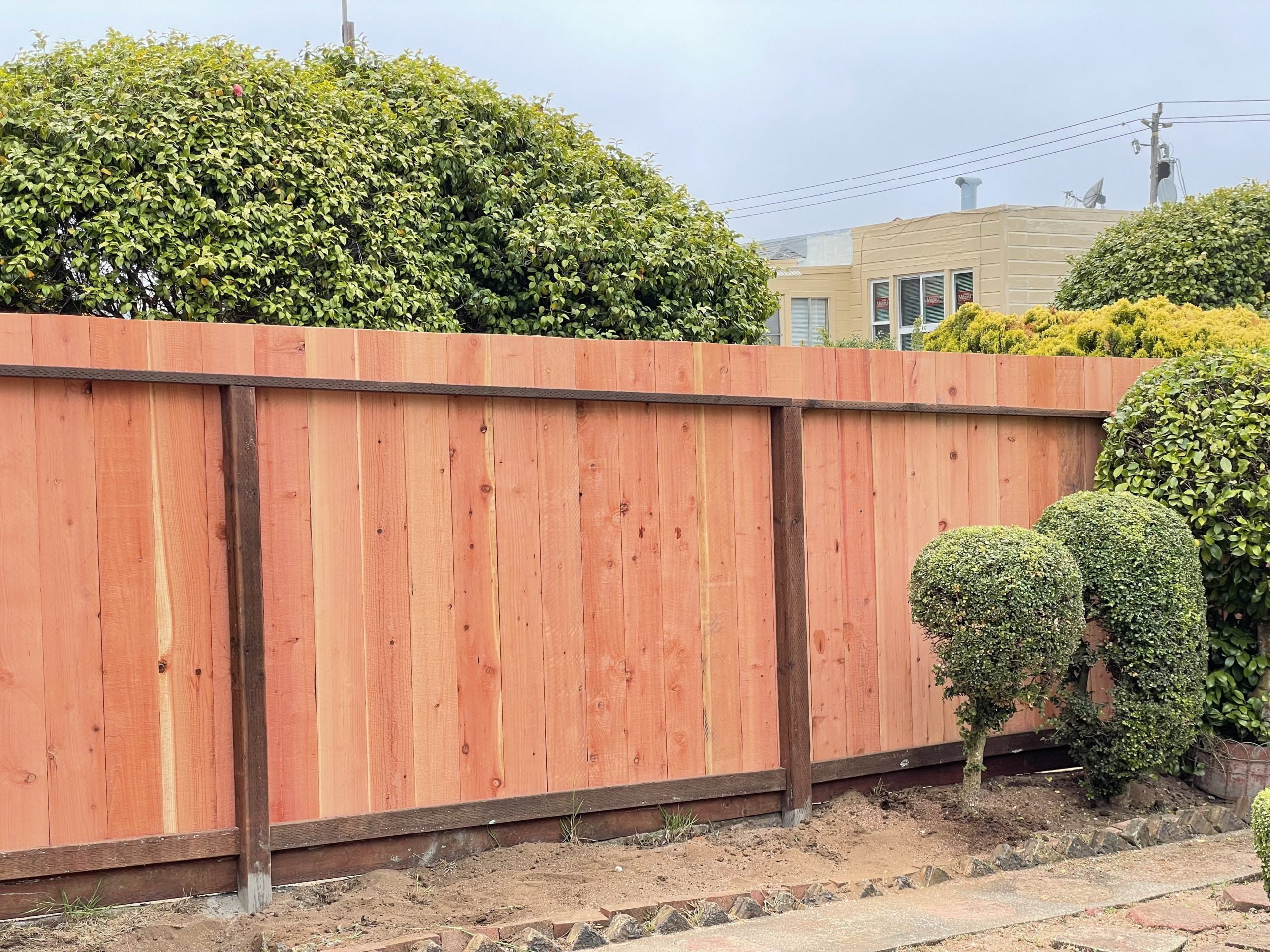

Hi there, I just installed the new fences, may I ask for your opinion, do I need to stained for the Redwood
You will need to stain this after a few months of weathering and prep. Try TWP Stains or Armstrong Clark.

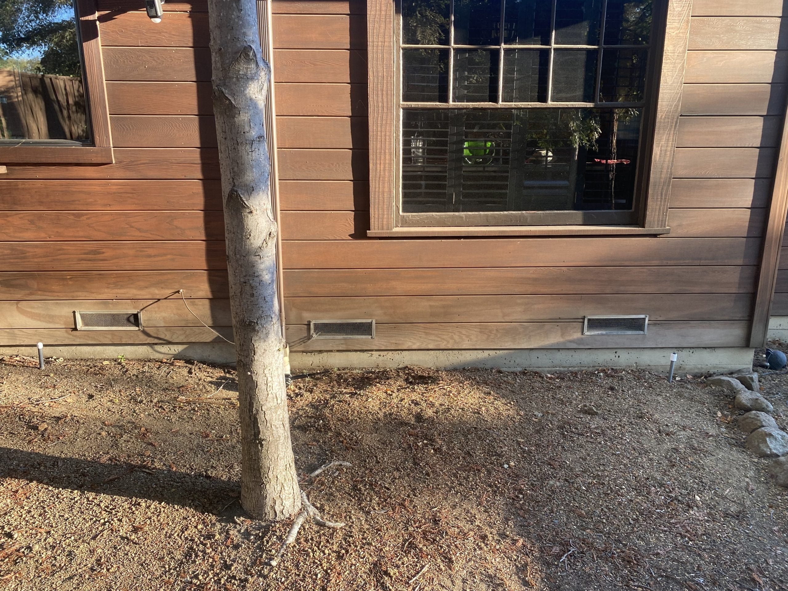

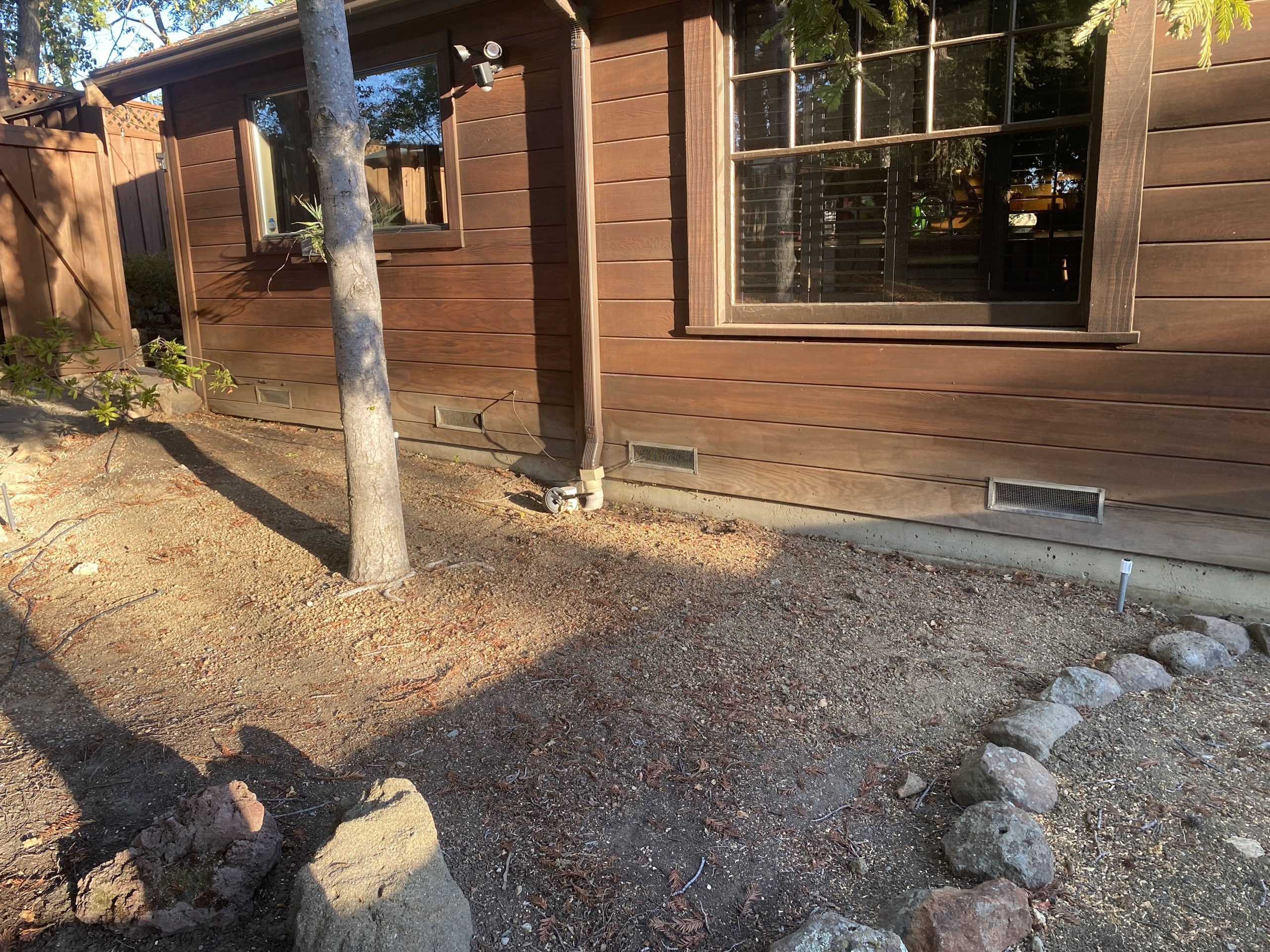

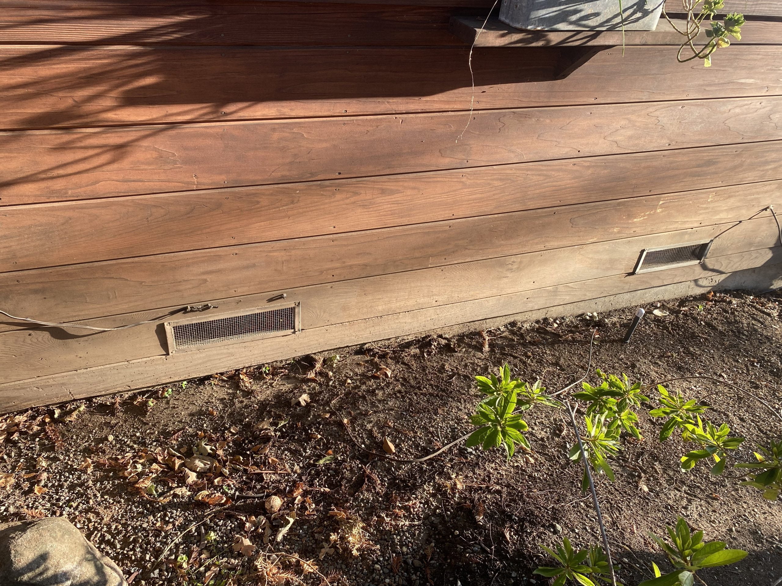

We have redwood siding on our home that has been there 30+ years. We have stained it every few years, sanded a couple times. It is uniformly brown/red. We’re now replacing sections after putting in new windows and doors, The only redwood we’ve been able to purchase has a lot of yellow in it, some really large areas and it doesn’t look good with the existing wood. Any suggestions on how to stain it so that it matches. Maybe staining the yellow section first allowing to dry, then staining the whole plank?
Thank you.l
No, that would not work. Best to remove all prior coatings and start over from scratch.

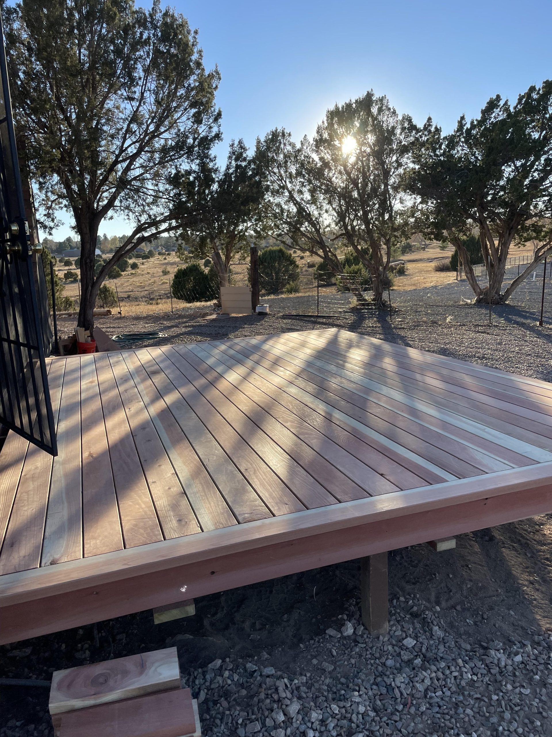

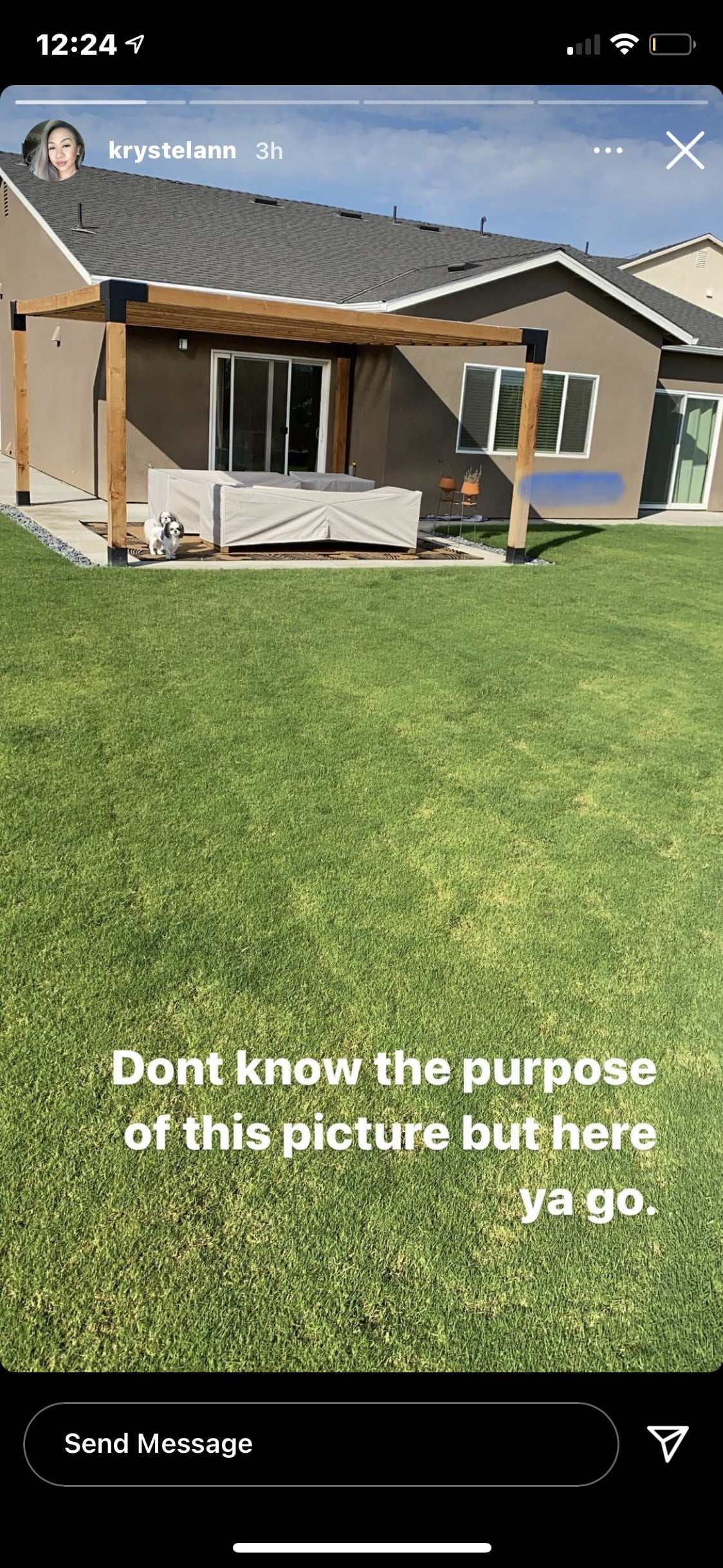

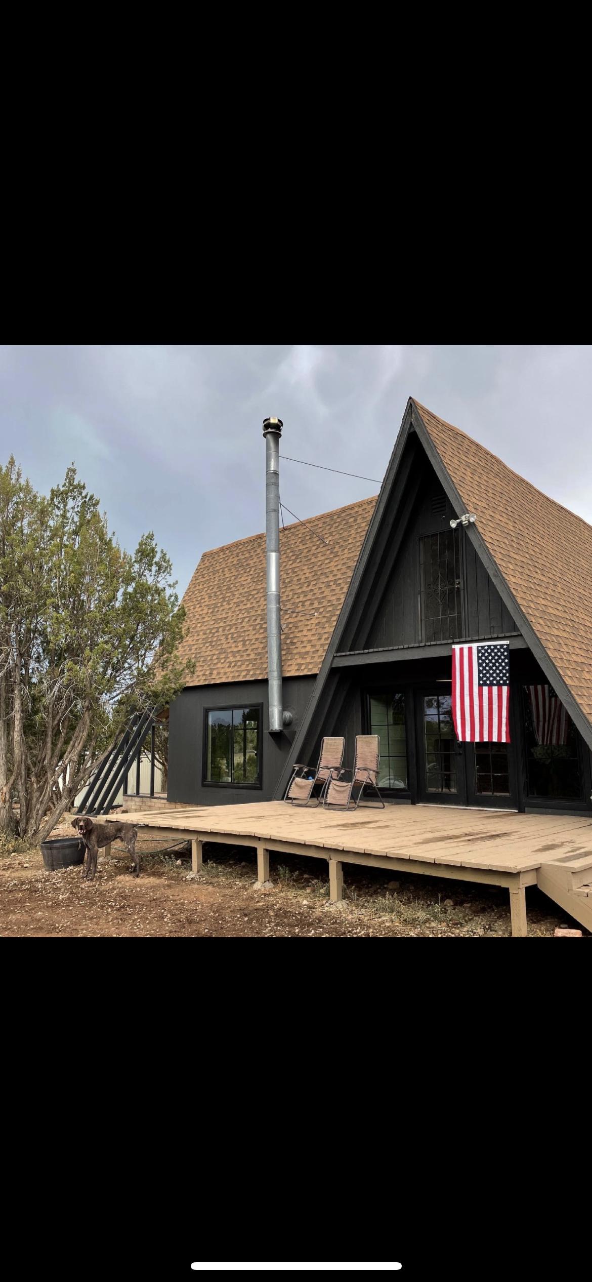

Hello! I too do not want a “red” redwood deck. Our cabin in northern Arizona a is painted a dark gray color and our roof shingles are brown. I would like a tint that means more towards a light to medium brown with gold undertones vs red – without leaning too much into the yellow. A neutral brown would be ideal.
I attached a picture of our cabin (this is not the deck we are staining, this one we used Cabot deck correct on until we can replace the whole deck) showing the gray paint and brown from the roofing, and also pictures of the color tone I’m looking for. The last 2 pictures are of sherwin Williams stain in woodridge (the fence photo is that color stain on cedar) – I don’t want to use sherwin Williams though, so looking for a stain that will help my redwood deck achieve that more golden brown color. Any recommendations?
Final colors vary drastically based on the wood type, age, and stain color chosen. Best to test samples. Look at colors from Armstrong Clark and Restore-A-Deck stains.
Is the deck new? You cannot stain new wood right away.
It’s just under a year old. We had to wait out the winter, and then my husband had back surgery so we are just getting to staining it now. We are going to use an oil based stain, is there anything that I should be looking for that would minimize the red tones? All the samples i’ve tested so far still end up very very red, or a lot darker than I thought they would. I was wondering if I first started with maybe a light green semi transparent, would that cancel out the redness, and I could then layer on another color? Or if you’re going to mix, does it have to be all mixed into one stain rather than layering? I would be mixing or layering with the same brand and type. Attached is a photo of the deck when it was brand new, my husband is working on cleaning and brightening while I’m agonizing over choosing a stain.
No, you cannot do two different colors, and semi-transparent colors do not come in green. You will need to look at brown tones to minimize the natural red tone in your wood, but it is not possible to get a light brown, as shown in your pictures. They would be more of a medium to dark brown.
