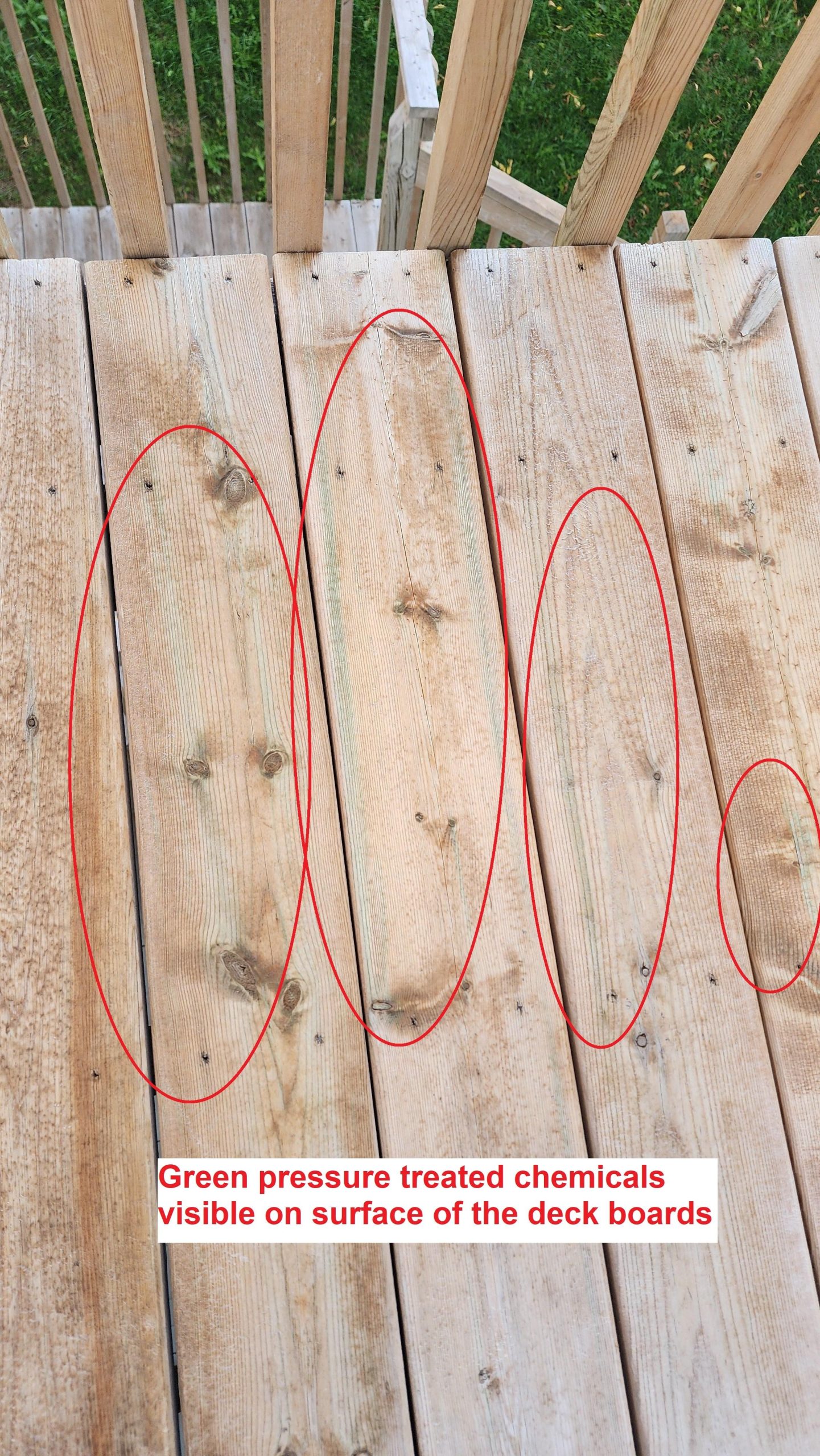

I have two 15-year-old pressure-treated decks, and 90% of the wood for both decks was replaced about four years ago with newer pressure-treated wood from Home Depot, although I’m unsure of the exact type of wood used as replacement. The posts, ledger boards, joists, beams, and rim boards are original, while the rest is newer. I live in Ontario, Canada, where we deal with cold winters and wet rainy seasons.
The deck has never been cleaned or stained, so it became grey with some green spots. My wife saw a TikTok video recommending a 1:1 mix of pool chlorine shock and water for cleaning. I applied it with a pump sprayer, waited 15–20 minutes, then thoroughly rinsed with a garden hose. I didn’t scrub, but now the deck looks bleached white with a fuzzy top layer, and I even suffered some chemical burns during the process. Unfortunately, I didn’t know a neutralizer was needed afterward, as I’m unfamiliar with deck maintenance.
Here’s my question: Should I start over by cleaning and neutralizing with a kit like Restore-A-Deck and using a hard bristle brush, followed by sanding with 80-grit to remove the fuzz? Or should I sand first to get rid of the fuzz, then clean and neutralize before staining with a semi-transparent oil-based stain? I’m concerned that if I sand first, the cleaning process might bring the fuzz back, requiring multiple rounds of sanding, which I want to avoid. Additionally, with Ontario’s rainy season approaching, my fear is if I finish sanding after cleaning or sanding prior to cleaning (which ever you recommend), how much time do I for the wood pores to stay open before I start the staining process? So what if I finish sanding, and it rains for an entire week, do I have to sand again or clean/neutralize again prior to staining???
Lastly, because the deck is pressure-treated, there are still visible remnants of green chemicals on the wood surface. If I use a natural wood-colored semi-transparent oil stain, will those green areas show through? Also which oil based stain brand would you recommend for this specific job? Sorry for the long message, but this process has become quite confusing and overwhelming for me.
Yes, redo the prep with the RAD Kit. If needed, buff off the furring after the cleaning and before the brightener:
You can just wait until Spring if concerned about the weather. The green will show through. You cannot do anything about that. It is minor in your pictures so not that big of a deal.

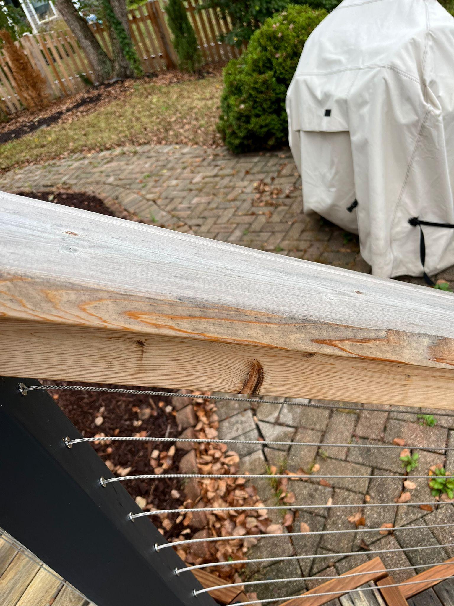

Hi, I installed my cedar railings back in April 2024 and stained with Ready Seal Clear stain. There was an unexpected rain started 1-2 hours after I applied the stain which I was worried about. Seemed like the rain washed off the stain but it looked well when it’s dry. It was ok for the first 1-2 months but after some time I started to see some black spots then it got worse over time (please see the current status in the photos). There is no problem on the lower side of the railings though.
Now I’m planning to remove this mold/mildew then reapply a light coat of a Ready Seal. Should I use this RAD cleaner kit for this purpose or RAD Guard Mildew Cleaner & Preventer ? or any other suggestion for removing mold, prep and seal in my case?
Thanks in advance!!
Prep with the RAD Cleaner and Brightener if you plan on sticking with the Ready Seal. If you want a better stain, then prep with the RAD Stripper and Brightener kit and switch to the RAD Stains or TWP Stains.

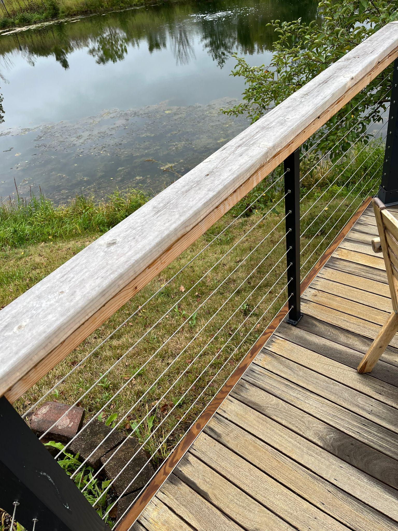

These are pictures of a 15 year old deck in northern WI. The light colored boards were pressured washed (took way to much time) and the darker boards are what I’m dealing with. It is pressure treated lumber but it’s never been stained or painted. Will Restore-A-Deck and a pressure sprayer clean the layer/years of dirt and mildew?
Yes, it will help. Make sure to brighten when done.
