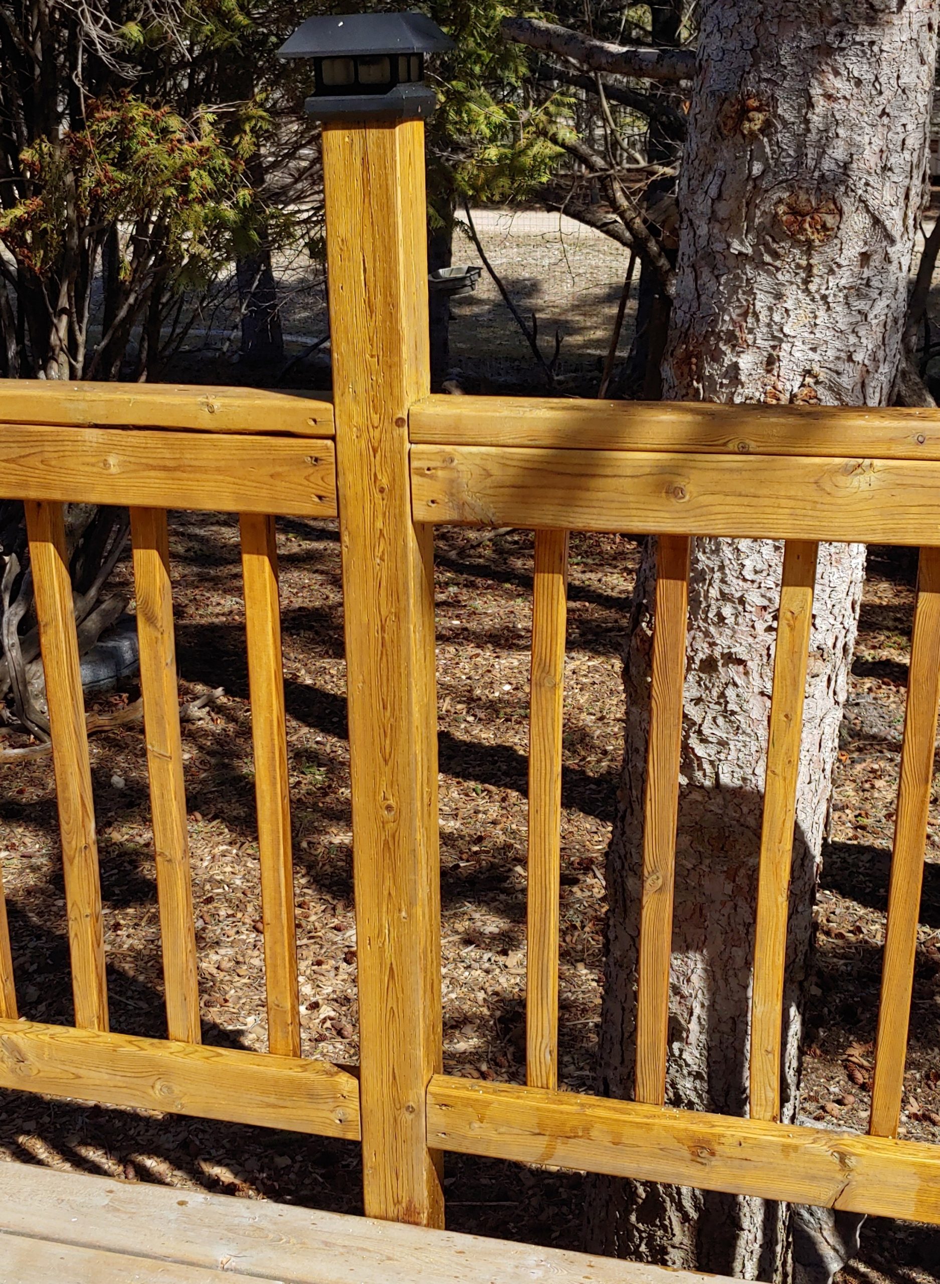

Blotchy deck stain application
If the air temperature is too cold, deck stains might not properly cure. When the air temperature is too hot, stains might dry too quickly or evaporate before properly absorbing into the wood. Keep in mind that direct sunlight can also make the wood’s surface temperature too hot and cause the same problems.
