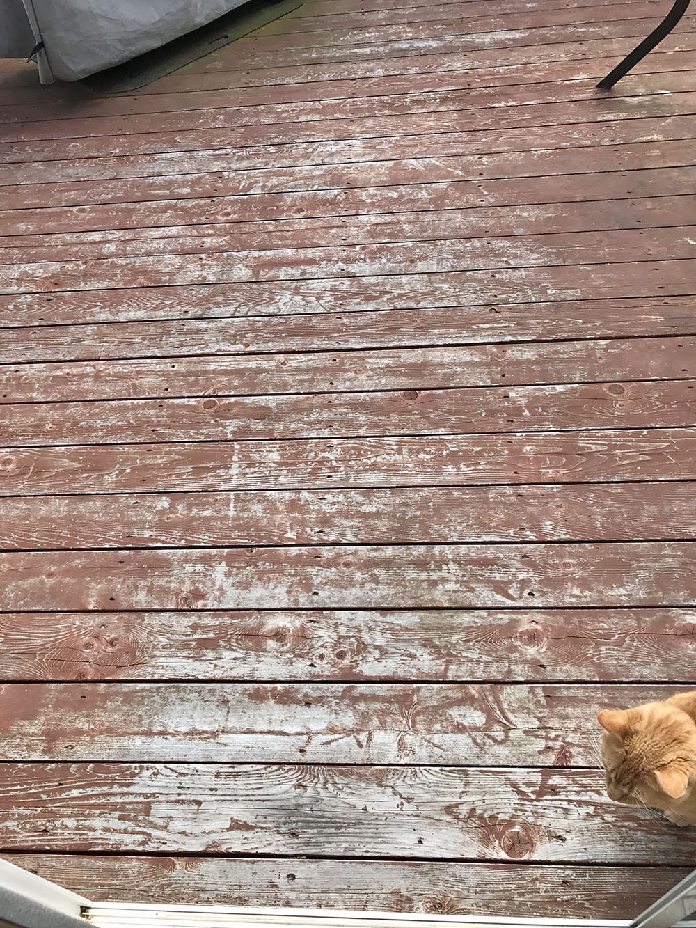

Sorry, images were too big. Please see attached for question about cedar deck stained with TWP 1500.
Hi. Had a cedar deck built in Aug 2013. Following summer, we sanded, power washed and let dry over night before sealing it. I used TWP 1500 based on your review. Going to clean and restain/protect it but not sure if I should use TWP again. Initially, the stain didn’t seem to absorb equally (some spots were a lot lighter than others). The high-traffic area has worn very badly and we have some mold around where the BBQ pit pad is (see attached pics). Do you recommend going w/ the same line or something else? If so, what steps should I take? If no, do I need to strip the TWP off? I’ve read some good reviews about Sikkens but don’t see it on your site, how does it compare? Thanks for the suggestions!
Location: St. Louis, south facing. Extreme weather here: Lots of moisture/humidity, sun and heat, rain and snow.
Go with the same TWP again. A couple of notes though:
-TWP suggests only 1 coat on new wood and then a second coat 12-18 months after the first coat. I think you missed this? The reason is new wood is not very absorbent the first time staining.
-TWP needs to be reapplied every 2-3 years going forward.
-Prep with the Restore A Deck Stripper and Brightener kit for this. It is an easy prep.
-Sikkens is reviewed on our site. TWP is a superior stain.
