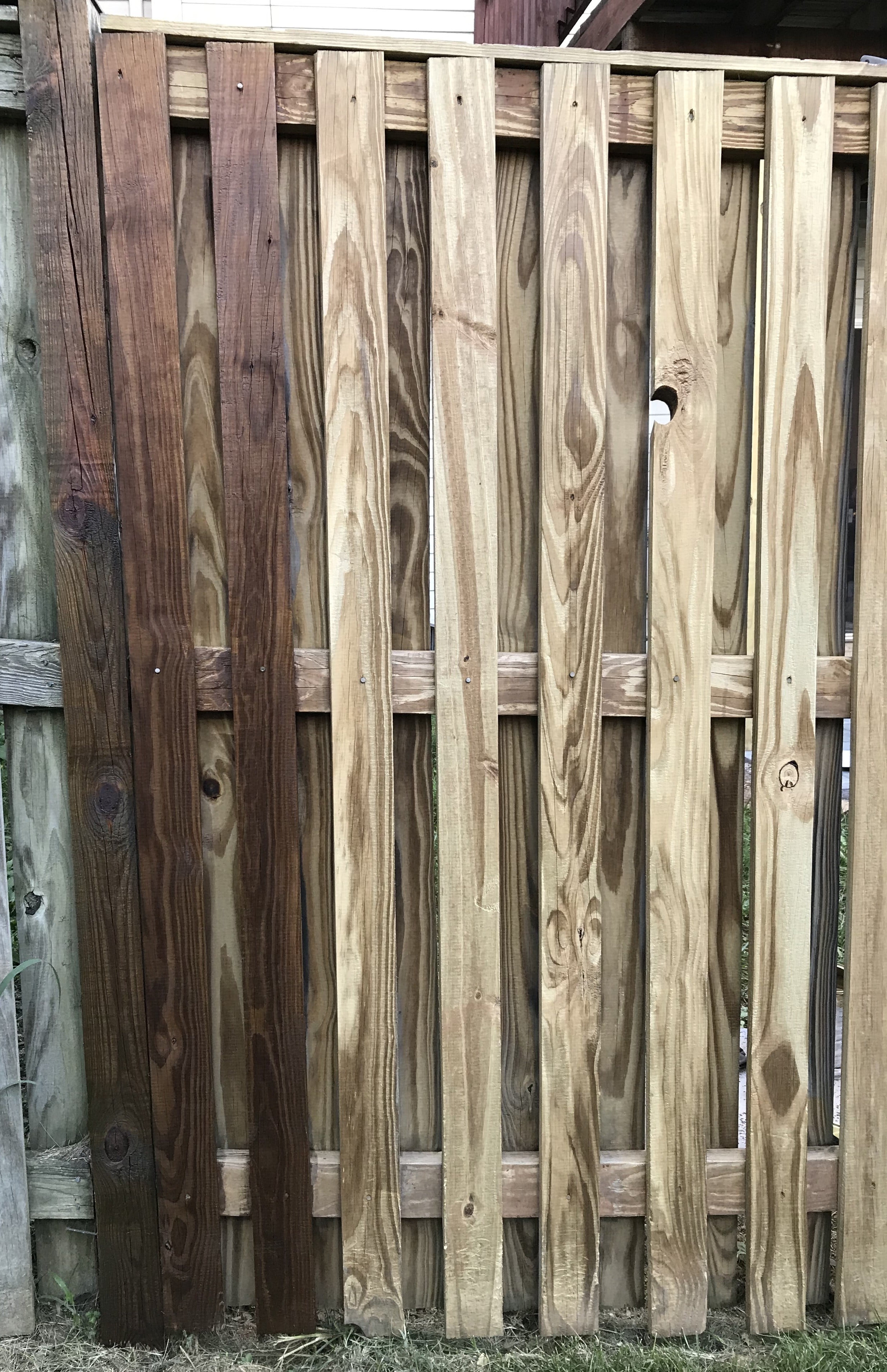

I received a can labeled 1501 Cedartone, but it looks like 1503 Dark Oak on my PT fence. Did I receive a mislabeled can or is this due to high absorption rate and age of my fence? The stain itself in the can looks dark.
Pictures attached
That is a result of your age of the wood and absorption rate.

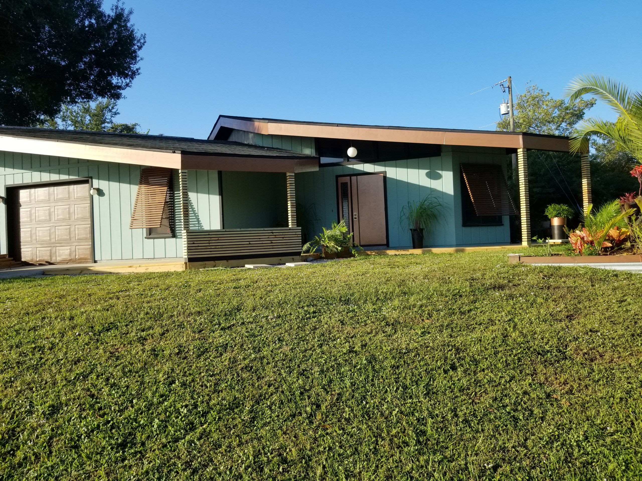

We live 3 miles off the Gulf in southern Florida. One month ago we installed a pressure and kiln dried pine deck using 2×6 boards and just this week we finished a planter box and slat wrapped posts. We are now officially out of the rainy season but high humidity is almost always a factor. Our UV is rarely under an 8 so sun bleaching is a concern as is mold and mildew growth in shady areas.
With that said, how long should we wait before sanding and prepping and what stain do you recommend that will give us our best shot at achieving a medium cedar tone (similar to the color of our window rainscreens), color retention and mold and mildew prevention? Are clear coats ever recommended?
Also, we will soon be refacing the entrance of our house (location gets minimal exposure) with cedar cladding. What do you recommend we use there considering we would like to achieve a close color match and when should it be applied?
Try the TWP 1501 Cedartone color. Clean and brighten the wood for prep. Just one coat of the TWP. You can use the same for the cedar cladding.

I just stained my deck with TWP 1500, rustic color. The rails are quite old, and the floor is a few years old. I cleaned and brightened everything well with Deck Restore before staining. The rails came out a warm brown, the floor is definitely reddish. Why two colors? If I put another coat on the rails, will it help the color match?
The difference in color is based on the wood age. Older wood is much more absorbent. Adding another coat should help some but it will still be slightly different.

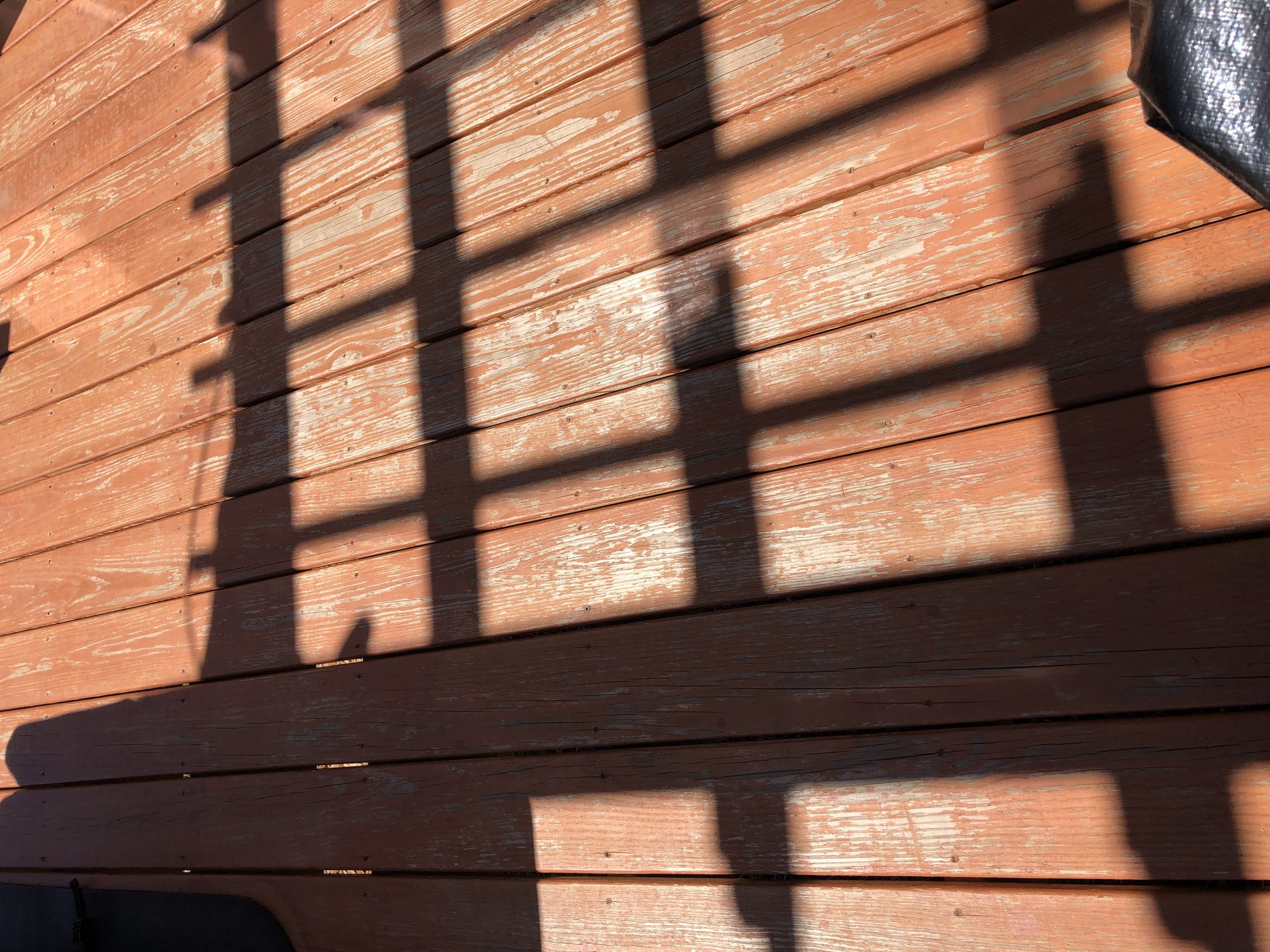

We Need Help…we have a cedar deck…23 years old. we live in Michigan. It has been stained over the years with a semi-solid stain and now we stain with a solid stain. We have always used a Behr product and recently (when we replaced some of the boards, the stain has been bubbling and peeling. 3-4 years ago we had some boards replaced that were rotting we let the new boards weather a year then used a deck prep product before reapplying new stain. All the the new deck boards peeled. The next year we sanded them and reapplied….same issue…the boards peeled. Almost all of the older boards retained the stain. We have a new round of new boards and want to know what to do. Should we restain the whole deck again? or just the new peeling boards? Let the new boards weather again? It didn’t seem to make a difference. The stain is coming off in strips. Please recommend!
The only way to fix this is to sand all off, 100% of the current stain so you are left with bare wood. Once this is done, lightly wash with a deck cleaner and then use a penetrating wood stain like the TWP.

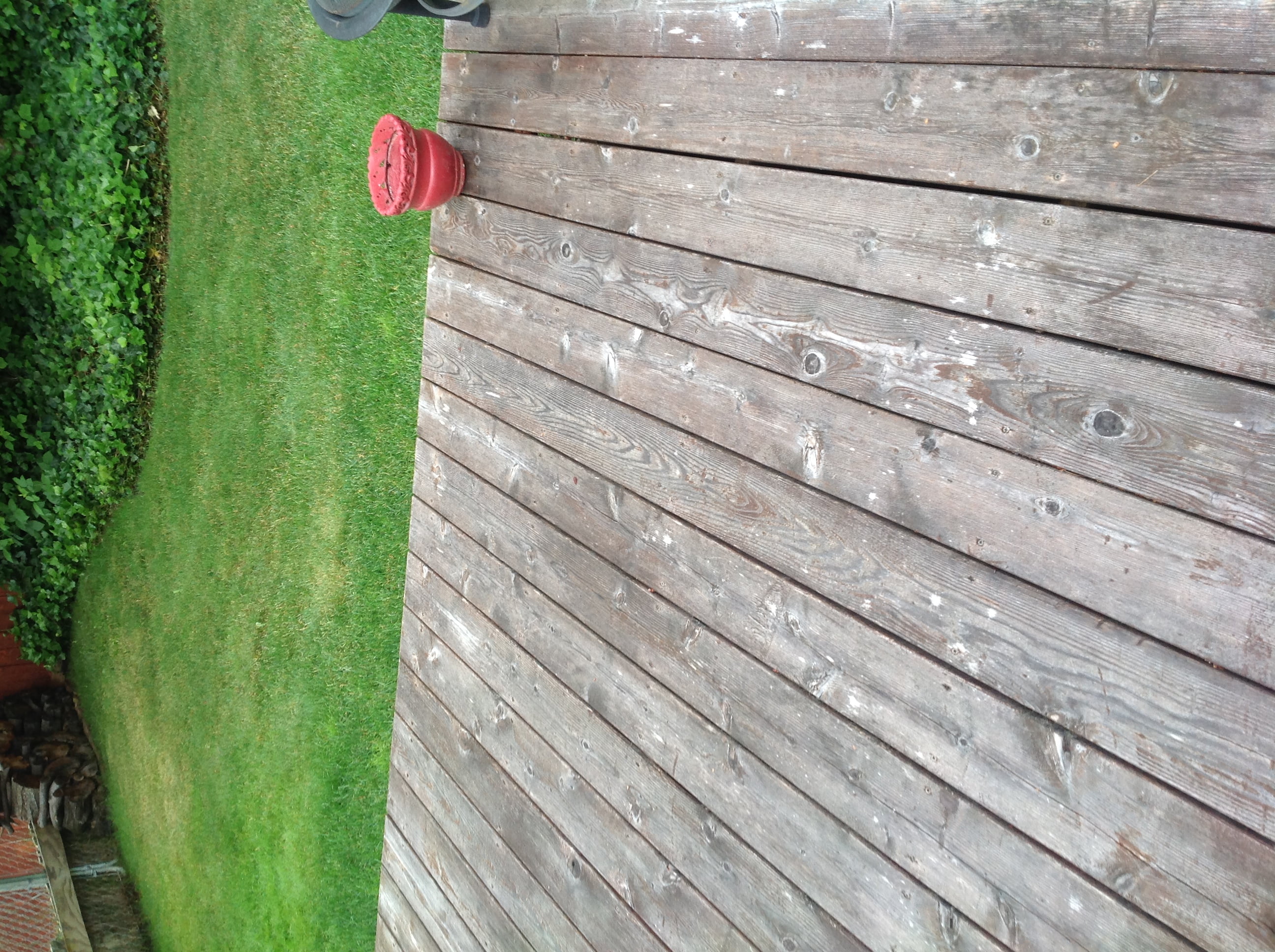

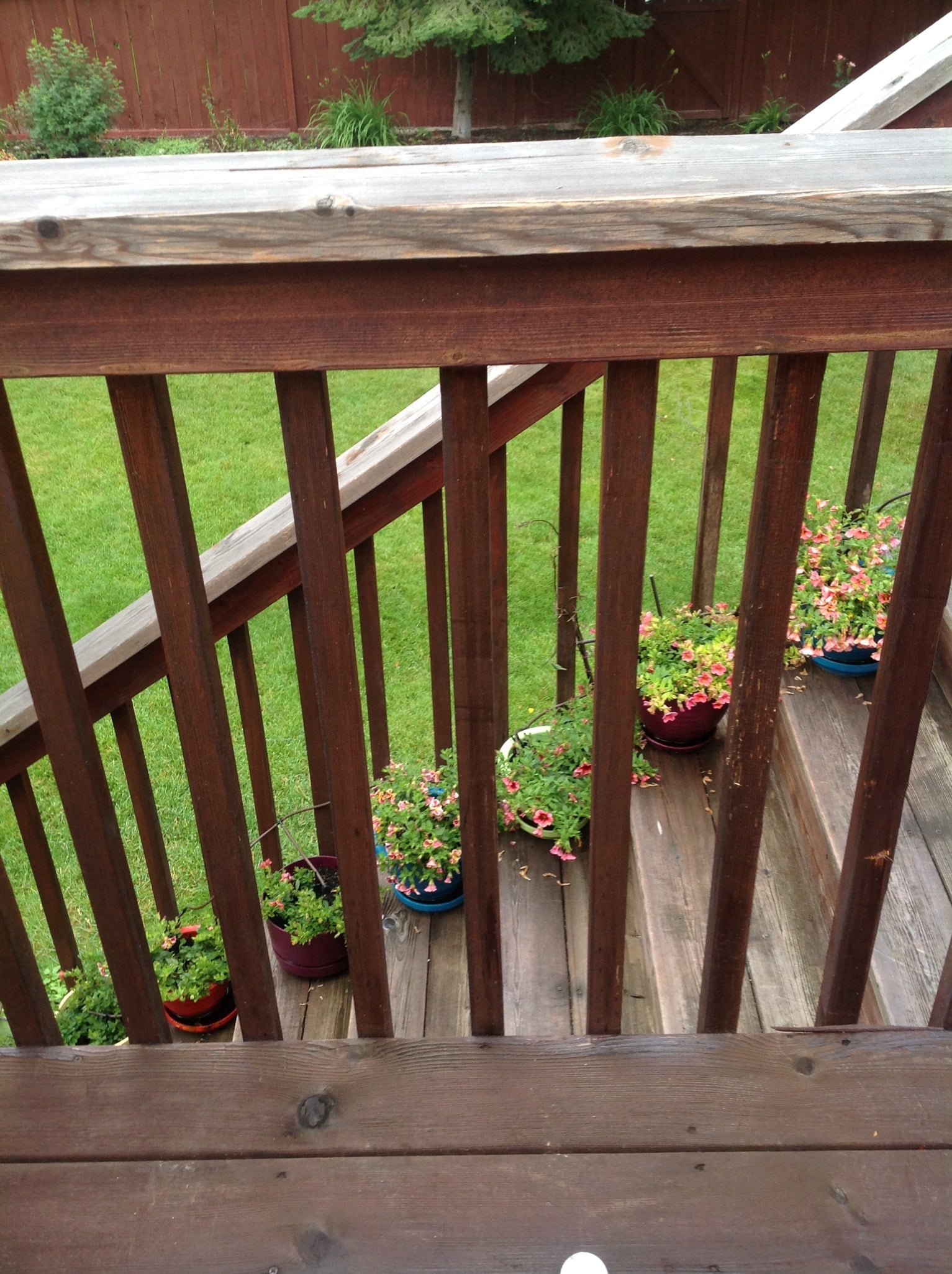

I have an 18 yr old deck/stairs/railing that have been stained over and over thru the years. However we have not stained for about 3 years now. We live in North Idaho so lots of cold weather and snow in winter. What would be best process for prep and restaining? Would TWP 1500 be best? Please tell me I don’t have to figure out how to sand the individual spindles in the deck railing! 😳
Strip and brighten for the prep with the Restore A Deck Products.
The TWP 1500 would work well.

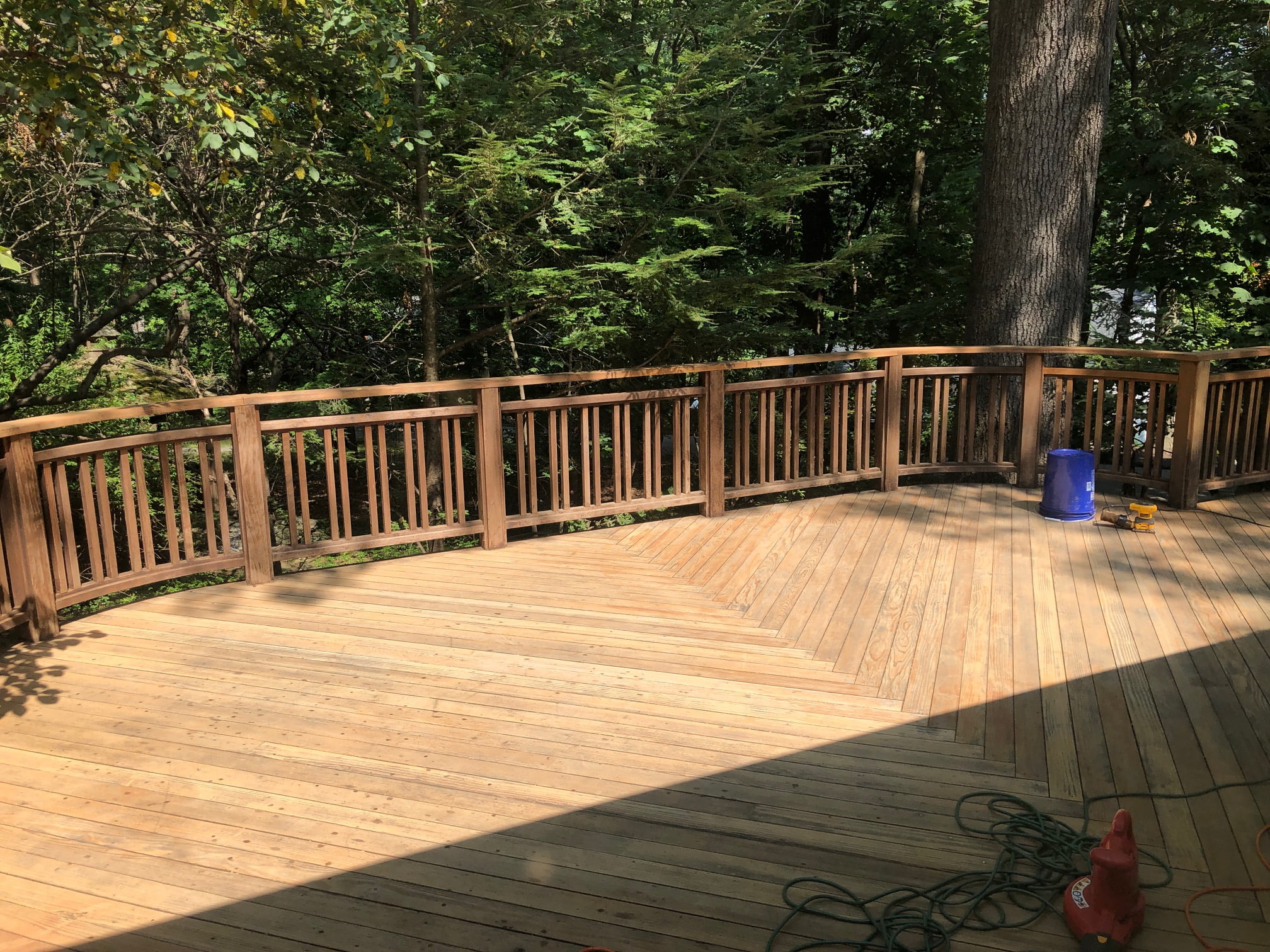

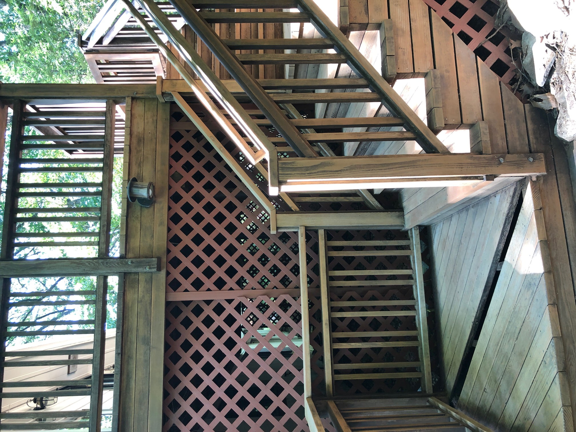

First two are under deck, third is sw exposure. Maine.
Tried to send as reply, don’t think it went through.
You should strip and brighten all wood for the prep. It will remove the old stain and the mildew.

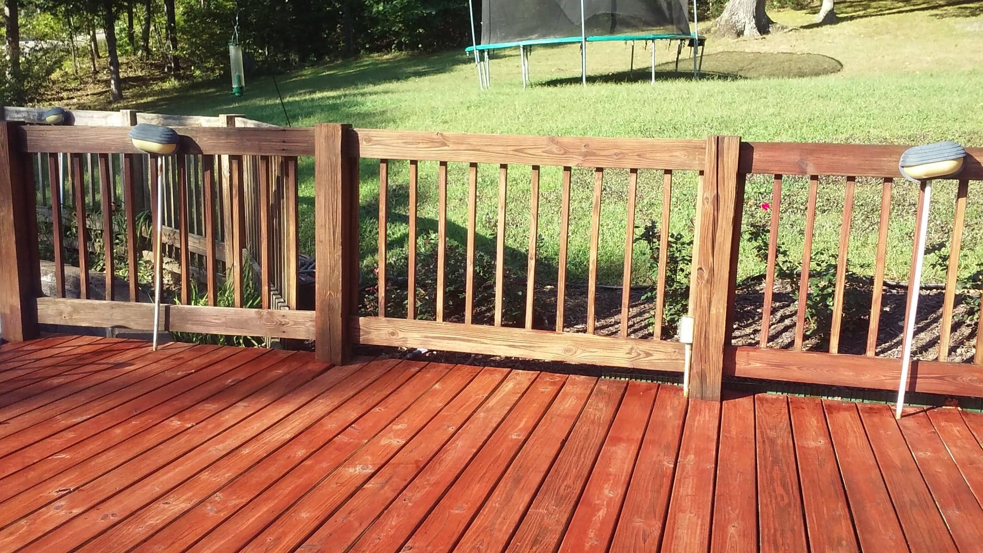

I have a one year old red cedar deck which I stained with TWP 1520 stain 2 coats at installation. I live in Connecticut. It’s still looking pretty good this spring after the winter and water is still beading up on it pretty well but some parts look a bit dried out. I’m wondering if it’s best to wash and put another coat on this spring or if it should be ok until fall or next spring and if washing now what cleaner to use. No mold apparent at this point. Thanks.
Leave as is and do a full restoration next Spring.
Full restoration meaning strip and brighten or Clean and brighten since its TWP?
Clean and brighten then reapply same color and series.
