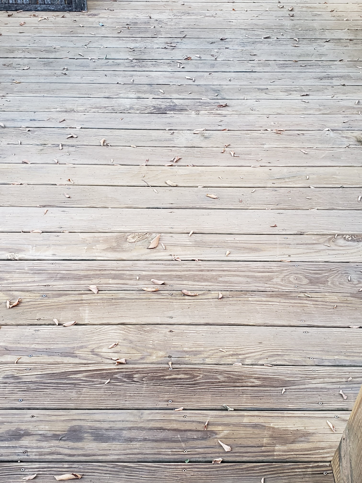

I have a few questions on the staining process on my PT Pine deck. I installed in in early 2019 October and have been letting it weather. I have tried a number of samples from different stain manufacturers and the TWP stain samples should be coming in this week. I wanted to know if i should pressure wash and sand for the stain process or just pressure wash. I also am reading alot about applying wet on wet on PT Pine wood. Can you explain what it means to apply wet on wet and with what tools?
For prep, use a deck cleaner while pressure washing. Brightener after. Only one coat if suing TWP on new wood.

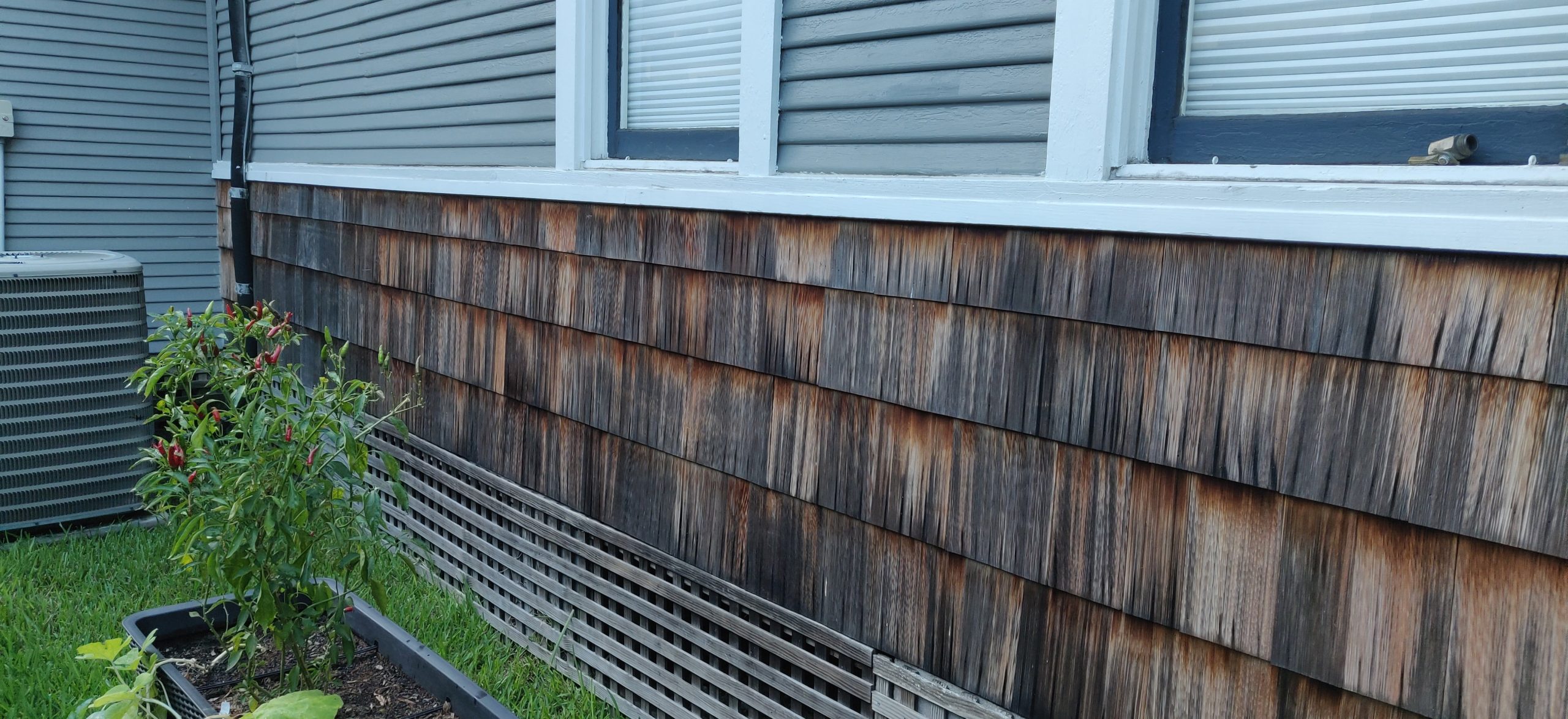

I used the TWP 1520 Pecan on our cedar shake siding (2 coats wet-on-wet after stripping and brightening) and am very happy with the results in Houston, TX!
