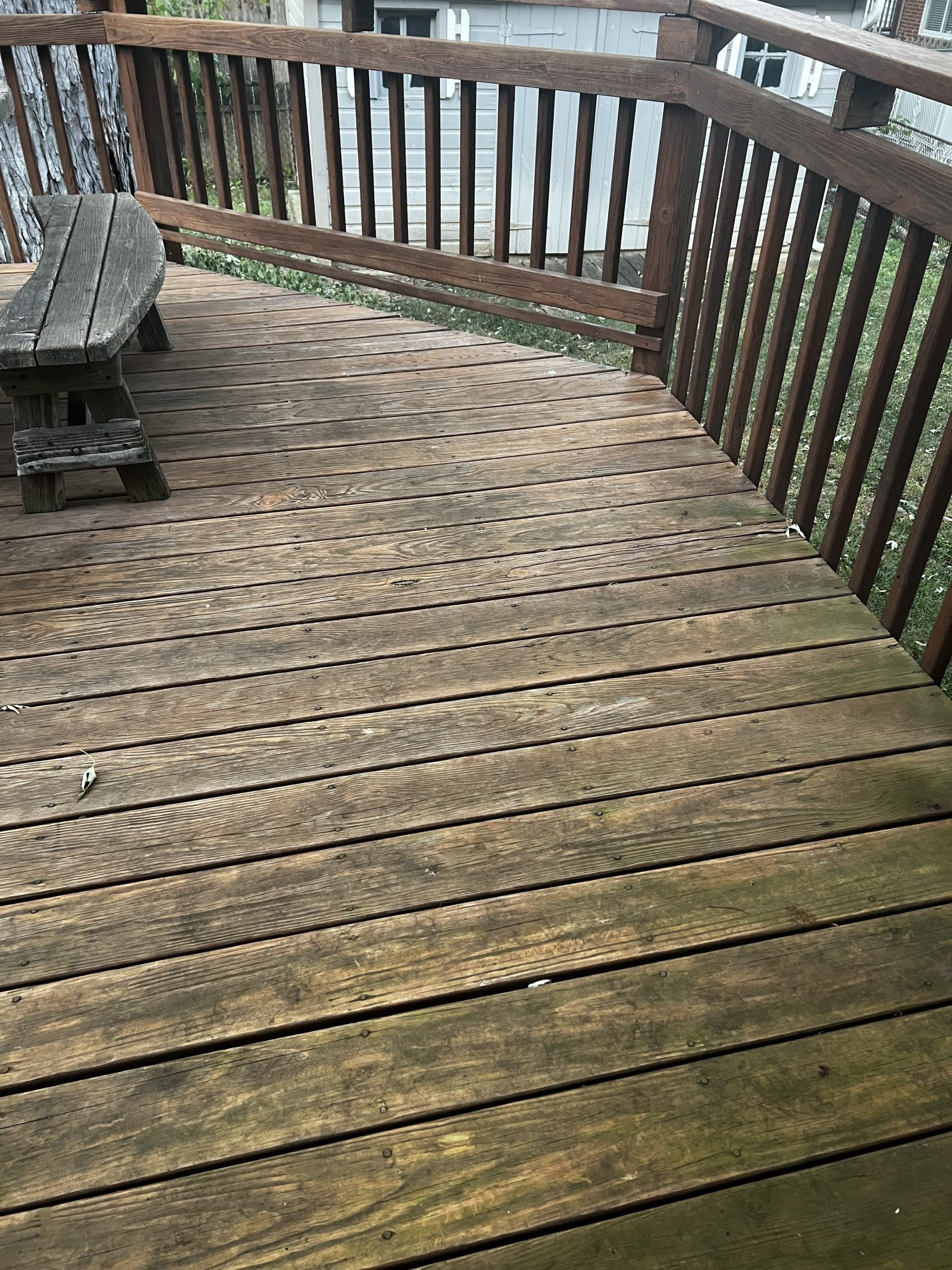

I have a PT wood deck that was built in the 90s. It was in good shape when I bought the home in 2017, and in 2019 hired someone to restain the deck. He sanded it and used a semi-transparent TWP product (mix of cedar tone and rustic). I live in MD (close to DC) and understand that it is no longer available here so assuming it was the 100 series???
In spring of 2022, I had my roof and siding cleaned and the chemicals the company used stripped the stain (ugh). The color is faded and there is no sealant/protectant. Water just pools. Now the wood is really dry, nails are popping up, it has mildew (lots of green) in areas, etc. Basically, it’s badly weathered. The person who stained the deck in 2019 is no longer in business. I have gotten quotes from 2 contractors and they want to sand it and put on Sherwin Wiliams SuperDeck. Based on poor reviews, I prefer not to use it. So, I’m trying to figure out what to do in hopes I can find someone to use what’s best to bring the deck back to life and protect it as well as prep properly. Here are my questions:
  1. What product do you recommend I use? I want to stick with semi-transparent if possible. The deck gets full sun on parts of it at different times of the day and is under a tree. As I mentioned there are areas with mildew. We get all 4 seasons, including hot/humid temps and snow. Should I stick with an oil based and go with TWP 1500 or try Armstrong Clark? Or should I get a waterbased product like RAD?
  2. What prep do you recommend based on the product you recommend?
  3. If I can’t find someone to use the product you recommend, what is the best option that would be available in local stores?
Thanks and greatly appreciate all the info you and your site provides!
Paula
Paula

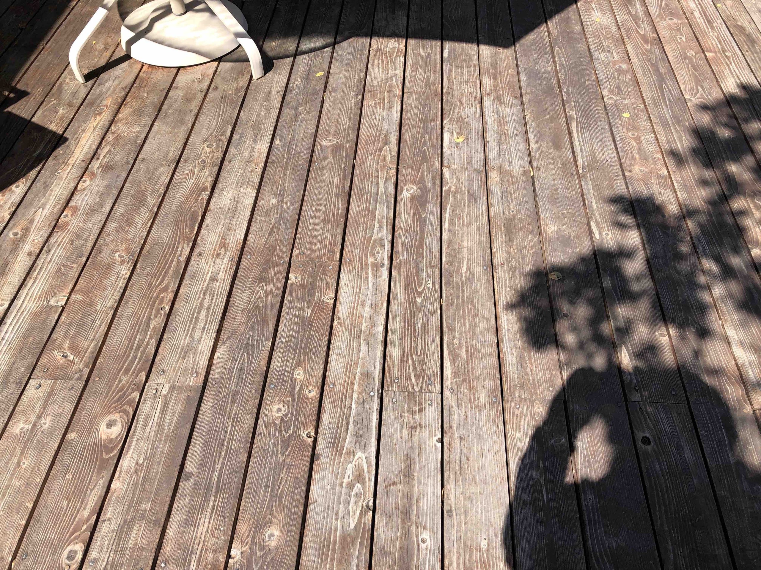

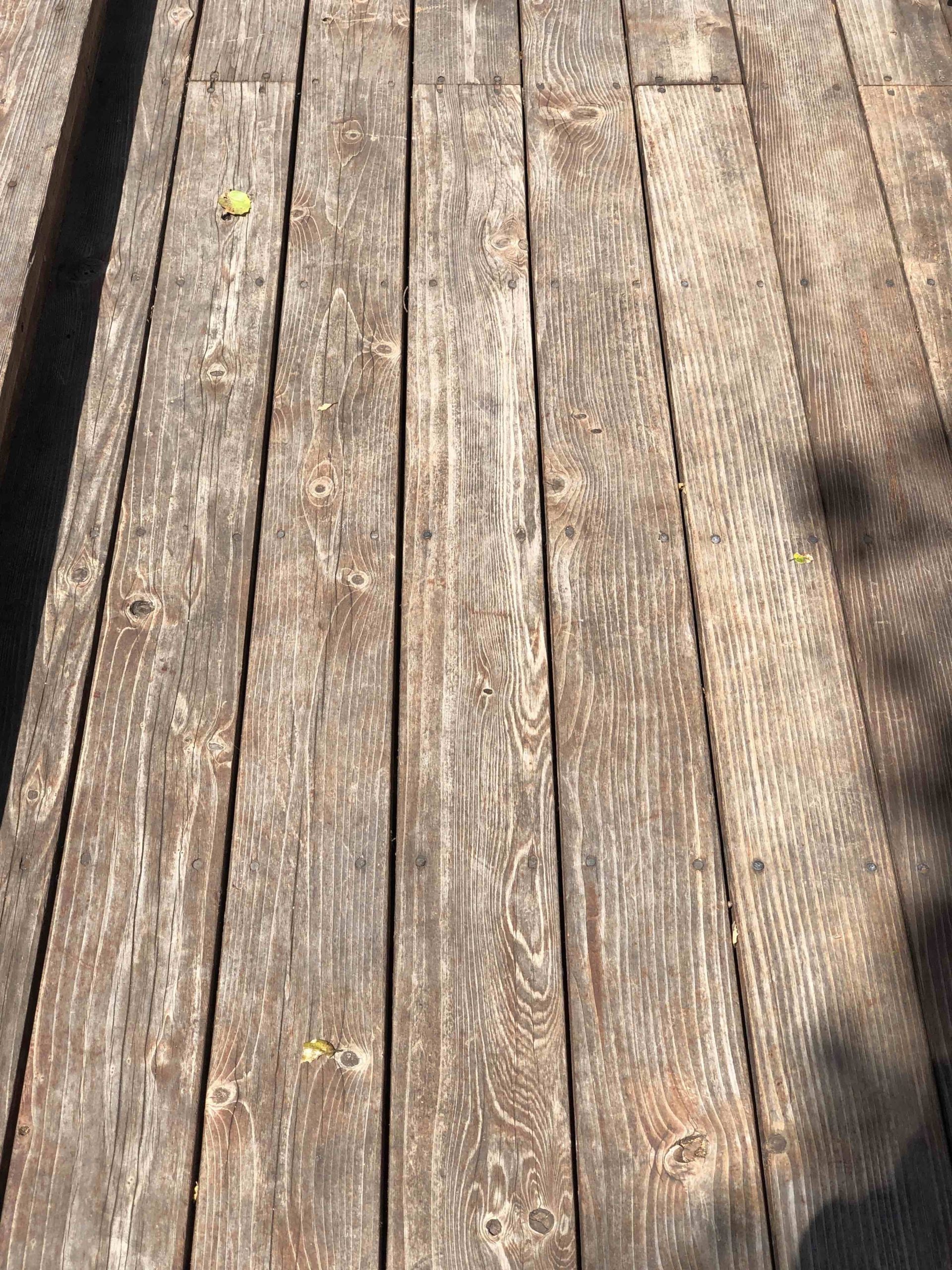

Thank you! Attached are some pics. About the color and prep, I prefer not to go with the same color because it was too reddish. Is it possible to change to pecan or the black walnut for a more brownish tone? What do you suggest colorwise and also prep if possible to change the color?

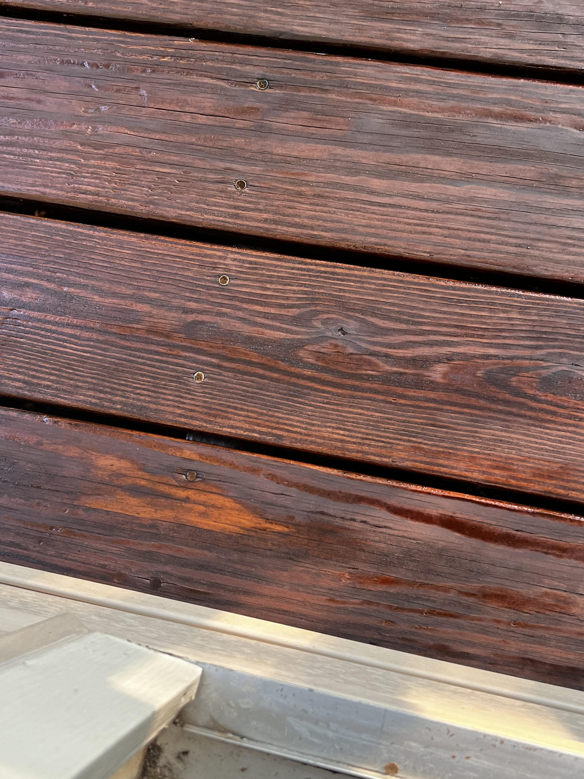

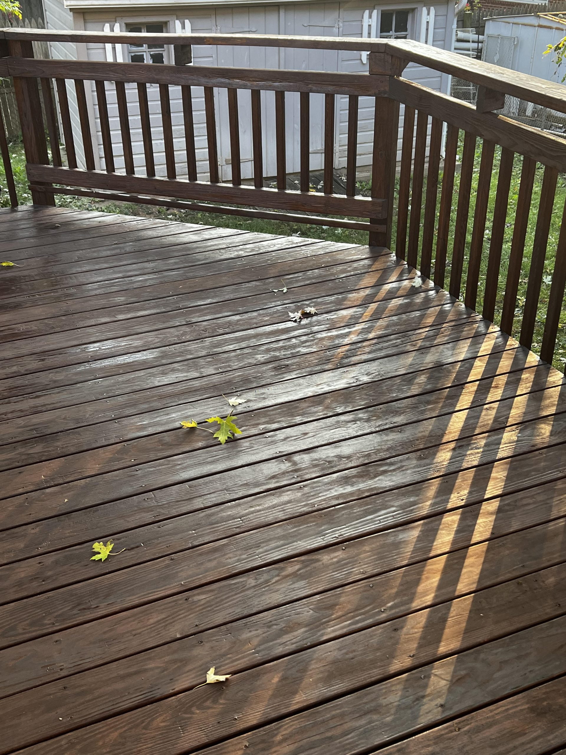

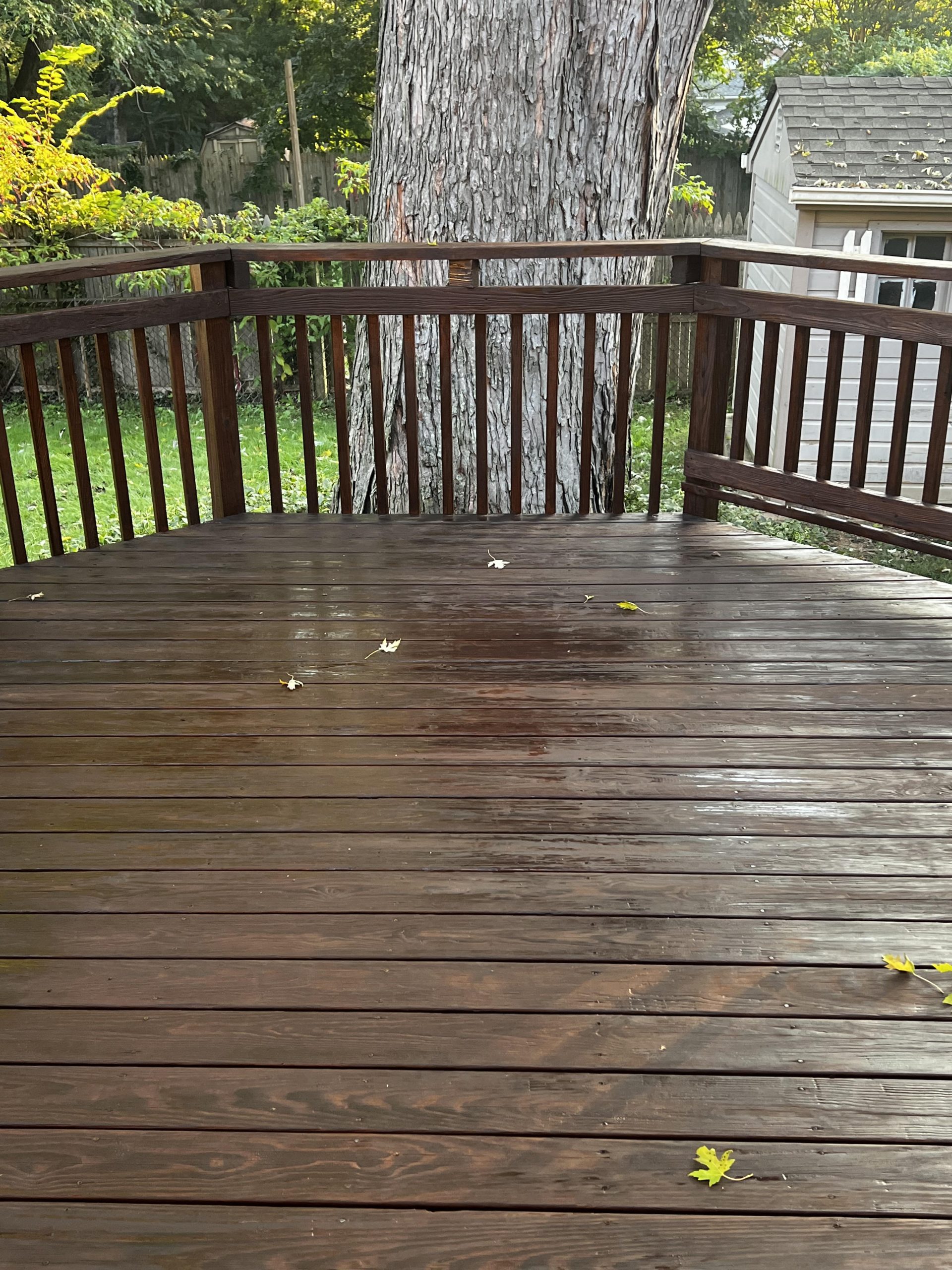

Hi Scott, the deck was finished being stained approx 15 hours ago. I’m concerned the stain didn’t fully penetrate, as you can see wet spots throughout the deck and when I wiped one spot near my door, the stain came off and it’s an orangey color underneath. Dark oak was used. The deck was stripped and brighened, using the boosters. The deck was dried for 3 days before staining and the wood was bare. A sprayer was used and then wiped with a staining pad. 2 coats were put on, using the wet on wet directions. A deck staining company did the work and it’s the first time they used TWP on a deck (they used it on a fence in the past). They followed all directions. What should be done now?
