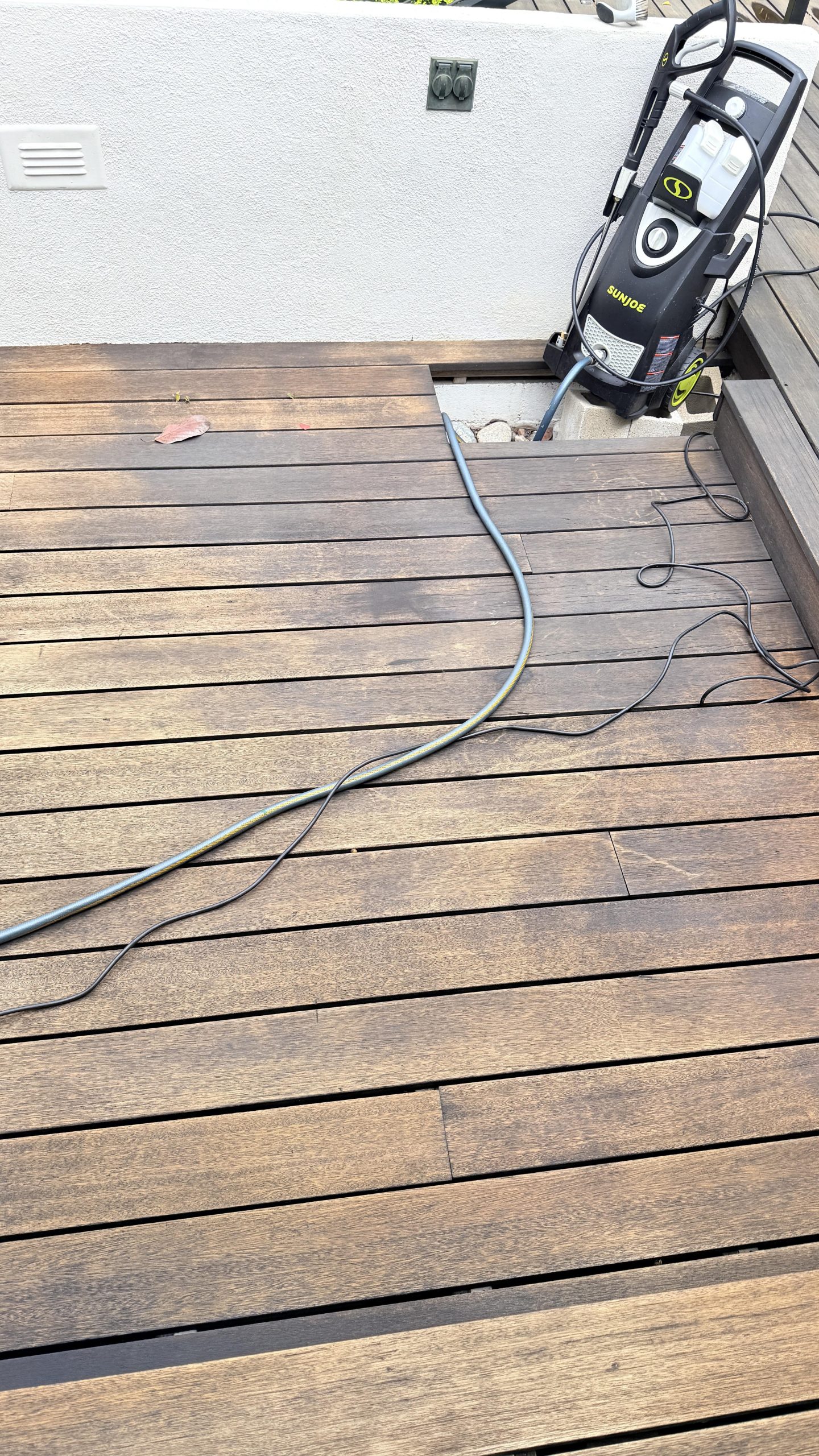

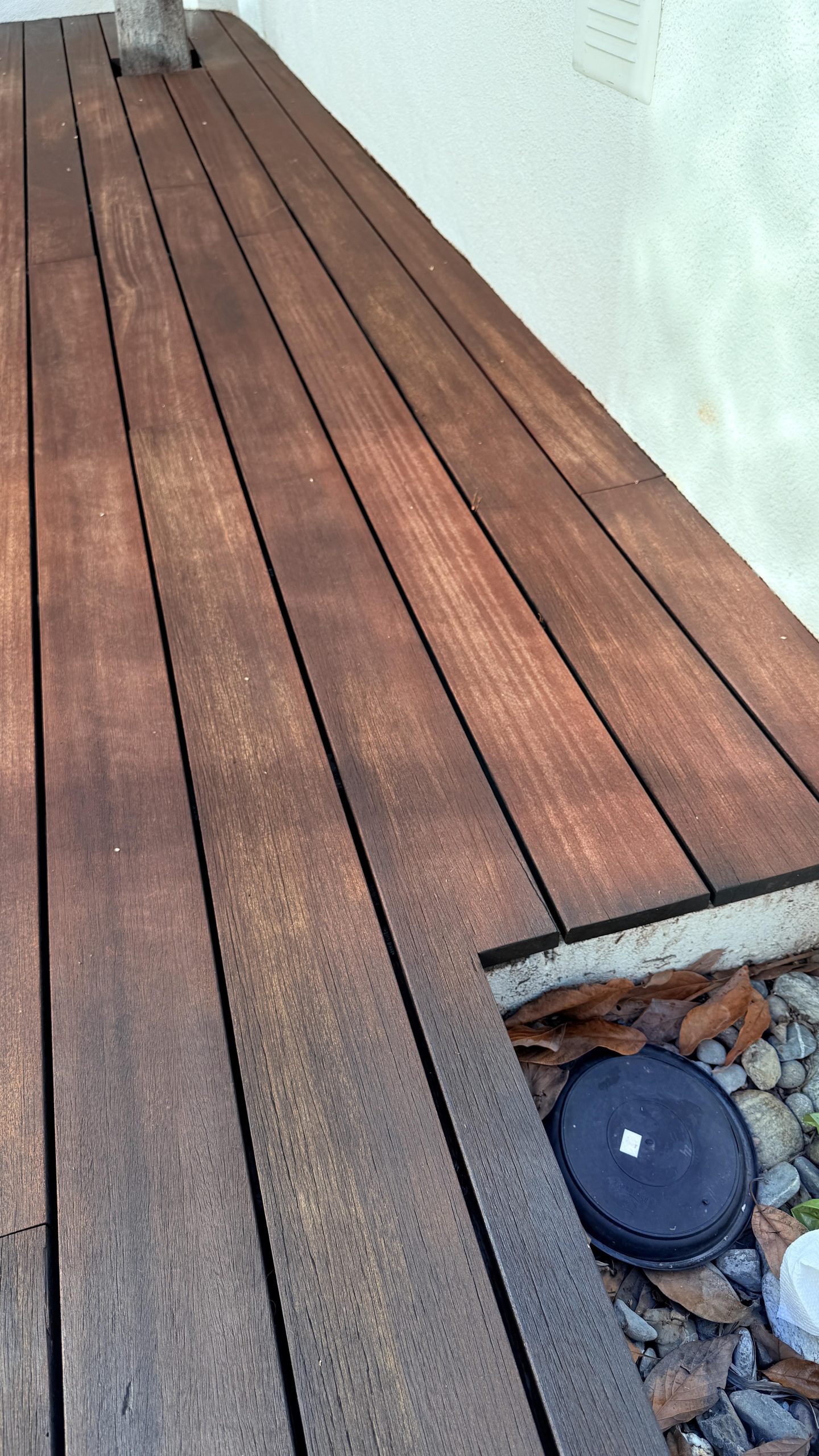

First time using a brightener on my ipe deck and I’m worried I didn’t rinse the brightener off enough yesterday. Is this fine? Do I need to worry about the darker spots vs lighter? Or is this fine and ready for the stain in 48hrs?
That is old stain where it is darker and it will look uneven when you apply a coating as it is now. To fix, you need to strip off the remaining stain and then brighten again.

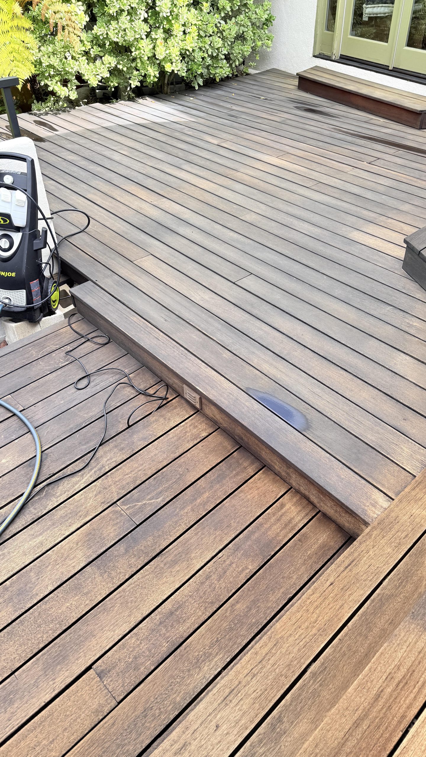

Is it safe to strip the entire deck again or should I spot touch the darker points?
Strip all is correct. You might want to use a better pressure washer. The electric one you have does not have enough PSI and GPM, making it harder to strip then it should. Use a gas pressure washer if possible.

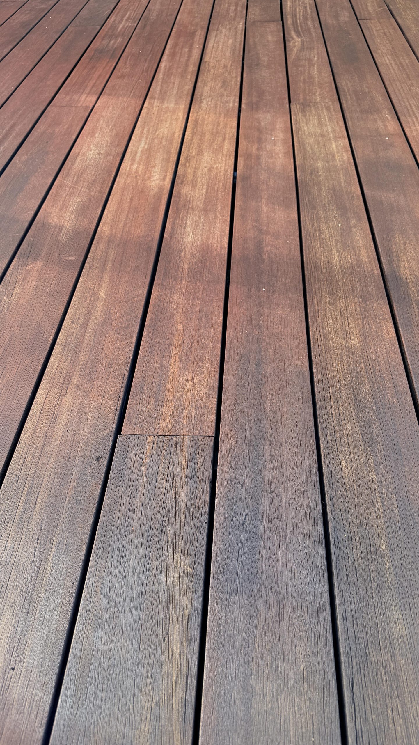

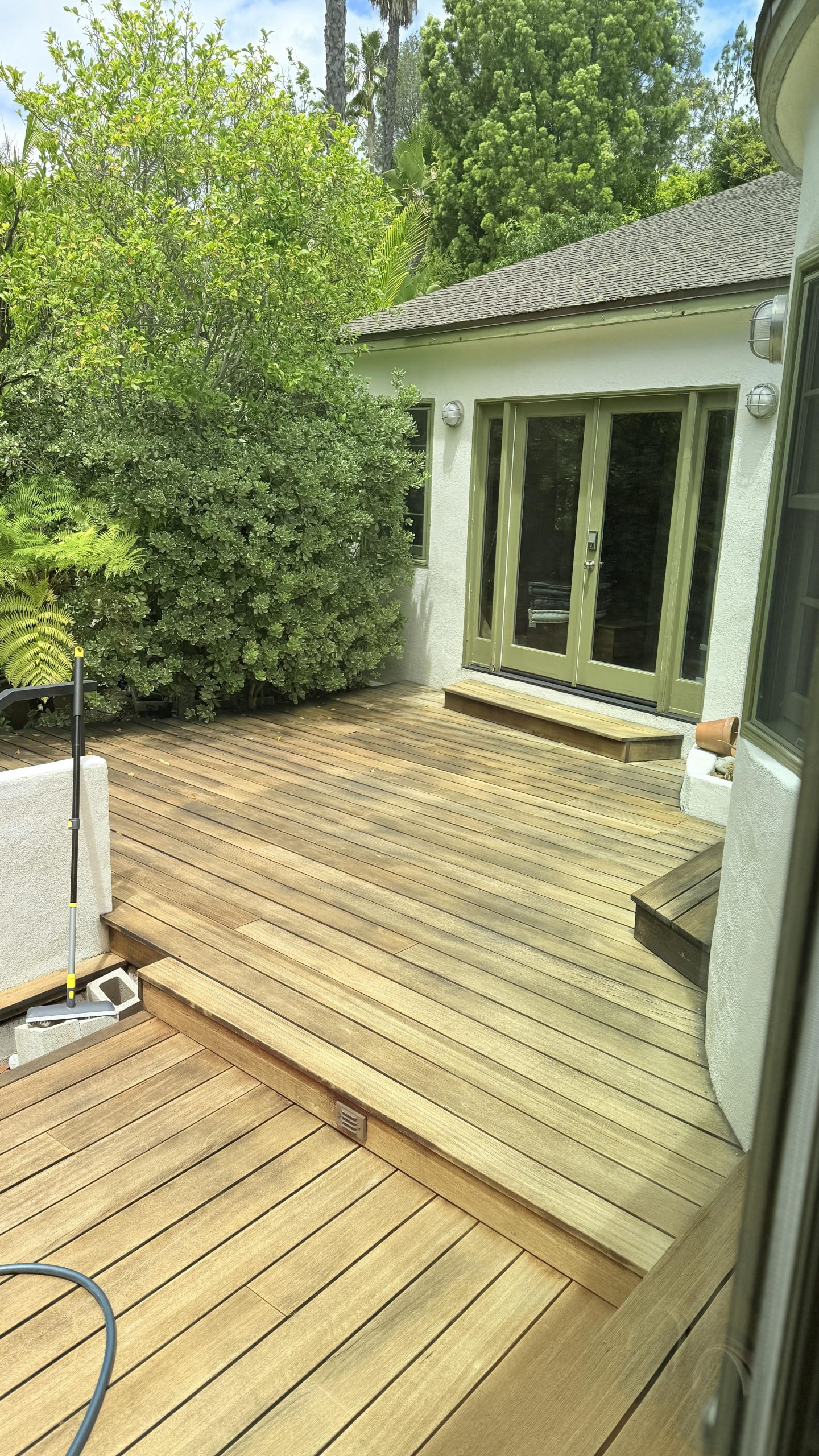

Thanks for all your help! I stripped again and most of the deck is clean, but this section still has some patches. Are these big enough to mess up the oil coat? So do I need to strip again?
Looks good to me!

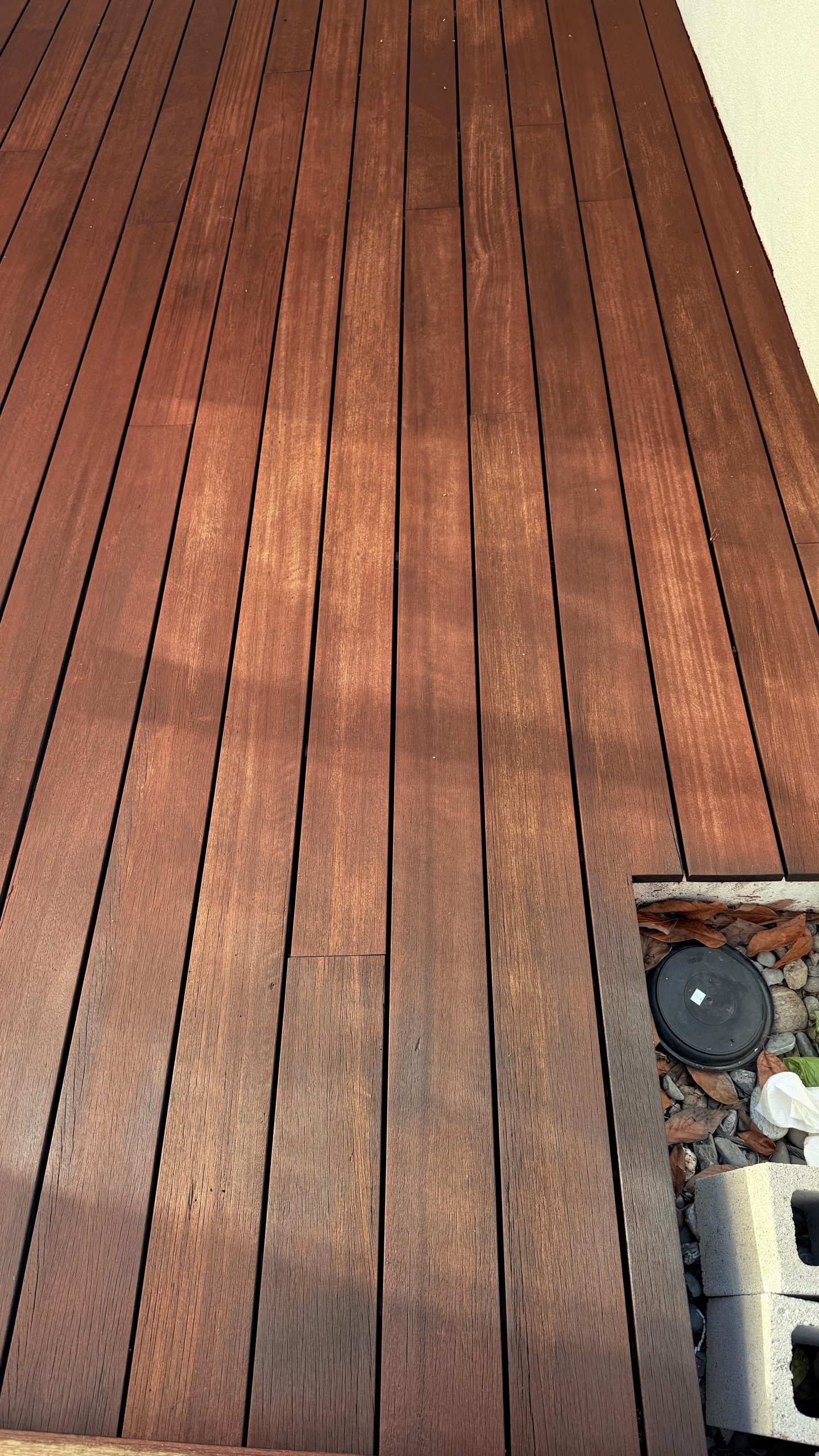

A few oops marks from my pressure washing are showing through the oil. Is this just vanity or is it a reflection of how well the oil has penetrated those spots? Either way, is there anything I can do to correct it? Next time I reapply I’ll sand everything to correct a few boards with some cupping, so it’ll get sorted then if there’s no easy fix now.
Thanks again for all the advice!
Nothing you can do now. It will even out when you redo it in the future.

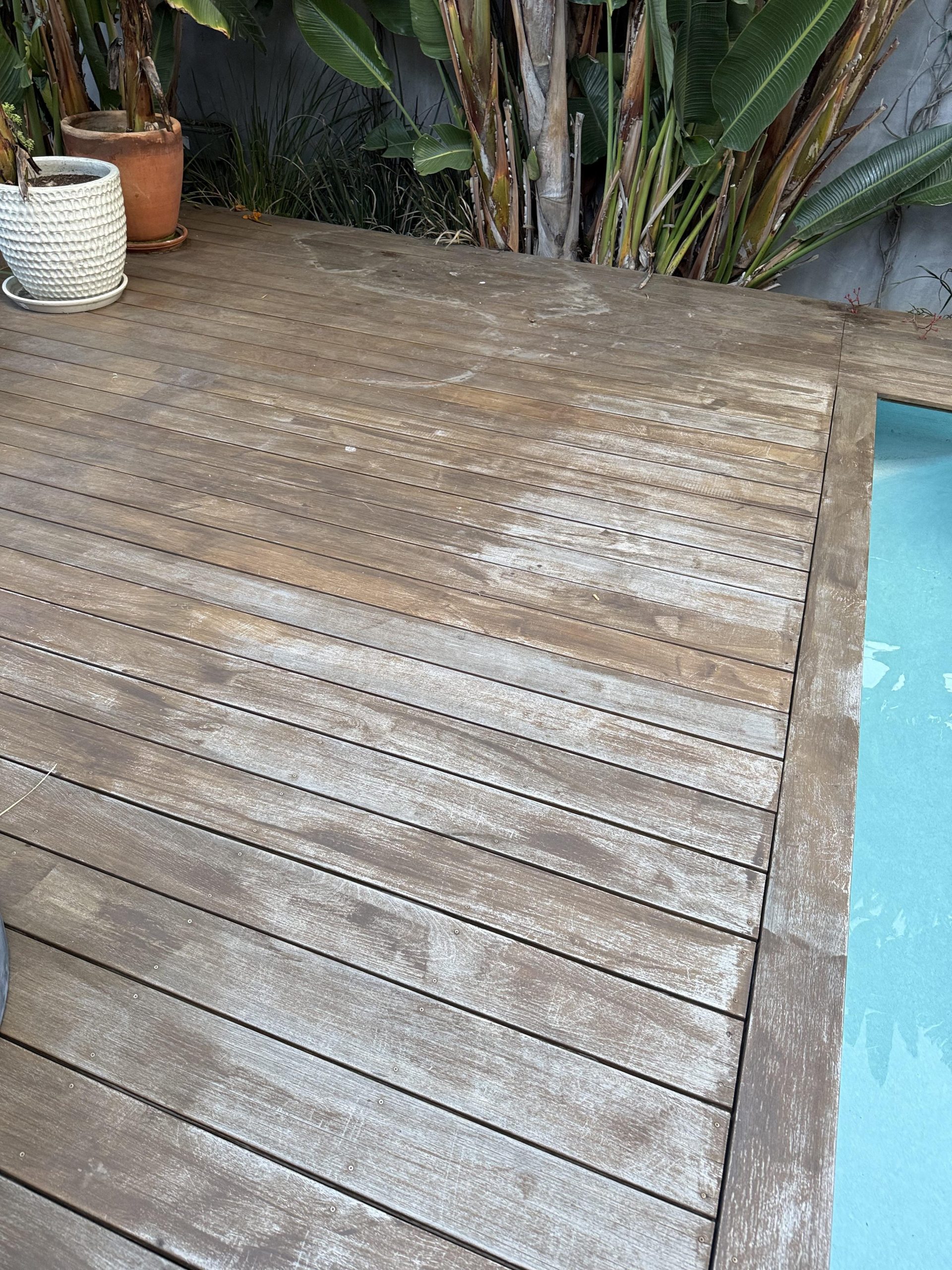

Hi! I am trying to clean up the white patches without redoing the entire deck. Is it possible to just do the cleaning and brightening? I want to get close to the weather dark on the left? Thanks for your help.
No, you have worn stain. The only way to fix this is to strip it all down to the bare wood and then recoat. Make sure to use a proper hardwood stain when done with the prep:
