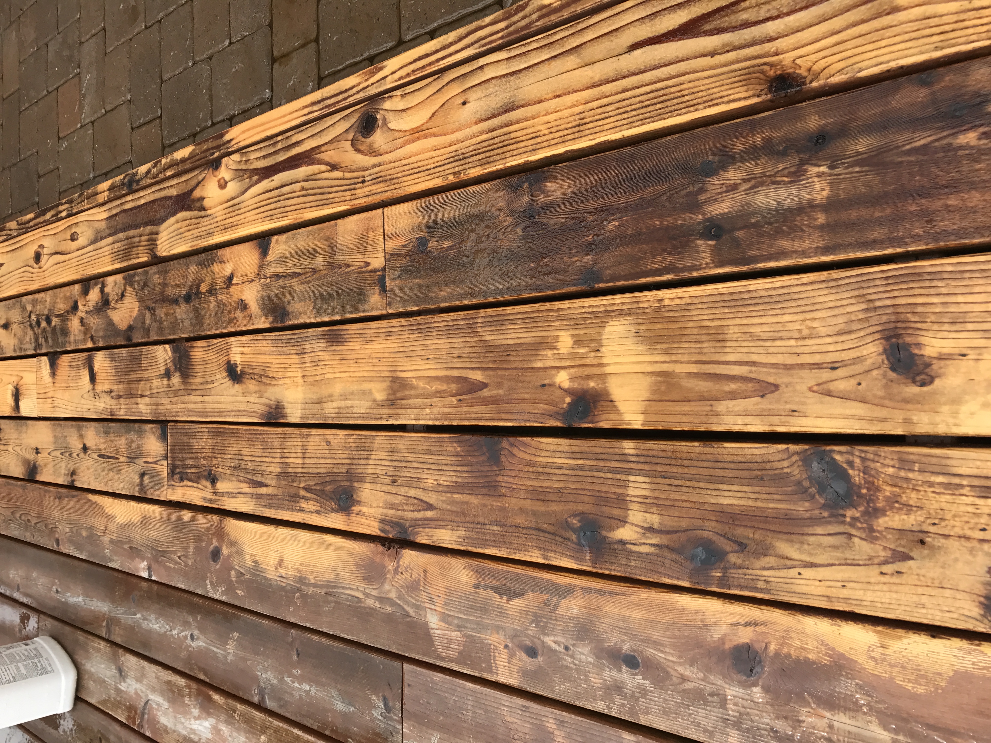

Used the old bleach and tsp cleaning method and pressure washed twice now the areas have a white film over then….sanding is not an option bc the deck has weathered and is not flat….what can I do to remove this film??????
Post a picture.
