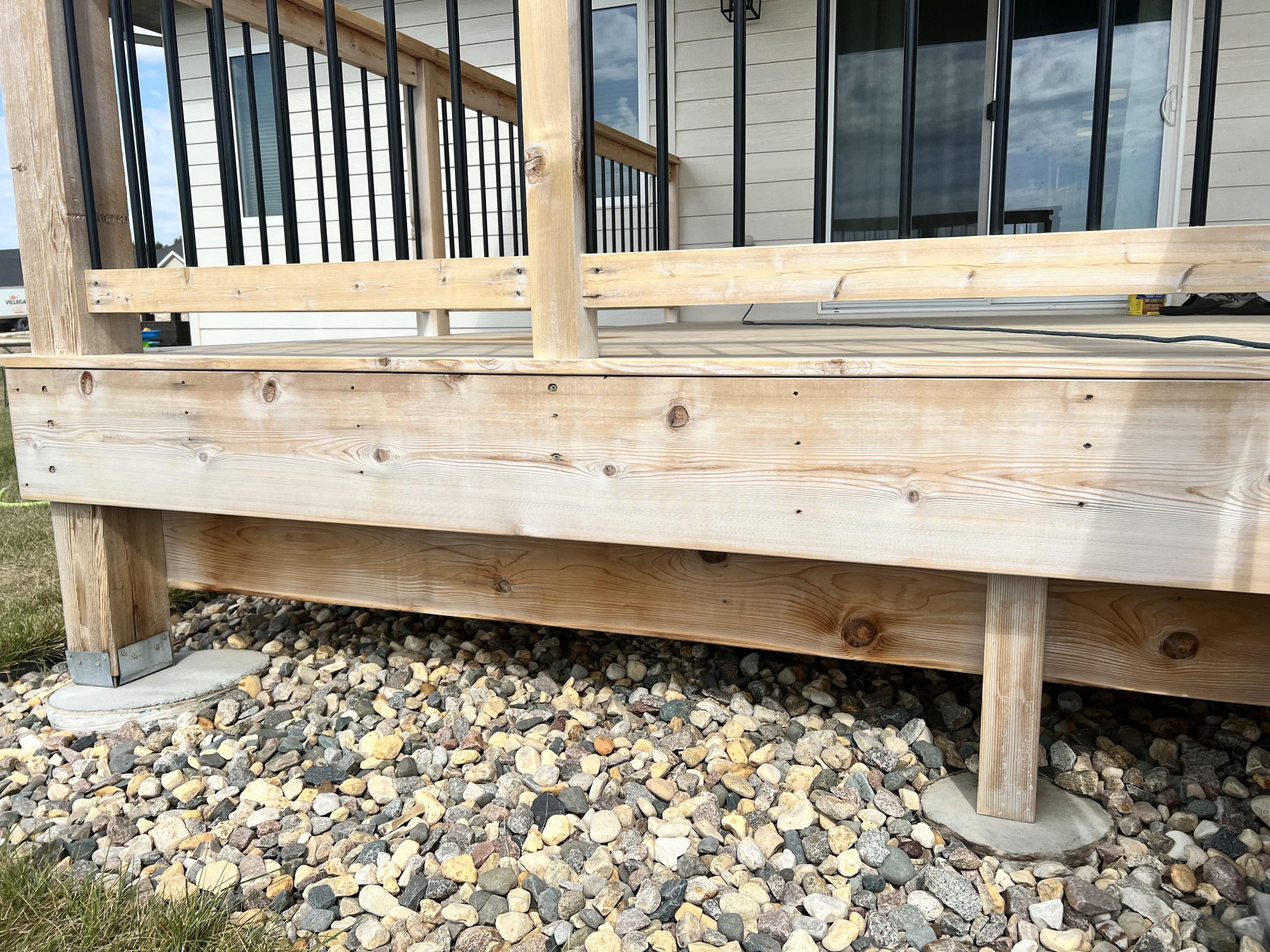

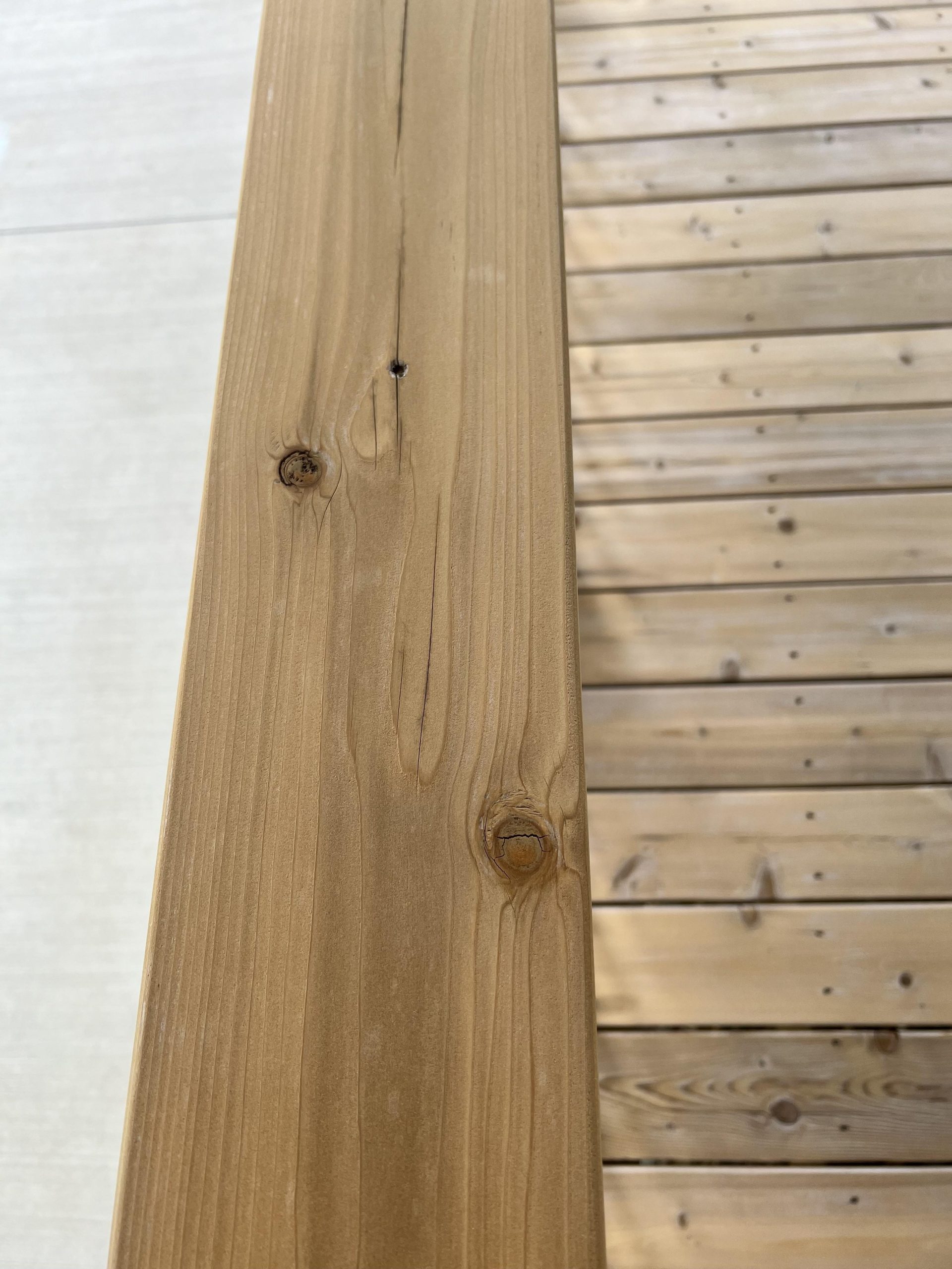

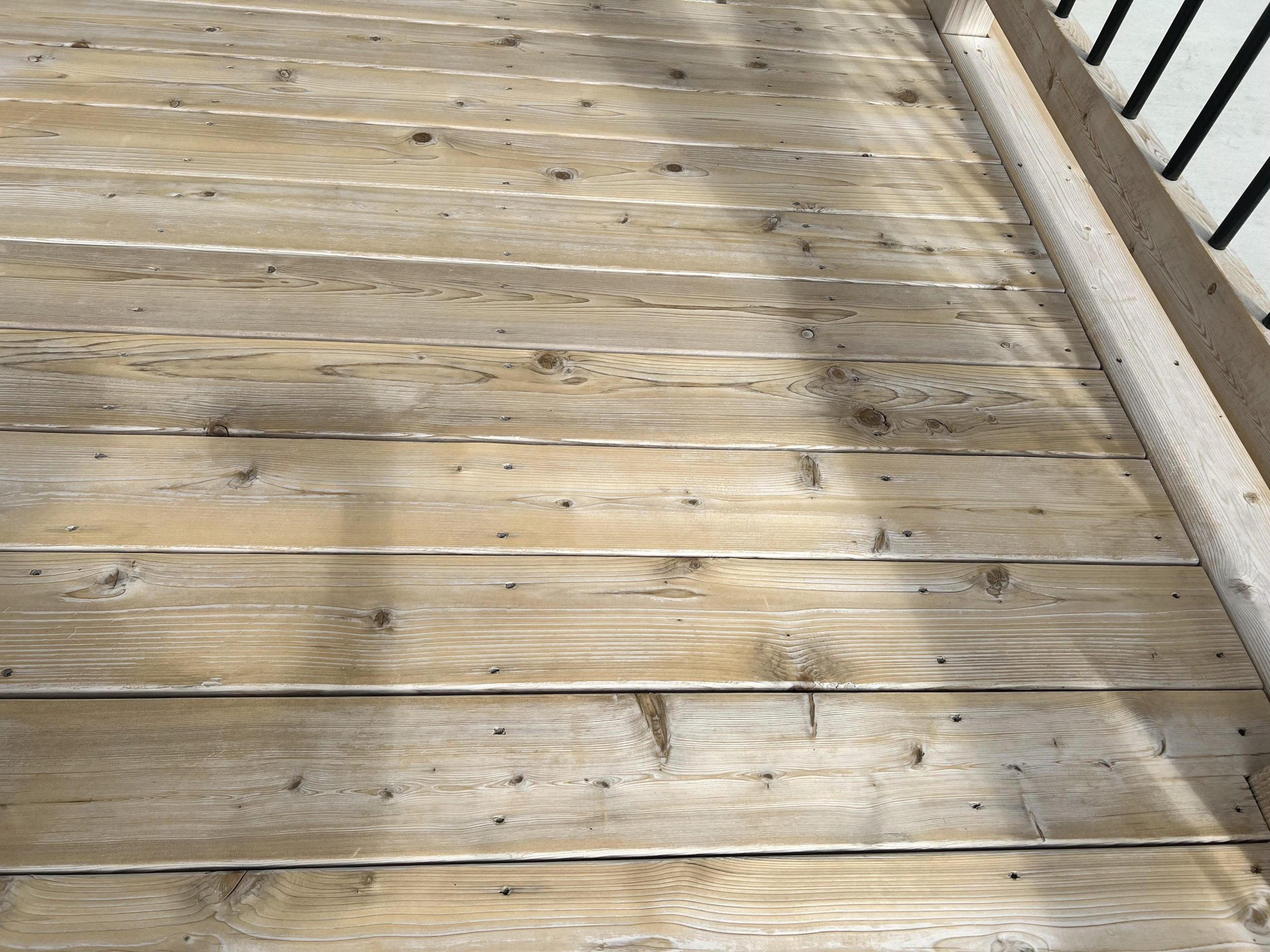

S year old cedar deck that was built last summer in South Dakota (extreme temperatures and both snow/rain). Last winter was fairly mild and we did not allow snow to sit on the deck but the wood had weathered and had small speckles of mold. We got around to prepping the deck for stain a couple weeks ago and am now realizing we made multiple mistakes. We first pressure washed then sanded everything with 120-220 (based on incorrect advice from a local hardware store- first of many mistakes). We then used a deck cleaner, and although we thoroughly washed after, we didn’t do the deck brightener until hours later. The wood then looked white or bleached in areas with some white fuzzies. So we started sanding with 80-180 grit to get rid of the white. Now after reading your sanding post, I believe we cannot stain as the pores are closed due to the finer grit, correct? What should we do about the white/bleached portions that are not fuzzy- Will it take up stain or do we need to sand it down to the raw wood as we had started to? The handrail is down to raw wood. It is mid September and I am worried about leaving it all winter again. It likely will not be nice enough to stain until at least May if we have to wait.
You can wait until Spring to weather this over sanded deck. Clean and brighten for prep and stain then. It will be okay over the winter.

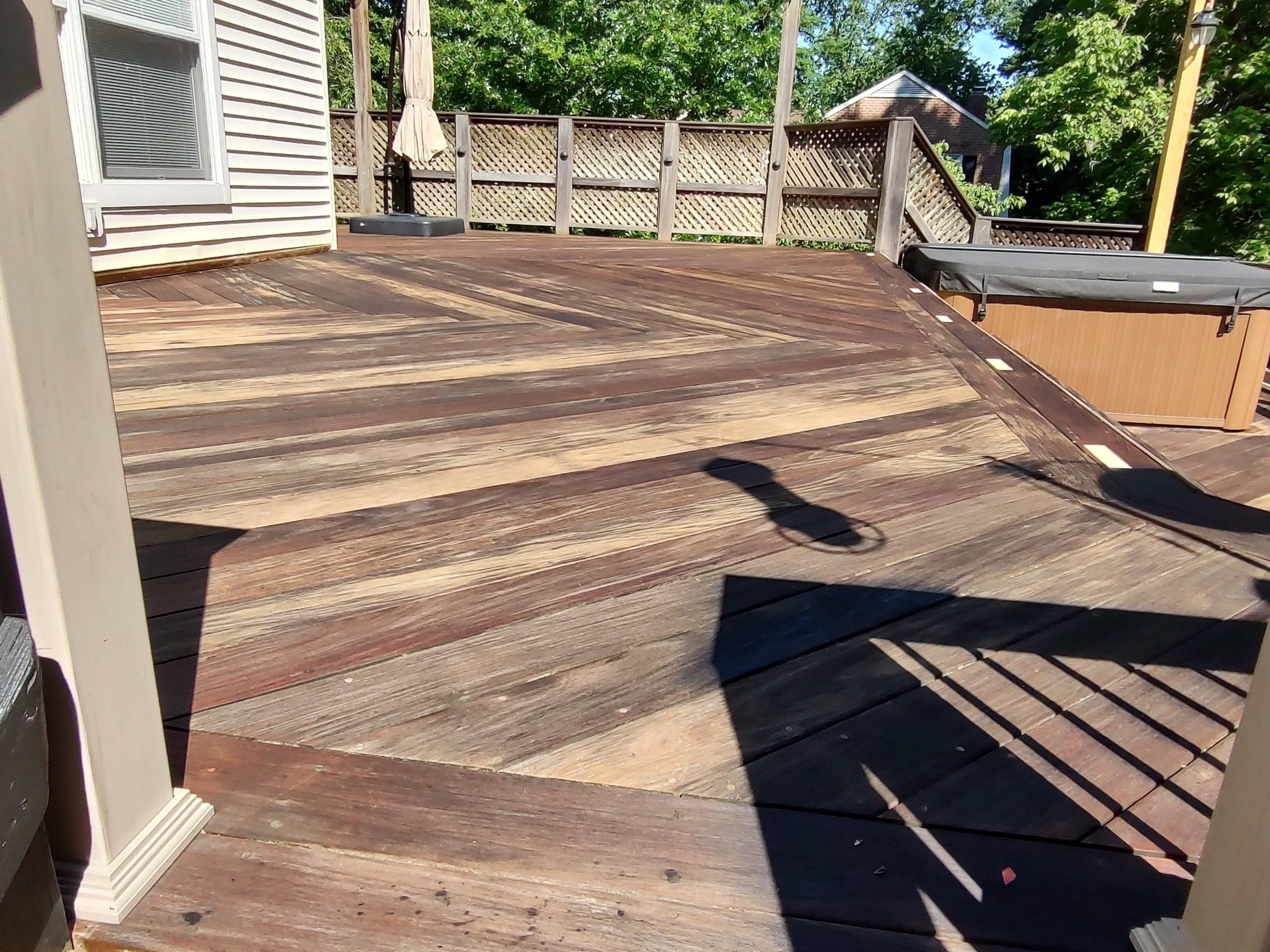

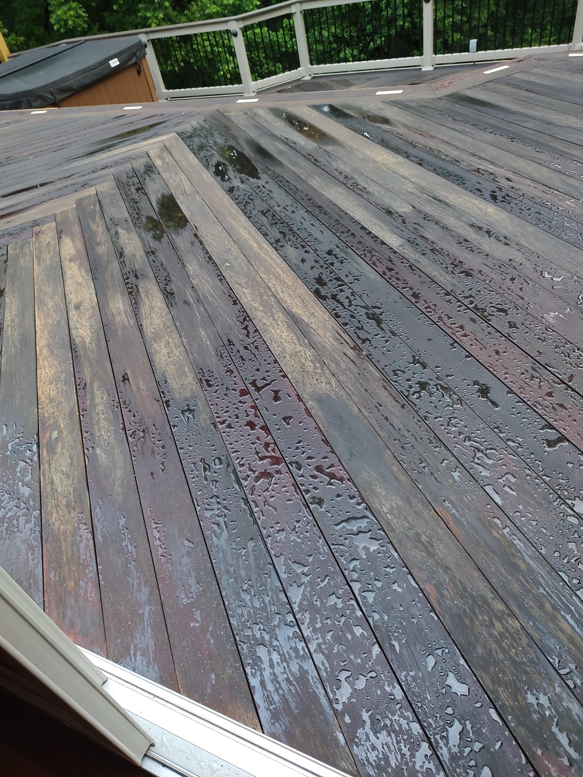

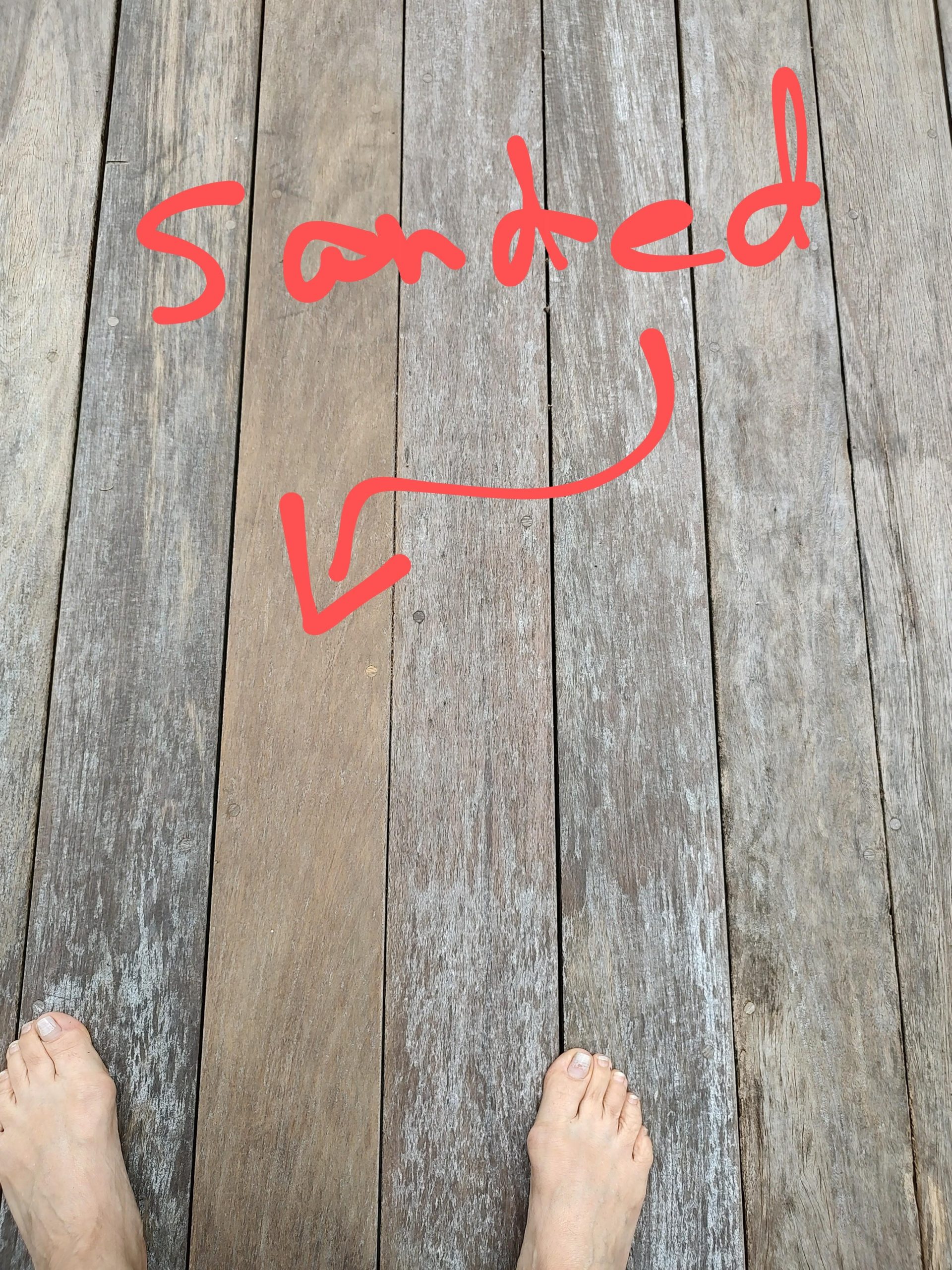

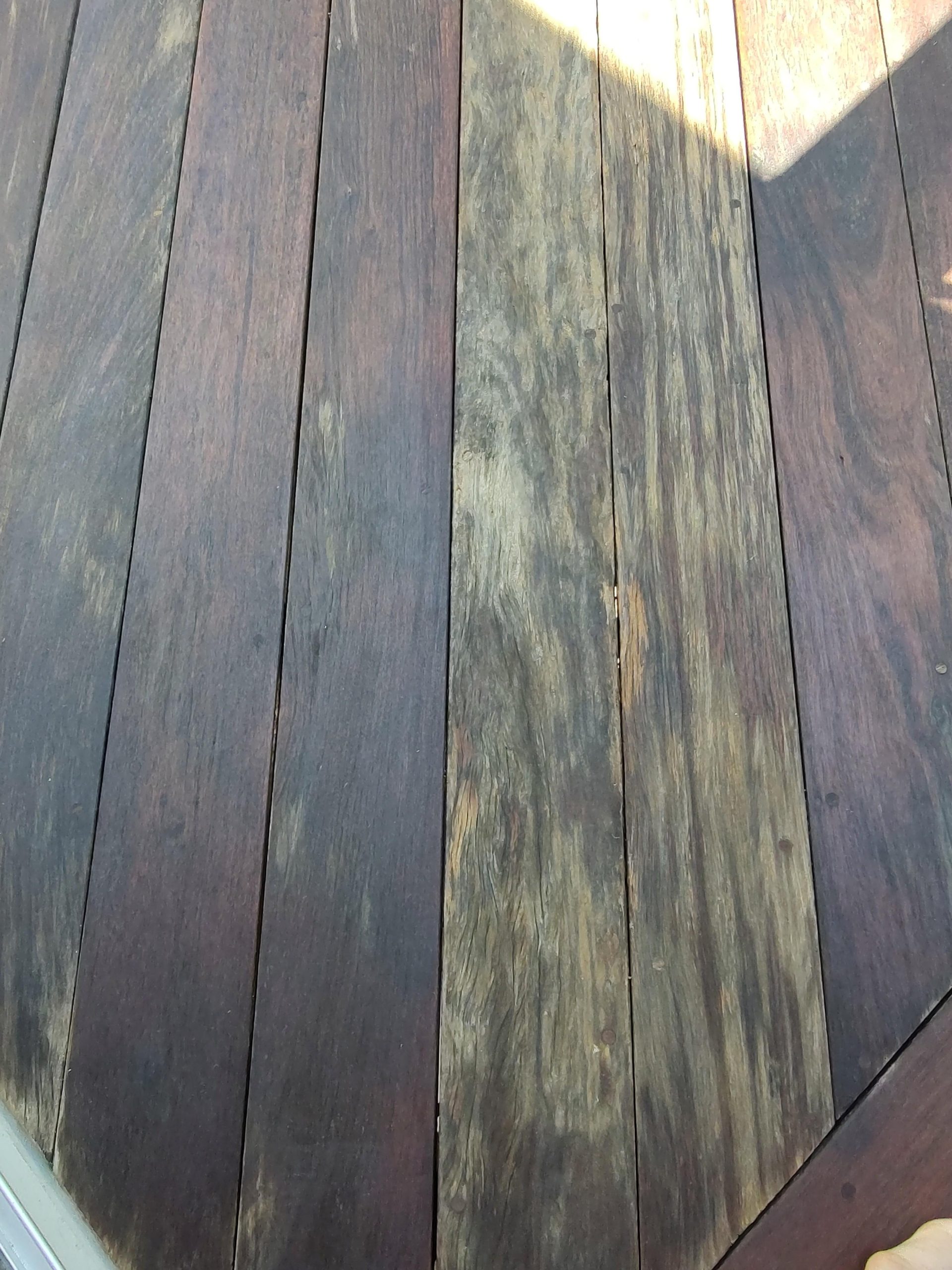

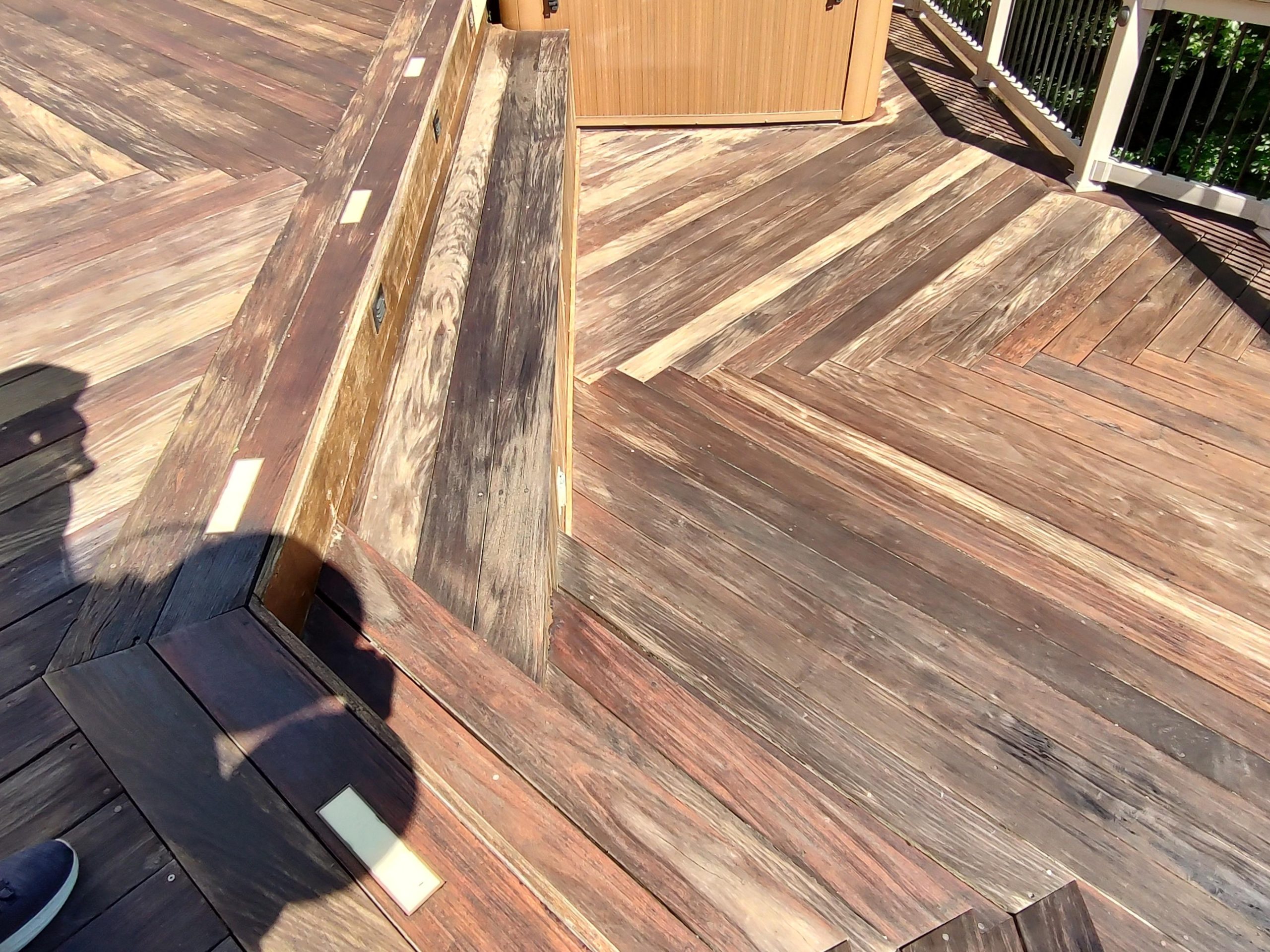

Company power washed unstained Ipe deck with just water ( I think) 10 days ago. The deck went from oxidized grey to blotchy white. They are waiting for dry weather to stain it with a natural colored oil. I took some 80grit sandpaper to some boards and took off the white blotches. Looks so much better. If they don’t sand will the blotchiness go away with the oil or do I need to sand it all off first?
If I need to sand, do I have to clean and brighten?
Oil? Are they any good? What do you recommend for Ipe
Ipe deck, 24yo, facing NE, 800sf still in great condition
Wooded Northern VA, half day blazing sun in summer, gets black slippery dirt when wet
Picture is after power washing. Company suggested Palm sanding with 120grit.
Thank you! in advance.
SB
That is furring. Best to buff it off. Never sand or buff finer than 60-80 grit.
Well, the company came back after 4 weeks (it’s been raining every other day) to sand (he said it was 80grit) and put the oil (Messer’s oil and Ipe Oil) on the deck and it started raining when he was almost finished. The beautiful IPE deck looks like a zebra. I think it was not sanded enough. He wants to put more oil on it.
I’m sick. More oil? leave it alone until next year? Now what do now to remedy my Ipe situation? Thanks Paul.
SharonB
If it was us, we would remove and start over. Strip and brighten.

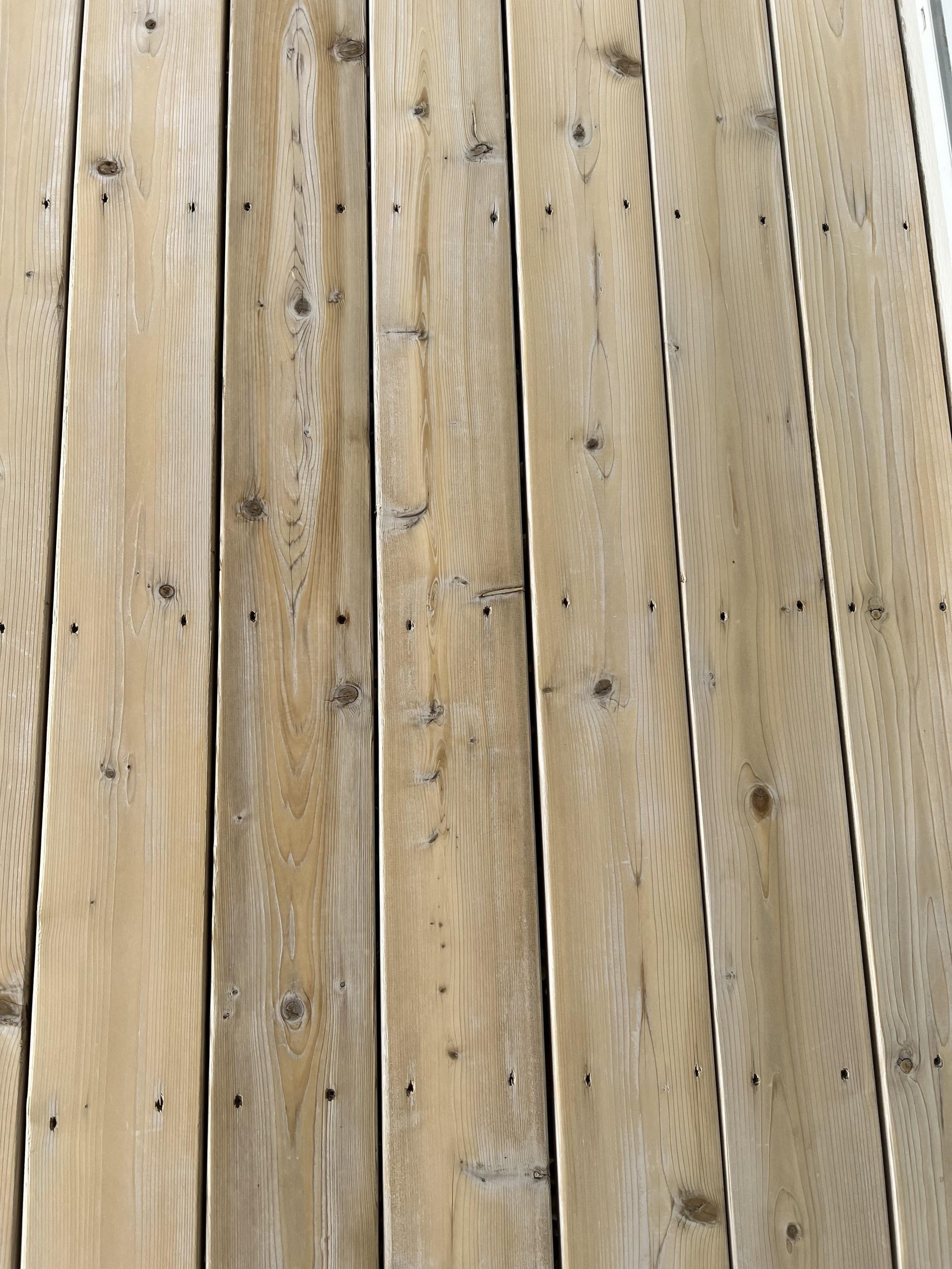

I had someone clean our new PT deck 5 days ago, then they came out and got paint splatter all over (long story). I decided to finish the job myself to avoid a long drawn out situation. I went out today to start trying to get the paint off and noticed the deck already looking discolored and see a lot of wood fibers coming off the boards. Pictures are of the deck as it looks now, and one section where I sanded to get the paint off.
Do I need to start all over by sanding, cleaning, and brightening the deck before I stain? It’s been weathered a year already (another long story). I appreciate any advice you may have. This deck project has been a total nightmare from the beginning.
They furred it up with the prep. See tips:
You will need to sand it to fix this.
Thank you so much for the reply! Do you think I should wash and brighten again or will sanding be enough?
Yes, you need to brighten again after to open the grain and remove sand dust.
