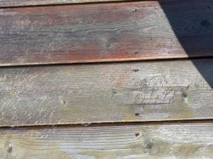

I’m rehabbing a 25 yr. old deck. Floor, top rail and steps have new pine boards (weathered for 6 months), but railings, stringers remain with redwood stain. I’ve started sanding the railings, stringers and 4×4’s, to remove the redwood color and to remove some of the sun damage from the wood. The contractor says I don’t need to continue sanding; he’ll clean and brighten the deck and then stain – 2 coats of semi-transparent on the floor/steps and solid on the railings, stringers. Thoughts?
You do not have to remove teh red stain from the railing fully if you are using a solid stain over it.

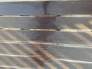

Brand new deck, aged 5 months, all sealed except my wife placed a metal plant stand on the unsealed deck and when we moved it it left a rust stained ring. My wife got out a palm sander and sanded the ring out but used the whole surface of the sander to do it. Now we have a two foot in diameter “whiteish” mark on the deck. My thought is to not stain it and let it weather for a few months to “darken” it up some, then seal it. What would you do?, thank you in advance for your advise
You cannot blend this with the other wood unless you even it all out and that will require stripping off the sealer, weathering it for a few months, clean it all, and then recoat.

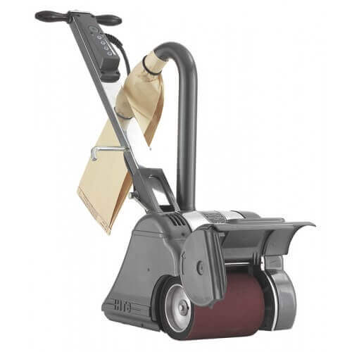

What kind Of hand sander is the best to use on a deck?
Palm sander.
Drum sander. 8″ Home Depot. Done over 3,000 this way.
I second the drum sander, and will add edger to the mix for the edges and railings. Doing a deck with a palm sander is CRAZY. Like cleaning your bathroom with an electric toothbrush!
Drum sanders and edgers have a bit of a learning curve. If you are going to do it yourself, I would recommend the YouTube channel “How to sand a deck.” It is a British guy, but he knows his stuff. One of his videos is a reaction to the top hits on YouTube about sanding a floor. His techniques are tried and true, and he demonstrates and explains the science of wood sanding very well. Best of luck!

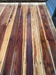

I have sanded, washed and brightened my deck and am ready to stain (after 48 hours of dry weather). After removing the old solid stain, I found the cedar has an uneven “two-tone” natural color to it. I was planning on using a semi-transparent stain. Will that even out the coloring? I don’t really mind the two-tone, but I don’t want it to look like a mistake. Would it look weird to leave it?
Staining it will not even it out. It is just how your wood is. You need to stain it for UV protection.
Oh my gosh, that wood grain is stunning!!!
Thats the woods natural color. Its a blend of heart (Red) and sap wood (white). Its a bit lower quality of wood as heart is more dense (middle of tree). There is no way to make a single color is using a semi-transparent sealer (which you NEED to use to avoid future sanding). Ive used what they now call 1500 series TWP and like Calif redwood color. Ive used over 4,000 gallons gallons of TWP in 30 years. I was fortunate to speak to the inventor of the product. He also formulated the paint that coats the Alaska pipe line.

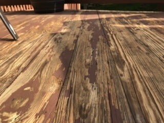

I power washed, cleaned and brightened then stained my deck 2 years ago with SW Superdeck solid stain. After 2 years the stain all peeled off on nearly every board but some new boards that I replaced. The deck is weathered and previous owner did not care for it. Was this due to poor prepping? Should I sand this time around for better penetration? If so, you recommend sanding first then cleaning and brightening? Thank you!
Pressure wash and strip off the loose stain. Let dry and sand any more loose solid stain. Cover the intact stain with a new coat of solid stain: https://www.deckstainhelp.com/what-are-the-best-solid-color-deck-stains/
Here is a photo. Same recommendation? Thank you again for all your help!

Use a rented squar buff sander (Home Depot or rental places). Go 36, 60, and finish with 100. Take your time, you’ll be amazed at the results.
